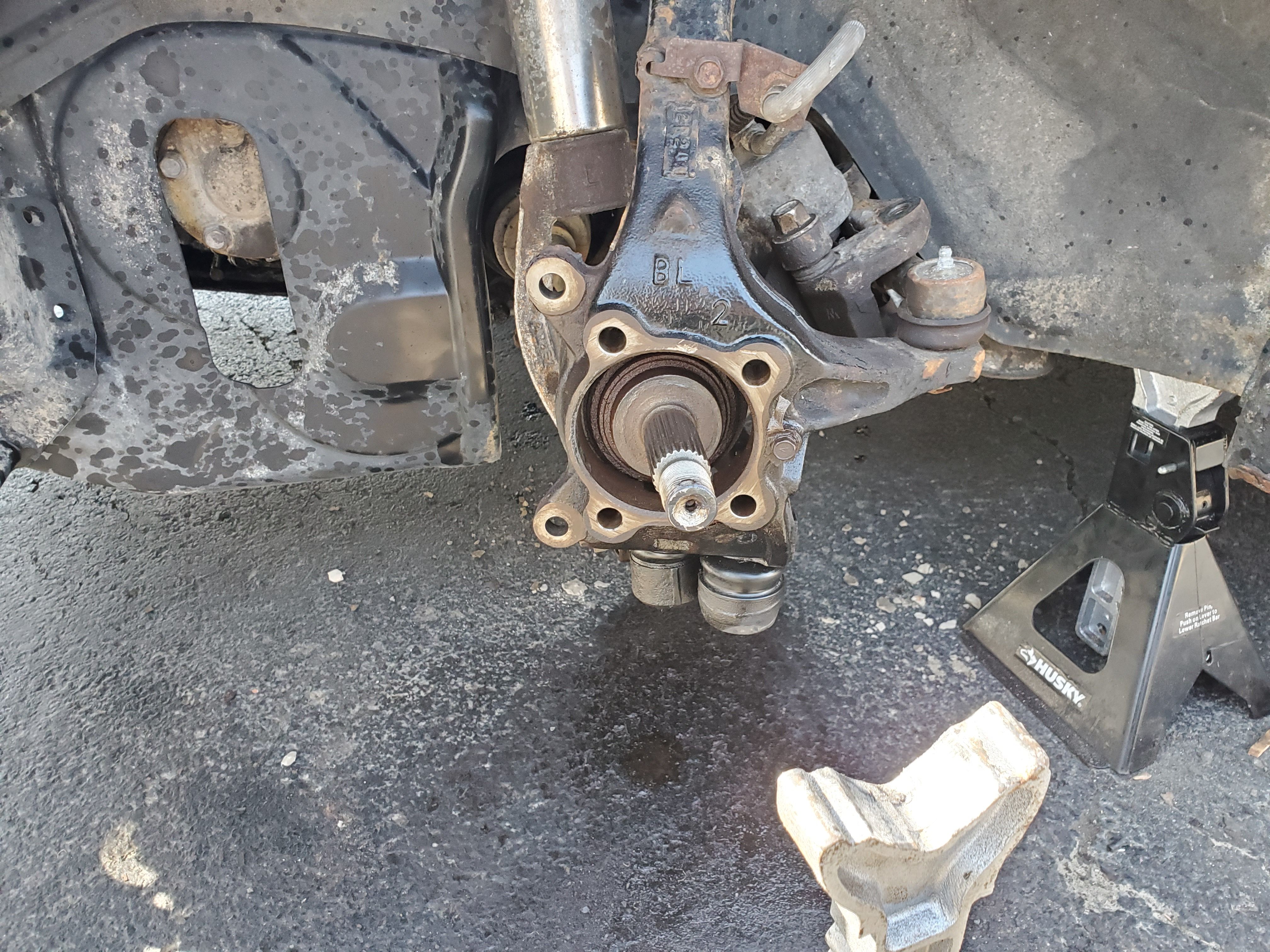

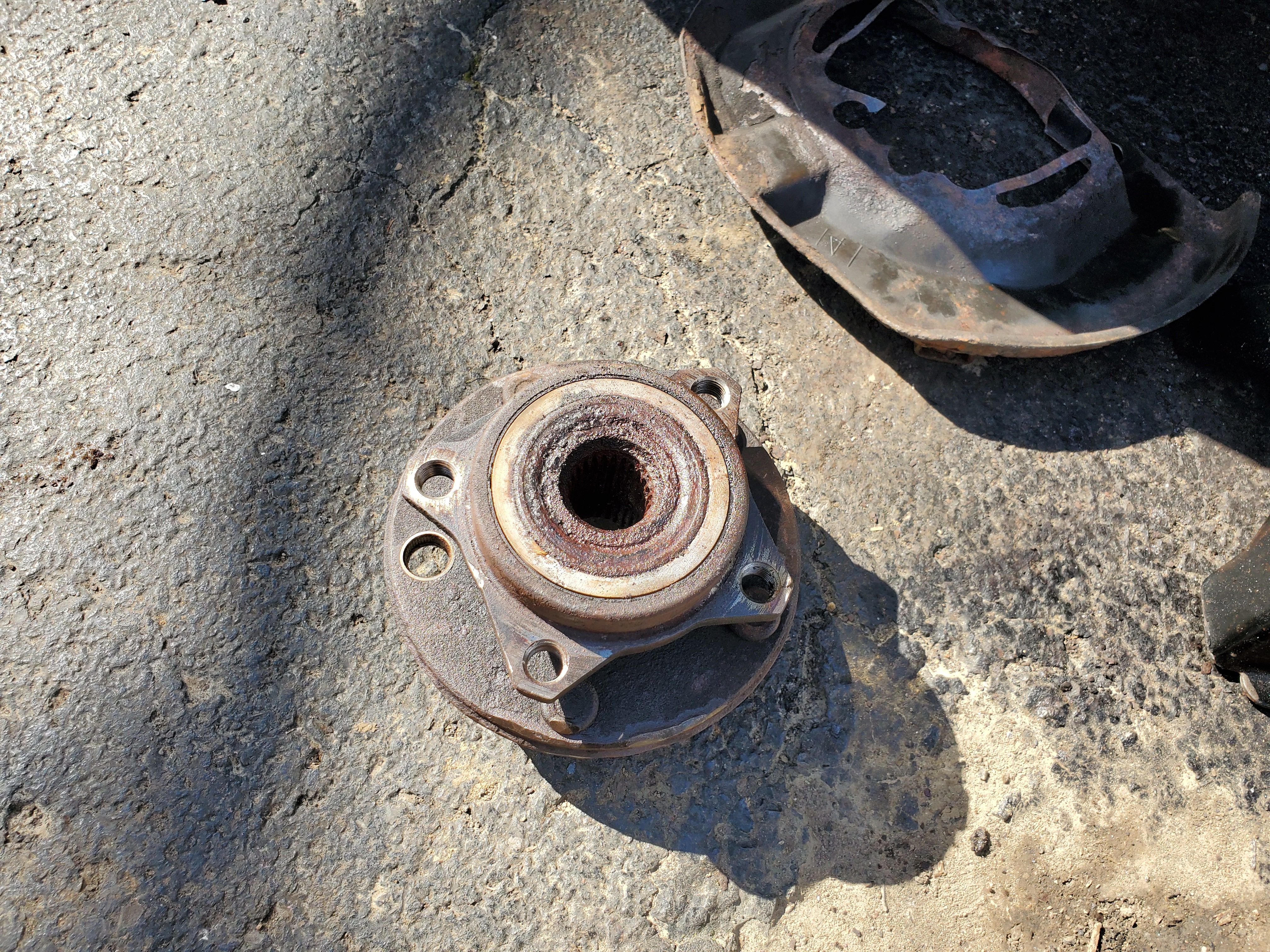

Next on my list is full bearing hub assembly replacement and new rotors and restoring the calipers, she should be solid after that. Still have idle issues, I believe it's the IAC or the evap leak. Might just take it to a shop for the evap leak since I dont have a smoke machine, it's a p0455 btw for reference.

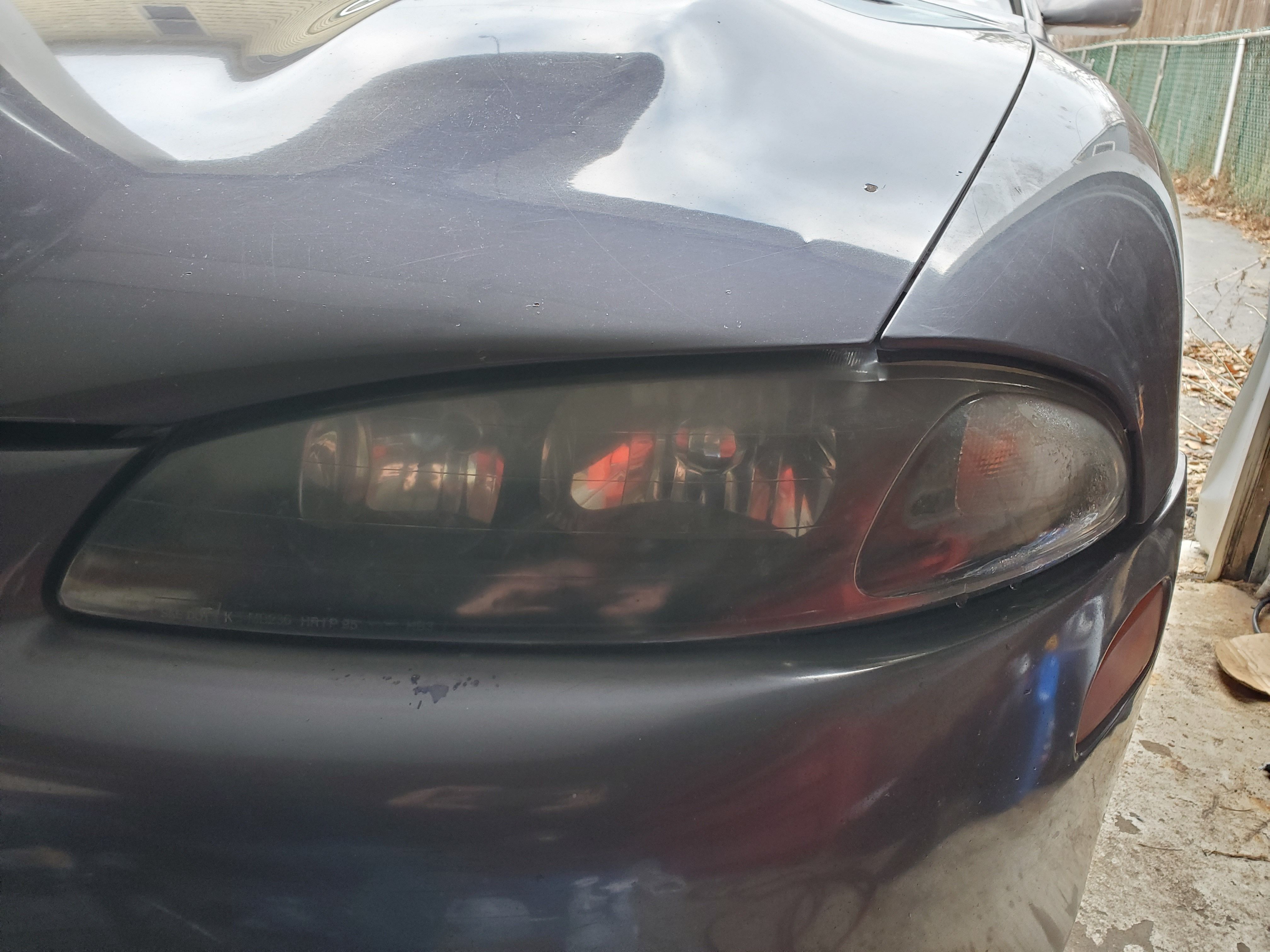

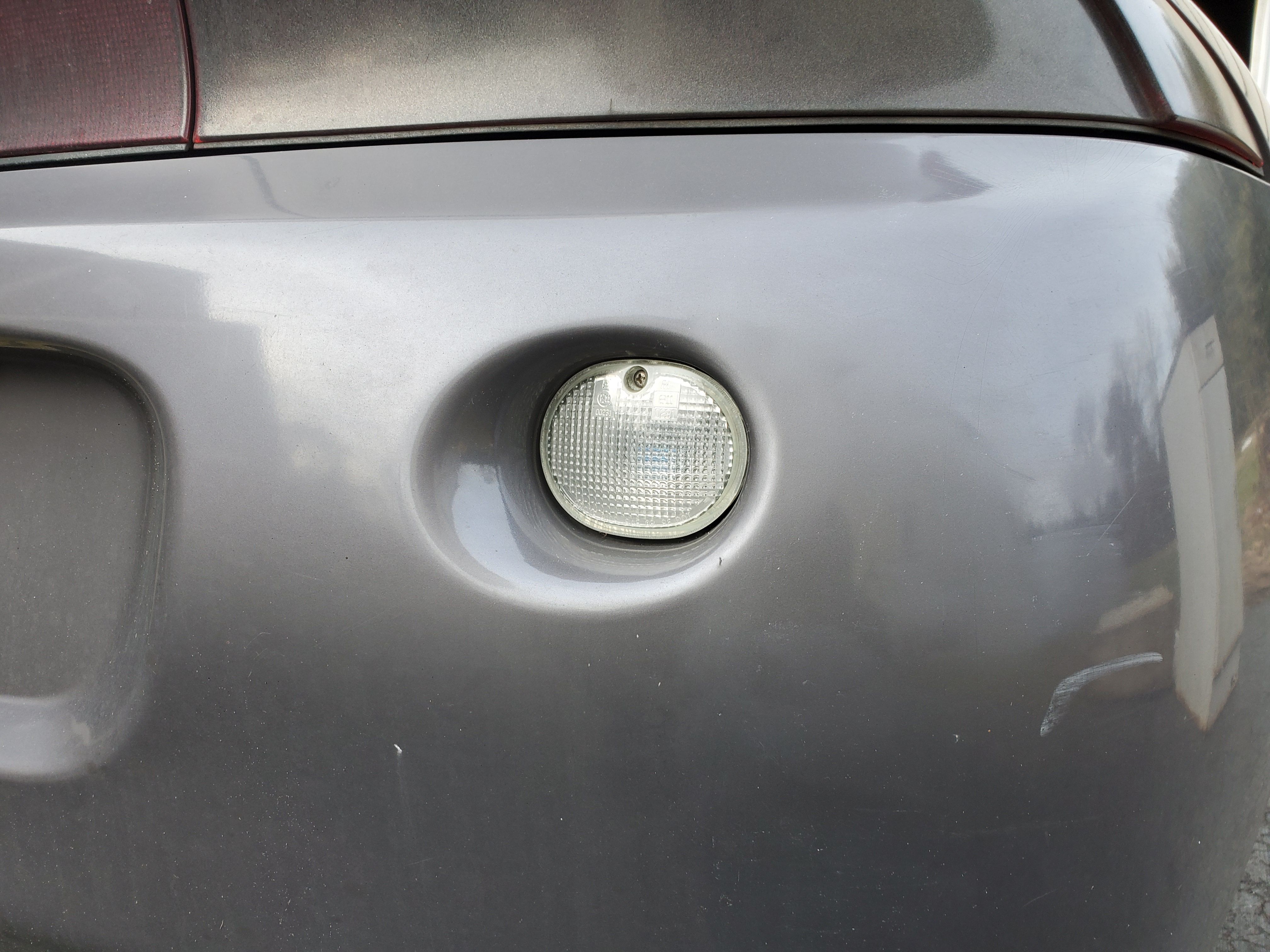

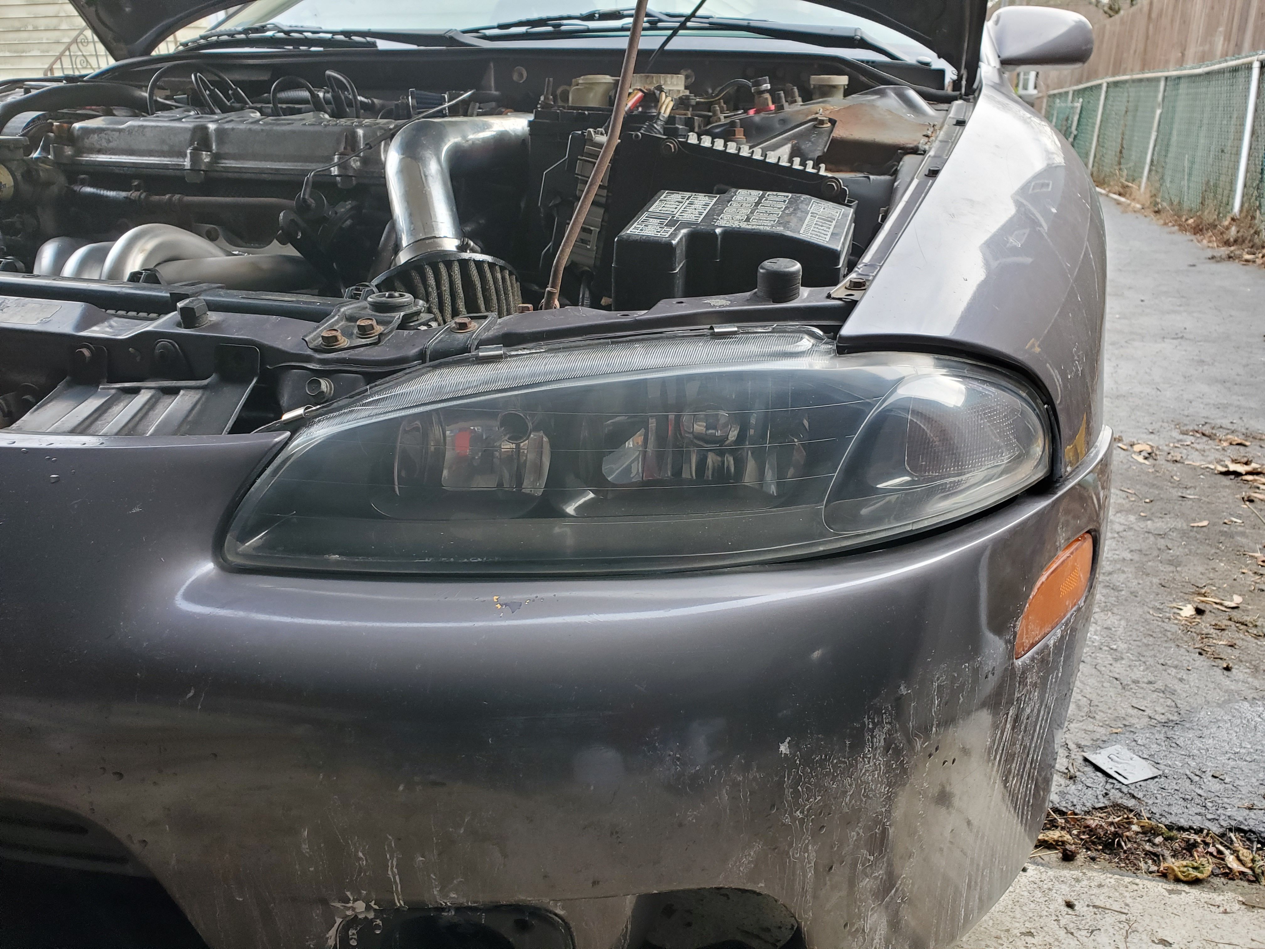

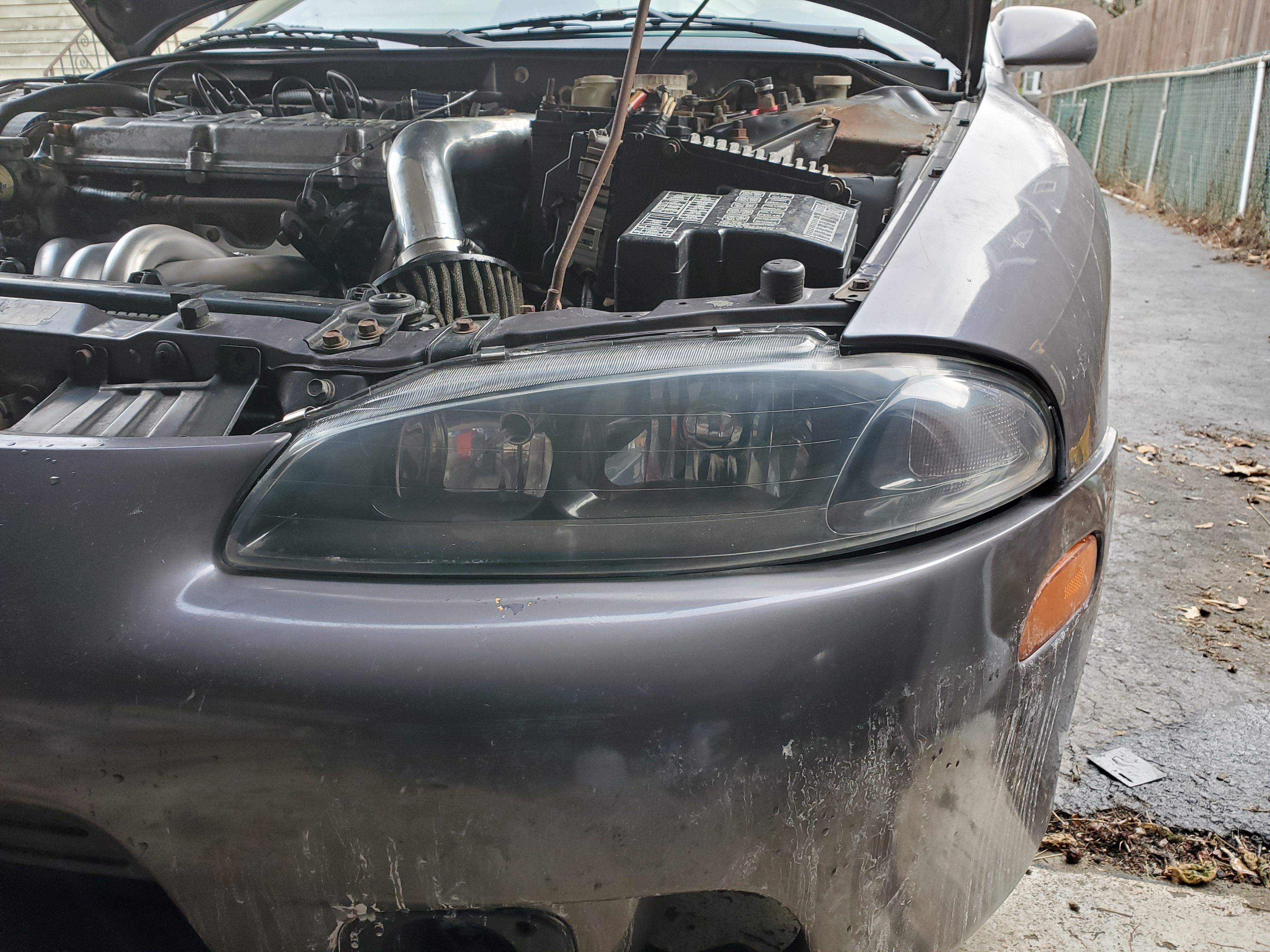

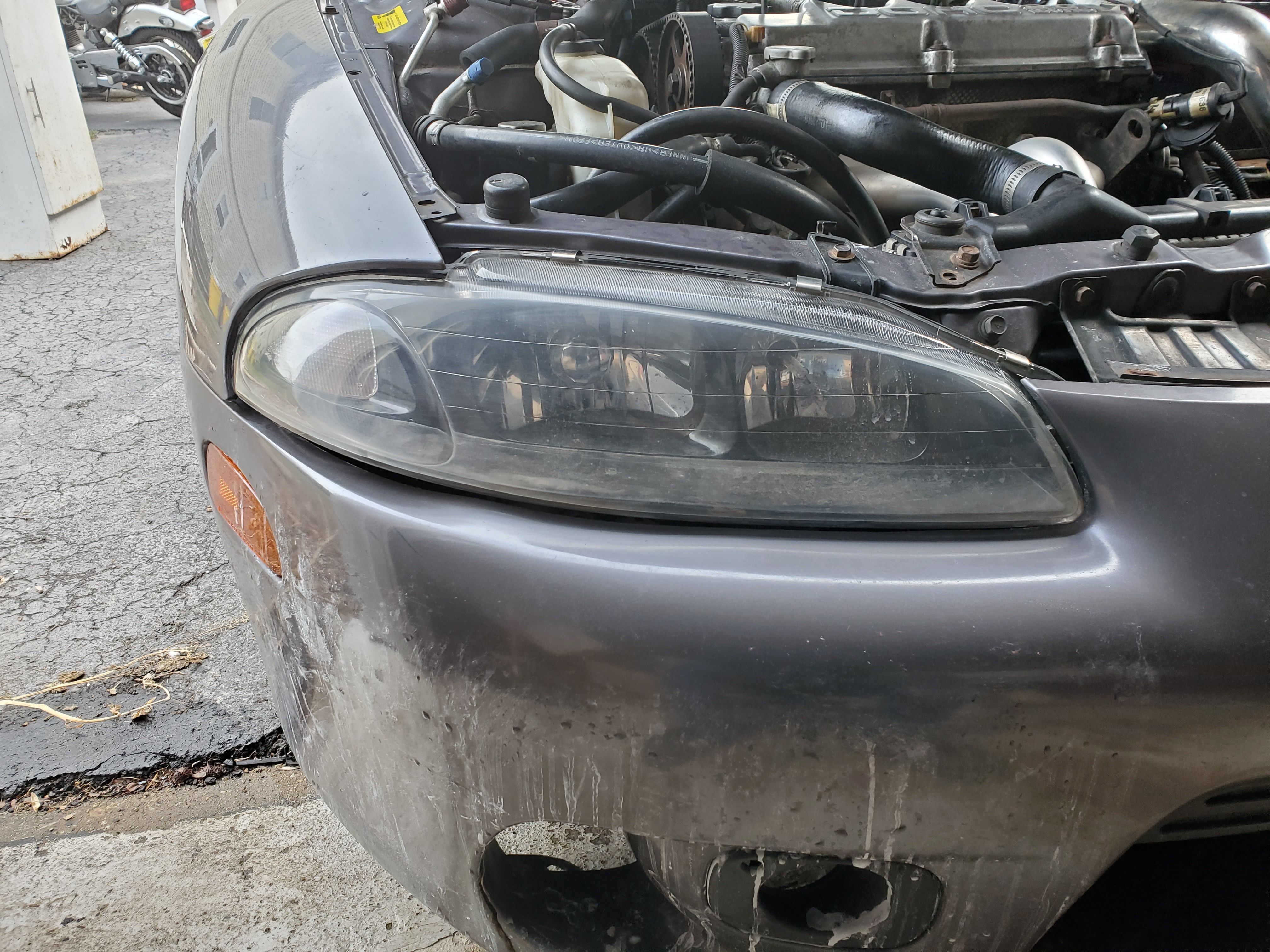

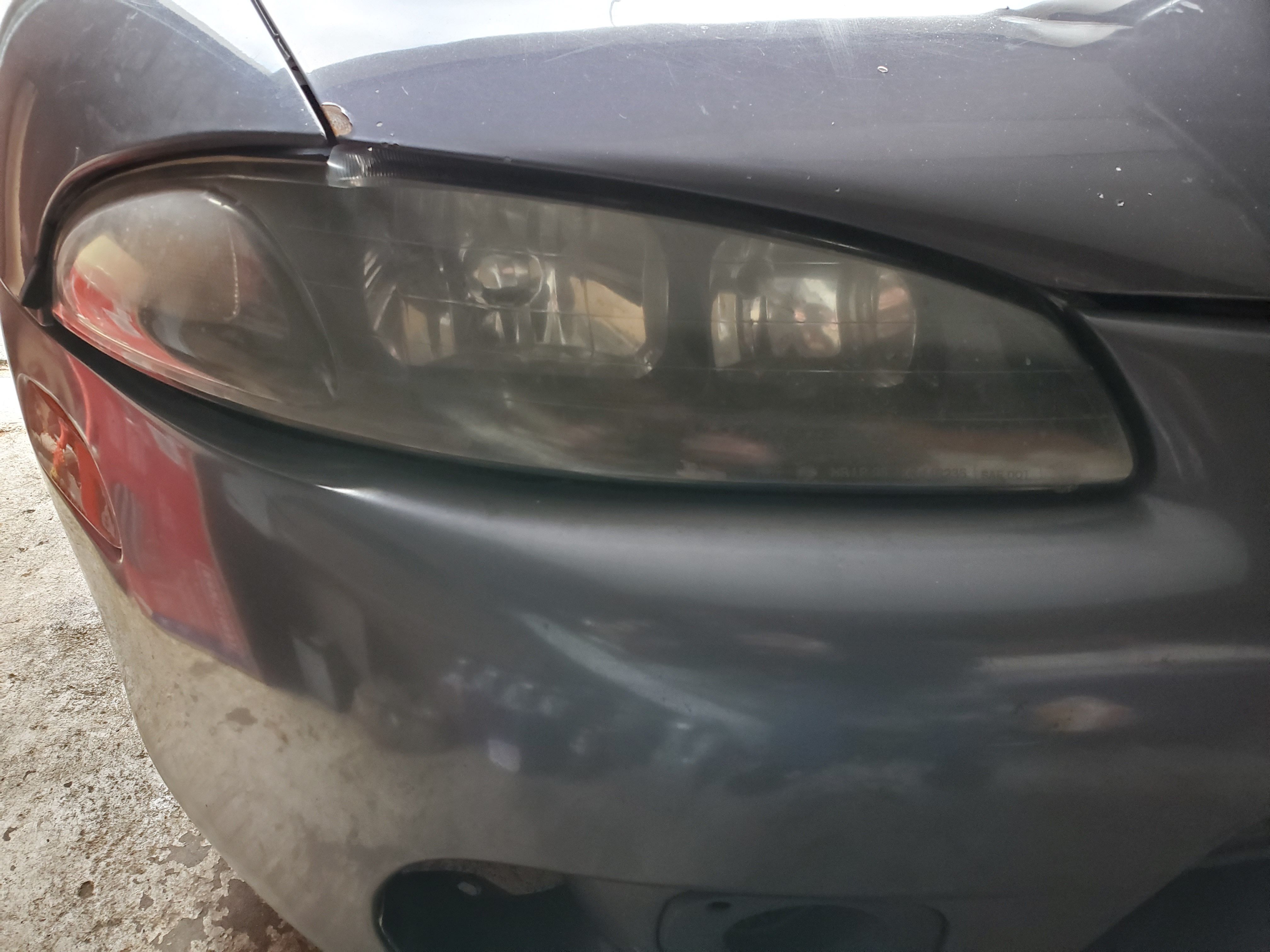

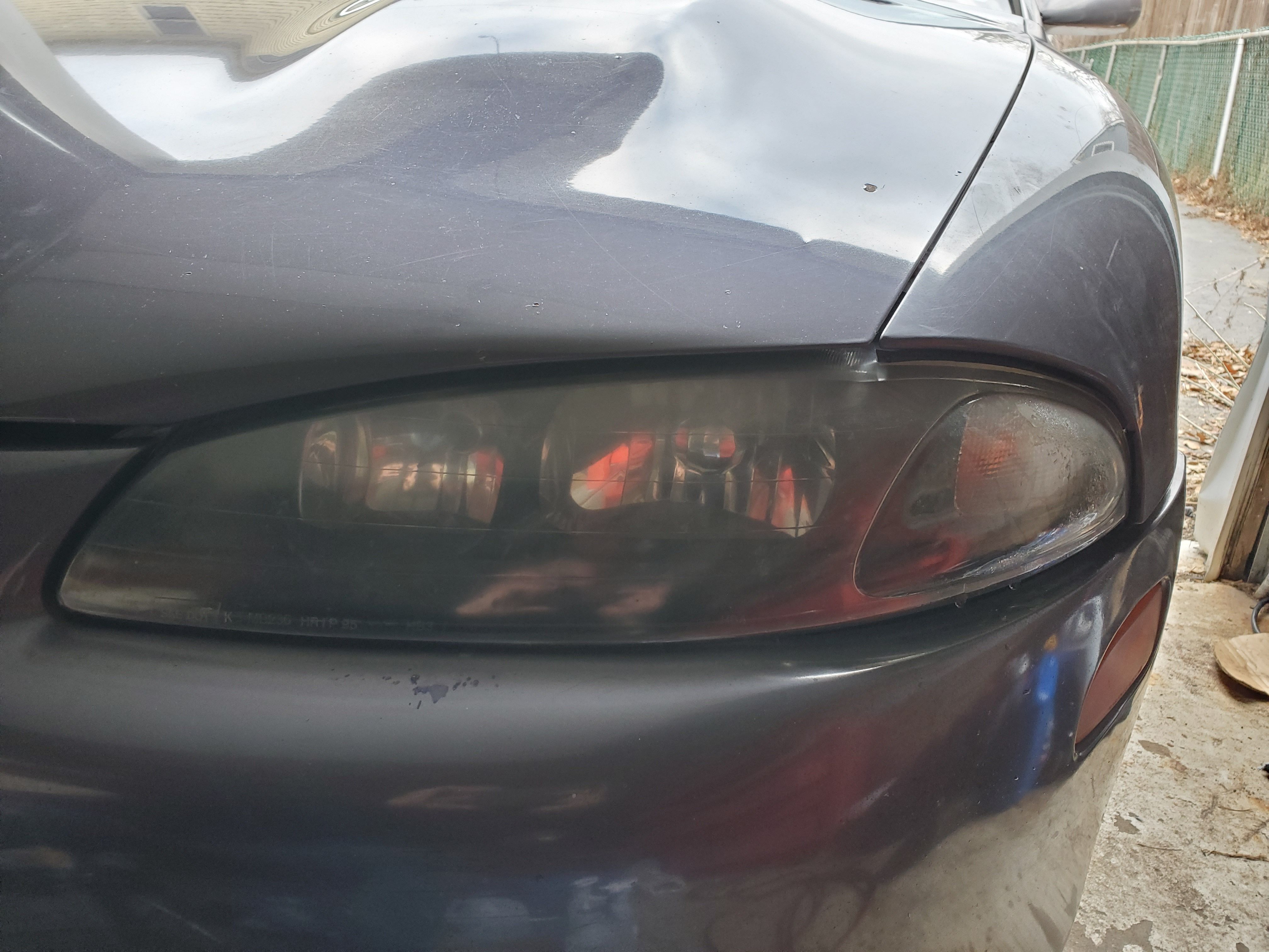

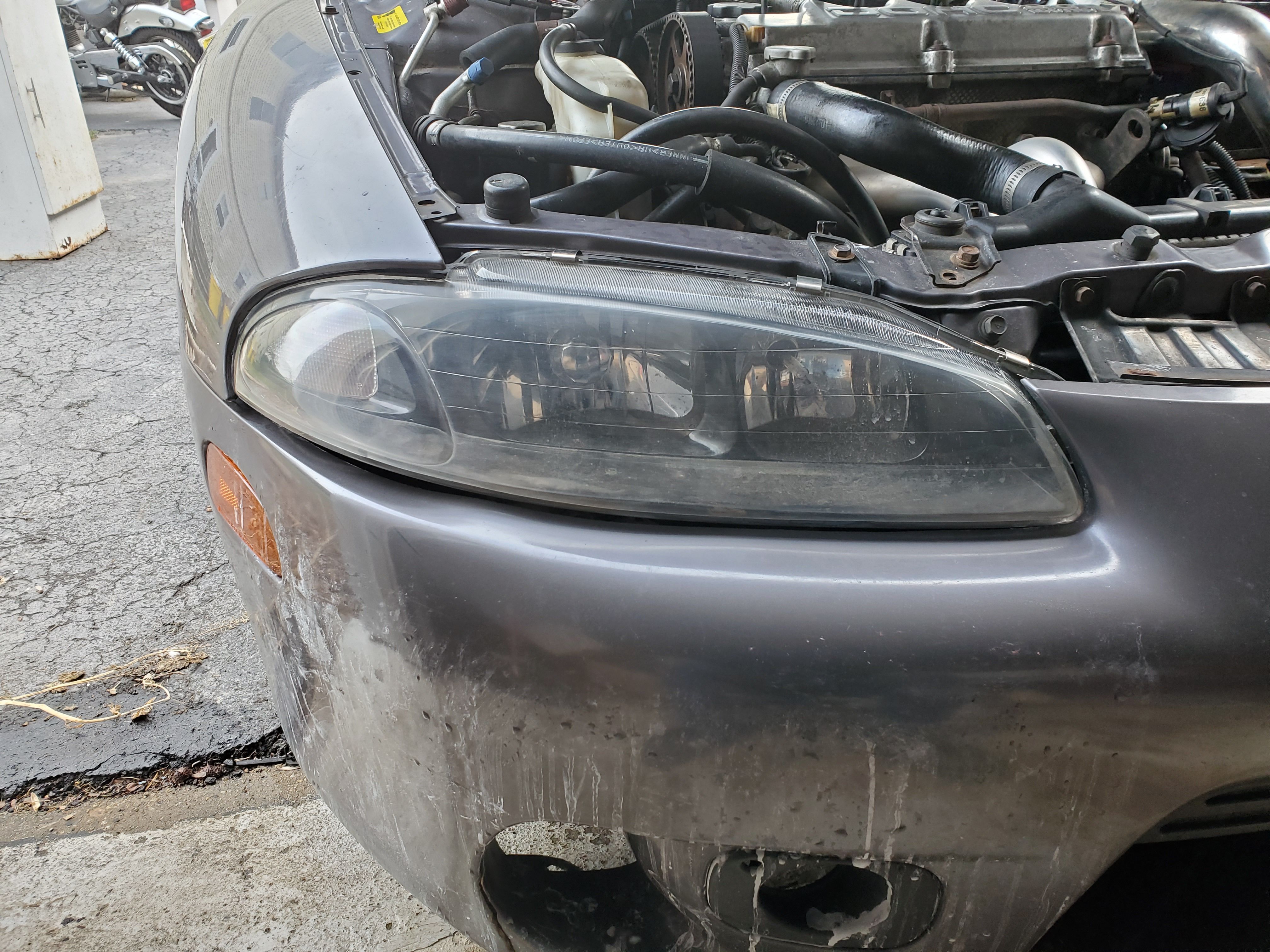

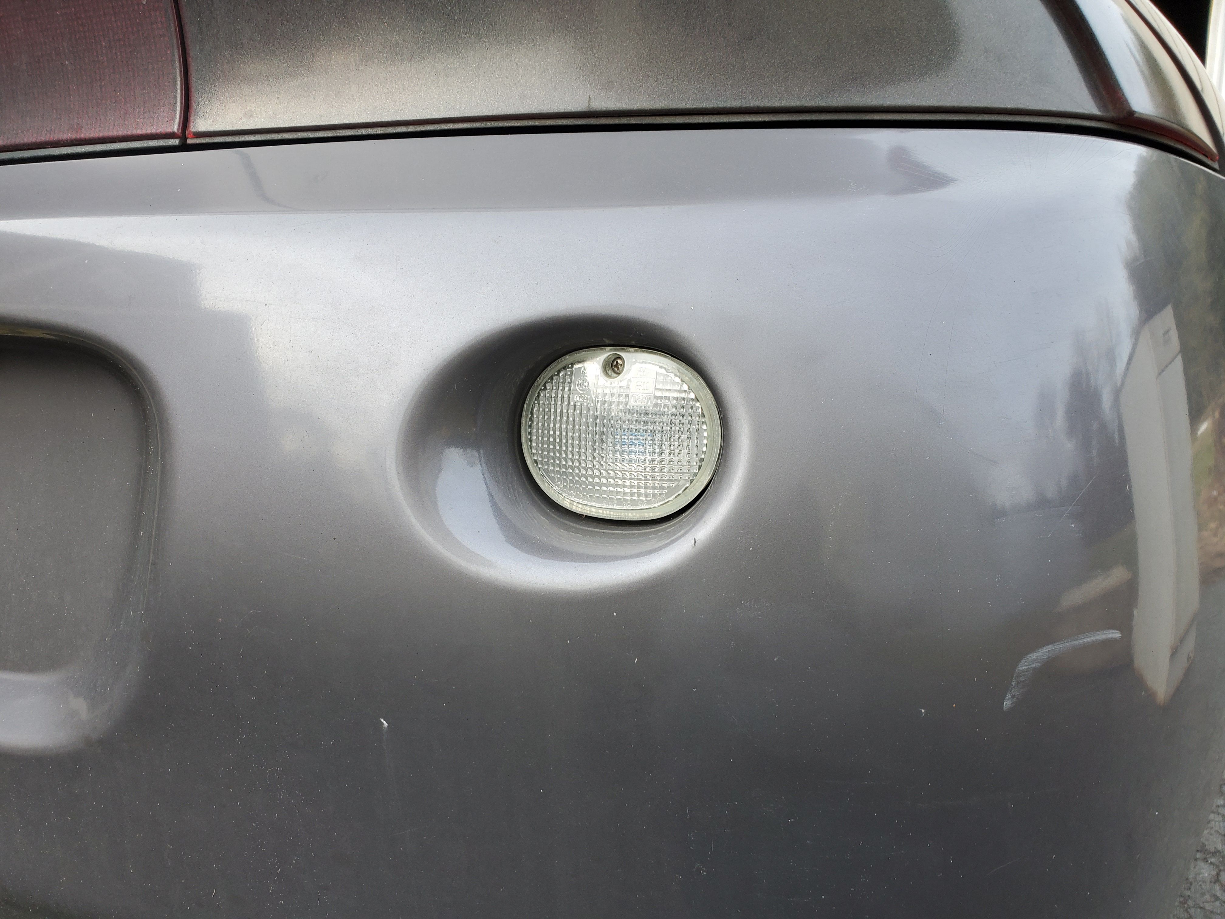

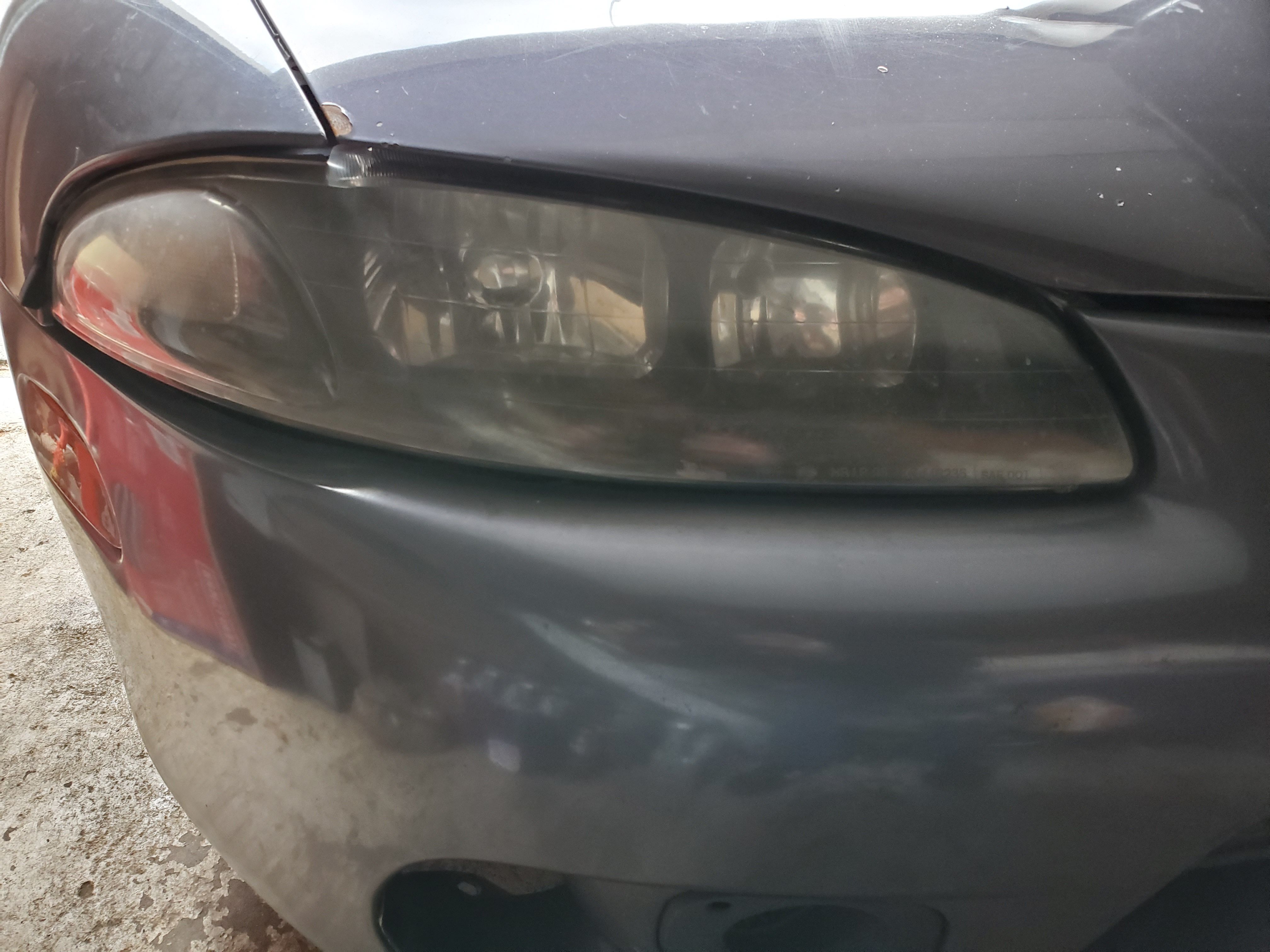

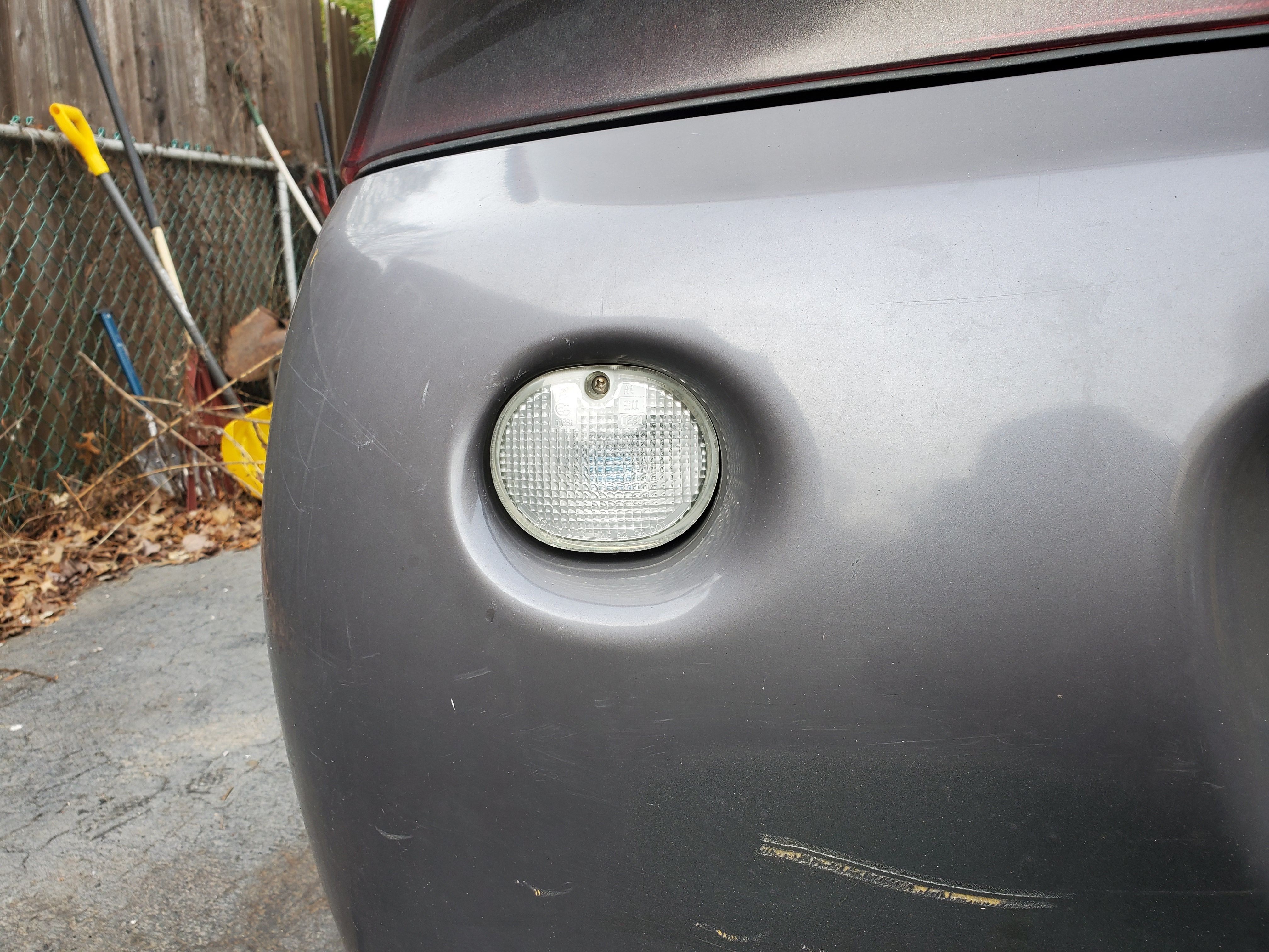

did some work on my lights. Before and after. Still getting the hang of sanding/painting. Total cost wasn't a whole lot, maybe like 5 dollars worth of supplies used.

View attachment 587356 View attachment 587357 View attachment 587352 View attachment 587353 View attachment 587354 View attachment 587355 did some work on my lights. Before and after. Still getting the hang of sanding/painting. Total cost wasn't a whole lot, maybe like 5 dollars worth of supplies used.
