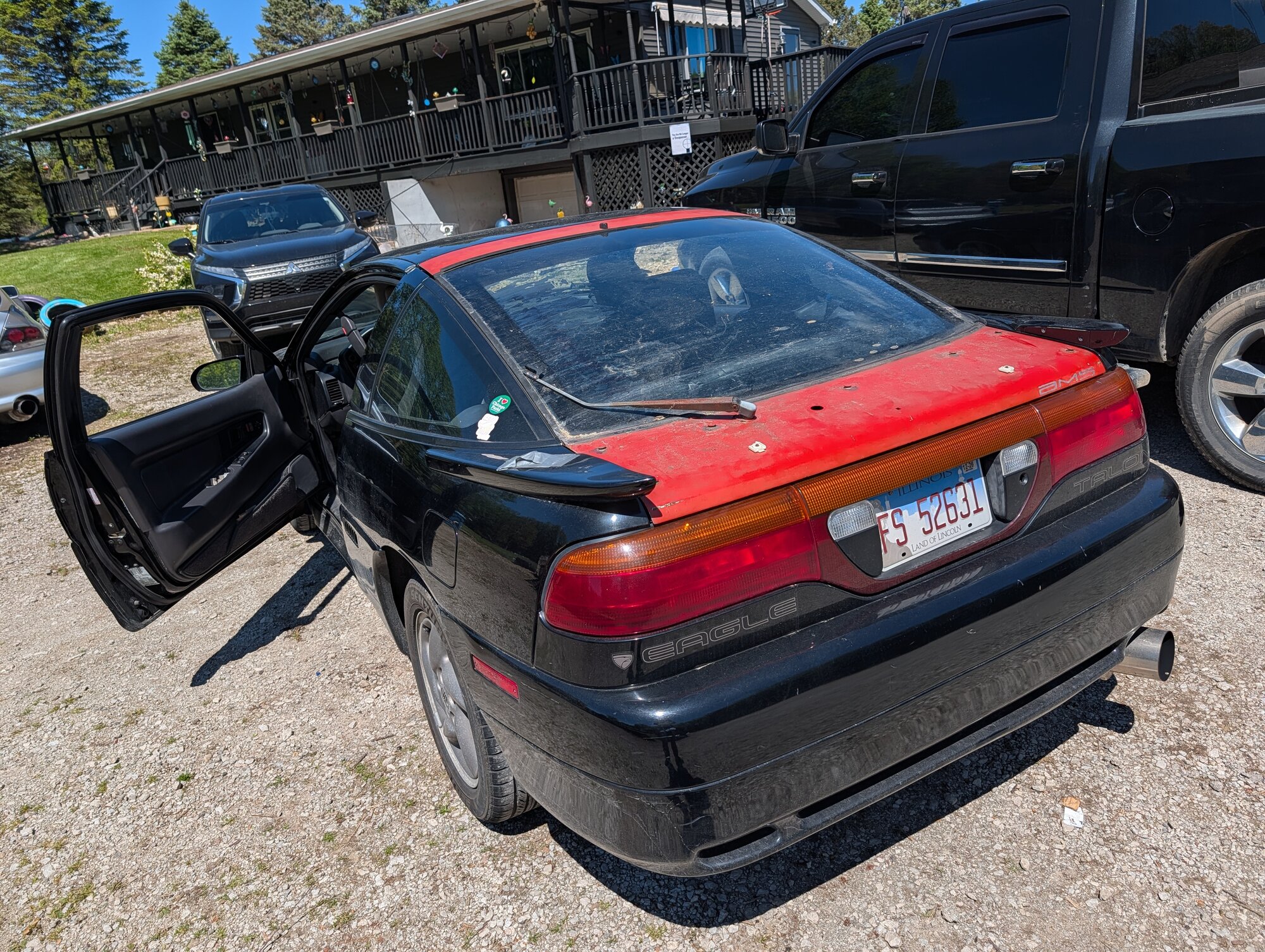

1994 Talon Autocross/DD project
1GB Talon TSi AWD that hasn't seen much action since last decade. Addressing little(and big) issues until I trust this car enough to road trip it.
I'm waiting on the weather to improve as it's rather slushy and wet outside. I'll update the list as I work my way through it.

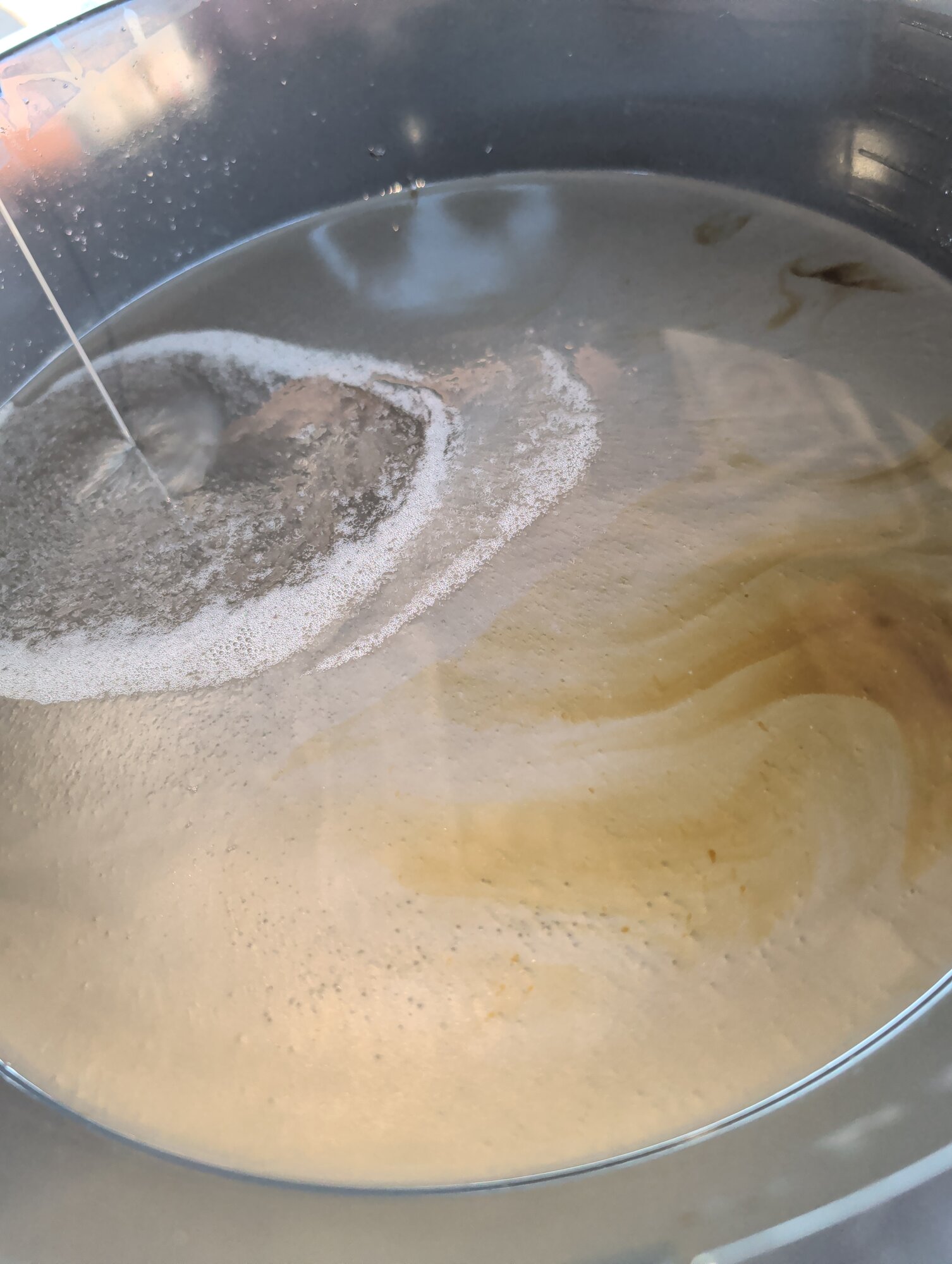

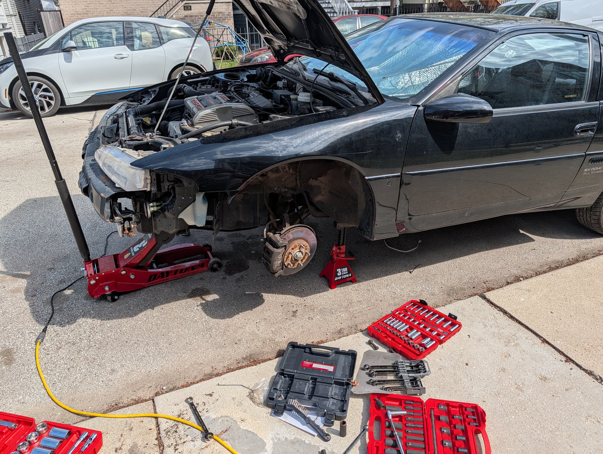

Most eventful was the removal and replacement of both front axles, coupled with the transmission fluid replacement. The whole job wound up taking around 8 hours, all spent in an autozone parking lot. The most difficult part was by far removing the passenger's side axle, since it's pretty hard to get at with a prybar. I had to remove the battery, plastic battery box, and the metal plate it all sits on, all for the sake of maybe getting a better angle. There were a few more minor hiccups like breaking the rusty axle nuts loose and reattaching the intermediate shaft, but things more or less went to plan. I did almost forget to put transmission fluid back in the car though. The stuff I drained out was a silvery gray color. Not sure how normal that is, but I'm told it's okay.

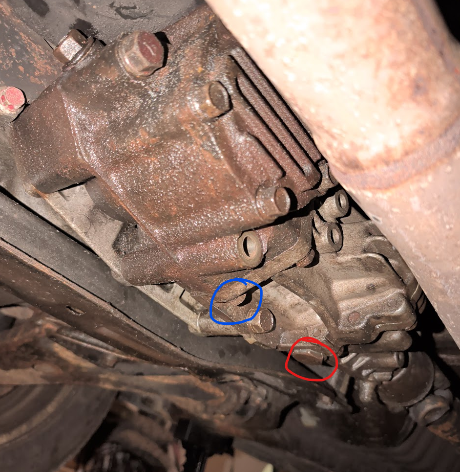

Most recently, I changed the spark plugs and the fluid in the transfer case and rear differential. There weren't any issues until I had to drain the transfer case, upon which I discovered that the fill plug was finger tight. Not a good omen. By contrast, the drain bolt was incredibly difficult to loosen, and
Oops. In writing this, I've realized a mistake I made. When I went to drain the transfer case, I removed the bolt circled in blue instead of the actual drain plug. Nothing drained out of the transfer case because I took out the wrong bolt. I'll have to iron this out next time the weather is nice, but it should be fine until then.

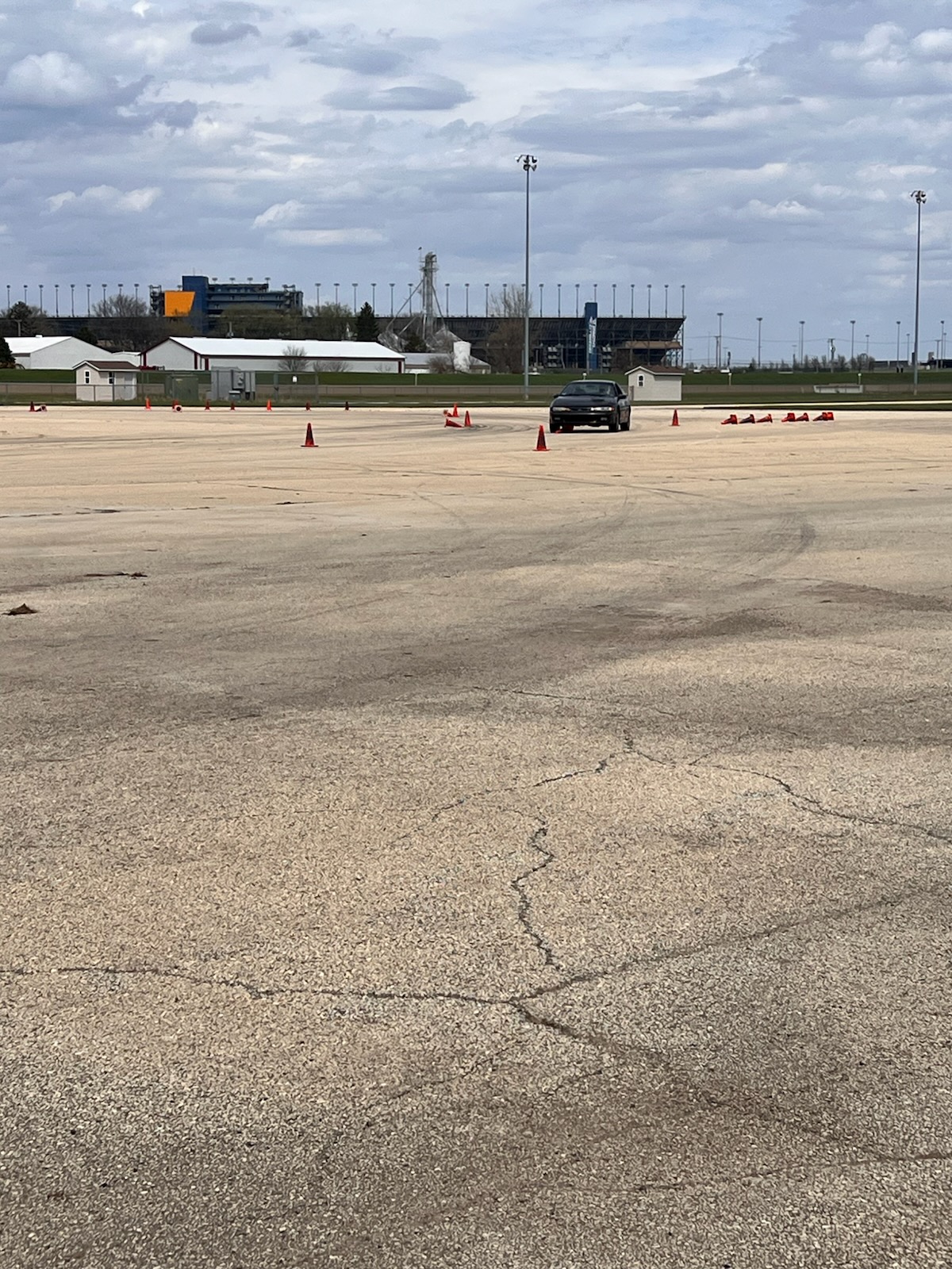

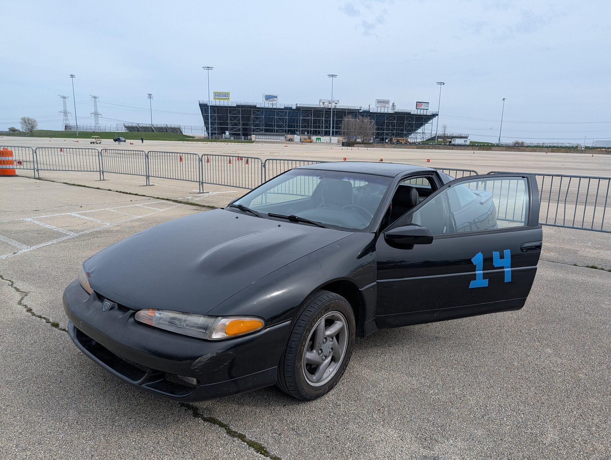

With this glaring issue now resolved and the car riding better than ever, I was ready for my unofficial autocross debut. It was spread across two weekend days, with the first day having two smaller courses, and the second having a larger course that was basically the previous two smushed together. I was also assigned an experienced autocrosser to act as my "instructor", so basically ride along and give pointers. I was able to get a bunch of runs in, especially on the first day. At this current point, I think I'll benefit most from just getting more seat time. Here's a couple photos and videos from that weekend.
This last one's from day two, when I hit a cone and dragged it all the way back to grid.

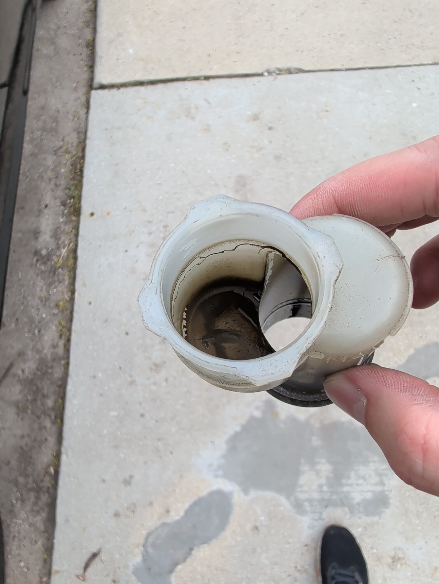

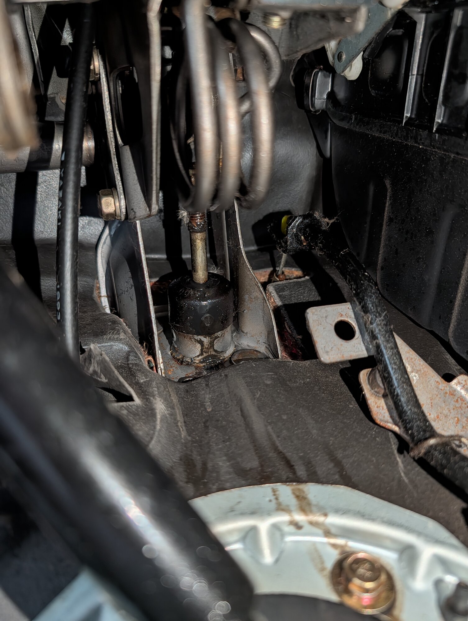

Everything was smooth sailing until the day after autocross. The car made it to+from the venue on both days without any issues. I thought I was in the clear, so I decided to go on a late night drive with my good friend. Fun is had, and I'm almost home when my clutch pedal starts acting up and sticking. While parking, I had to pry the pedal off the floor once or twice, and it was clear that something was not right. I checked the clutch fluid reservoir and saw that it was empty save for some blackish grime.
Further inspection revealed that the master cylinder was leaking into the interior, and the slave cylinder was damp all over.
This was a problem that I could not ignore, especially if I wanted to attend the next autocross event. One rockauto order and a few days later, I was the proud owner of a replacement master+slave cylinder. Replacing both was quite the ordeal, and oh so messy. My hands were absolutely drenched in brake fluid, but the job got done and everything was back to normal. I believe I also bled all my brakes around this time, but I'm not sure exactly when.

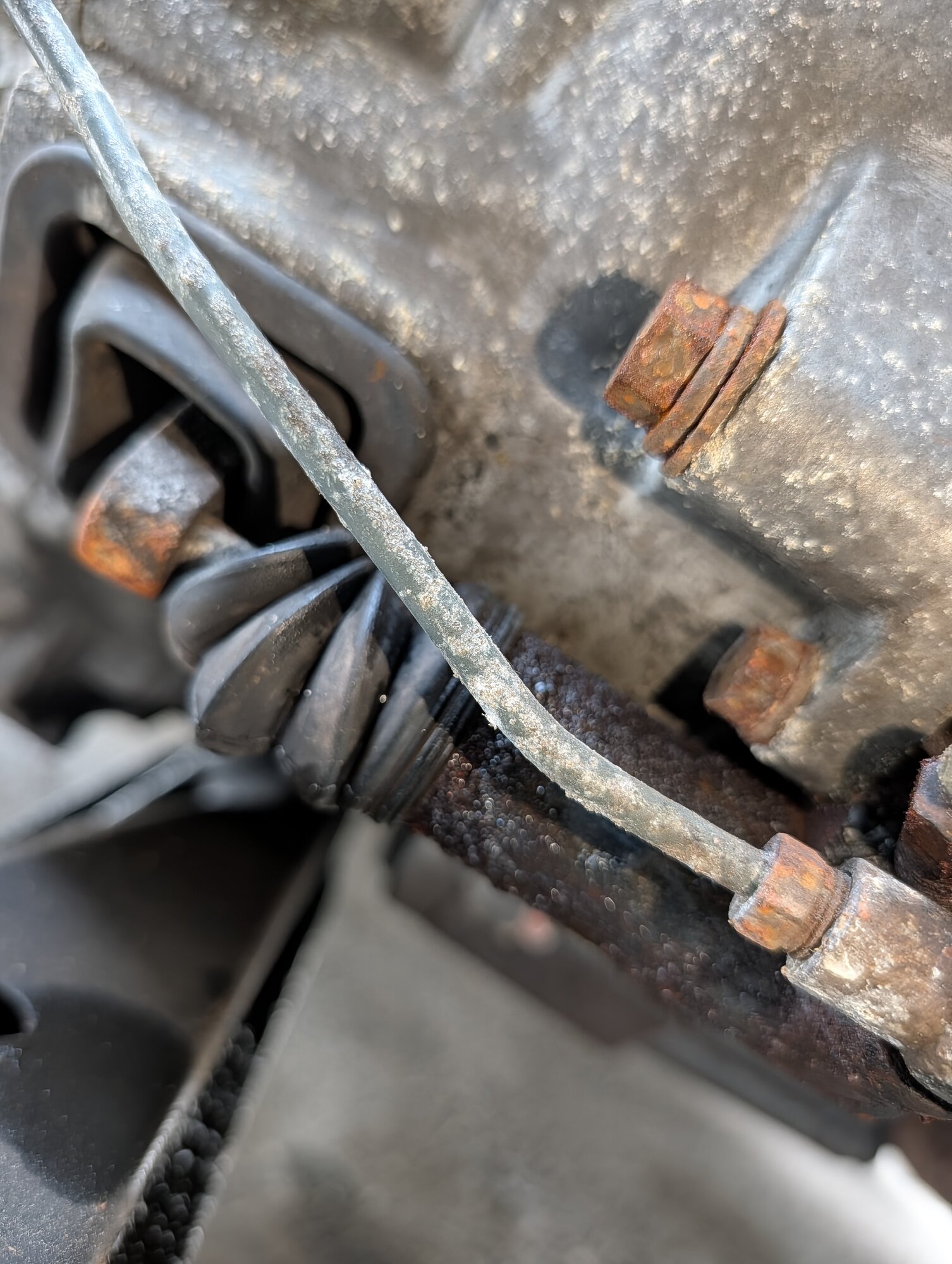

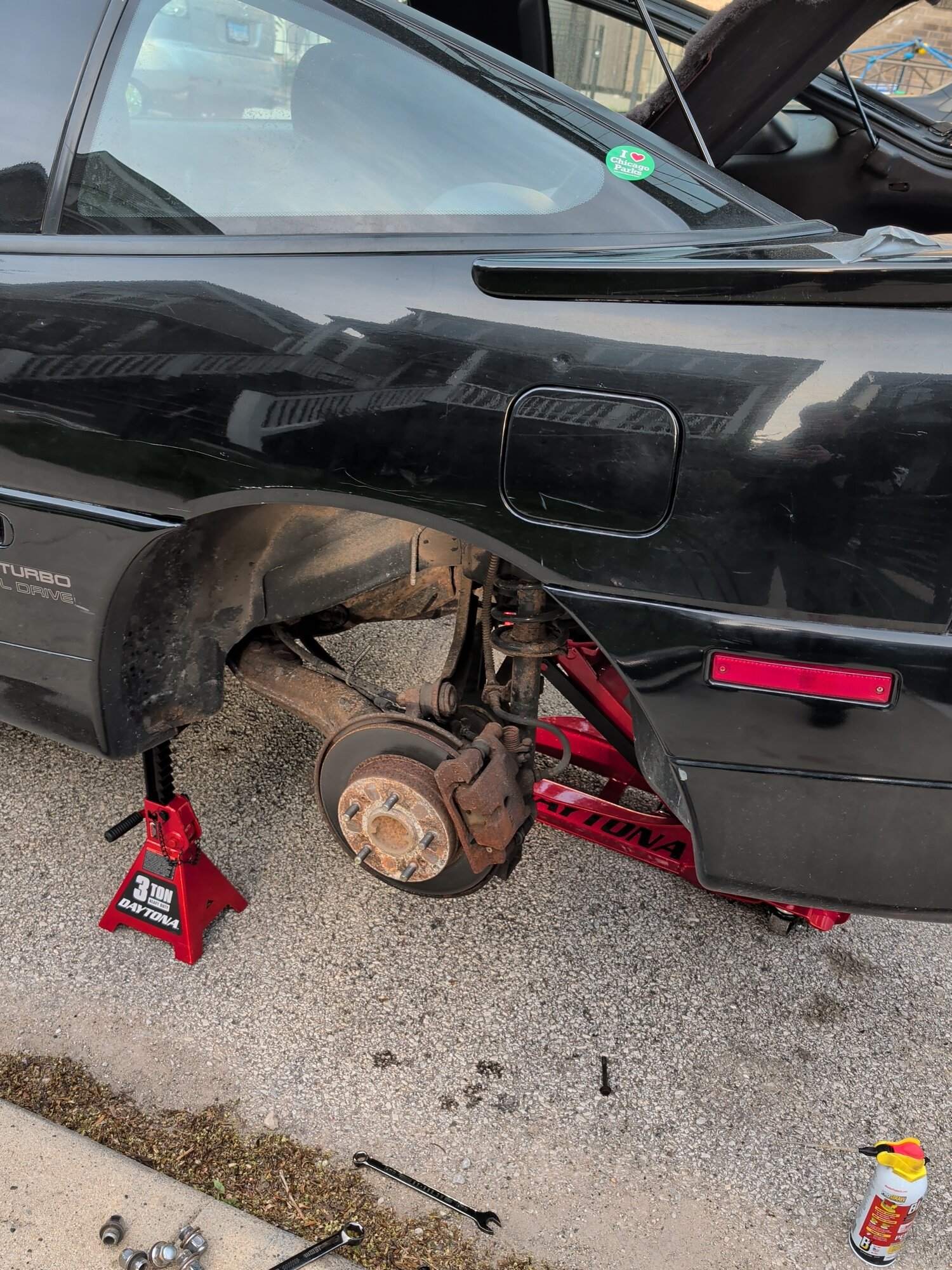

Fast forward to a few days later, I decide to replace the rear pads/rotors because the pads are looking pretty thin. I could not have imagined the frustration that it would end up causing me. It turns out that both caliper pistons have seized and will not compress, even with a c clamp. Not to mention the ebrake component on the passenger side caliper is completely frozen (and the ebrake cable holder is rust welded to the ebrake cable). This is turning into quite the ordeal.

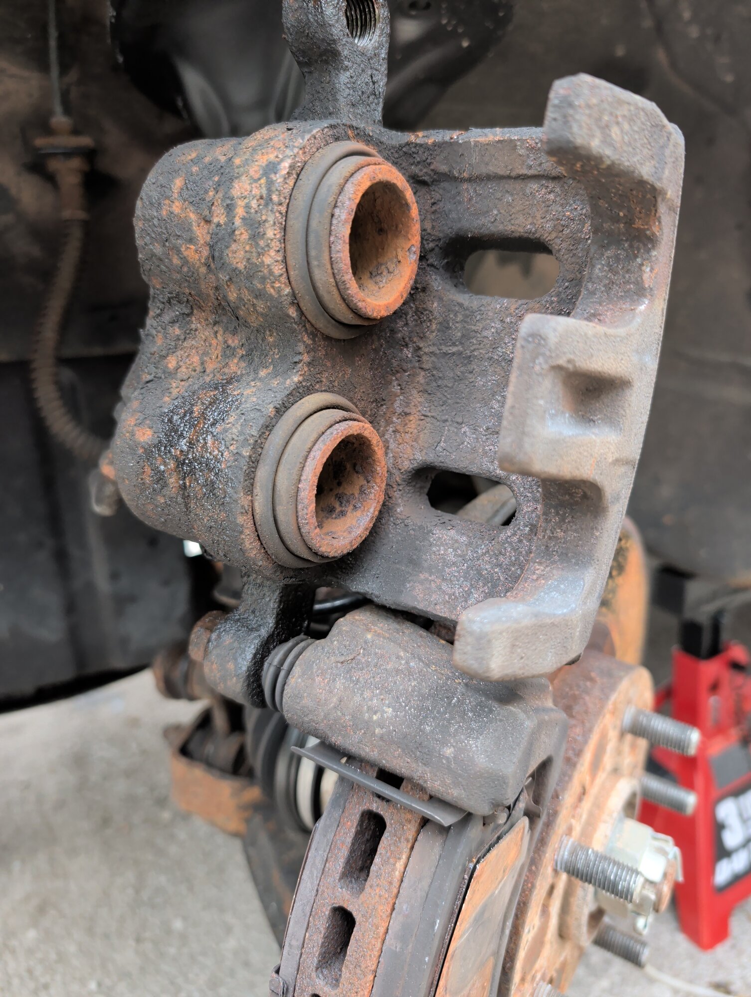

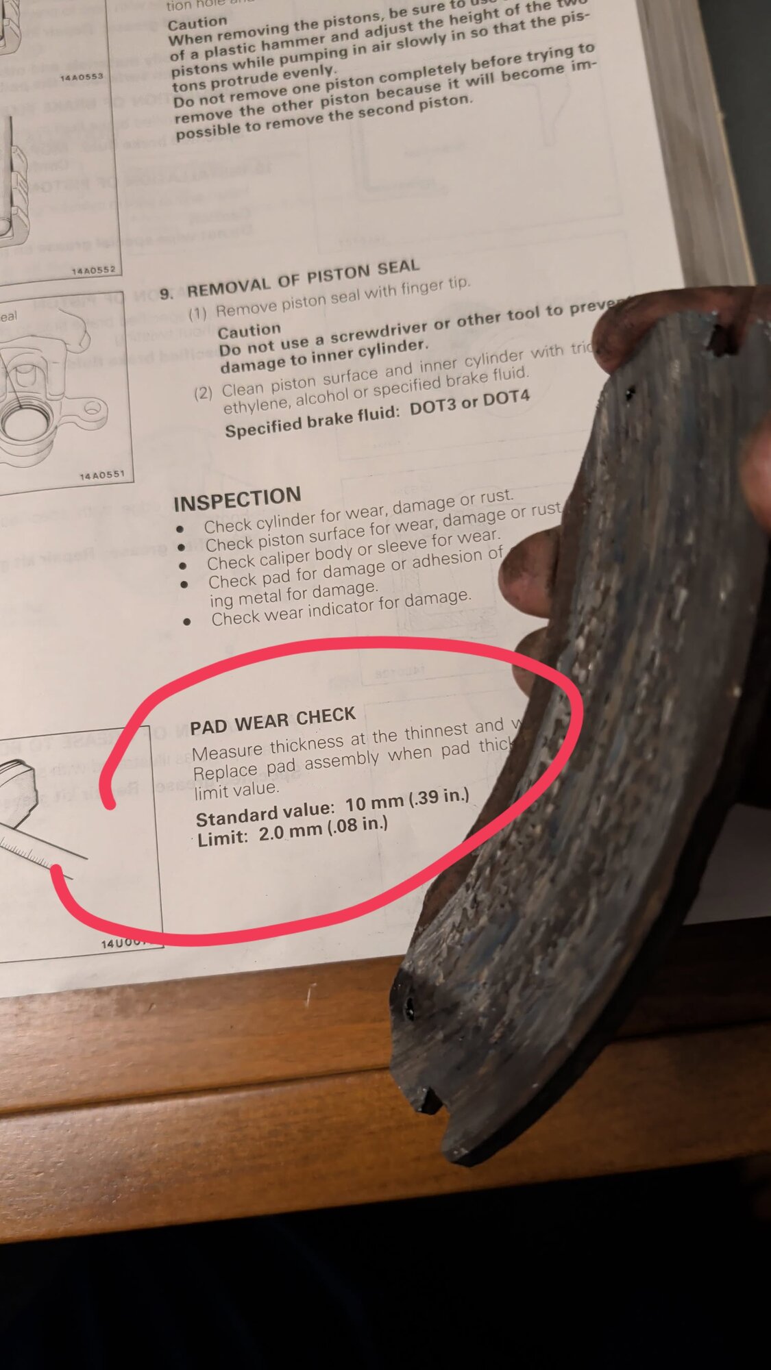

Next up on the repair list is my front brakes. On the way back from Sunday's event, I notice a worsening metallic screeching/scraping noise coming from the front on braking. Undoubtedly brake related, and I'd had the foresight to order pads+rotors a few months prior around the time I bought the axles.
Here's the state of the driver's side inner pad:
Think it's still got some life in it?
The calipers/pistons were a little crusty, but still compressed like normal (unlike the rears).

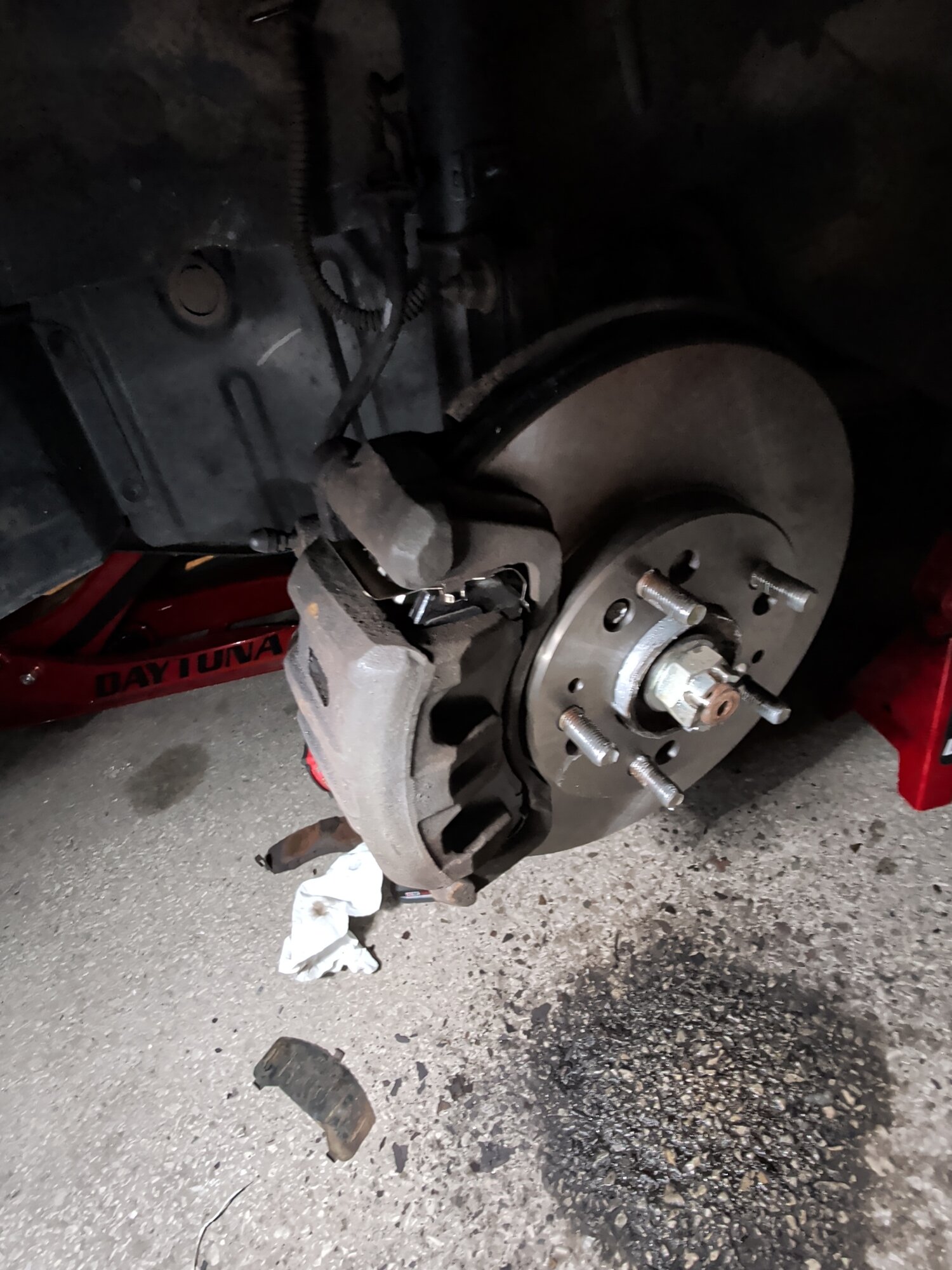

I replaced the pads/rotors/clips on both sides, and made sure to liberally grease the slide pins. Also a generous helping of anti seize between the hub/rotor and rotor/wheel since the previous rotors had rusted themselves to the hub. I wouldn't have been able to remove them if not for the threaded holes in the old rotors (and the conveniently matching threads bolts I had on hand).

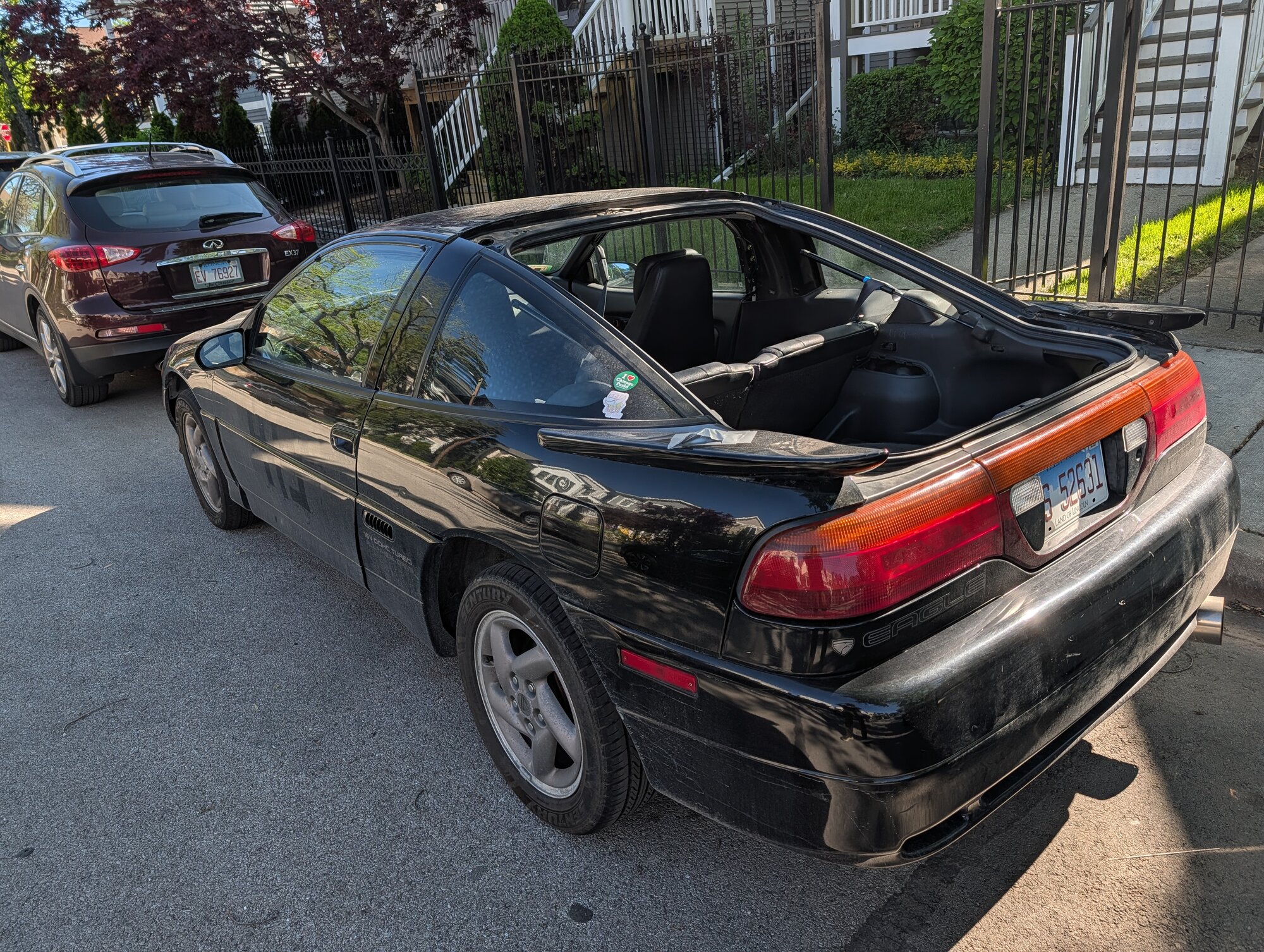

Side quest time! I was browsing marketplace, and I saw someone listing a 1g hatch with glass for free. Knowing that glass can be difficult to source for these cars, I figured I might as well go pick it up. I made a trip out there (~50/60 miles) in my Camry, only to find that the hatch was too big to fit in the backseat or trunk. That left only one viable option: removing the existing hatch, driving topless on the highway, and then mounting the spare. It went pretty smoothly, although the wind noise was understandably pretty crazy.
Here's the before:
And here's the after:
Once I got back, I promptly swapped the hatches again as the spare was considerably nastier than the original. Judging from the wing that was originally on it, the hatch belonged to a 1GA Talon(?). A nice find regardless.

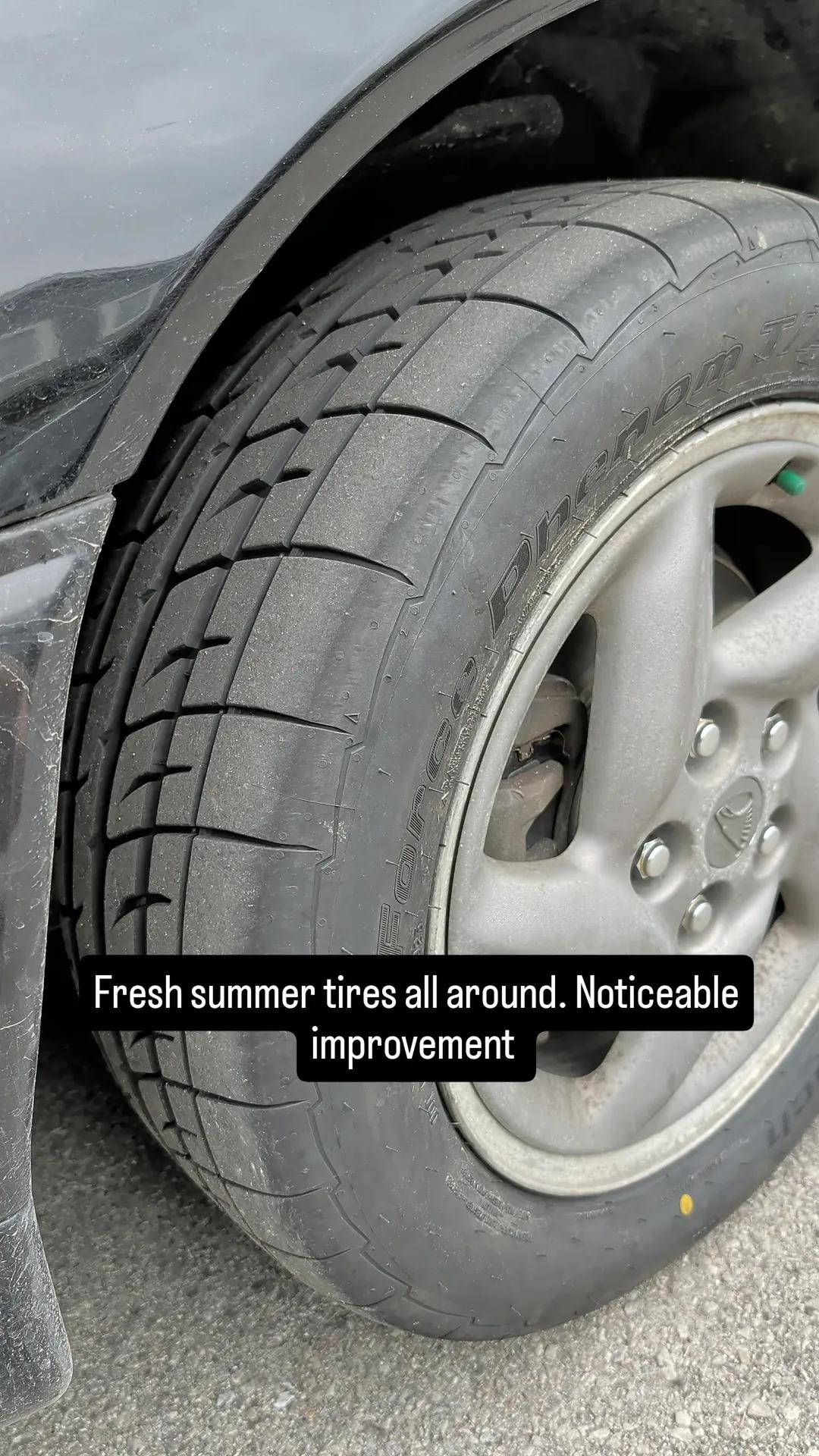

Around this time I'd also placed an order for some summer tires to replace the tired old no-name all seasons that came on the car. Fast forward a few days and it came time to actually get them installed. I bought them from Costco, and I had to stop by in person to schedule because you can't select cars from before 2000 on their online scheduler. They got me taken care of though, and I'm now the proud owner of some tires that don't suck.

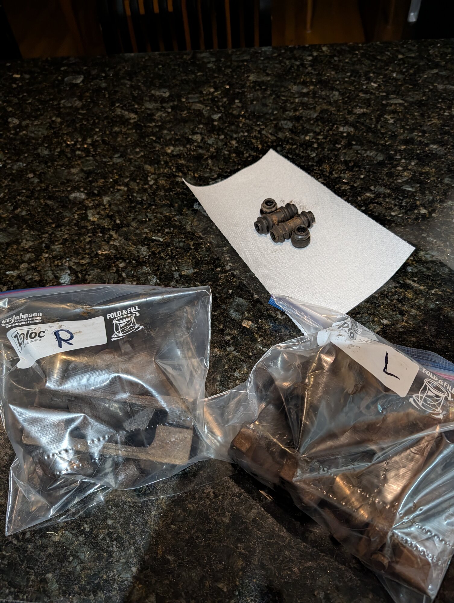

Now we're fast forwarding again, this time to last Wednesday. The month prior, I'd ordered some parts from rockauto that were supposed to be rear calipers (they were not) and instead turned out to be front single piston calipers. I found this out when I tried to replace the rears, only to notice that the mounting holes were wrong and they lacked the handbrake mechanism. :ohdamn: Not my finest moment. The only remaining option was to find someone to rebuild my calipers, but fortunately a quick search in the DSM Facebook group helped me find Josh Bachman. No idea if he has a page on here, but if you're reading this, Thank You! I'm crossing my fingers that he'll be able to get them sent back to me in time for the next autocross event (June 13/14), but we'll have to see. If not, I guess I'll have to beat on my Camry.
Here's everything bagged up and ready to go.
