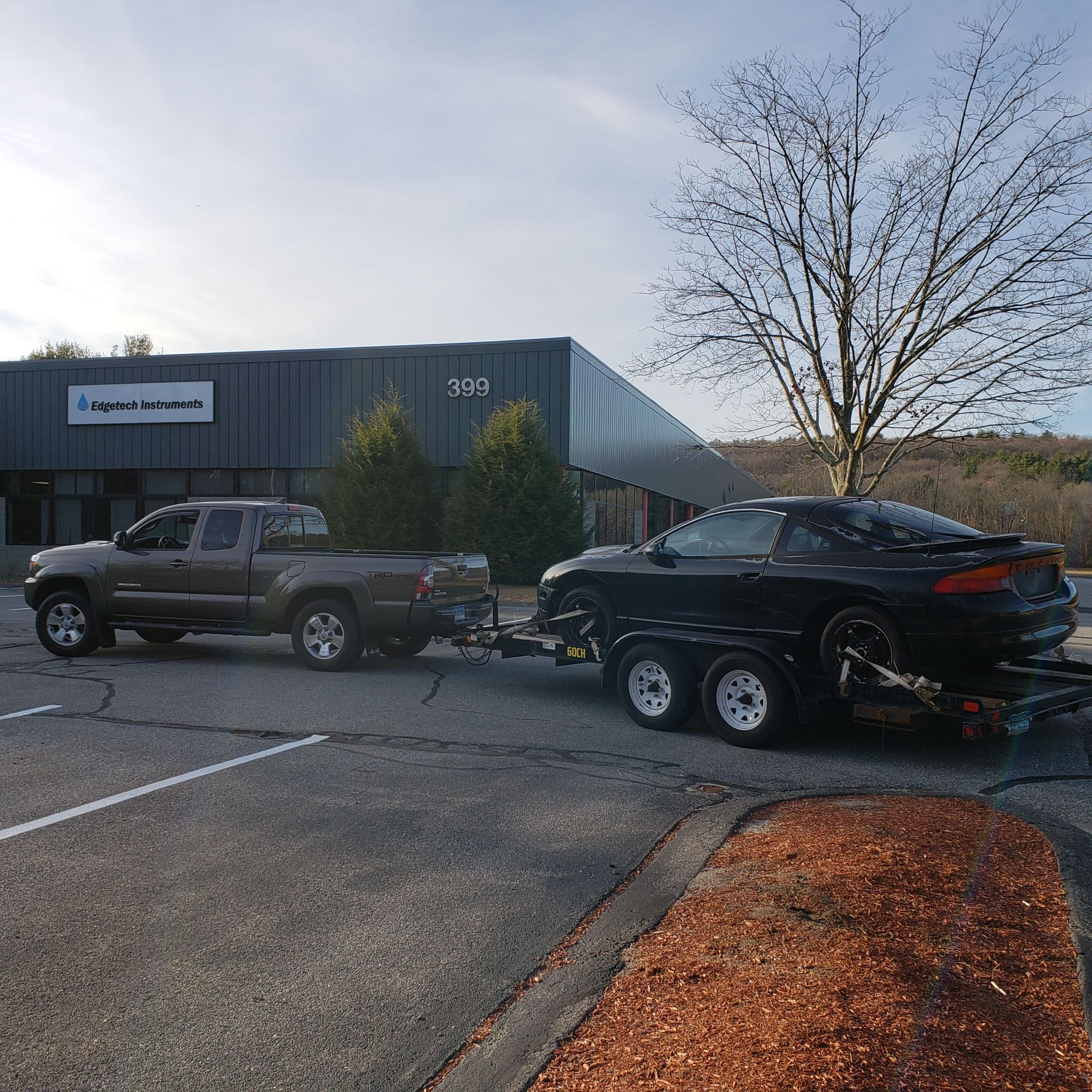

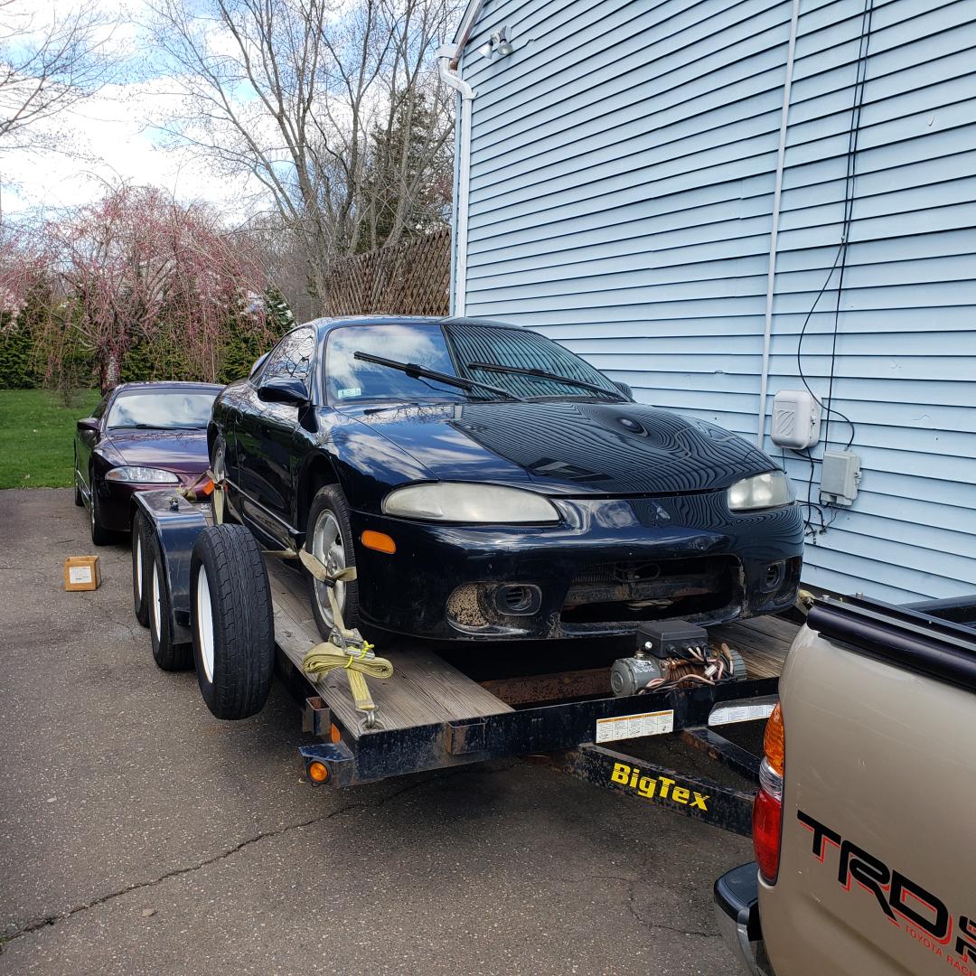

What's this? You've bought a Talon?

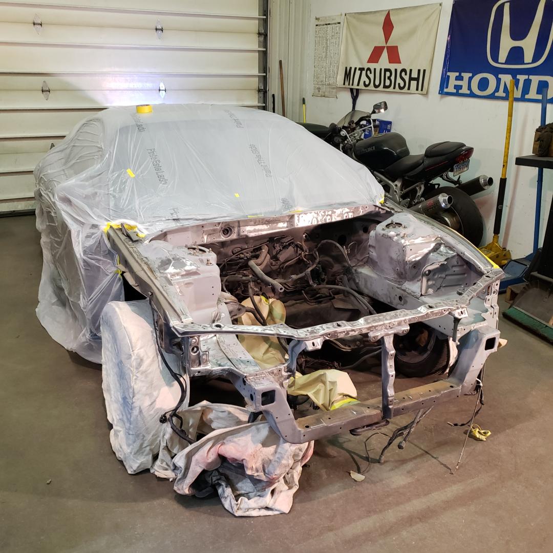

What’s the game plan for this guy?

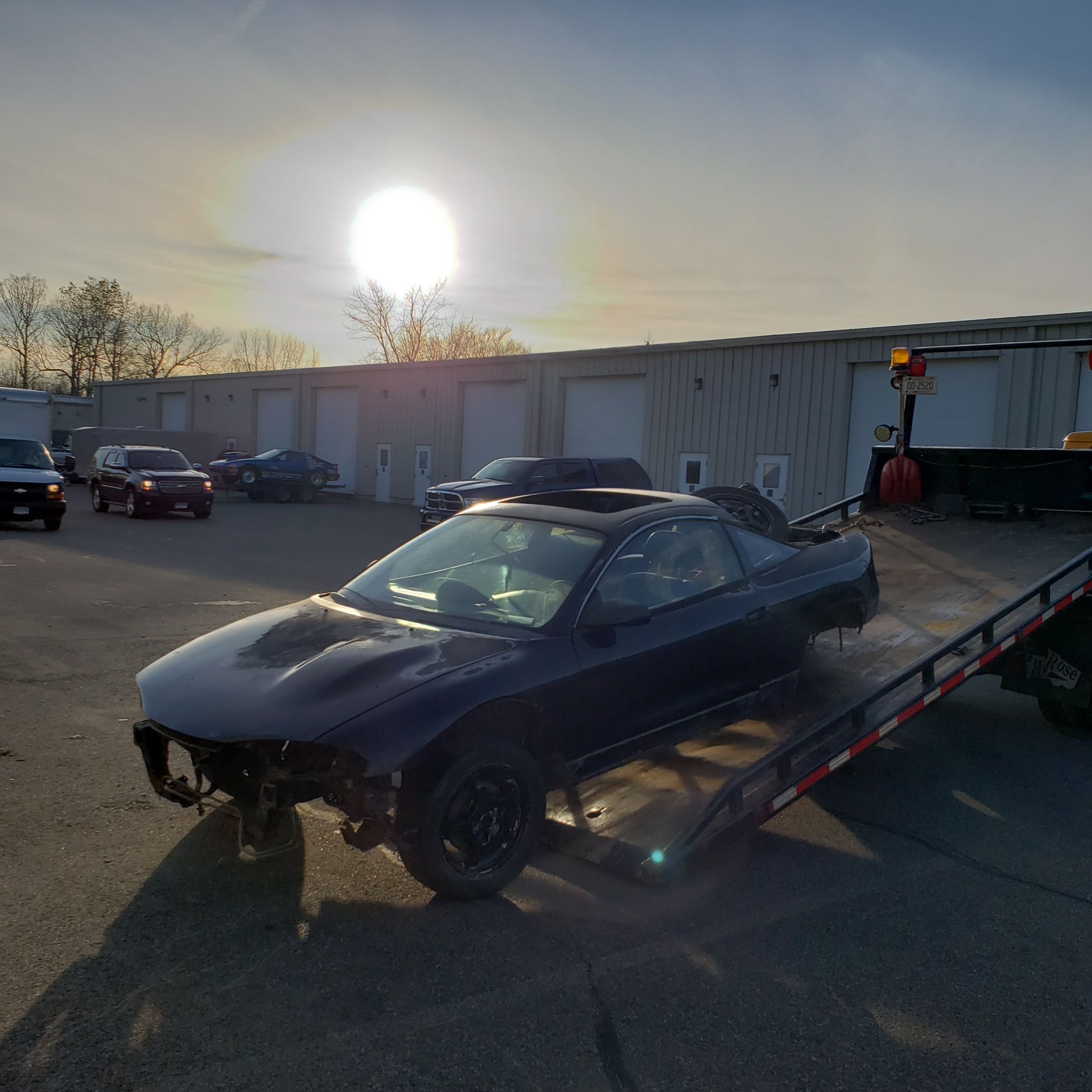

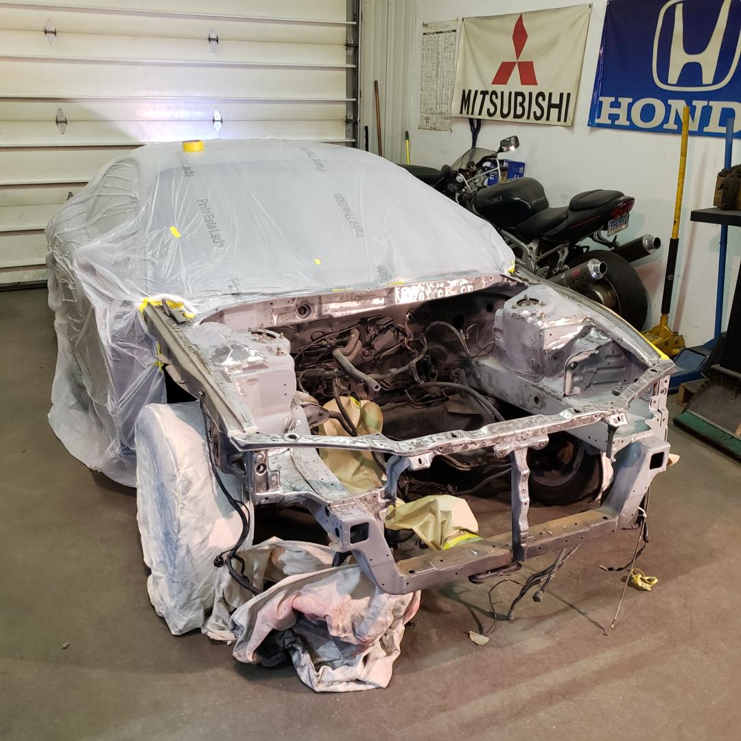

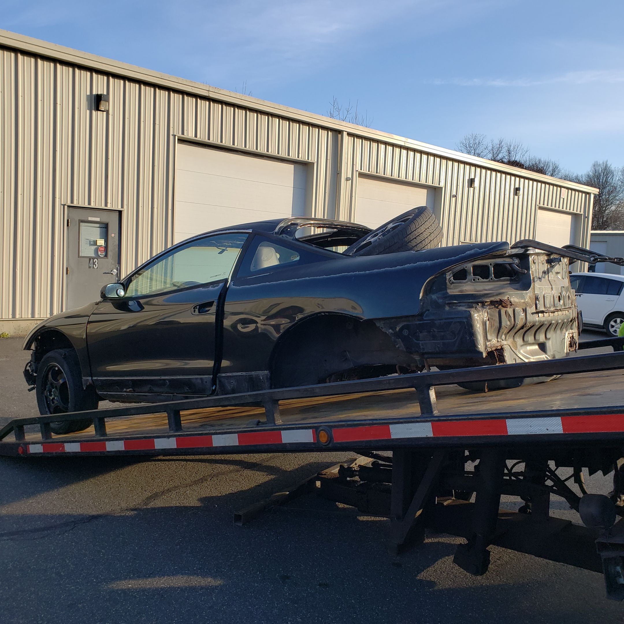

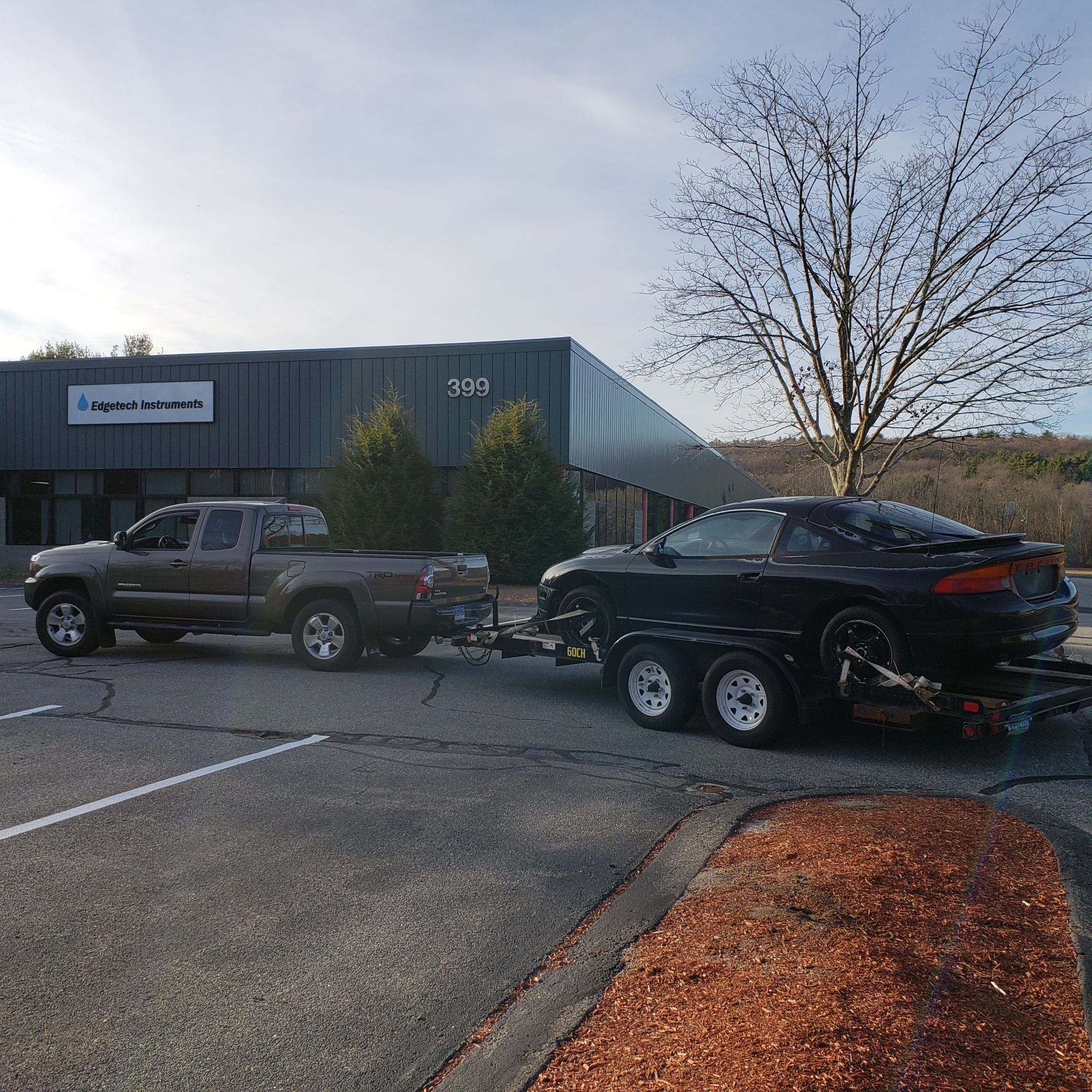

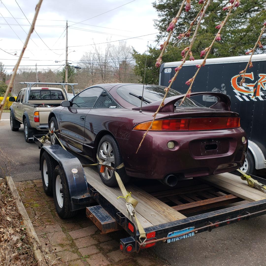

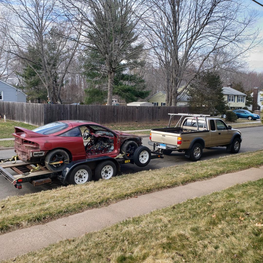

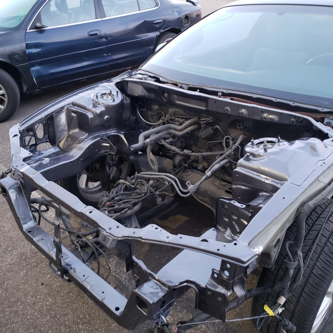

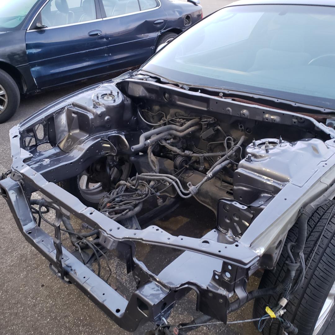

Yeah grabbed this up for parts. The rockers where gone and the strut towers had windows. All the driveline parts where good, along with a ton of other neat crap though. I brought it in and tore the whole thing down over a 48 hour period. I had the local yard haul it away when I was done with it.
The final images are rather brutal:

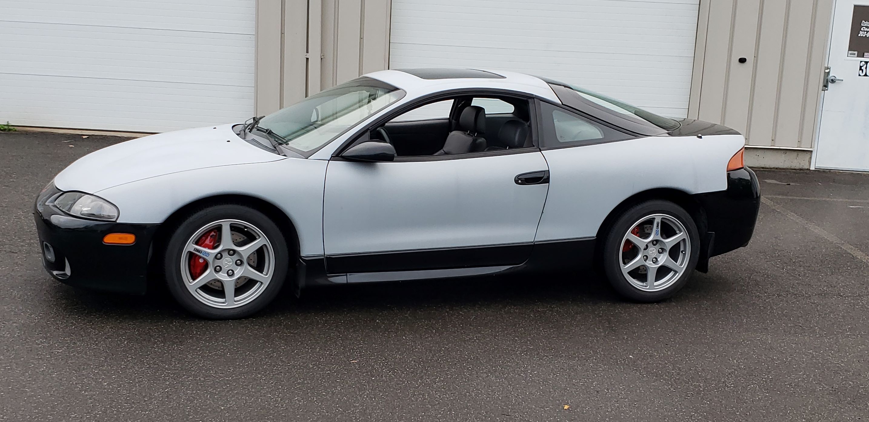

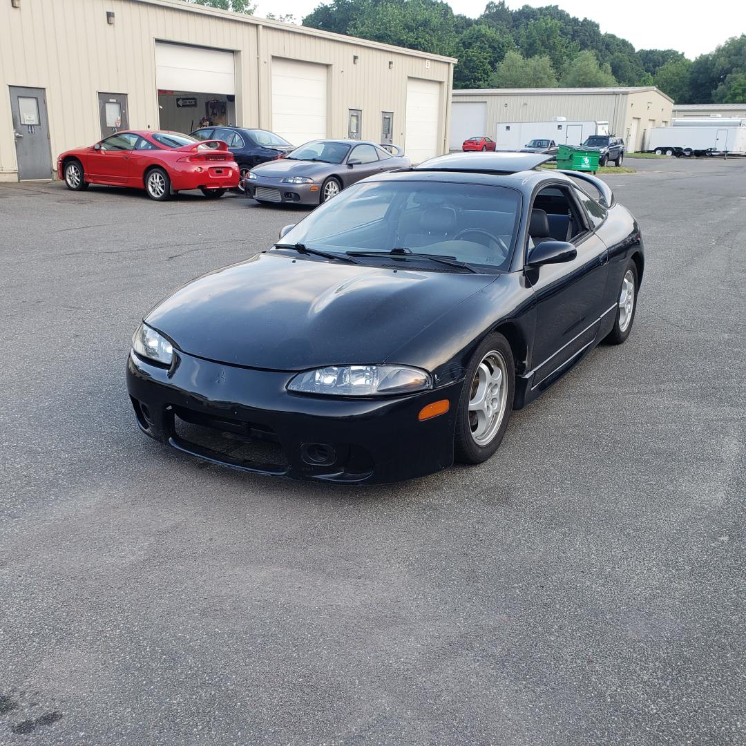

Are you just stripping and scrapping these? Most of them look to be in better shape than my current JSB.

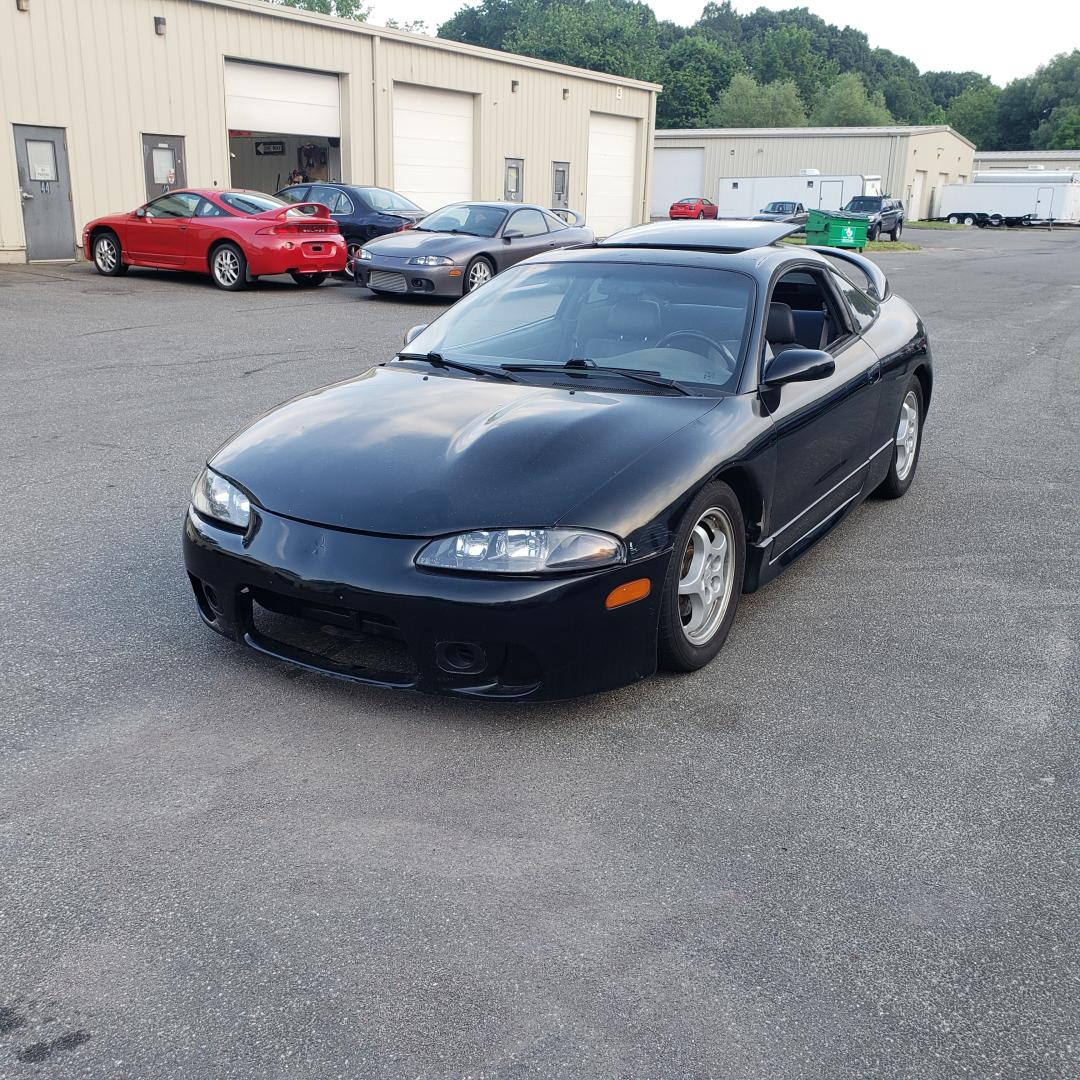

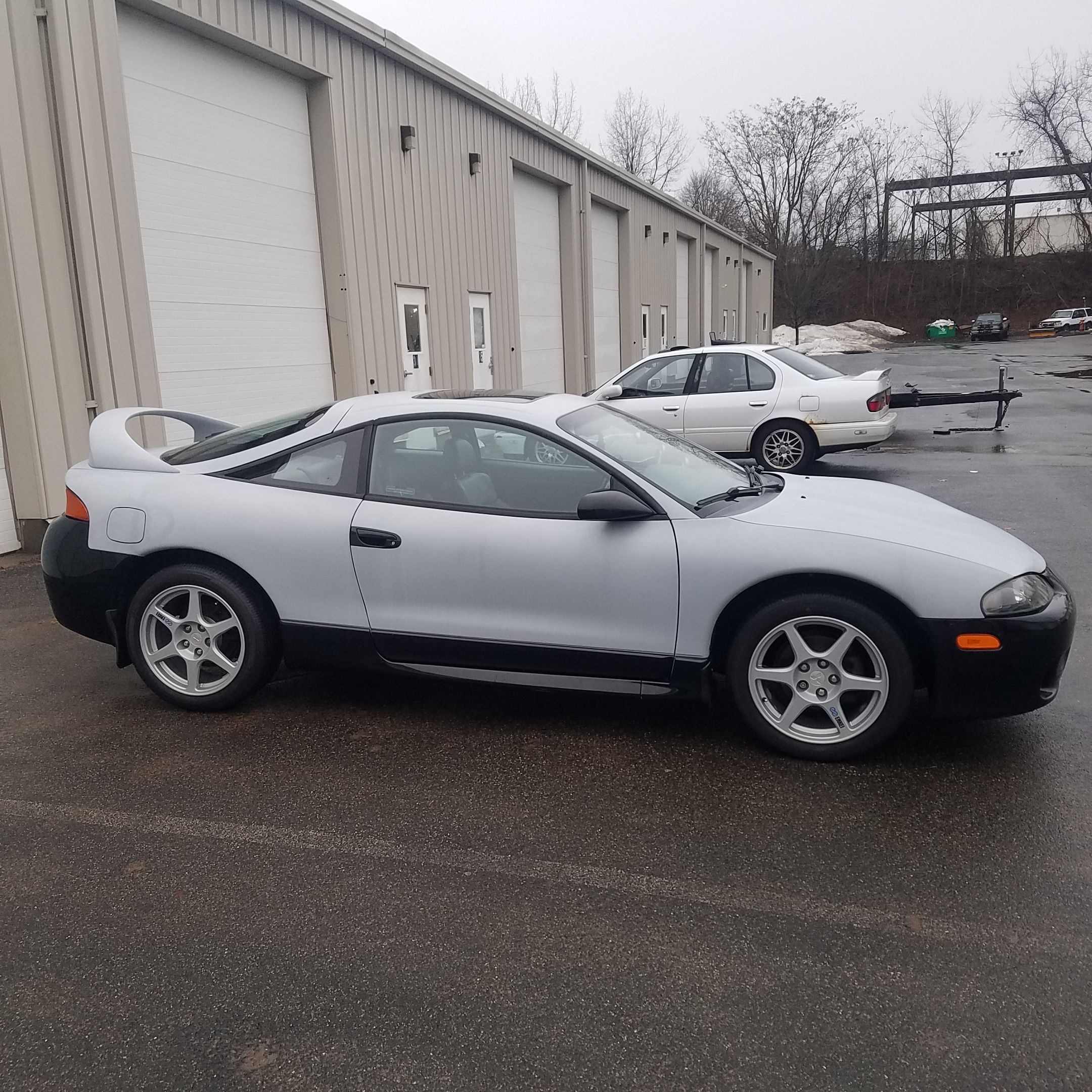

Not at all- Ive got to post some more pics to better illustrate what Ive been up to. Some of these cars where absolutely worth the effort and are now running driving cars. A couple of them where well beyond economic repair.
-Magenta Grey is now very nice complete car
-Maroon is the cleanest shell I own- zero rust on any part of it
-Red was stored indoors its entire life- roof drip/belt moldings are like new- needs some work but i will get to it
Any little piece of any of these cars is being used, stored, or distributed to those who need.......... nothing is going to scrap unless it is 100% useless to us all and nobody wants it.
plenty more to come

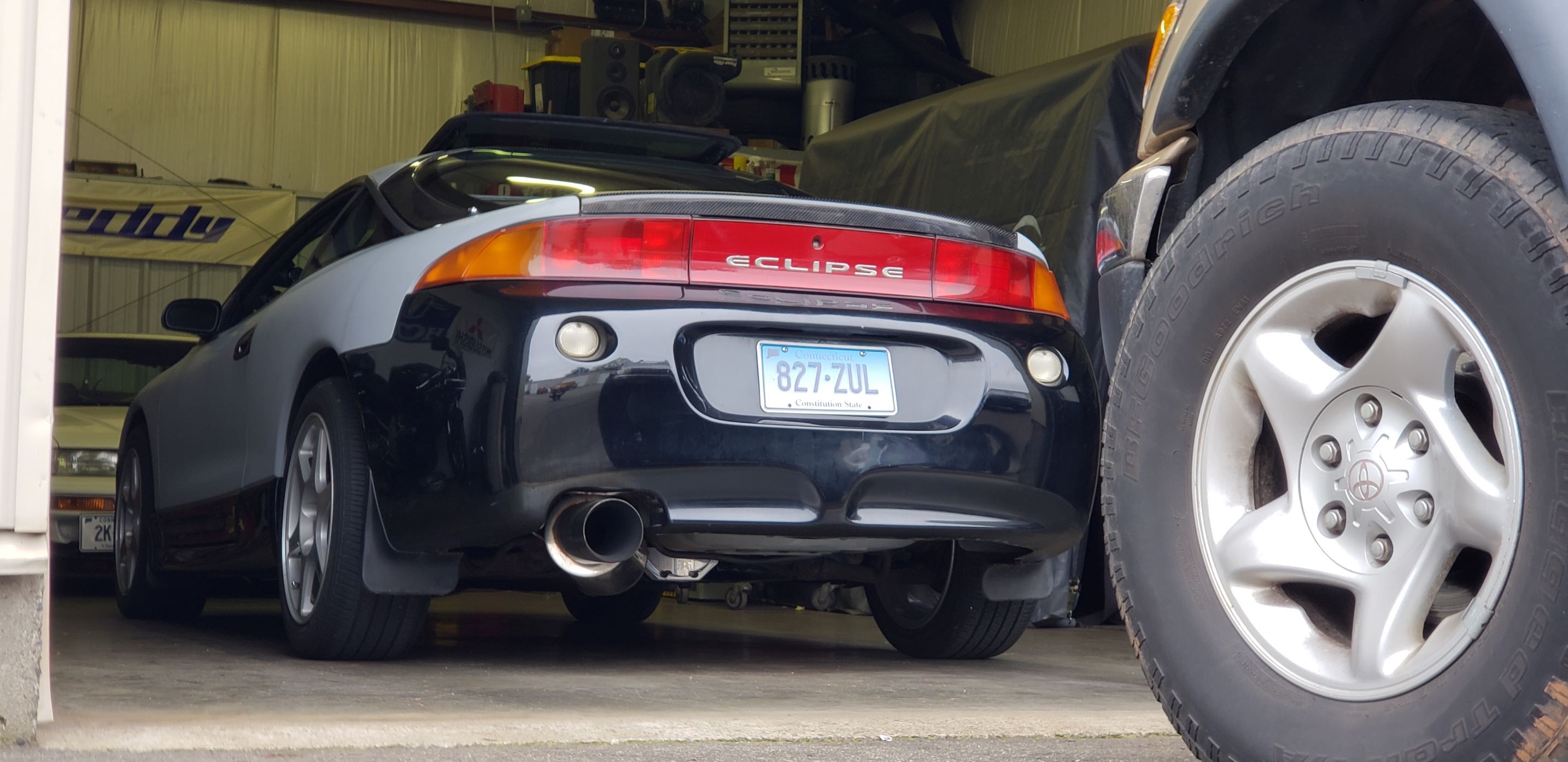

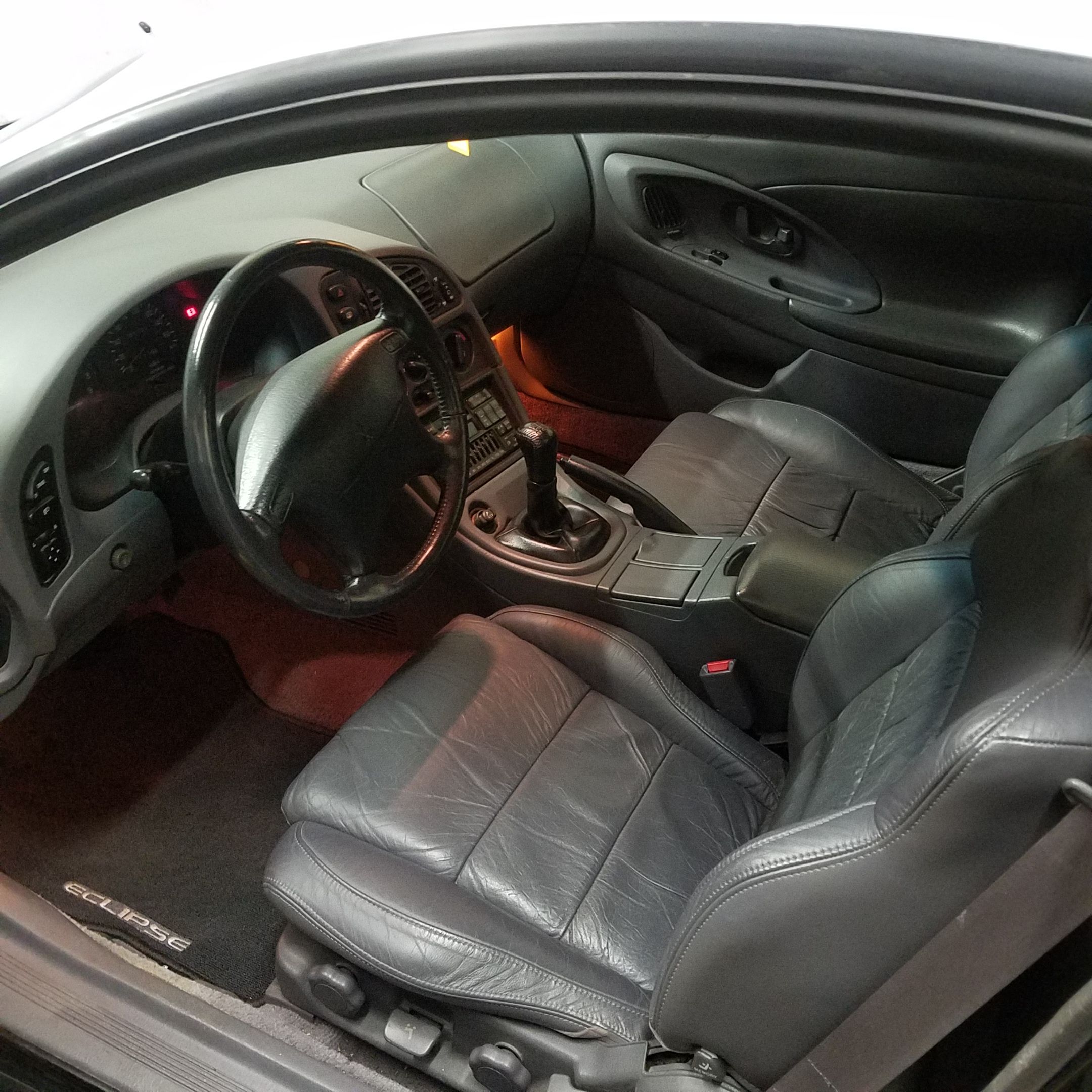

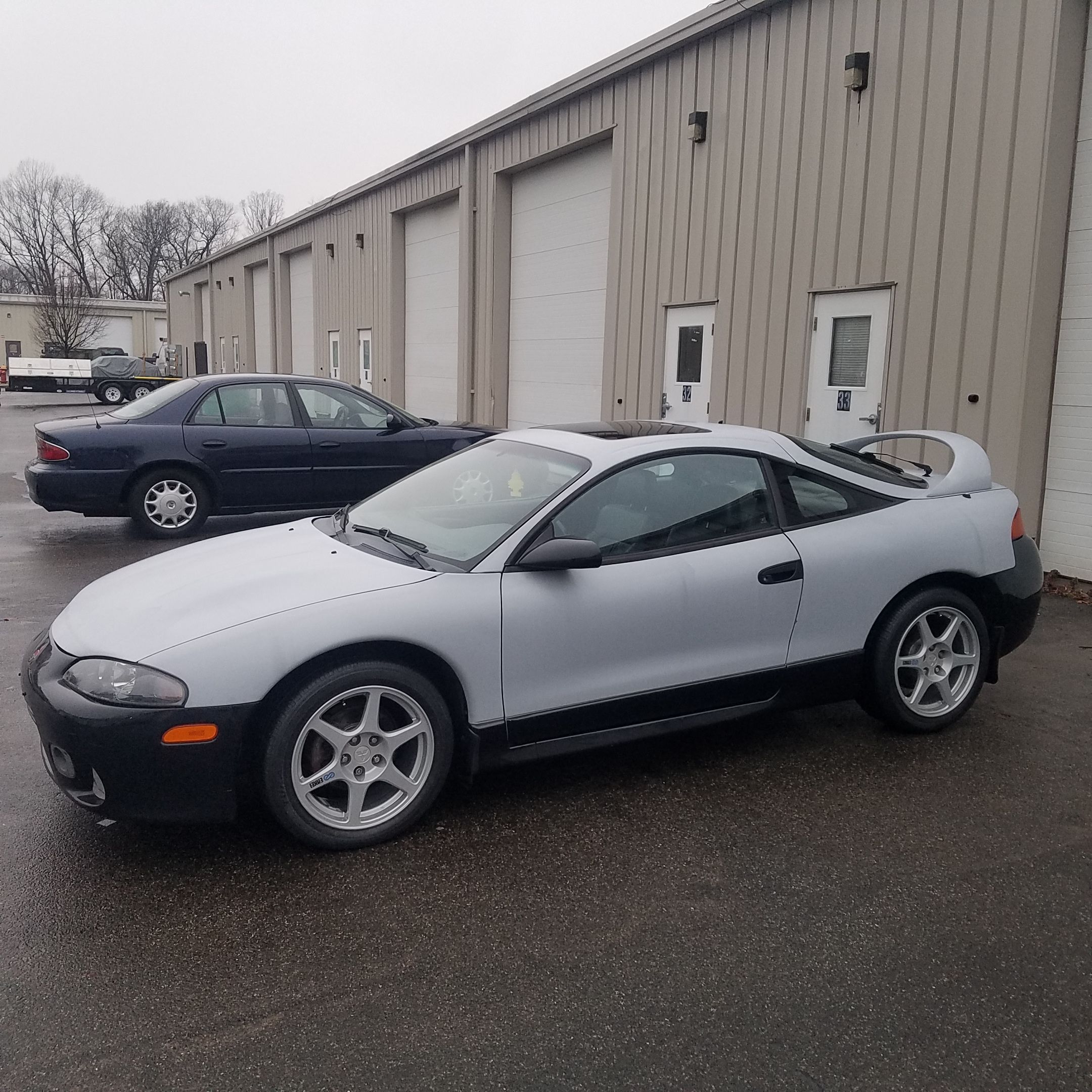

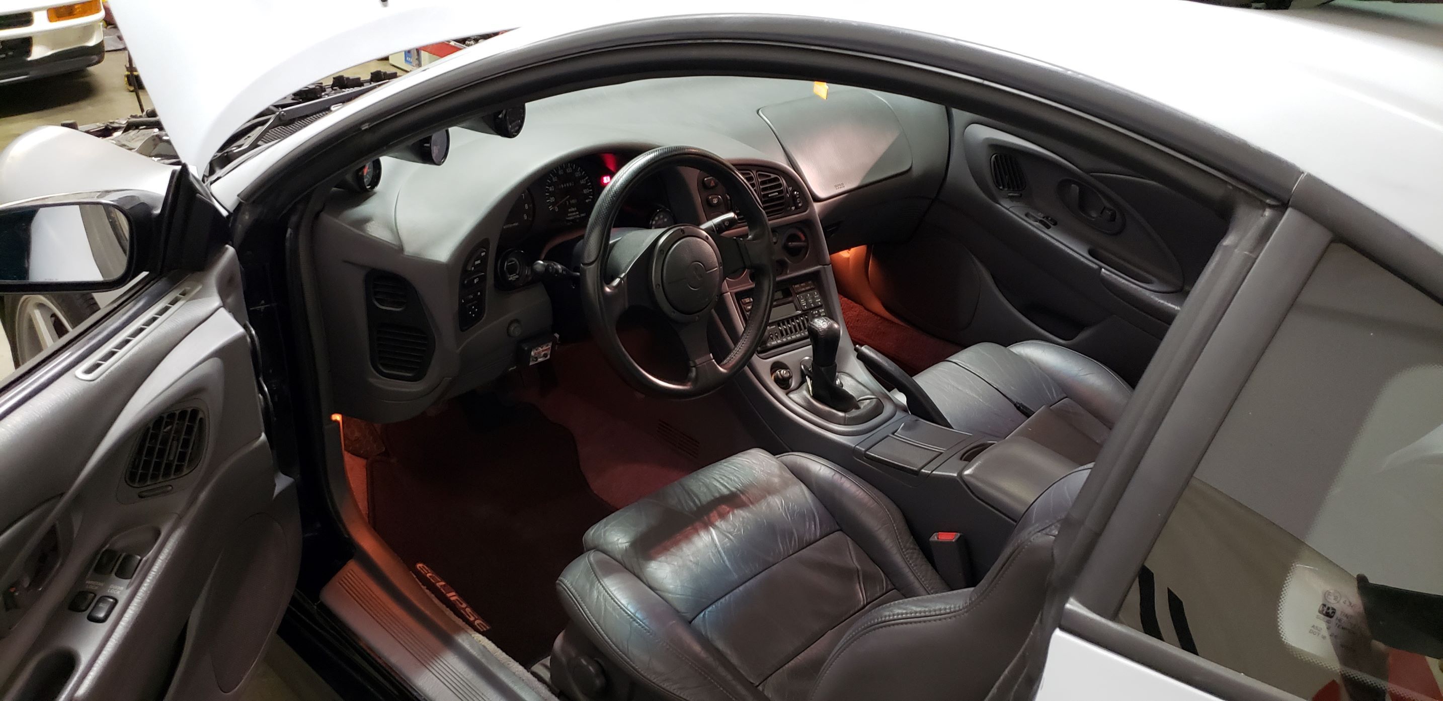

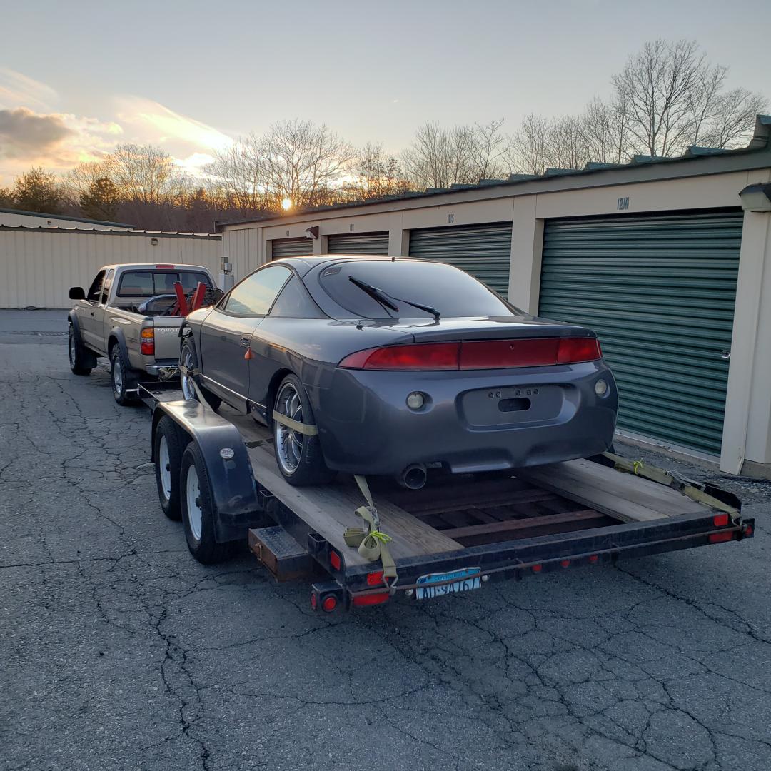

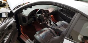

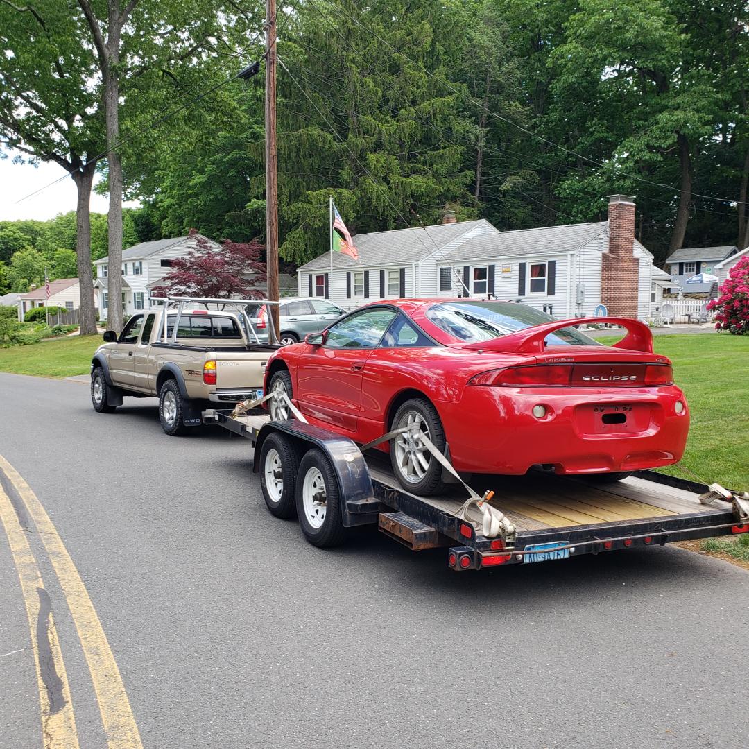

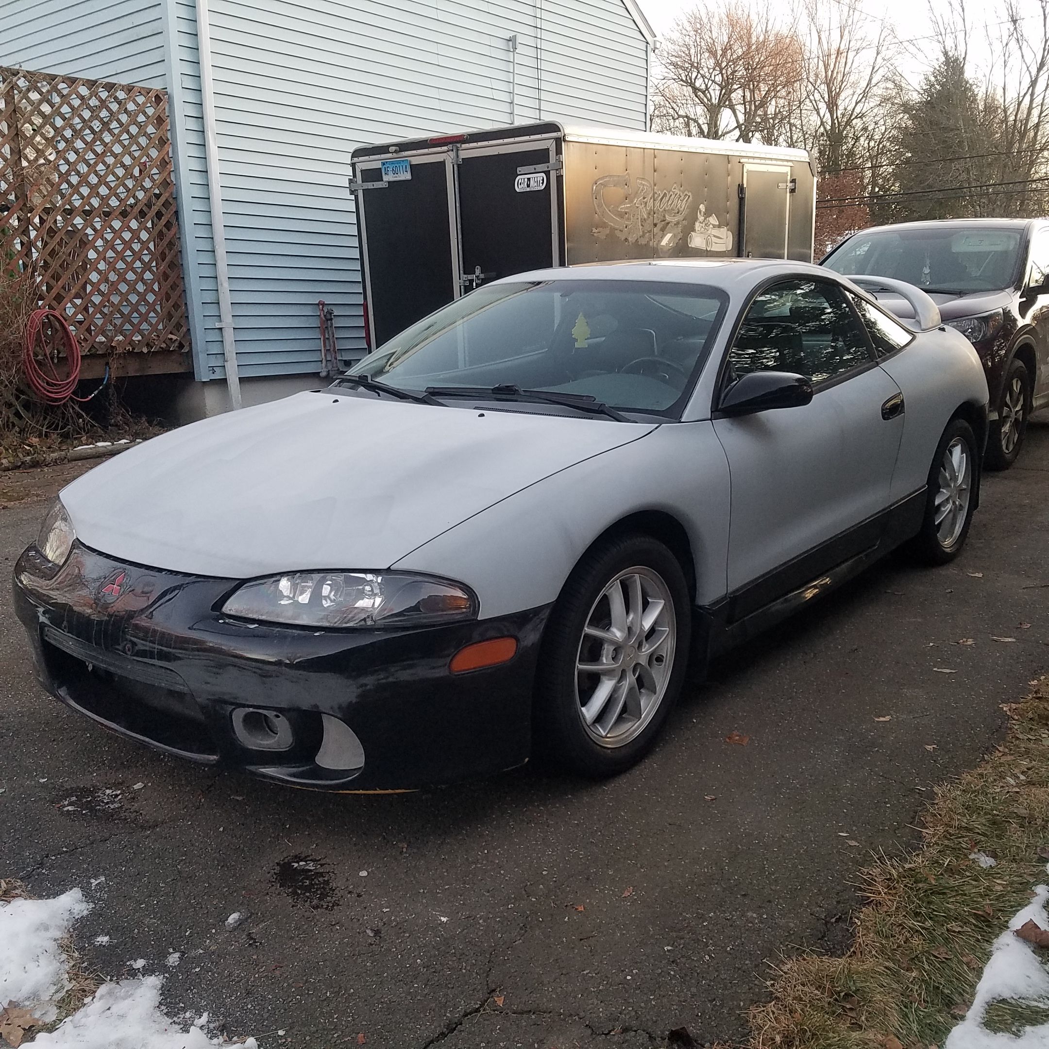

-Black with the smashed out windshield was a rescue scenario- a car I sold over a year ago (after owning it for 15 years) to a heathen who trashed it- got it back for 20% of what I sold it for, put a new windshield and lots more and its now a nice GSX
plenty more to come

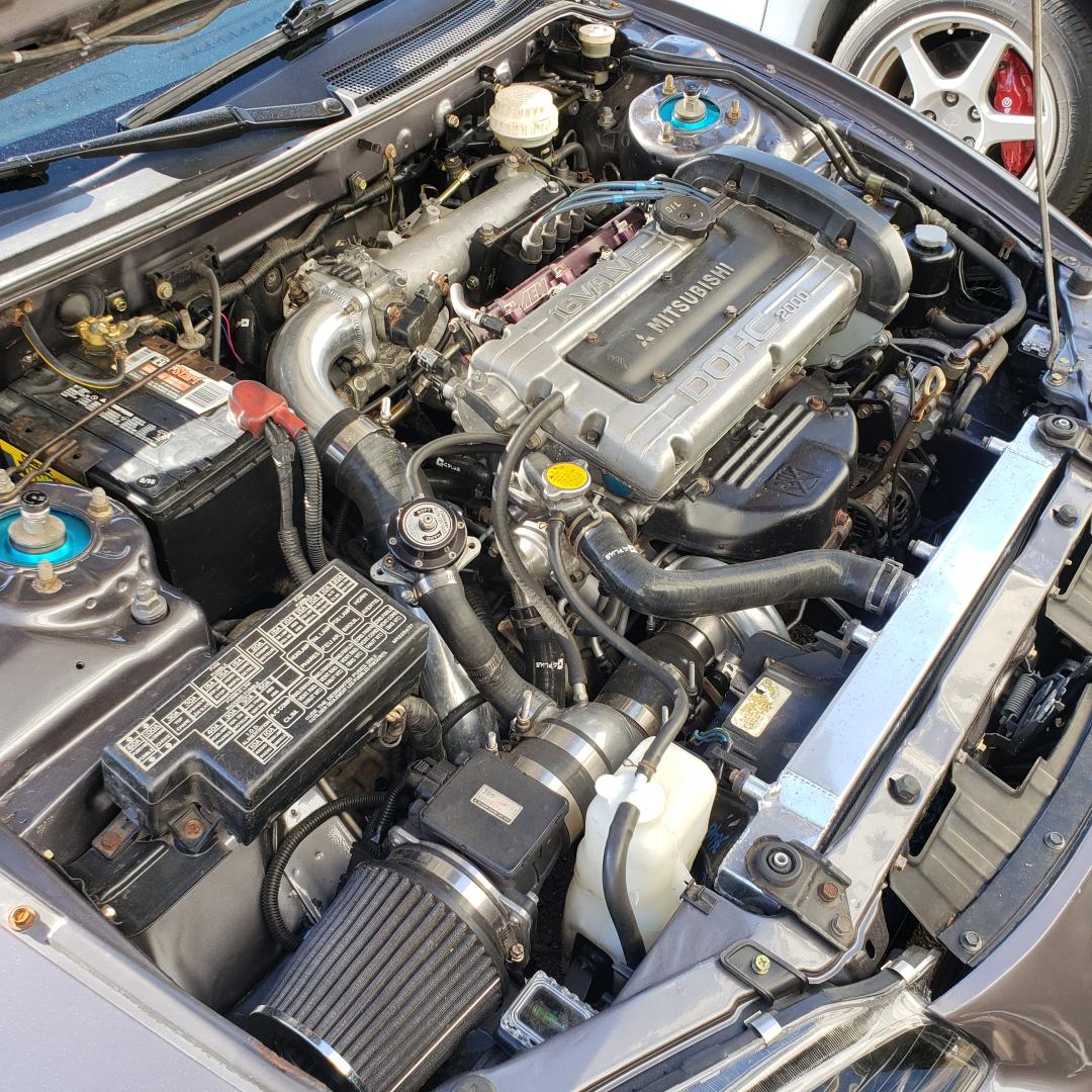

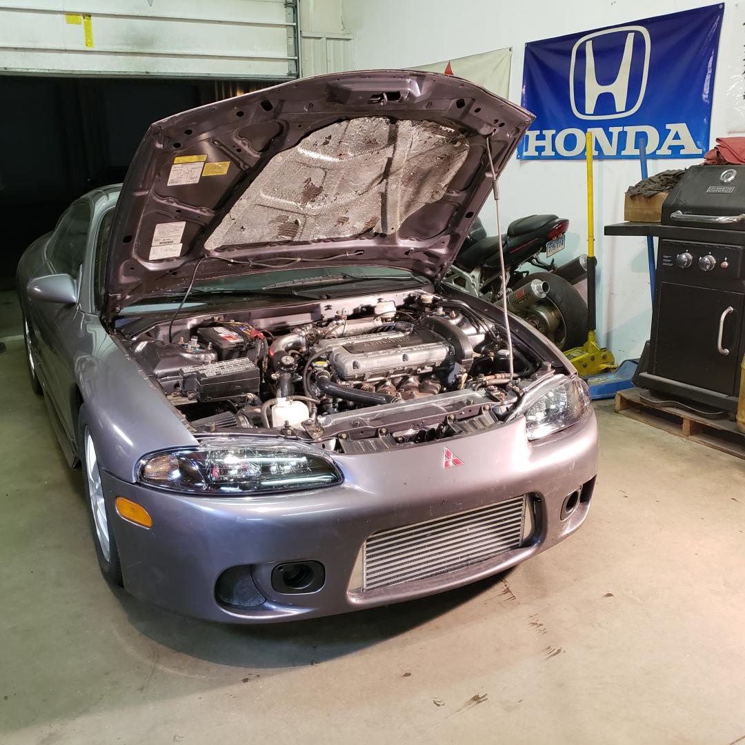

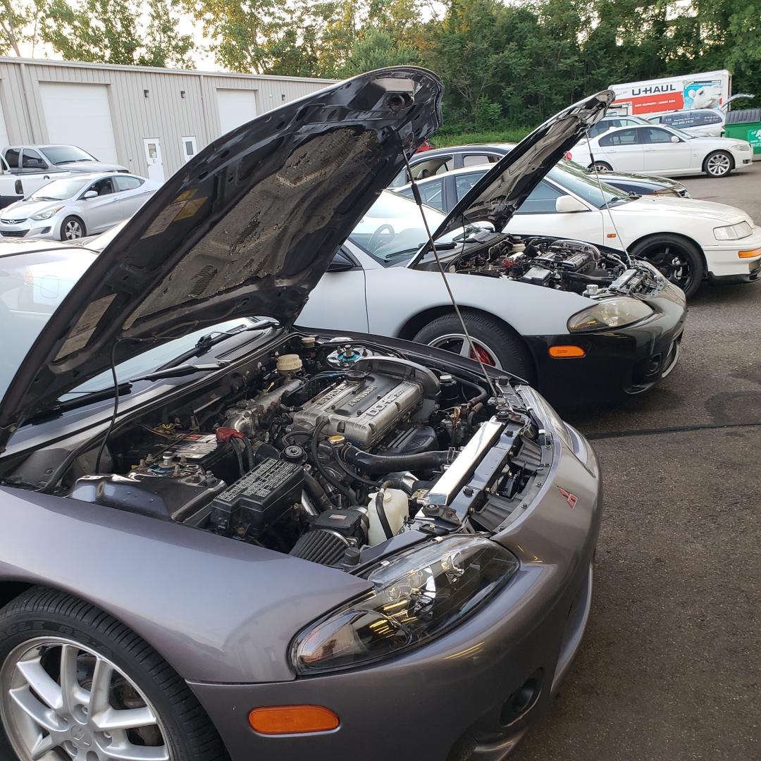

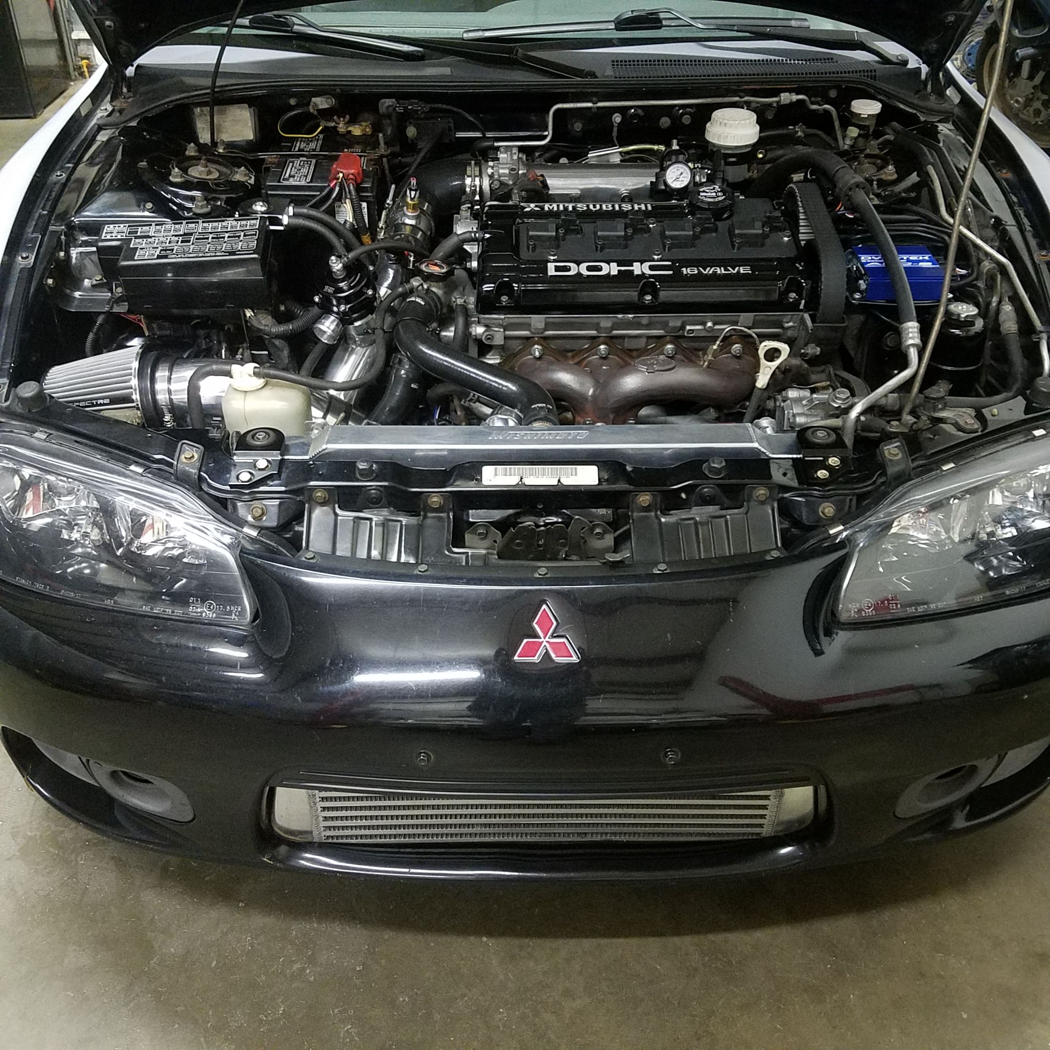

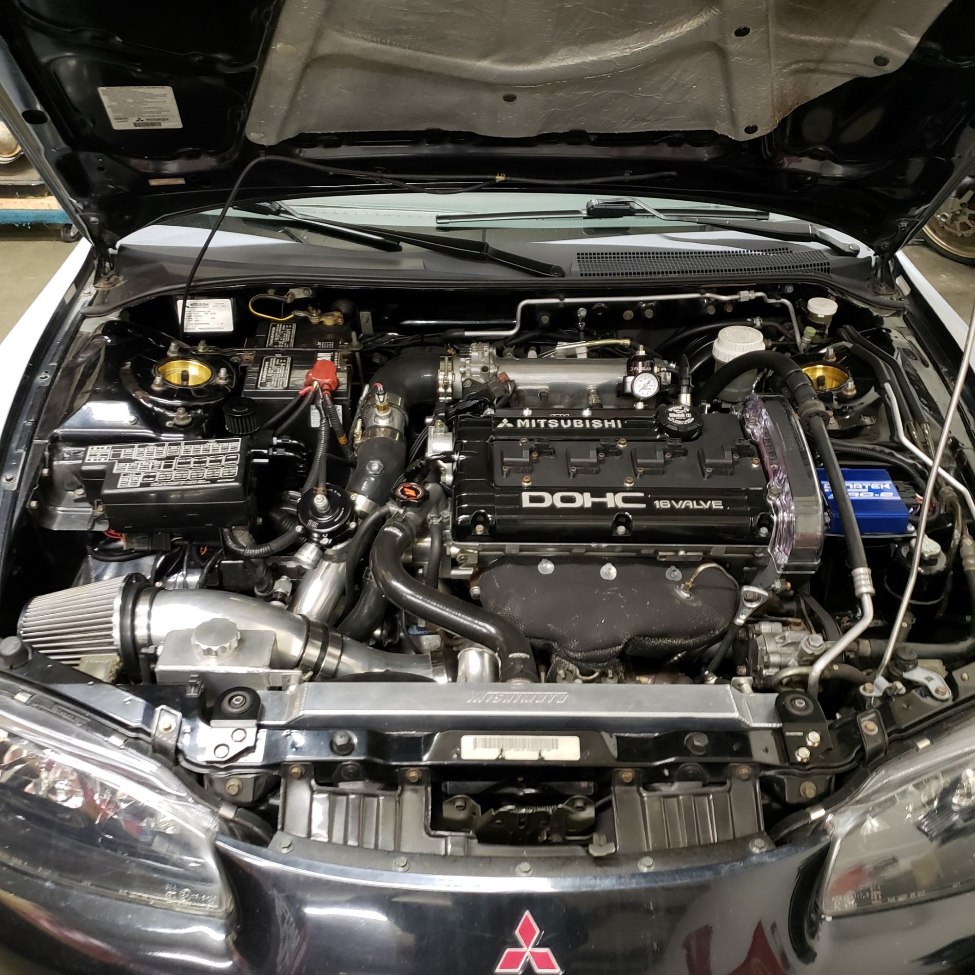

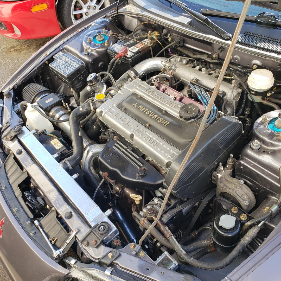

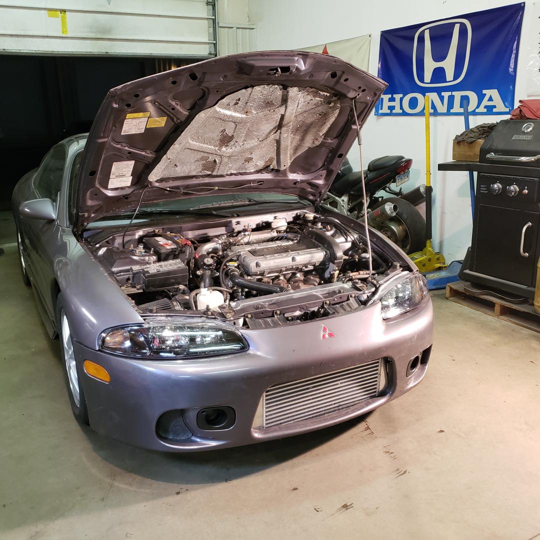

This is Magenta Greys engine bay.
Some of the upgrades include:
evo316g
evo8 560s
evo8 MAF
evo3 IM
3" Thermal
ECM Link V3
I should probably make it its own build thread. Ive got tons of pics from start to finish over the last 2 months. Black leather too.
