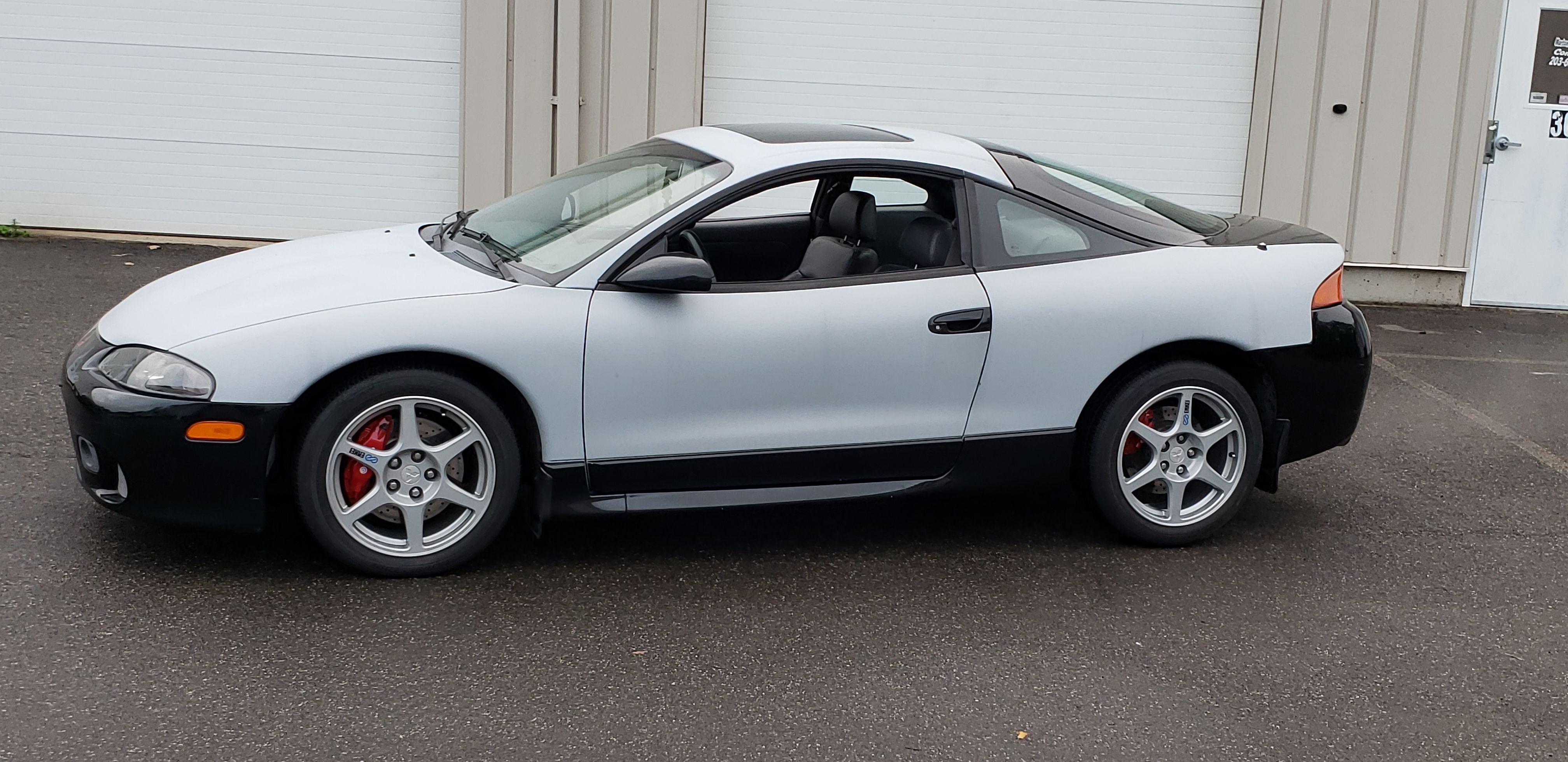

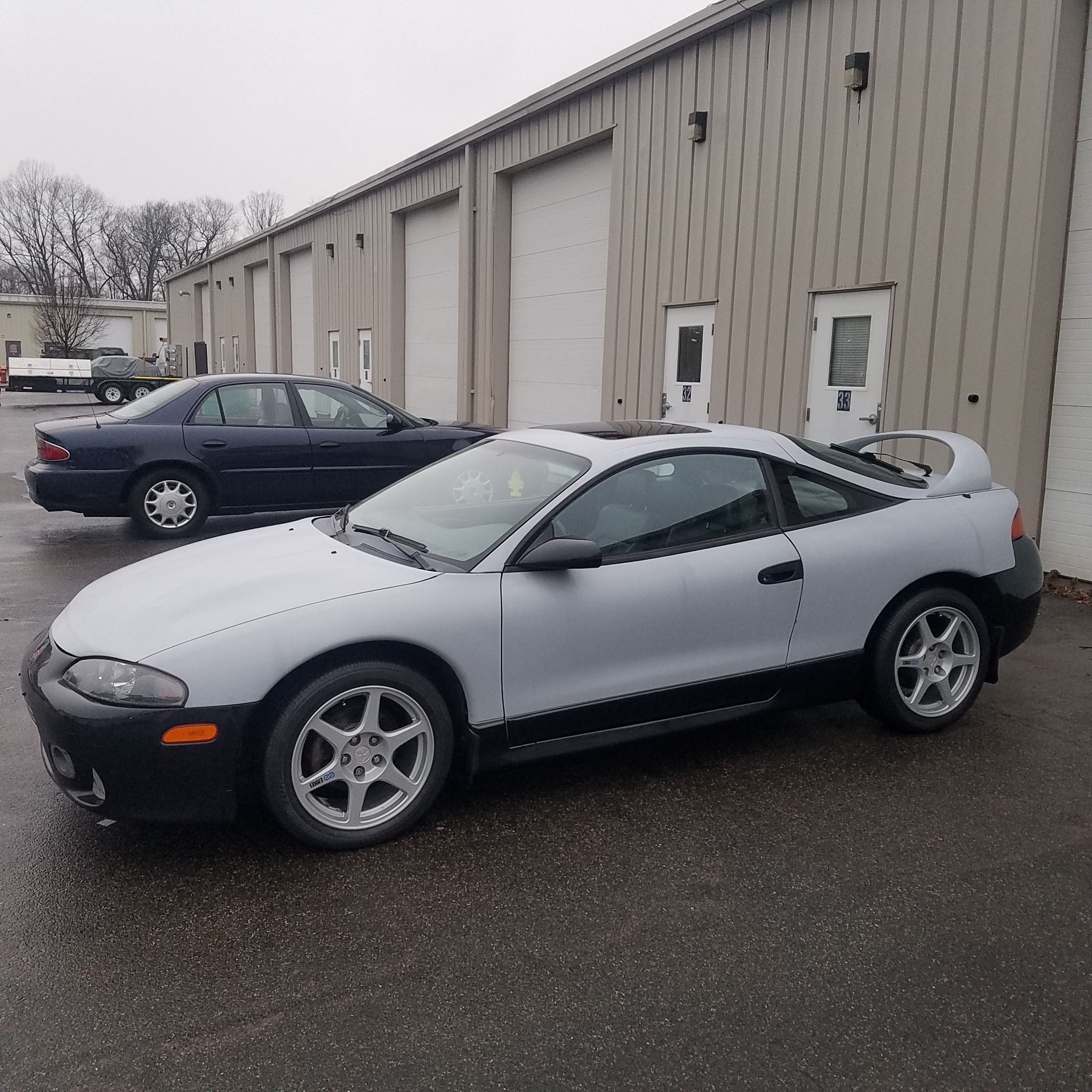

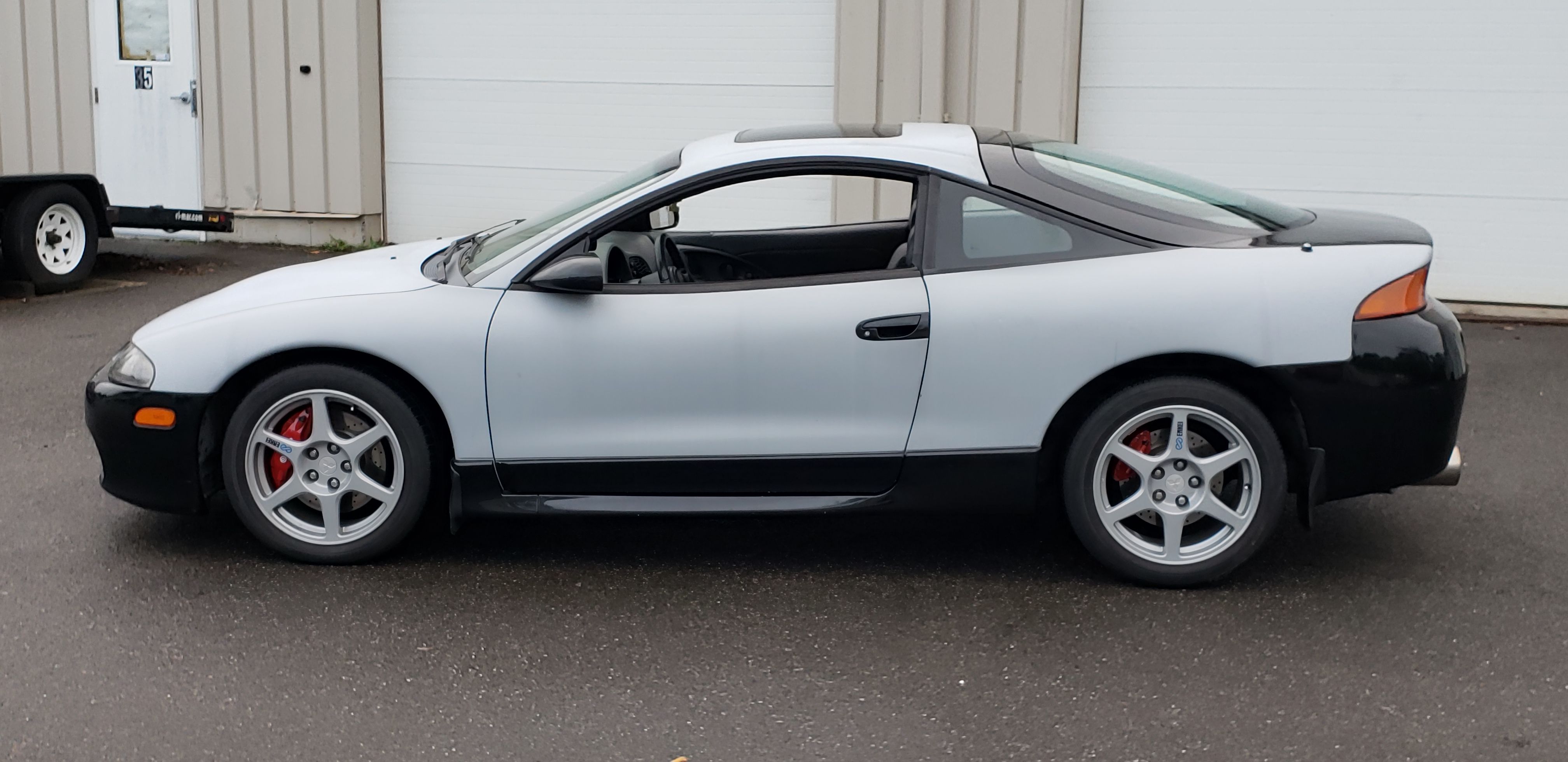

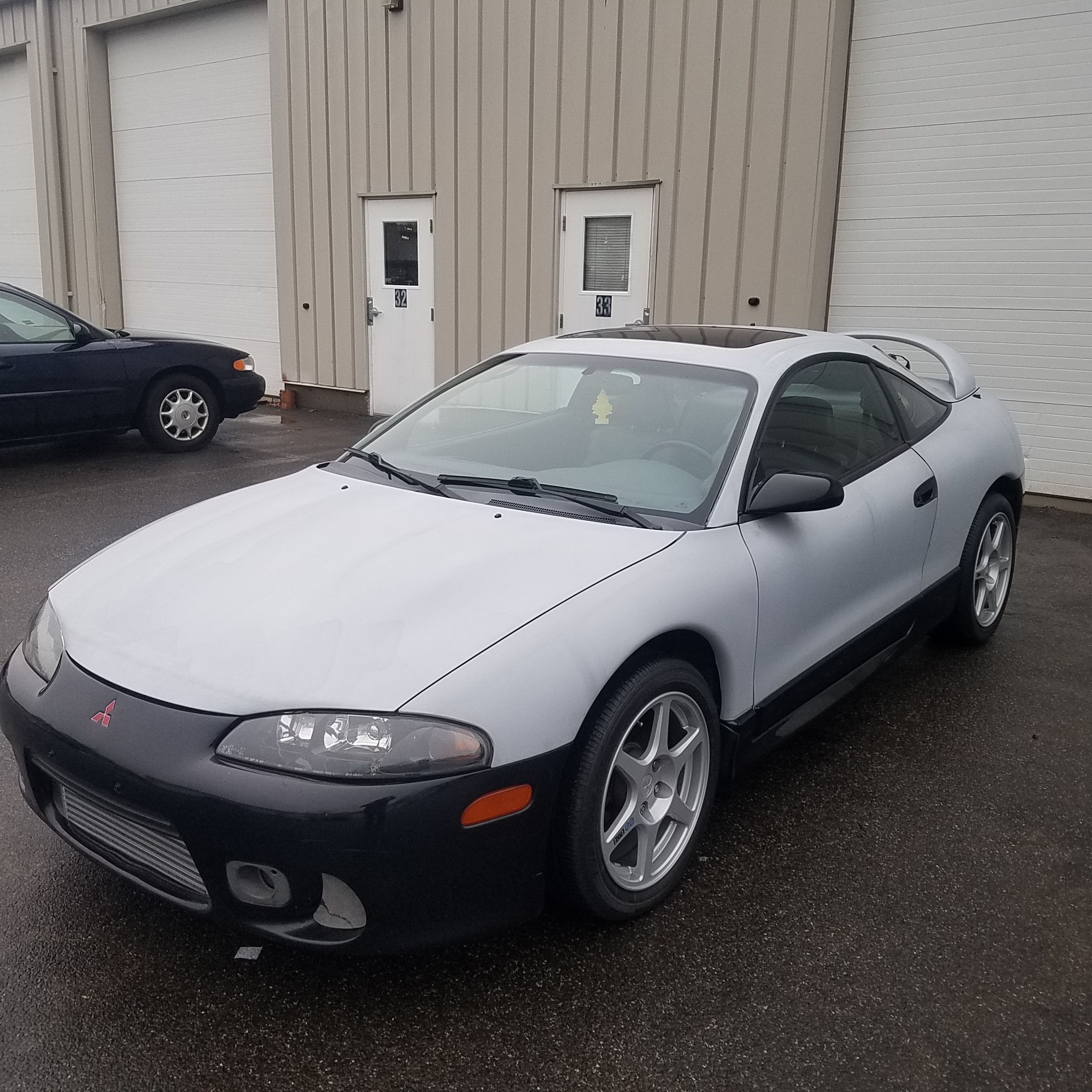

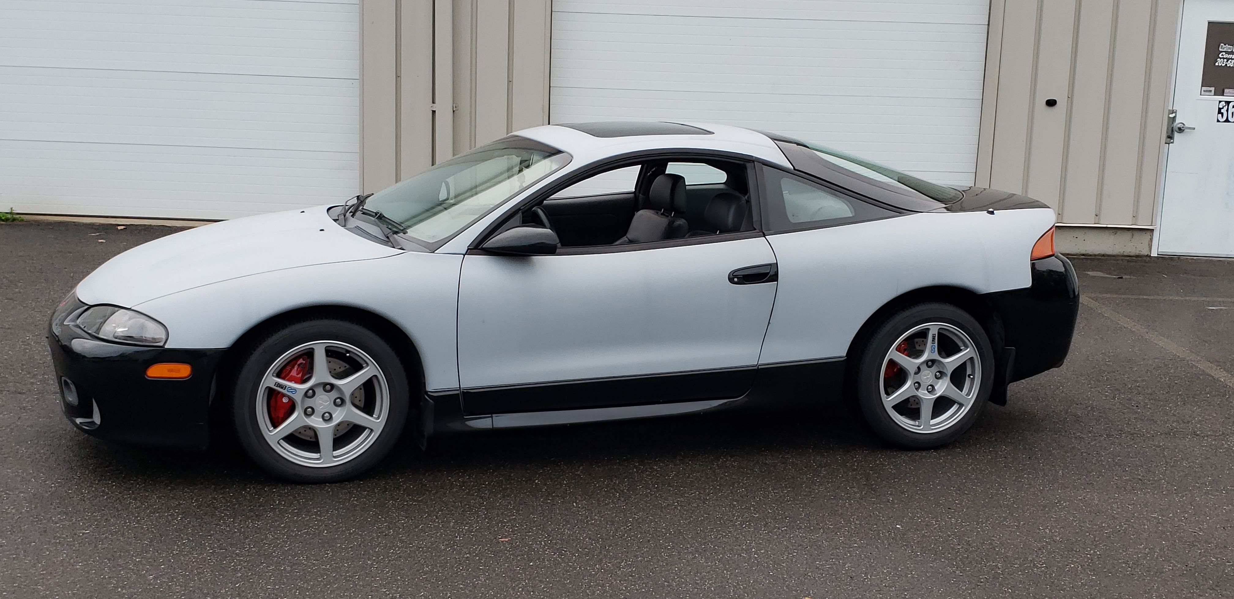

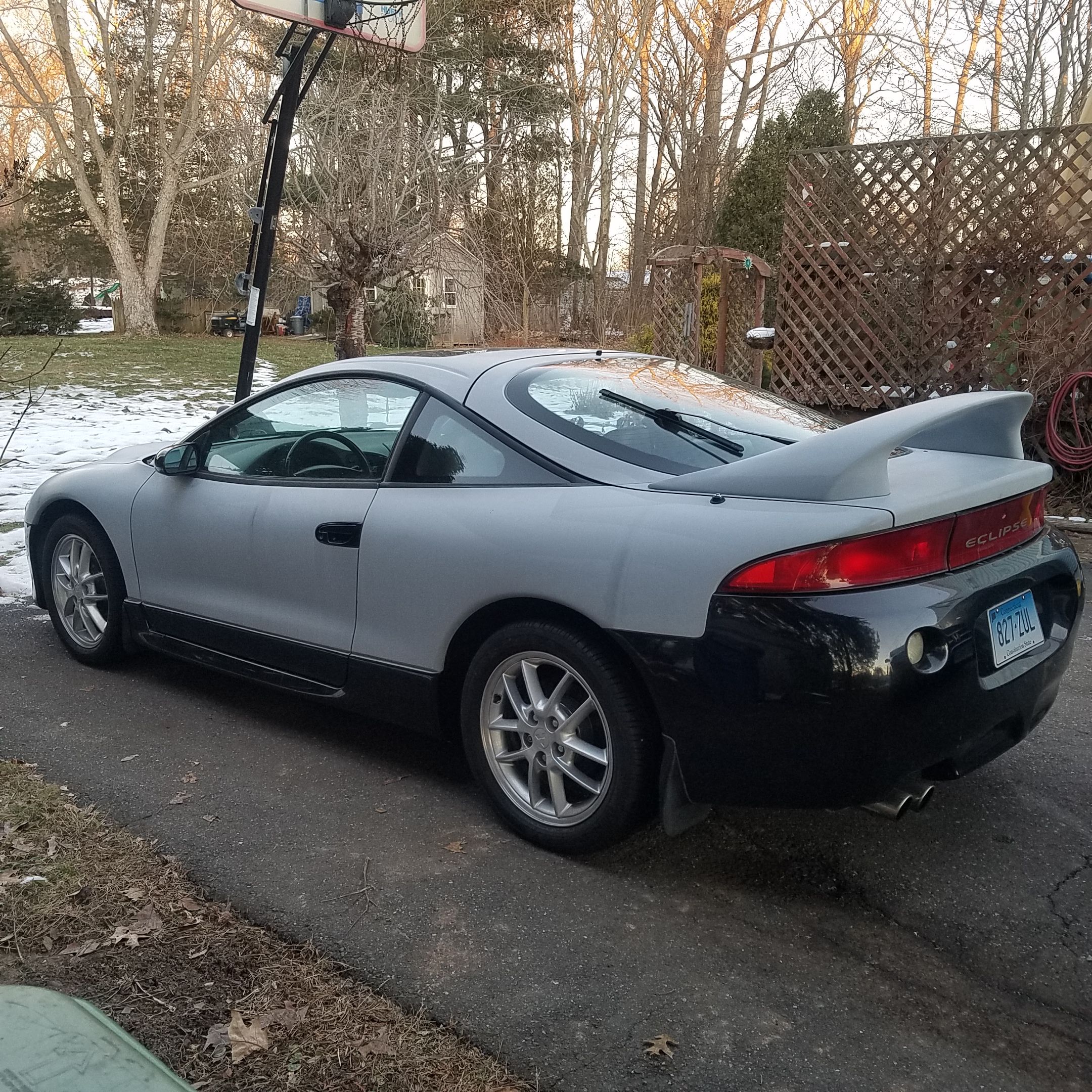

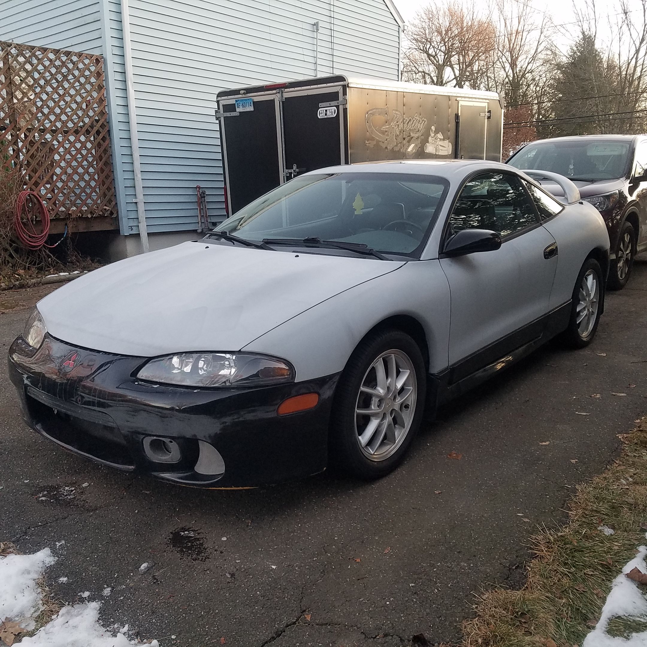

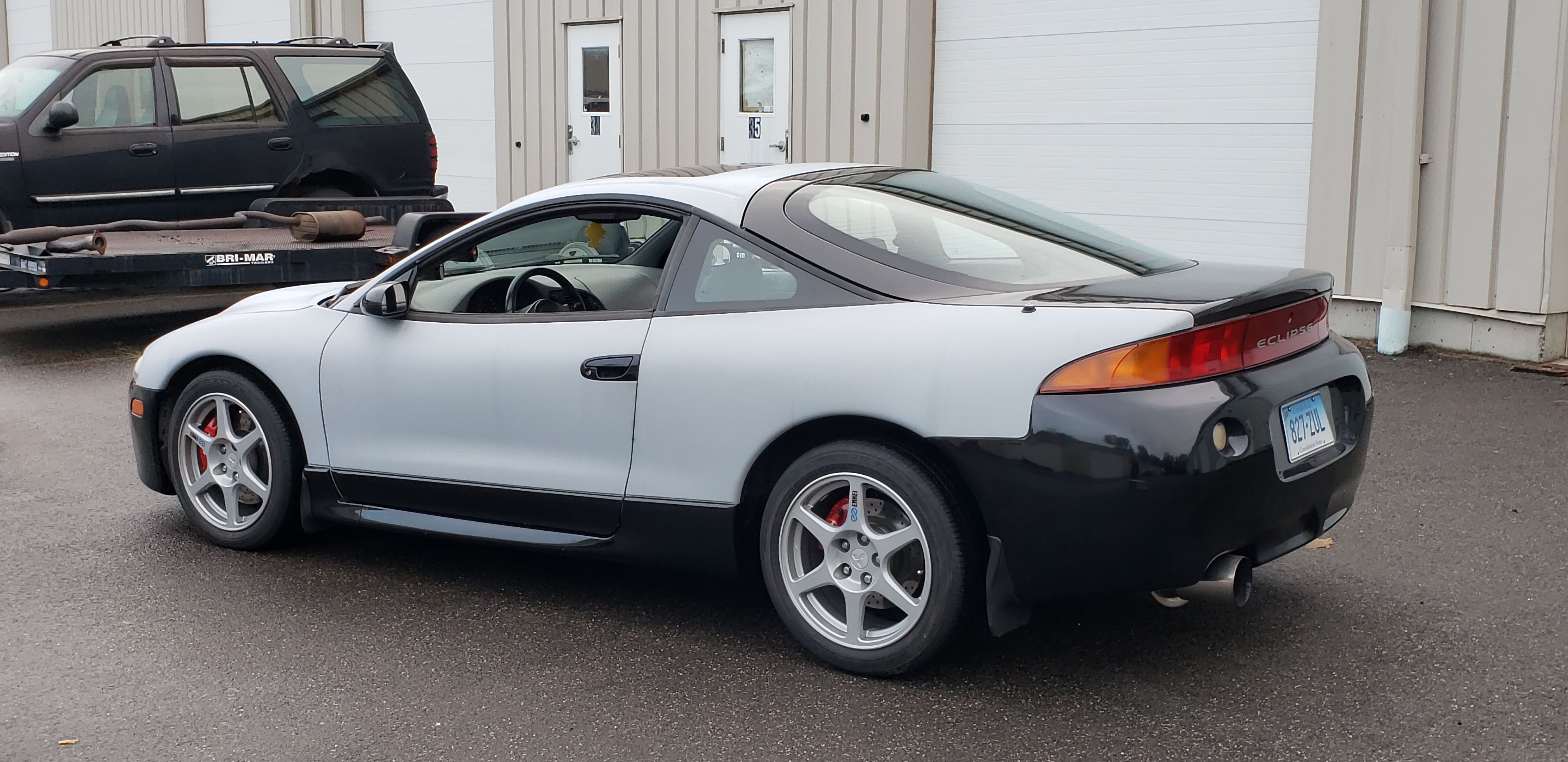

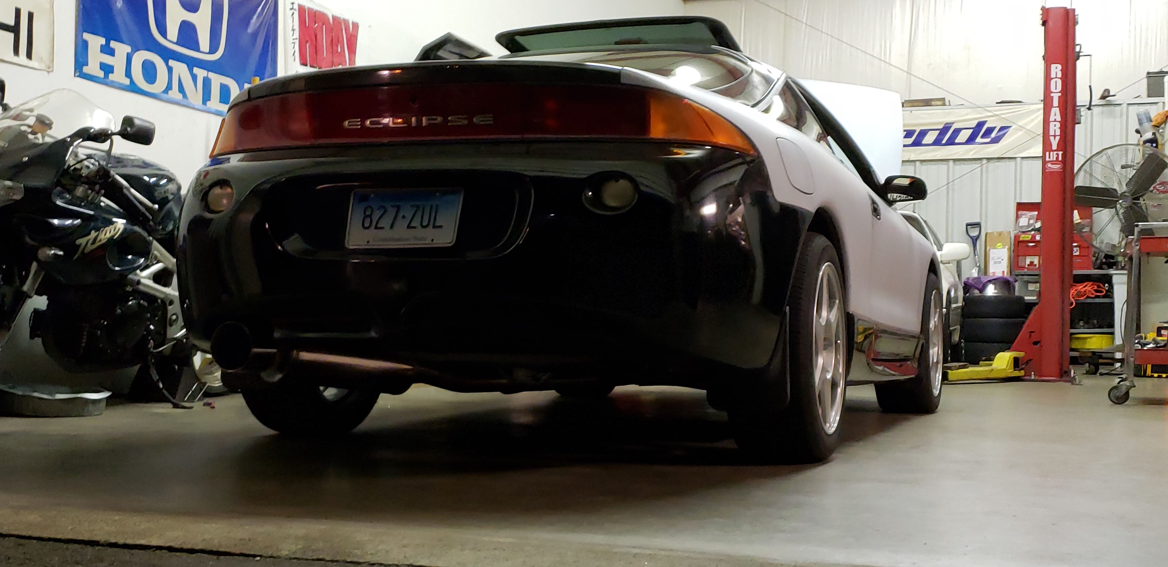

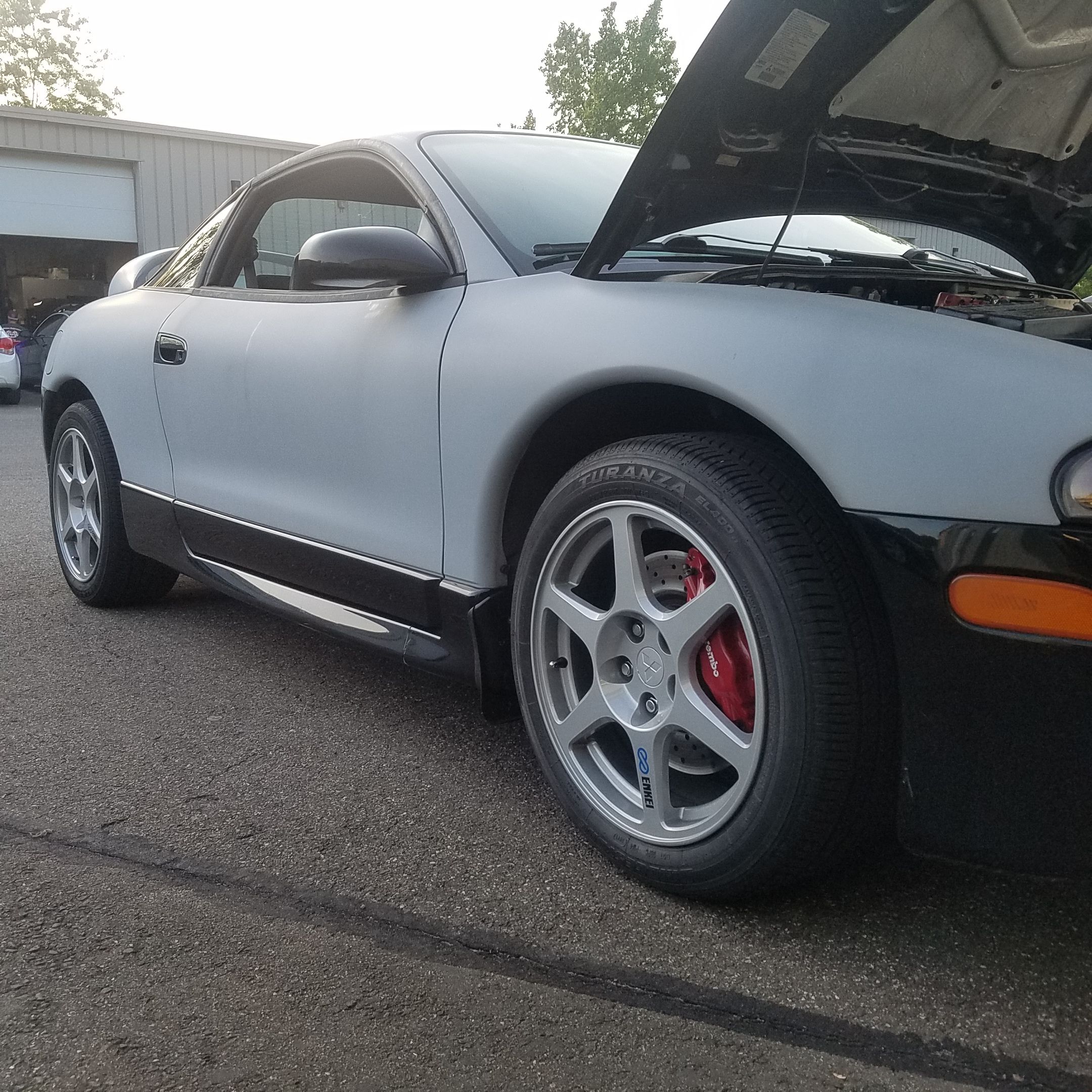

1997 GSX

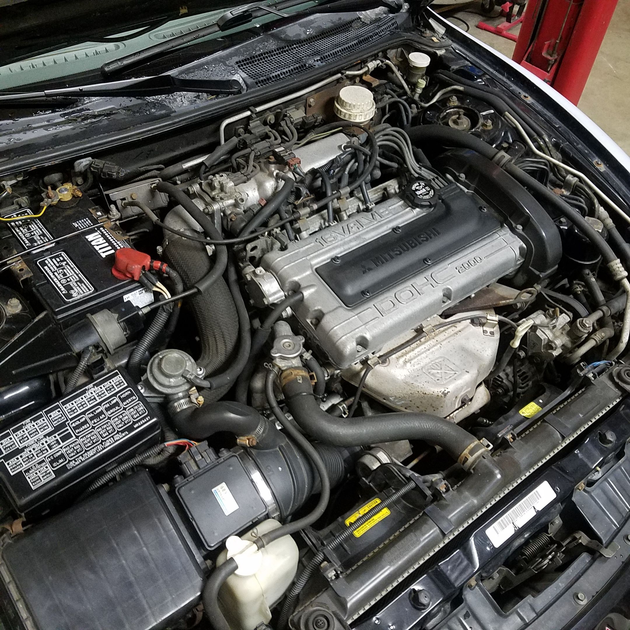

This is the car shortly after I bought it. First thing I did was fix all the dings and dents, sanded down all the sun beat clear, and locked it down with a quality urethane primer. This was a few years back when most of the body parts where available at the dealer. I went nuts and bought everything, belt moldings, quarter glass, roof drip moldings, windshield rubber, ect. All hoarded for the day I decide to spray it and reassemble with all mint new parts. It will be a special time when I finally do this. Something I planned way back.

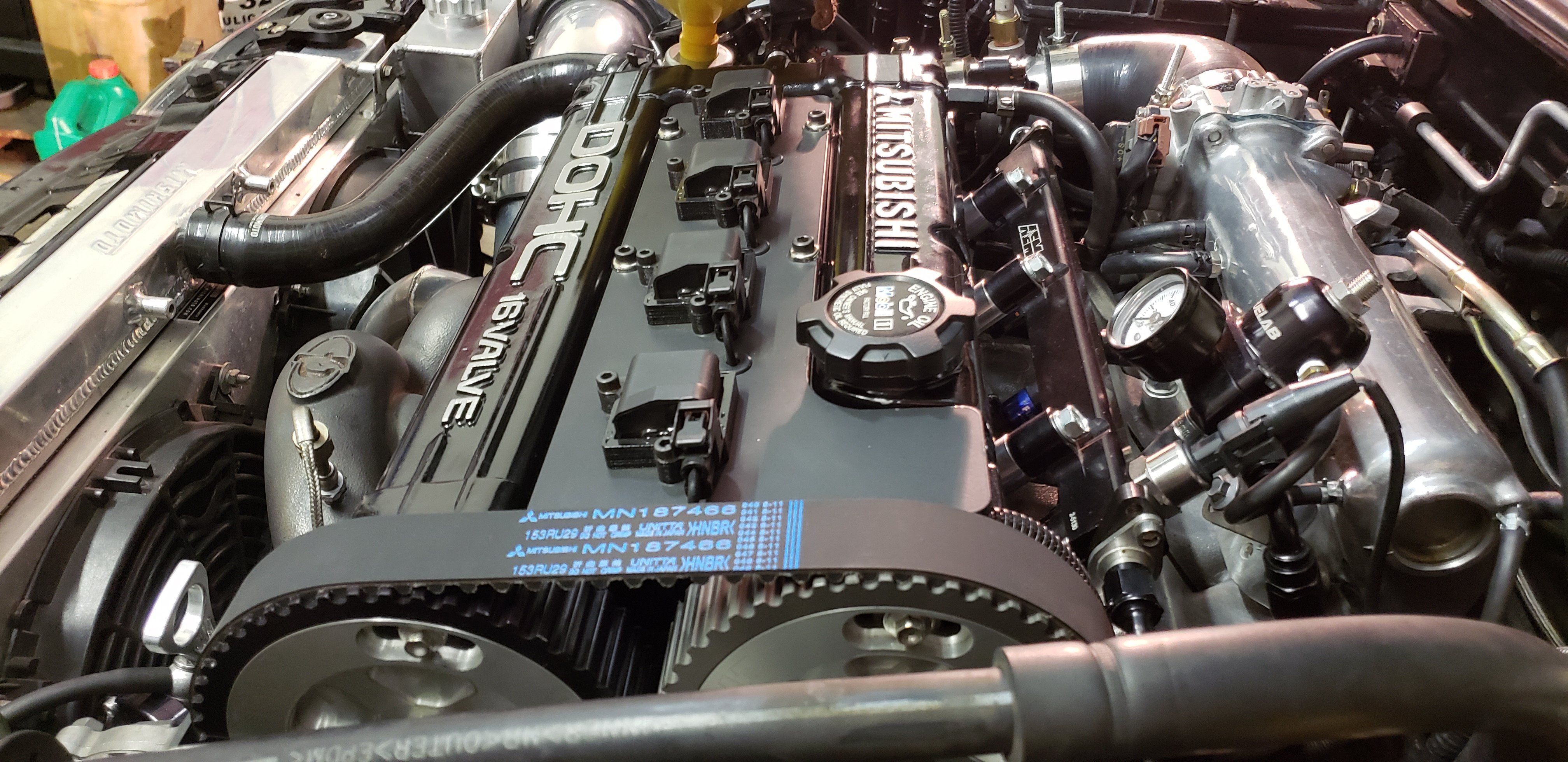

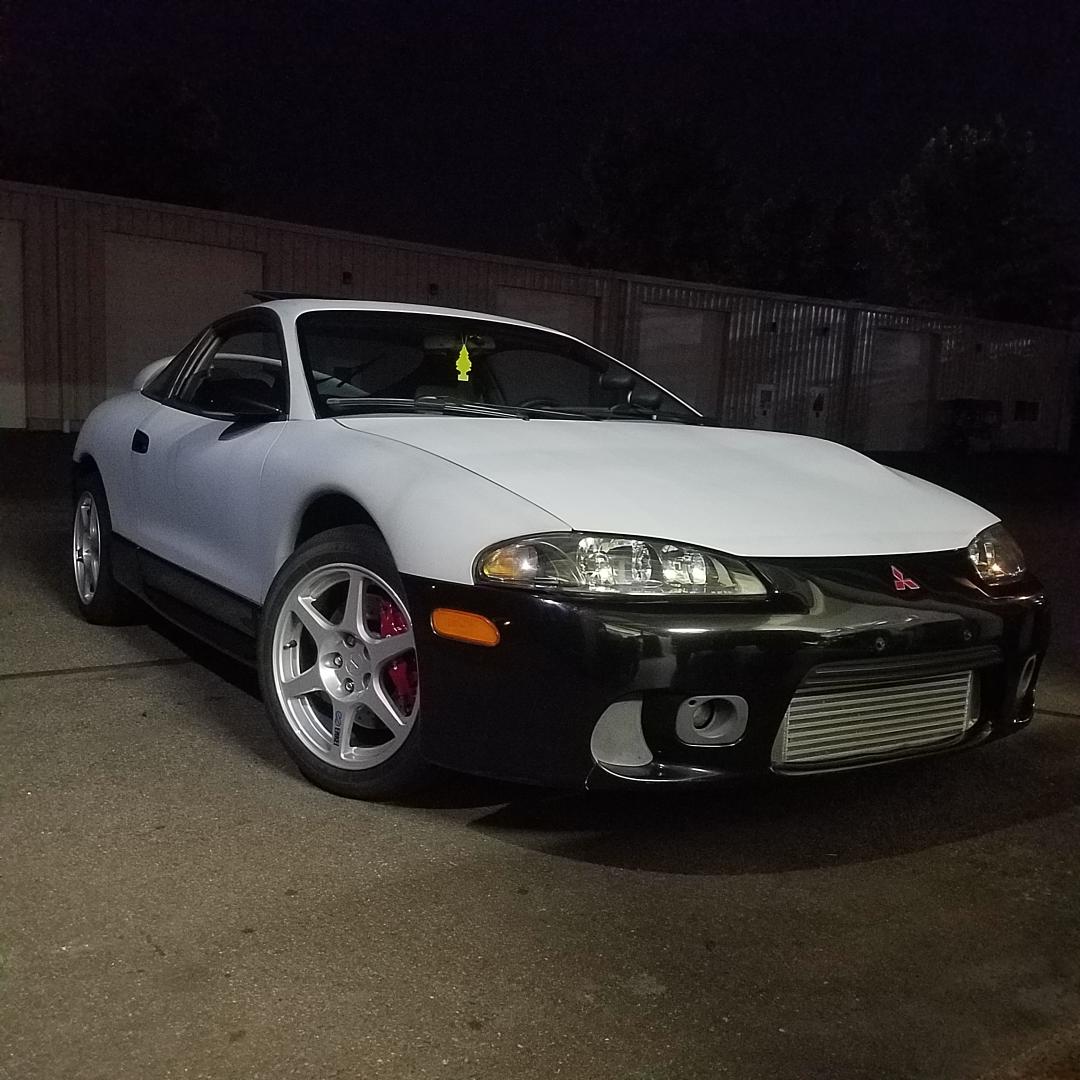

Car was completely stock when I bought it. At this point I had switched out the plastic BOV for a 1g unit just to turn the boost up a touch on the T25. I did not leave it this way long.

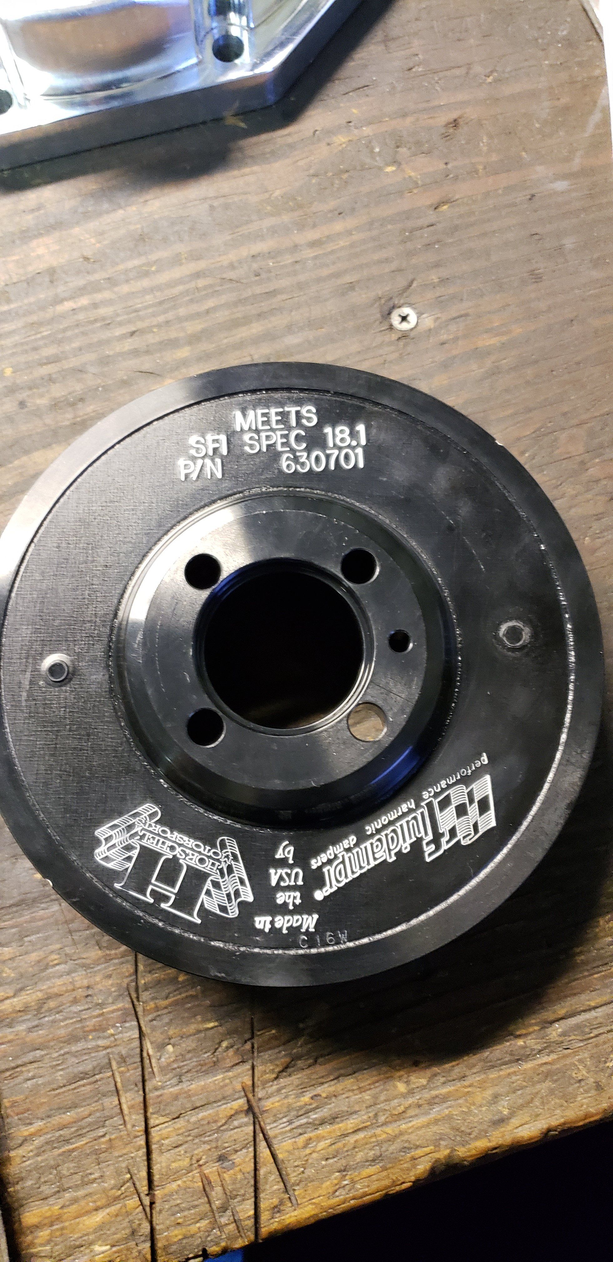

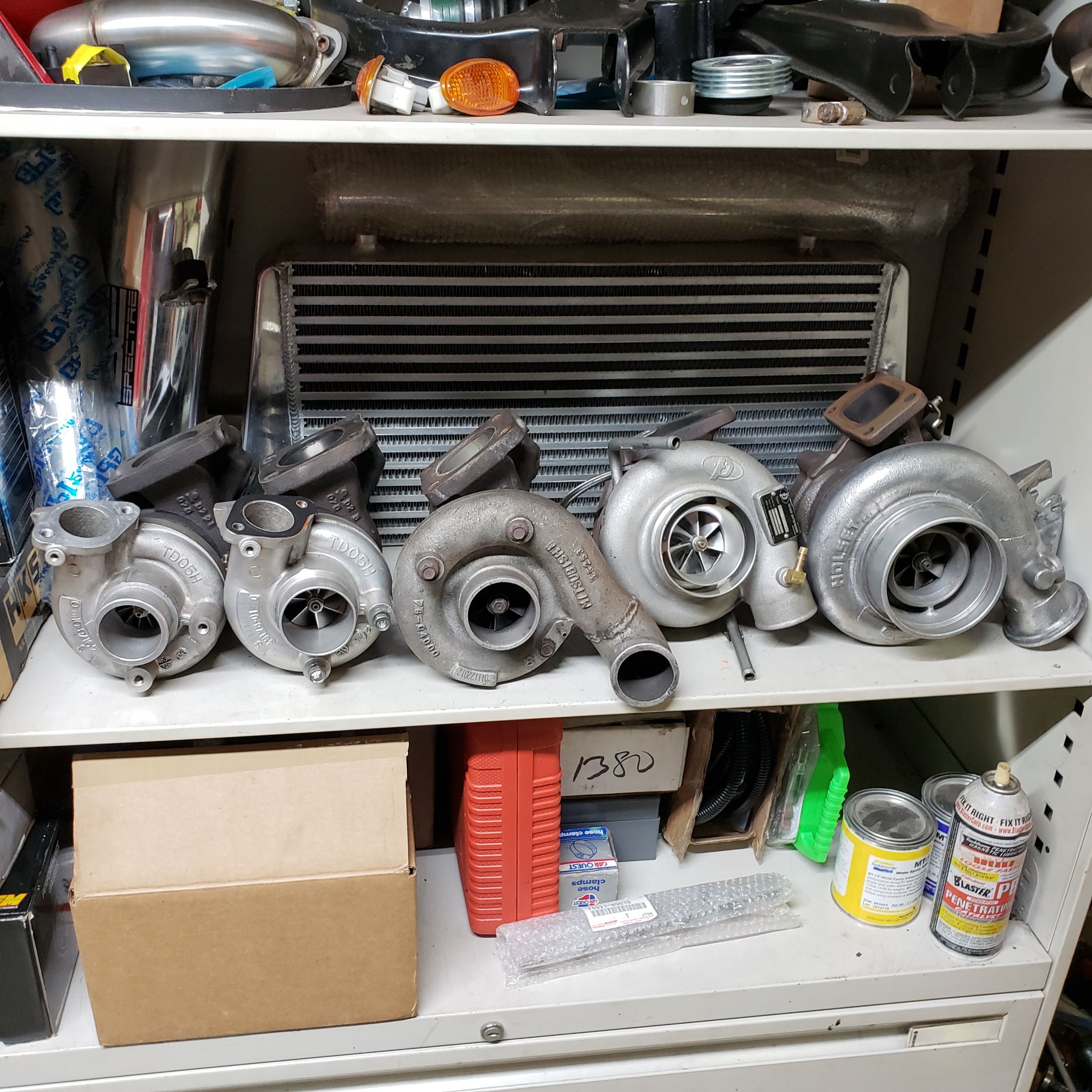

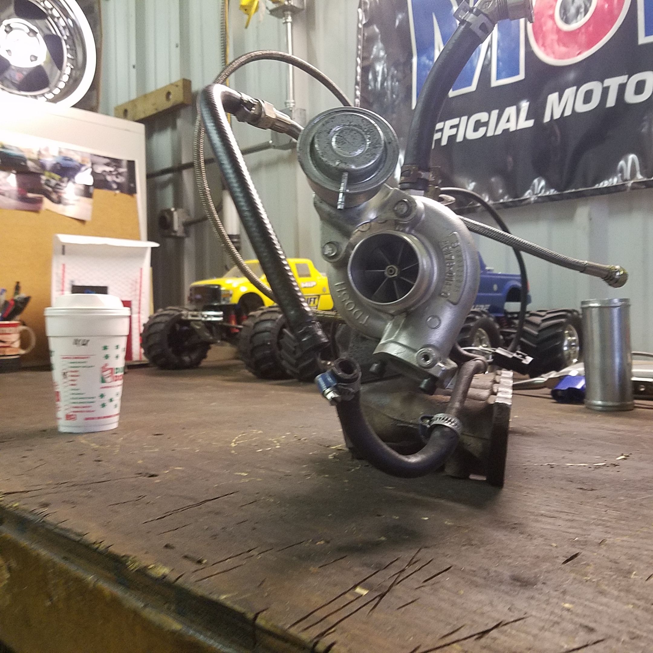

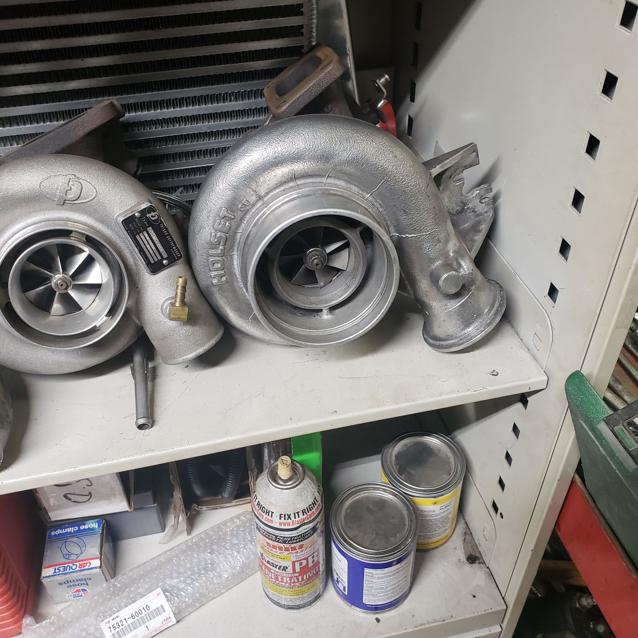

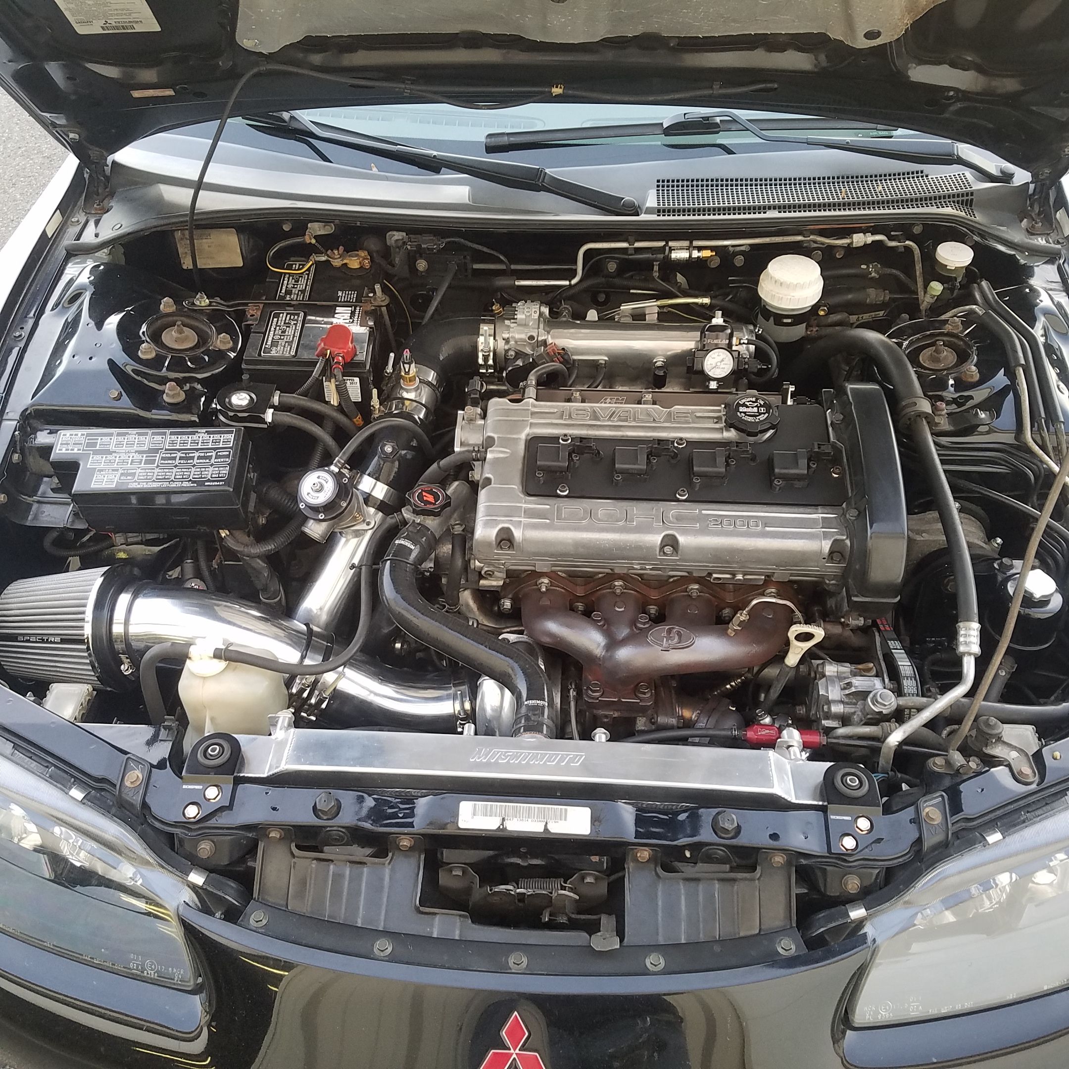

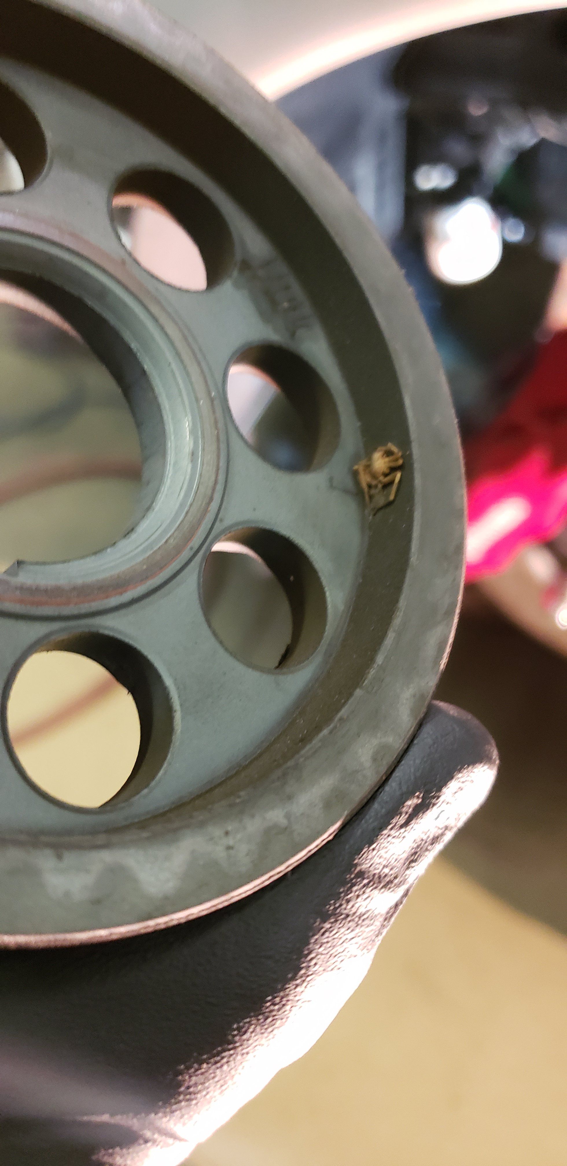

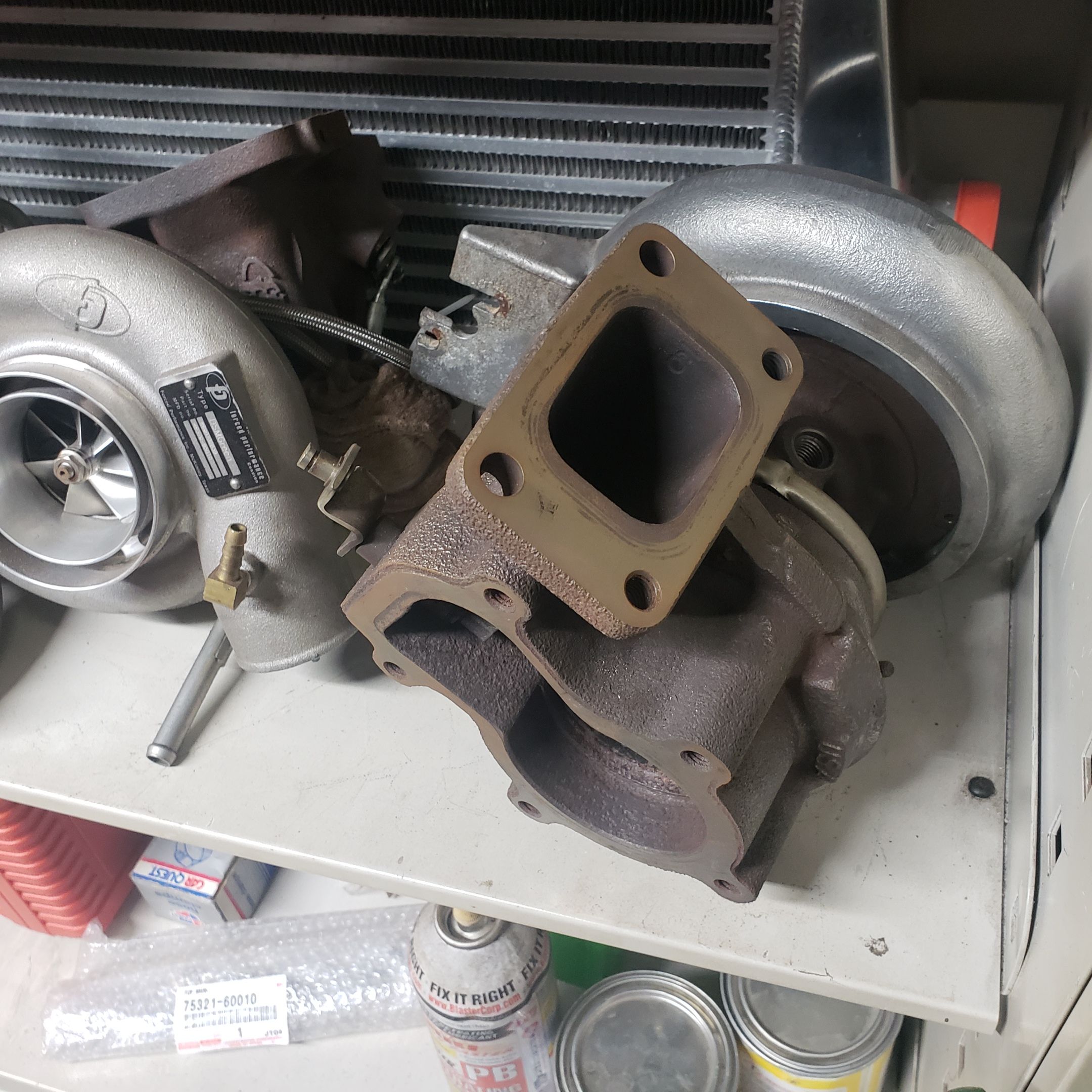

This is a V1 HTA68 I picked up a while back. Before i got this car.

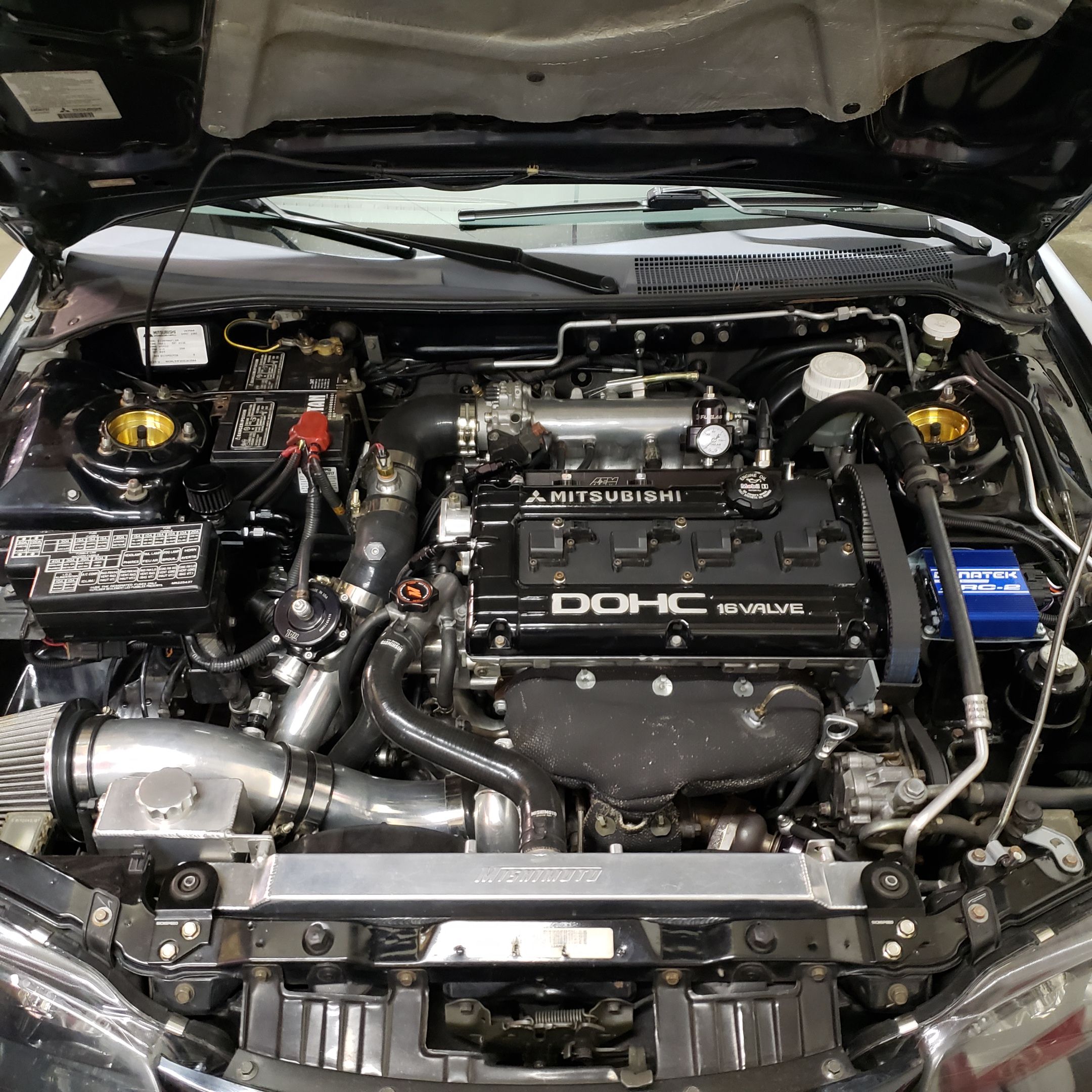

This is a mint almost brand new FP Green. Wasnt sure exactly which one I wanted to go with. Ended up trying a few different things.

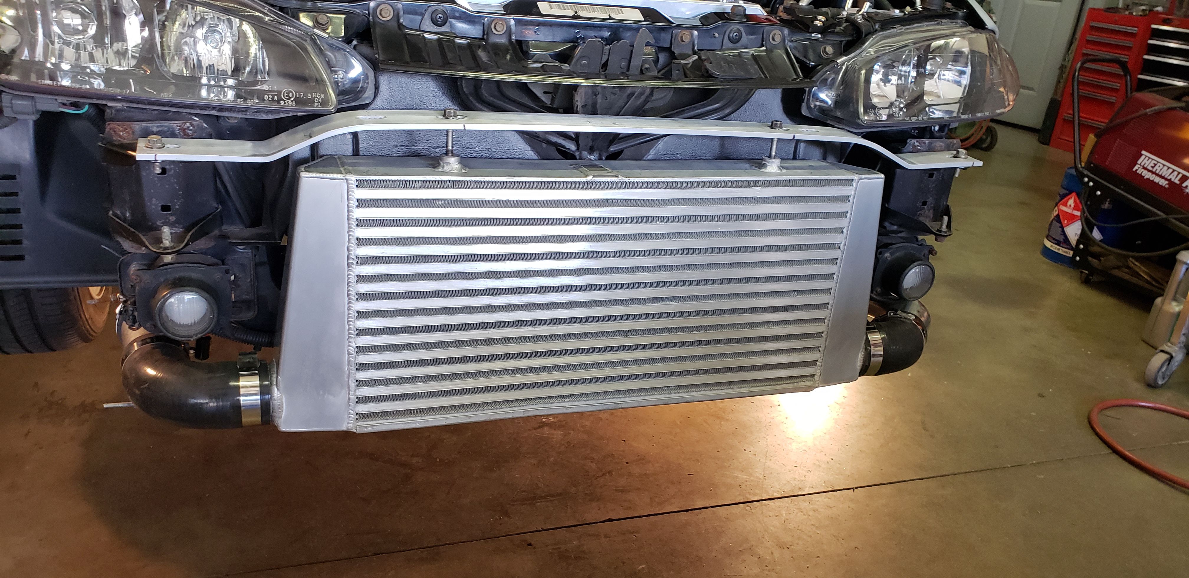

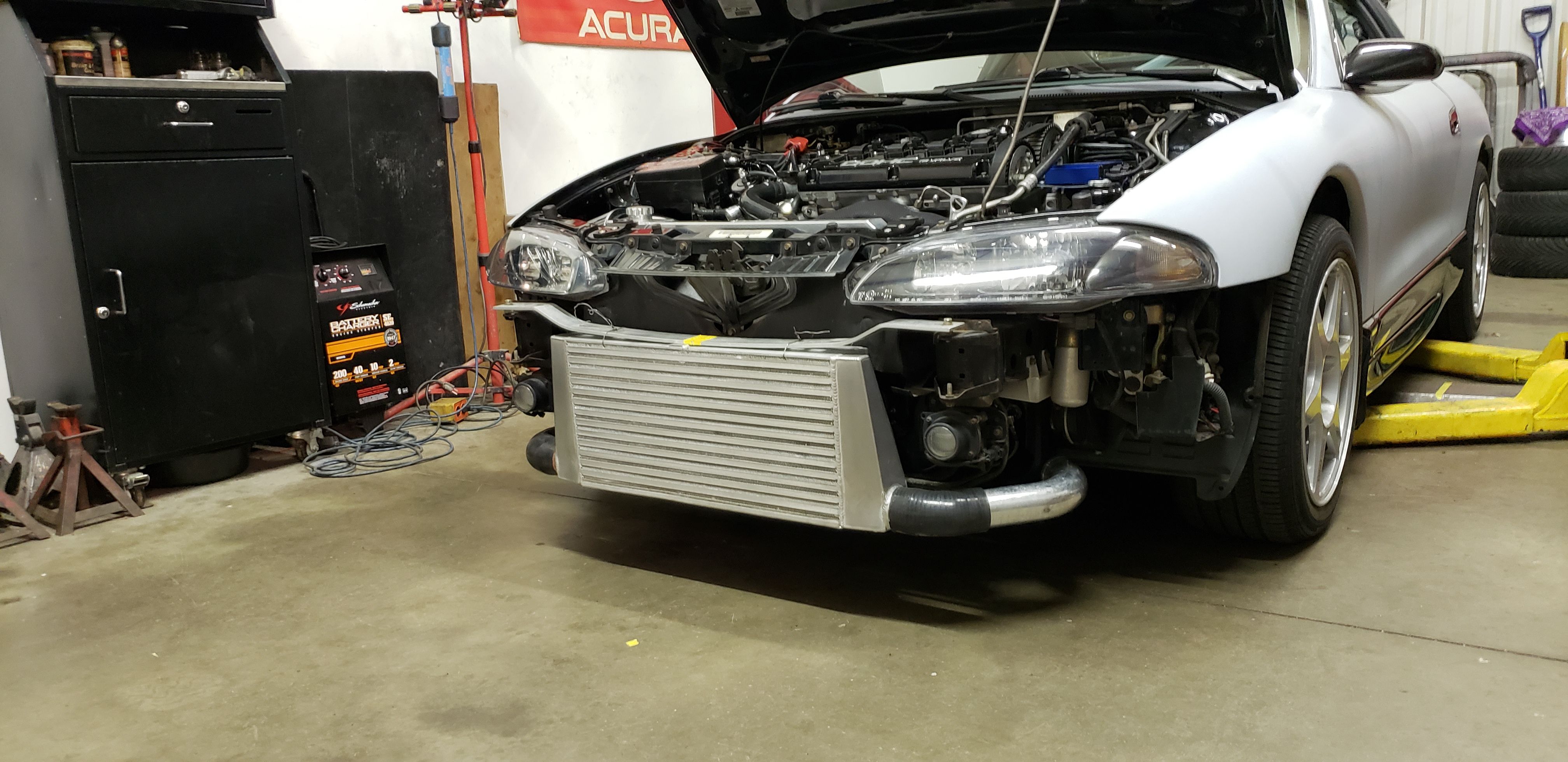

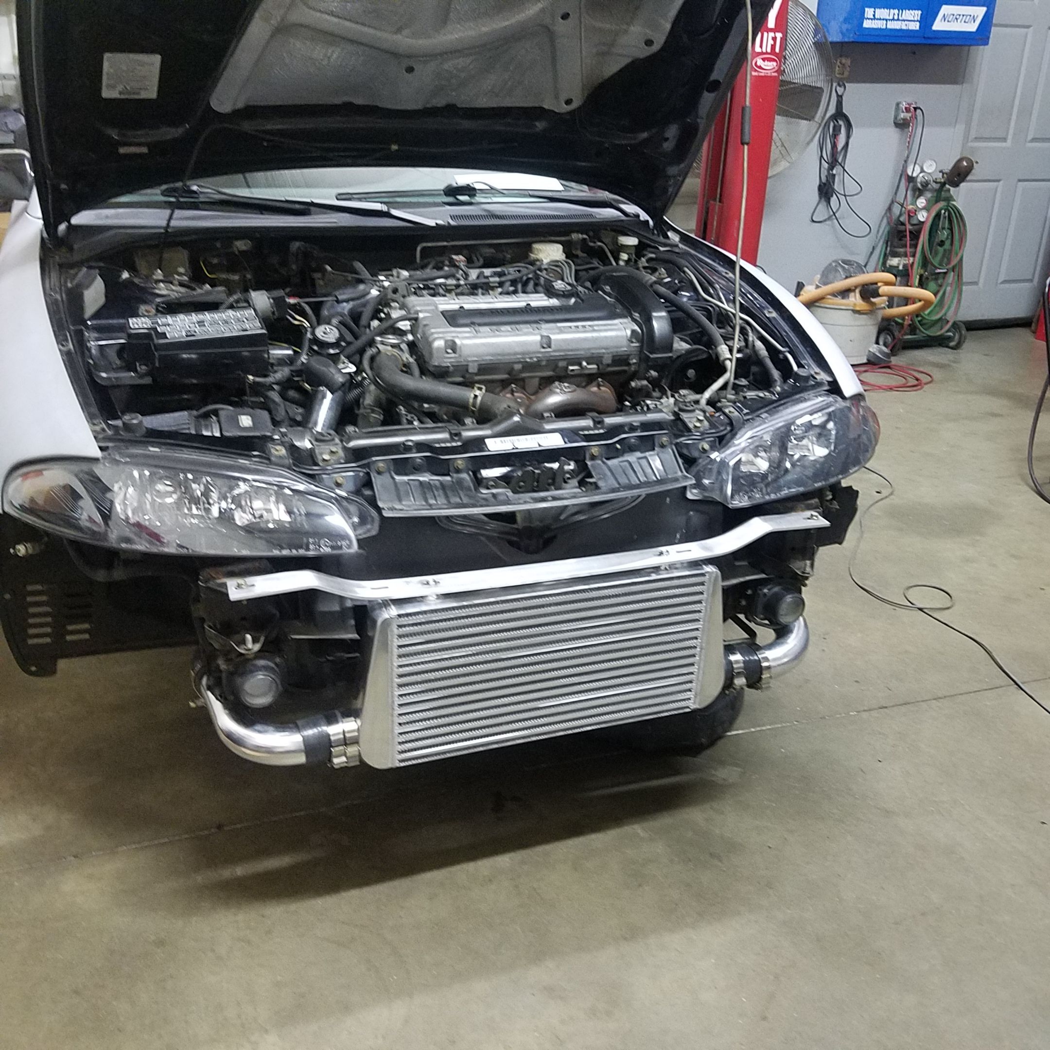

Picked up a Punishment Racing FMIC kit mainly for the piping and to get something in there fast and easy. I had plans on swapping to a better quality core in the near future.

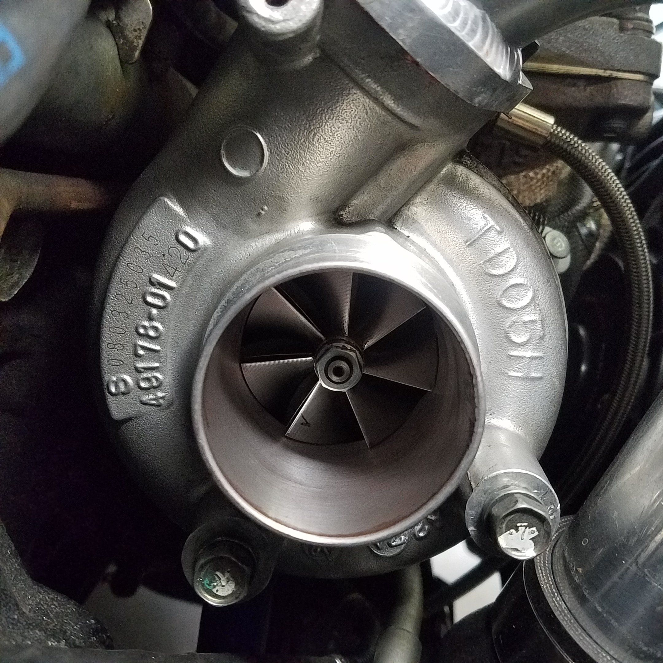

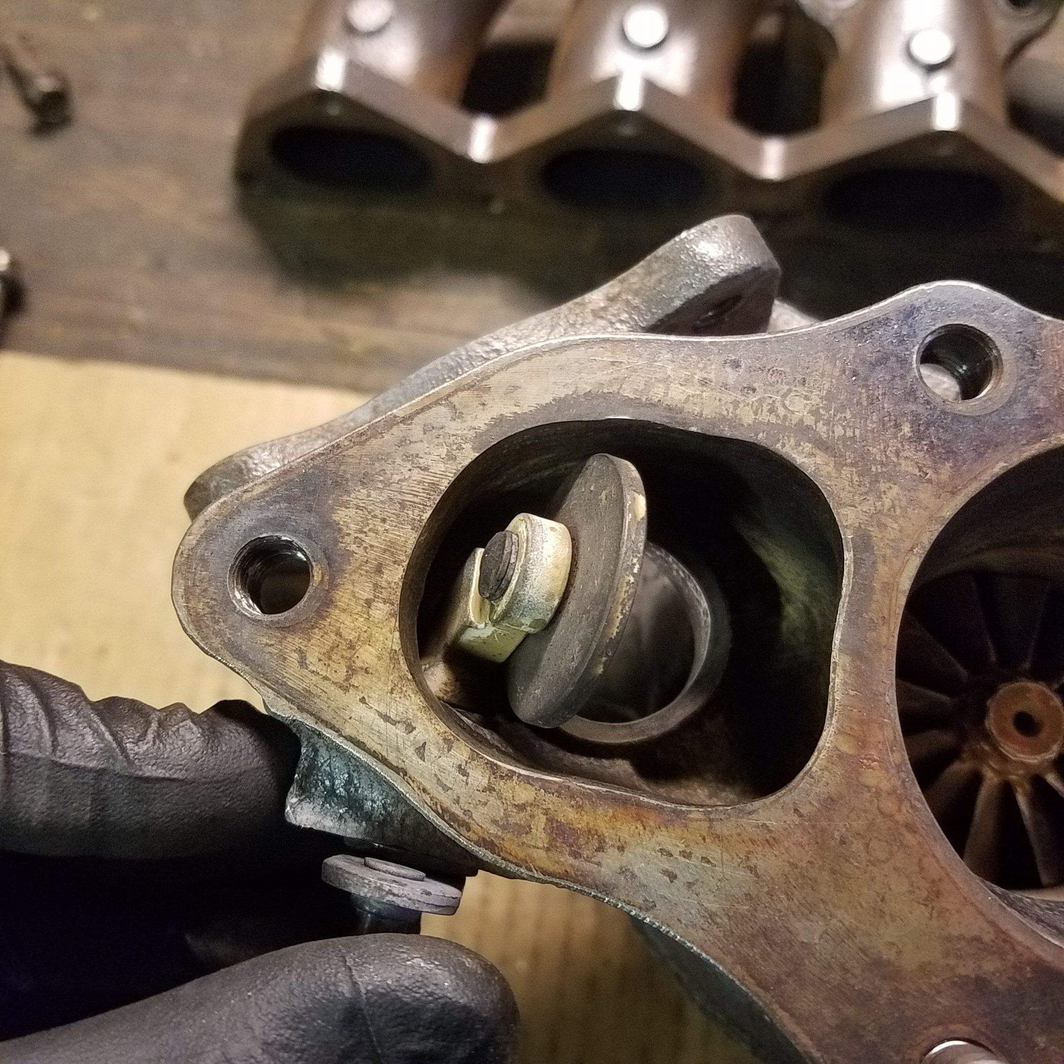

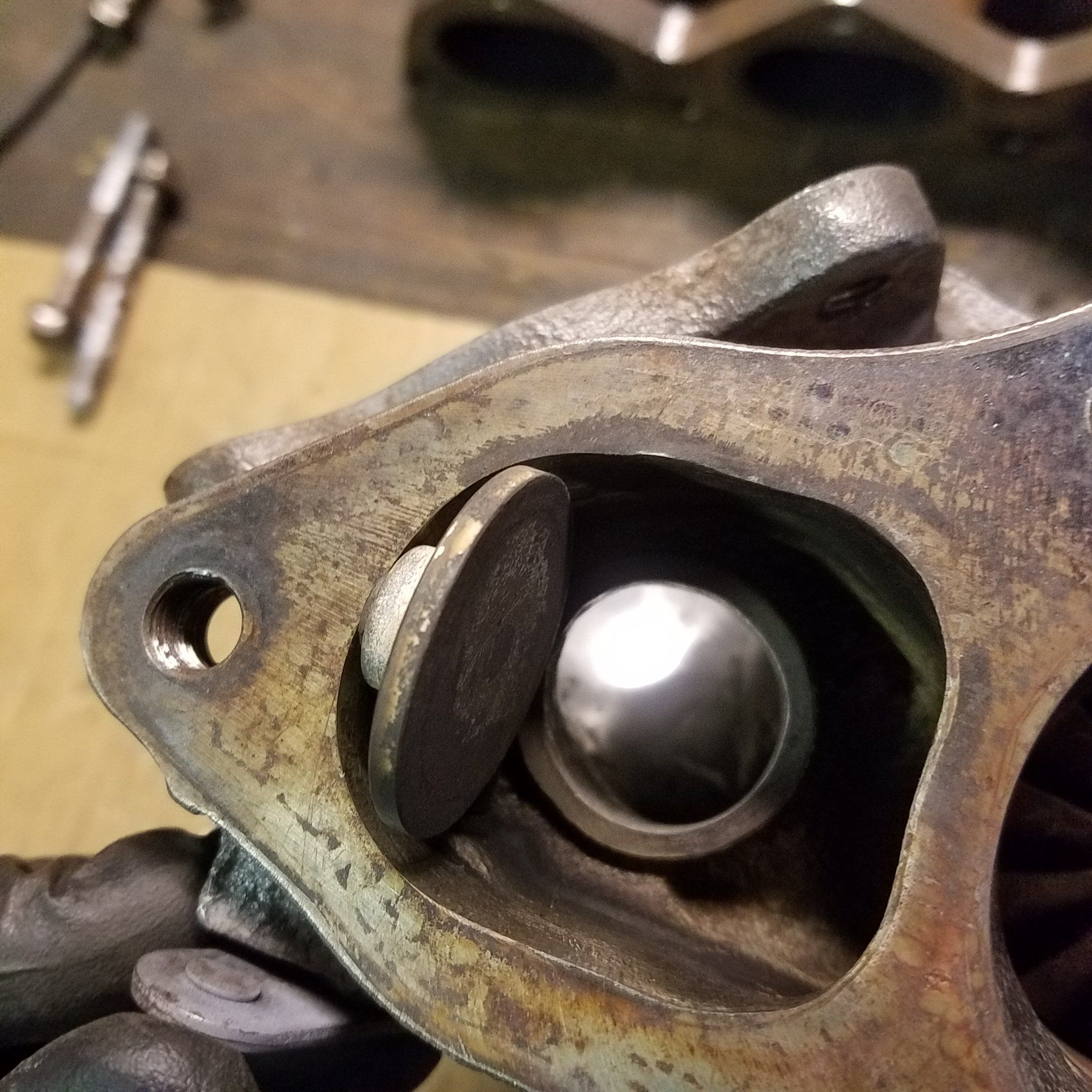

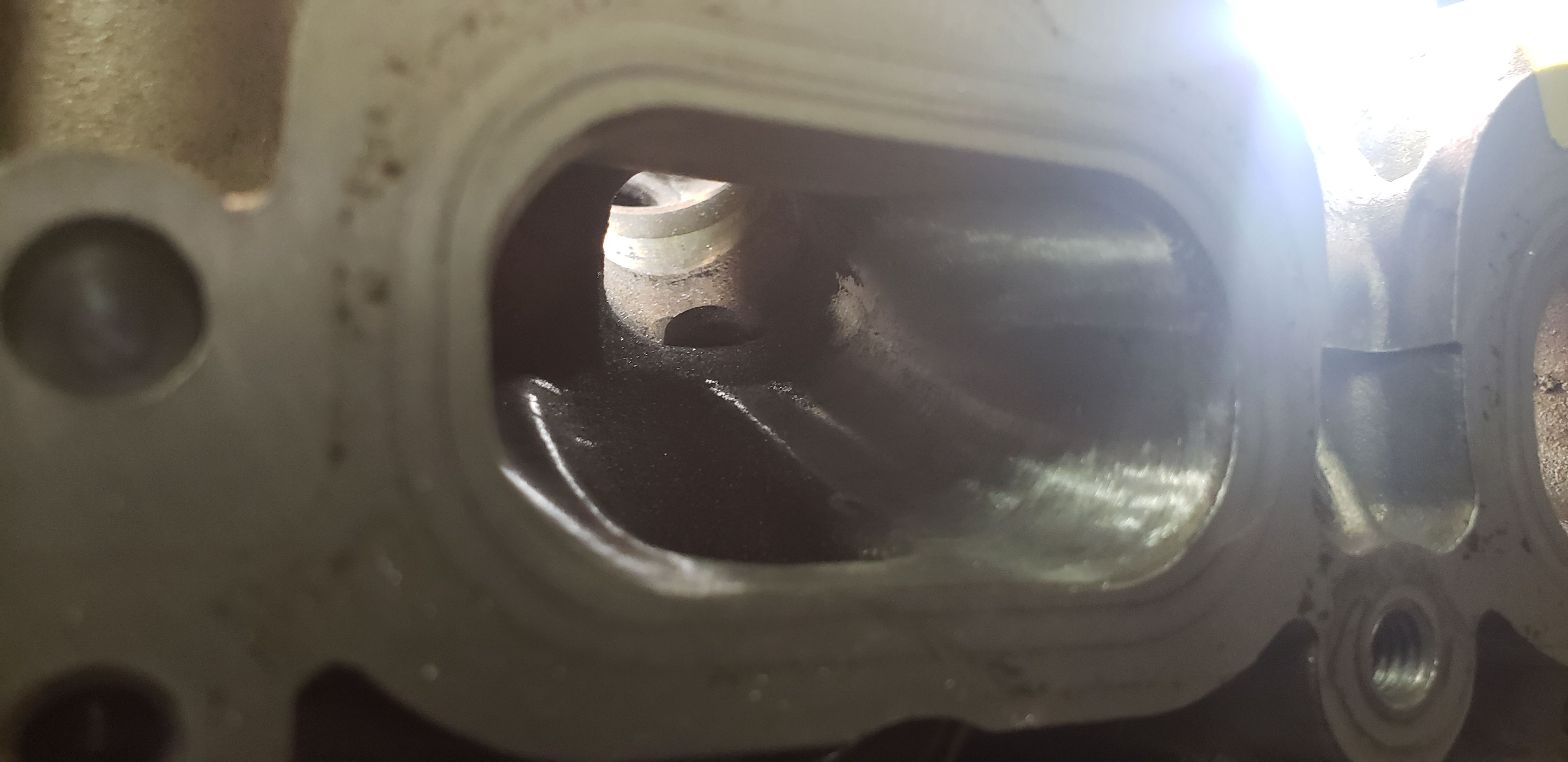

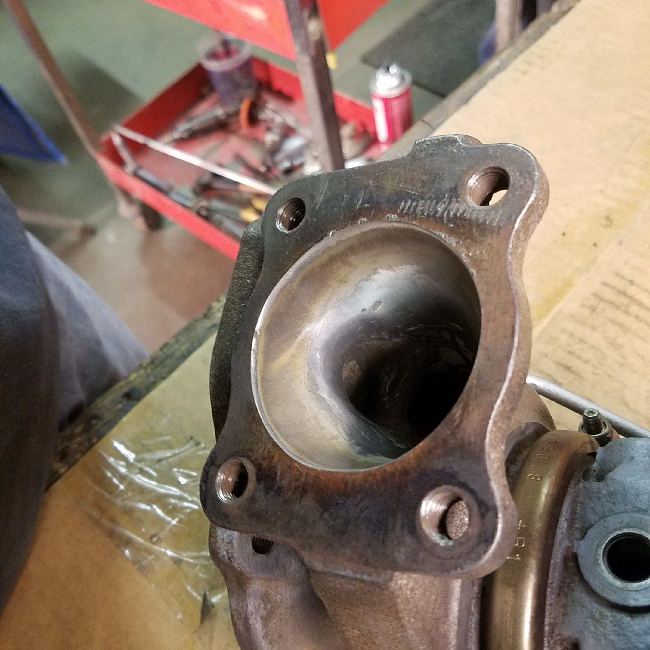

Getting a 7cm evoIII 16g exhaust housing ready for use. Started off with the internal gate so porting the WG passage to help combat creep.

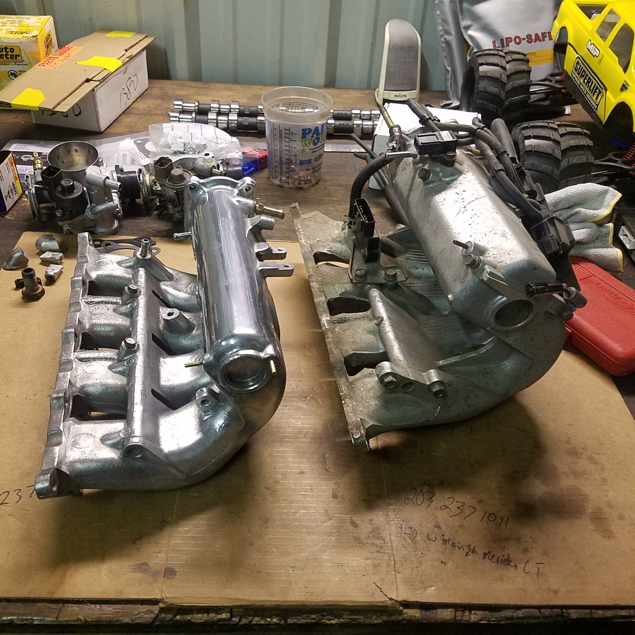

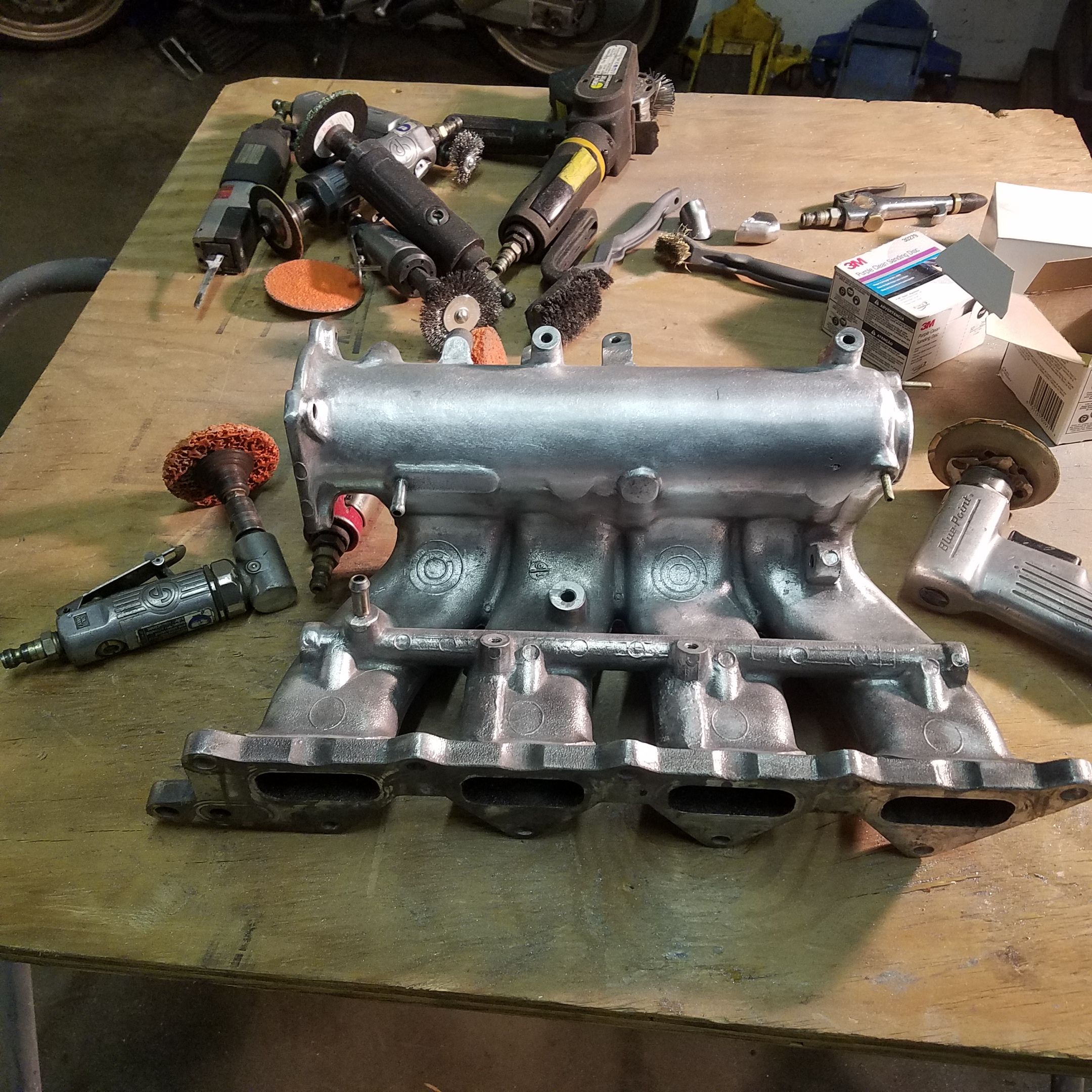

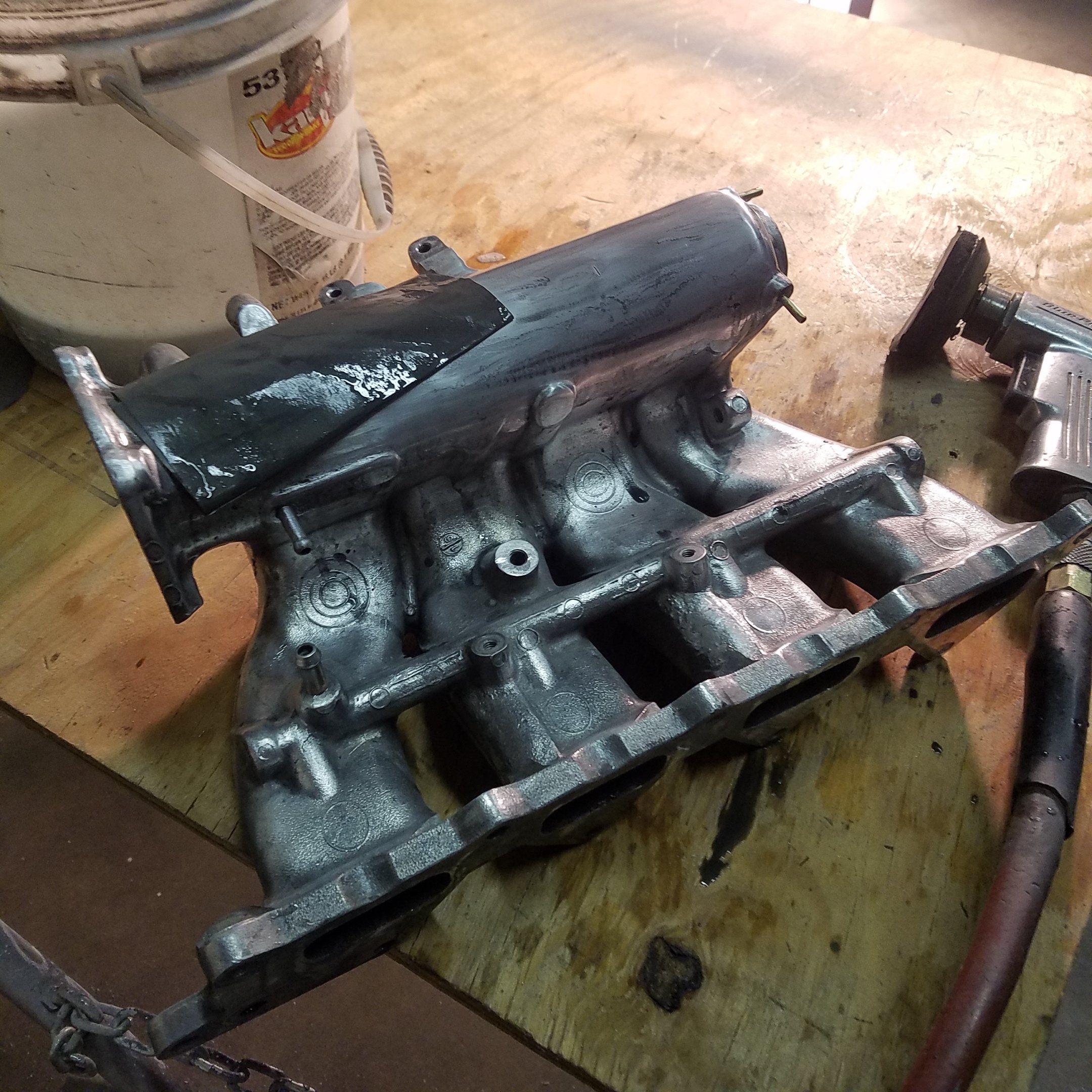

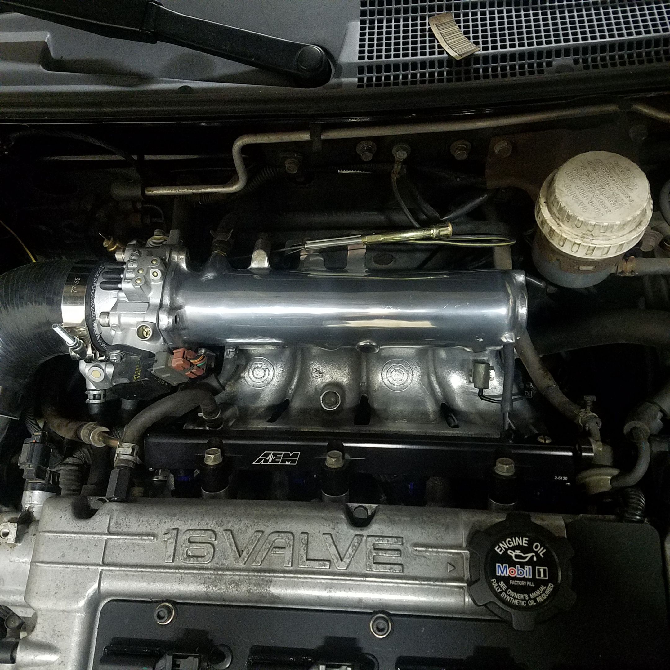

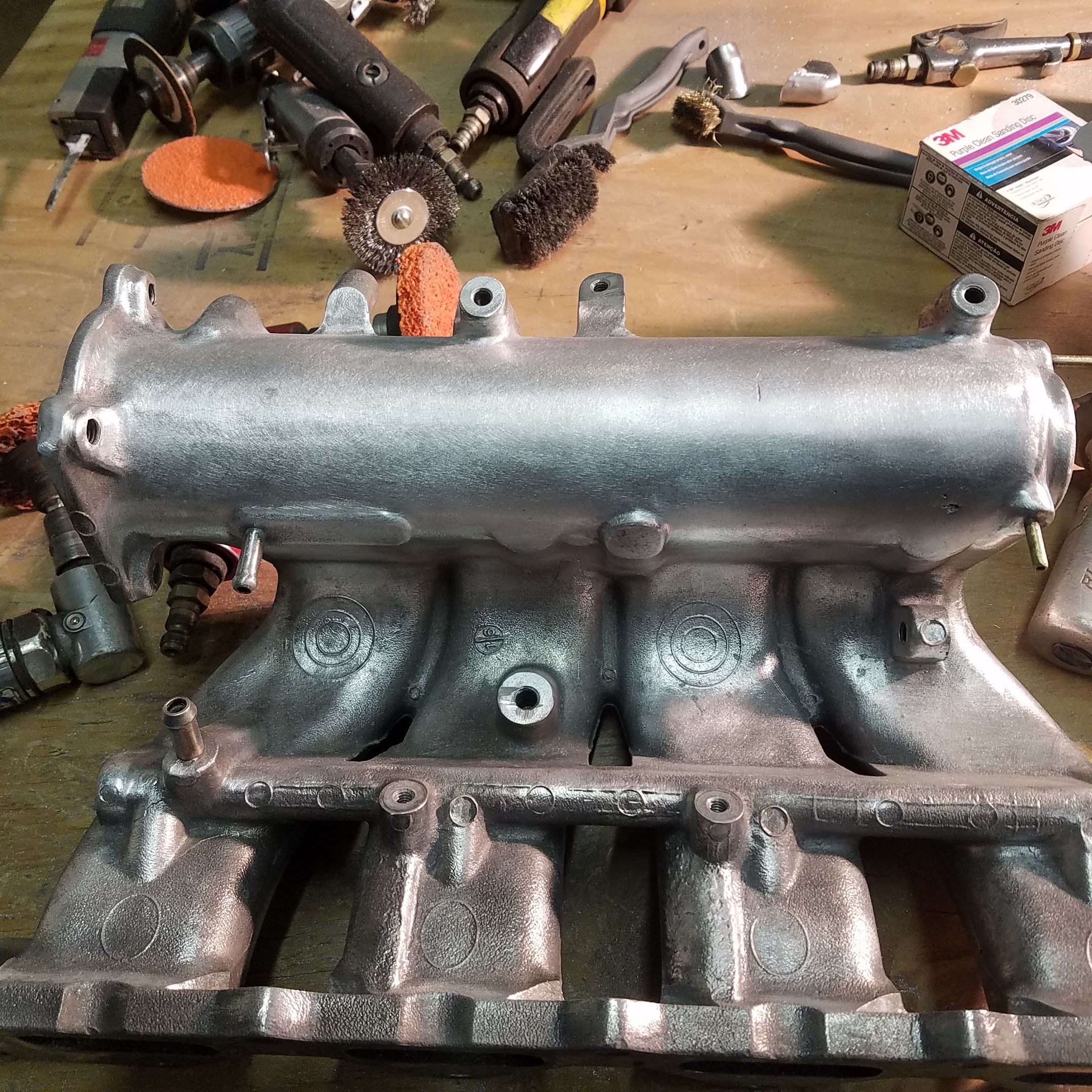

Going with and EvoIII Intake manifold
I cut off the mounting lugs for the coil pack bracket in addition to a few other things for a cleaner appearance.
Wetsanding, almost ready to start the polish

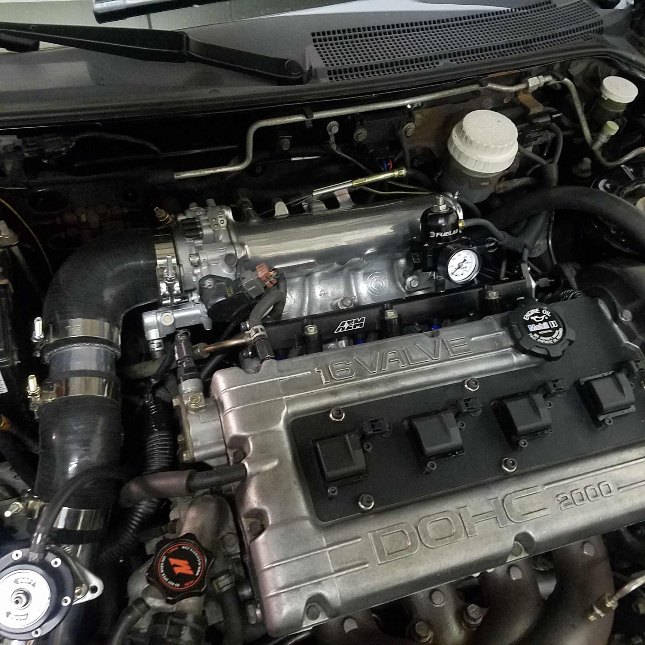

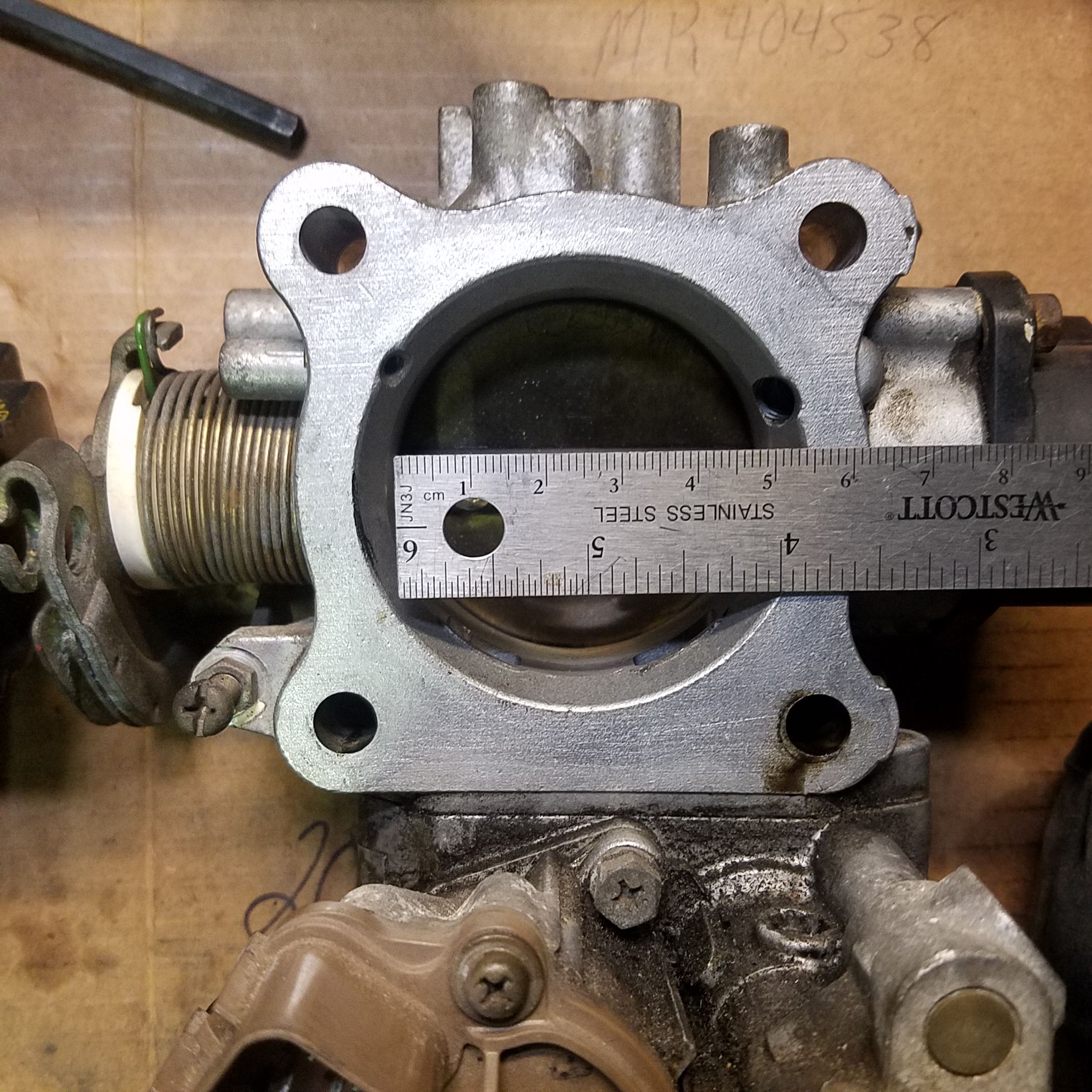

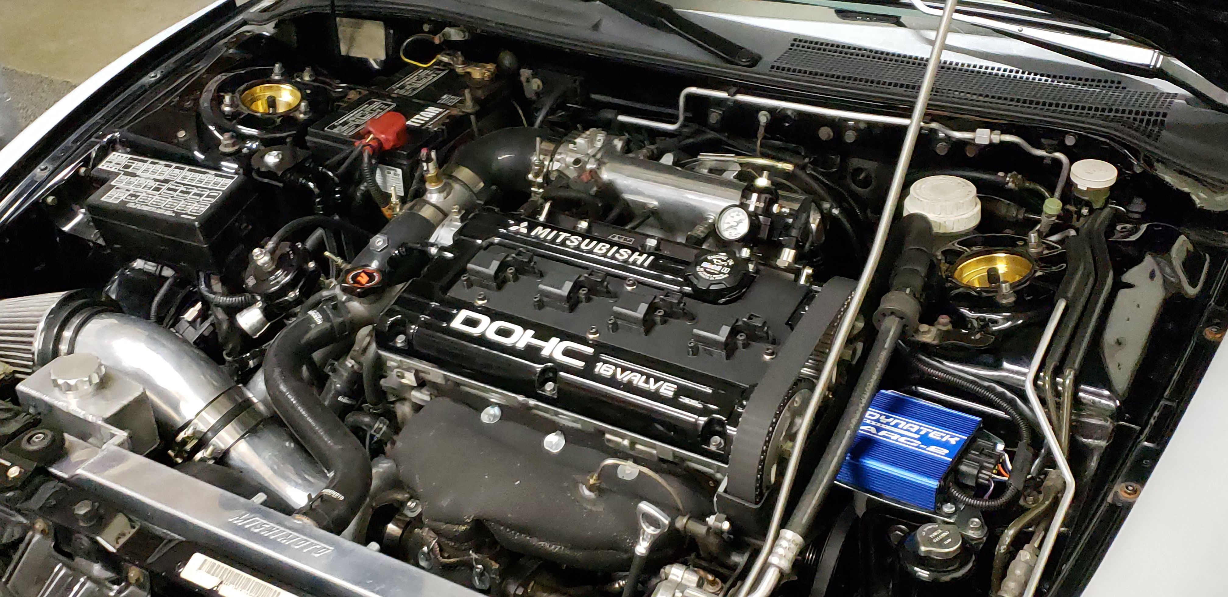

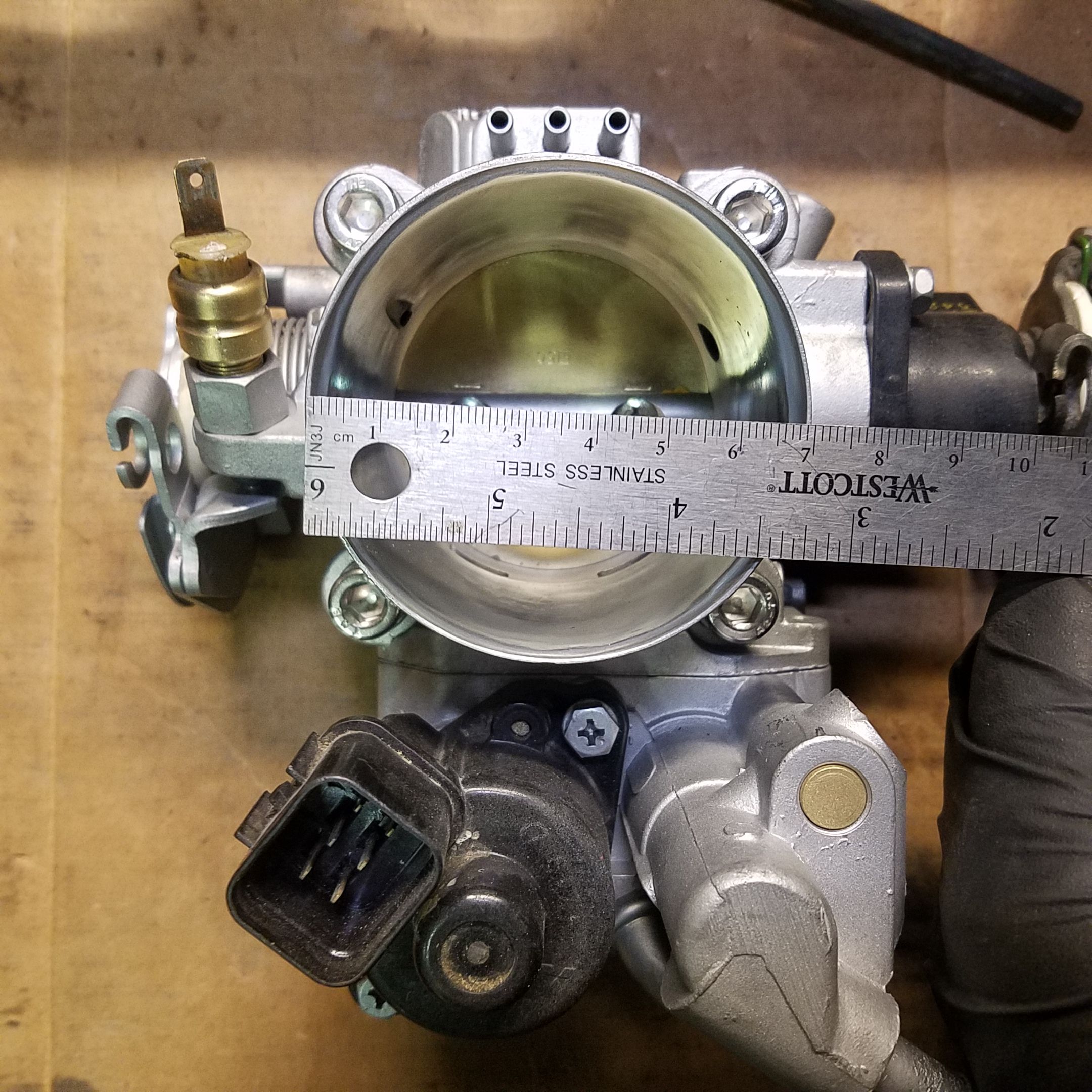

Went with a 1g NA throttle body. Sent it to throttlebodies.com for a rebuild, taper and polish.

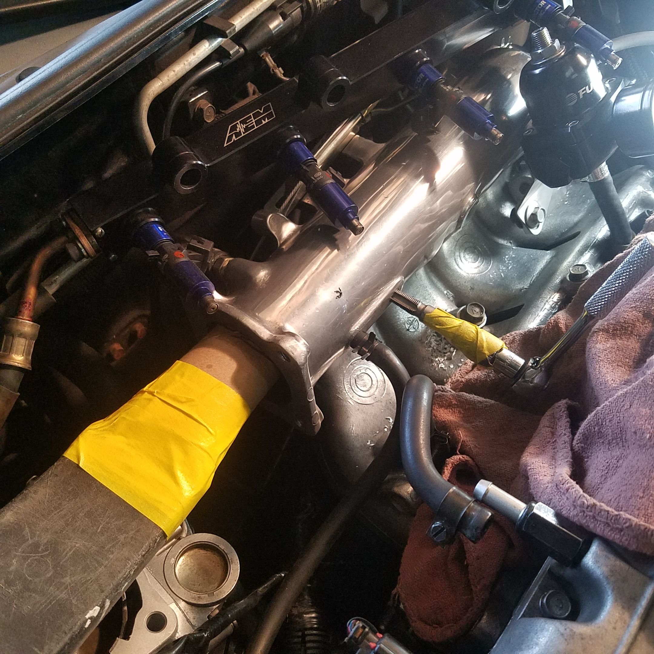

Evo II IM next to stock unit. All finished up ready to install.

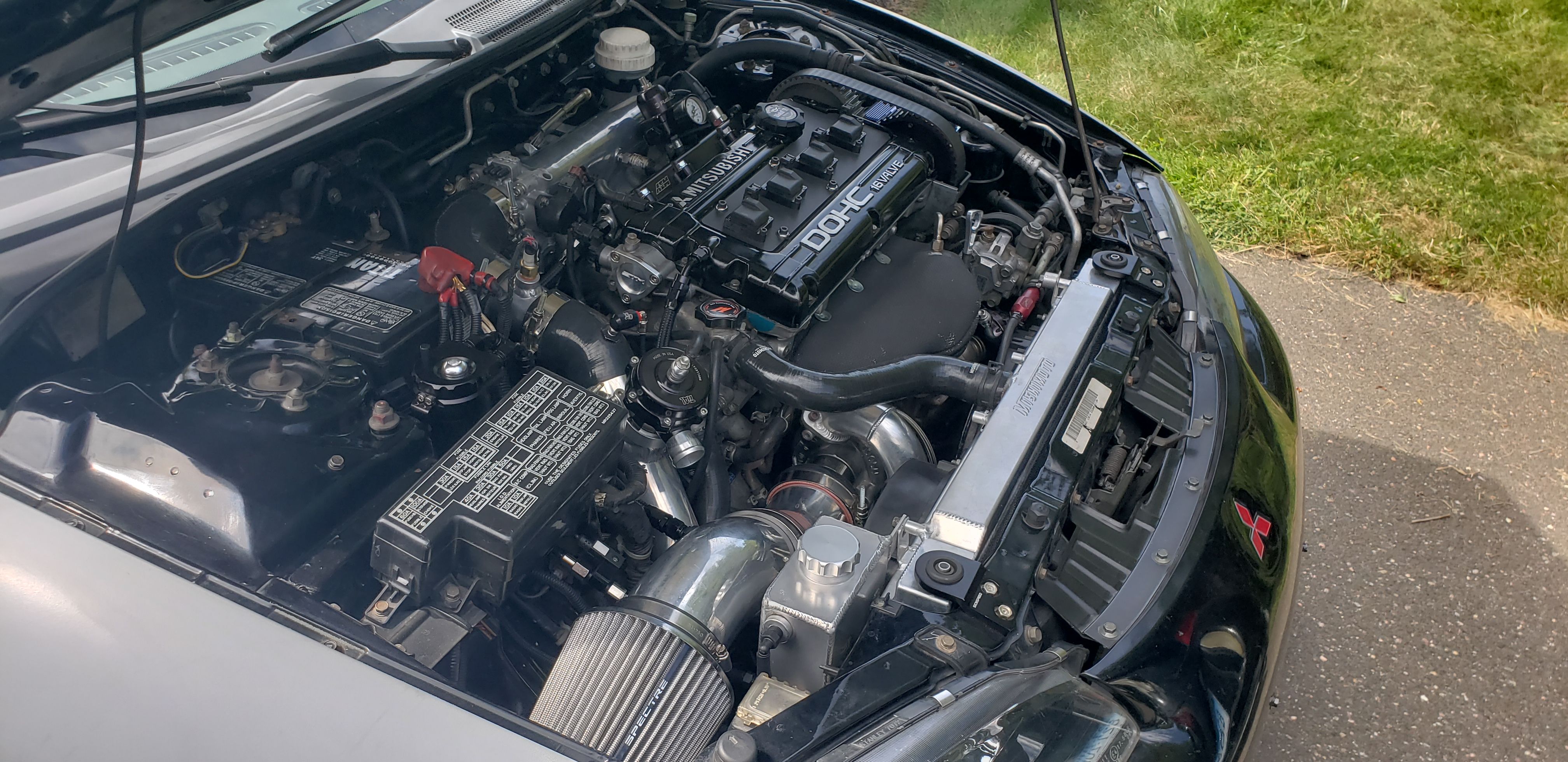

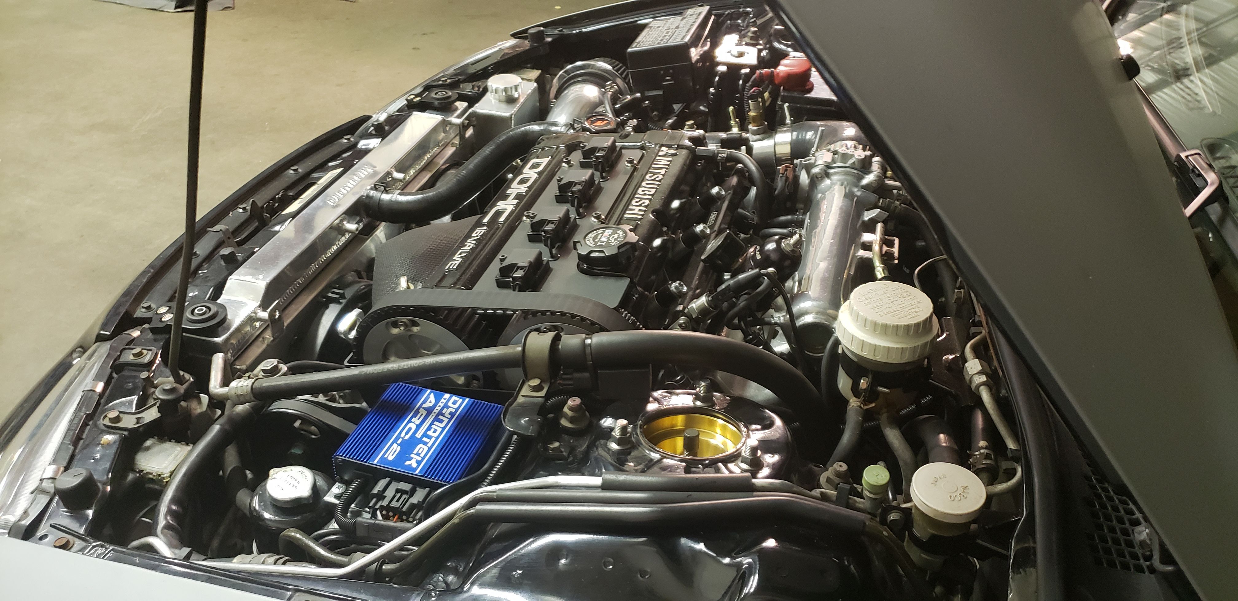

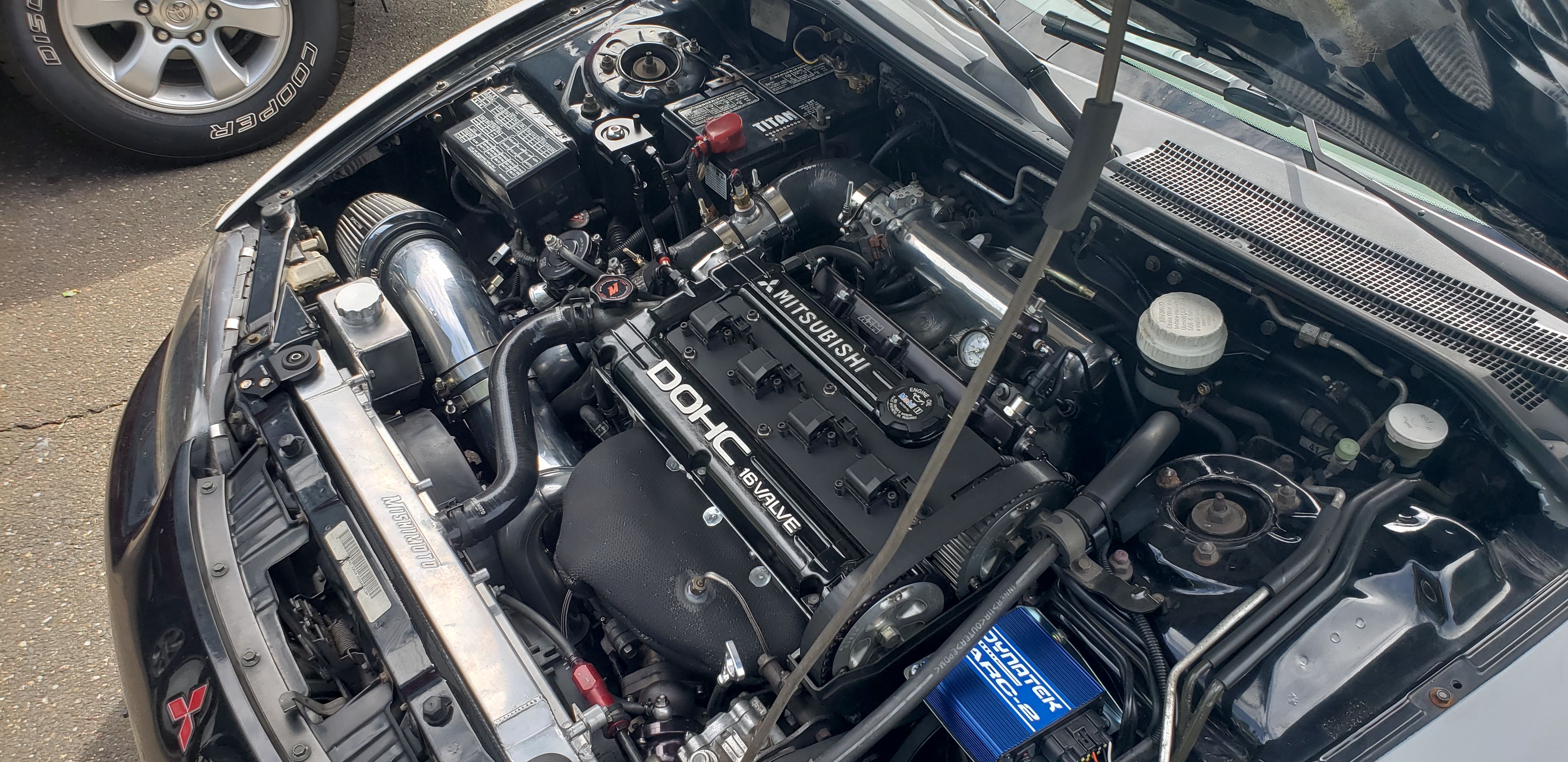

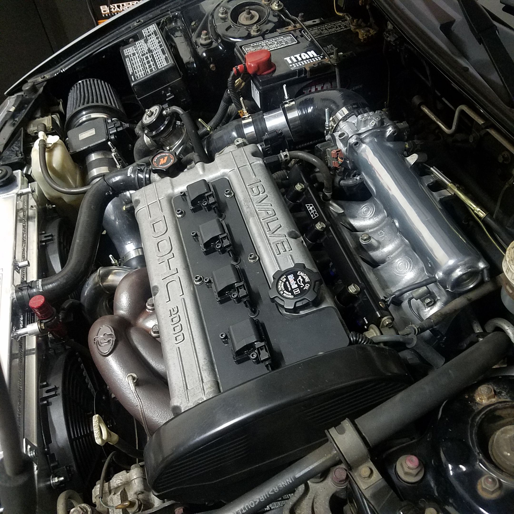

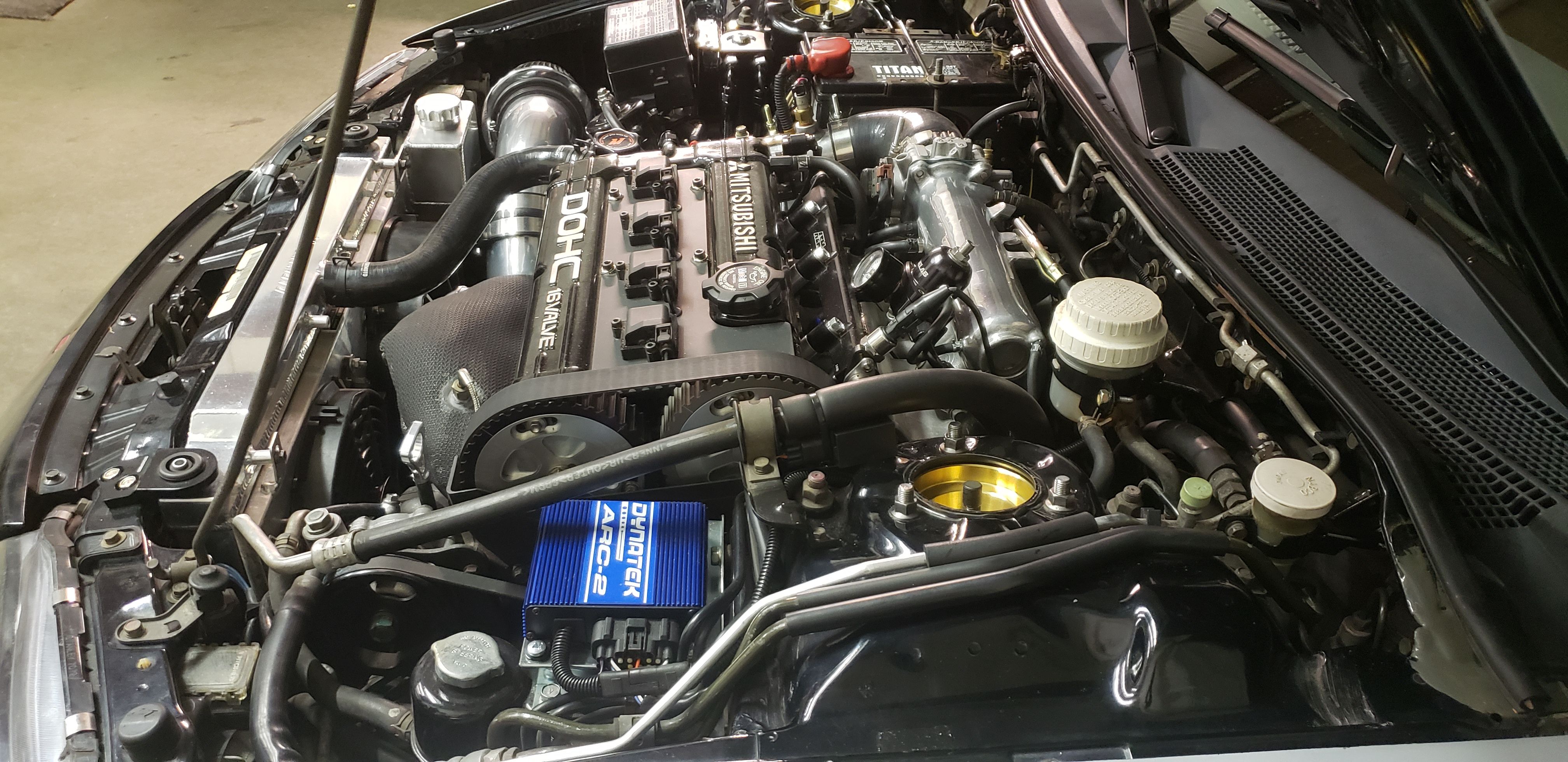

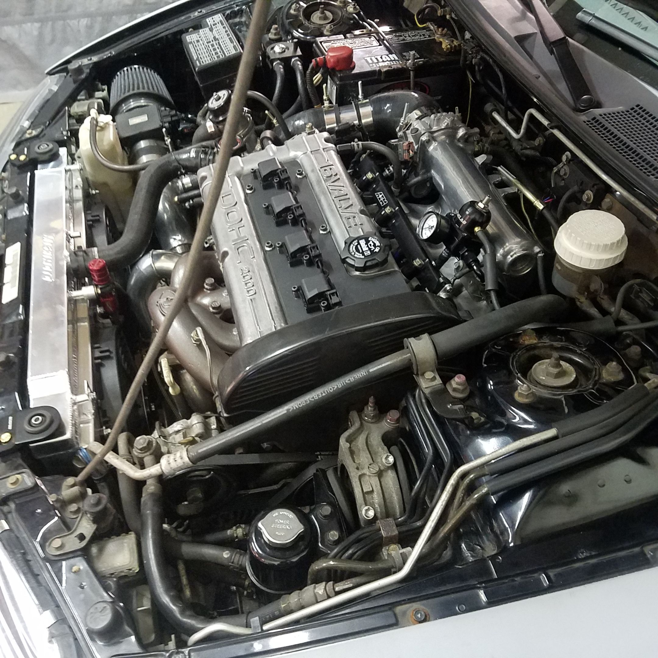

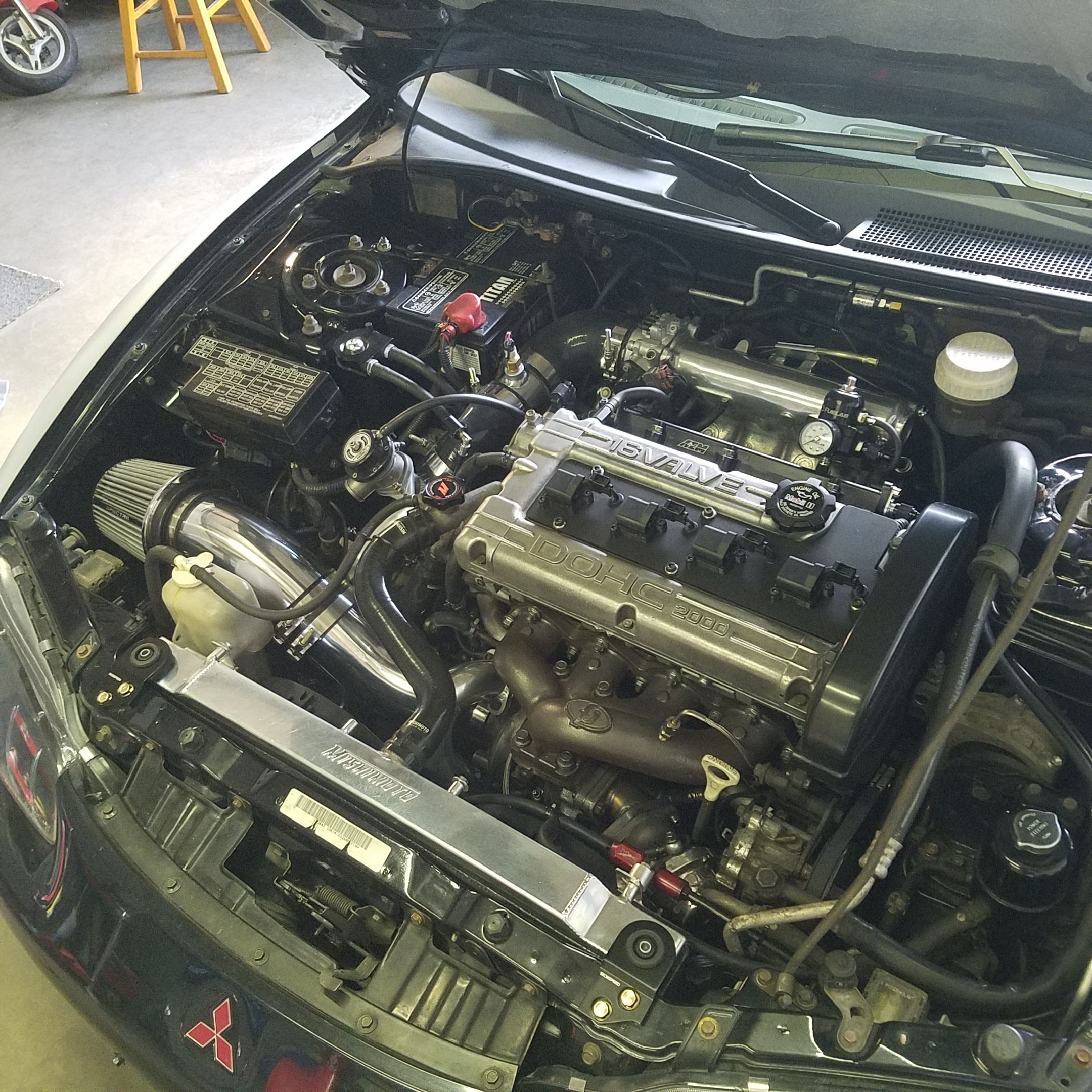

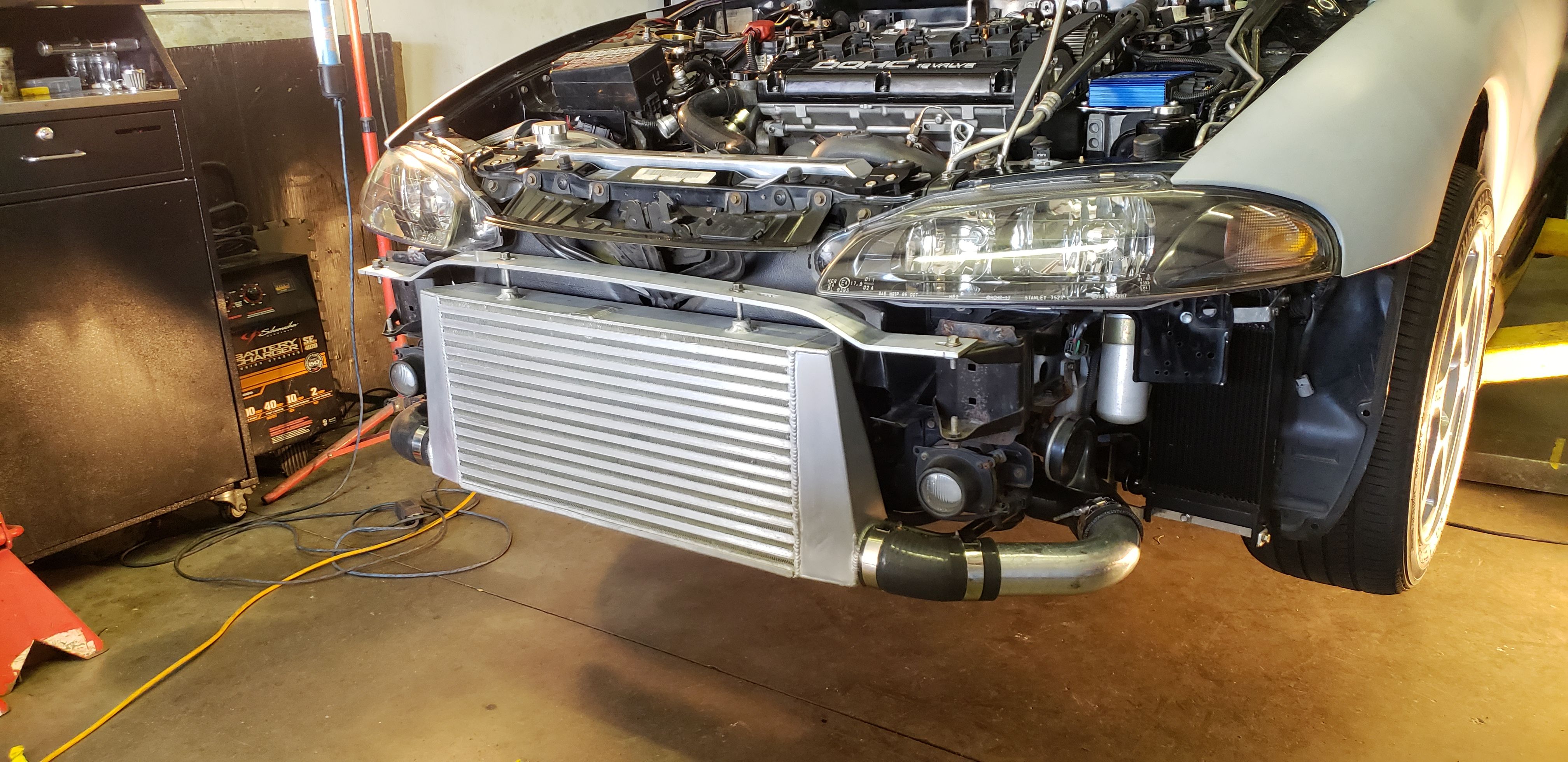

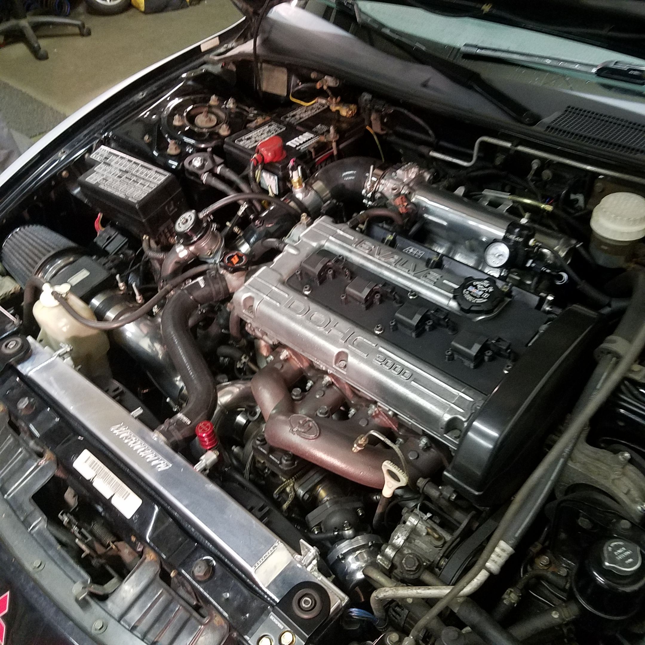

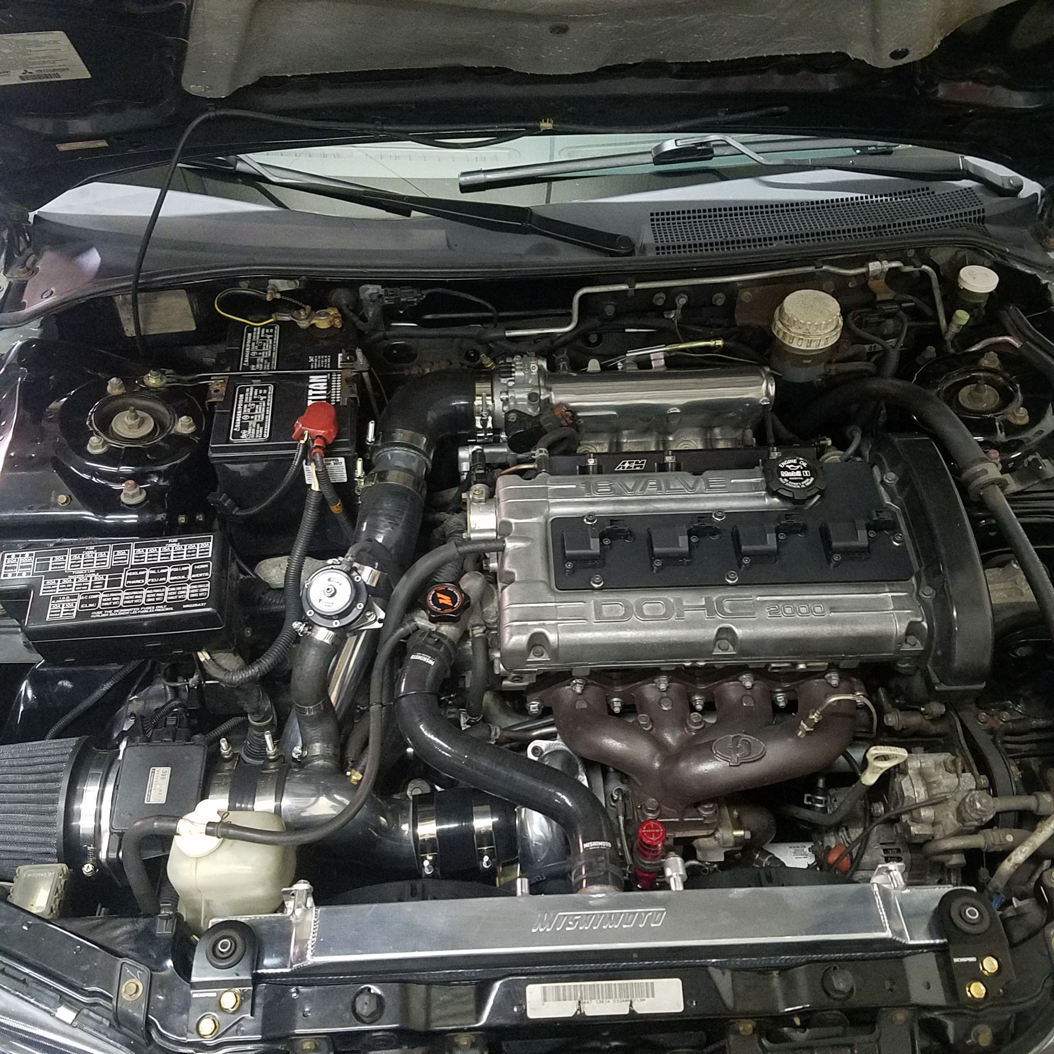

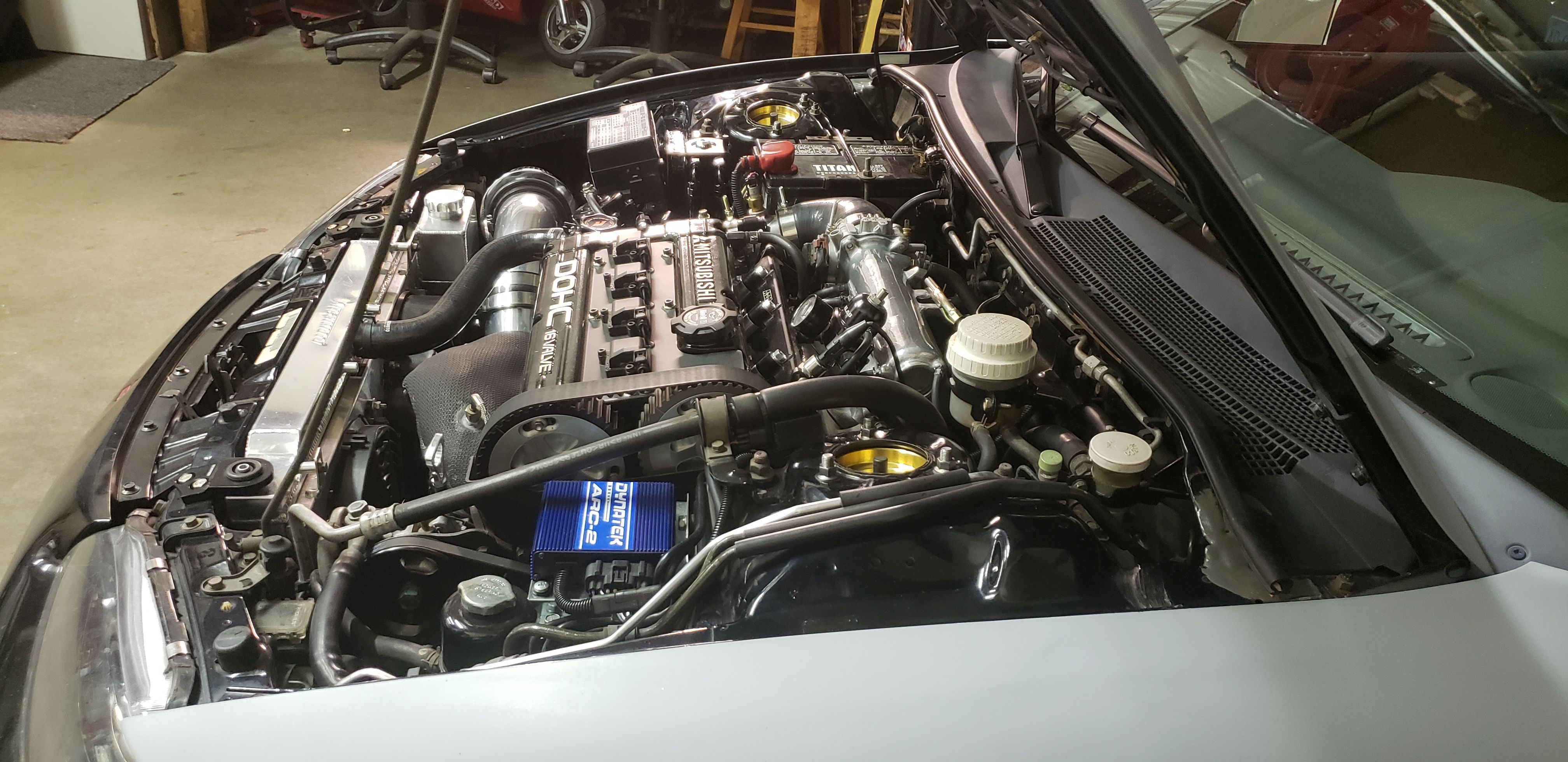

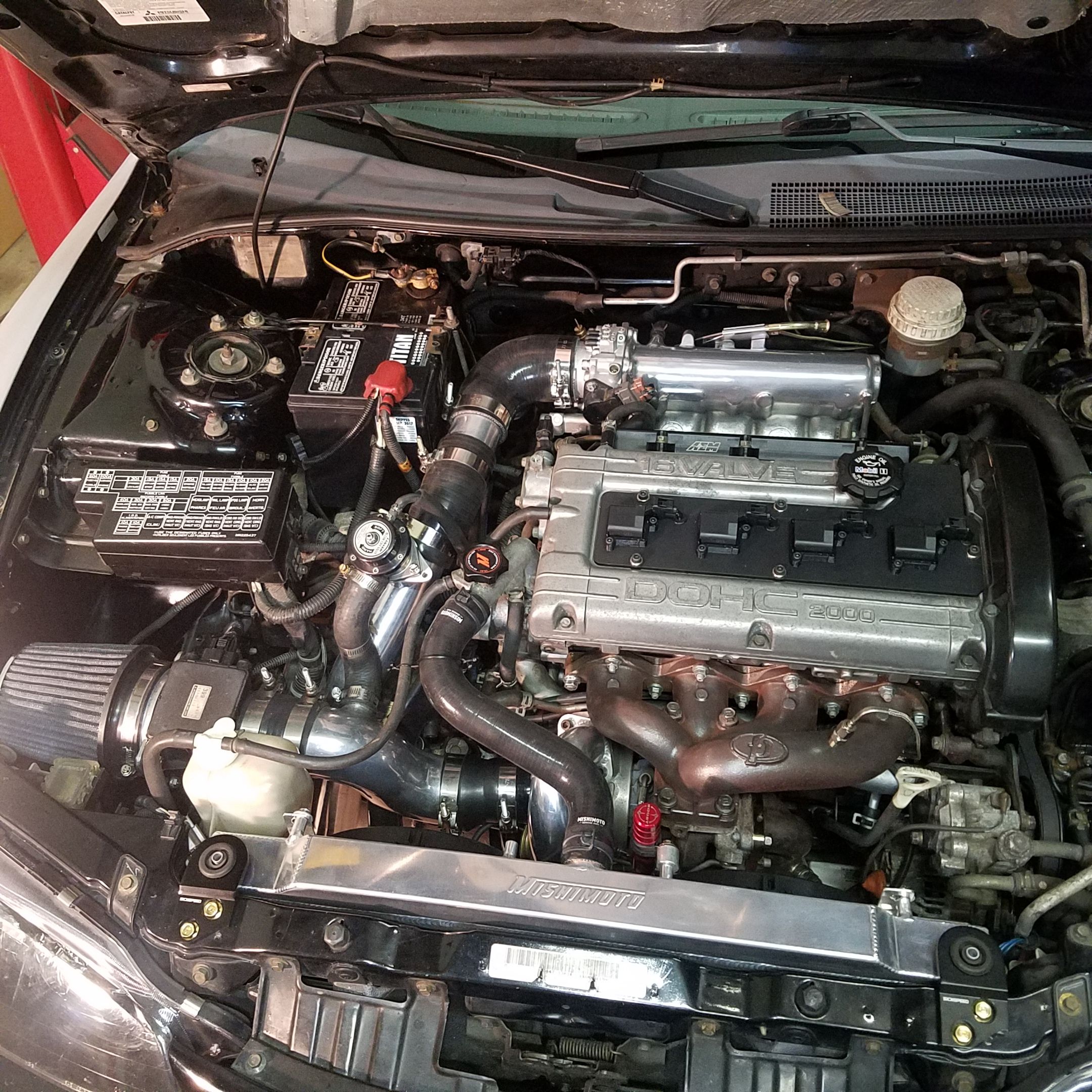

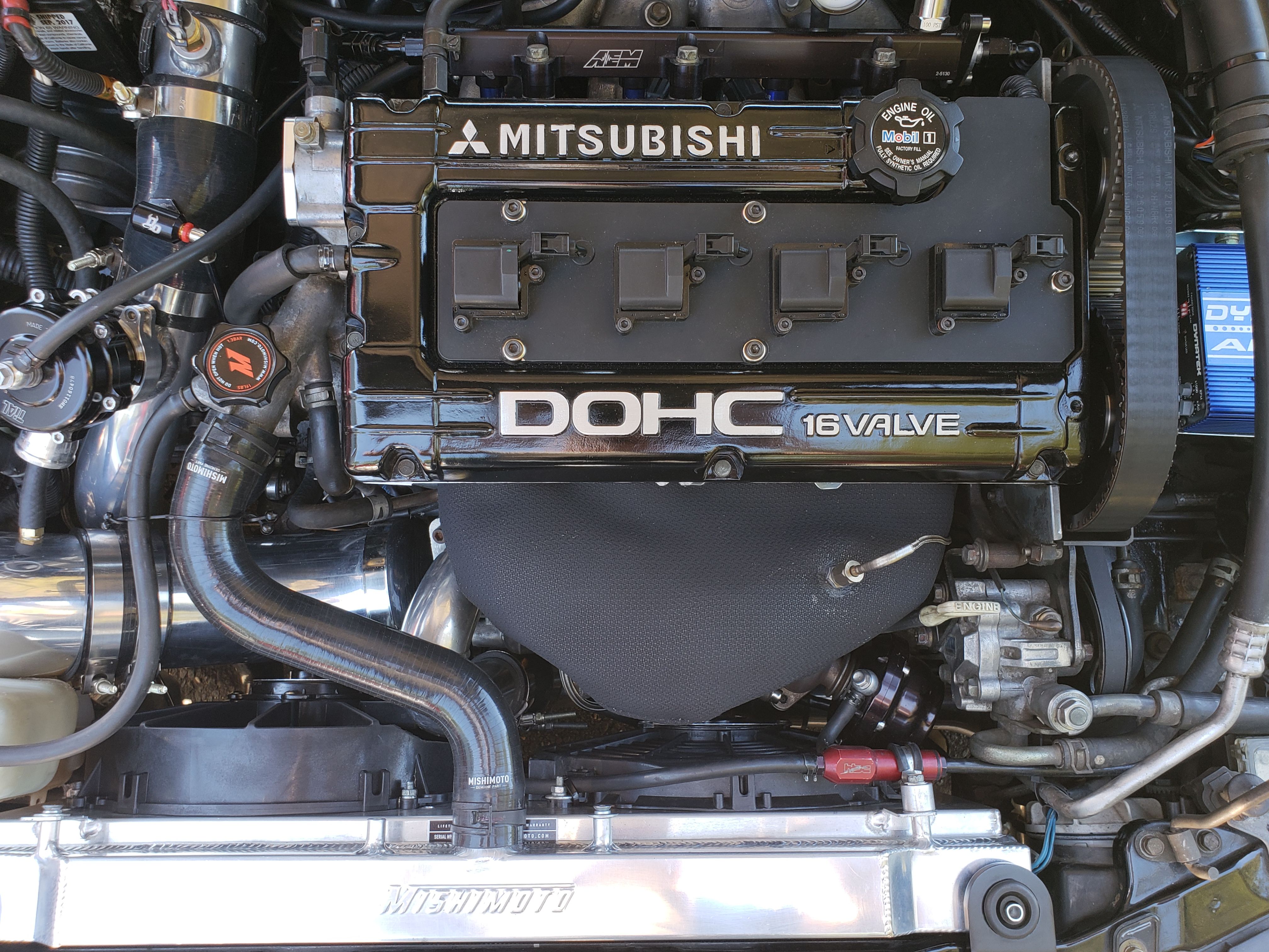

At this point, the quick and simple setup was coming together really nice. Started off with the evoIII 16g. I was really happy with the way the IM turned out too. I had also added ECMlink and a set of FIC 1200cc HiZ injectors, in addition to all other supporting mods to run around 22 psi on pump gas.
Evo8 MAF here. Swapped to a new RAD too. Those slim fans did not work out. They just cannot flow enough to do the job.

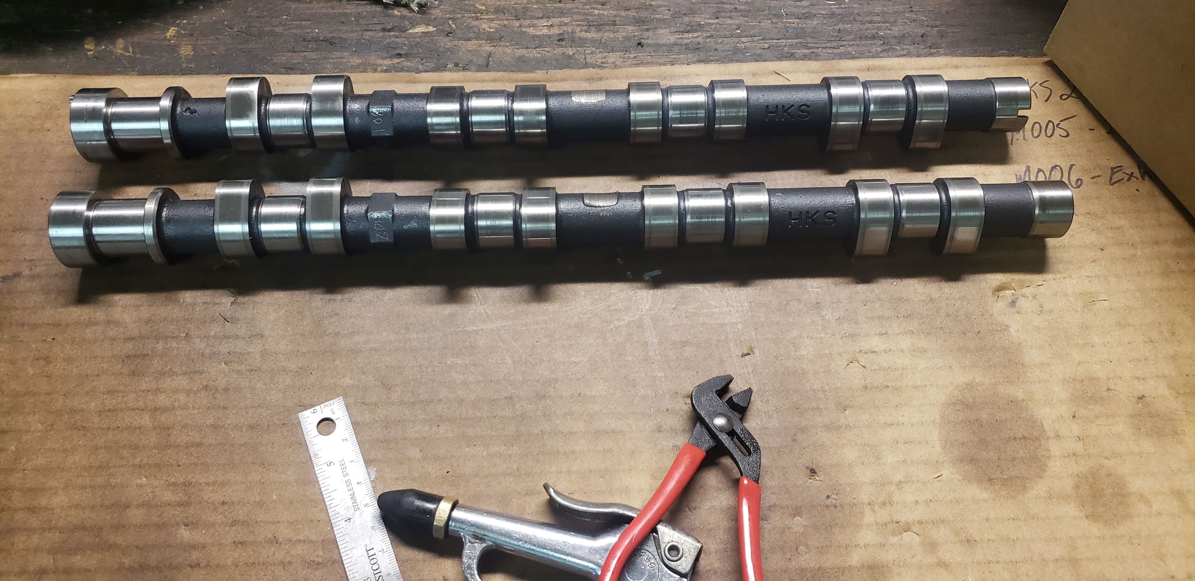

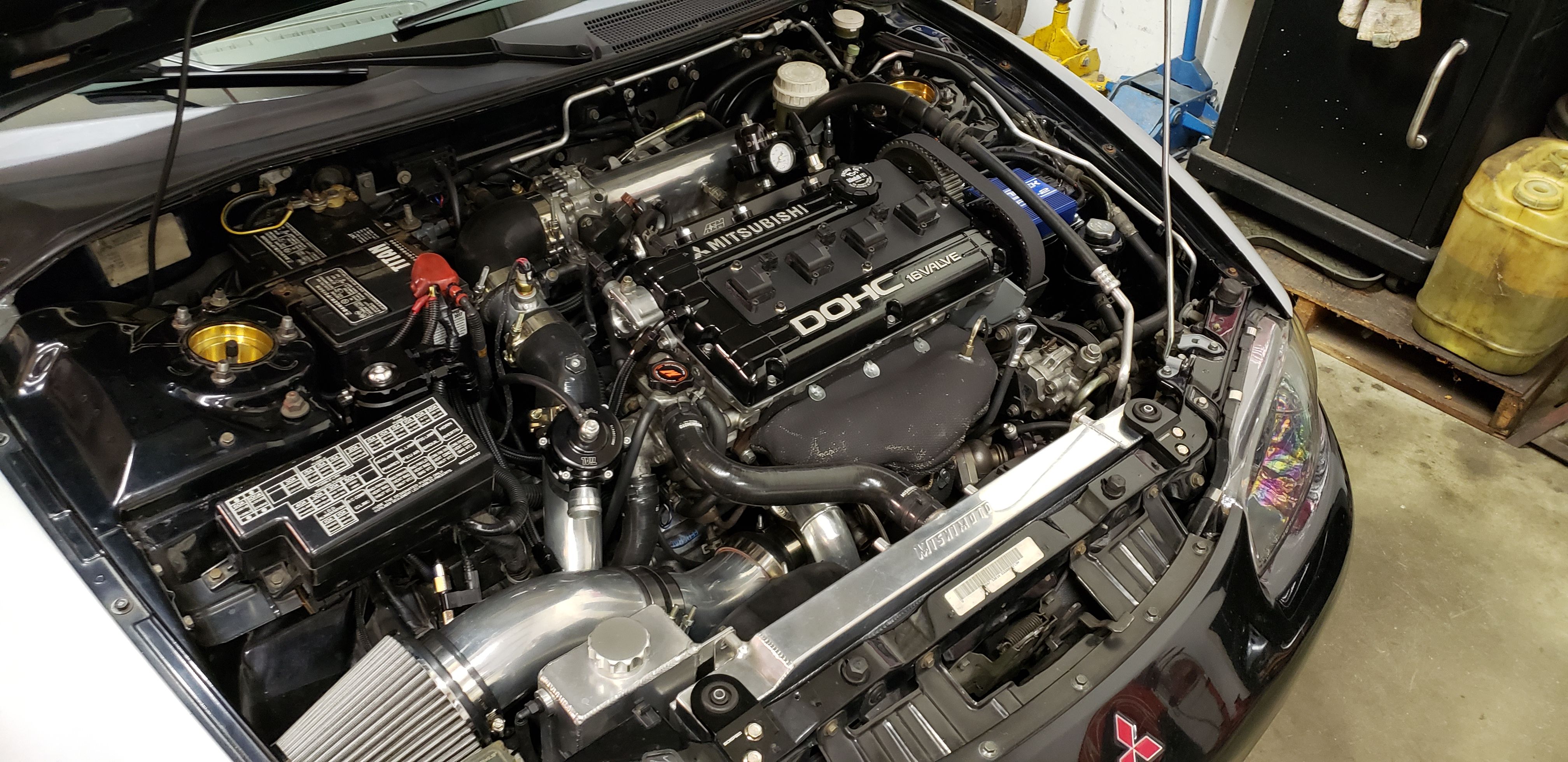

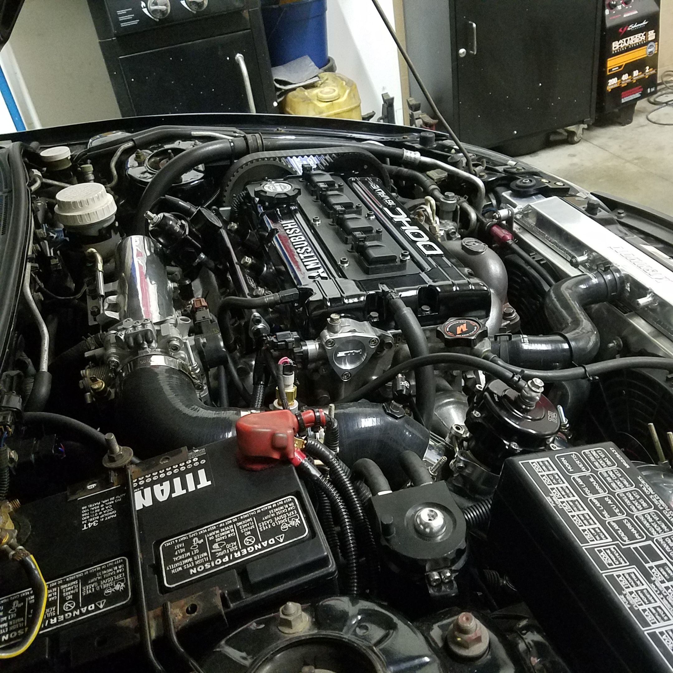

Adding a set of HKS 264s to the setup

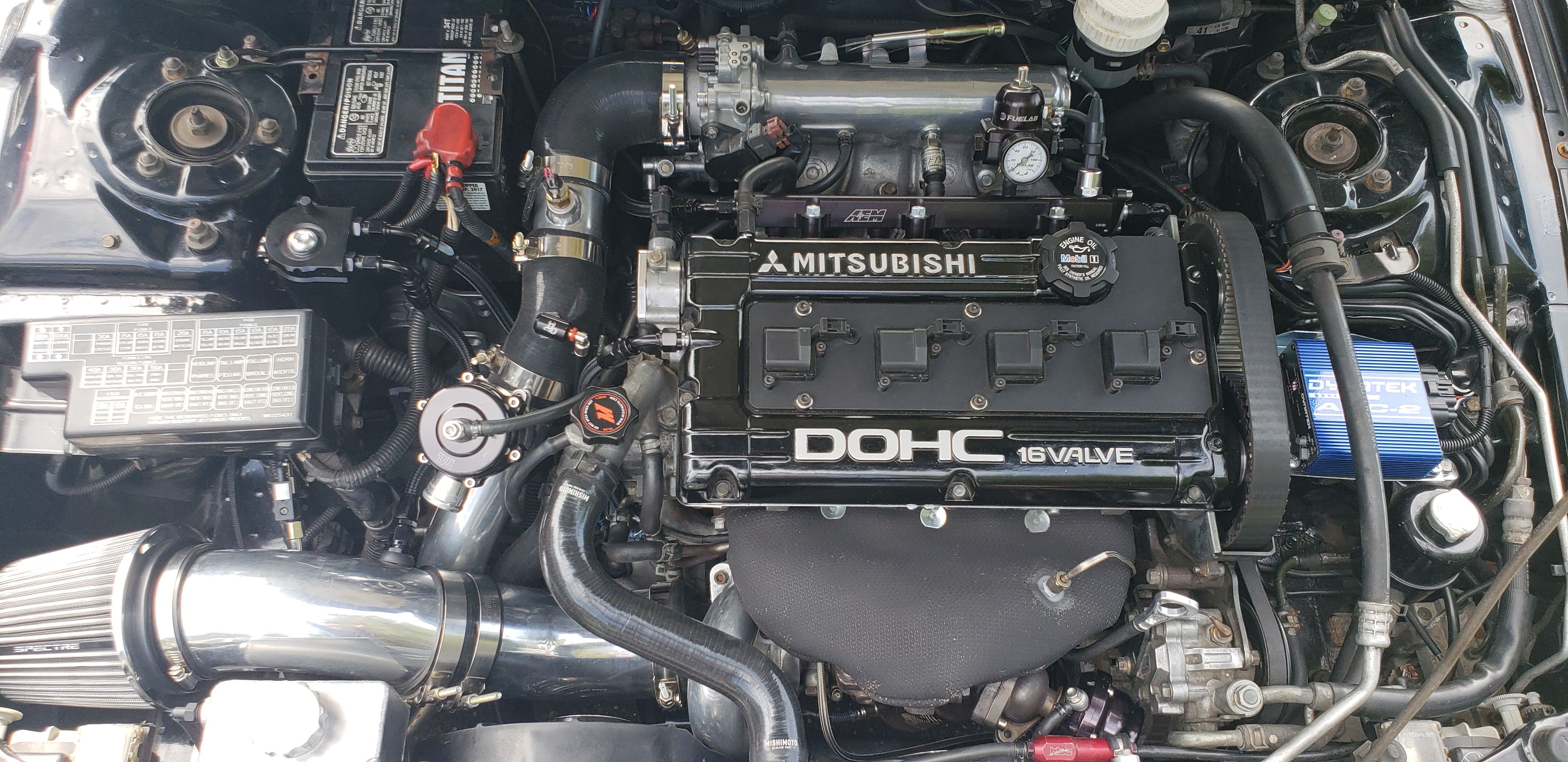

I really enjoyed the way the car performed at this stage in its build. I had it tuned pretty well around the way the WG would blow open and the spike in boost was a blast as it was accounted for and settled in really nice at 22psi later in the pull. Might sound crazy but I felt like I had lost some of the fun when i switched from the internal gate to an external gate. I missed that spike.

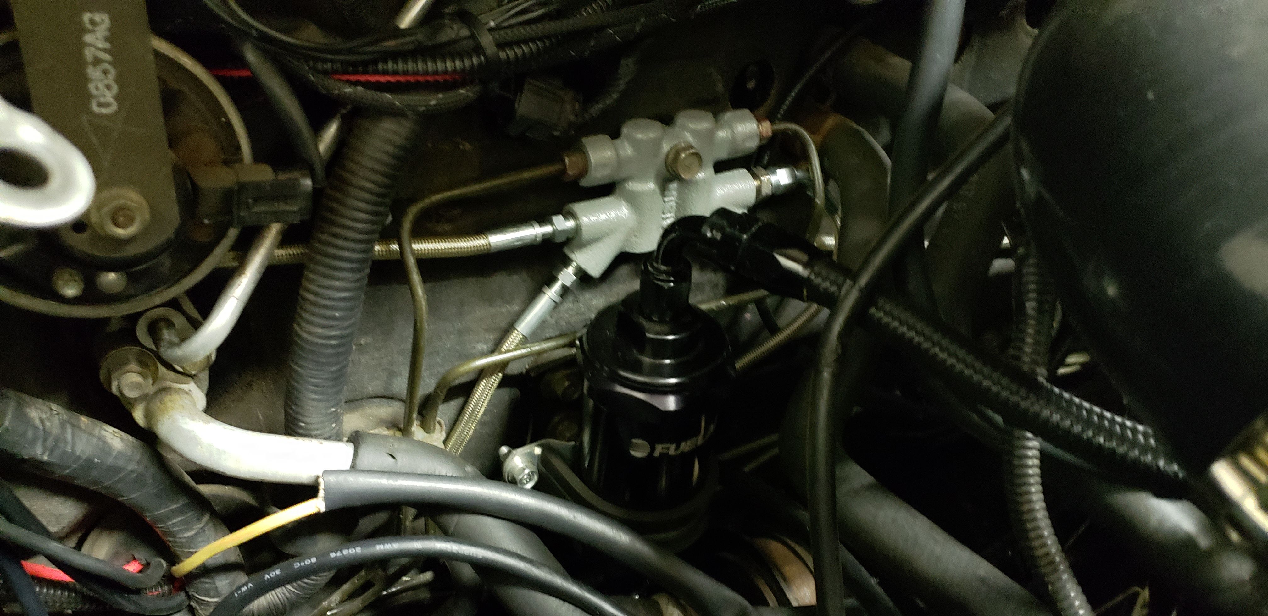

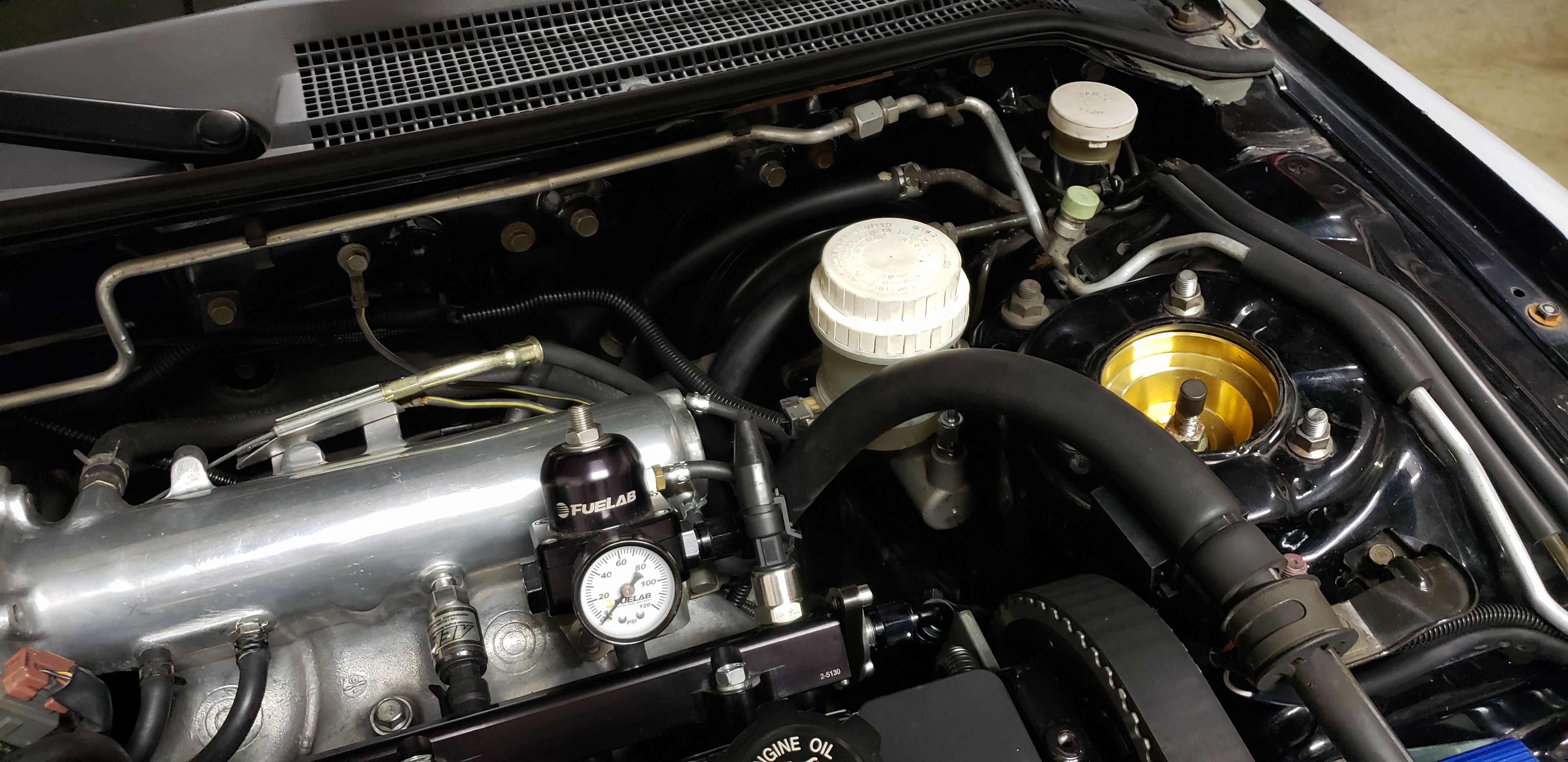

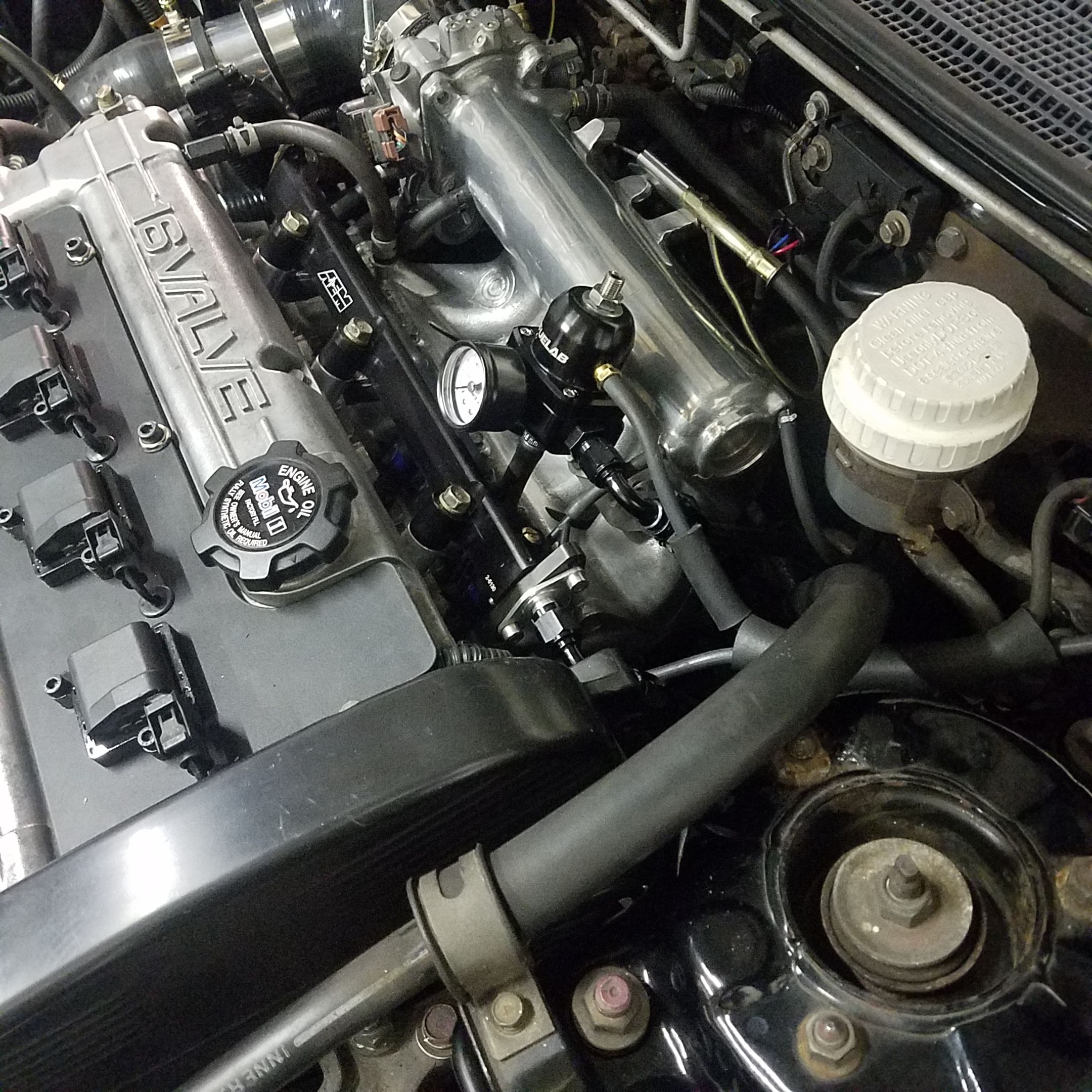

Added a Fuel Lab AFPR. Made a bracket to mount it to one of the threaded locations that I did decide to leave on the evoIII manifold.

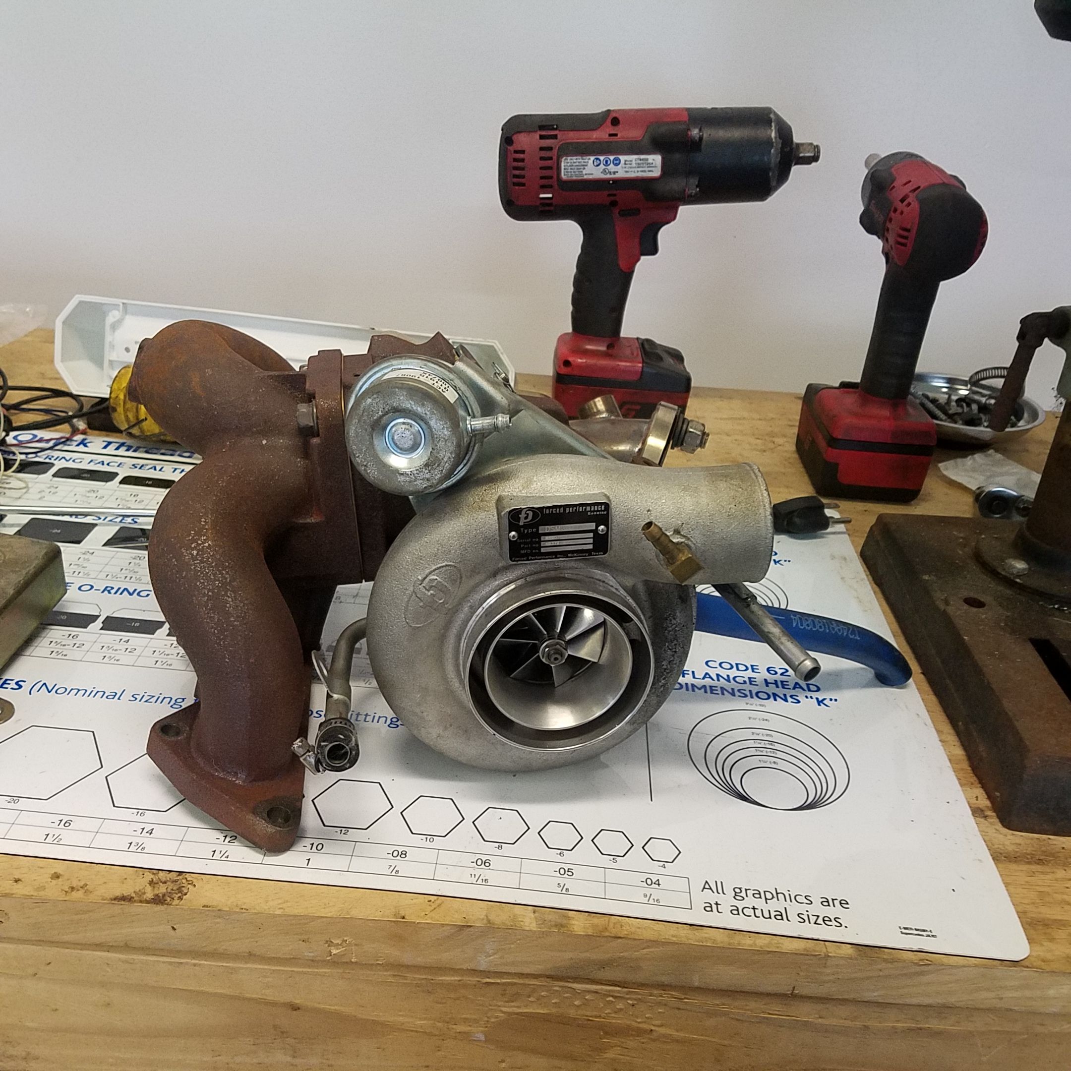

Decided to give the HTA68 a spin.

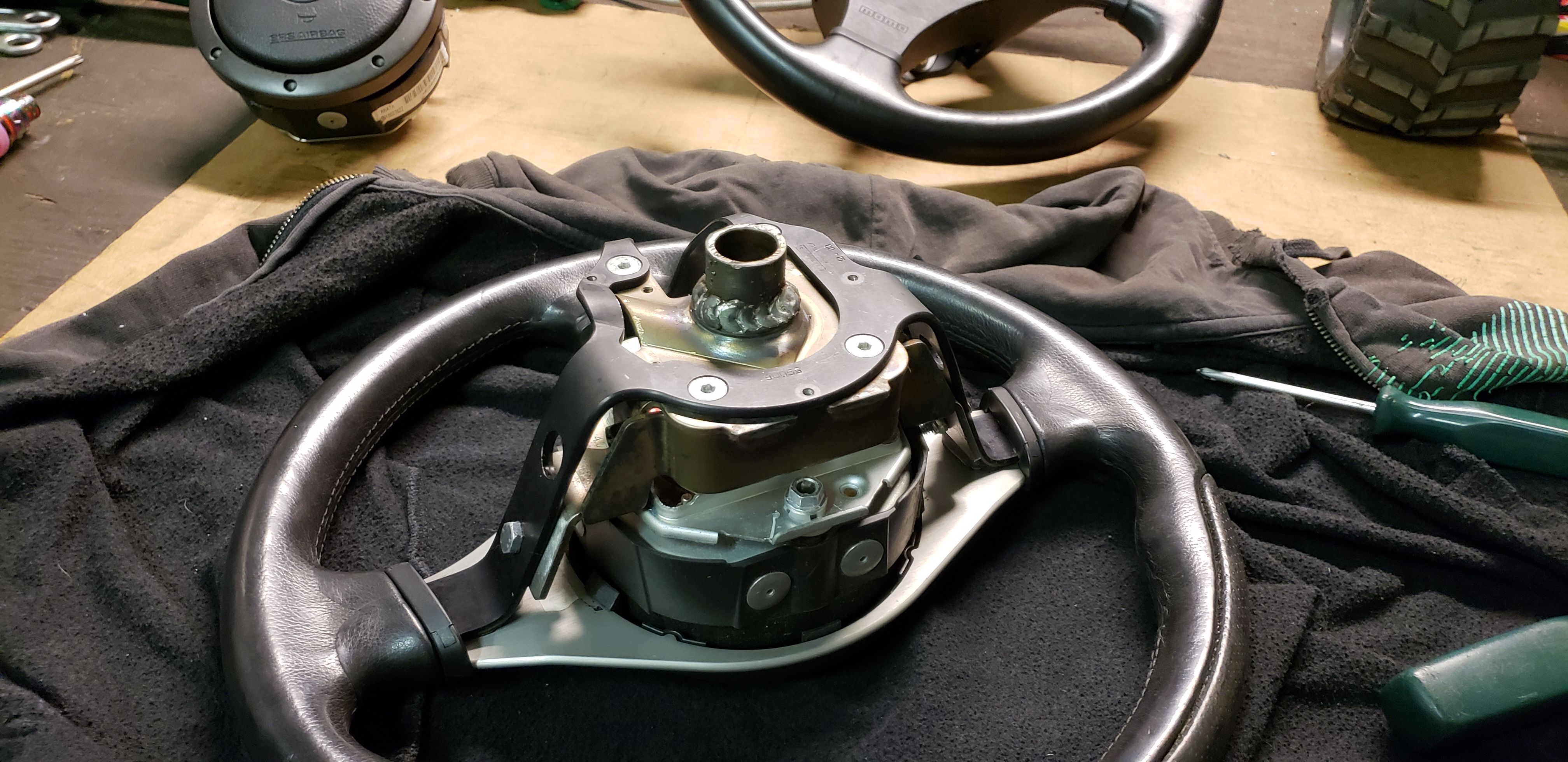

Now with an Evo8 steering wheel. This wheel is a major improvement to the look and feel.

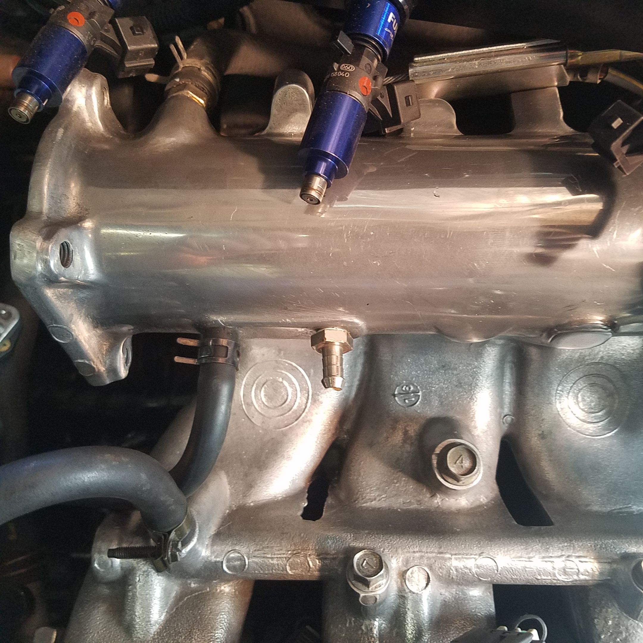

needed an additional tap to the IM
fast,simple

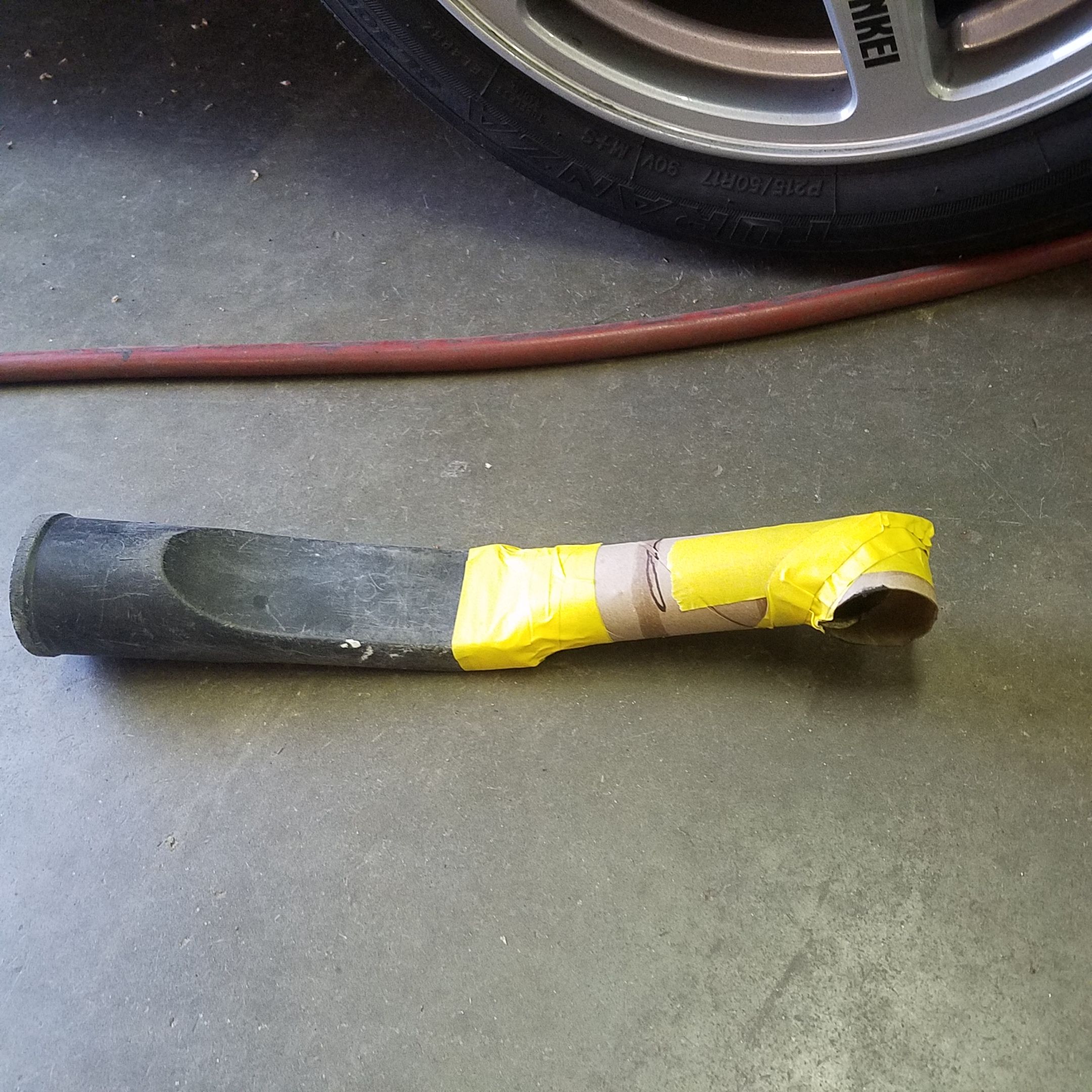

this is the shop vac attachment I made to suck up any shavings as they where created. You can see it in action above.

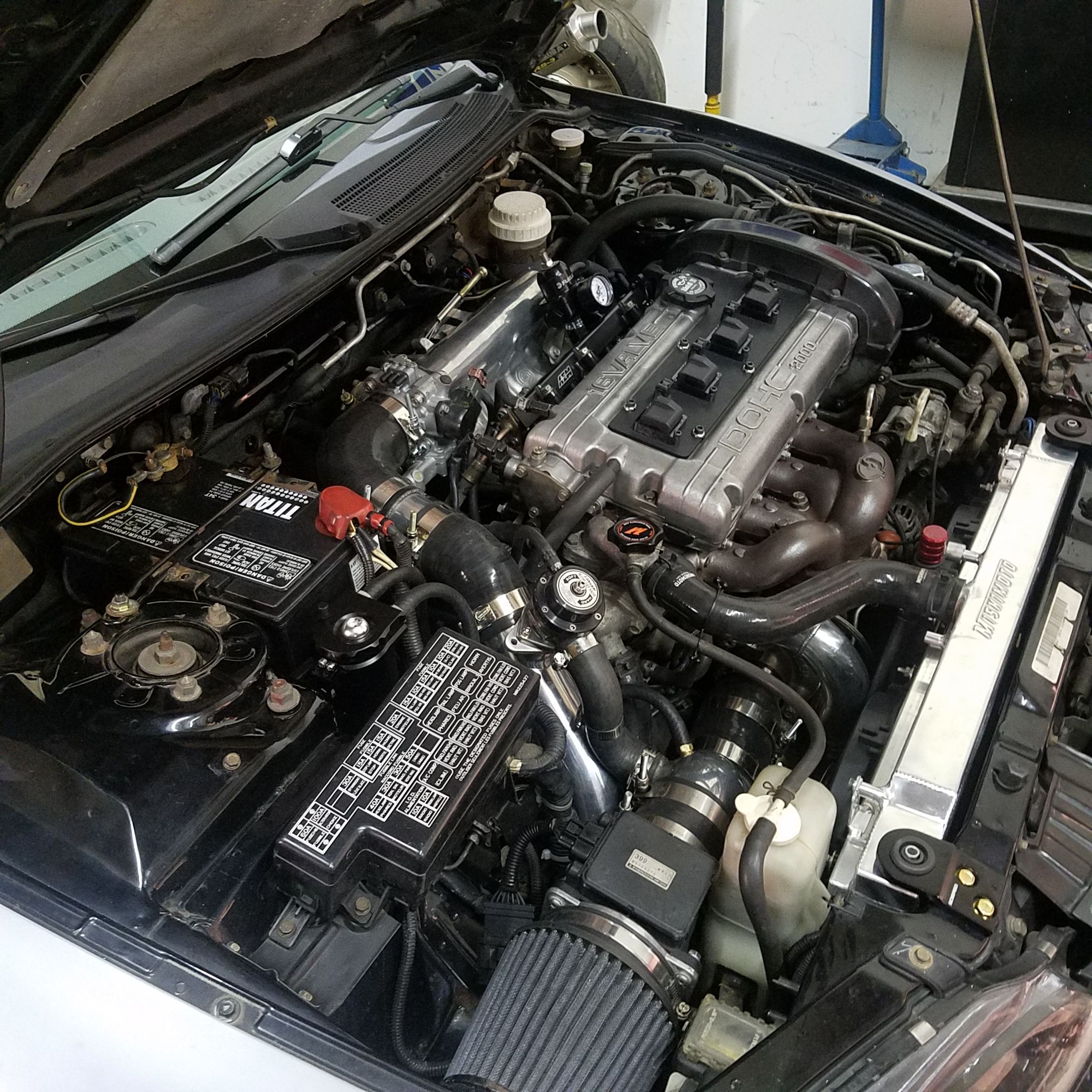

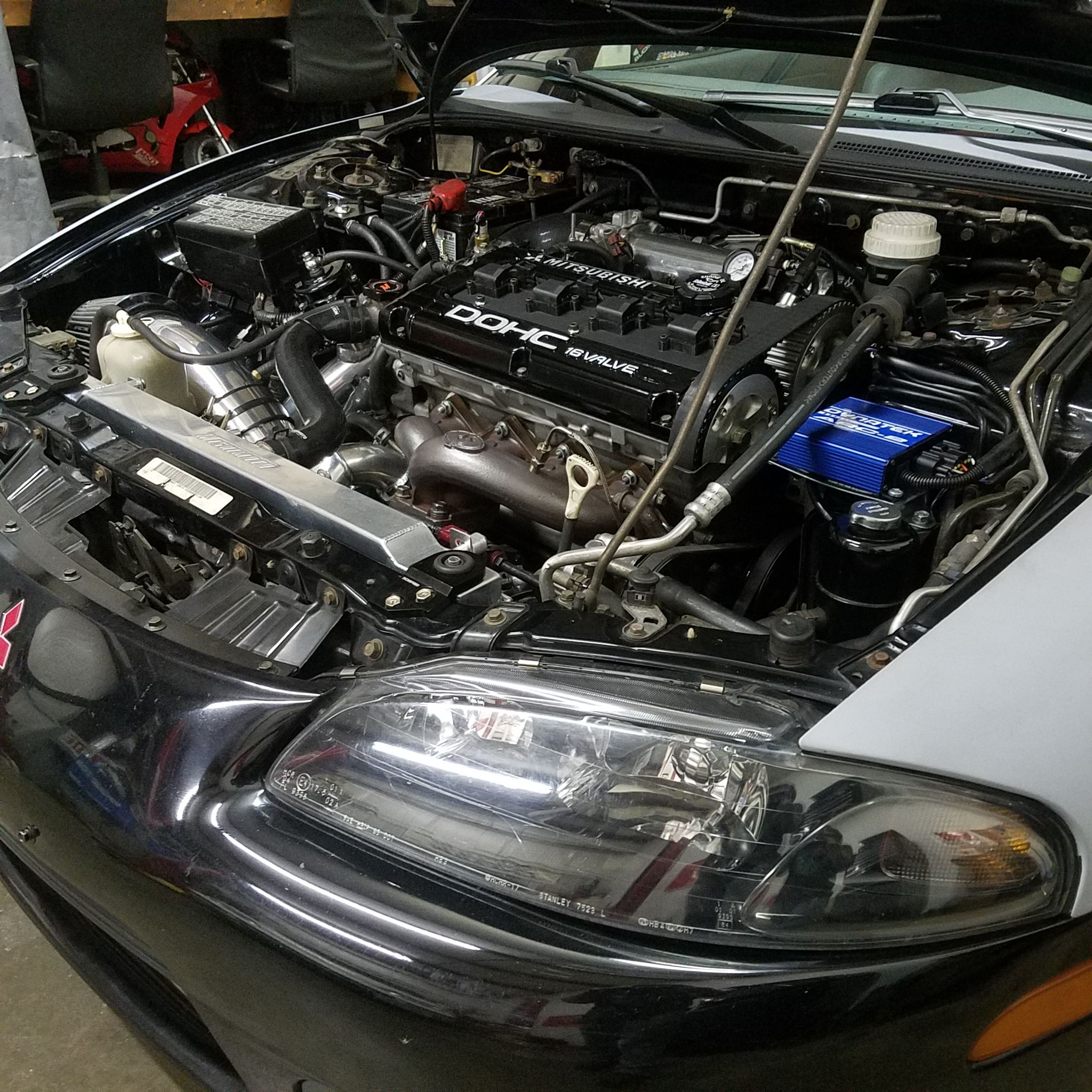

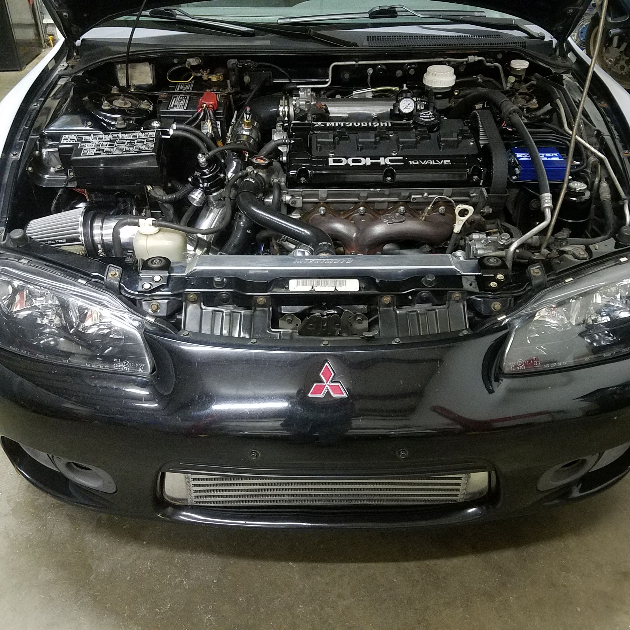

Made up a 4'' pre turbo setup. No more MAF. Decided to try out SD. Never did switch back.
Switched from an old school official Greddy Type S to a newer TIAL BOV. Also picked up a Mitsu labeled valved cover and refinished it. Added a cheap sealed catch can between the valve cover and the preturbo pipe too.
I switched back to the EVO III 16g. There was a couple reasons for this. Finally picked up the ARC2 to add to the COP setup. I had just added methanol injection and was looking to max out an EVOIII16g.

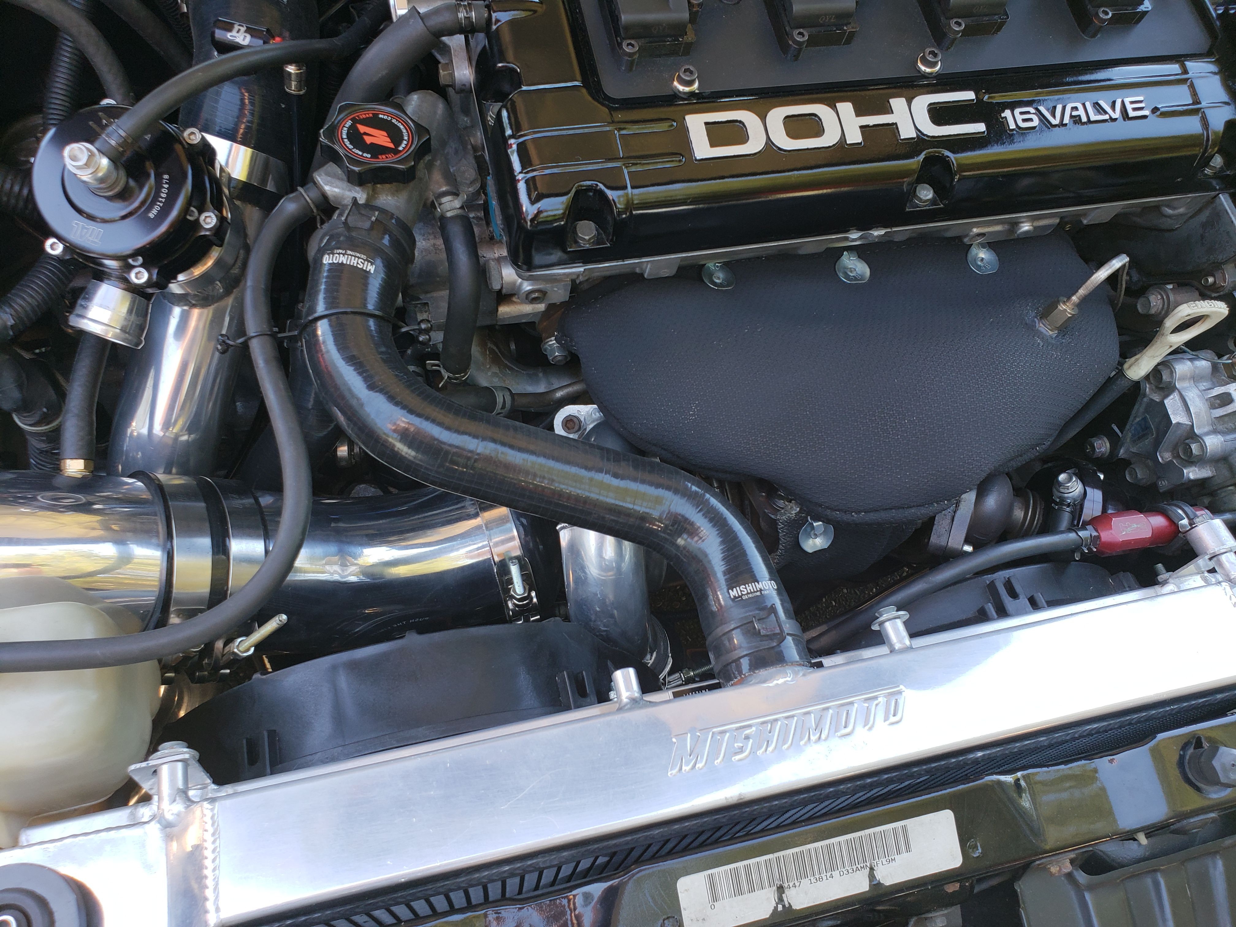

Manifold blanket and turbo blanket from TPP. These really do a great job a lowering engine bay temps. It all adds up.

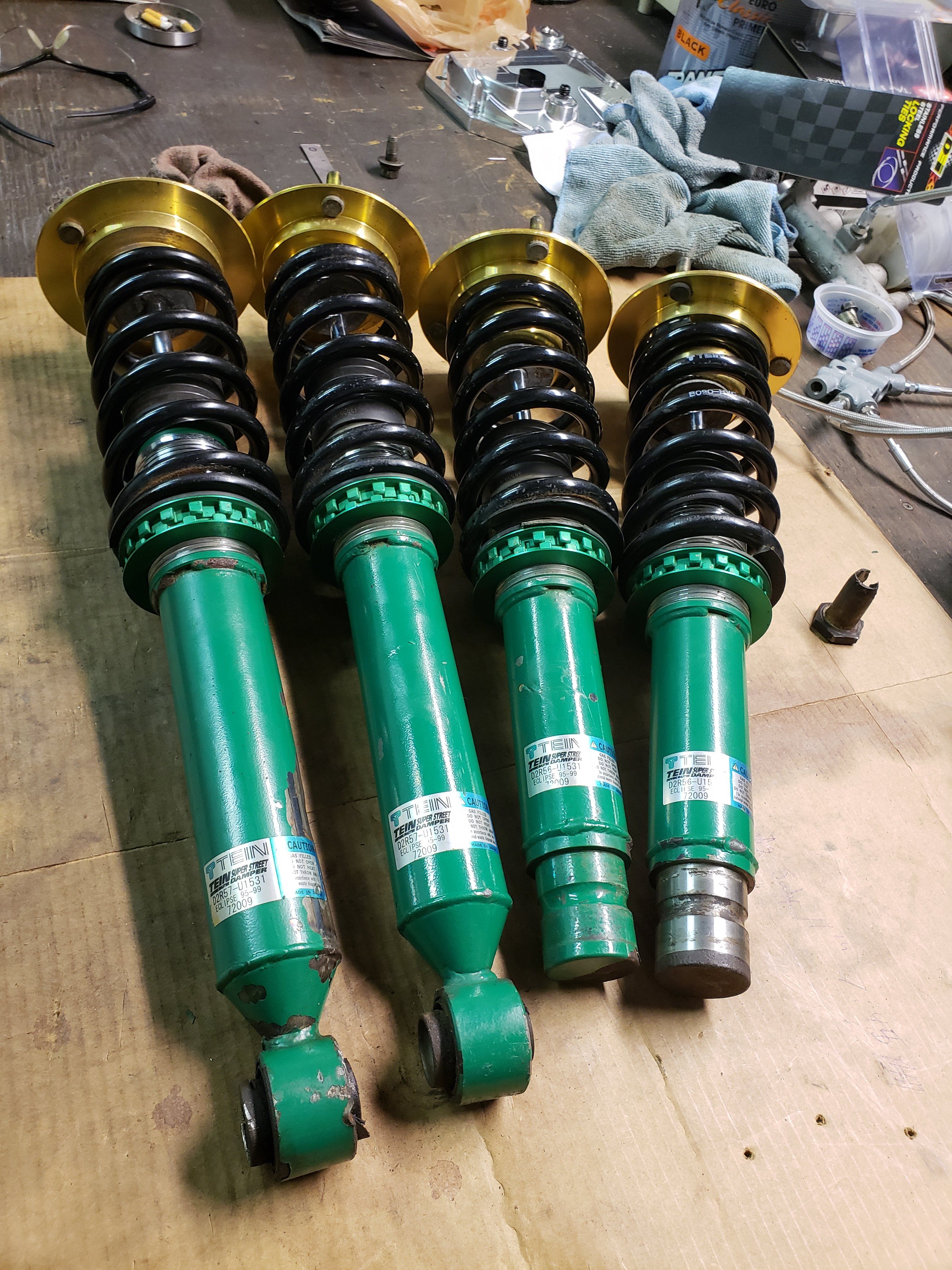

TEIN= waste of $

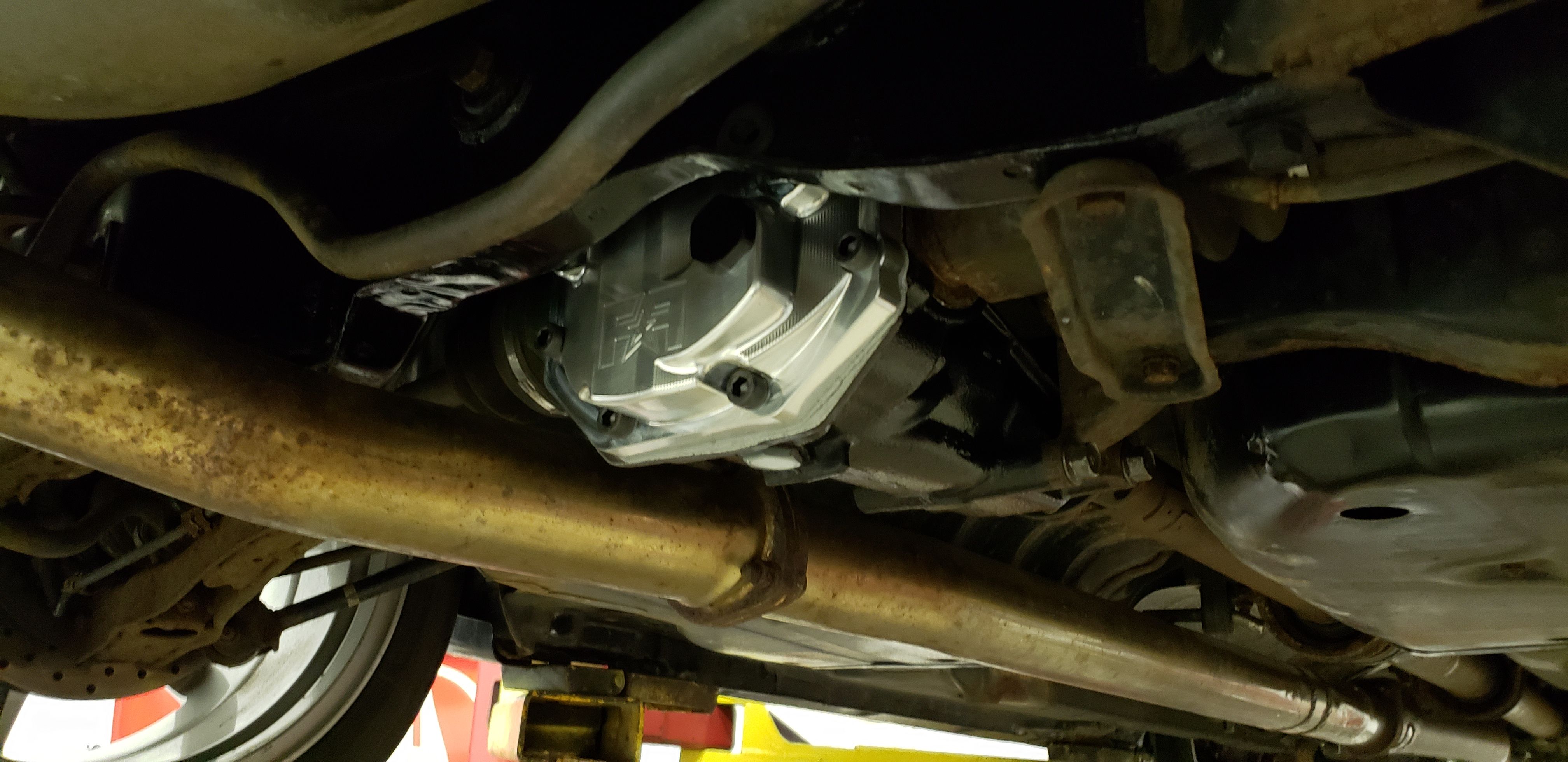

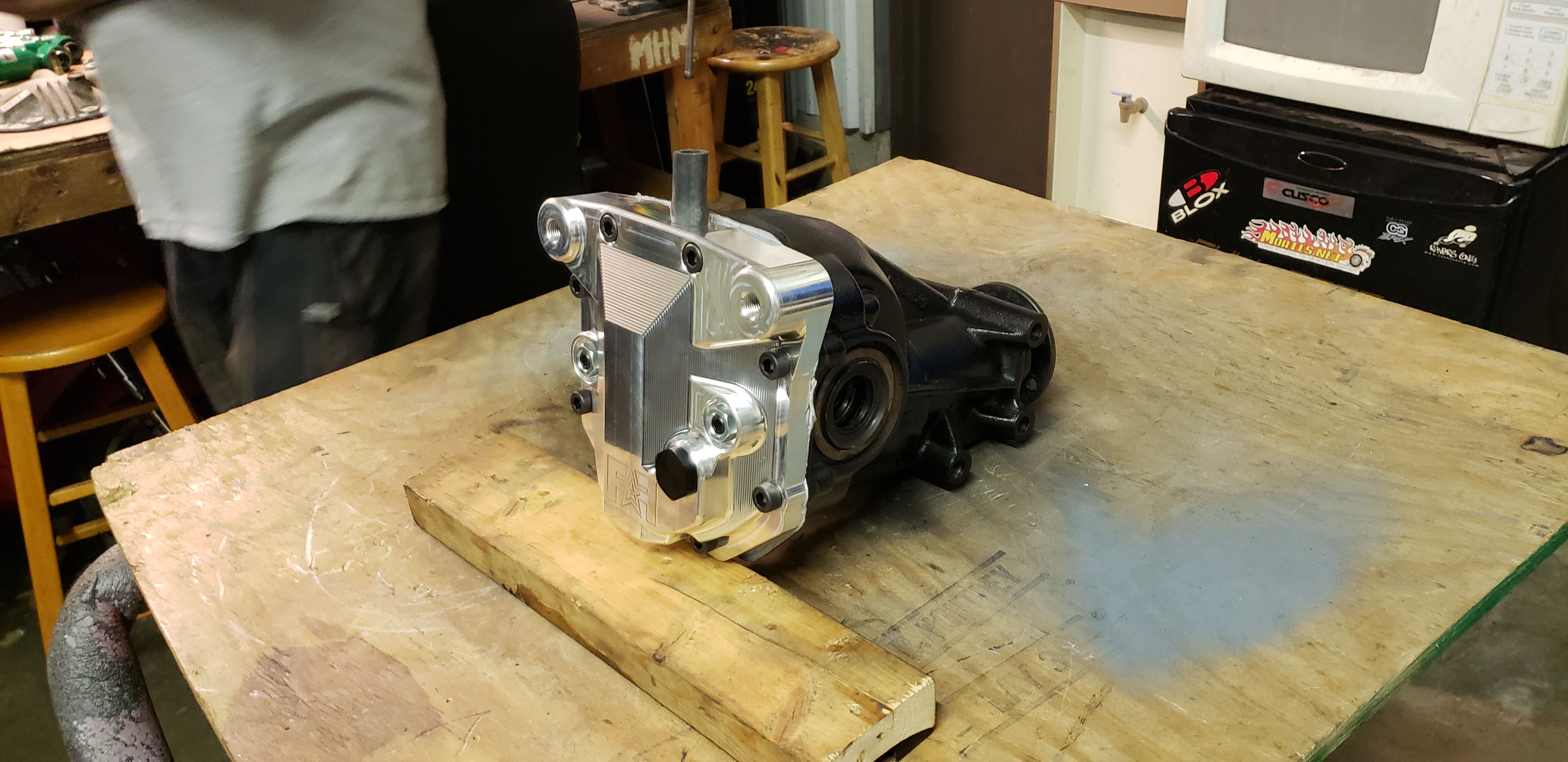

Pulled the rear diff and cleaned it up.Swapped the new diff cover on.
Back in there

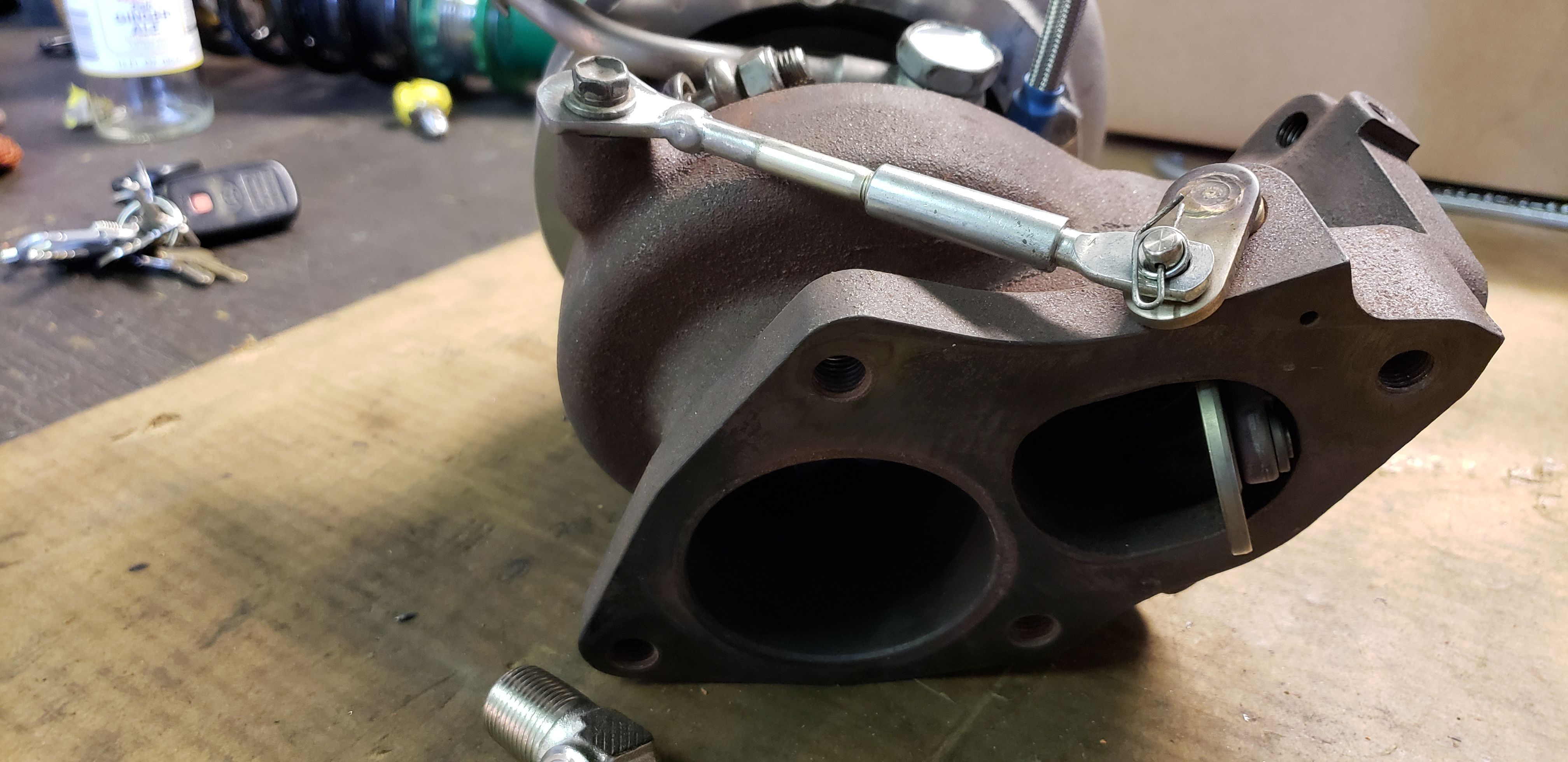

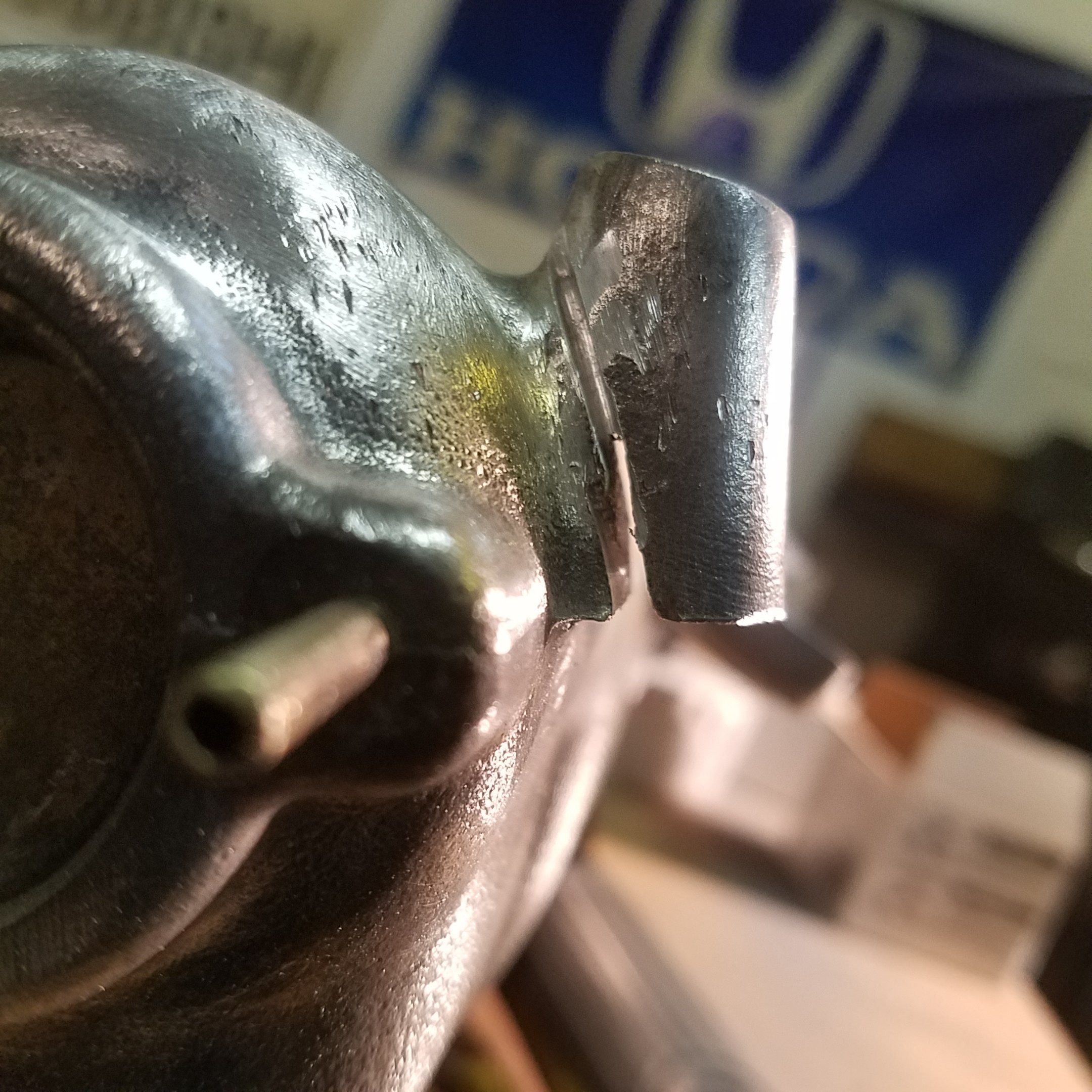

Thinking about giving this FP Green a shot so I made this arm to hold the WG flapper open. Nice because Im able to try it out on my external O2gate without permanently altering the FP 8cm housing.

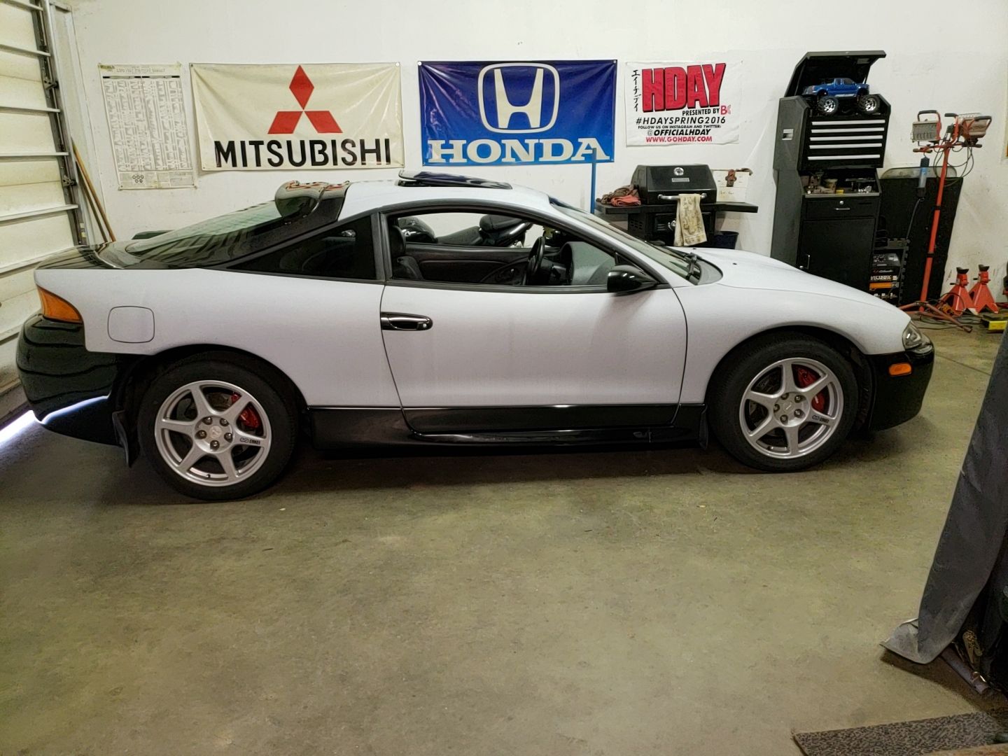

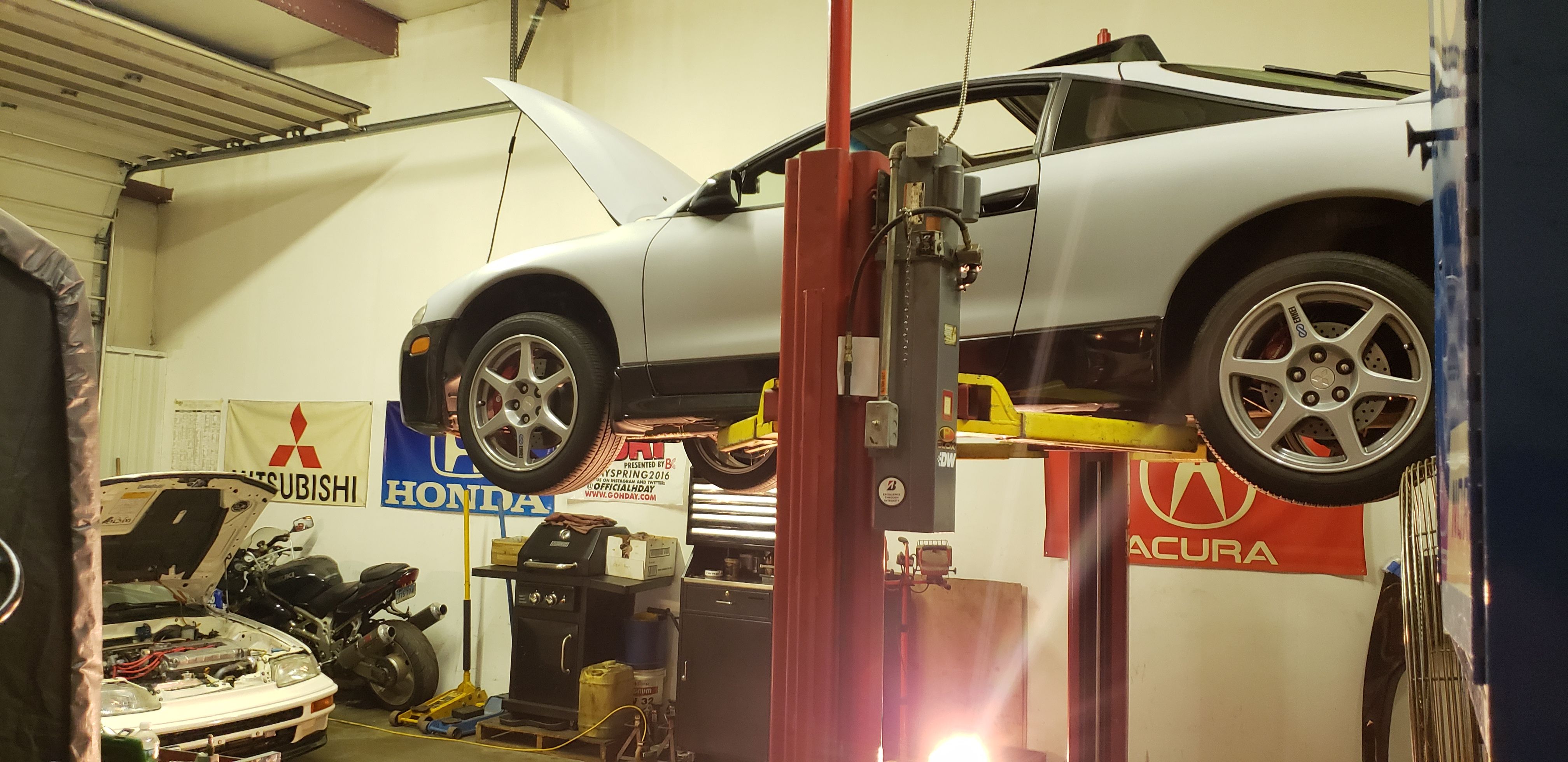

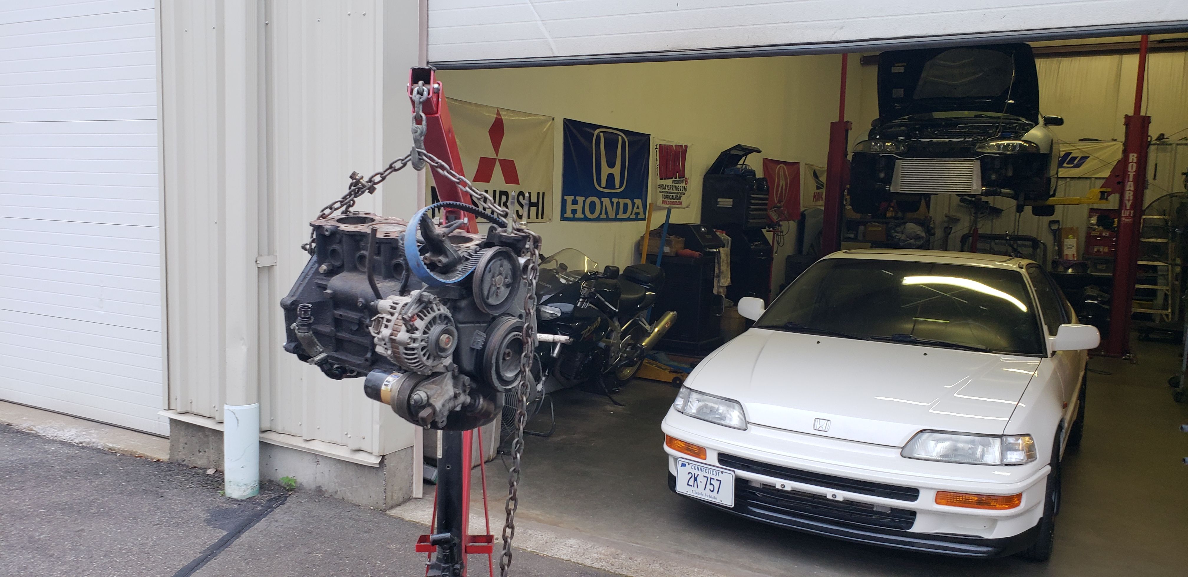

Having a proper shop makes all this stuff so much more enjoyable. Me and my buddy split the place. We added the lift last year. I remember what it was like to be out in the driveway.

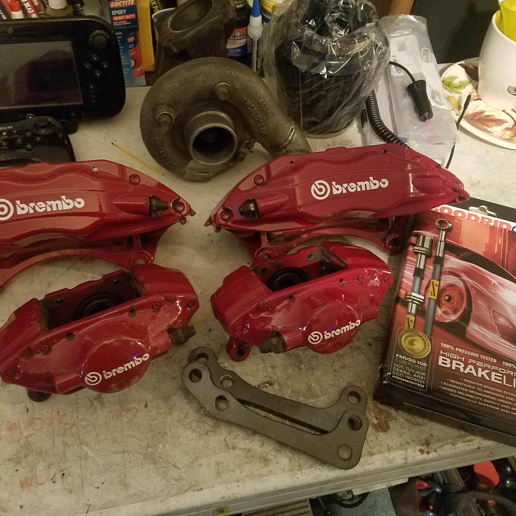

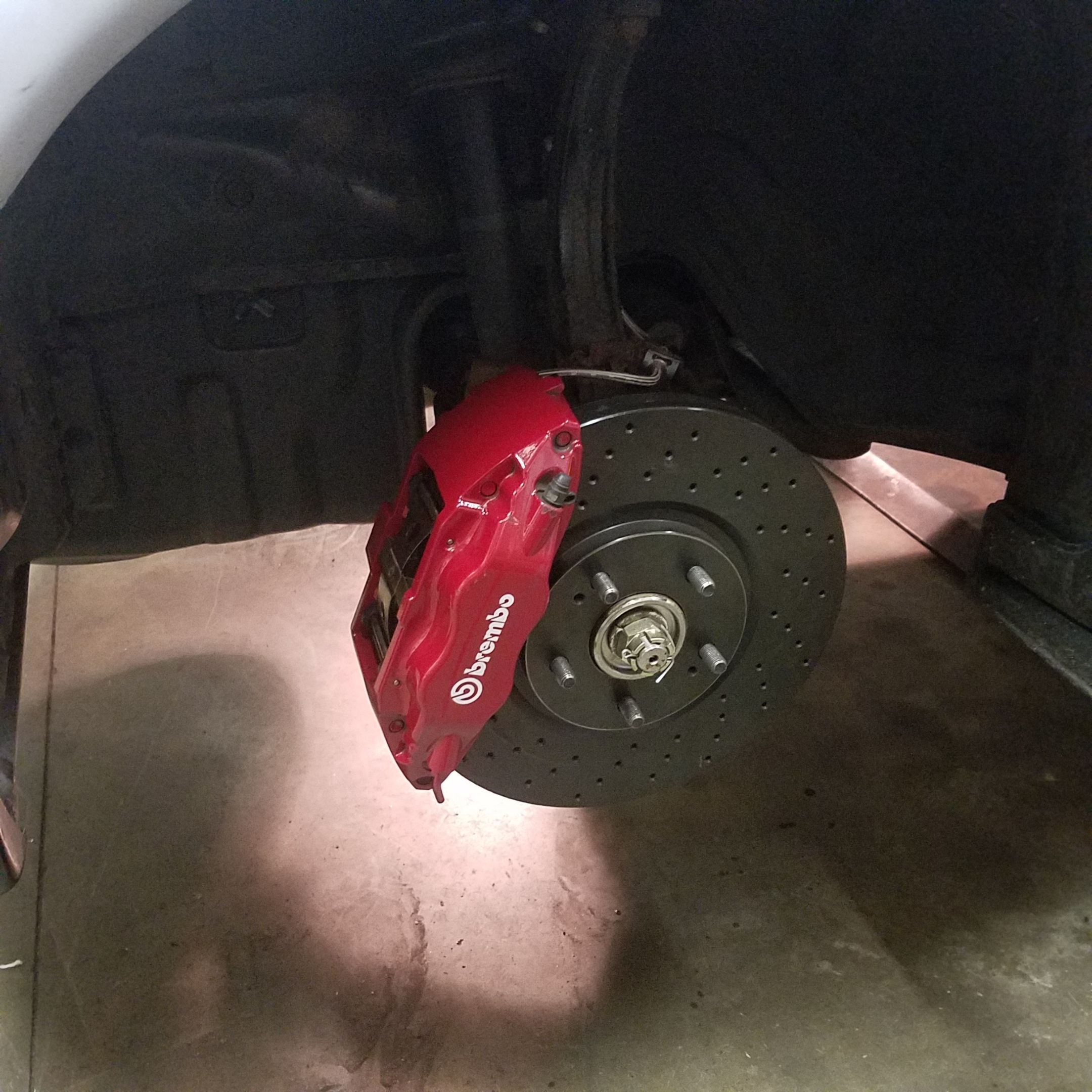

Ive had this Thermal Exhaust forever. Pulled it off the last GSX. I think I was doing the tank to rail setup here.
Had just done the Brembo swap too.

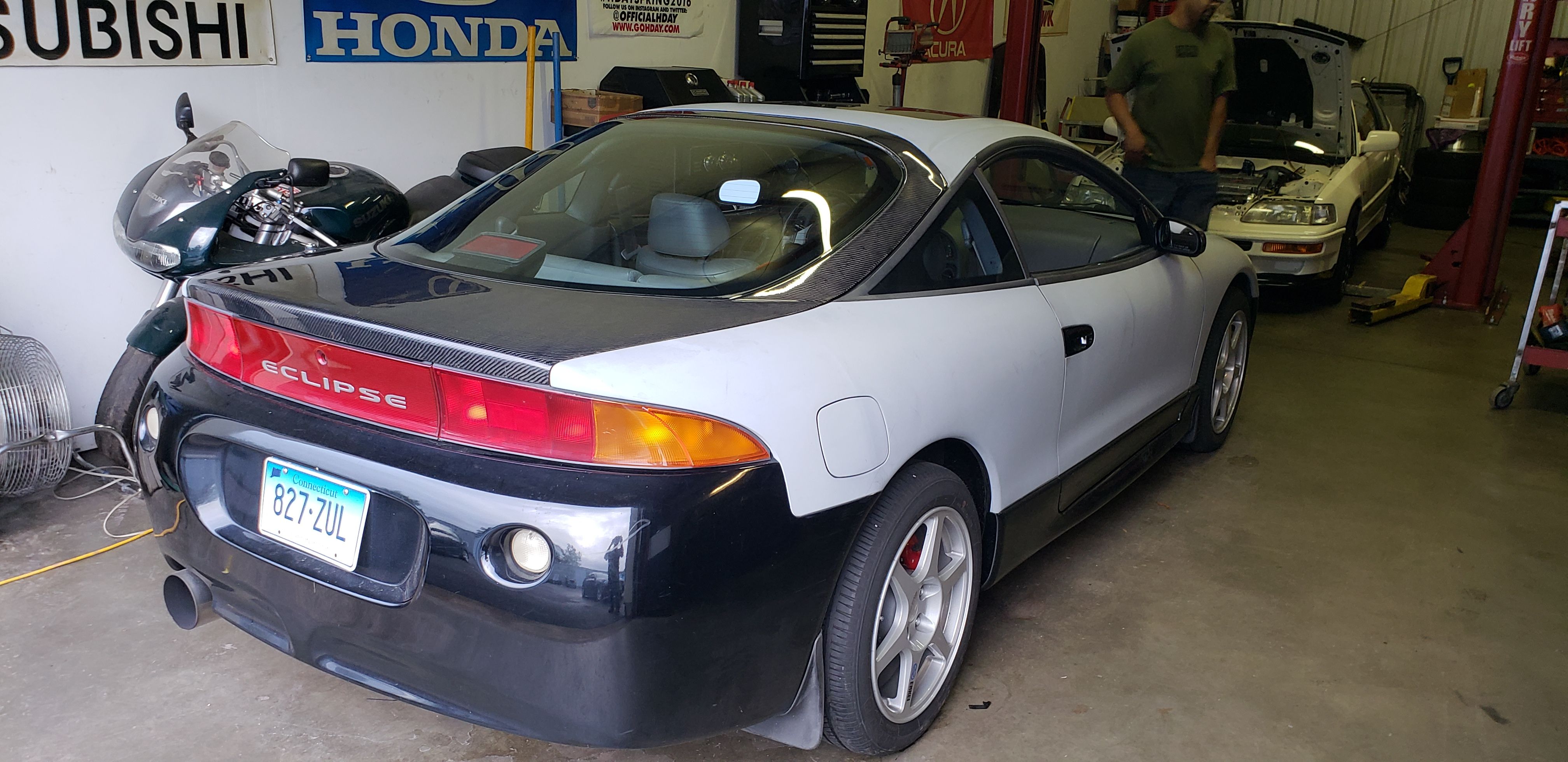

Sorry my photos do become a bit out of order from here out..................Heres a look at my weld job for the evo steering wheel. This was actually the splined hub that I dug out of a 2g steering wheel. It is buried under a ton of aluminum on the 2g wheel but the part that matters is steel and it CAN be dug out and used. Heres proof. Obviously the donor 2g wheel was junk to begin with and was destroyed to do this.

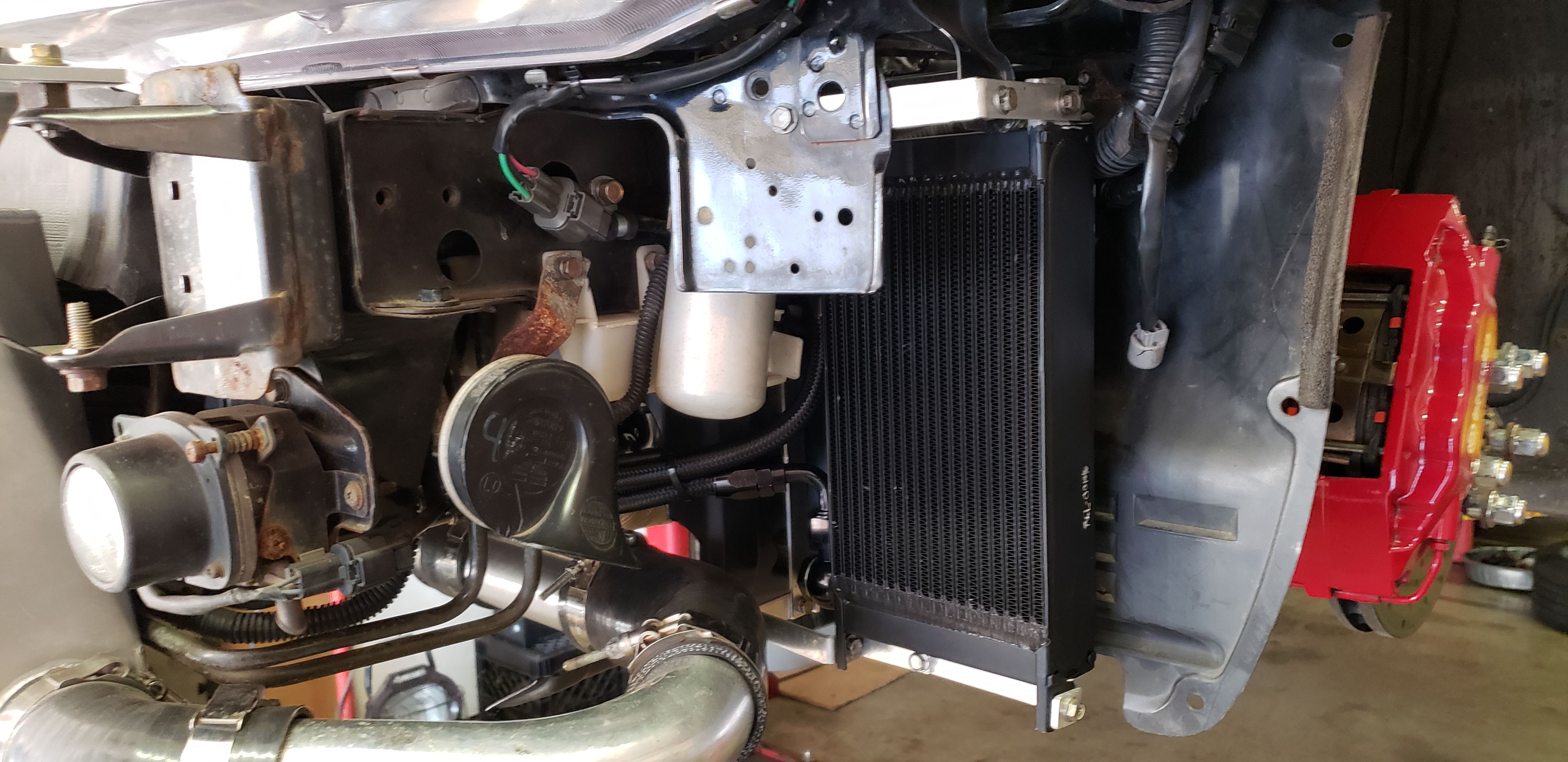

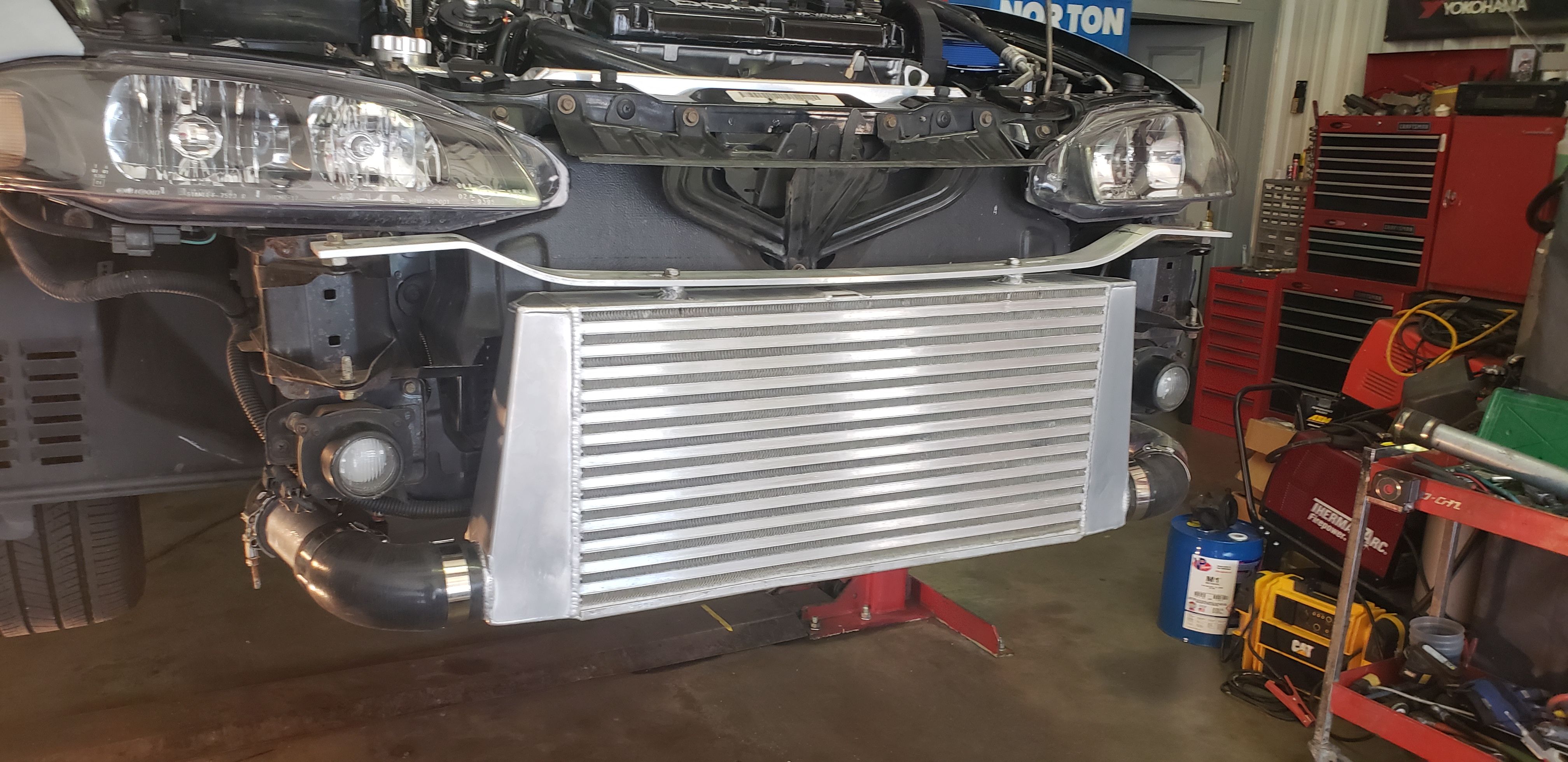

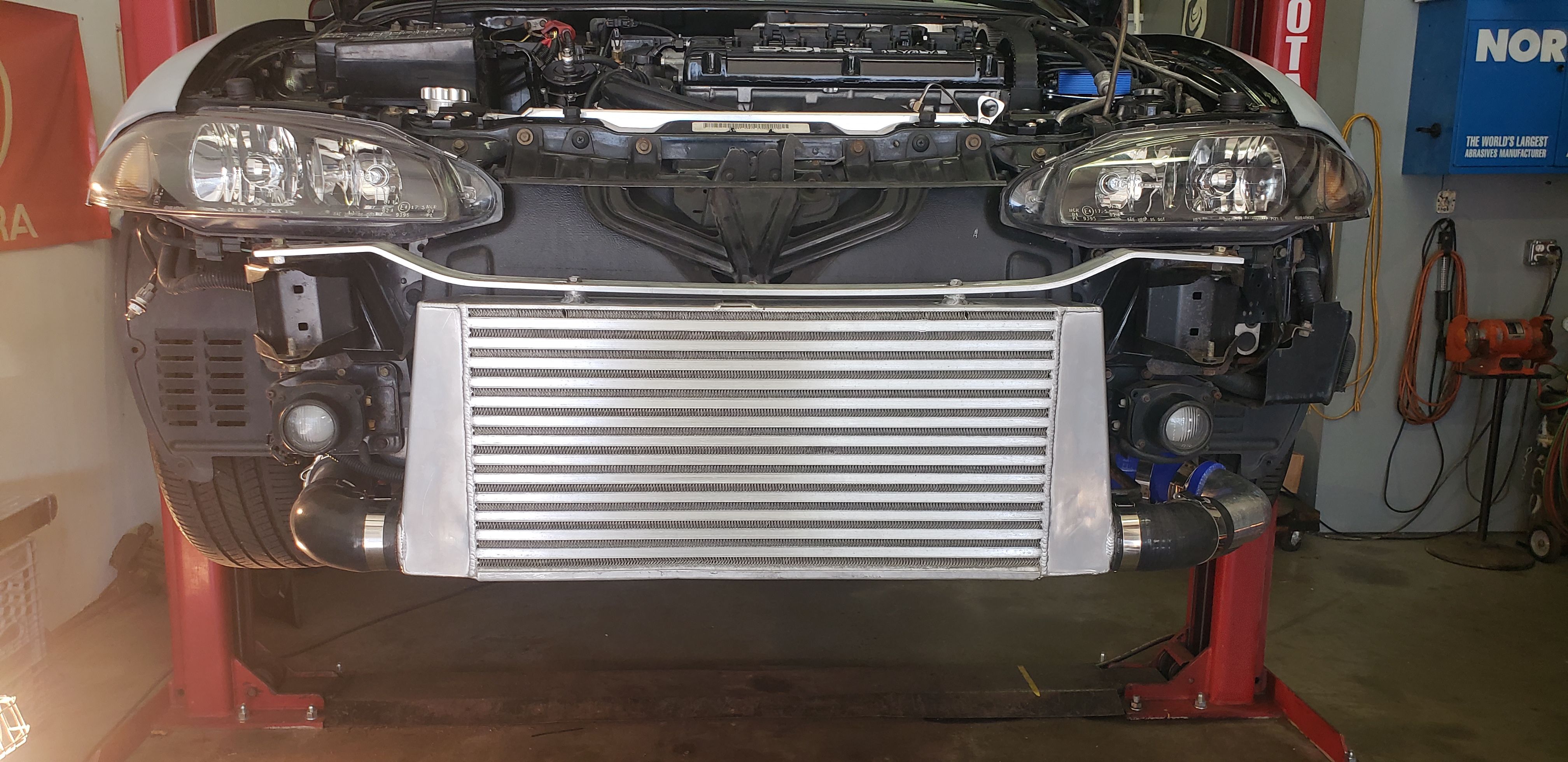

Scored an evo8 ETS 4'' core. I made some minor modifications to make it work well here.

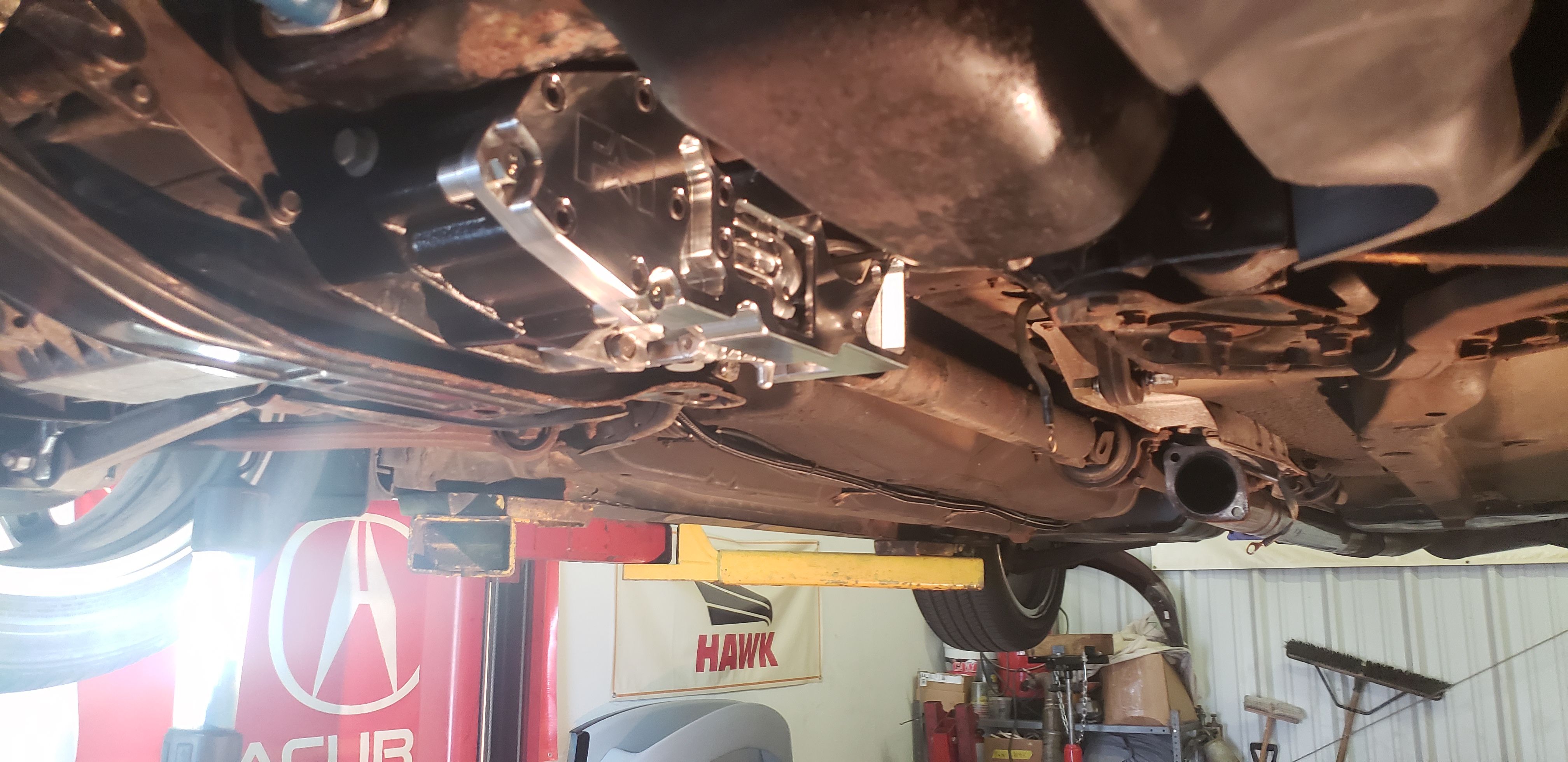

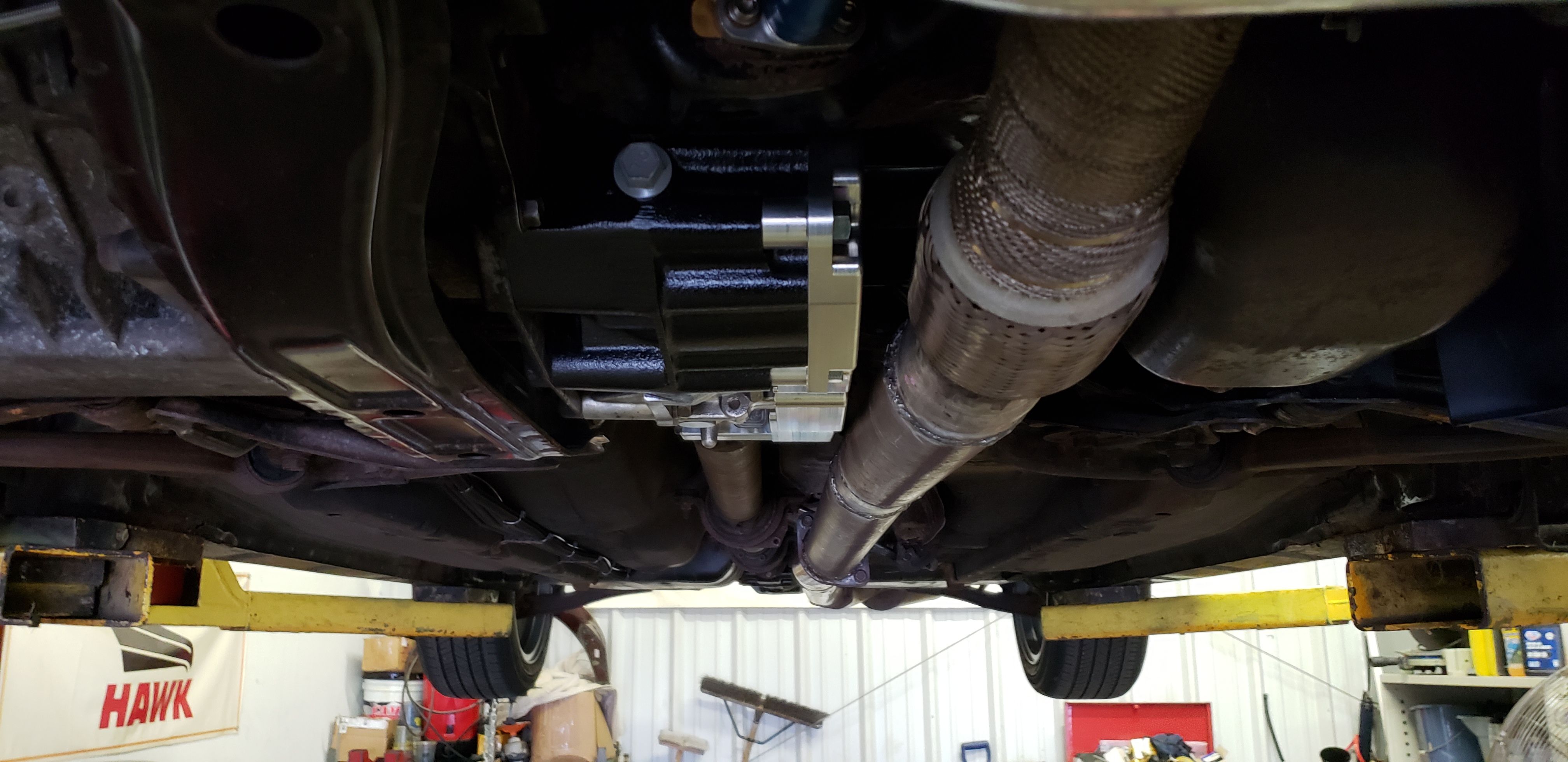

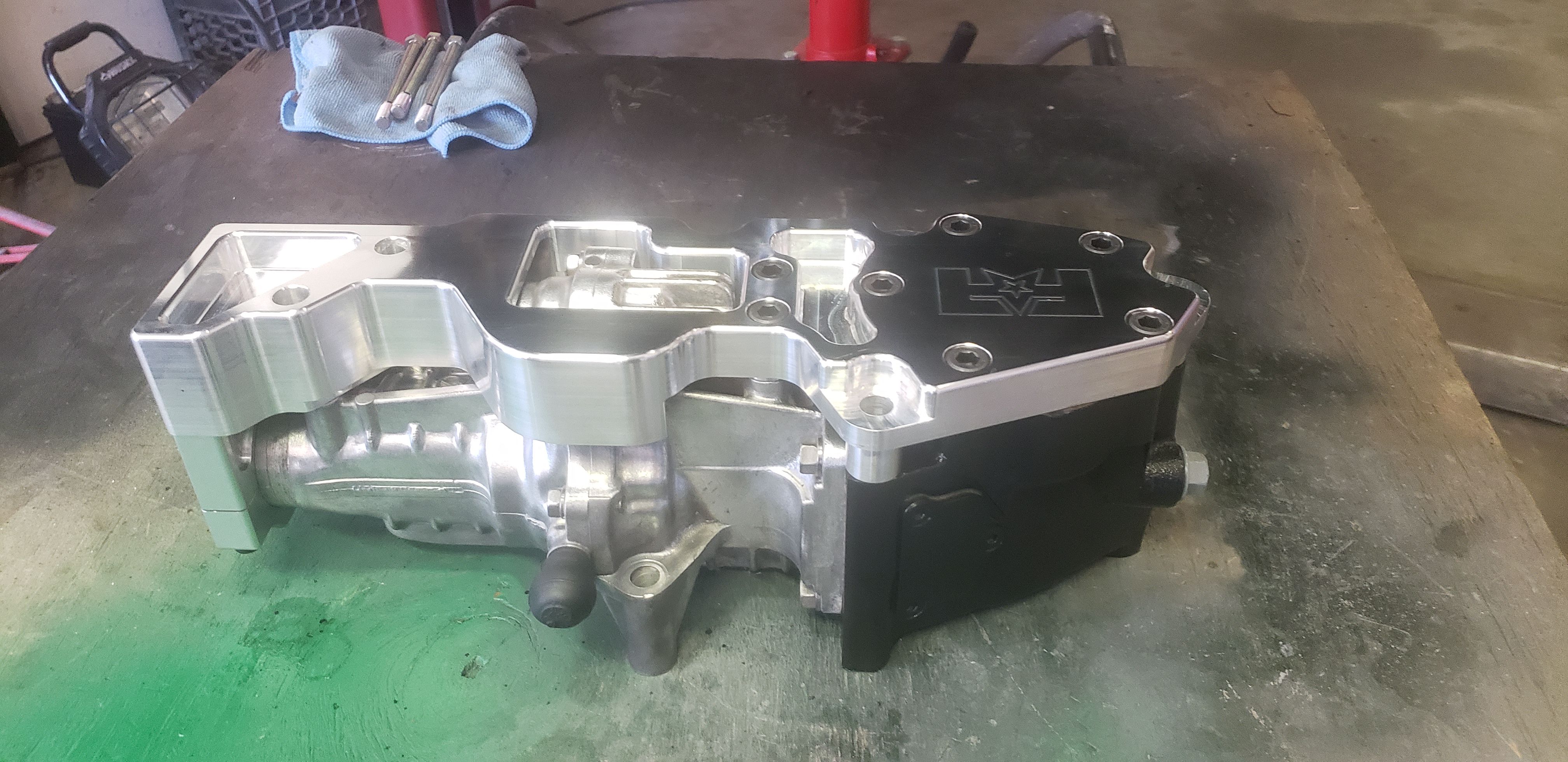

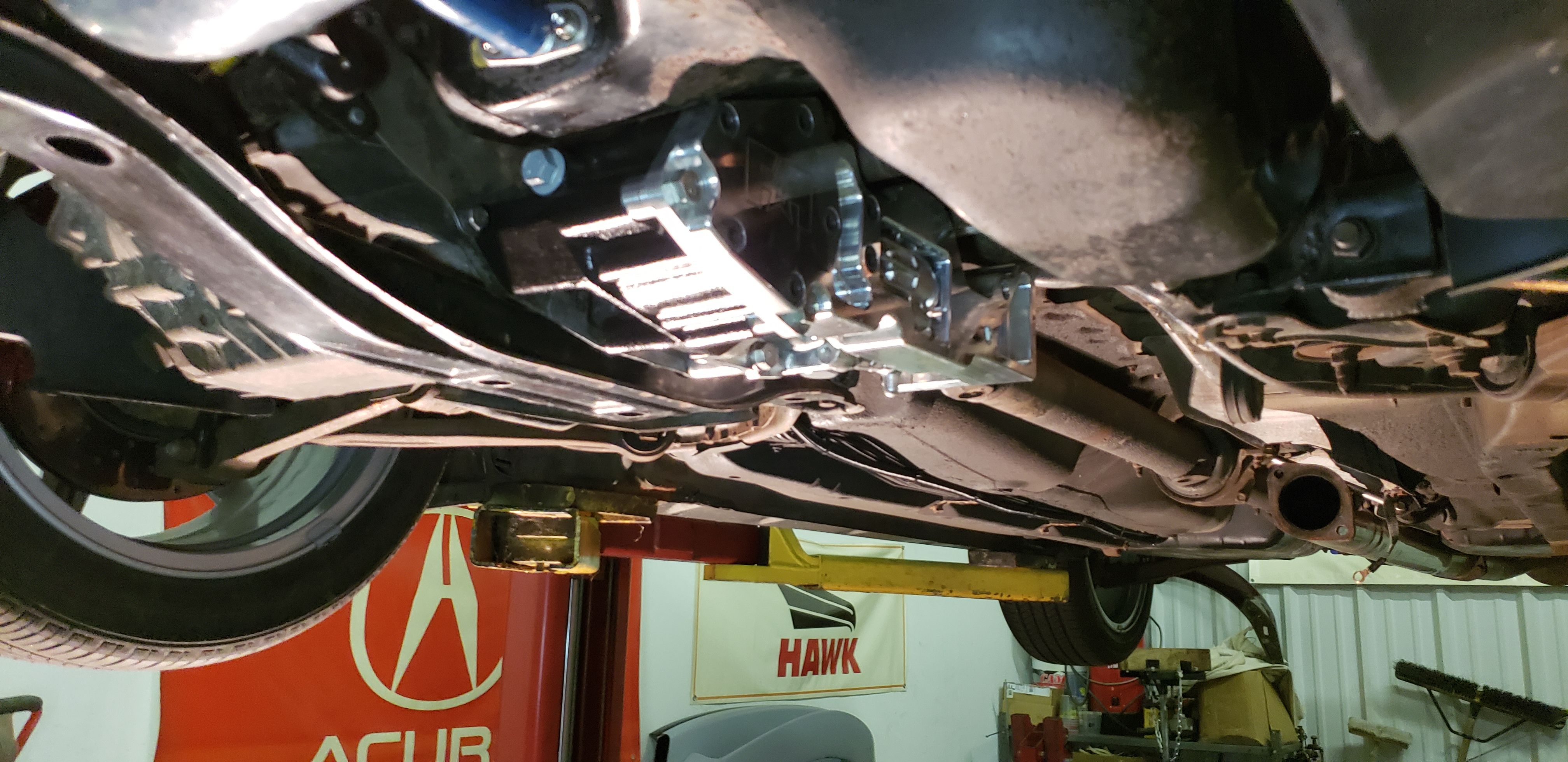

An awesome deal on something I always thought was really cool.

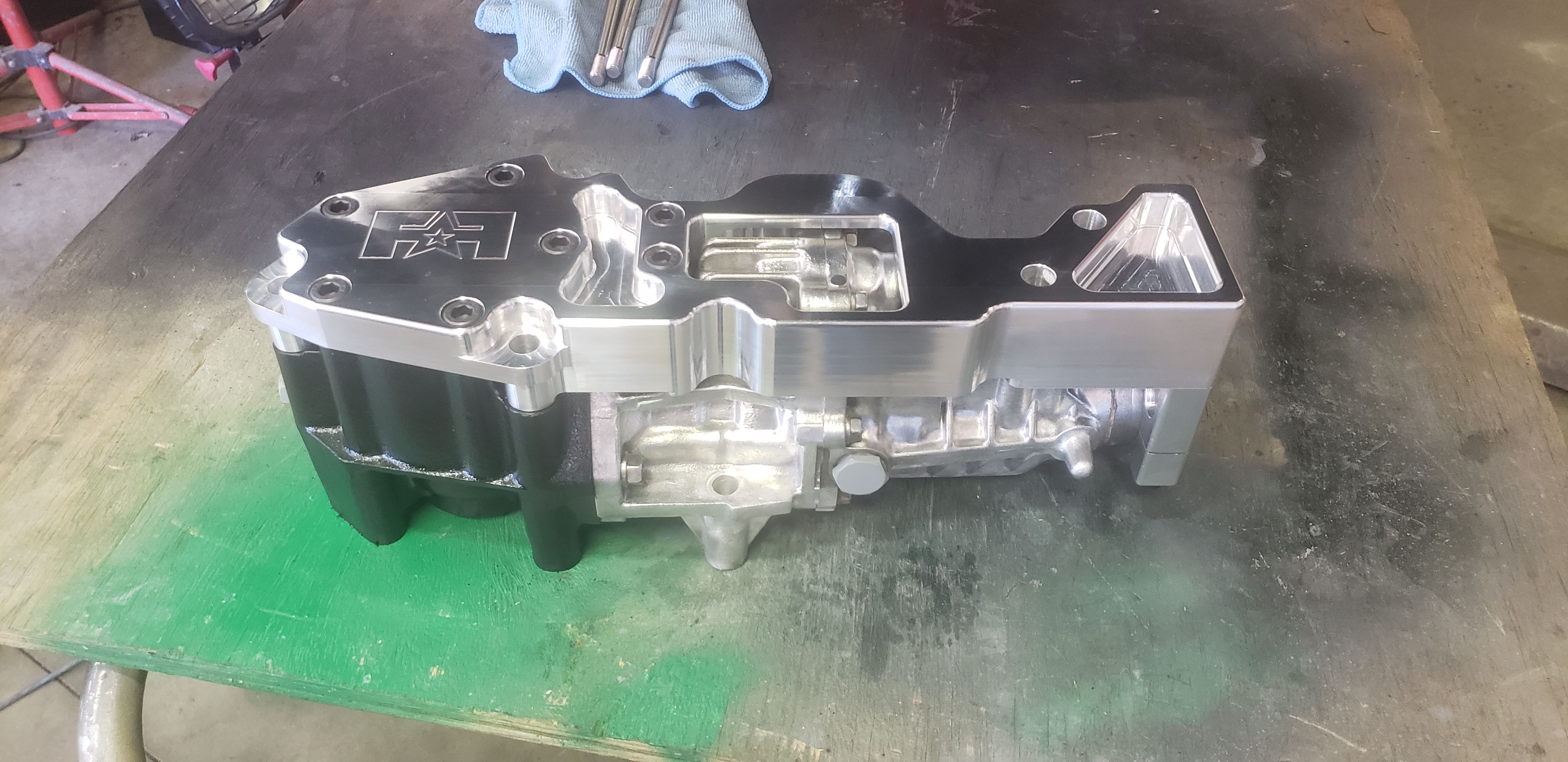

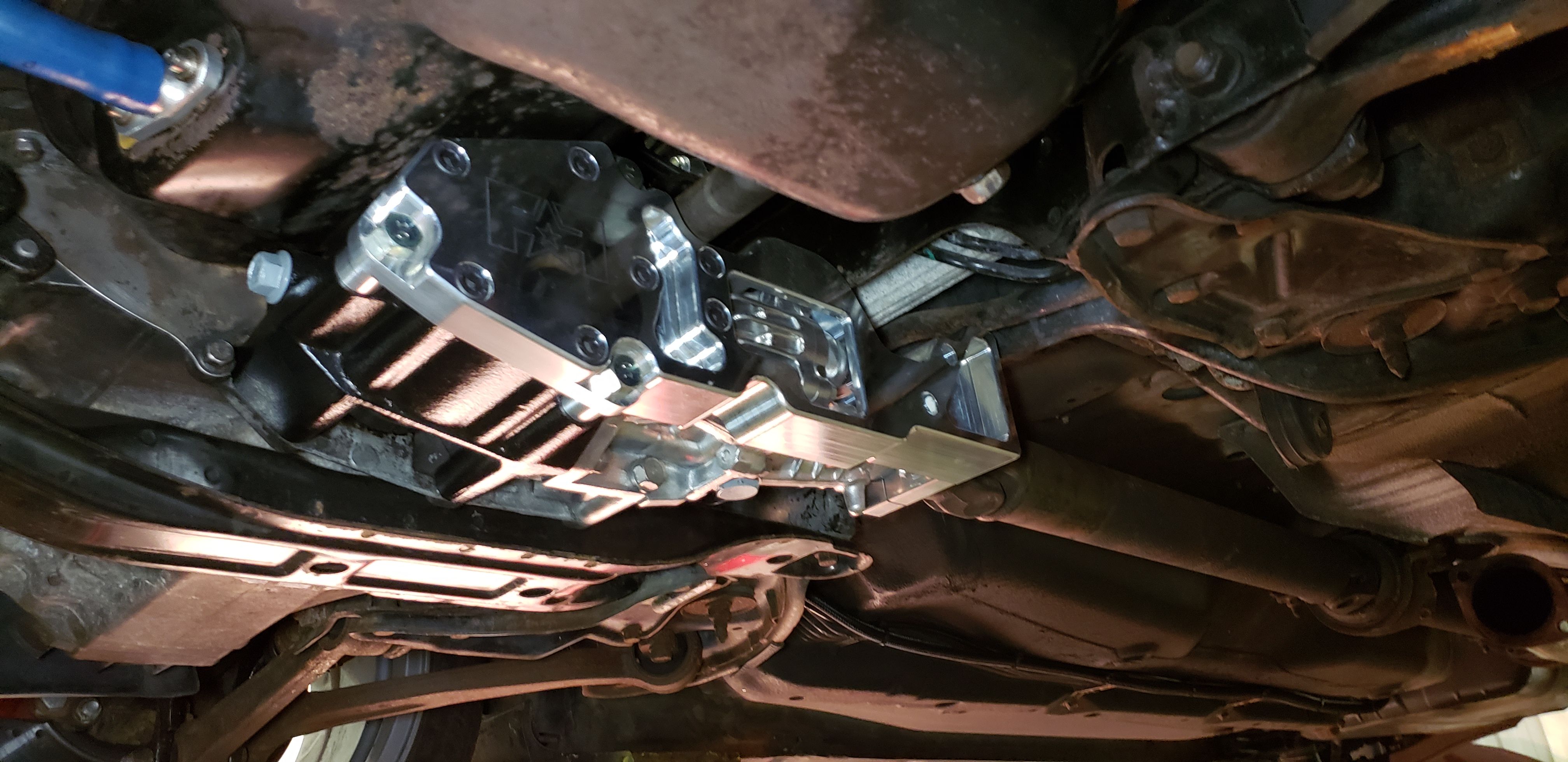

Tcase ready to go
back in there
I had to make a few minor modifications to get the tcase in with the brace but nothing too crazy.......just a couple relief notches. I also had to slightly reroute my exhaust.

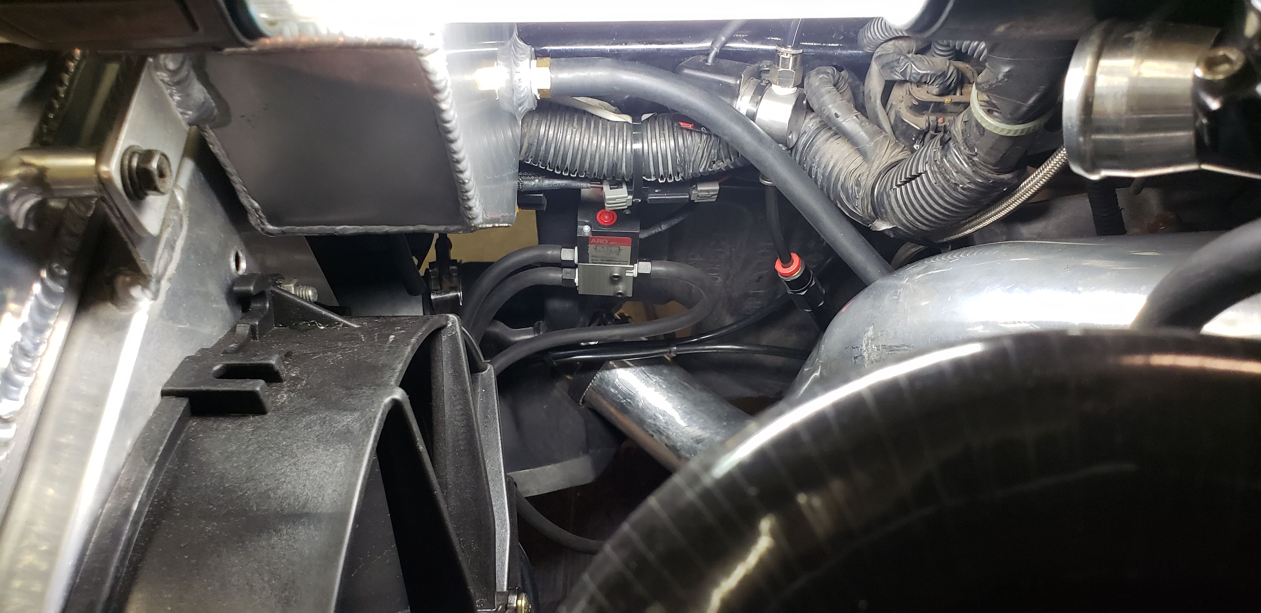

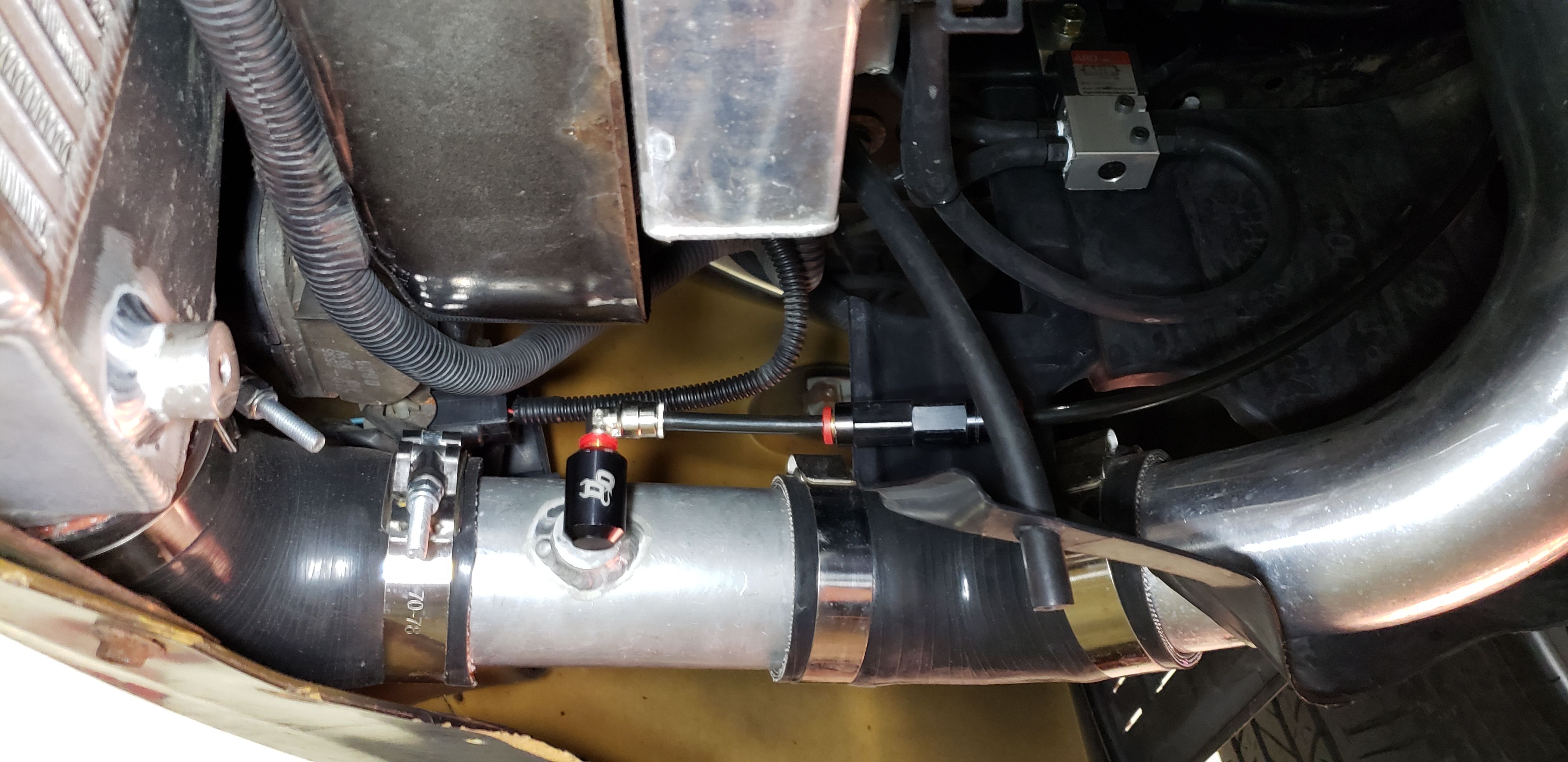

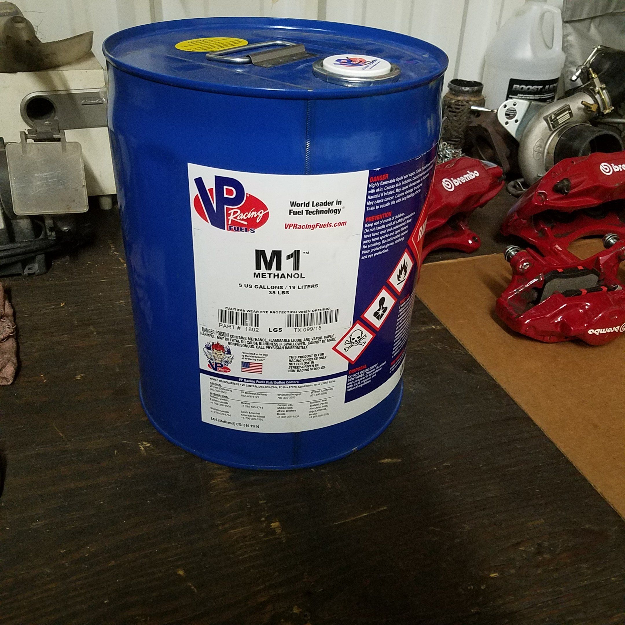

This is a look at one of my most used methanol injection locations, just after the intercooler. Ive tried a few different things as far as nozzle quantity, size, and location. I have found that one single properly sized nozzle in this location to give the best results. I would like to pick up a spare evoIII IM and weld a bung to each runner and try direct injection with 4 small nozzles at some point. I live in a pathetic place with no E85.........this is all I can reasonably do.

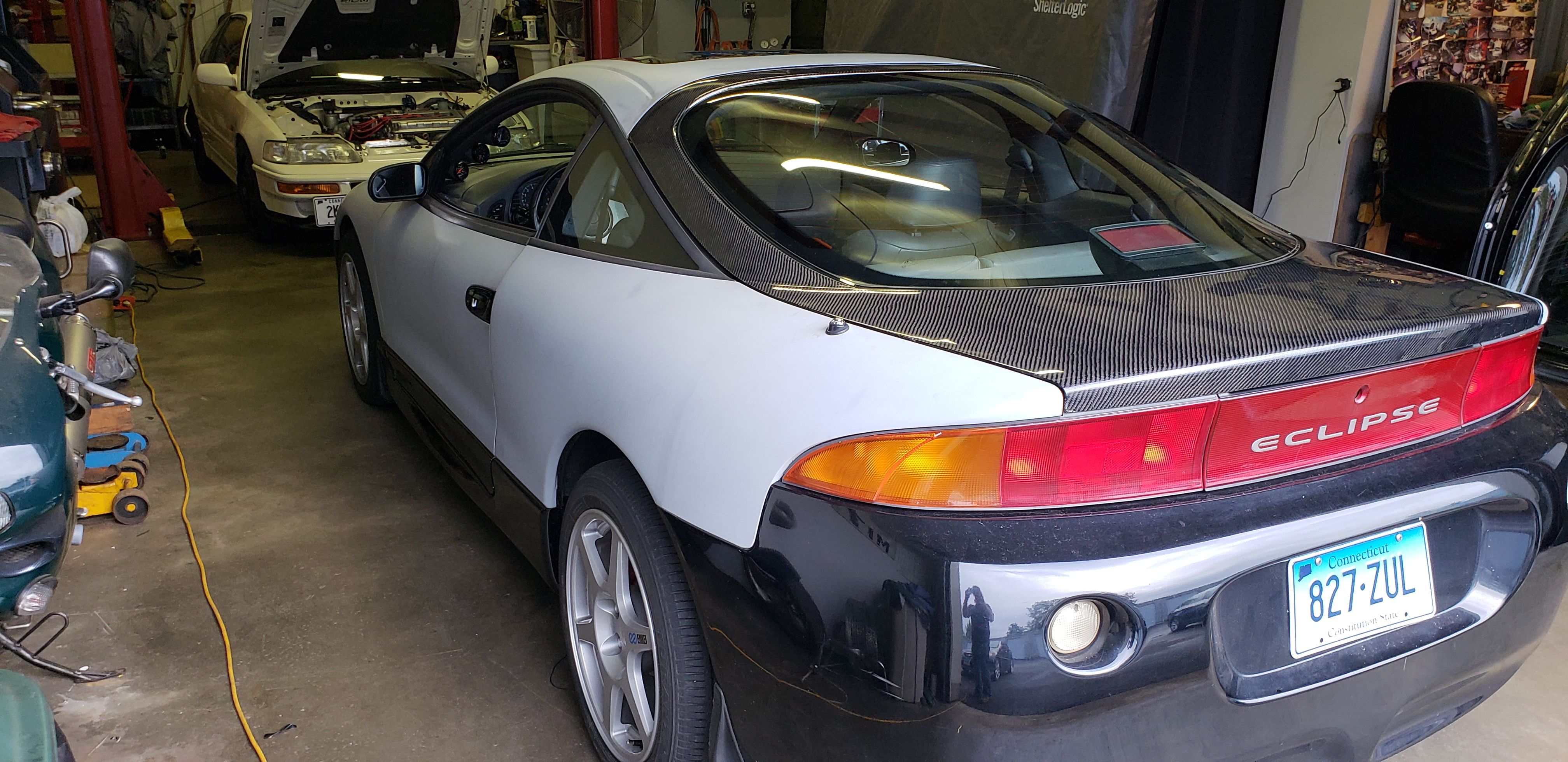

Picked up a carbon fiber hatch, local. Another deal I could not say no to. Something i would never typically do but I was ready to try something new. Also pulled my EDM tail lights out of the parts hoard. Ive had them forever. Ive got the side view mirrors and the side markers (fender mount) too. View attachment 571798

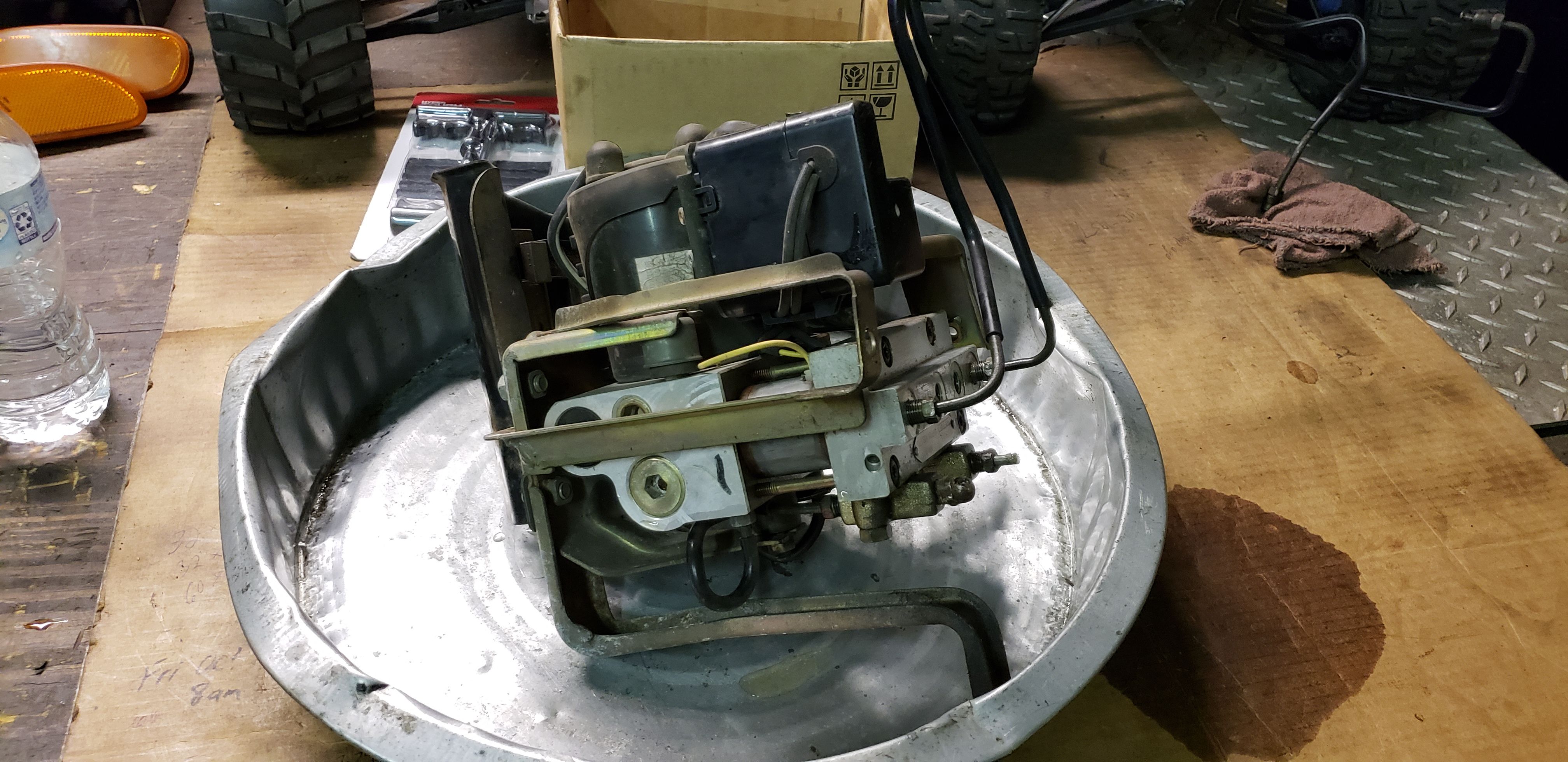

Did the ABS delete. New 3g Brake Master
New Non ABS Brake proportioning valve

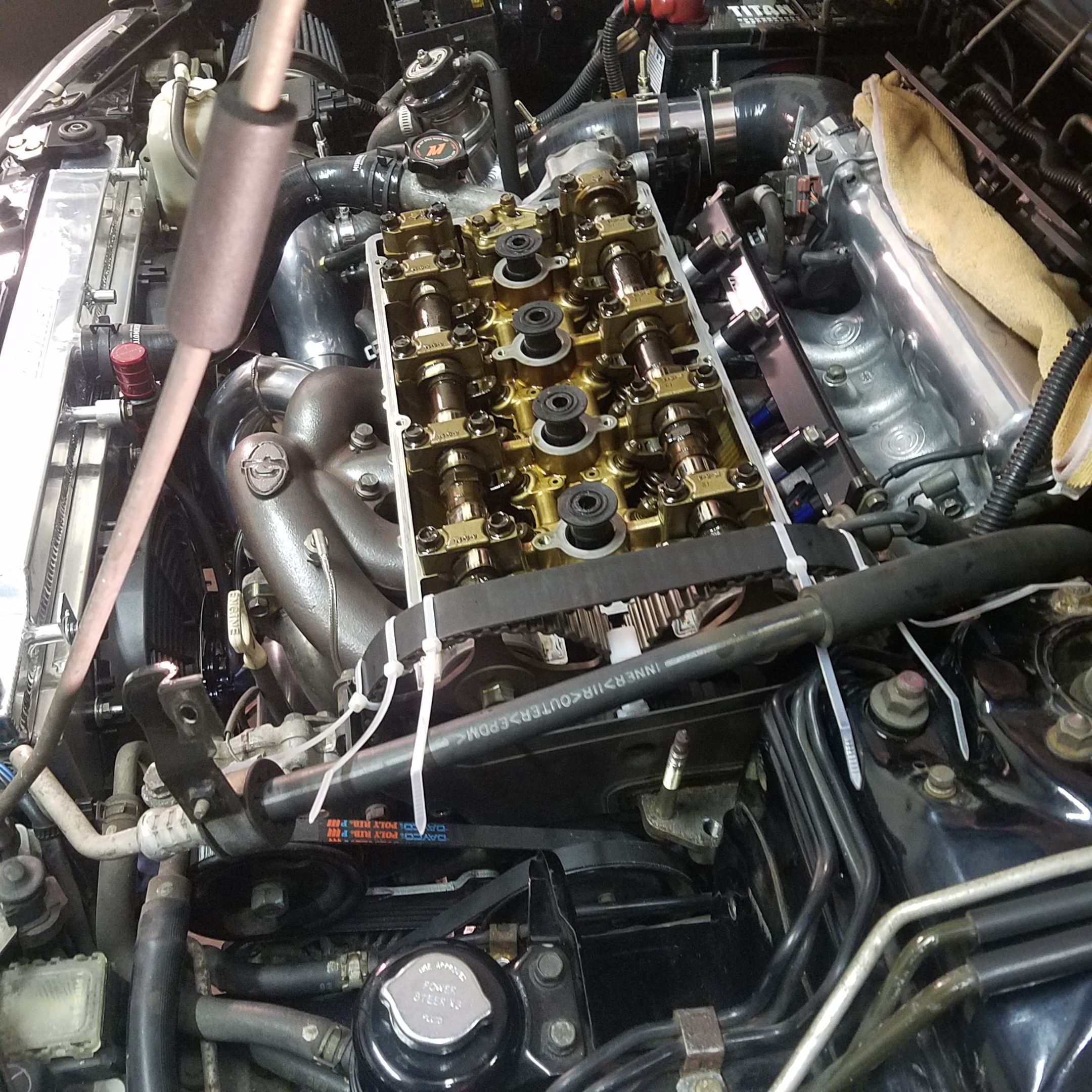

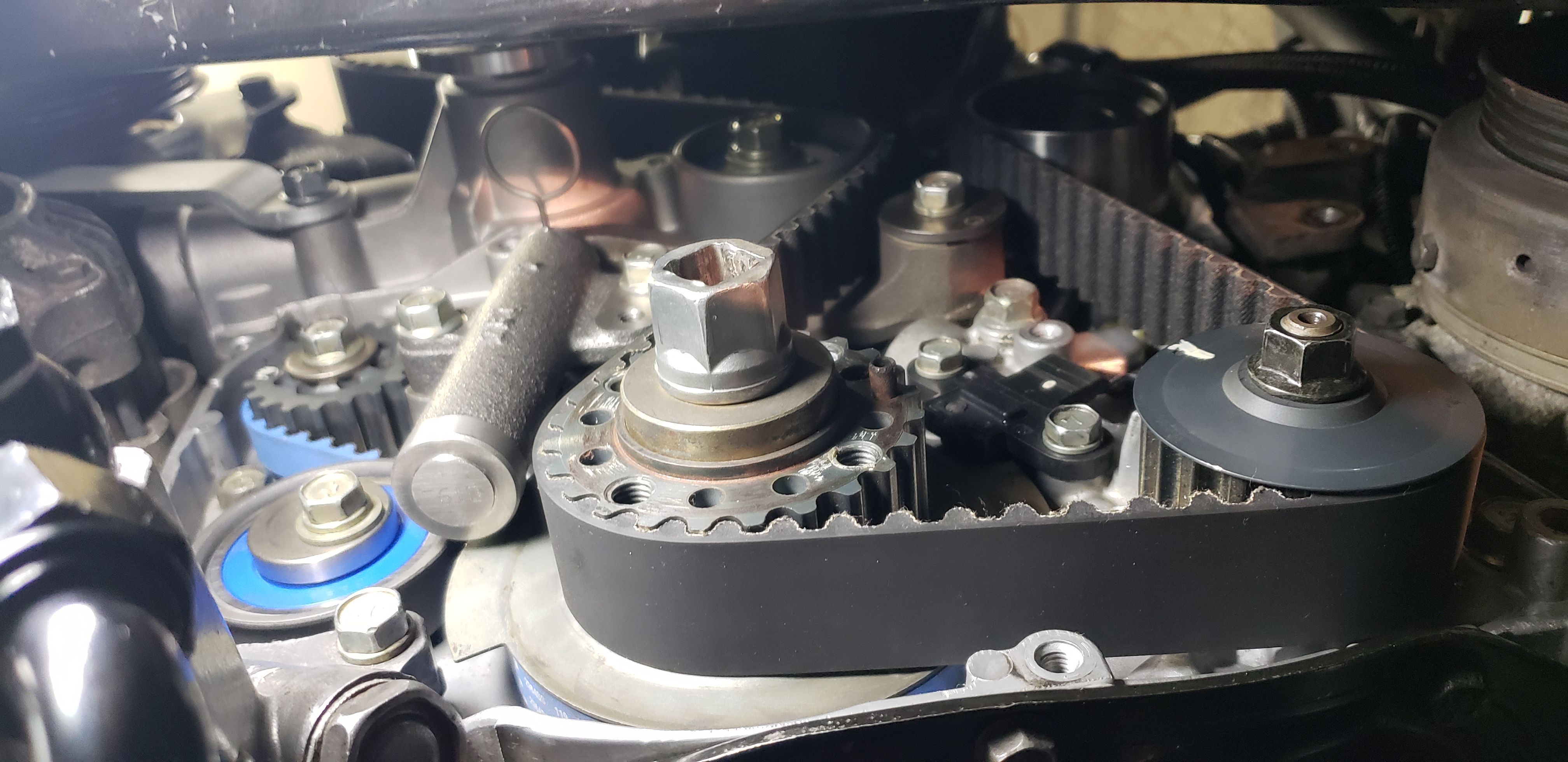

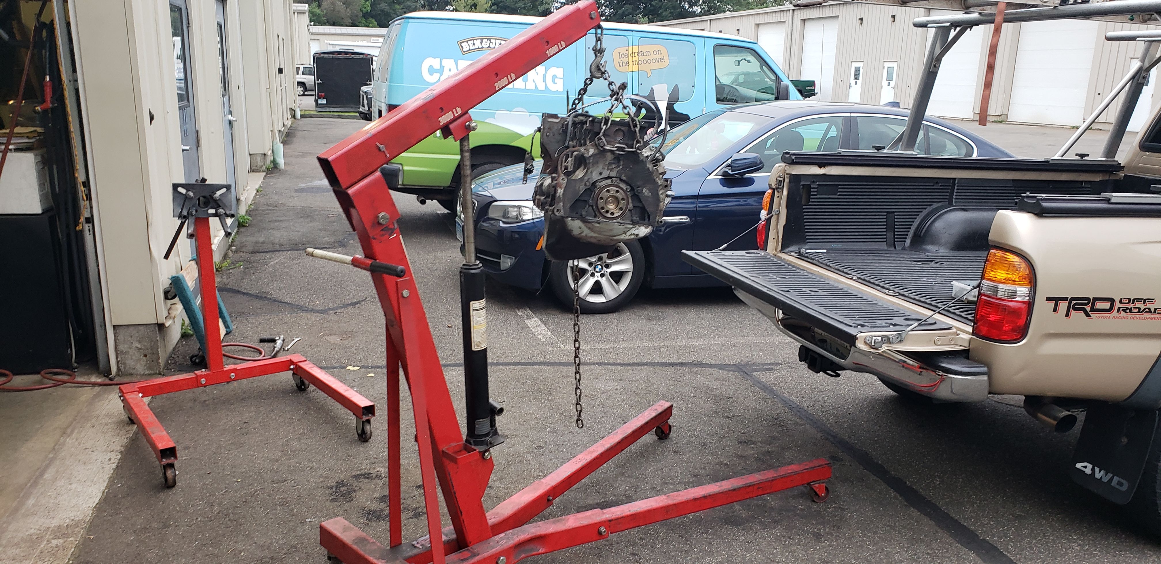

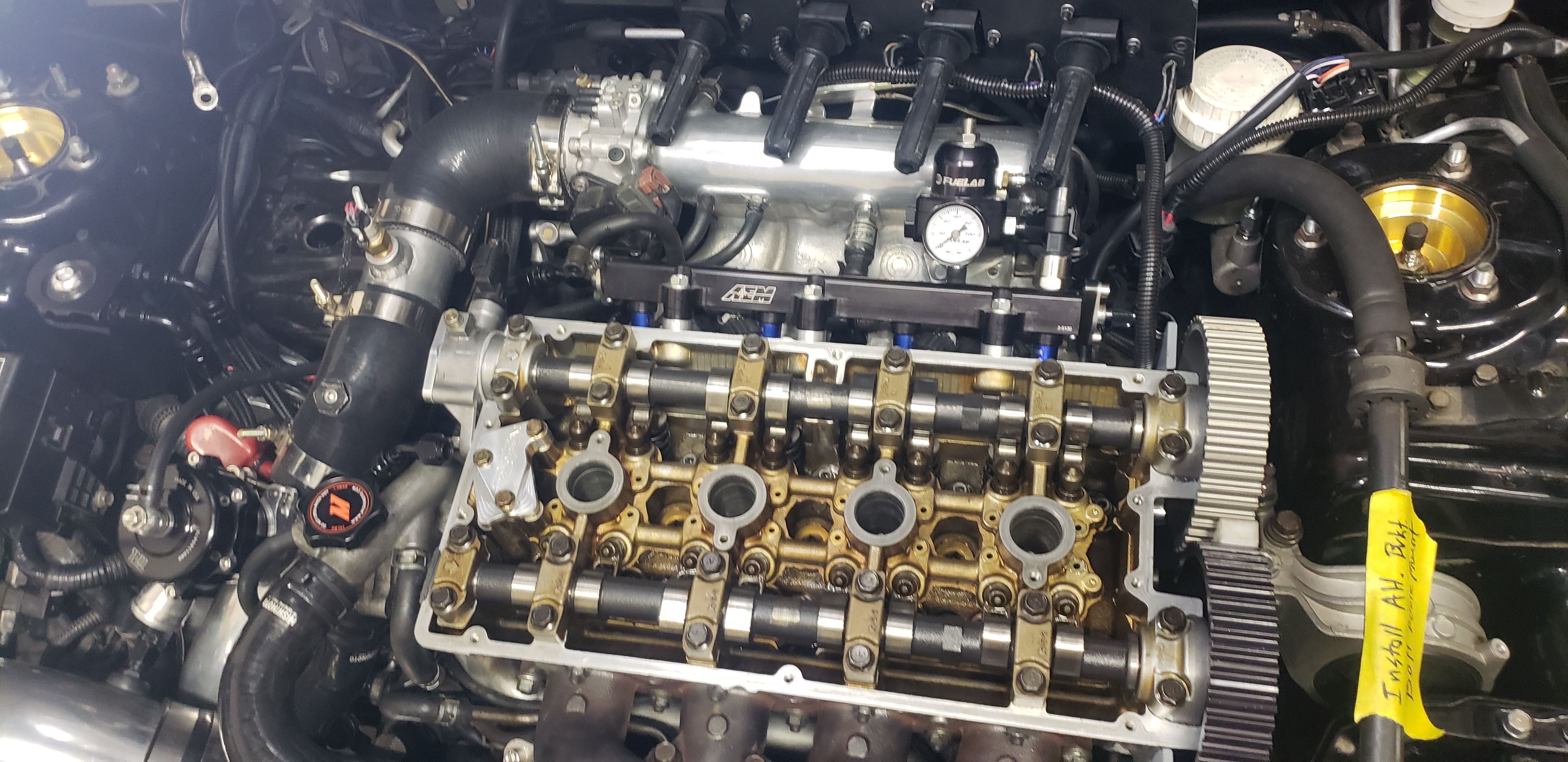

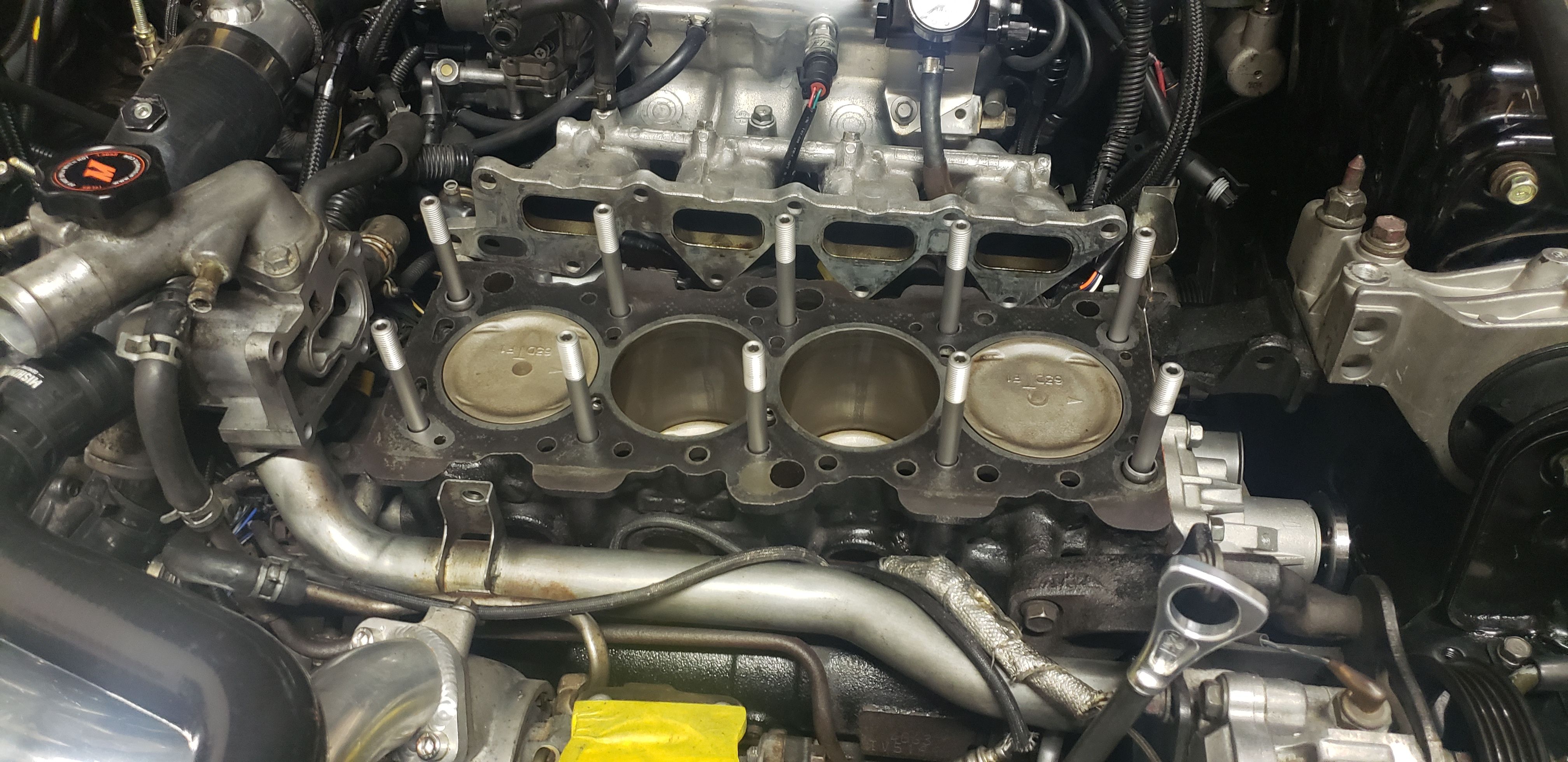

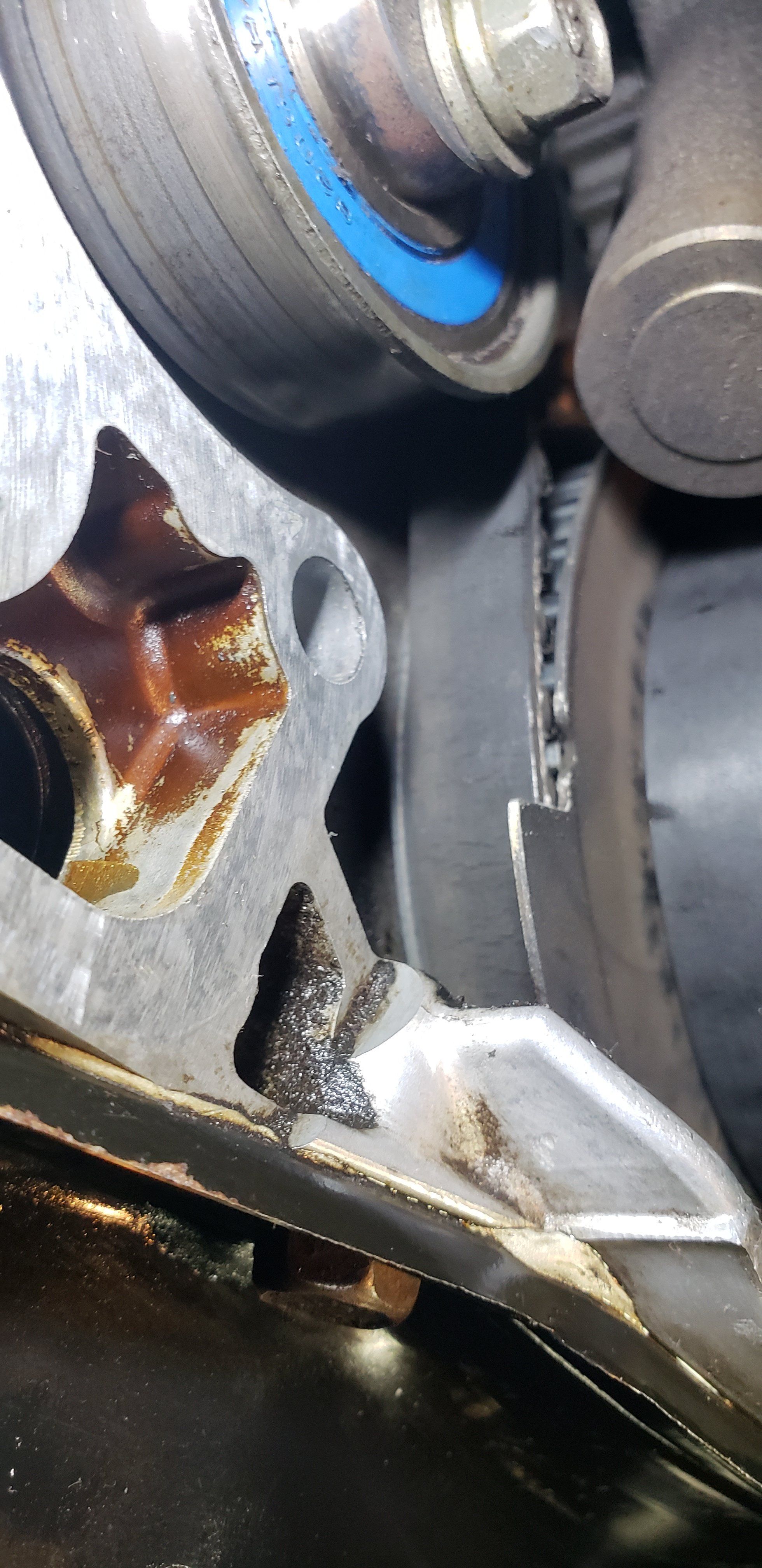

Put the car on the lift to do the timing job. Decided to do the head gasket too.At some point while I was waiting for parts I added an evo8 oil filter housing and a Setrab oil cooler.
Found this guy in there.

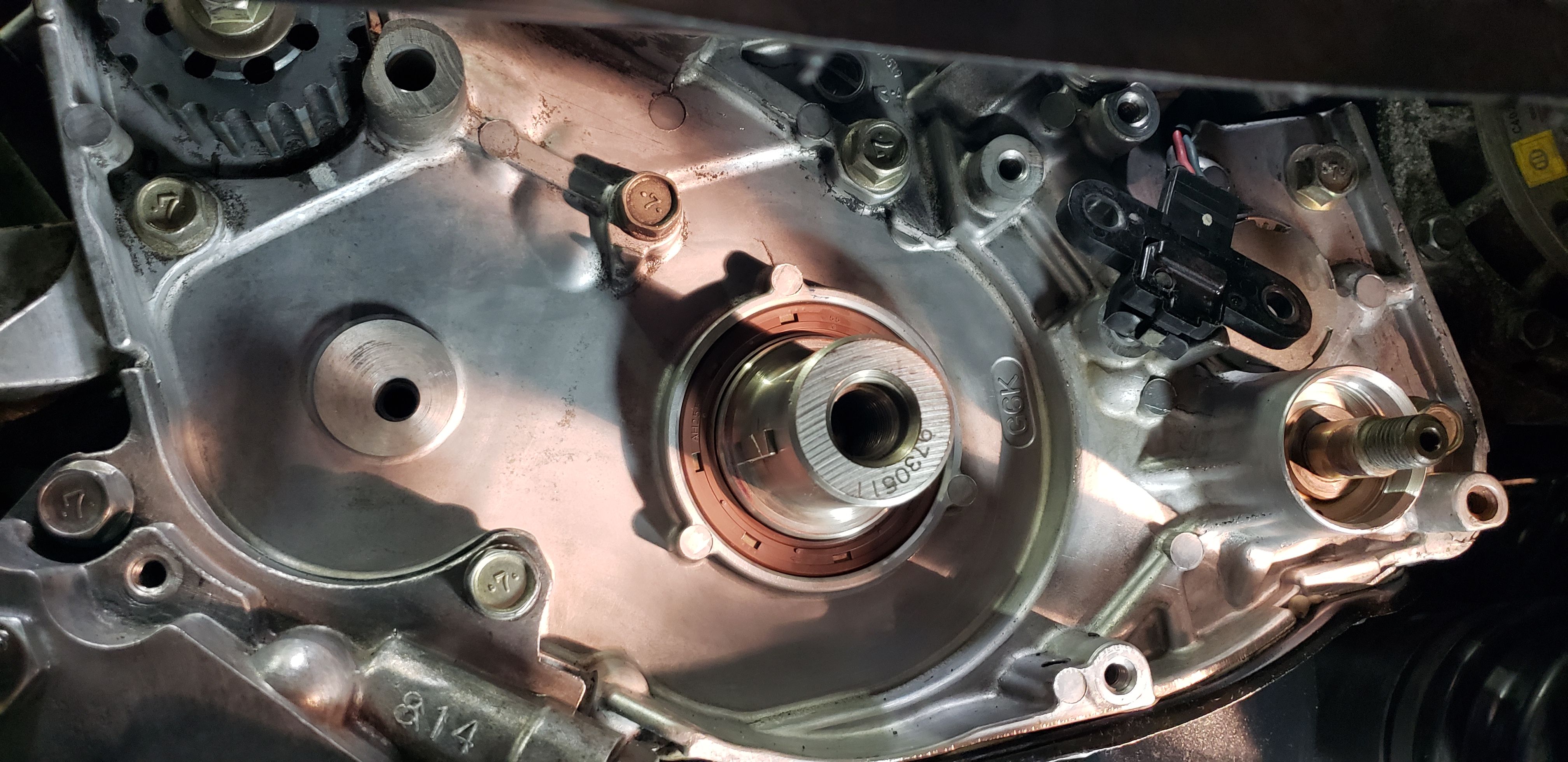

Spent some time cleaning up the front case and changing all of the seals with new OEM.

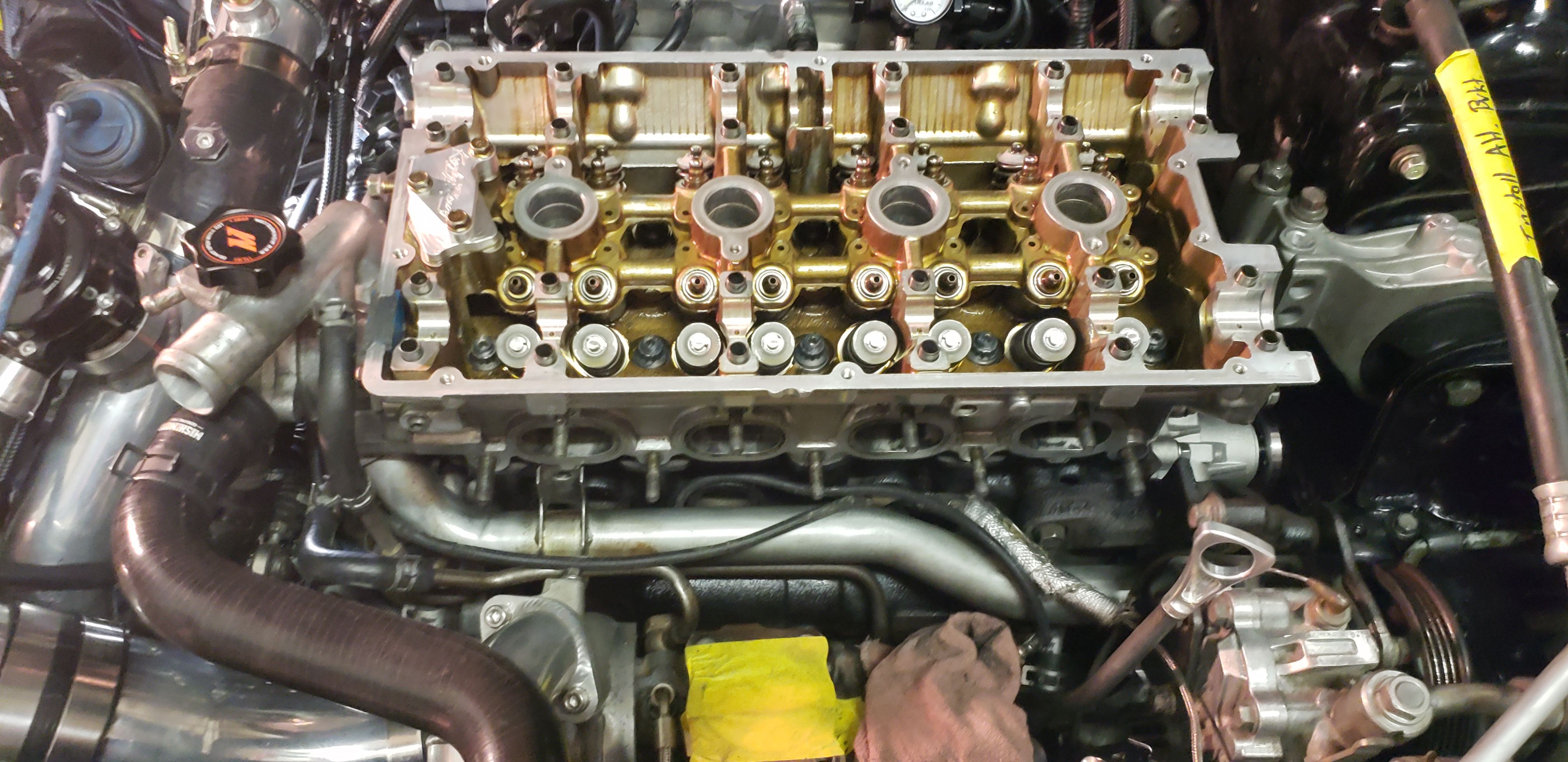

head is now off
Block all cleaned up and ready for new OEM composite gasket. New A1 H11 headstuds and new OEM water pump

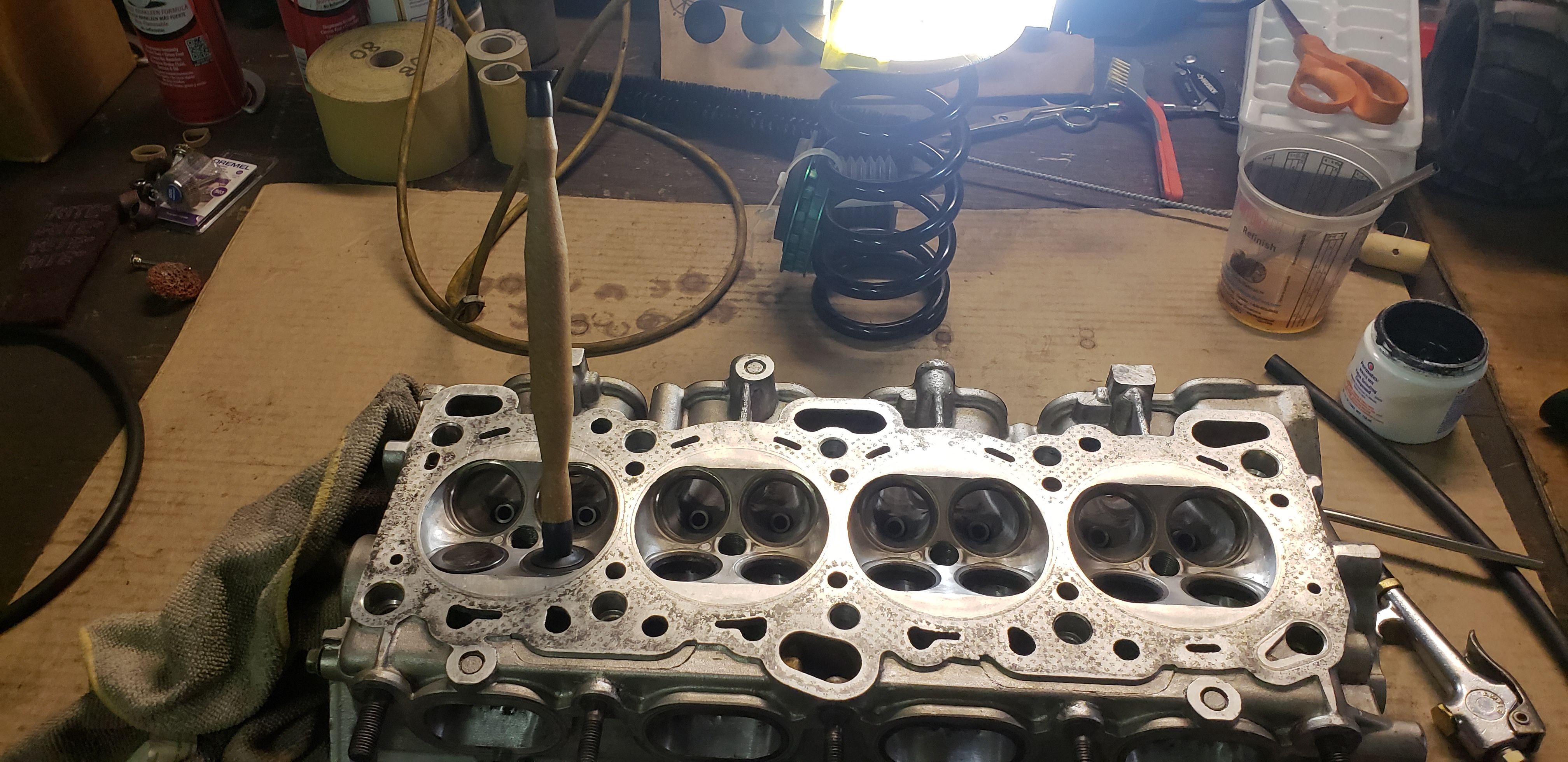

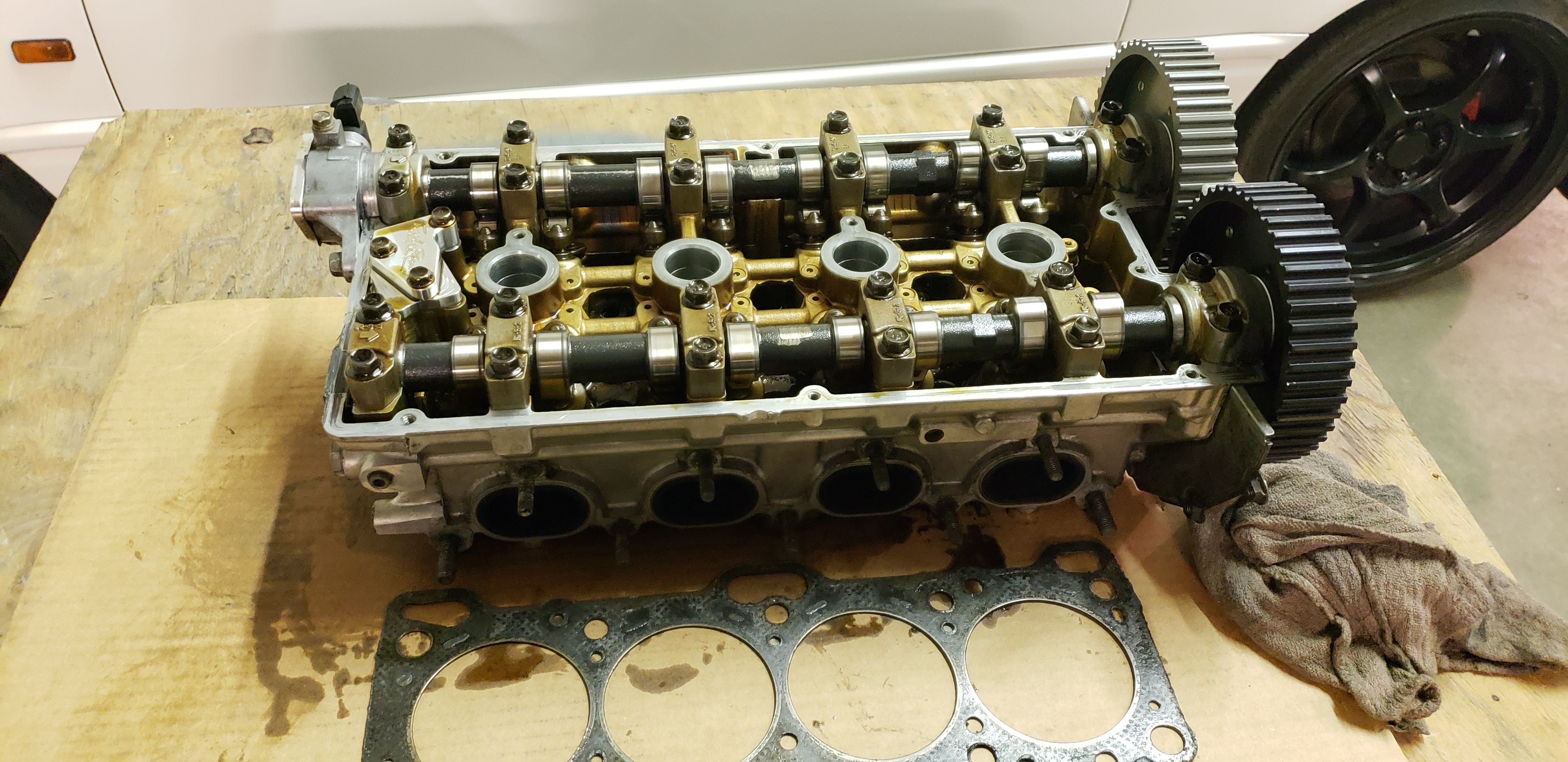

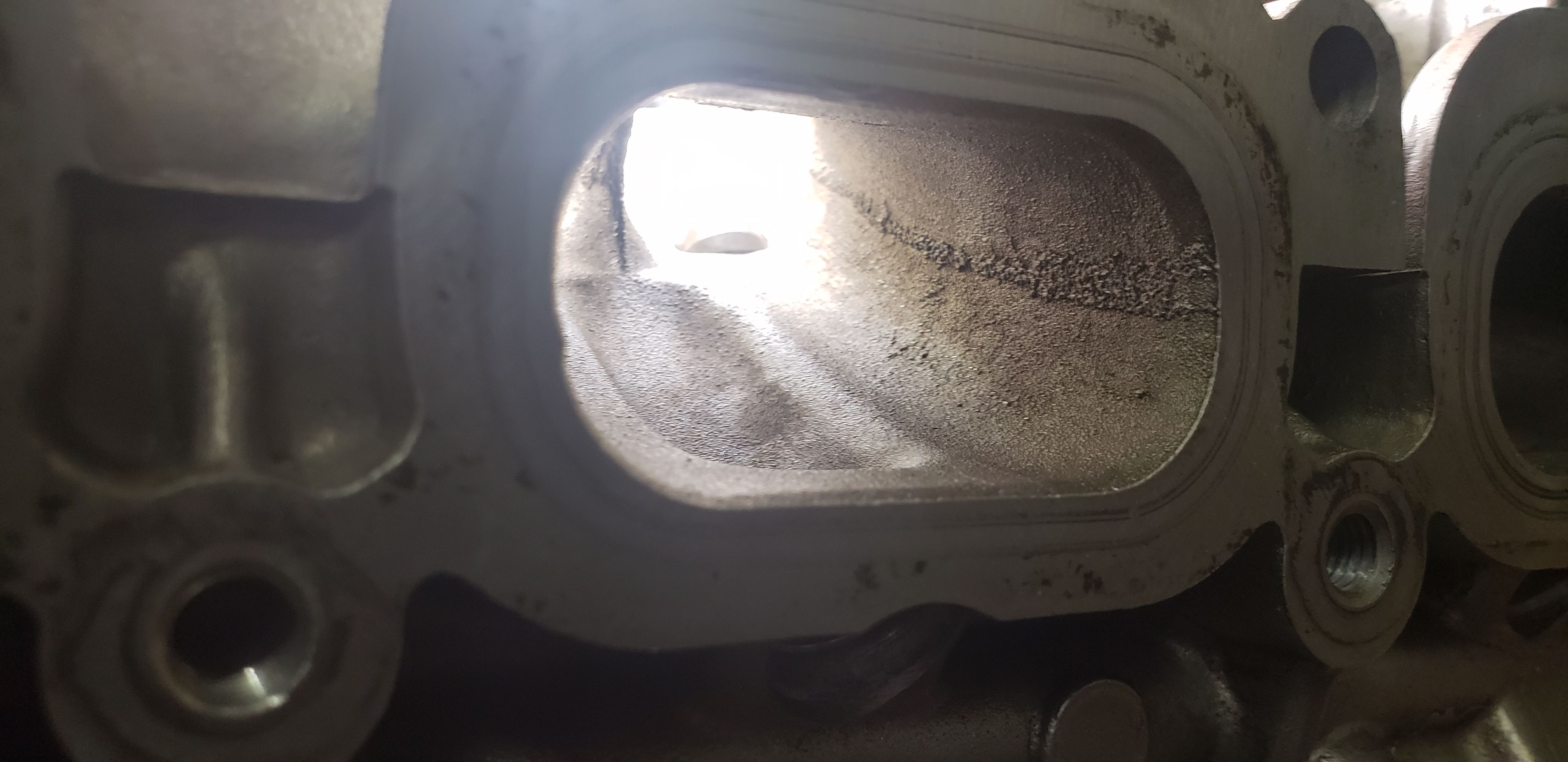

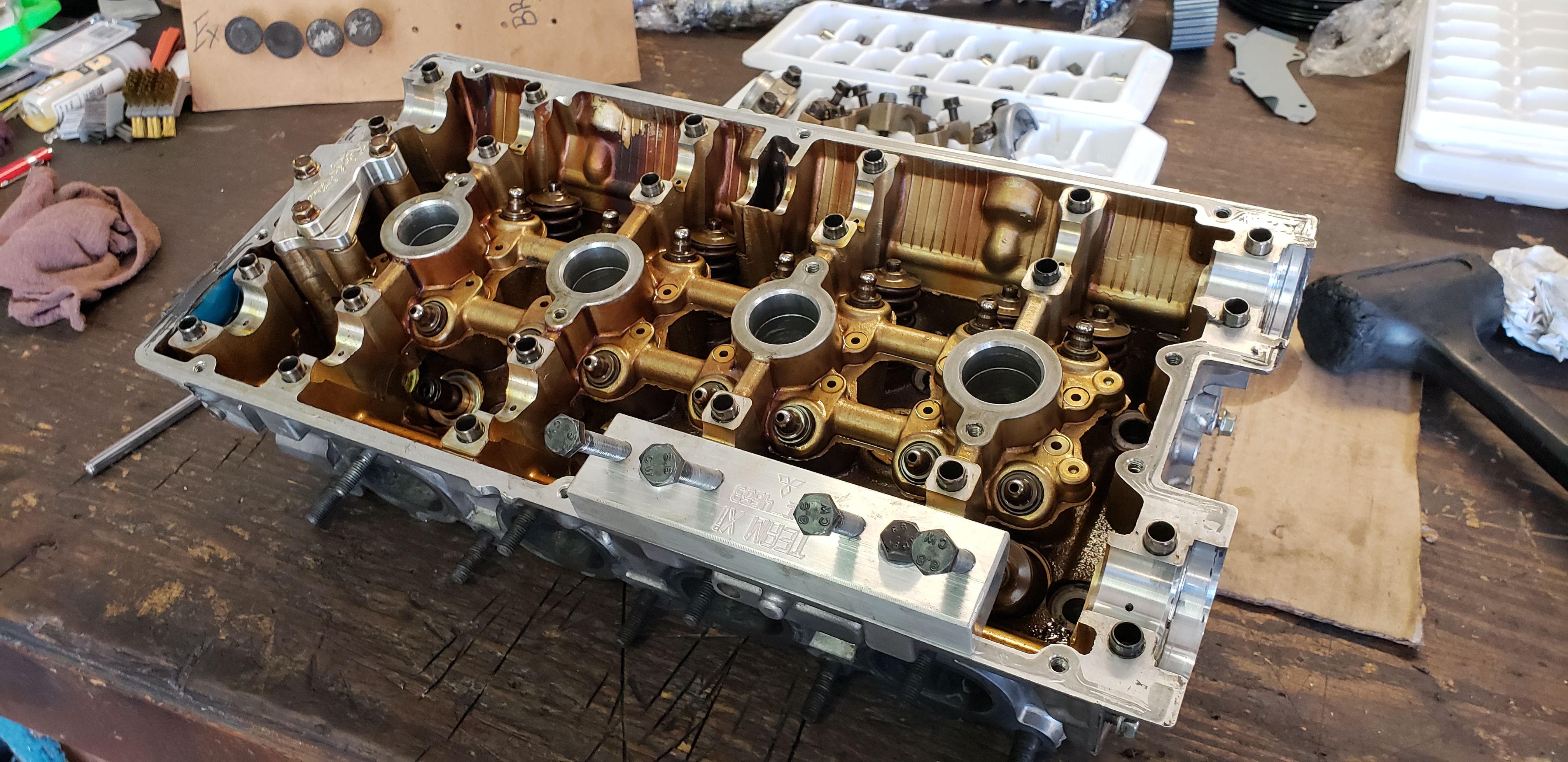

Decided to do some work to the head while I have it off

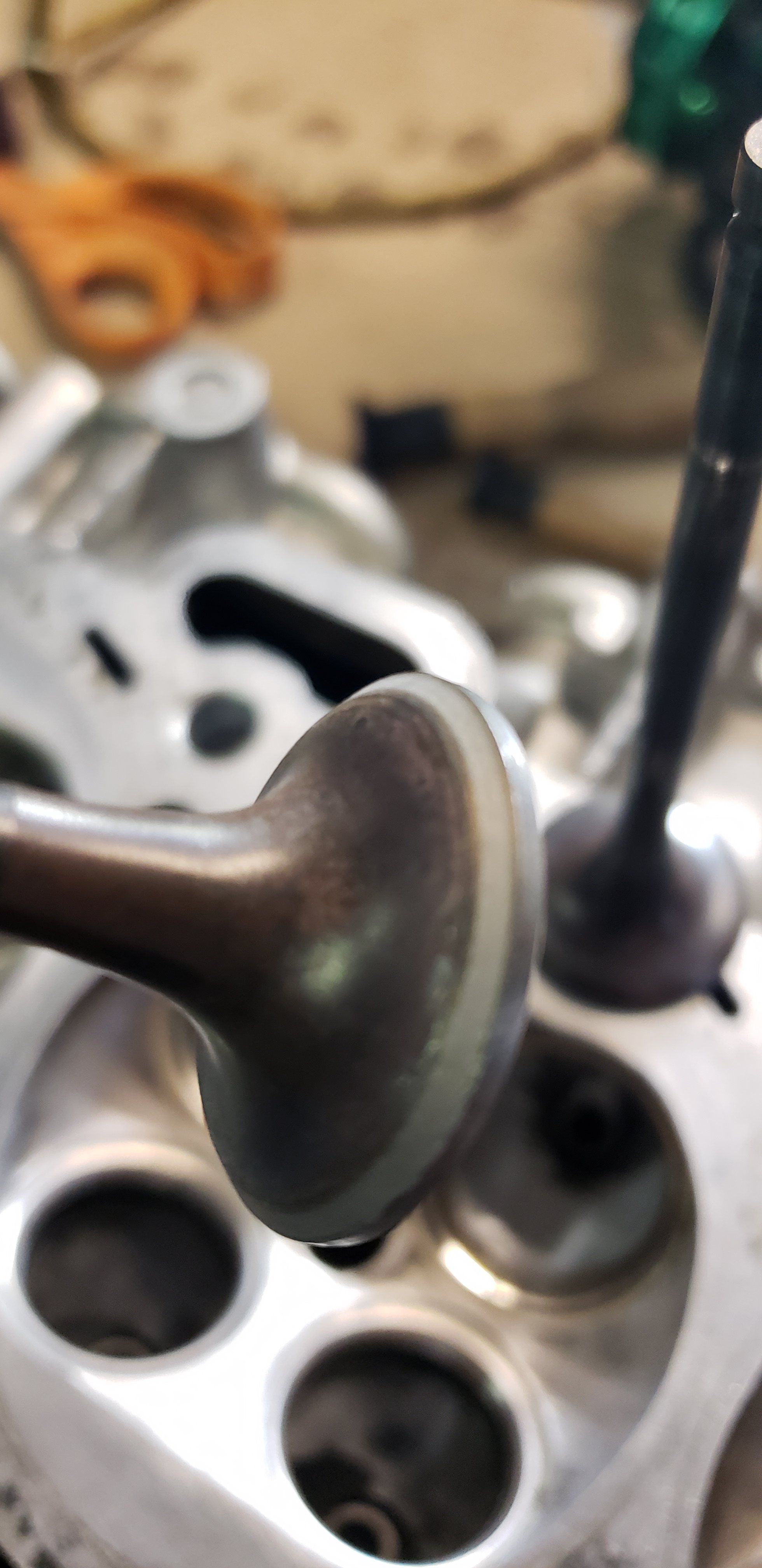

Mild port job. Removed all casting flash
Lapped all valves and tested seal

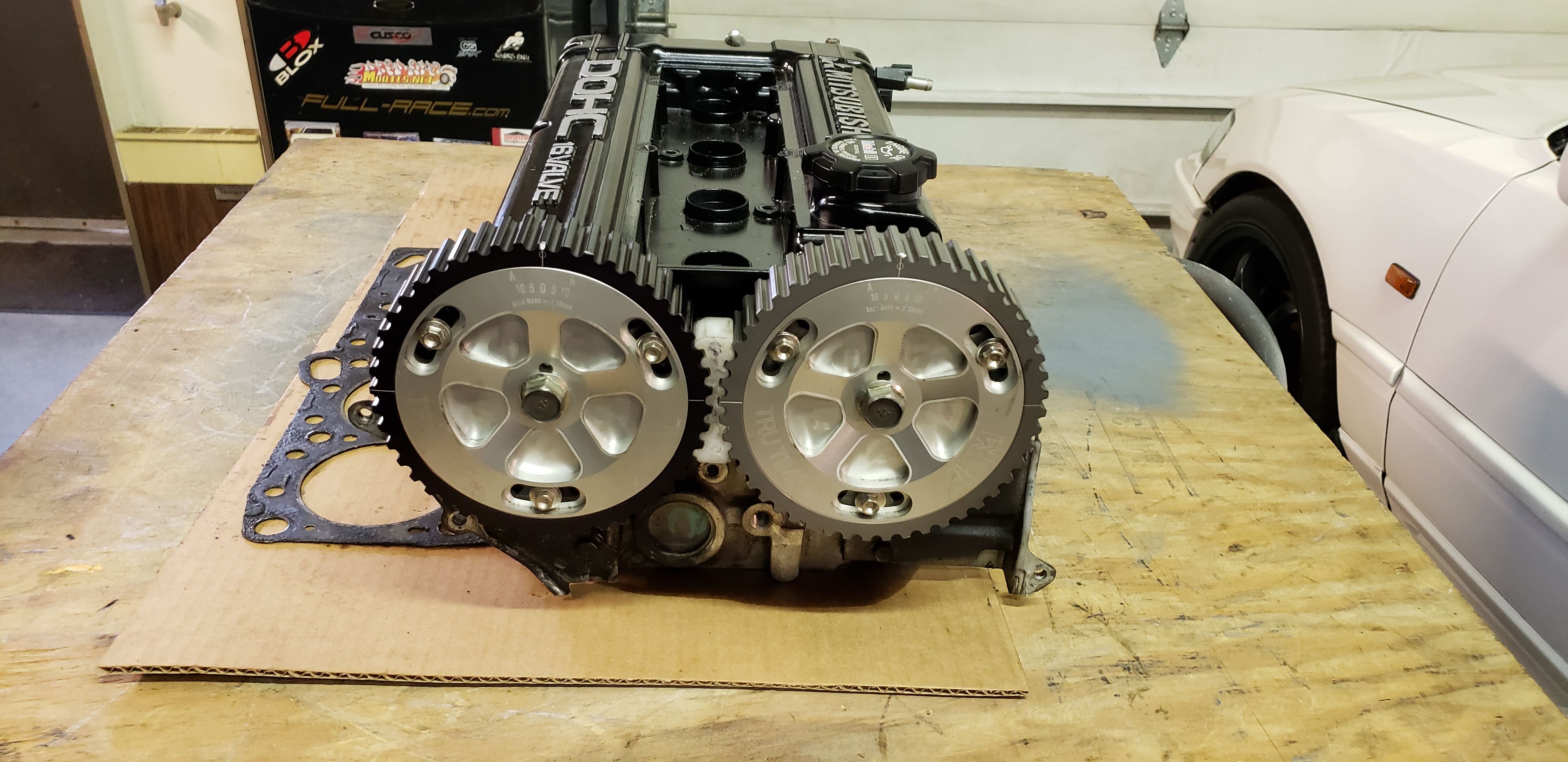

Dropped head back on with evo8valvesprings,retainers and keepers, 3g lifters and a Kiggly HLA.
HKS 272s
all back together with new oem parts. I love to see a spotless timing case like this.
Evo9 Kevlar Timing Belt

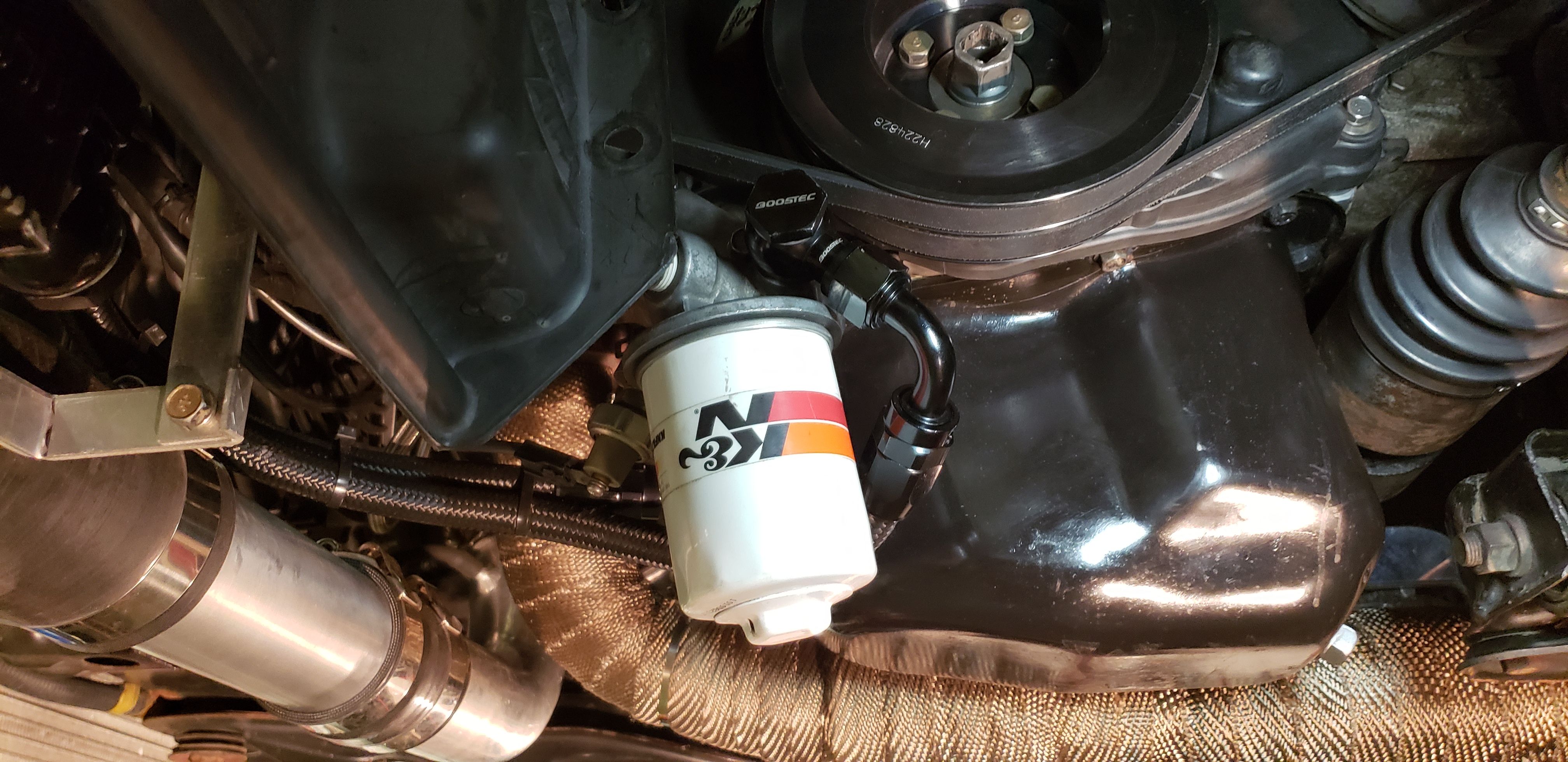

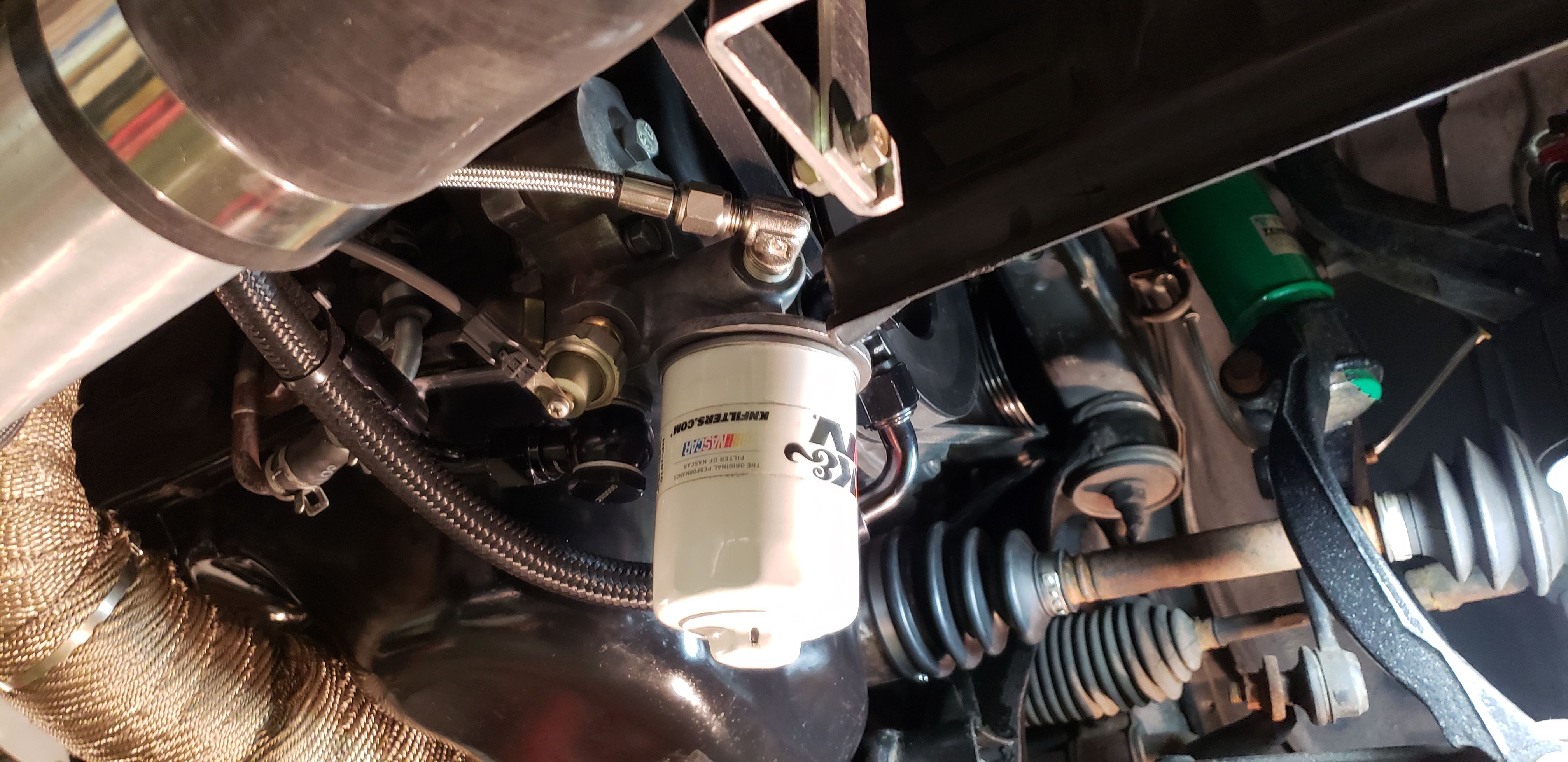

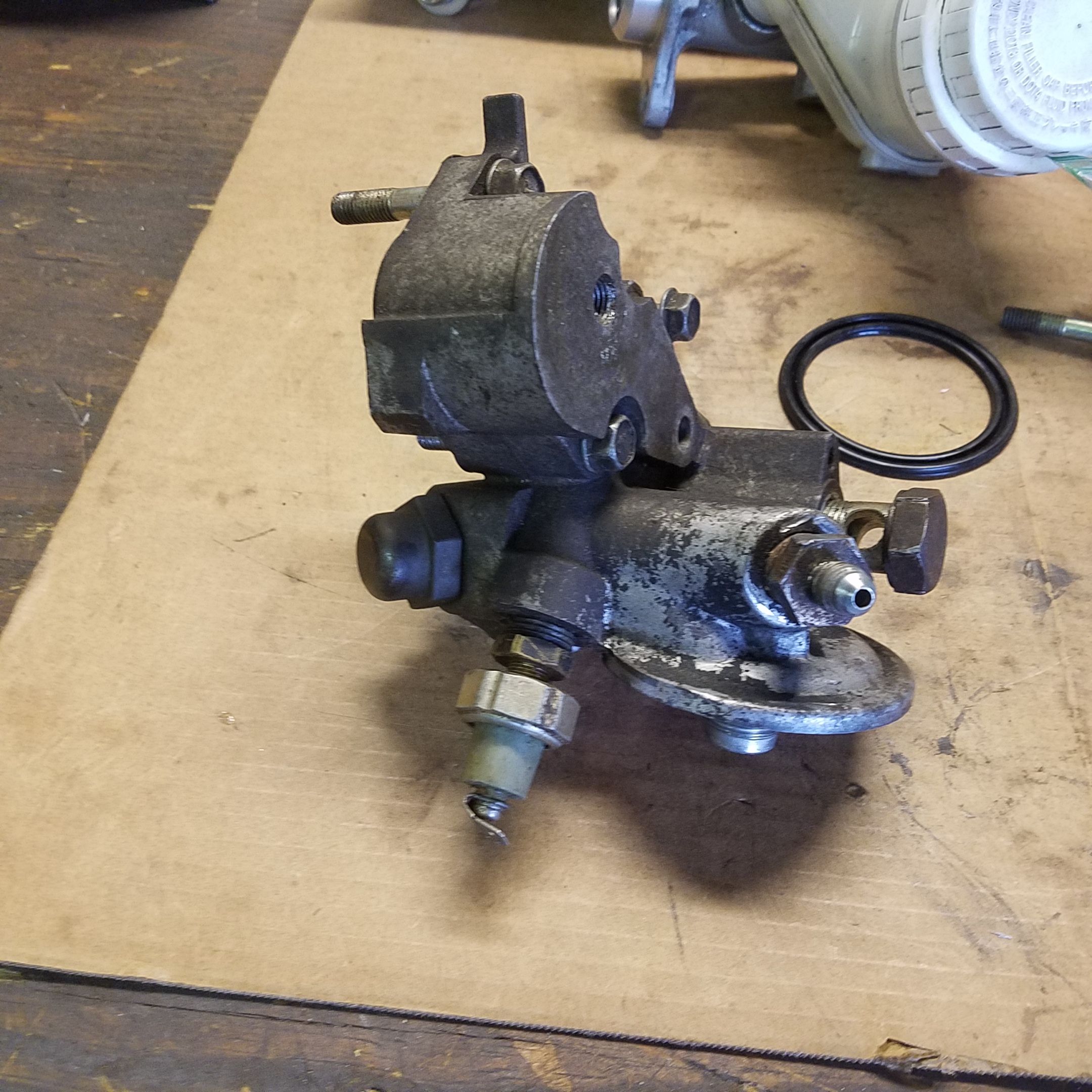

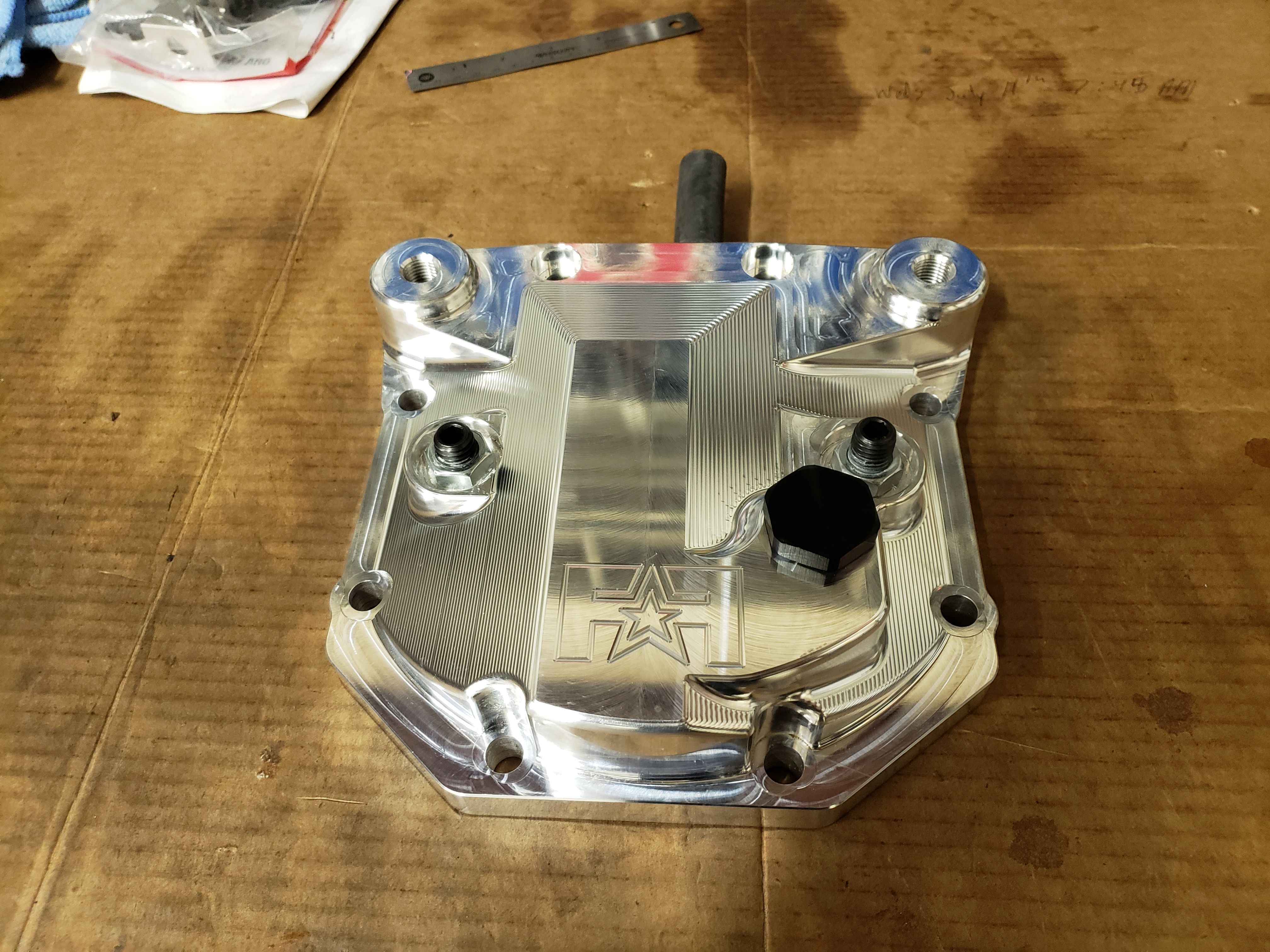

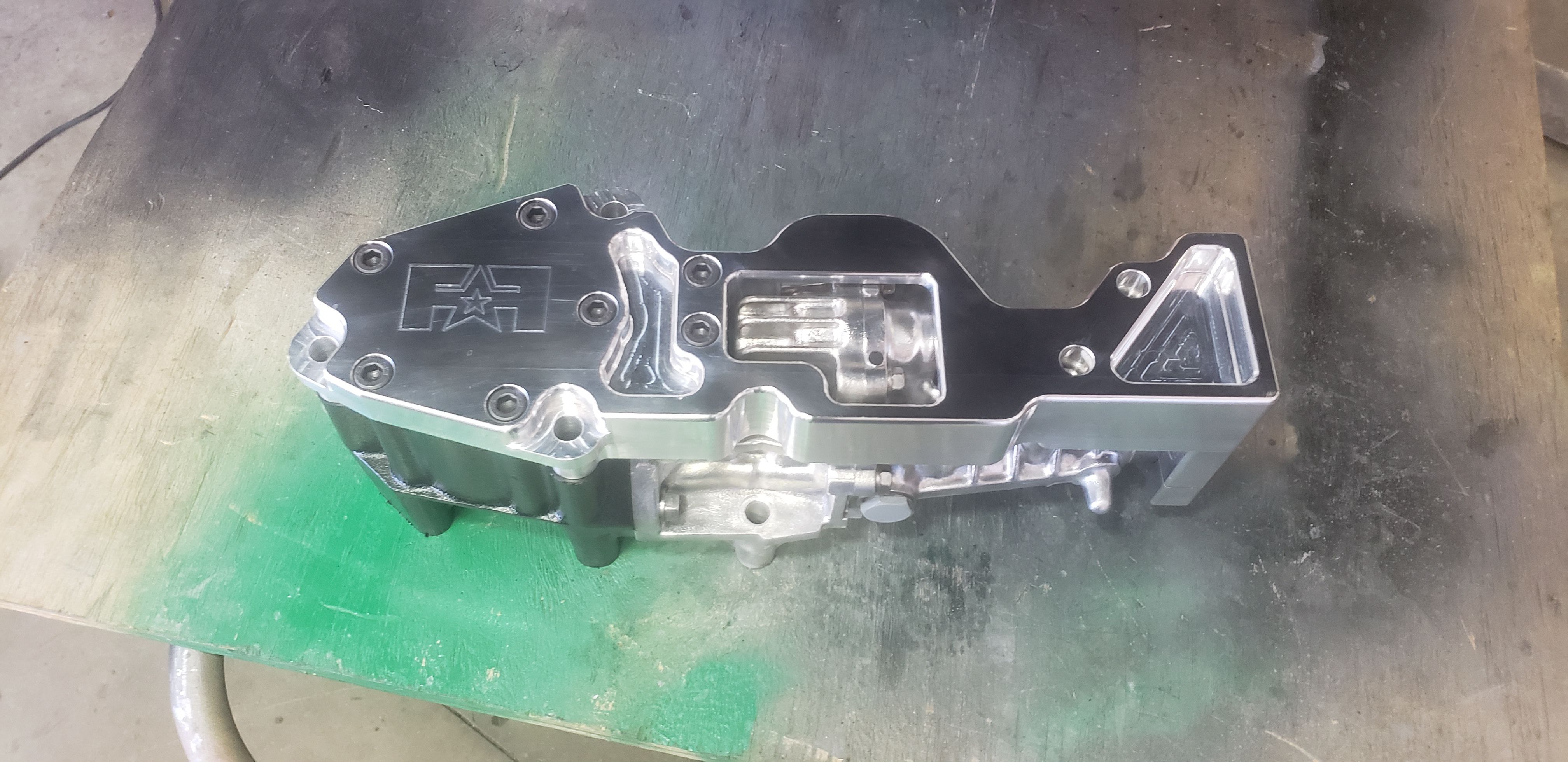

Heres a few shots of the evo8 oil filter housing/ oil cooler install
I used low profile banjo fittings so the factory splash shield would still fit without rubbing anywhere

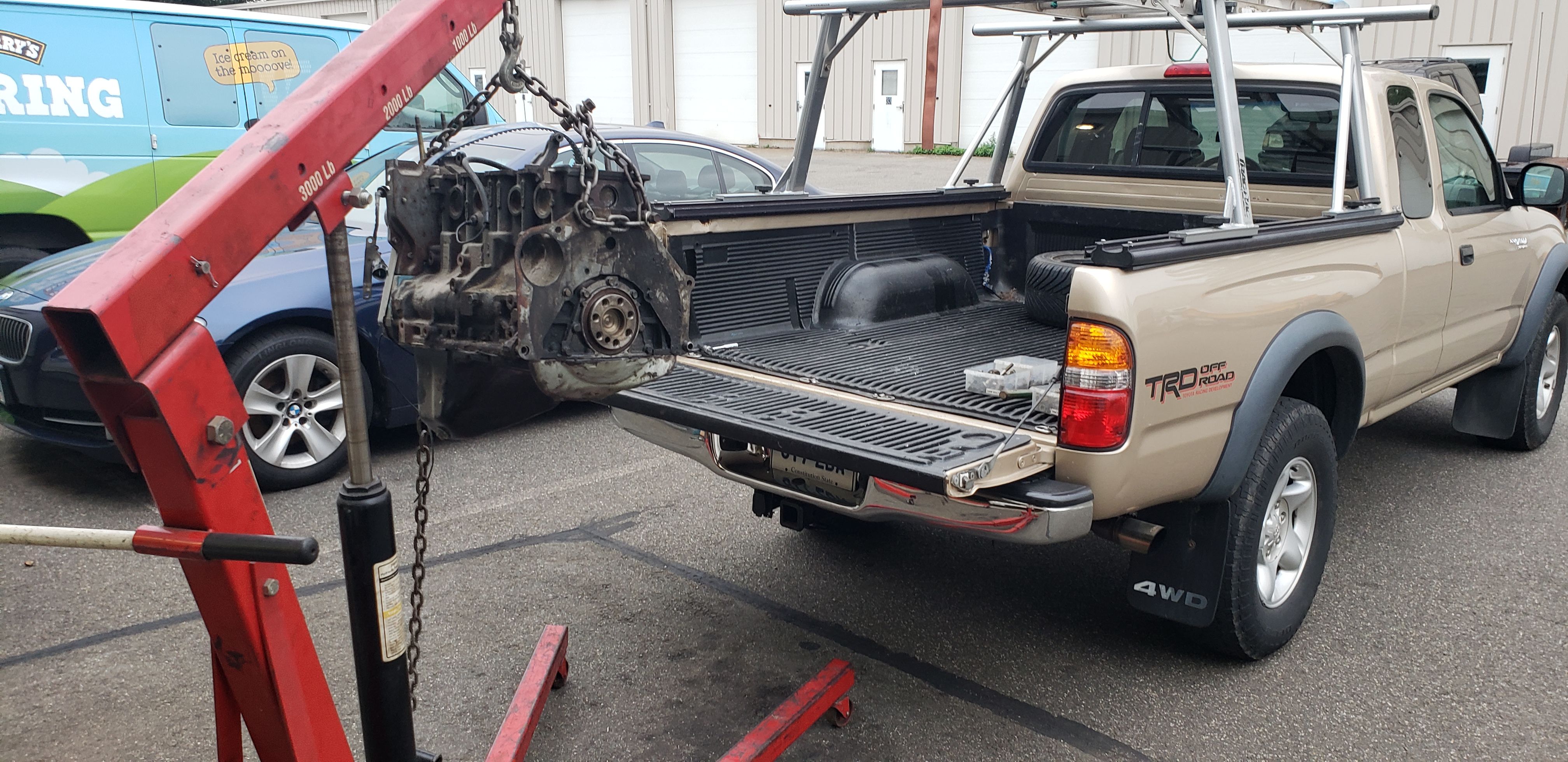

SC for TacomaView attachment 571842 These are the calipers that went in the GSX last year

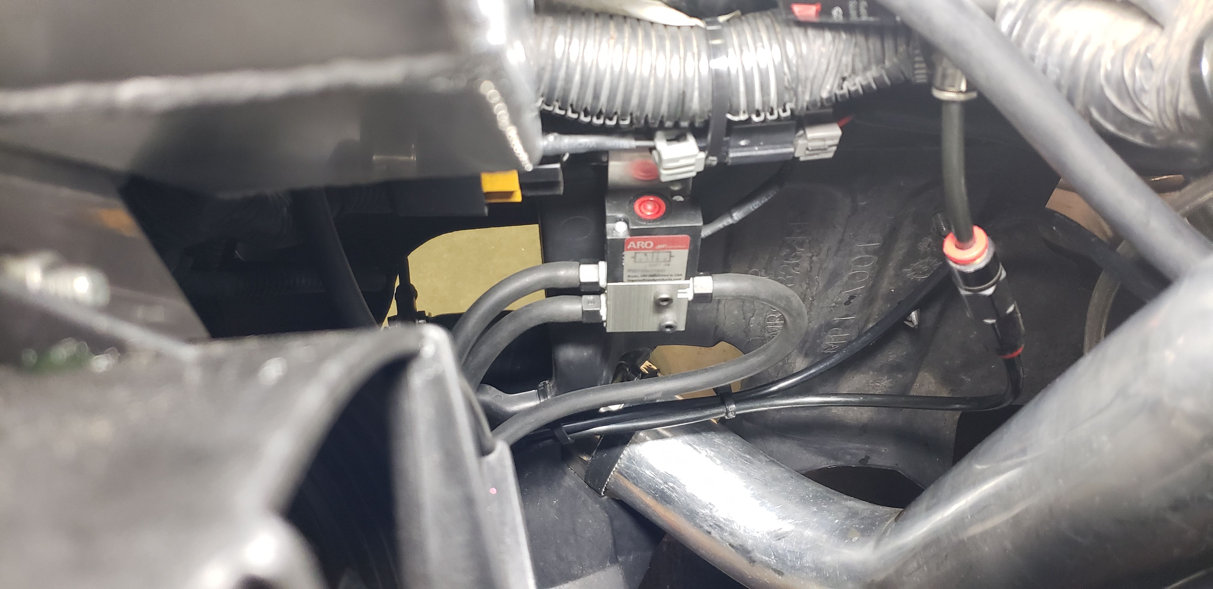

IR Boost Control Solenoid

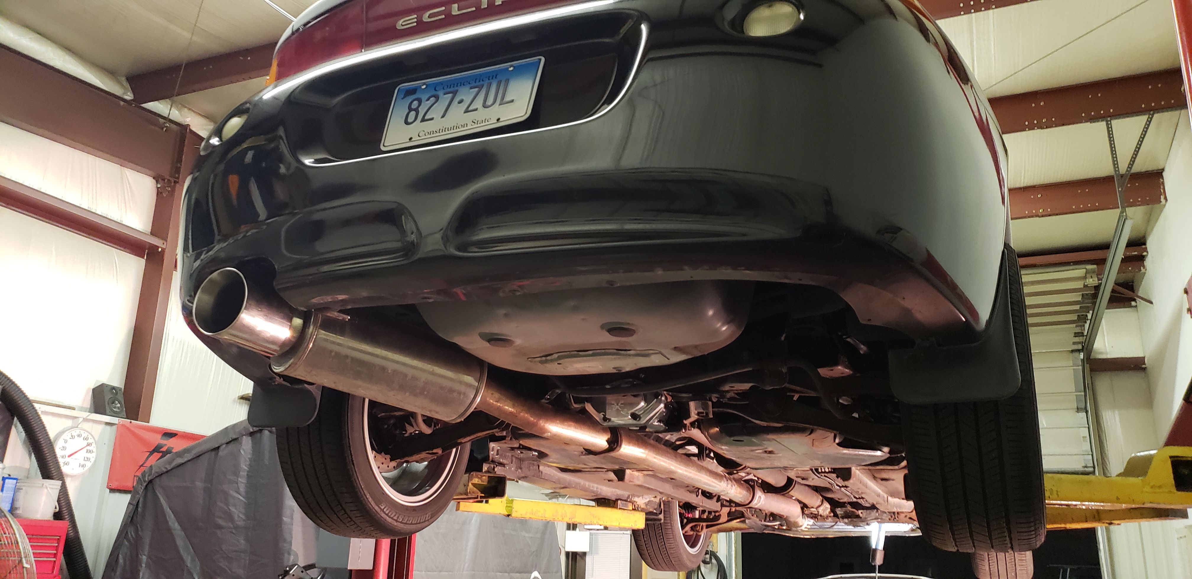

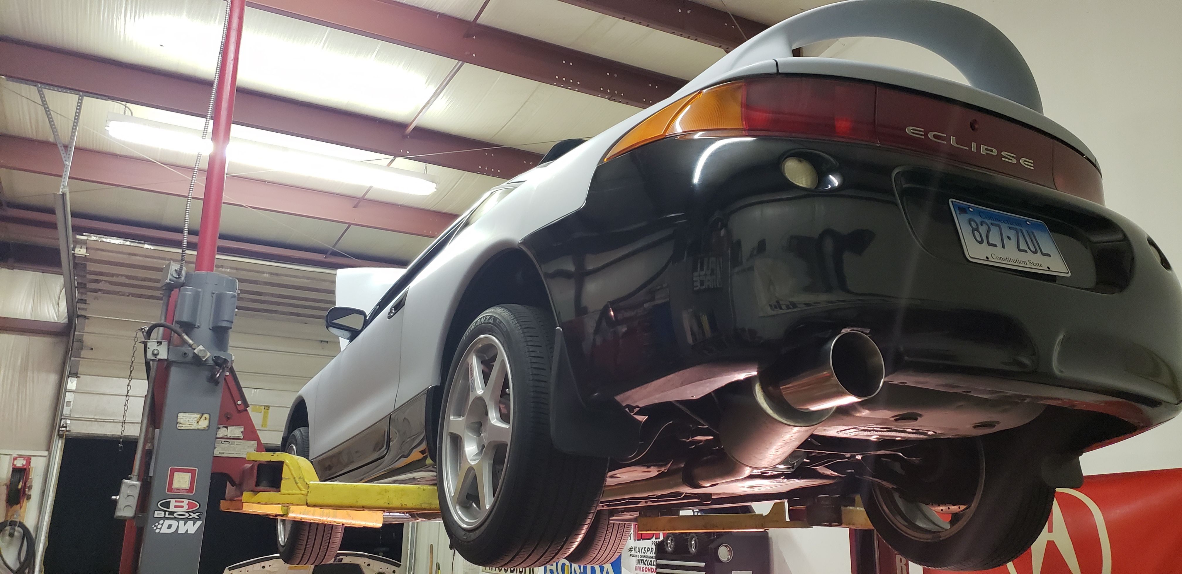

- install a cat back setup with a cat (which I had to weld up the other night so it will bolt to my 3'' downpipe just so things dont get too crazy as far as what I have to do exhaust-wise)
