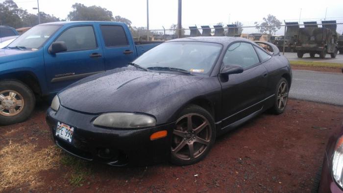

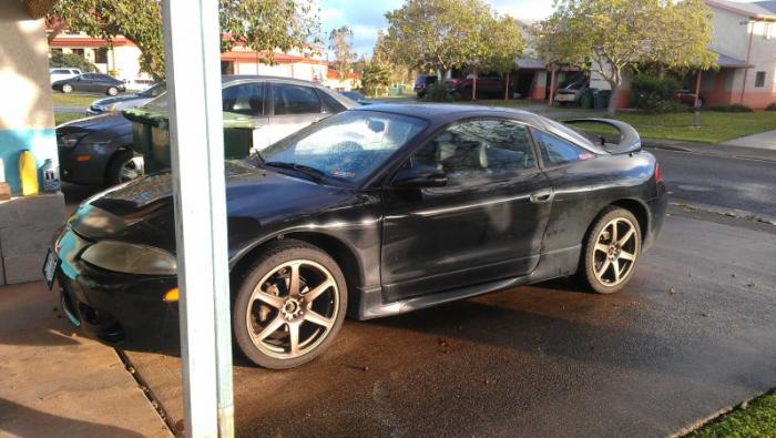

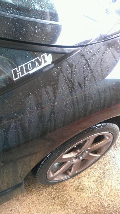

I have just traded my Red 95 GSX for a Black 98 GSX:thumb:
I have no abondoned or changed my Project Redsun goals or ambitions except for body restoration. I will no longer need to do a partial or full 2GB conversion with highrise spoiler. I will not be doing a hardtop conversion. Instead I will be getting paint repair and rust prevention.
Basically heres what went down.
Last night I met up with a fellow DSMer whom I was waiting to purchase this 98 GSX from. He babied this car, which is all stock, he recently had all the interior redone. This car is very well taken car of. He sold it to a sailor on pearl harbor who didnt really have a full graspe of what kind of care these DSMs need. So I sought out this new DSMer in hopes they would trade me. His and my opposites were in tuned. He wanted a beast machine capable of high horse power he would only drive on weekends. I wanted a stock fully restored DSM I could slightly dip my toes into the world of Gymkhana with. I traded my faults for his faults.
My leaks for his leaks. My bodywork needs for his rough idle. My bigger turbo for his stock turbo. This was a straight trade involving no money. We even became friends and I aggreed to do work on the car if he needed help because lets face it. Shops dont know crap about these cars!
But enough of me yammering on! The project name hasnt changed, which in a few months you will see why it is called Project Redsun. The goals are the same. Just alot of the work is done for me which is fine.

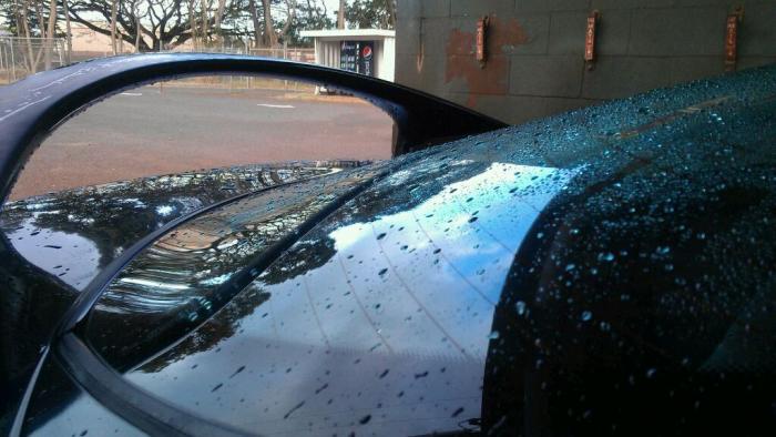

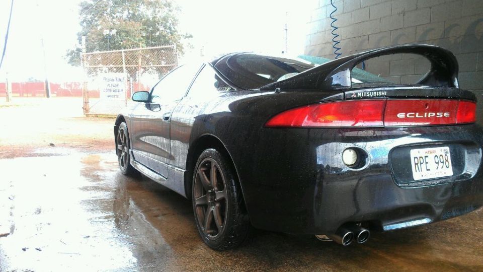

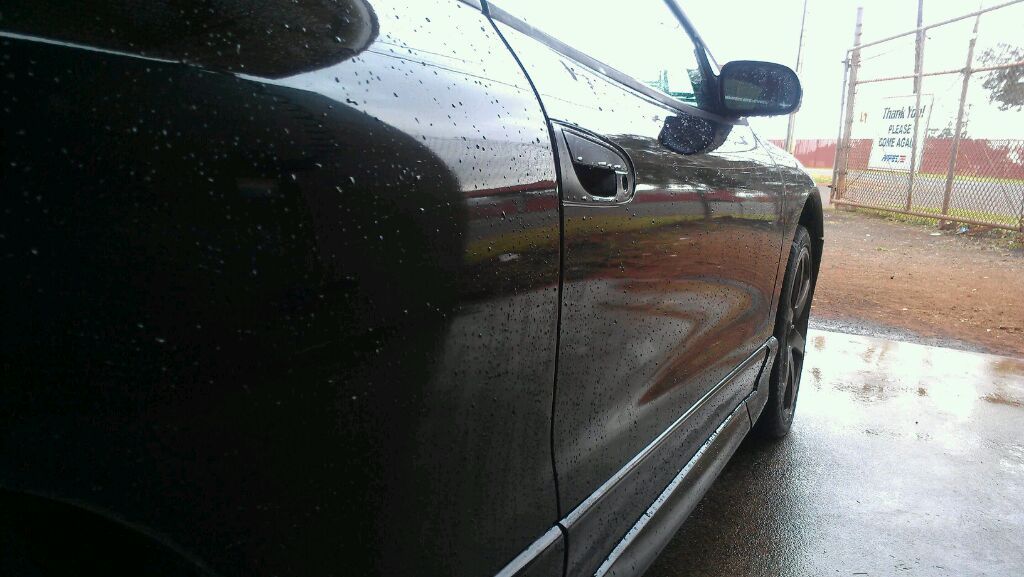

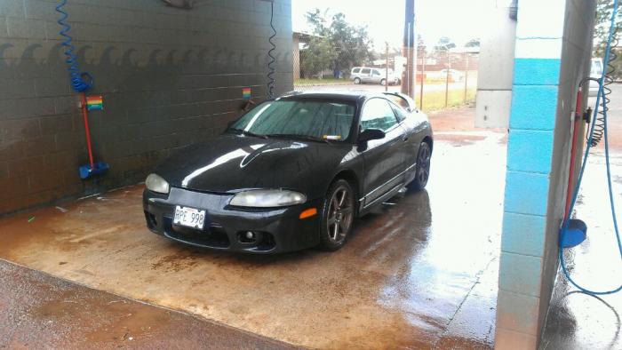

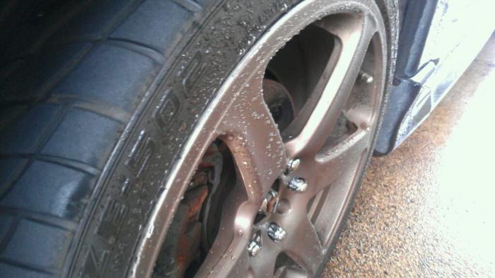

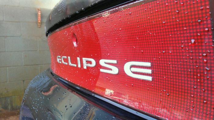

Keeping your dsm clean and tidy is not only our obsession but it is also apart of our general maintenance. No only does it keep our girls sexy and sleek, but it helps prevent paint damage, fading and our biggest enemy... Rust.
A good maintenance schedule is nothing without frequent cleaning, and detailing of our disappearing beauties. Remember to wash, wax and clearcoat protectant as often as you so can, and as much as you fight it. Don't. Yeah I may seem a bit obsessive washing my DSM every 3 to 4 days but. The end result... Well... See for yourself

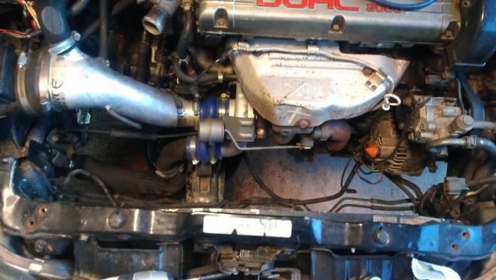

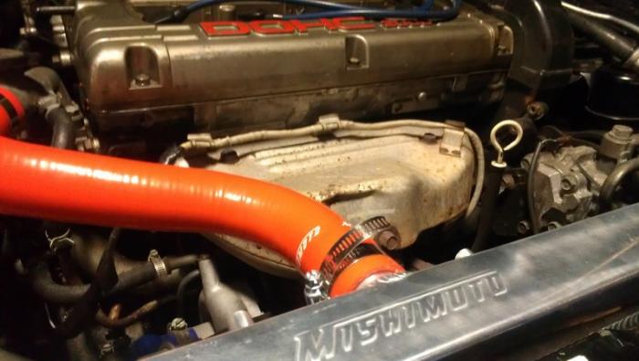

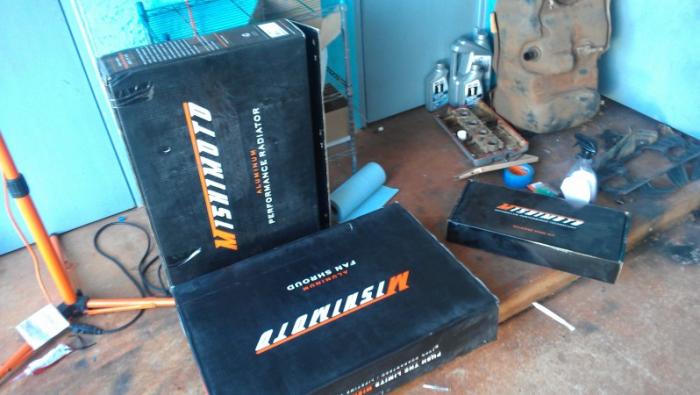

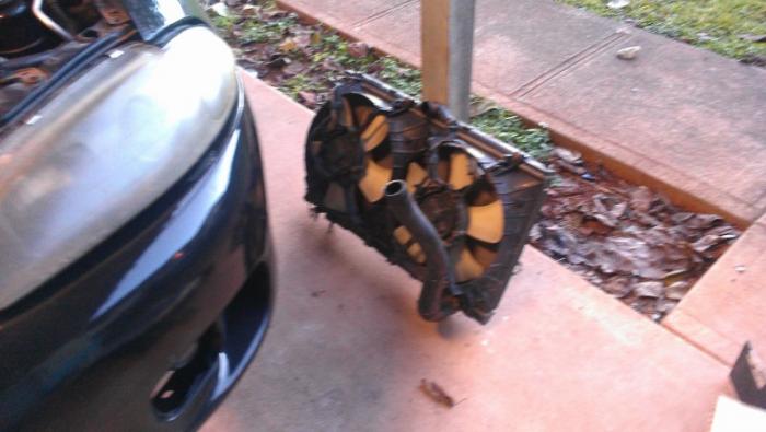

Installed - Mishimoto Aluminum Radiator,
Installed - Mishimoto Fan shroud kit,
Installed - Mishimoto Silicone Radiator Hoses Received -Mishimoto Street Style intercooler (Black)

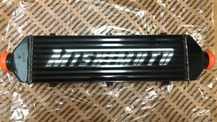

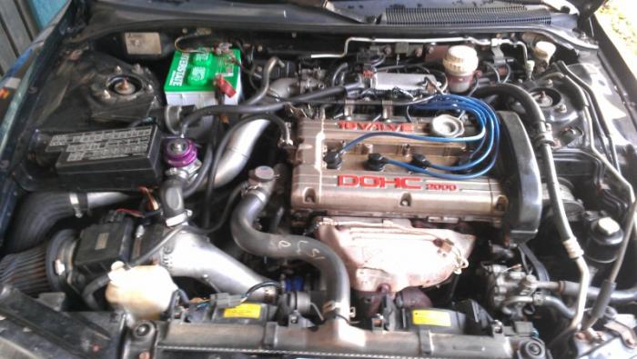

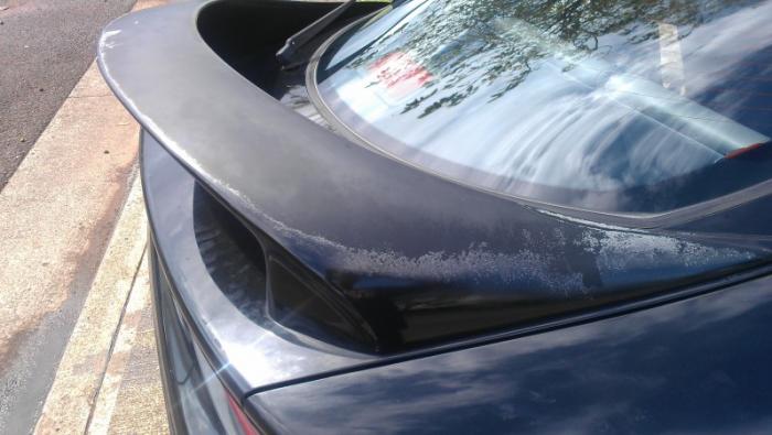

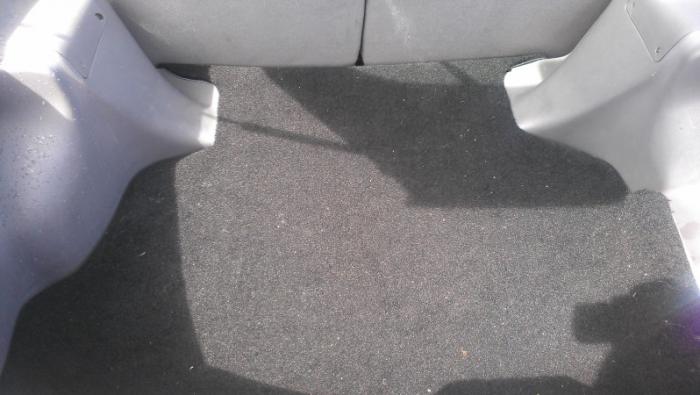

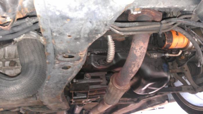

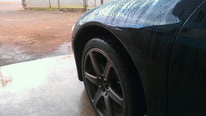

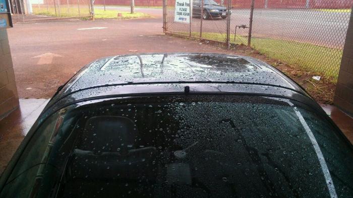

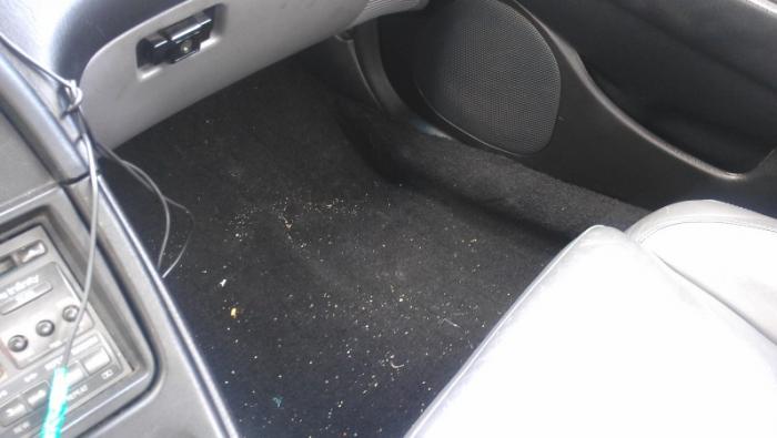

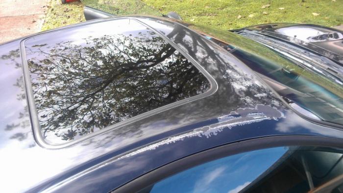

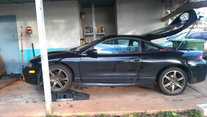

So I traded my lightly modified 95 GSX for a completely stock 98 GSX, which has a nearly flawless body along with the 2GB body style I’ve long awaited. Leaving the older 95 2Ga GSX was one of the better decisions I’ve made in my time with DSM’s. It was argued in the forums that 2Ga’s should be left 2Ga’s. I’m not too much of a fan of the 2Ga body style, but I have enough respect for DSM’s to leave it alone and no “butcher” a perfectly fine looking car. Anyway aside from that I’ve decided that within my exterior portion of the restoration Achieving the 2Gb body I want was very successful, and I’ve also decided to NOT do a hardtop conversion. One of the main reasons I wanted a hardtop 2Gb is because rust always likes to form on the sunroof assembly. In this cars case, there is no rust or signs of rust on the sunroof assembly, and as long as I continue to take care of that general area after heavy rain or washing I should be fine. Sunroofs add a nice accent to the car I must say. The only thing left for me to do with the exterior part of my restoration is to fix the sun damage on the roof and the high rise spoiler. This shouldn’t cost too much or be too hard.

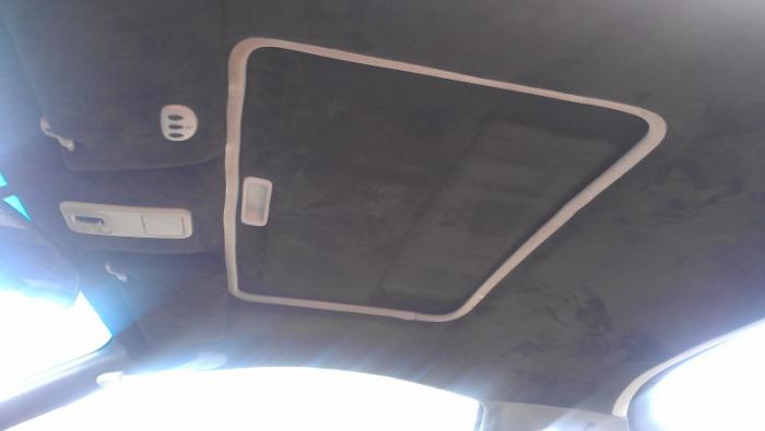

The interior of this car is spectacular. Not only is it very clean and well kept, there’s no sun or heat damage inside the car, all the body panels are present and undamaged. There is is new black carpet all the way to the truck space, and new black suede headliner which adds a nice touch to the GSX. Along with the inside the car features the OEM stereo/CD player. Of course it is in lockdown mode and I haven’t had any luck with contacting Mitsubishi on getting the code for it. This weekend when I open up the interior panels and check my ECU and electronic equipment I’ll see about getting the unlock code. I’ll be leaving most of the interior alone since it is in such good condition but I will be replacing the sets with black leather racing seats and adding my listed AEM gauges and other electronic mediums inside (Future updates)

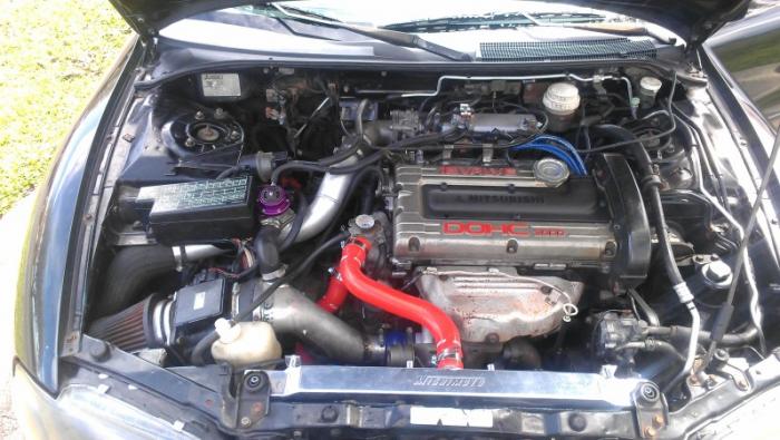

The engine bay is well stock. Except for some upper hard piping and a Authentic Greddy Type S BOV, which the adjusting bolt stripped when I was adjusting. But that’s okay hopefully my NGR Type S will be here soon ( Will I ever get my NGR Performance BOV? ). I plan on upgrading the turbo with a true bolt on with performance in mind T28 Turbocharger. I also plan on either using my Mishimoto FMIC or another SMIC for the 98 GSX. My current SMIC has a hole in it I’ve repaired with Aluminum Epoxy. It was a quick fix at a gas station but seems to be holding well, and was the source of my boost leak. I could possibly still be leaking boost which might be the reason my boost isn’t “knock you in your seat powerful” or it could be the very stock T25 turbo I currently have on there. My DSM isn’t the fabled 98 GSX I’ve read about on the forums so I am a tad disappointed but then again. Power wasn’t meant o be purchased outright, you have to work towards it. I am at ease as my engine bay is free of tangled unorganized wires leading to nothing, and missing components here and there. I have NO LEAKS. This is a first for me in any used car ESPECIALLY a DSM. Unlike the other GSX I’ve found nothing wrong with the vacuum lines except the ones leading to the WG. Thanks to John over on Big Island I was able to do the BCS mod. Although my car isn’t running right now because of a fuel pressure solenoid (Did Seafoam kill my car? )
My Exhaust system is stock as well. I have no idea really what kind of system I will be putting on this beautiful machine, but I know I’m not going to make the same mistake as to getting a 3in straight pipe system with Apexi turbo back muffler ( Rally Exhaust? ) I’m more so considering a 3 in downpipe, 2.5 in Piping with a resonator and HKS turbo Muffler or Apexi. I feel like with this setup I won’t hear the annoying sounds I hear from Hondas. But all of this costs money which I am no unfortunately short of. Hell my car doesn’t start because of a fuel pressure solenoid and I cant really afford to fix that because of the lawyer fees I’m now paying from a Racing on highway charge and speeding above 81 MPH ( Need a Jailhouse Lawyer ). But I’ve been getting a lot of help from my friend John over on Big island and without him I would be up a creek without a paddle. After all of my legal troubles are solved I’ll continue full speed with Project “RedSun”. You all are probably wondering why I’m still calling it “RedSun”. You’ll understand in either the next project update or a very near future update from me.

Mishimoto Radiator and Fan Shroud installed

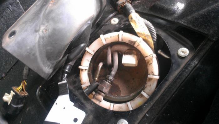

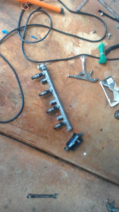

After recent events concerning my fuel system. My car sustained damages to the stock fuel lines leading from the tank to the filter and rail. After some simple "DIY" testing I've concluded that a near full fuel system replacement and upgradeis in order. After further discovery I found my OEM fuel rail was being held on by only 1 fuel rail bolt and spacer. This was a scarey discovery, even though it was on there pretty solid. Definatly not the safest thing to find and know in the back of your head so.
I complied a short list of things I'll be needing for this much needed upgrade and replacement:
(4) 450cc Injectors (OEM)
8 - 10 ft of -6AN SS fuel line
Inline Fuel Filter
(2) Fuel Rail Spacers
(2) Fuel Rail mounting bolts
Walbro 190 LPH Fuel Pump (Kit perfered)
Hopefully as long as the finances work out I can requsition most if not all of these items from here:
STM Fuel Tank to Rail Kit
DSM parts Walbro 190 Kit
Spacers
Rail Bolts
I considered going with STM's double pump hanger kit but its insanely expensive and I wont be needing a double fuel pump setup for the low HP numbers I will be going for eventually. And I do not really like purchasing parts from vendors solely based on thier prices and the recent lack of shipping ability by them. The injectos I can get from my local autoparts store of used from a donor car. Although a fuel system upgrade isnt something I wanted to do to this scale its not needed more than ever in light of recent events. Hopefully I can find these specific parts elsewhere, especilly if I can get these parts locally from shops or parts stores on Oahu.
I had the hardest time getting all the lines off of the the stock fuel pump hanger in the RedSun and ended up with the beginnings of a stripping nut on the hardline end of the fuel line to the rail from the tank end. I just called it quits at the moment. If I end up breaking yet another hard line its going to cost me more money. Visegrips and the plathora of tools I have at my disposal did nothing to ease this removal of the old stuck lines on my car. But another day further down the rod might see an easier way. I've considered the possibility of just replacing the whole assembly all together.

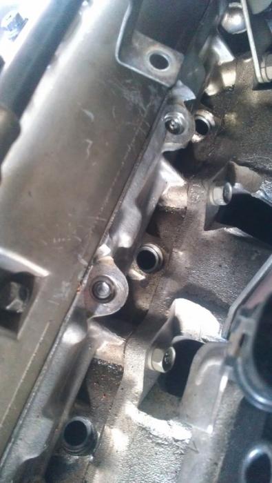

Made a huge discovery today. The redsun may have had a slight fuel issue but it would start because of the simplest thing. The timing was off by a tooth. I ask myself how could I have checked the timing after following the how to diagnose a no start guide and reading it over and over again? Simply I did read it correctly but for some reason while reading the how to article I continued to perform the action of checking my timing incorrectly. I know there is a term for it, almost like when you know you locker combination but continuously input it backwards LOL.
Well thanks once again to the best DSMer around DSMkaui. He quickly pointed out where I was essentially f*ckin up. Now I know what needs to be done. A full timing job. And it doesn't stop there. Since I'm gonna have it all apart I'm going to finish the completion of my cooling system upgrade with a new water pump. If I can find the money todo so ill problably consider an oil pump as well but there goes an old saying. If it ain't broke... don't fix it.
I have options that I must alone deeply consider.
1 Take the redsun to the mitsubishi dealer and have an OEM full timing job done and over with. Warranty and peace of mind.
2 Have a more experiance DSMer do the timing job for me. Peace of mind and a chance to watch a veteran of the 4g63 motor up close and personal.
3 Complete a full timing job myself. Learning experiance, possibly a downtime that would double the amount of a more experianced professional would have. Not as much peace of mind but a sense of accomplishment.
All three options are good ones. Its a real eye opener that something so basic and key I myself didn't do correctly. Although it has me questioning my mechanical ability to complete the redsun without harming her anymore than she already is, I have enough faith in myself to push forward through this as quickly, safely and logically possible to get this dsm back on the road and back to the prestigous condition it deserves to be in!
For now my goals still stand, the upgrades of course will wait. The PMs will continue to come first and foremost above anything else. And when it is done. You will know. Tomorrow I get some qoutes and make a descision that will lead to the next update.
I wanted to add something. An apology to all the dsmers out there who strongly suggested timing. It shoulve have dawned on me that I was checking the timing incorrectly sooner and it didn't even after all of the tell tale signs of timing were there. I owe you guys something and the best thing I can do to make up for it is to get the redsun running like its new and continue this restoration rightly.
