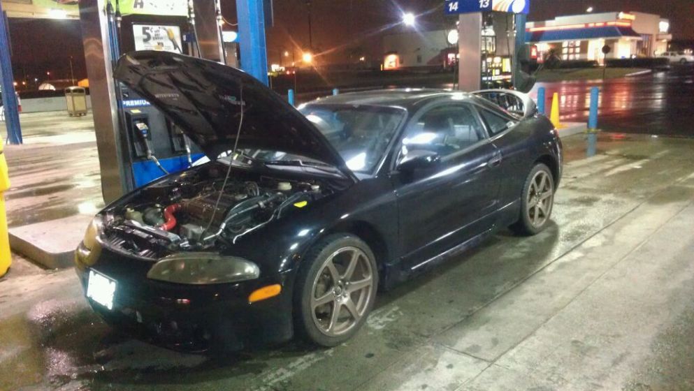

Still working out some kinks. Especially with the idle. Possible vacuum leaks and I really need to hunker down and get that boost gauge! Here's a picture from the finish line of a local car cruz. And DSM meet on oahu

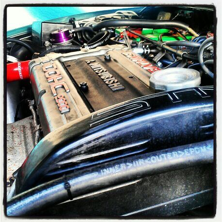

Aspect facing engine bay from front.

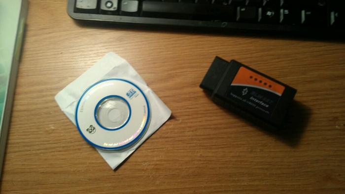

So recently I purchased the Torque app from google play marketplace for droid, as well as the ELM327 from ebay. When I first about about this app and product I was extremely skeptical but a lot of the myth and mystery behind it all was debunked. Ill write a full review on it later. Ill also post up my logs here from time to time so you can all see what I've seen all day today.
I do say one thing though. It has me super curious and wanting more better and more detailed logging outside of the ability of my phone and app.
