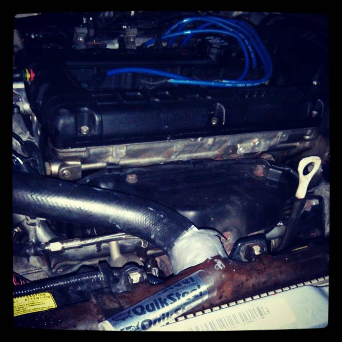

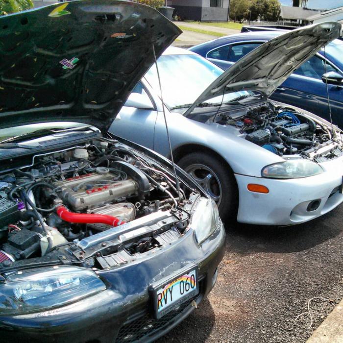

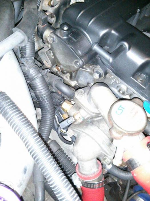

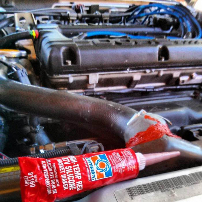

So on my way to the parts store for lugs I smelled coolant. The plastic top end of my rad broke. Crap right? So while at orielys I grabbed some quick steel and make a temporary fix. Then when I got home used some permatex to seal it so I could go to work till my friend can give me a proper radiator. Too bad mishimoto left a bad taste in my mouth otherwise I would be jumping to my credit card to order one.

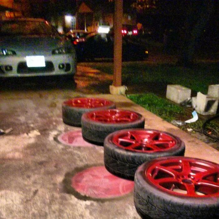

I found a talon down the street from where I live so I bought it with a friend for 300, then stripped it. Got some nice rims and good parts. Painted them. I don't like how the wheels came out however... They are made in the USA and are forged, light as a feather and fit. Can't beat that right? More to come.

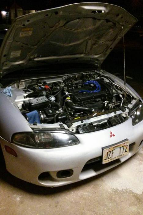

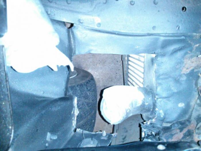

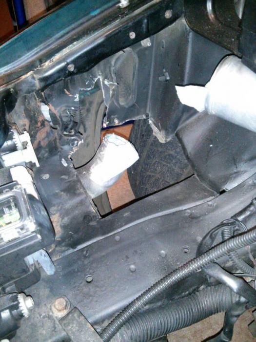

Tonight I'm doing a lot of cutting and catching up on maintenance not done. I managed to cut out slot of rust and spray some rustoluem in places. Made some room as to not have bare metal cutting into my hoses like it did the stock intercooler hose making major boost leak.

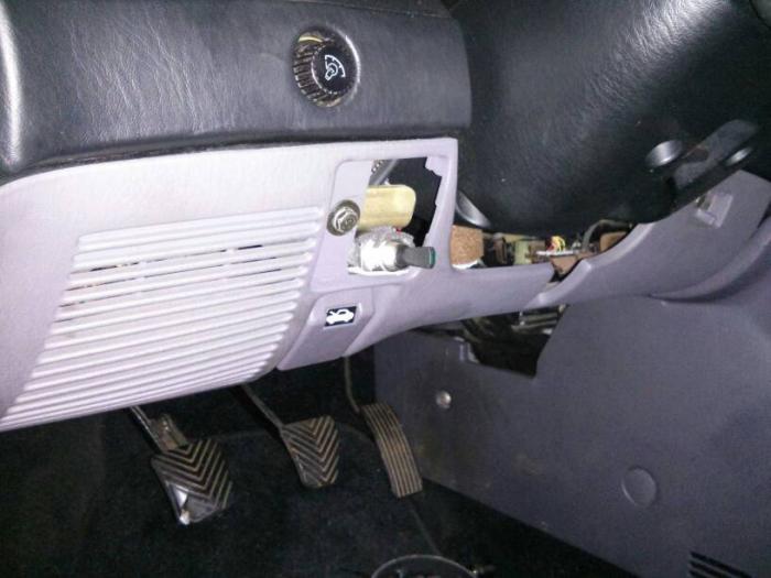

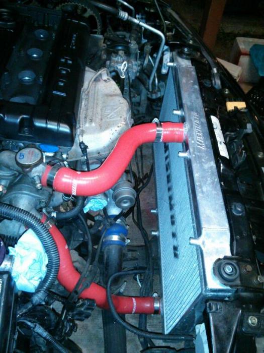

Tonight my replacement fanshroud comes for the rad. I'm thinking about directly wiring it to the battery and having a toggle switch in the cabin to control the fans. Depending on the location of switch how clean of an install I can do and the availability of switches at my local Oriely Auto I will decide whether or not to use the factory harness or a in cabin toggle.
My fuel pump hanger assembly will be delayed by a few weeks but that gives me plenty of time to plan carefully how I will preform the installation and I'll have more than enough time to run the new fuel lines. I like that I am not rushing things.
The GST still has a lot of surprise goodies coming so get ready for DSM PORN

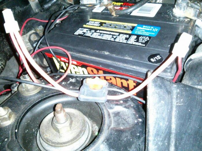

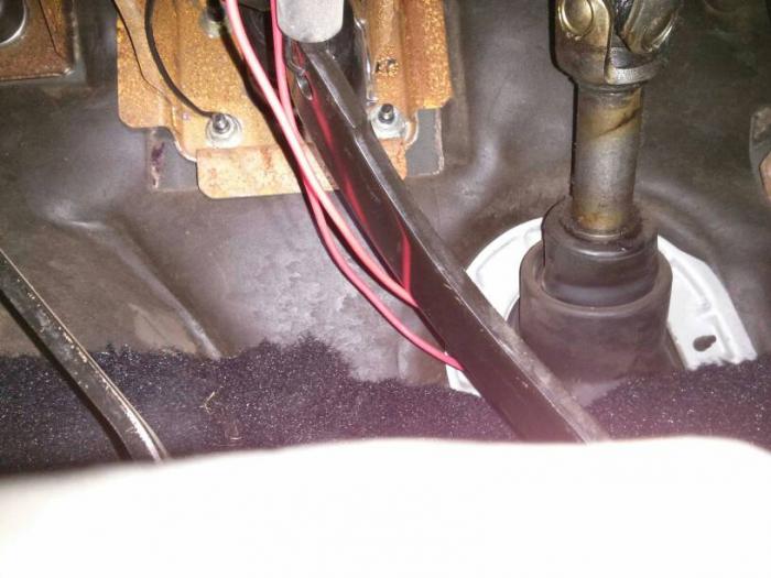

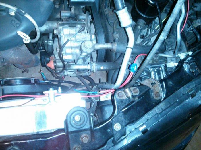

Tonight I wired in my replacement fanshroud I bought because mishimoto wouldn't honor their lifetime warranty. Even though I wanted to go with godspeed or another brand I have OCD have to match for the time being. Plus I have to admit most of the mishimoto line is good. I wired them in using a in cabin switch this time that way I have complete control of when both my fans are on and off that way I can ensure the short lifespan of my mishimoto fans can be extended because cool nights in Hawaii on the highway I do not really require my fans to he running. It took me a few trips and a little learning and some good advice from some gurus to get this rigged up. I hope you all can benefit from it.
For reference I used a 40 amp inline fuse between a toggle switch and the battery. The fans are grounded on the battery. The toggle switch is grounded on the chassis. The toggle switch is illuminated when power is being supplied to the fans. The passenger side fan quick splices into the driver side fan power wire. Both fans are powered by 1 power wire and it is 14 gauge. Use connectors that are comfortable for yourself I choose bullet style and female disconnects. Keep in mind that later I will be quick splicing into this same power wire for another small fan to mount on my stock SMIC.

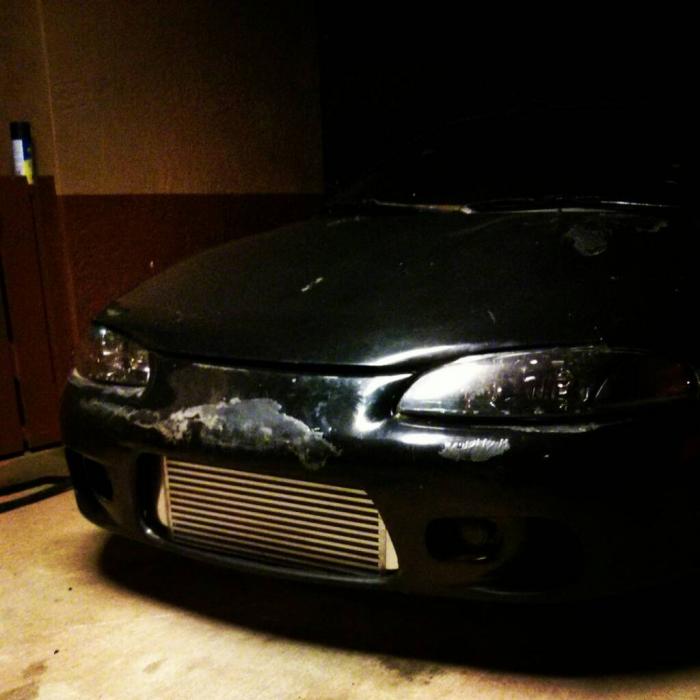

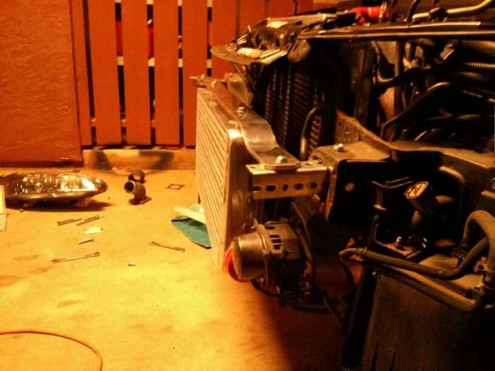

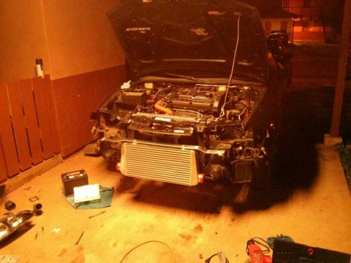

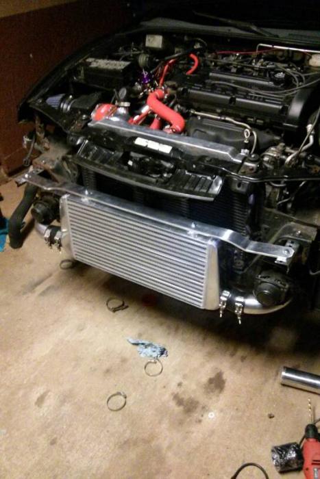

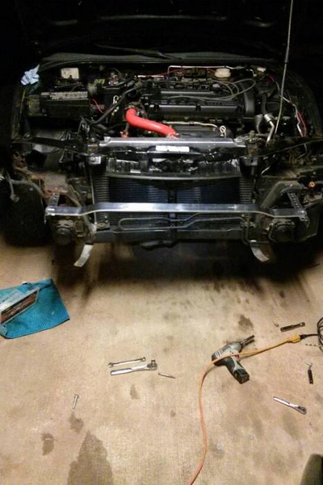

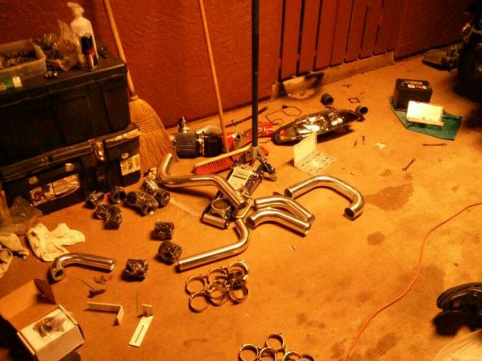

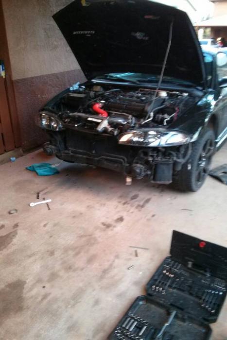

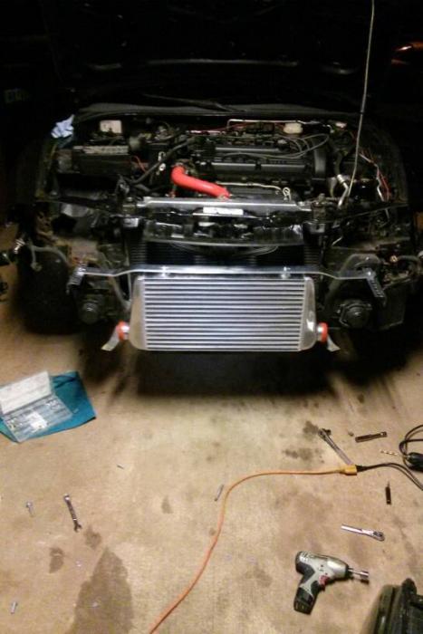

Punishment racing front mount intercooler came in today.
A lot of work so far guys I'm pushing through
Almost done
Photos aren't working standby

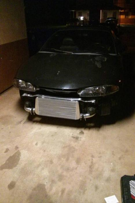

All in all the installation was a success. I hit a few snags connecting the pipe at the turbo because of the length. Lucky for me punishment racing is so badass they sent the j pipe for a 14b or 16g turbo free with the kit. I simply cut some of that piping and made an extension and used the extra coupler PR also sent with the kit and made it all fit nice and snug. The BOV that comes with the kit is nice and loud. I don't know what to expect later down the road with it but I'm impressed and I will review the kit properly later on elsewhere in the forums.

Driving my gsx like I stole it I love it so much. I don't know why everyone says a fmic is bad for the stock turbo. I haven't noticed anything but good things. I have considered selling the gst for 4 grand to further this build.
