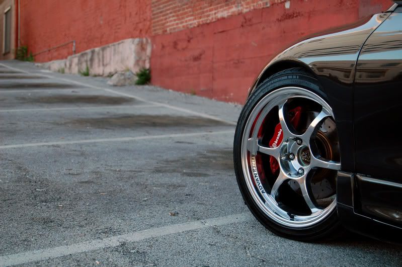

great build man, I love the red wheels, with the black car, the contrast is sick
Thank ya, it may be getting a different kind of contrast with the wheels here soon ;)

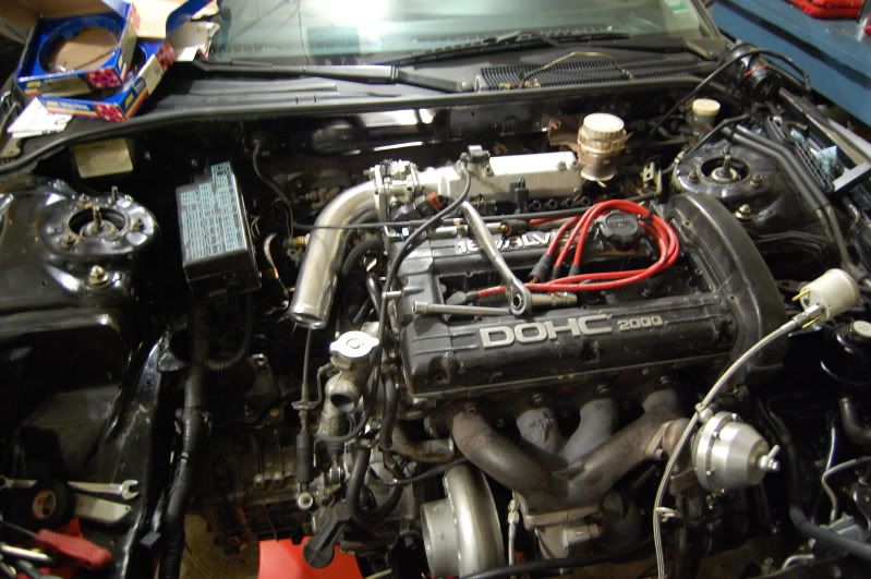

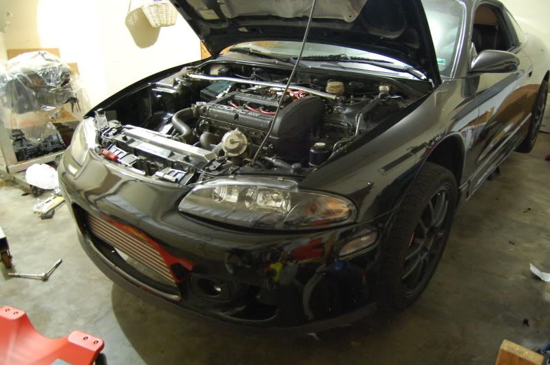

March 20-27, 2012 – Pulling the motor and transmission
And so it begins...camera is setup on a tripod so there will be many pictures taken this time...
More done

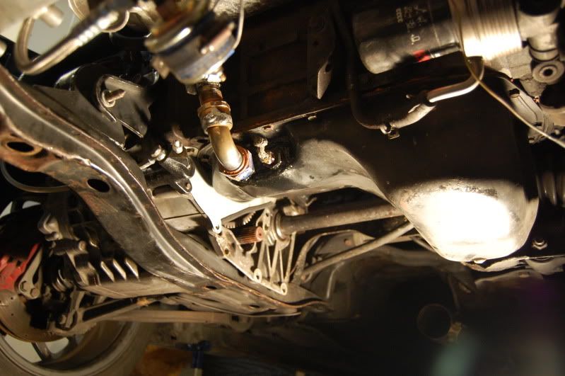

Transfer case and downpipe off...have a little oil leak as you can see

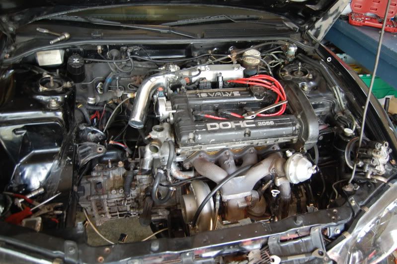

Motor mount and such off along with intake piping etc etc

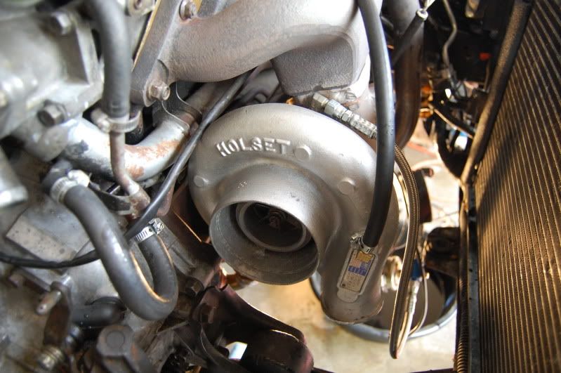

Just throwing in a picture of the holset :p
Little more work done

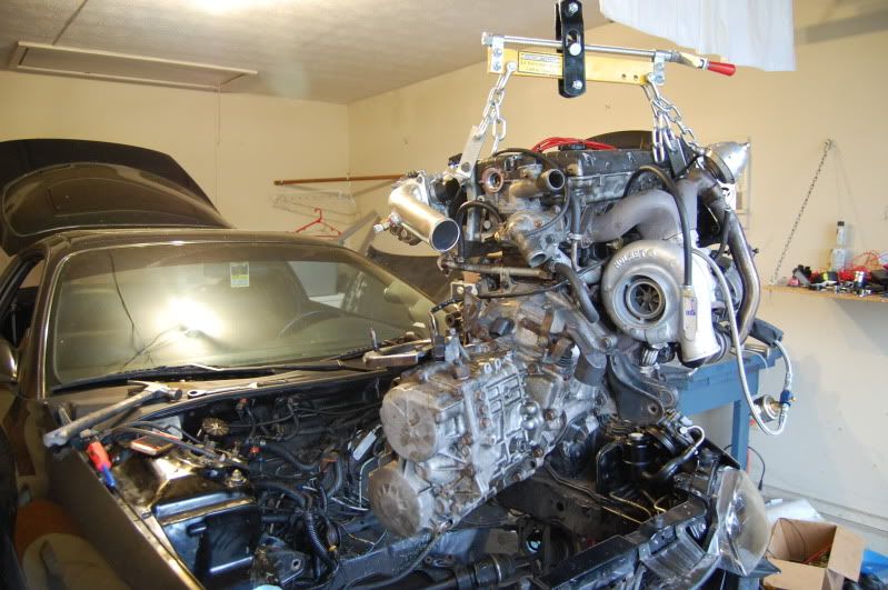

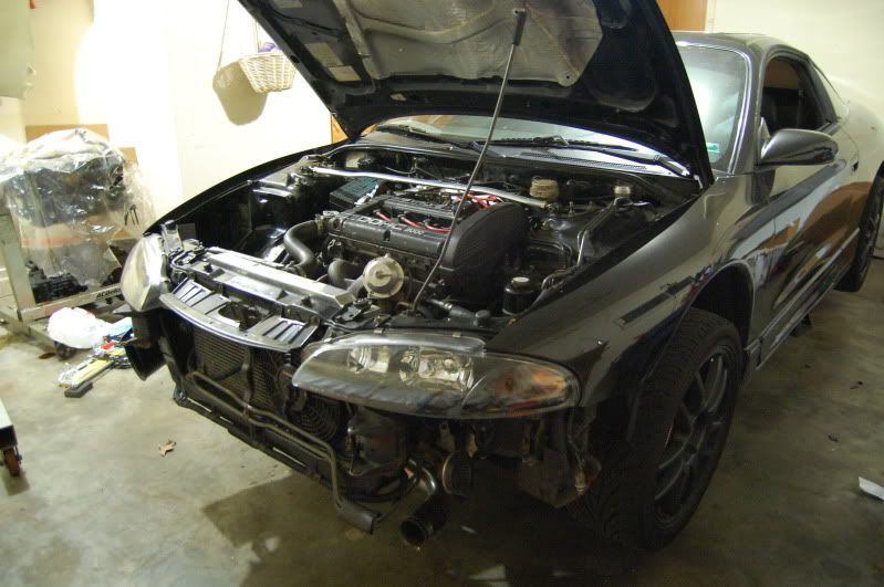

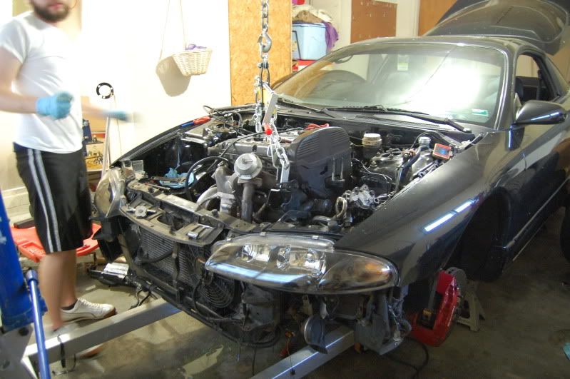

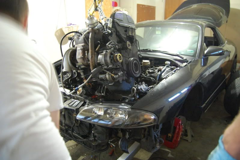

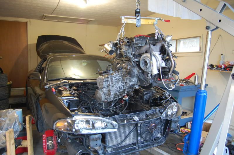

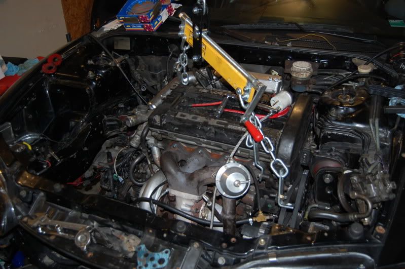

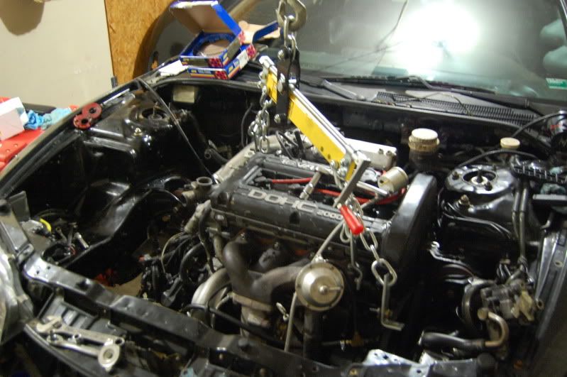

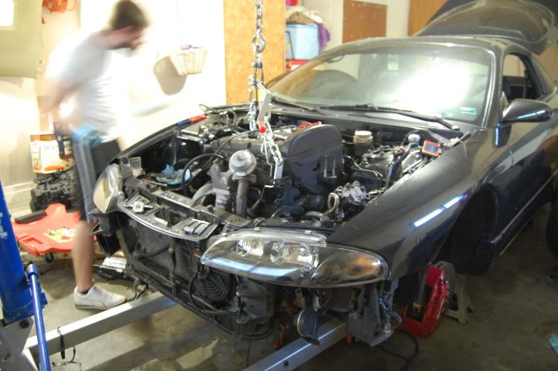

It's coming out...had a friend come over and help

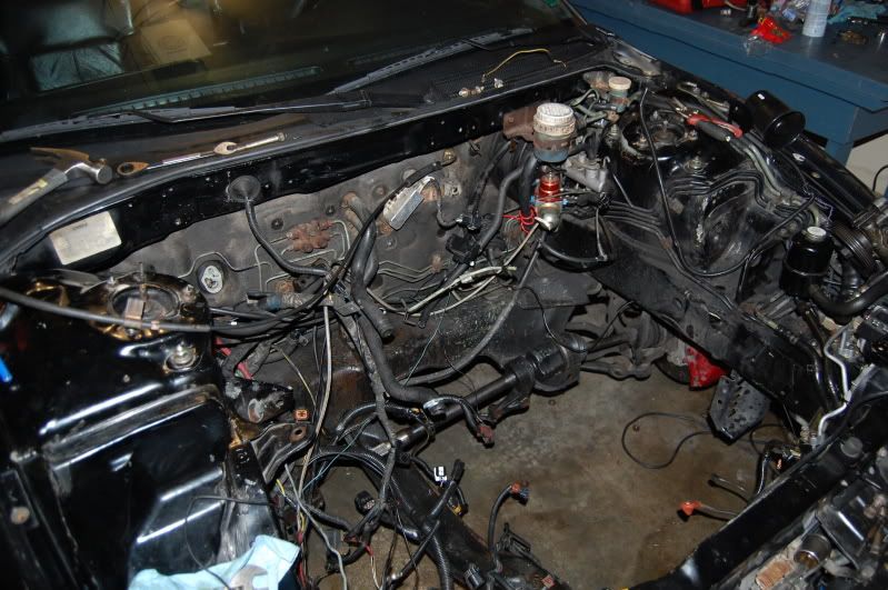

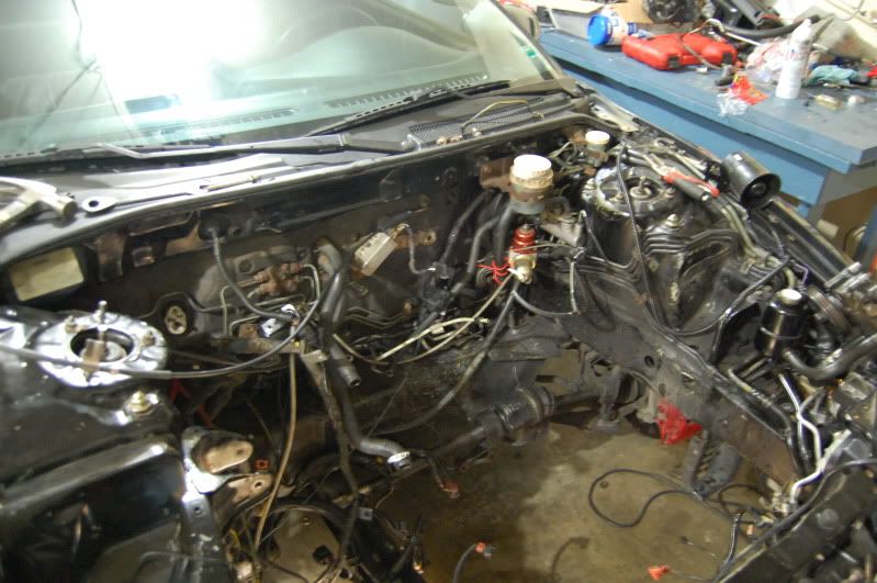

It's out!

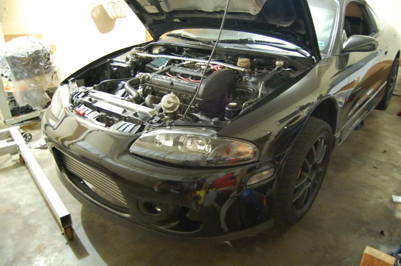

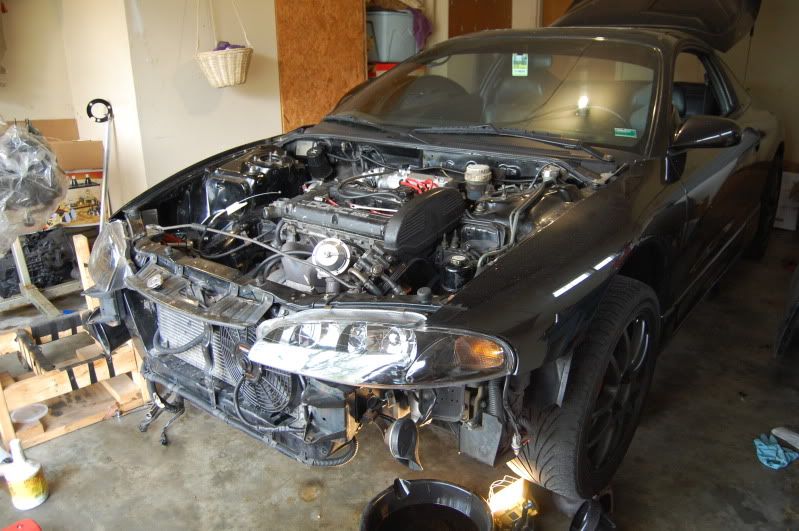

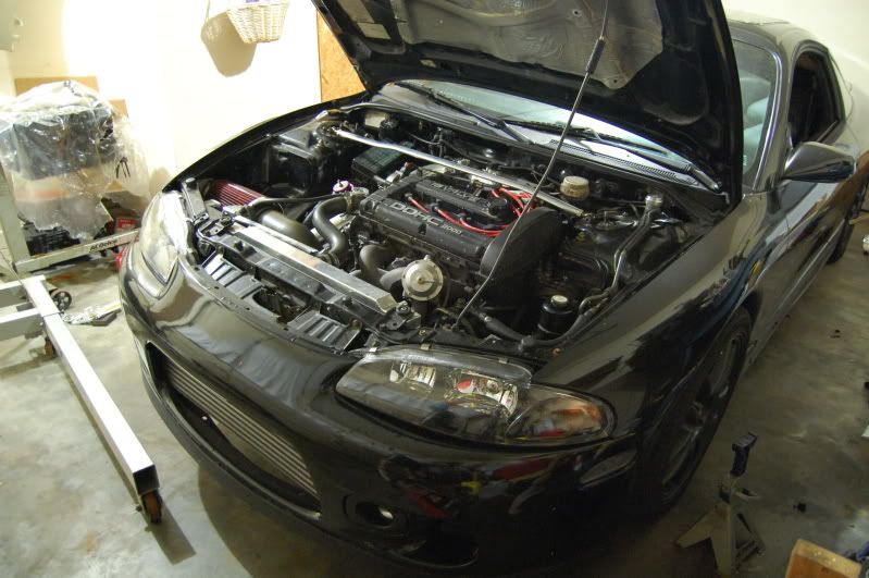

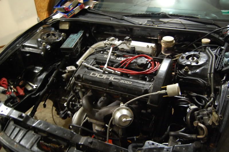

Something is missing...and yes I am going to try cleaning up the engine bay and getting rid of some wires...yuck

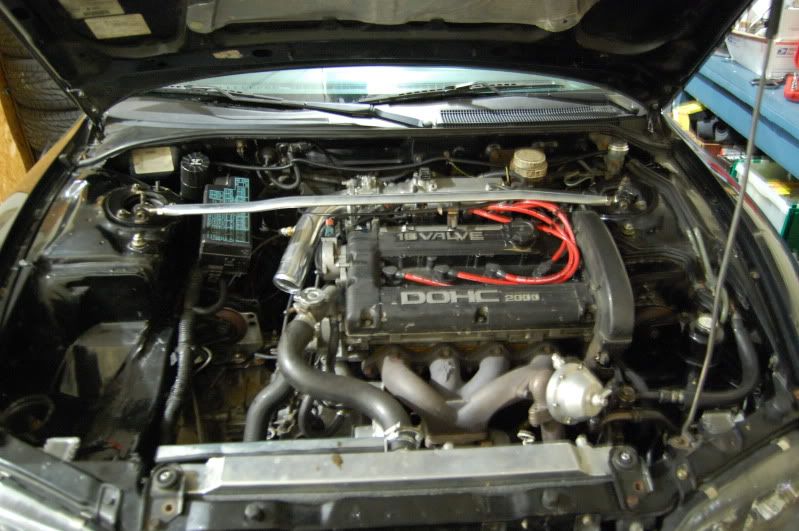

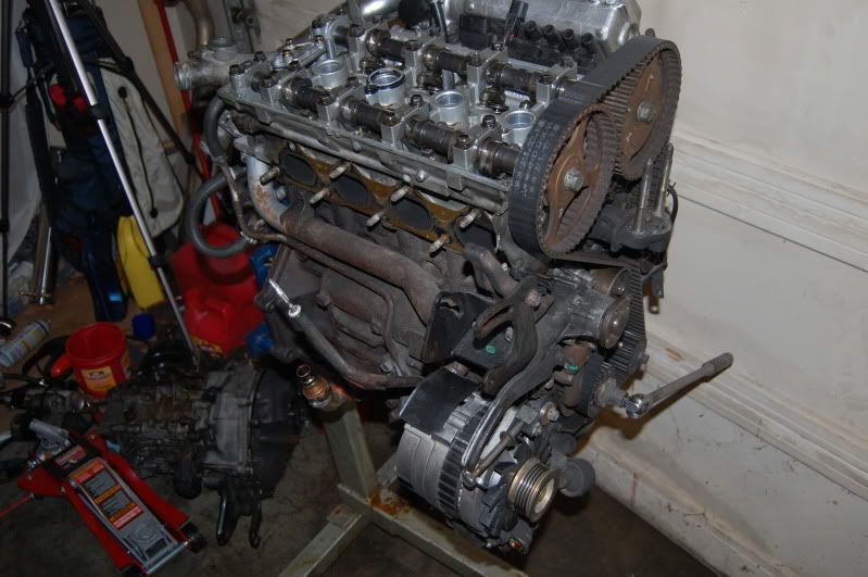

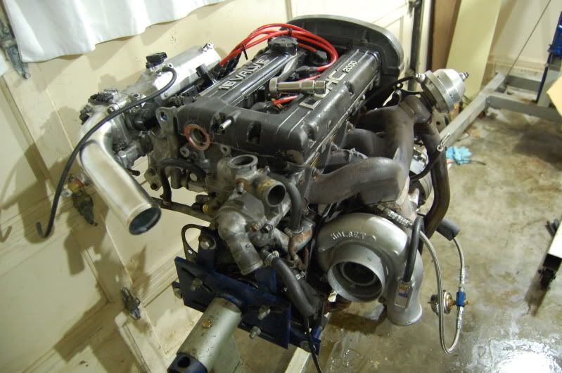

On the stand ready to be worked on
And so the tear down of the motor begins...stay tuned for more updates tomorrow

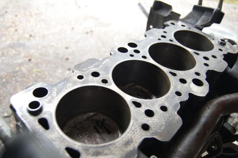

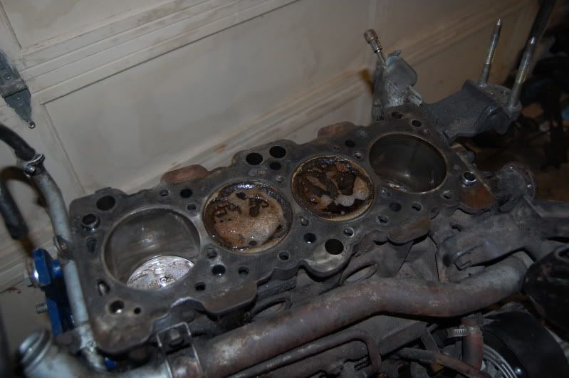

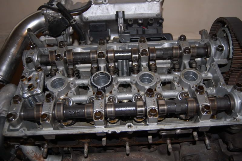

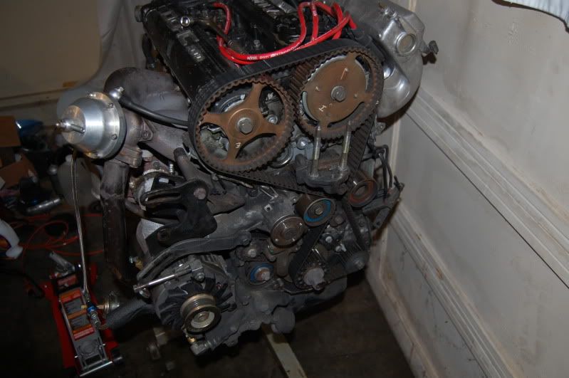

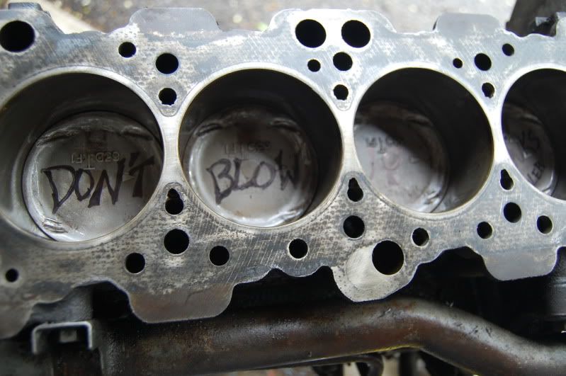

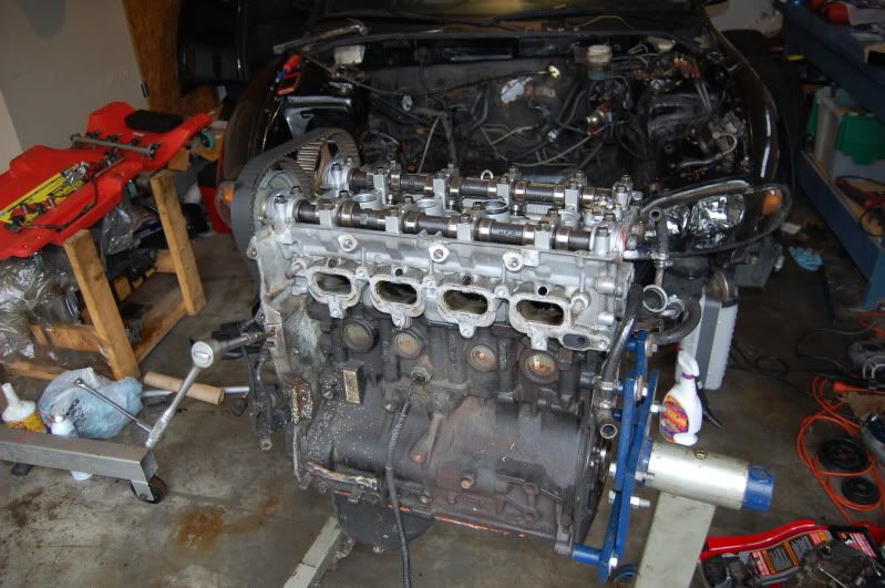

Valve cover off along with exhaust manifold
Mmmmm, clean head

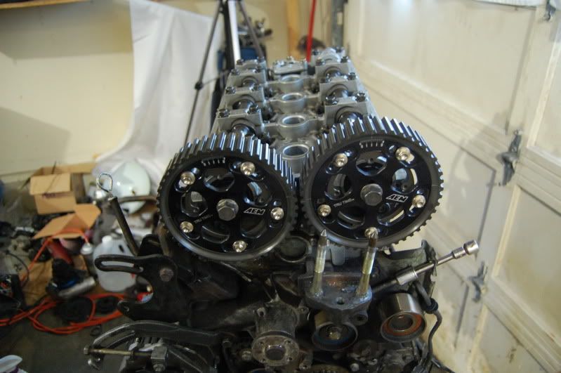

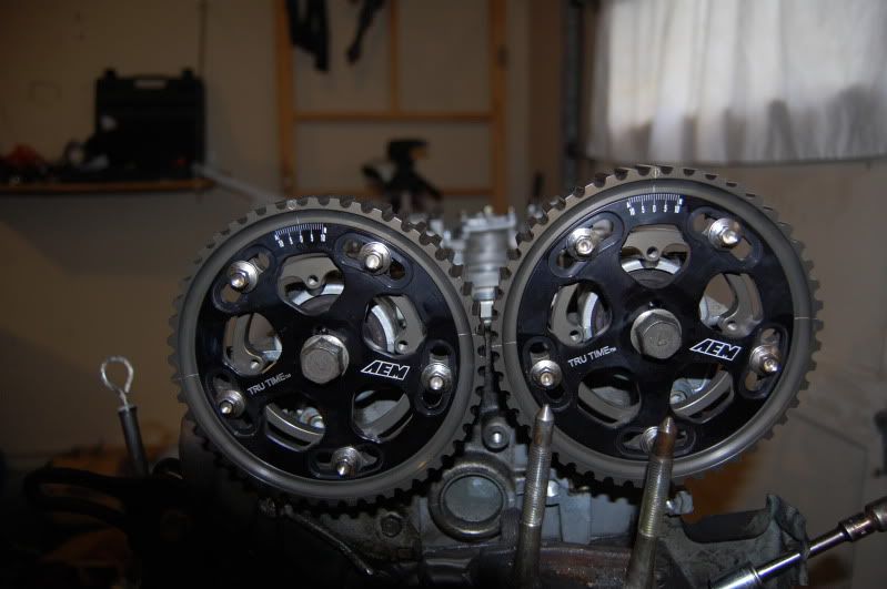

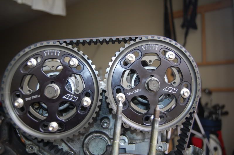

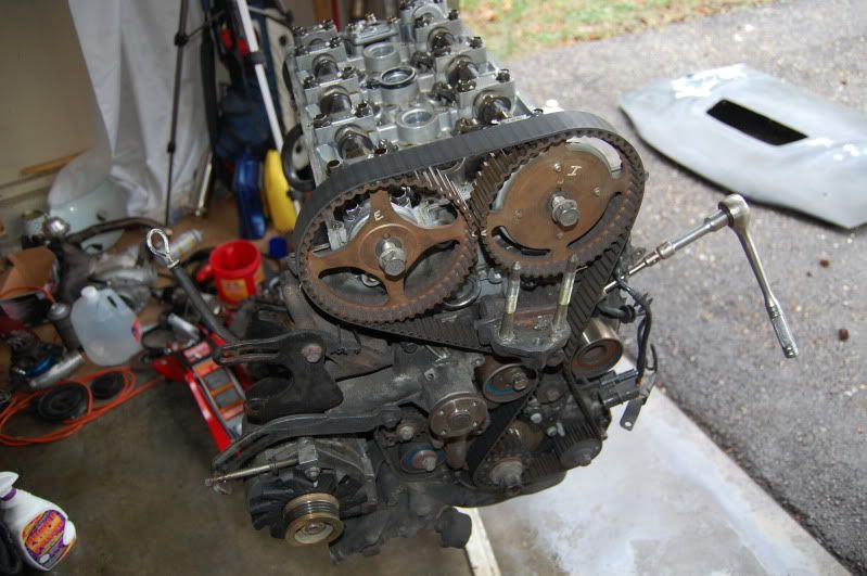

Cam gear bolts loosened and ready to take off for my AEM gears. Intake manifold off
Random
Cam gears on

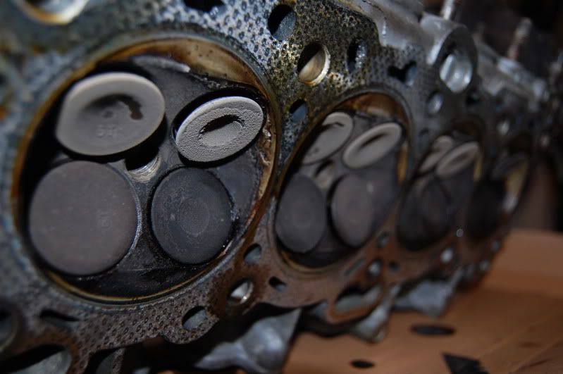

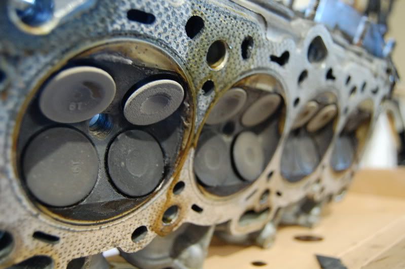

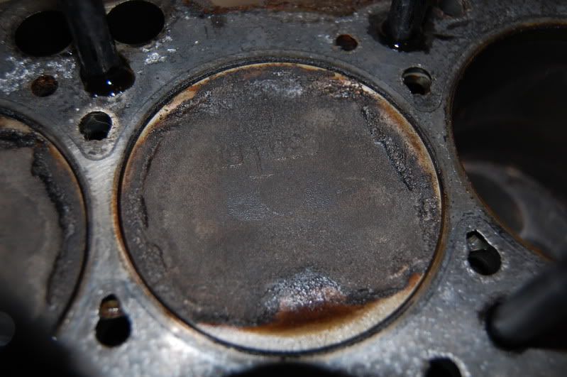

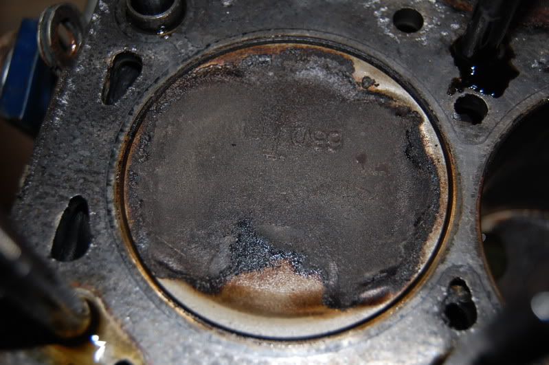

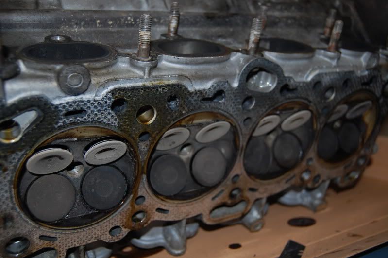

Filthy! Sooo much buildup on them
Head looks the same way

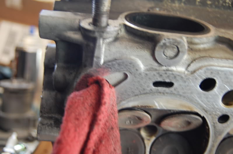

Brake cleaner, a screw driver, and purple power to the rescue!!
Much better, not perfect but it will work

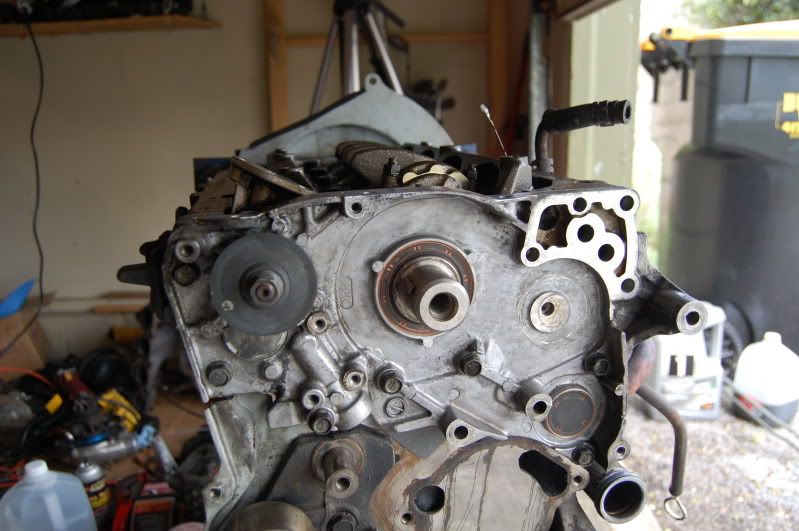

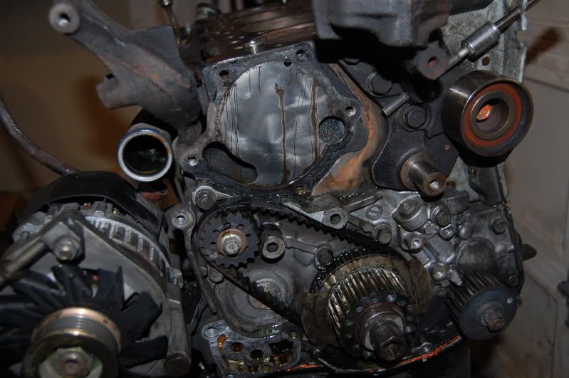

Water pump and other misc crap taken off to get ready to pull the pan and do the bsek

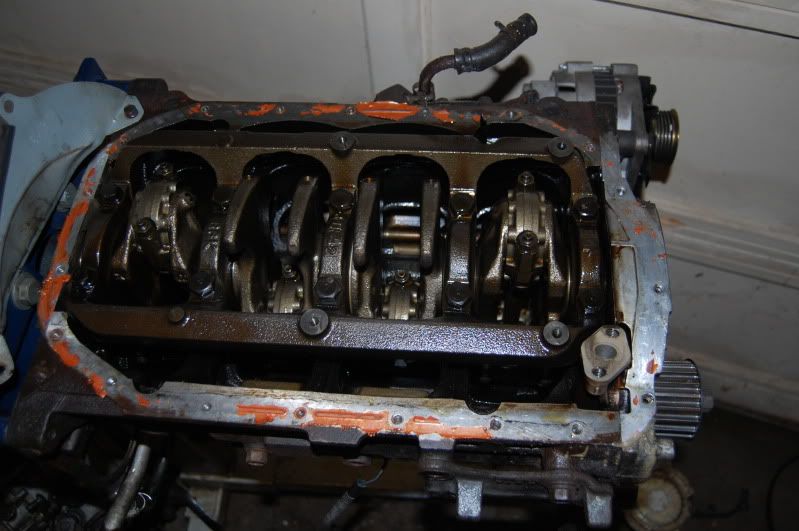

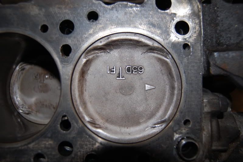

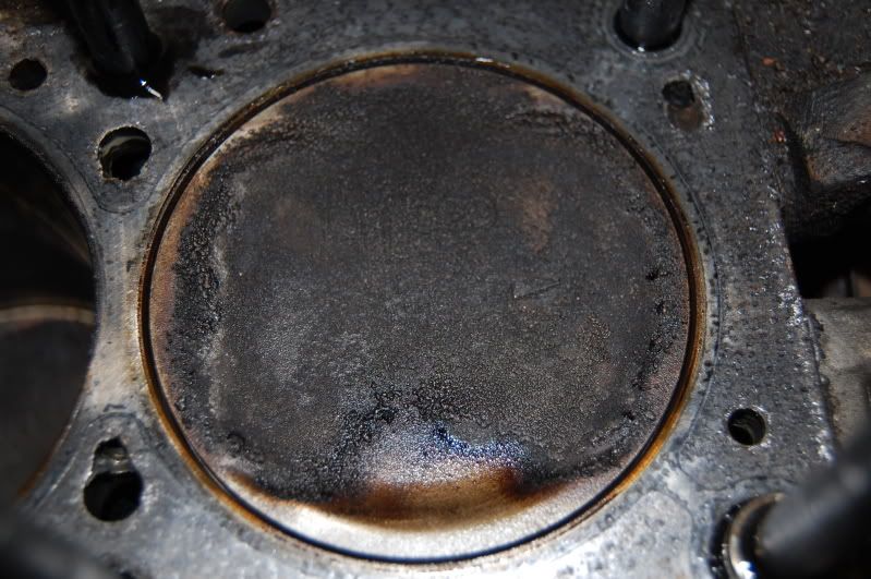

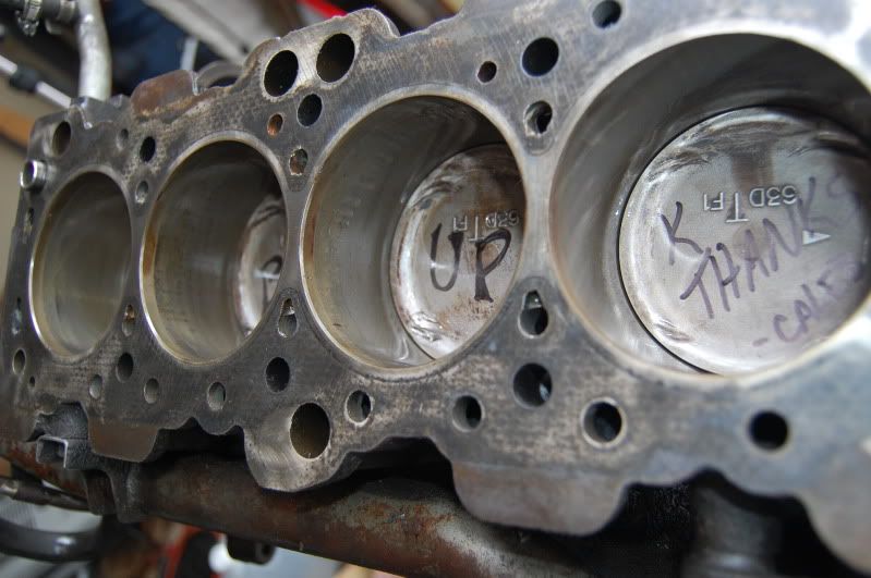

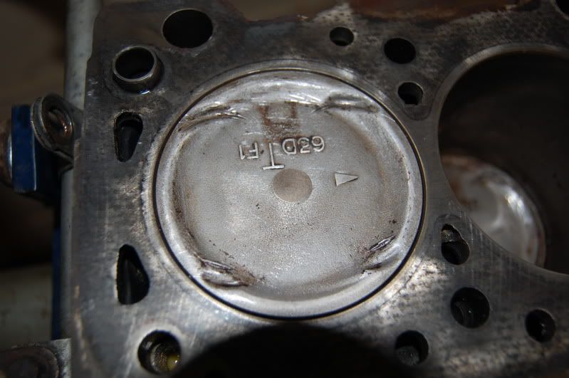

Crank looks pretty decent
Crank sprocket off
Another of the crank

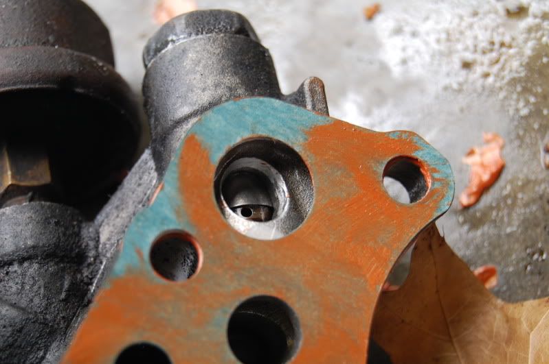

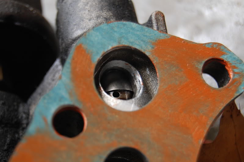

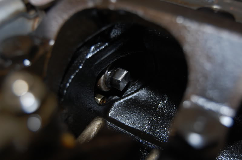

Porting that hole...no after pics because it looked like crap LOL. Should do its job though
Front cover back on and ready to put back together

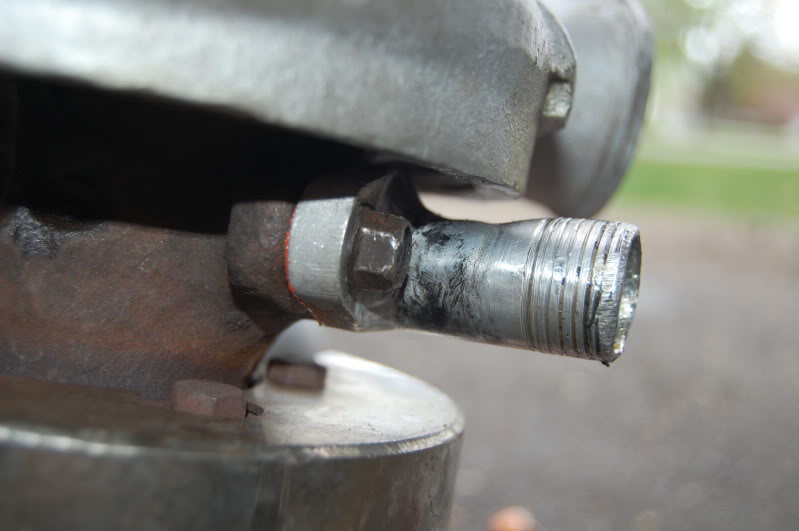

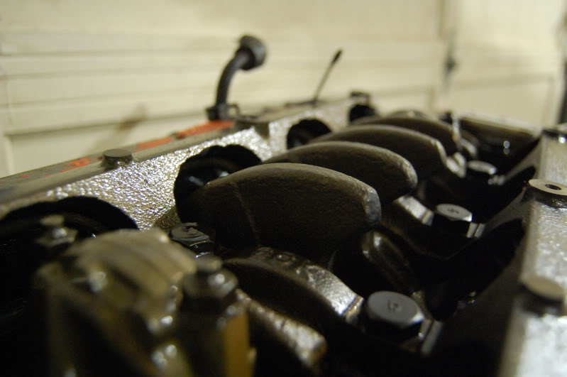

Balance shaft stubby
Ported ofh relief valve hole

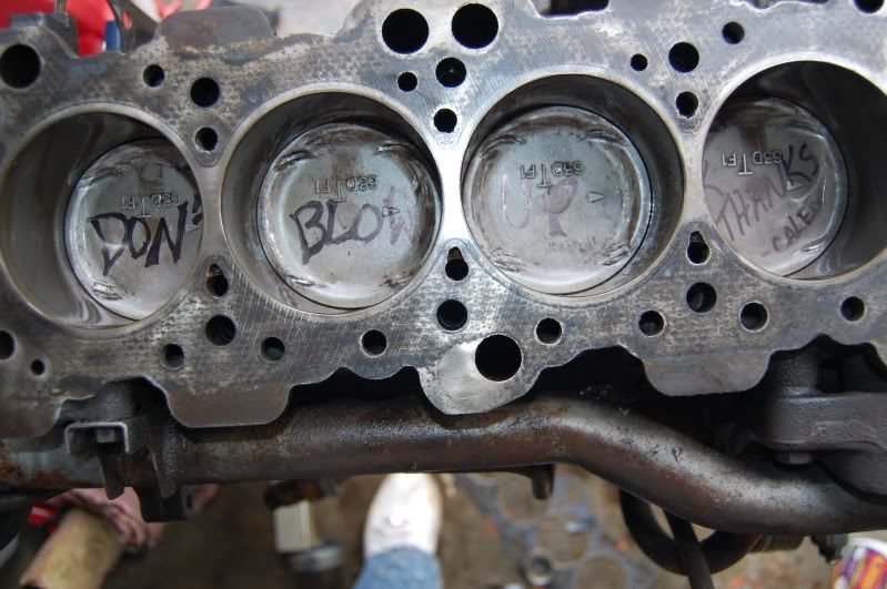

Little motivation for my engine...

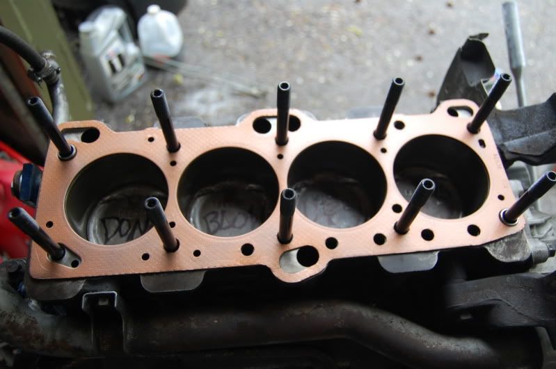

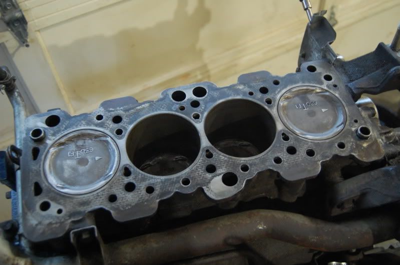

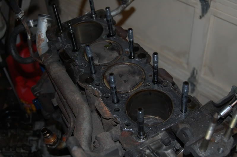

OEM headgasket on and ready to torque down the head. Copper sprayed it just to be safe, shouldn't hurt either way

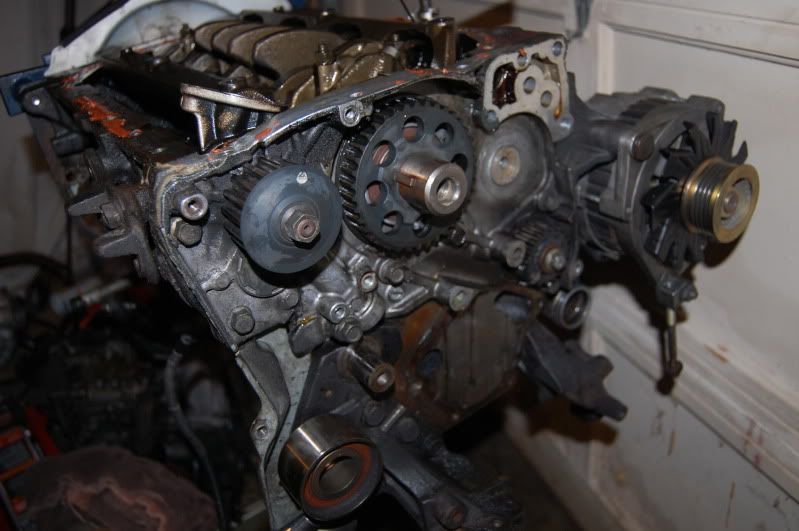

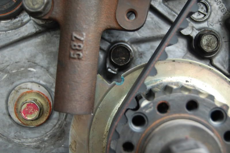

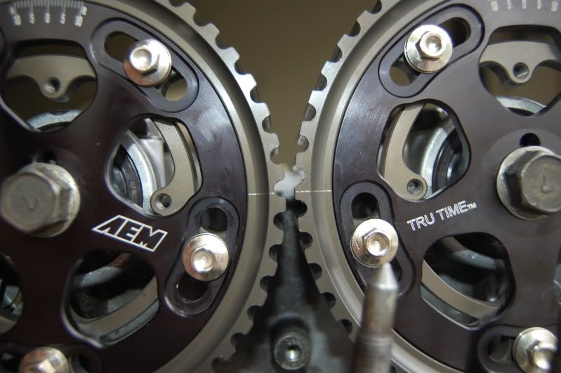

Took me ffooorreeevvveerrr to try and get these lined up right...hope this is correct
Location of the crank sprocket with the gears like above

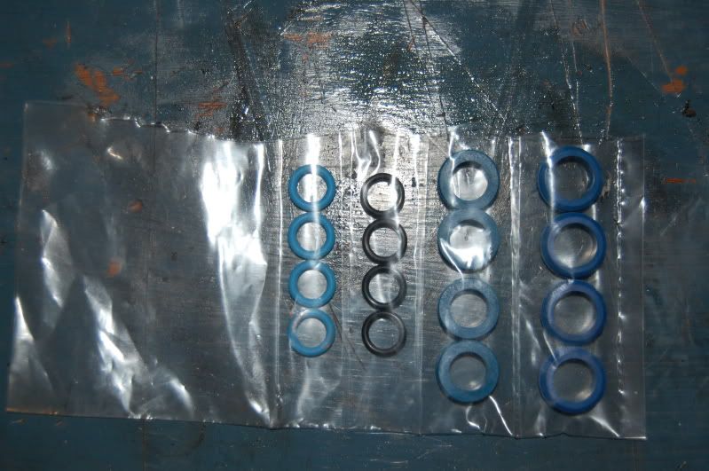

New FIC injector seals

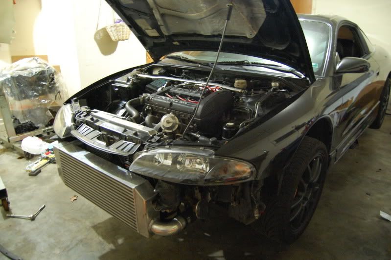

Engine in, was actually very easy to drop back in

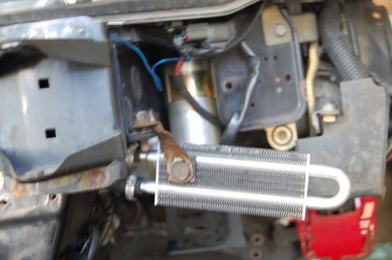

New power steering cooler setup. Just a $20 kit at autozone that I bought to replace the terrible factory one. Mine was leaking and rubbed against my IC piping so I just did away with it completely and put this on

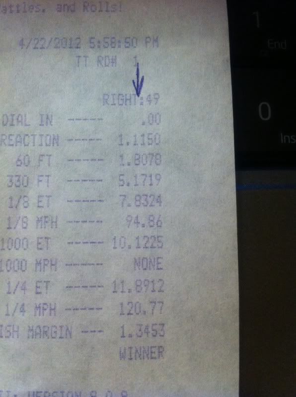

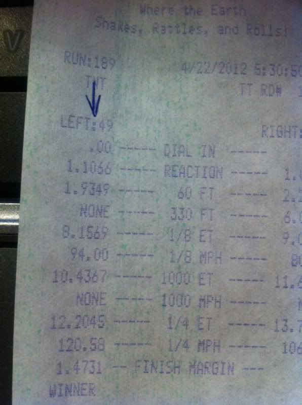

Enough of the talk, here are the times and for reference, the car.
Mods are in my profile, boost is set at 26-27psi..it changed a little throughout the day but the 11 second pass was at 26psi
First pass of the day and first pass with the new turbo...bogged the launch pretty bad
Second pass I did a little better launch after raising the two step but I had to let out in second due to wheel hop
Third and final pass I got a decent launch and made it through the gears decently
All in all it was a good day. I am very pleased with the times and I know for a fact it has more in it because I was running rich the whole day and I haven't done a boost leak test in months...even after tearing the motor out and putting it back together :coy:

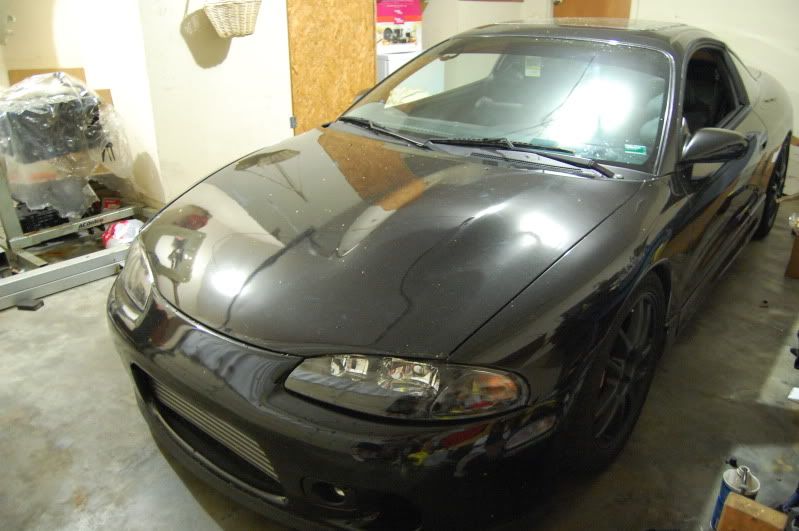

June 24, 2012 - Prep for the S3 Magazine Shoot
Well a couple days ago (Tuesday I believe) I was contacted by the editor of S3 Magazine to do a feature on my car. I was ecstatic! He asked if it was running (another DSM guy I think LOL) and I said yes, so his photographer contacted me and we set up a time and place to meet for the shoot. Now I only had a couple days to get my car picture worthy so I started throwing things together rather quickly.

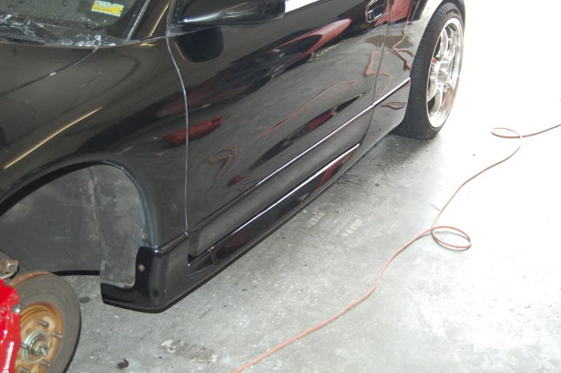

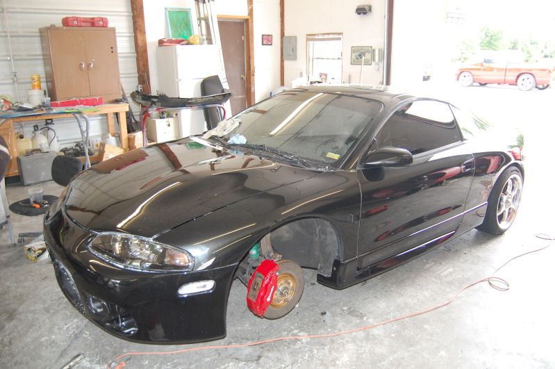

Firstly, I took my 2gb side skirts to a friends shop (Kirk Kustoms) to be painted. I asked him if he could possibly have them done by Friday and he said sure. While I was there he offered a killer price on a full buff and detail for me...so I gave in and brought the car to him Thursday morning. Amazingly, the side skirts were almost done as well! So it worked out perfectly.

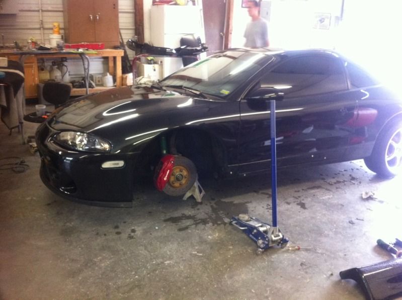

Jacked the car to get to the bottom screws for the side skirts better

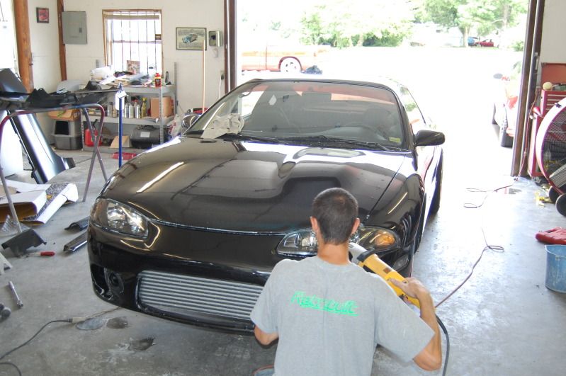

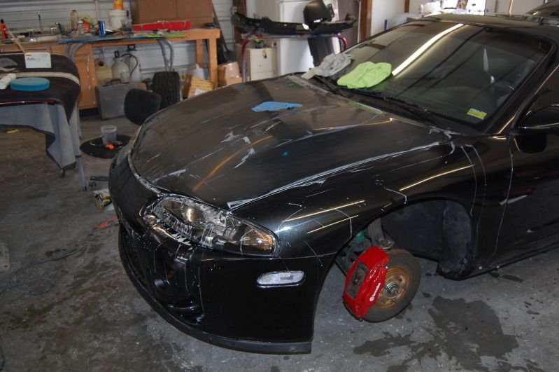

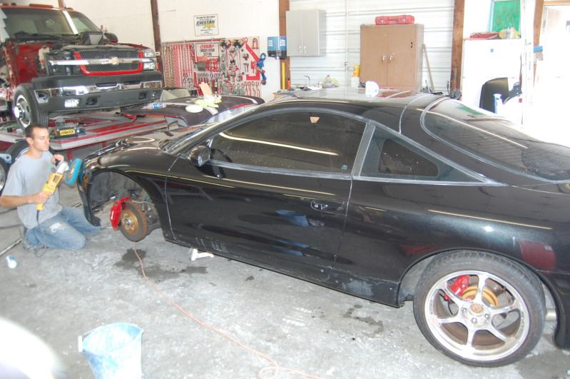

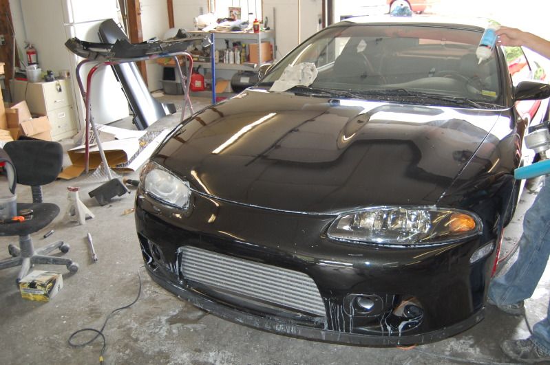

Wetsanding on the hood began and I took off the front wheels to fit my screwdriver to take off the old endcap
Hood has been buffed over with rubbing compound
And now the bumper
By that time I had the old side skirts off and the new ones were finished drying, so on they went!

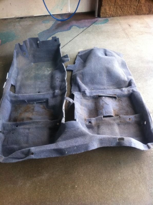

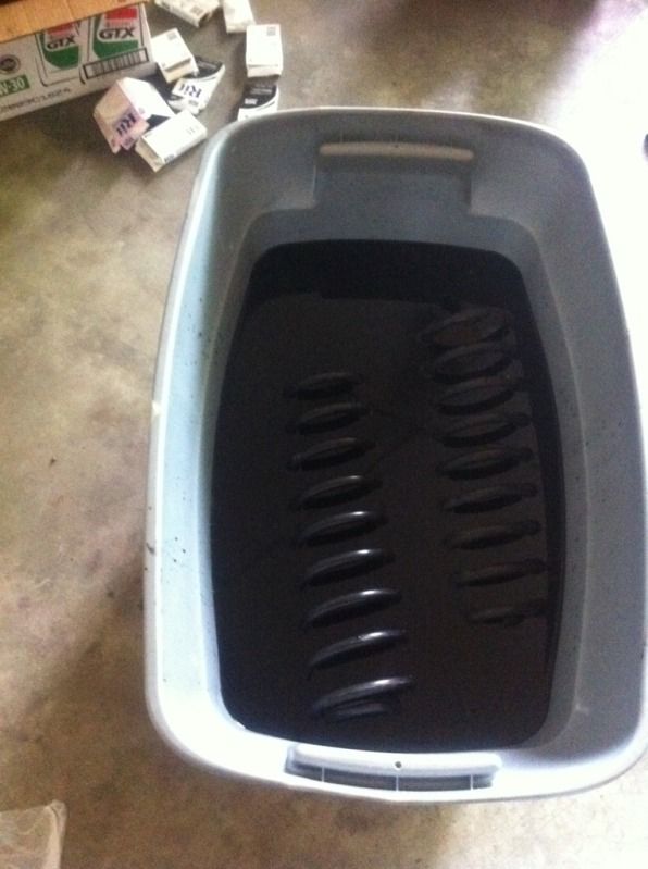

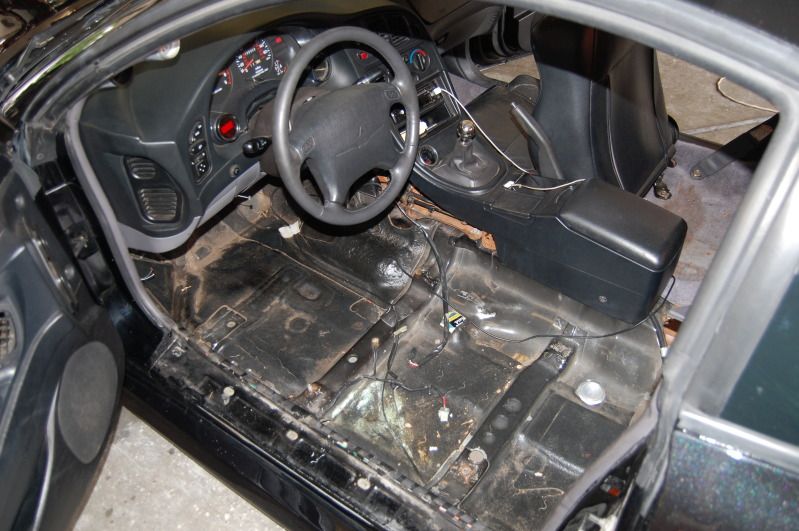

I have had crappy cut up carpet in my car for a while so I finally picked up some extra carpet and put it in Ritz dye for 24 hours before heading to the body shop for the buff and wax
Before being put in the dye
In the dye
Old carpet out
Annnd, I fail for after results LOL. I will take a picture of it today to add to this
Anyhow, car being washed after the polishing compound did its work
And all done! Ready for its date with the photographer

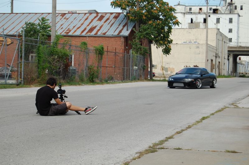

I got a few pictures of the photographer at work. The car won't be featured until the November issue I believe so the anticipation will kill me, but I am excited to see some of the editing the photographer does to the pictures and what he shows me until then.
After the photographer was done, my friends and I needed to kill some time so we went and did a little photoshoot ourselves
