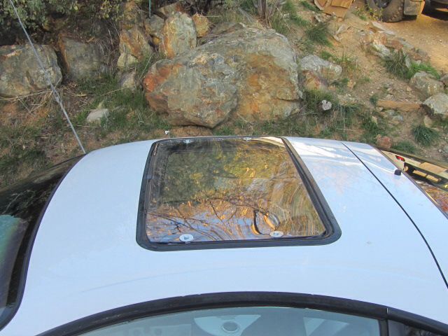

gonna try this for the rear hatch..work n 2 kids been keeping me busy
Window, Windshield or Rear Window Mounting Kit Race Car, Racing, Dragster, Chassis, Roll bars, Cages, Fabrication, Suspensions, Parts, Shocks, Springs, Motor Plates, Brakes, Drivelines, Housings

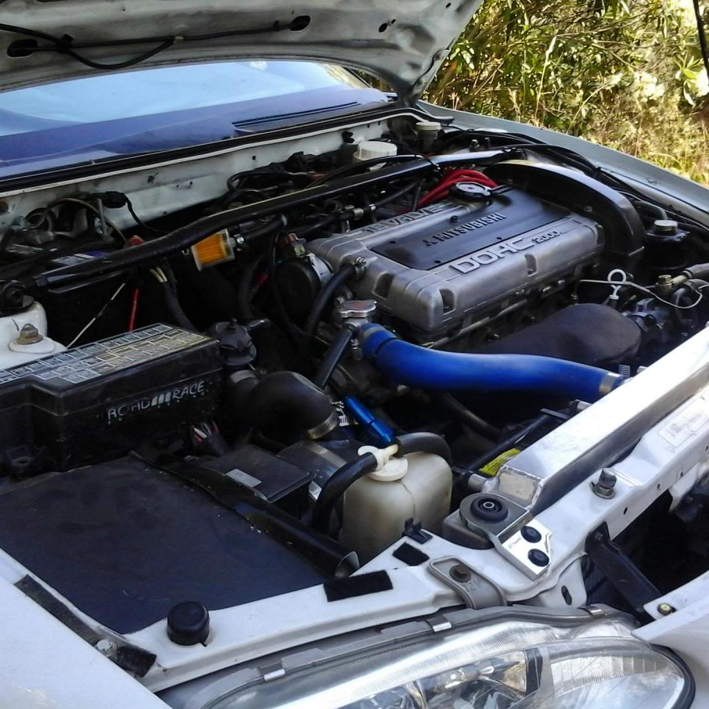

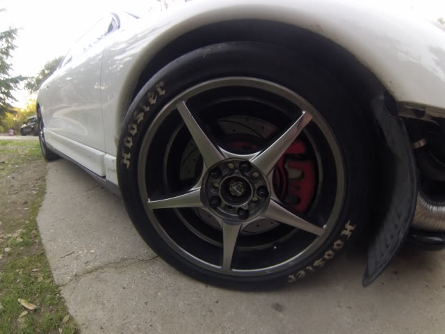

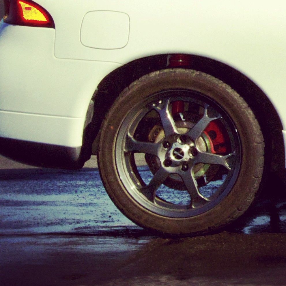

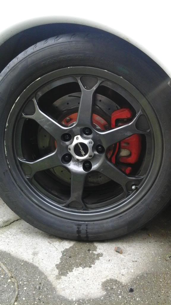

Rear set up centerline rpm 14lbers 17x7 aem bbk

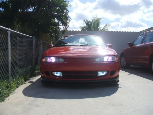

Picked up some 2ga fogs and gotta try to mount them got a new lip off ebay gonna try to look like this

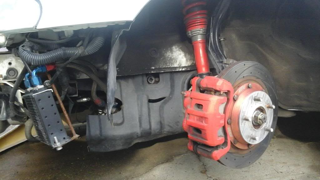

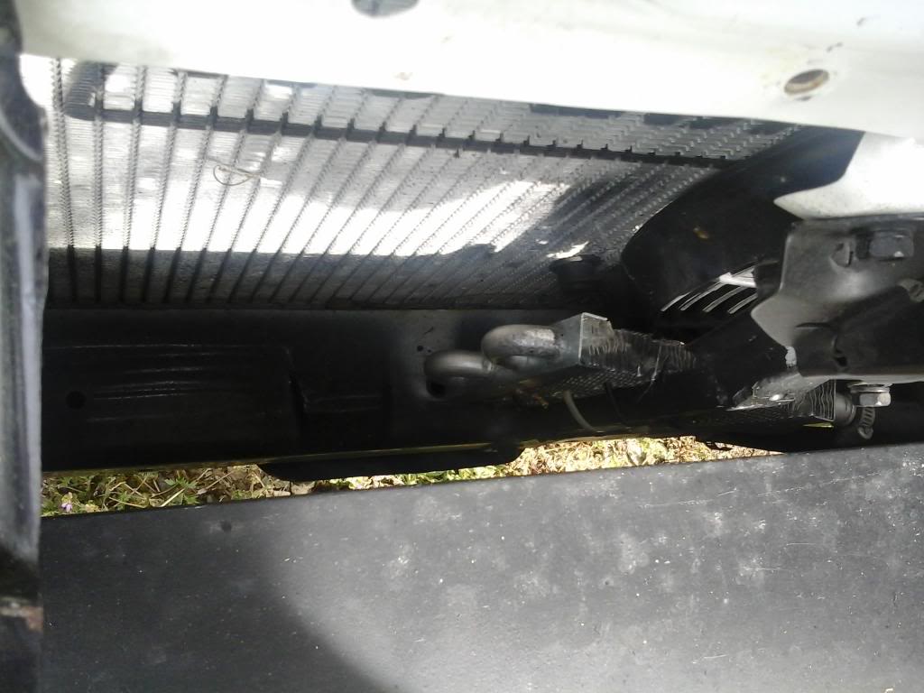

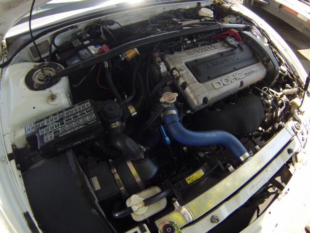

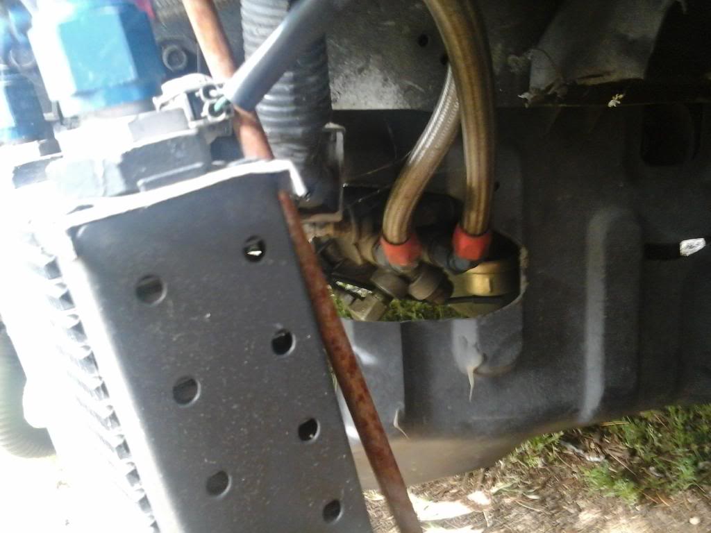

oil cooler n lines
power steering cooler for autox

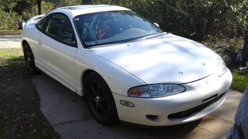

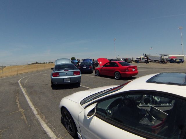

Hot day at the track 100deg. Ran a 13.0@108 on lower boost and shifting into fourth instead of leaving it in 3rd..( new gt mustang was running 14.1..haha) had fun and no breakage

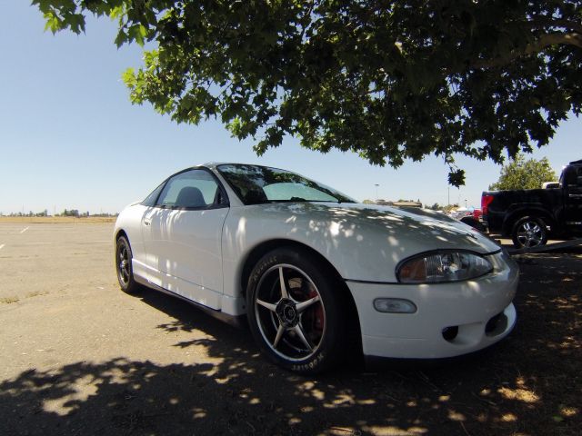

Shade parking balla
