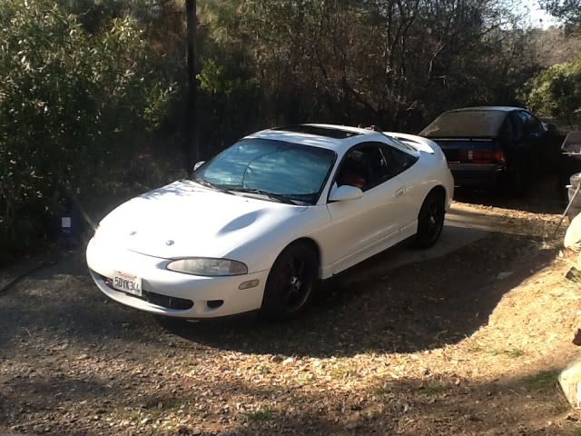

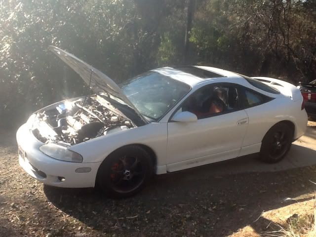

1995 GST 6bolt FP Big28 Street/Drag
Gst-street- drag autox

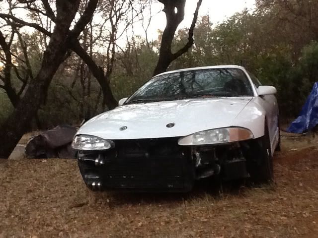

Finally got the ins. To take care of it..they were trying to make a diff. Claim for every pine cone n charge me 500 deductible per one..haaha..

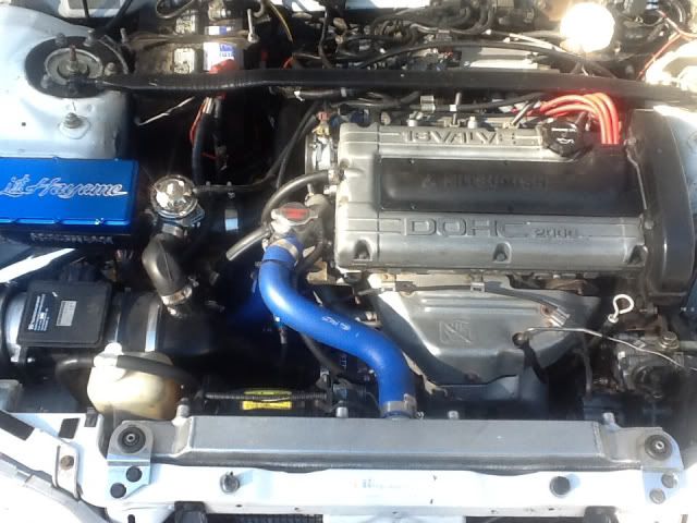

Ht68 and fp manifold? Maybe bigger idk

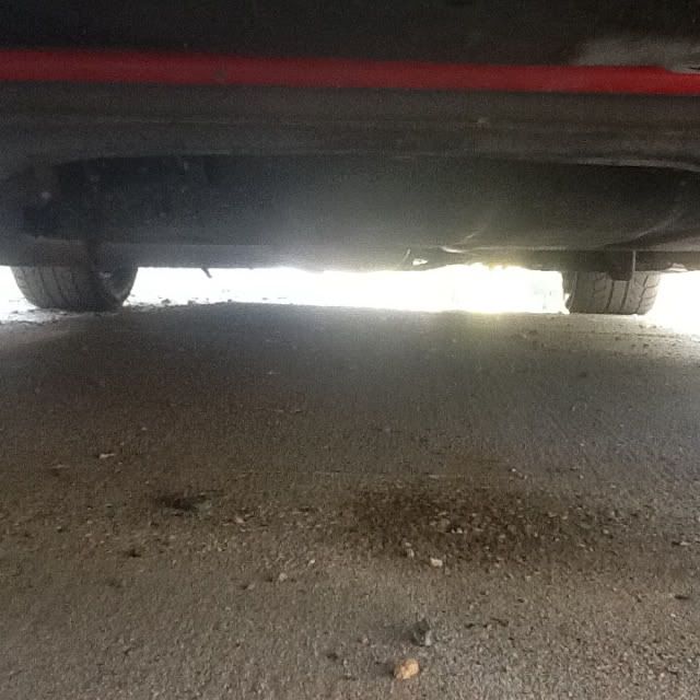

3"cut out

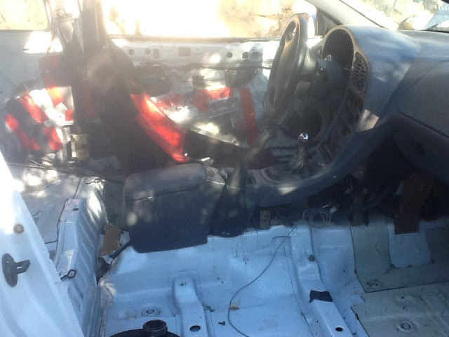

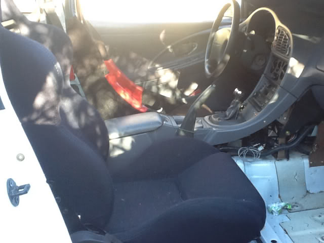

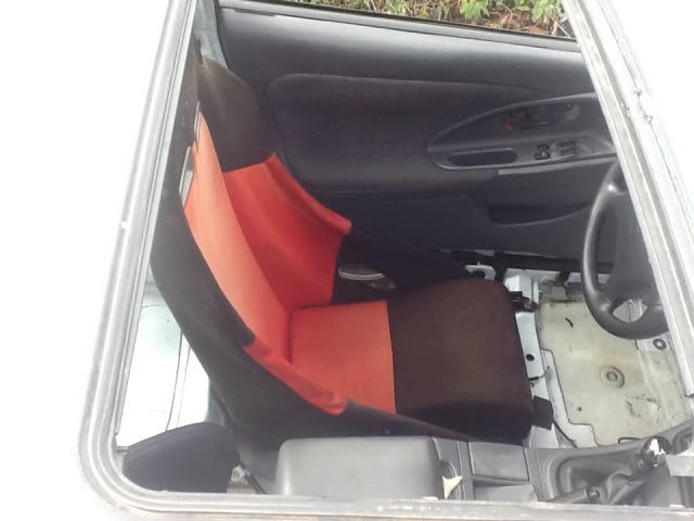

Put my cobra seat back in and strip it out

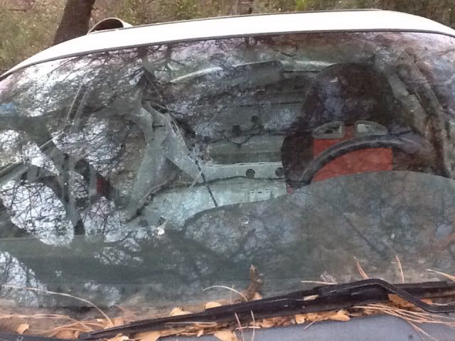

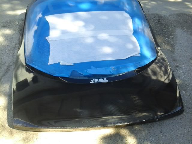

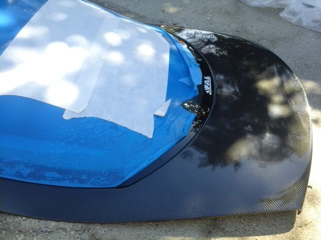

Just pulled the trigger and got the fal back window ($268 shipped )for my cf hatch (38lb total hatch weight) stripped out all interior just a cobra seat n dash left....

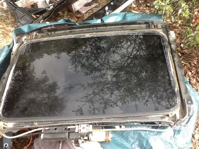

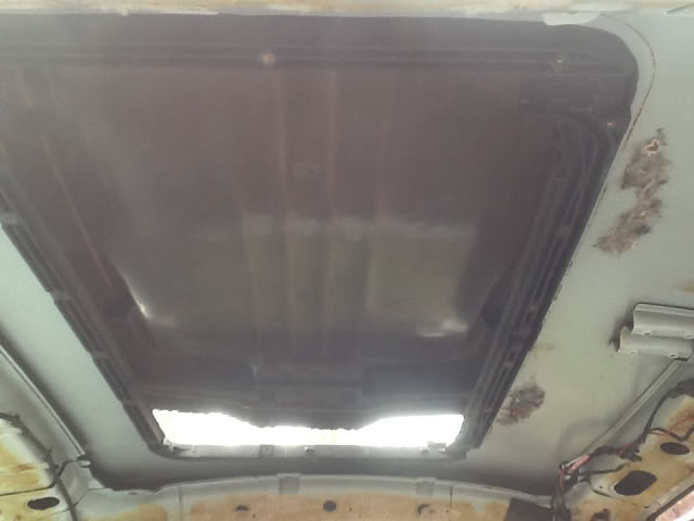

My bro is picking up a sunroof plug from Sergio for $100 tomm

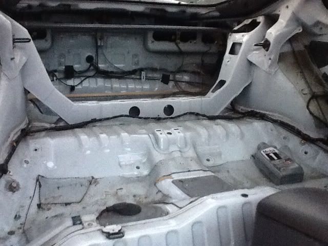

Next up remove both airbags , wipers , blower motor. Haven't got it weighed yet im hoping for 25-2600 w/o me

I ordered the FAL hatch lexan (blemished ) after i talked to them to make sure they still had it (guy said they did). Turns out they dont but are sending me a brand new one at the same price ($268)...big thanks to FAL and Dave
But it wont be here till the 29th

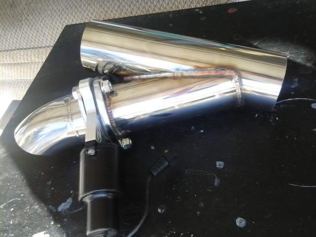

Got a qtp cutout for the track.... Should have it here this week

Sergio who does the carbon fiber stuff is really hard to meet up with i need the sunroof plug bad.
How sturdy is the FAL lexan hatch. Is it durable enough that someones not gonna come by in a parking lot an trash it like a convertible top? Are they as stong as the glass or close to it?
Took out everything bolted/screwed that i could get ..got the seat mounted a just gotta get a lil done everyday

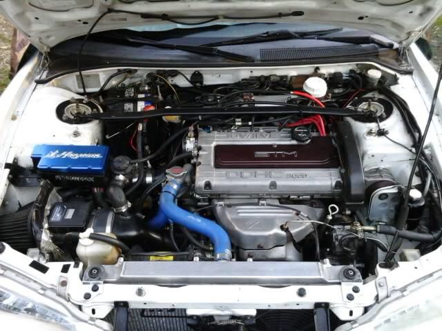

Hahn ol school fmic n oil cooler

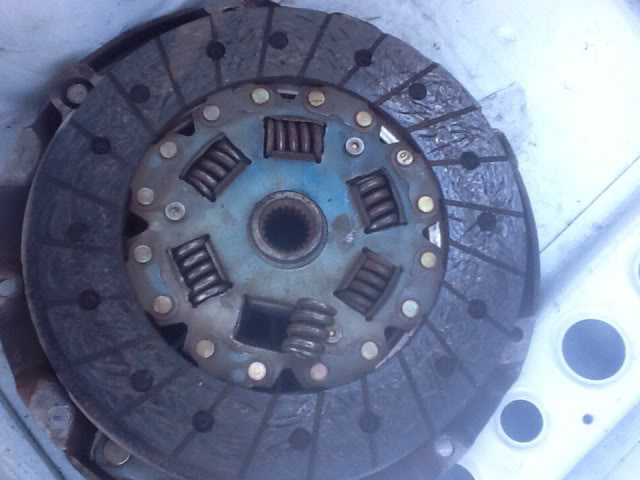

Got a new act put in. The old one popped a spring

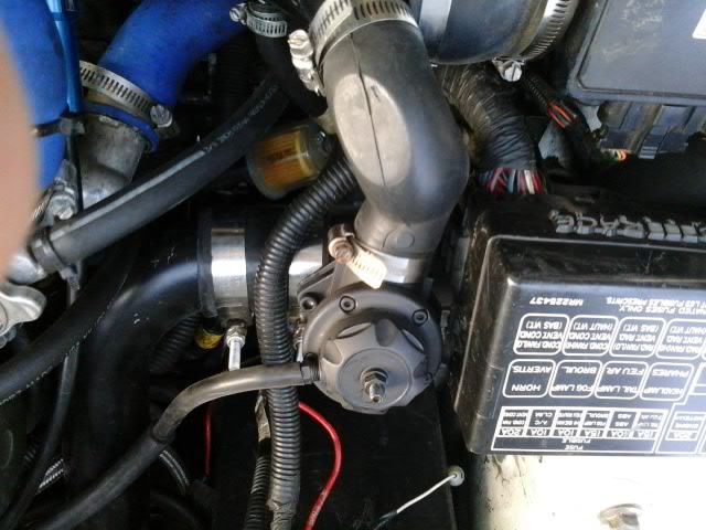

Got the cutout welded in just breaking in the clutch then ill hit up a test n tune

Got a oem sunroof for $60 thanks spawn but it looks like mine was not oem and picked up a spare tranny for $100

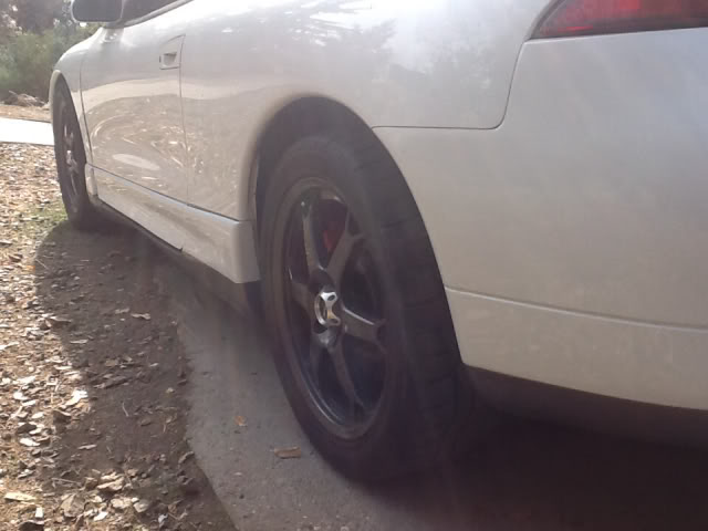

Got the drivers side raised another 1/2 inch ,i always seem to spin my front right tire..

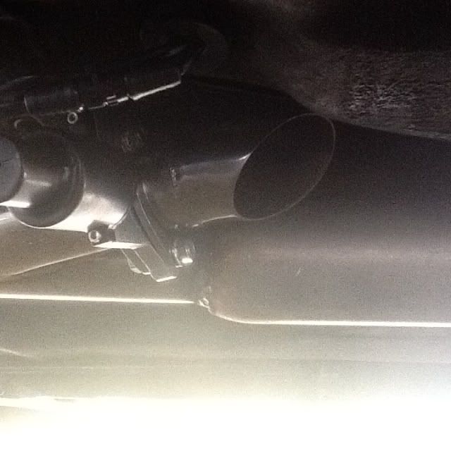

Some qtp cutout pics
Tried to tuck it up as best i could cause i live on a dirt road
No hang down

Prob how the int. is gonna stay

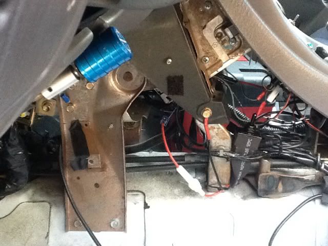

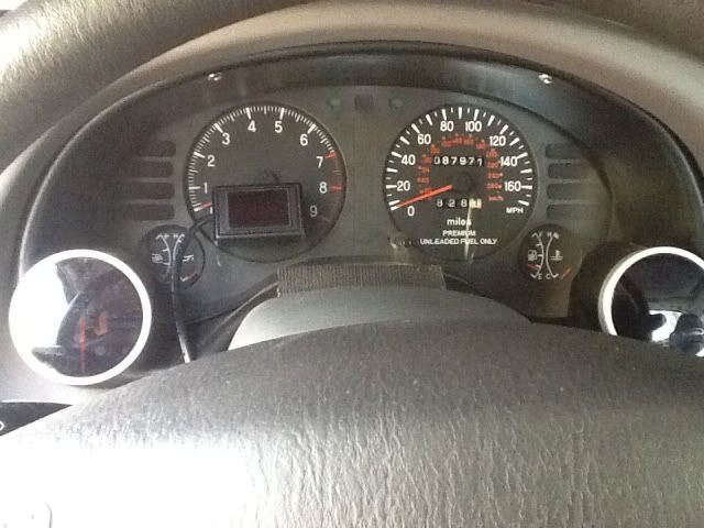

Switch with boost controller
Defis n egt
Rear lift

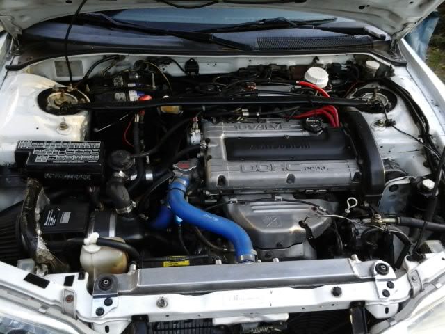

Got the motor all back together new plugs/oil change/ oem cover..just gotta finish breaking in the clutch n see what she'll do..
Probably gonna put the stock intake back on for that oem sleeper look..ha

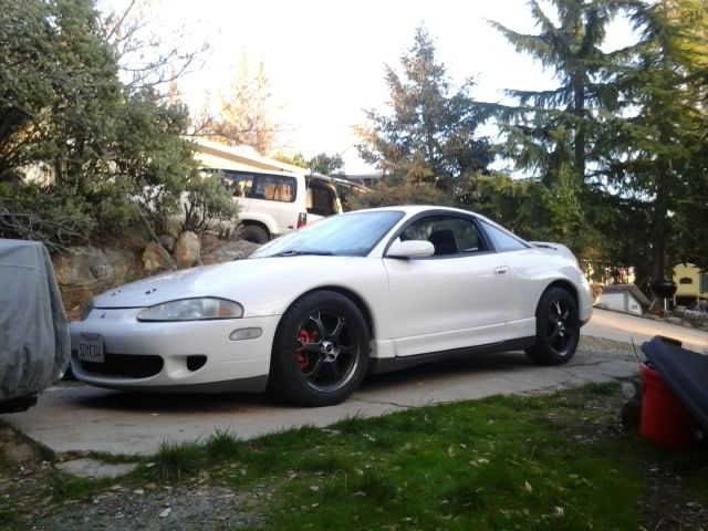

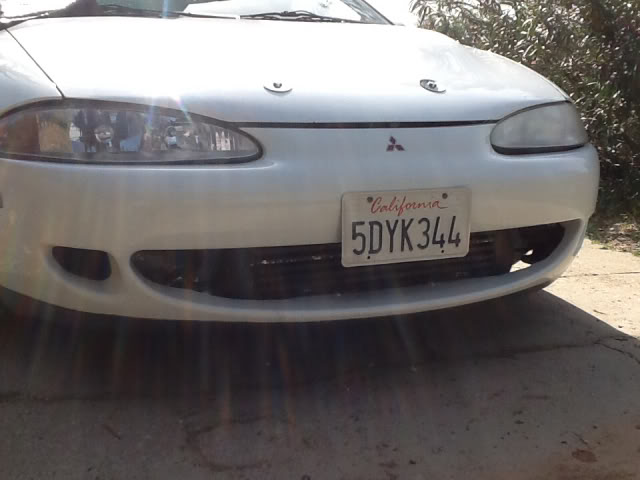

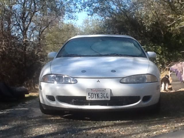

Gonna clean up the front bumper next... Cut out grille, holes behind the plate for a lil airflow at the track n re paint the grey on the bottom

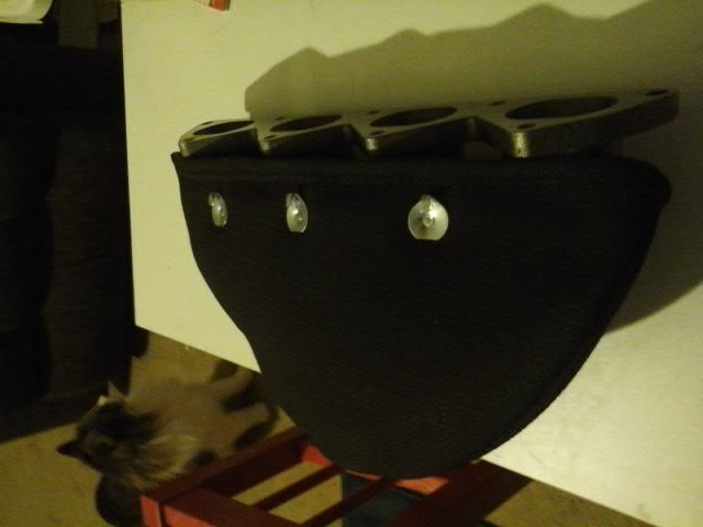

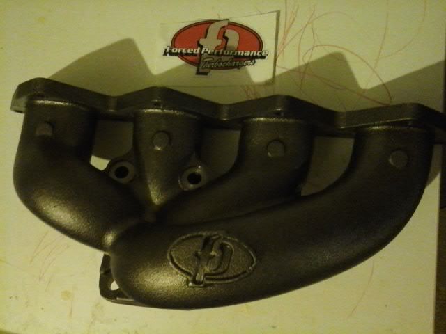

Order a fp manifold off their sale $175 n gonna have tedspec do the tunning before march 2nd first race

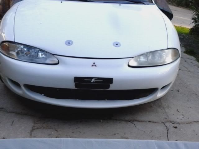

Here's my sunroof problems mine must have been a non oem one it has no bolt hole to the body idk
Inside
Oem one with bolt holes n drain

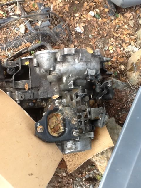

Used tranny im gonna play with

Got the rear fal window just need to mount it to the cf hatch not to shabby on a budget..order a fp manifold blanket should have that here this week...

Fp mani another piece of the puzzle my old oem was leaking since I got it..just waiting on the blanket for the mani.

Cut out grille n re painted the grey bottom , painted the bov n pipe black
Gotta fix the bumper cut didnt turn out right
