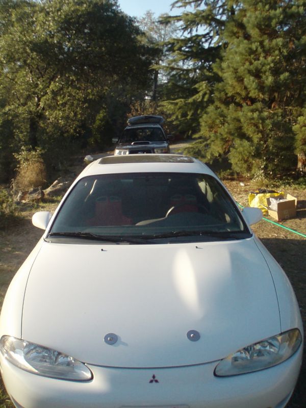

my newest project is a 95 gst gonna build it for sunday mtn. runs and a few drag races. its a mint one with 85k and 50k on the 6bolt

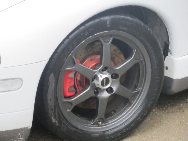

- GSX Brake 2 Pison Caliper Upgrade with Matching Master Cylinder
SS- Braided Brake Lines
- AEM Big Brake Rotor kit, Front (12.5") and Back (11.5")

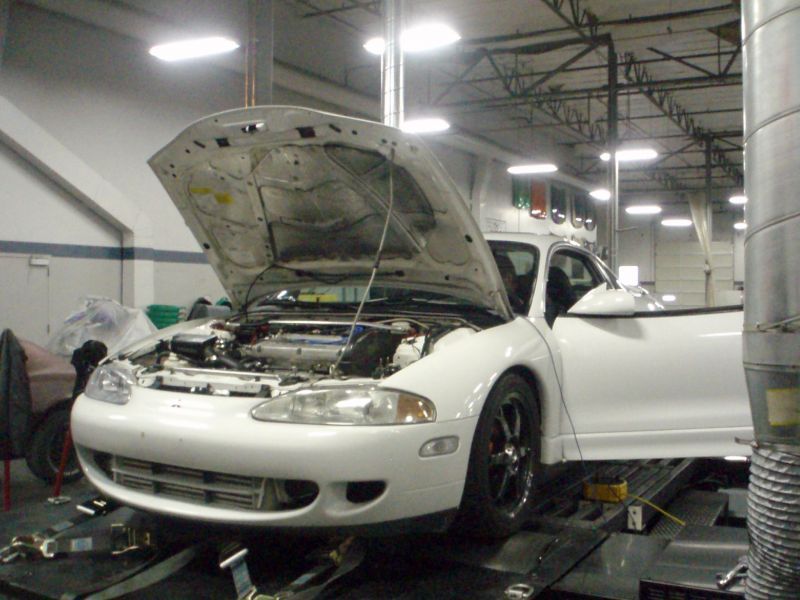

just got my first dyno tune in full street /smog trim (stock downpipe/O2/cat) and hit 230hp/ 260tq on 91 oct

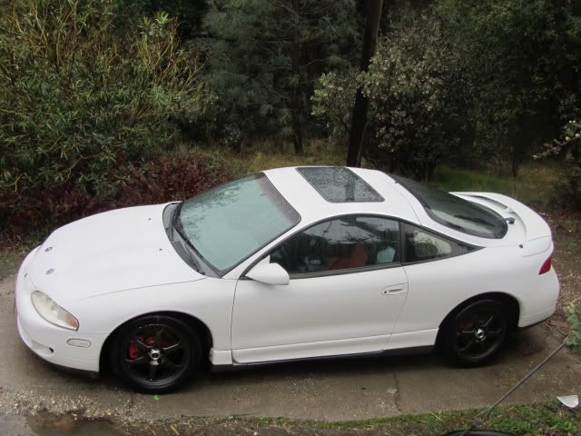

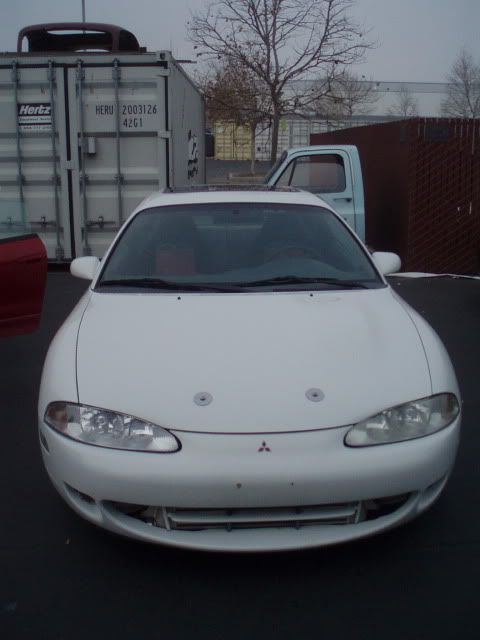

some pics

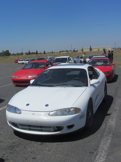

Hit the strip again on my old bfg dr's ( from 07)
2.2 sixty , 13.5@106 mph didn't do a burn out just slipped it at 3k , got a lil spin in the top of 2nd. And I kept it in 3rd gear.
Had a bad boost leak And a few crappy launches so I'm gonna fix the leak and try for 18 psi with a proper burn out, I just need some more seat time ( my 10th run total)

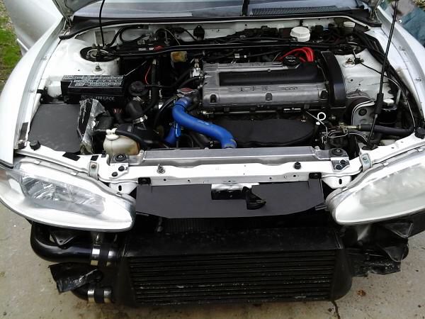

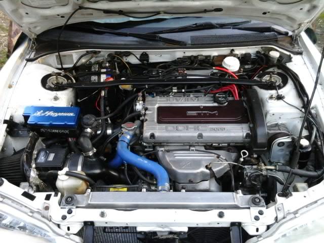

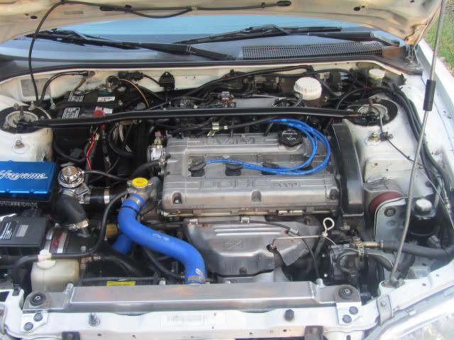

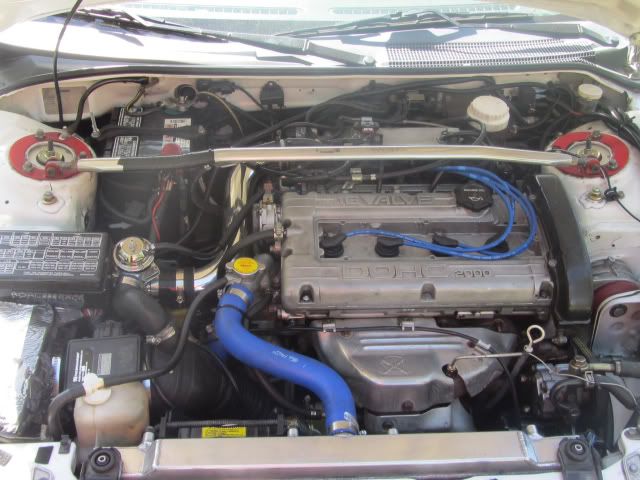

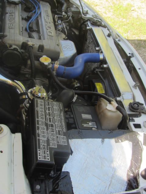

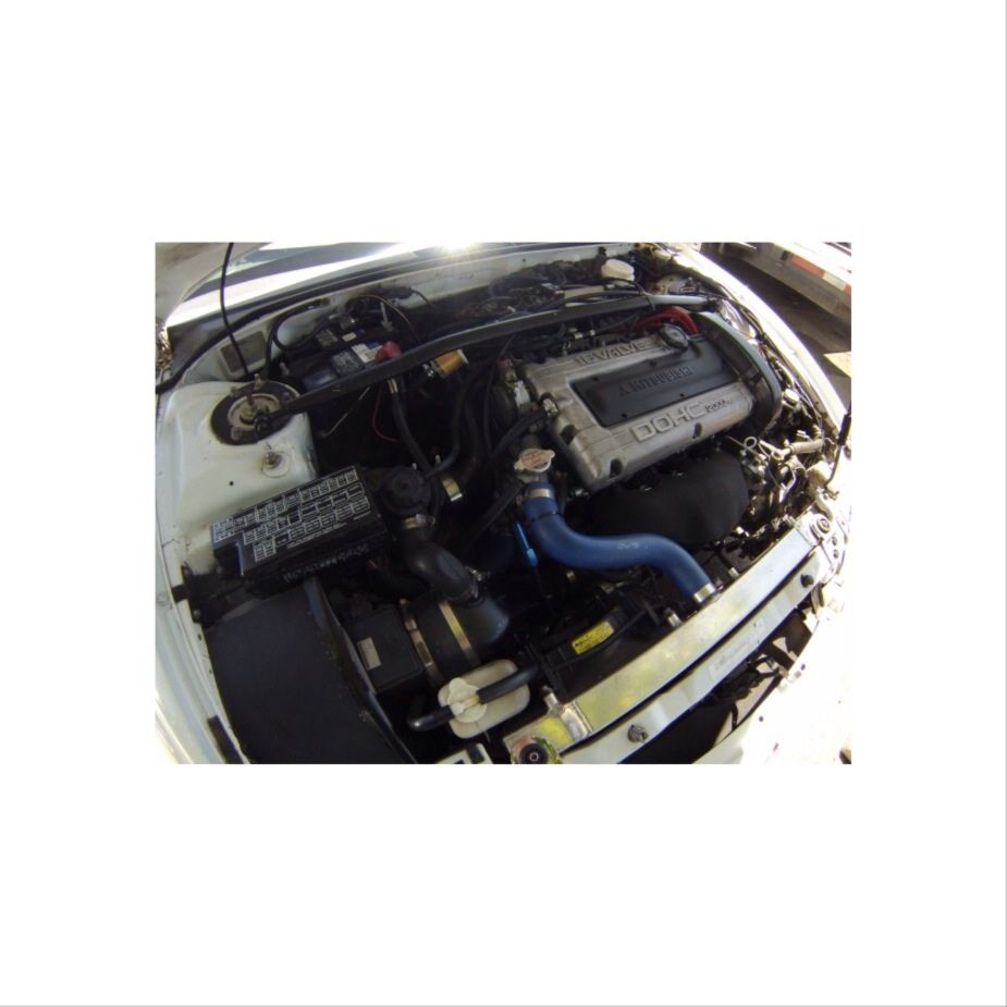

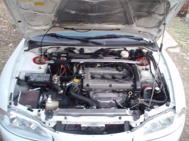

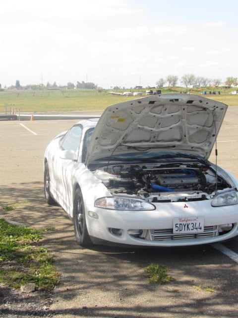

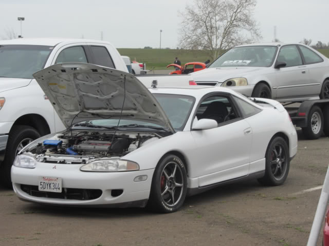

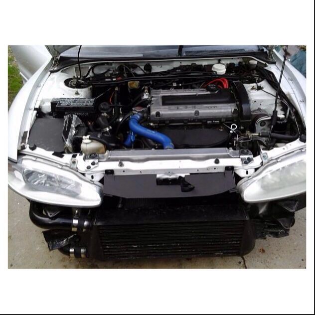

NEw engine bay shots
Super cheezy air box but it lowered ait 20-30 deg.
Got a proper air box getting built and I'm gonna paint the IC pipes black for stealth look

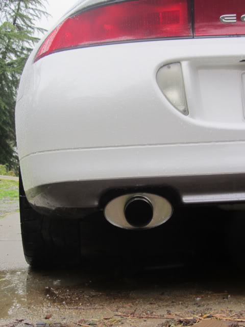

Painted borla muffler
car is looking good my friend.. i have a 1998 2gb auto fwd.. same turbo just lil more supporting mods... do you mind if you post some pics of your turbo from a top shot so i can see ## j pipe setup..
debating if i should put a oil filter with this turbo.. great turbo tho i havent hit high boost yet

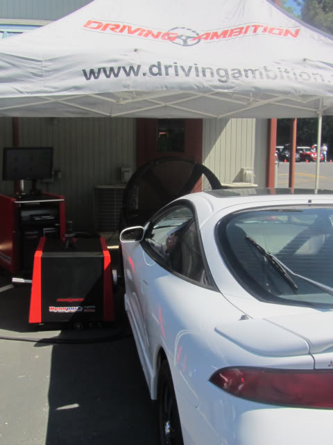

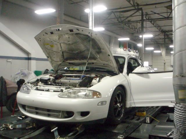

Just hit the dyno ( dynapack hub dyno )
With the injen intake and 17-18 psi it hit 229hp / 269 TQ
I didn't really feel any extra power from the injen ( my old k n n was a lot bigger filter )
