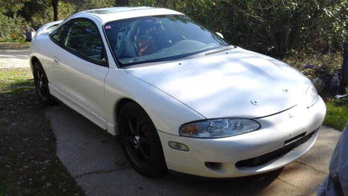

1995 GST 6bolt FP Big28 Street/Drag
Gst-street- drag autox

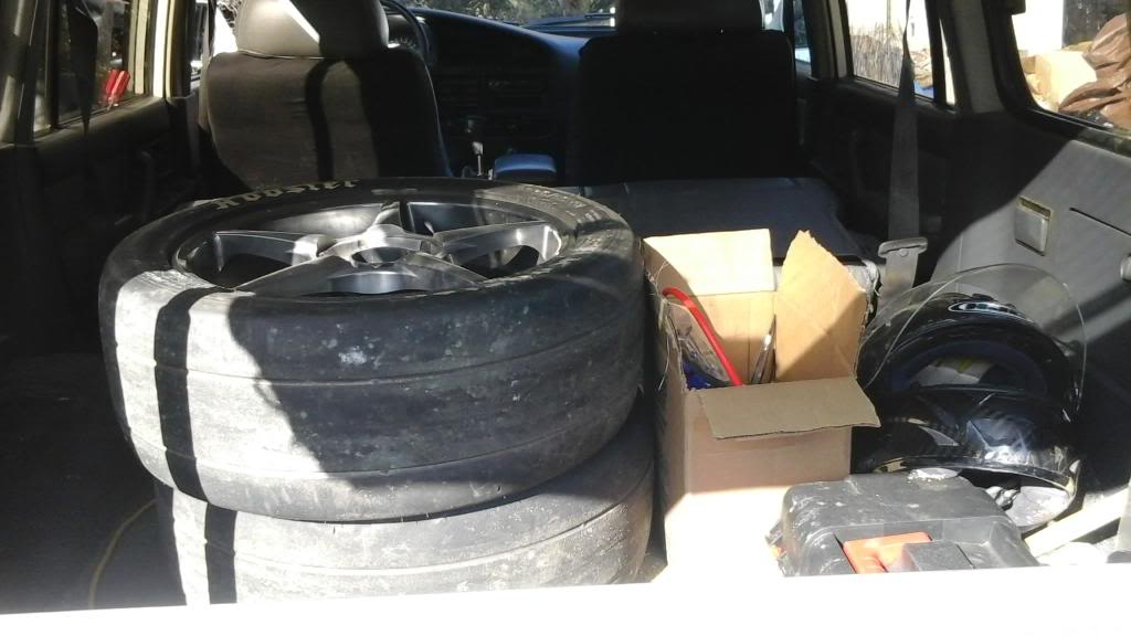

Drove the car 25 miles to get some exhaust work n a dry garage to work on it...had no tags, no sunroof, window was broke and the wipers sucked it was a fun trio in the rain..haha

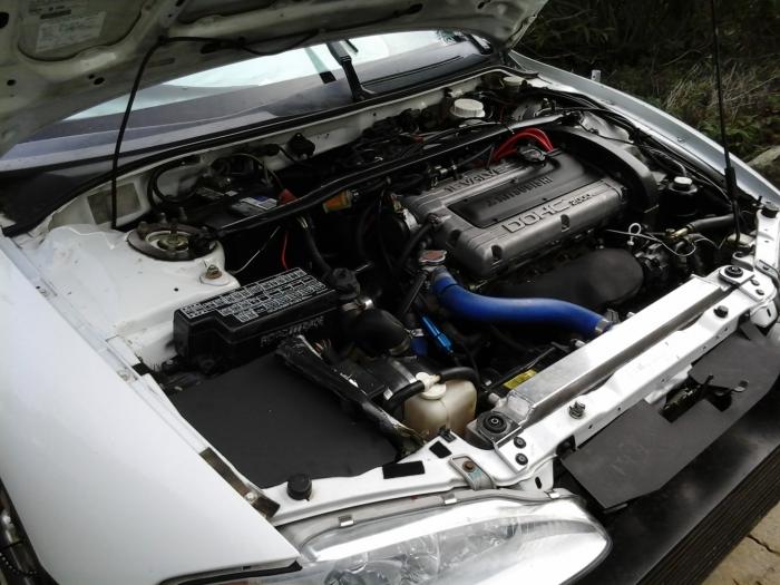

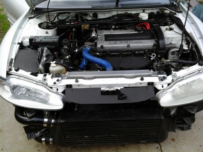

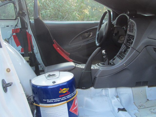

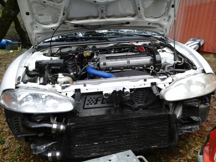

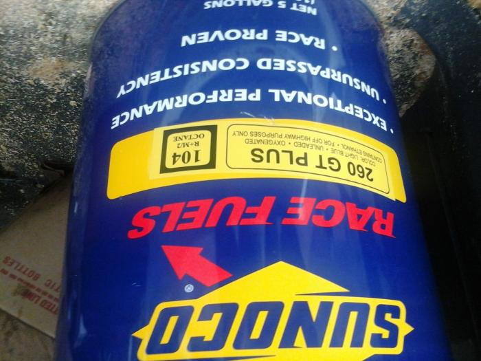

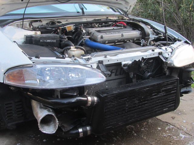

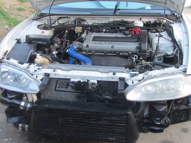

got some race gas and aem wideband n fp manifold put on didnt get the hatch on for the race..should be racing sunday if it doesnt rain
Gonna be pushing around 20-22 psi this race n up it to 25psi in April. Hopefully my last race on the ol t28
if your in norcal and need a tuner hit up ted @tedspec

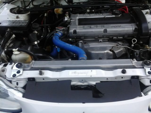

Got the fp manifold n blanket put on n aem wideband installed hoping for no rain tomm so I can race...

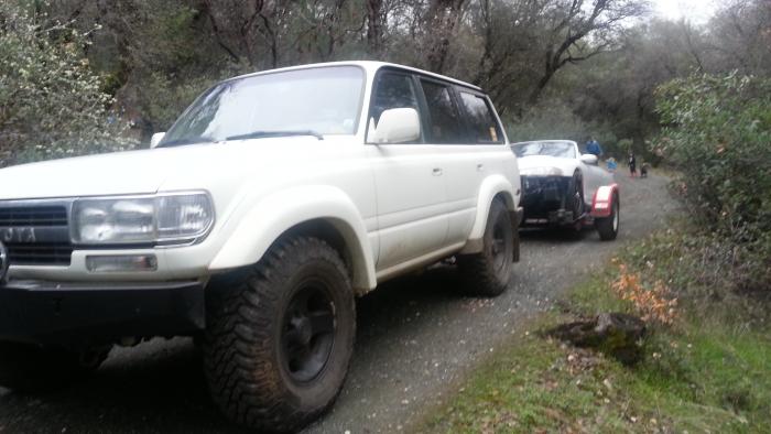

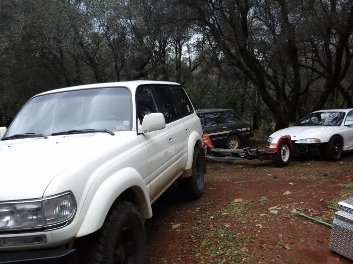

my low budget tow setup 300k mile land cruiser

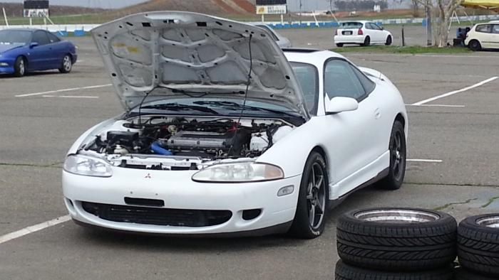

Race got canceled they let us run a really crowed test n tune only... got one run off the trailer to get a log n bogged the launch 2.3 60 ' ran it up to 6800 n left off early n got a 13.0 @106
ran at 18 psi.. this new act 2600 is rough to launch....
tedspec dialed the tune in a lil bit but its looking real good so far...
im think mid 12's @116 next race
Yea I was just doing a easy pass, the t28 is a mean lil turbo for sure I think lauren from fp got a 11.9@119 out of it .
ill be back at the track in 2 weeks to break some muscle car n honda hearts..haha
Next race ill up the boost to 21-23psi ..and the track should be prepped its was a no prep rainy day :(

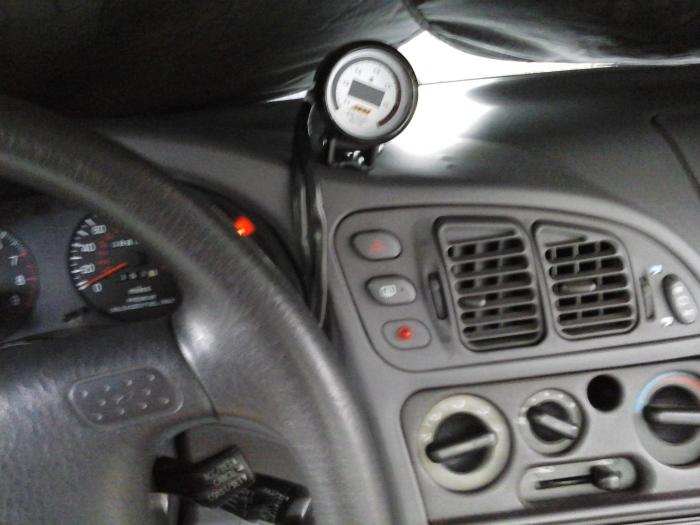

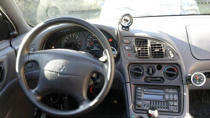

mounted up my aem gauge n started my air box

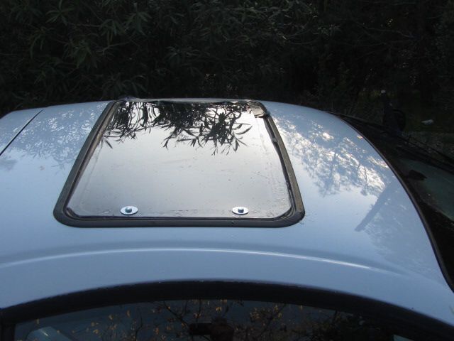

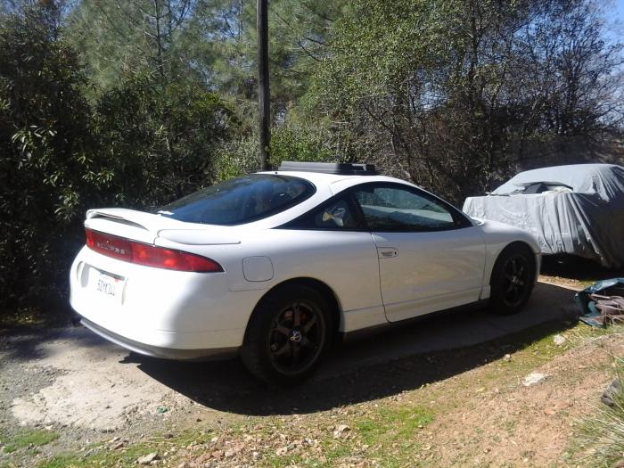

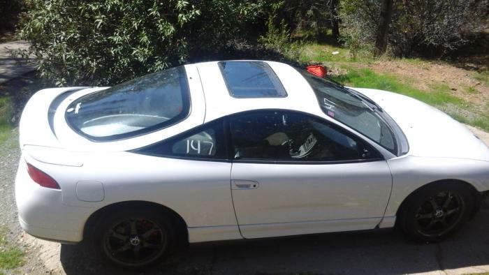

Cheesy lexan sunroof used 1/4 bolts n a alum spacer

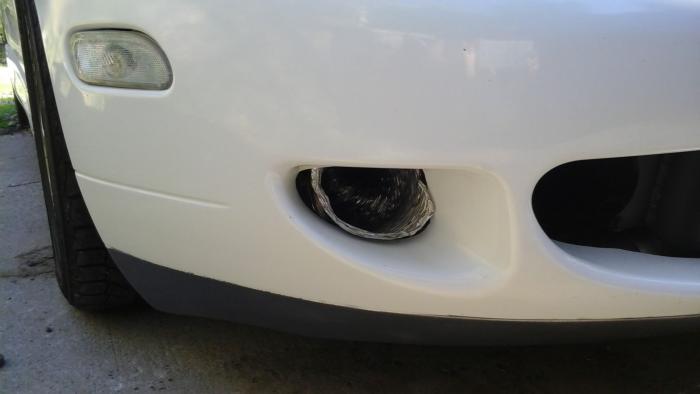

Air intake to the box
Air intake
Those brackets that hold the front bumper on are good to ditch for weight savings. Since you're not running your bumper anyways. If memory serves, they felt abt. 15 lbs each when I took mine off. Maybe more than that.
Nice build.
Nice build.
Thanks I run a bumper though its just off when I need to tow it to the track
