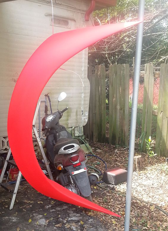

Well another weekend came and went and did not get all I wanted to get done!. Was able to Dip the New Spoiler so I can mount it this weekend. I need to figure out what I am going to do about Gaskets for it though? Thinking about using Felt.

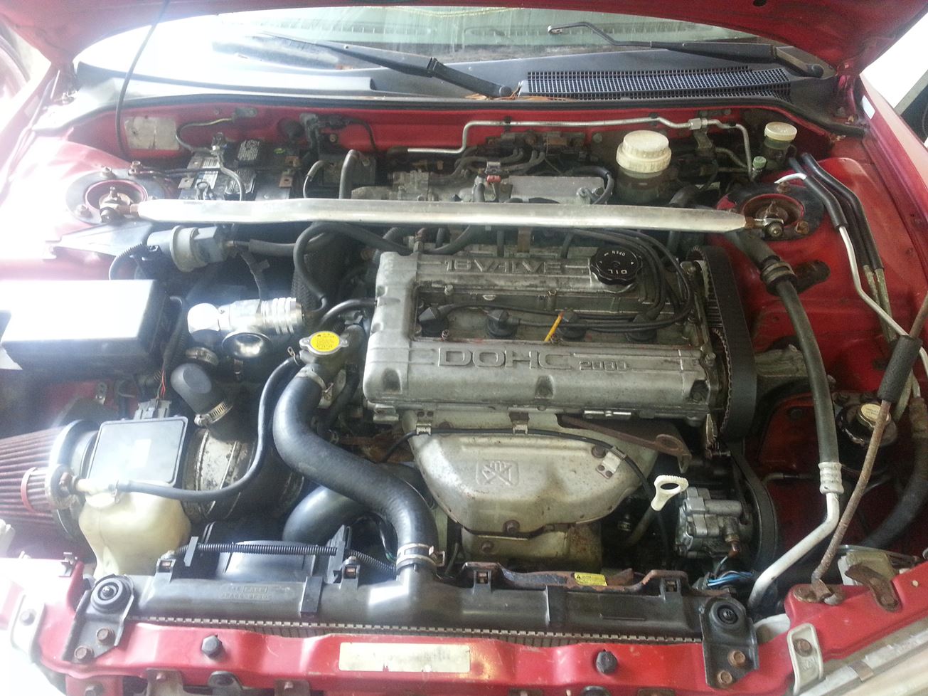

Also Been sing Torque App and Finally got it to start displaying Boost/Vacuum.
At idle I seem to get about -20 Vacuum and as I build up boost it goes to the Positive.
Curious if this number is a good thing..
-20hg of vacuum is a good number :)

Usually the turbo timer is used on a non-water cooled turbo to allow it time to cool with oil circulating through it, like my Holset turbo. You probably still have water cooling yours so I wouldn't worry about it right now. Mine is only oil fed and even I don't have a timer but I sit in the drive, parking lot etc for a good minute before turning the car off. Most of the time it's not necessary, only when I am at the track doing a hard pull is when I will sit and let the car idle awhile before turning it off. Ebay turbos are for the most part just Chinese junk and will last a few months then give out. Everyone on here will tell you not to buy Ebay items and do your best to use OEM parts for these cars. When you get ready for a turbo upgrade, we have a very good turbo man on this forum and I recommend him. You can PM me for details when that time comes. What are you using for engine management or is it the stock ECU? Upping boost without a way to add fuel can lead to a lean condition and be very detrimental to your engine. Just FYI. Keep up the maintenance and enjoy it.
Right now still using stock ECU, I do want to get DSMlink eventually LOL need more loot LOL. Car came with a reported 16G EVO 3 GT Turbo LOL from my understanding its a ebay turbo LOL.. I do get some boost in the upper 3-4k range. Not a lot of boost but i can feel it. I am not sure if this turbo is water and oil or just oil... still noob when it comes to turbos.
I want a good Garrett or something like that.. but I am looking for a turbo that will fit my current setup and be better than mine of course LOL

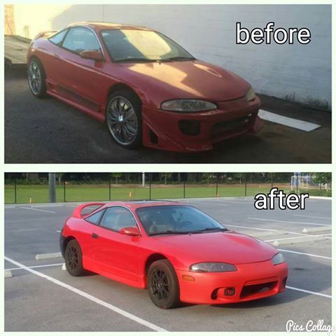

Added a before and after photo of my car . God do i still have alot of work ahead of me and little loot to do so LOL.
