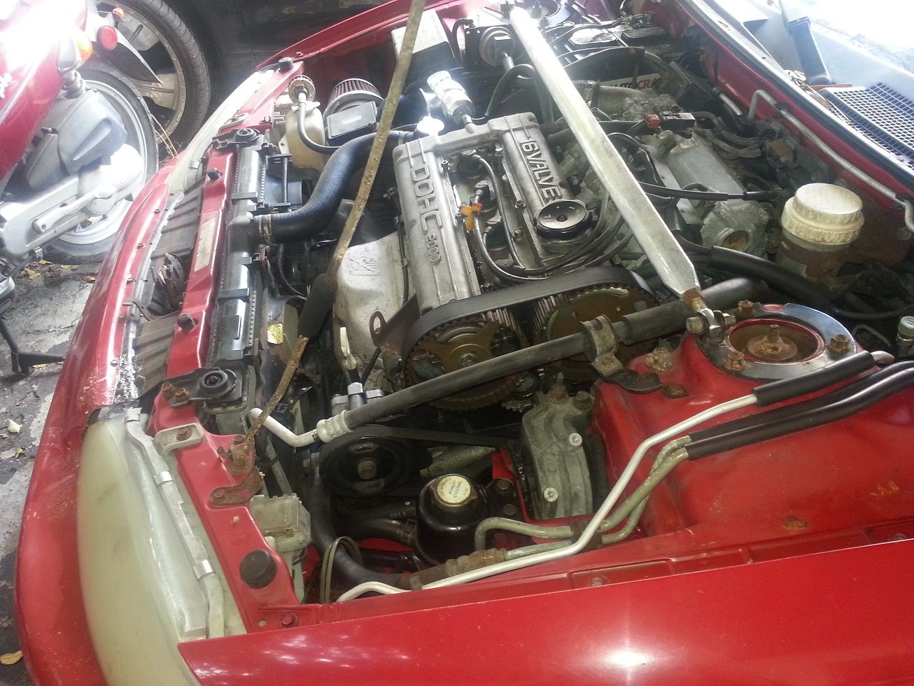

Found this Diamond in the Rough ( Hopefully) for 1k. Has 112k miles on it. A little Ricey at the moment but planning on taking care of that first thing.
Dragnous updated 1995 GST
If anyone else may have noticed I have well passed on my 95 GS. The car's Engine is just passed what I would like and the Rings are shot. The car will never be exactly what I want and figured it was time to move on. I am now a DSM fanboy more so than i thought so started looking right away. Found this 1995 GST on Craigslist. To be truthful I actually passed over it several times due to what i saw in it. But As my budget or lack there of one would have it I kept coming back to it. I went to look at it and the engine sounded great, No oil leaking, no rust in engine bay. It does have some cosmetic damages and blemishes but nothing that I shouldn't be able to take care of. I do have a Donor now for some of the body parts.
This is my first GST and 2nd DSM and any tips and help anyone would be willing to throw my way will be appreciated.

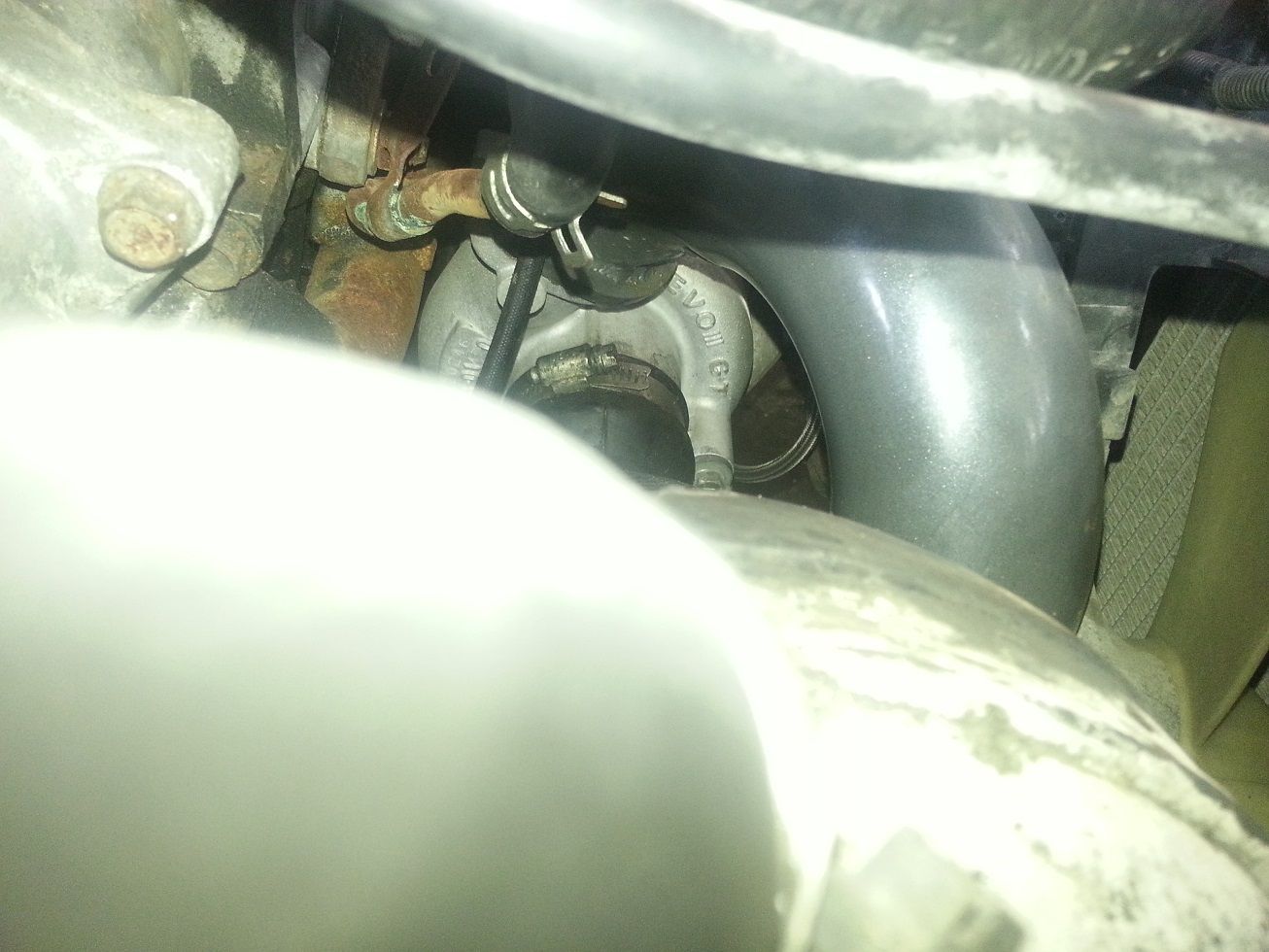

So Looks like I am in need of a new Cat So Looking into the whole 9 yards.. Headers, Download Pipe, cat-back etc.
As for the headers Do need a special Fit style to accommodate the turbo? Still a noob to turbo stuff so was curious so i can plan accordingly.
Also How much different is the cat back from a NT 420a compared to a 4G63.

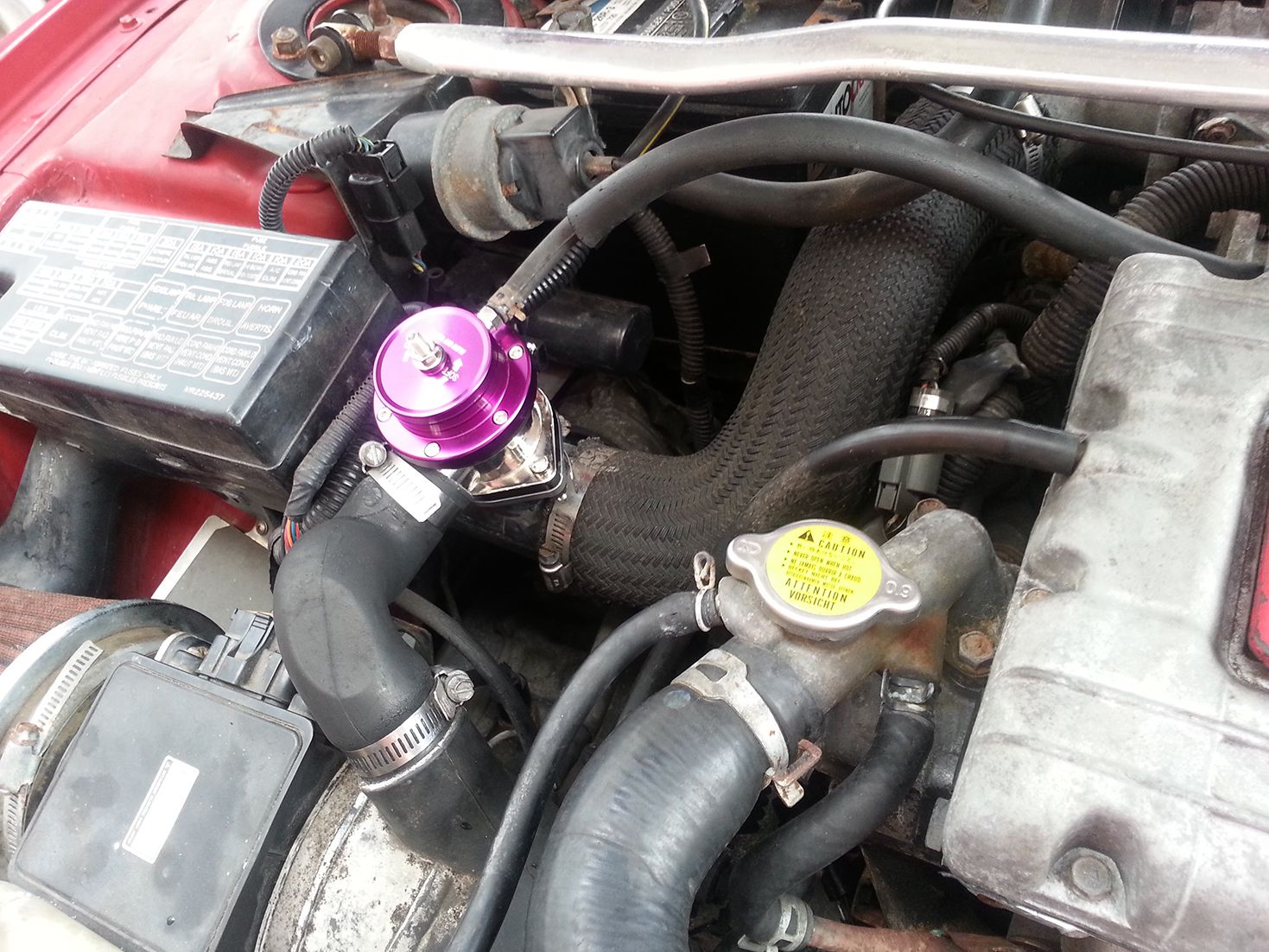

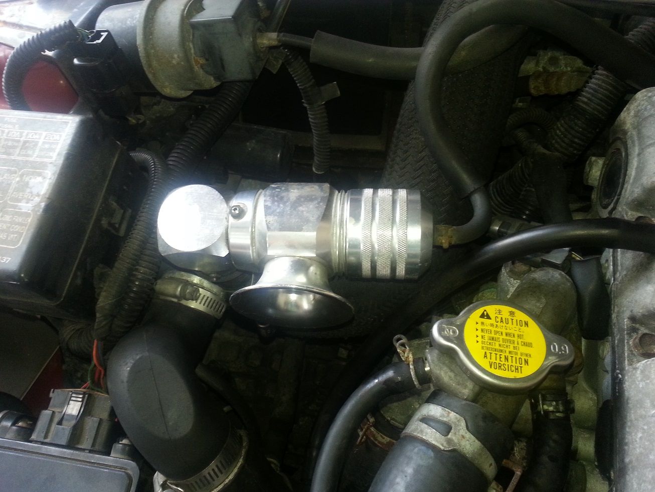

Ordered the BOV Adapter So i can install and recirculate the new BOV.
Pretty Much it.

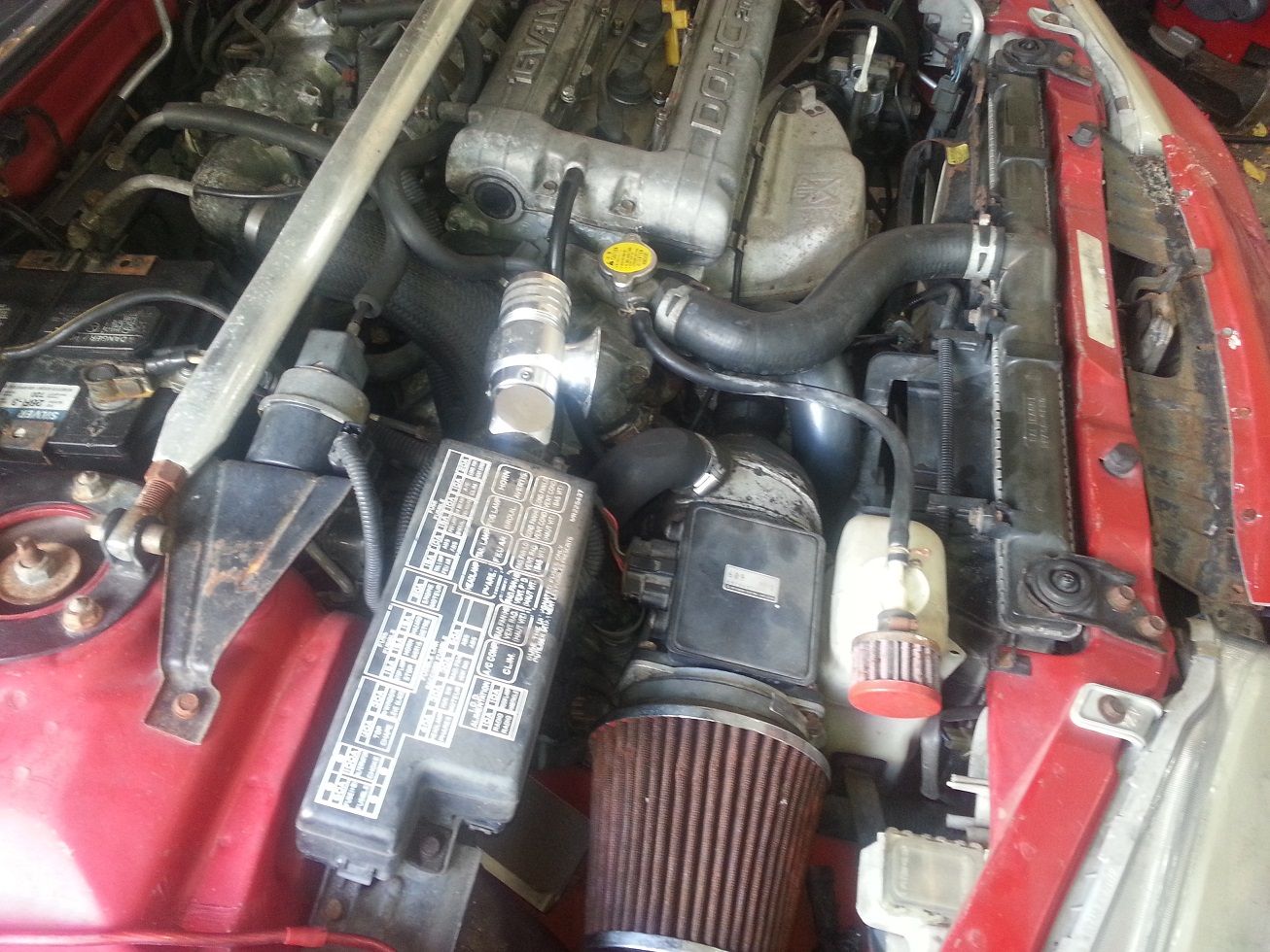

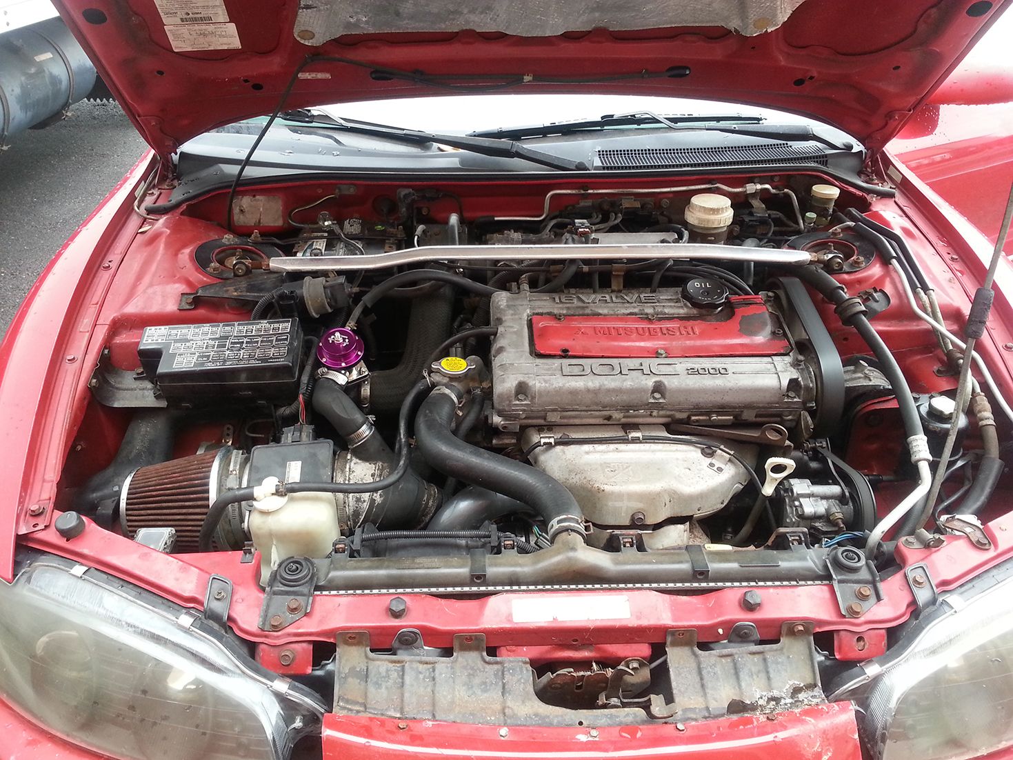

So today I have installed my new BOV and is Recirculated. Looks by far much better. However may need to get some new hoseing as the openings where a bit larger than the adapter so right now really clamped down.
Thank you to 2gGST98 for the Donation of the BOV. I love it and thank you very much.

No problem man, glad it's on and working. It looks good hope it sounds good also. Let me know if you need anything.

The 420a catback will bolt up to the gst the piping on the NT exhaust is smaller though. The cat itself will not be able to be used from the NT car because the flange is rotated about 45 degrees differently than the gst

Going to order a new K&N Filter.
