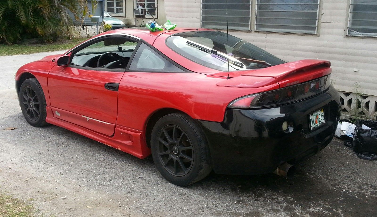

Found this Diamond in the Rough ( Hopefully) for 1k. Has 112k miles on it. A little Ricey at the moment but planning on taking care of that first thing.
Installed the OEM Bumper on the rear...
Just need to get and install side skirts, wing and paint.

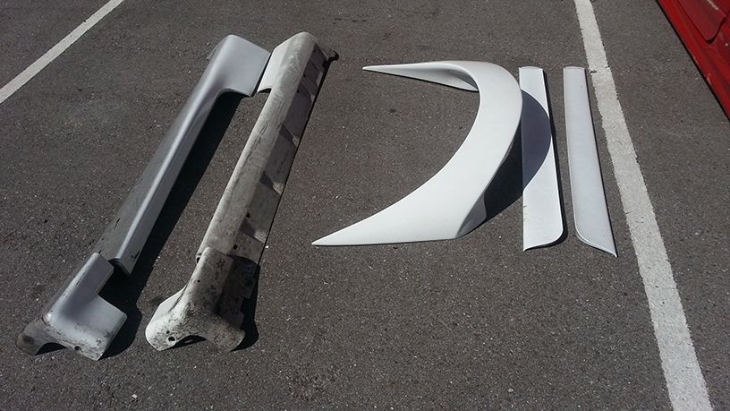

Obtained the 2GB SideSkirts and High Rise Spoiler.
Shout out to Drift247365 For the parts.
Next step Clean and Prep... Going to wait to install till its time to paint car and I will have the painted off the car so everything is nice and purty

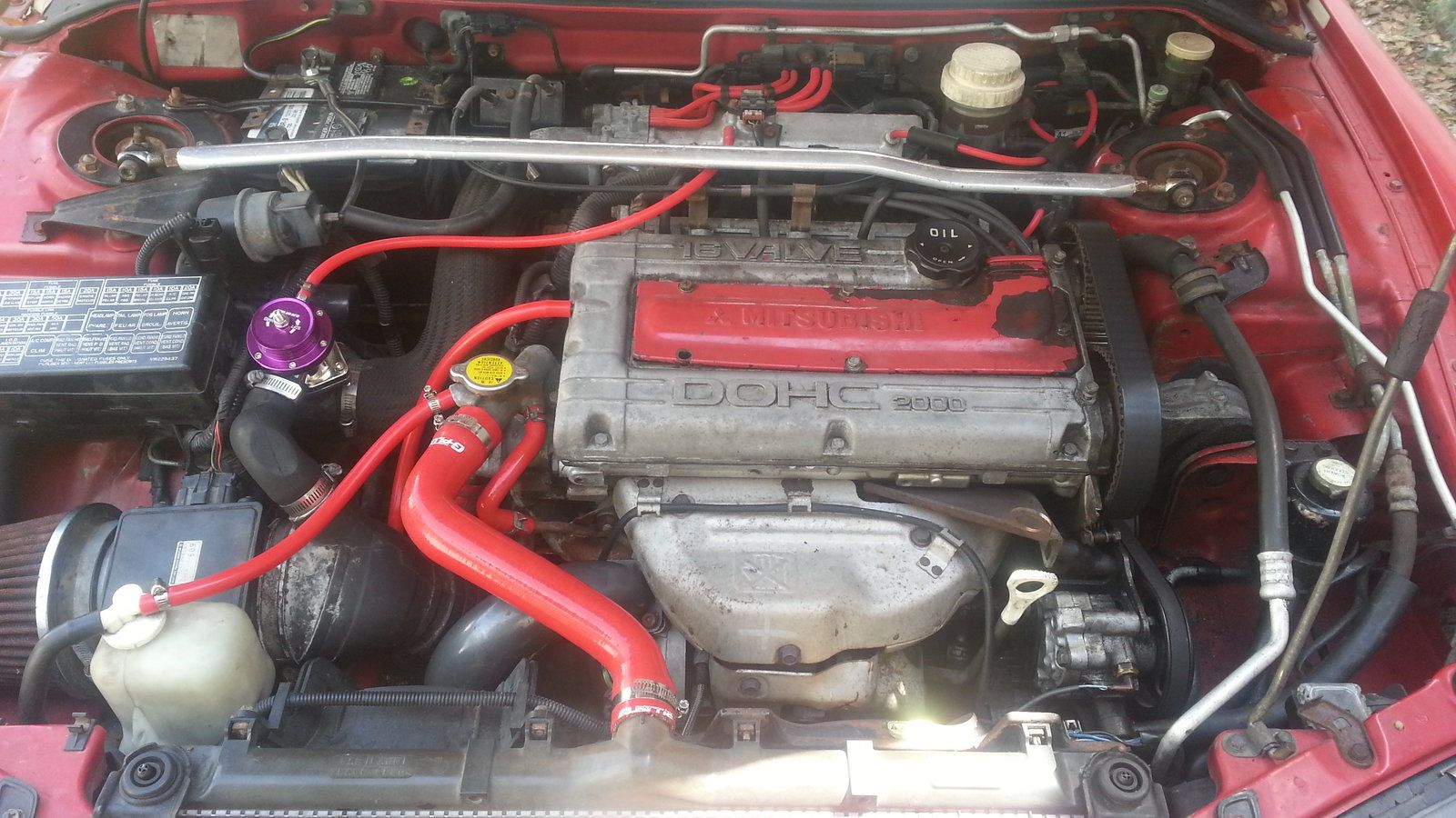

Did a little bit of work this weekend.
Replaced Upper and Lower Radiator Hoses. and some other hoses as well.
Replaced a lot of dried out and broken vacuum lines.
Tighten up the accessories belt so it stops making annoying sounds LOL.
Fully Charged AC system and Now i get cold air.. (ME DUMMIE and forgot you have to have car and ac on when filling LOL)
*Edit: Just realized i put my strut bar on wrong.. Fix that on lunch I will.

I need a new Spark Plug cover, and a new valve cover.. I know its not horrible but I broke one of the spots where the spark plug cover screws into LOL..
Thinking about pulling one from junk yard and cleaning it up and painting it and swap it..
Still need to do a engine bay clean.. Looking at foams and what not...
is there suppose to be a support or mount for the air filter? Mine just kinda free floating atm.
Also I need new K&N Filter bad LOL (Next purchase).
Mine is free floating alo. Some people make a box over in the corner I may do that with sheet metal. And a junk yard is where I got mine also.
As far as engine degreaser I get some really good foaming stuff from advance auto that made my block and train lock almost brand new, used when I swapped my head out. I'll get the name of it later.
That would be great. Want my engine bay to be as good as i can.. ( Not going to delete anything as I dun feel its necessary to do so. ). May relocate Fuse box. otherwise going to get some wire sleaving kits but yea.
