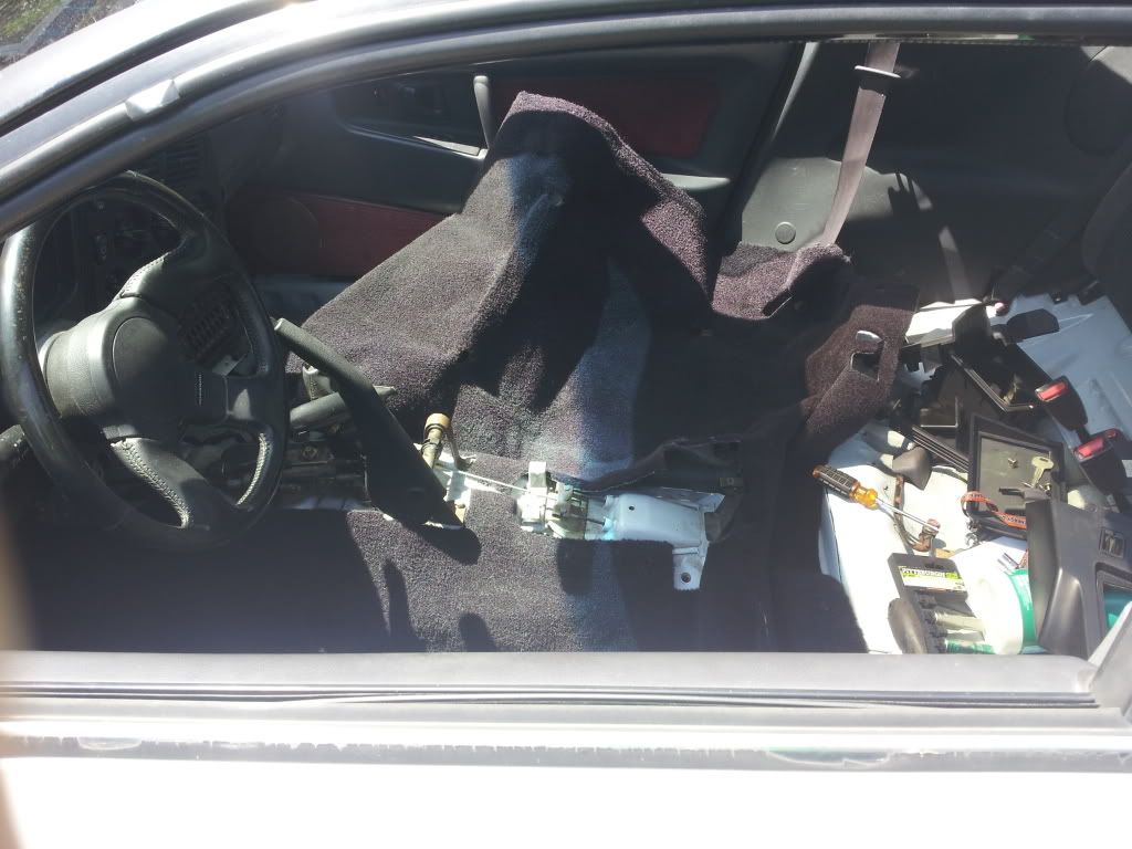

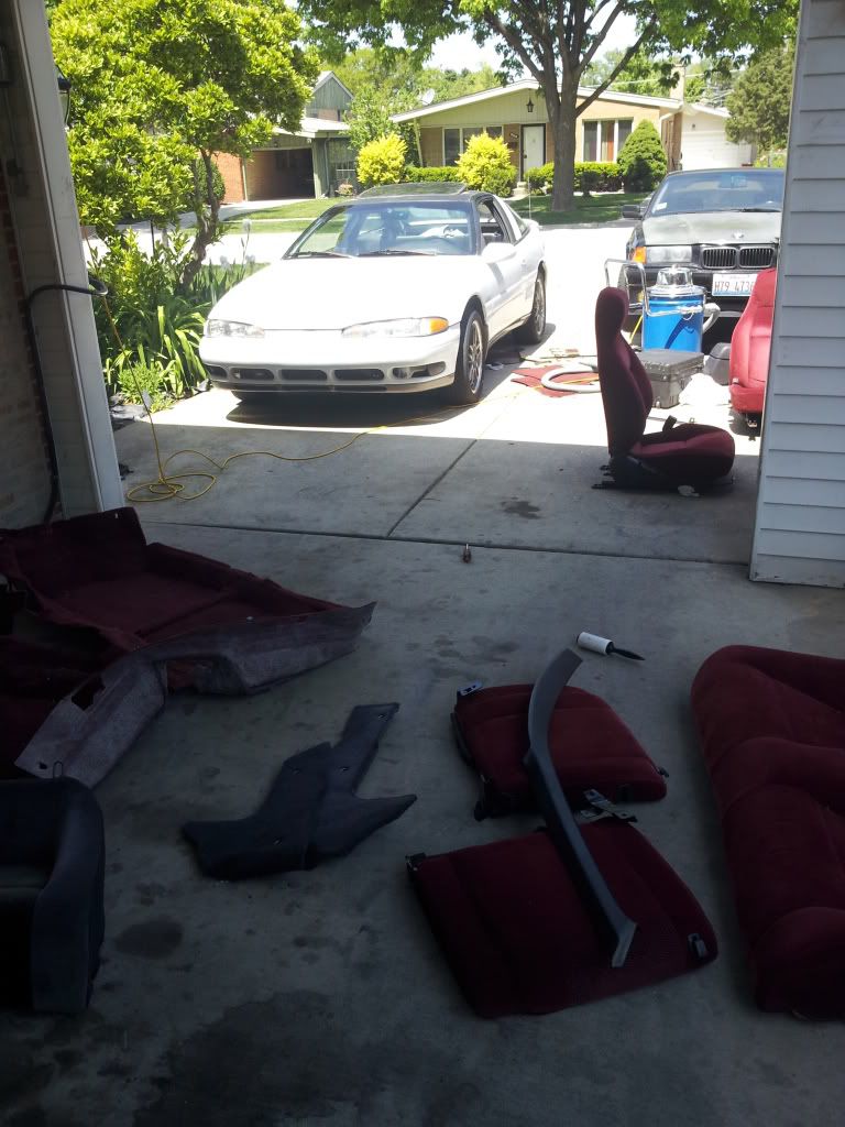

Thankfully still having my 1g talon shell, today I pulled out the red interior and swapped it with my black carpet and gray seats. Looks 100 times better IMO.
In the process of swapping it out:
Putting the new stuff in:
And I completely forgot about taking a picture after it was done, just glad it's all swapped out now.

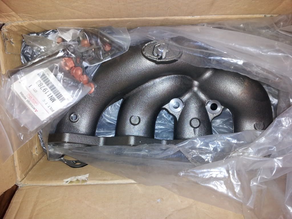

Today I noticed that the radiator was leaking from the plastic endtanks so I just ordered an aluminum radiator off of ebay. Also got a new fp manifold for 150 with gaskets and bolts from a buddy :D
I'll give some real updates of whats going on tomorrow.

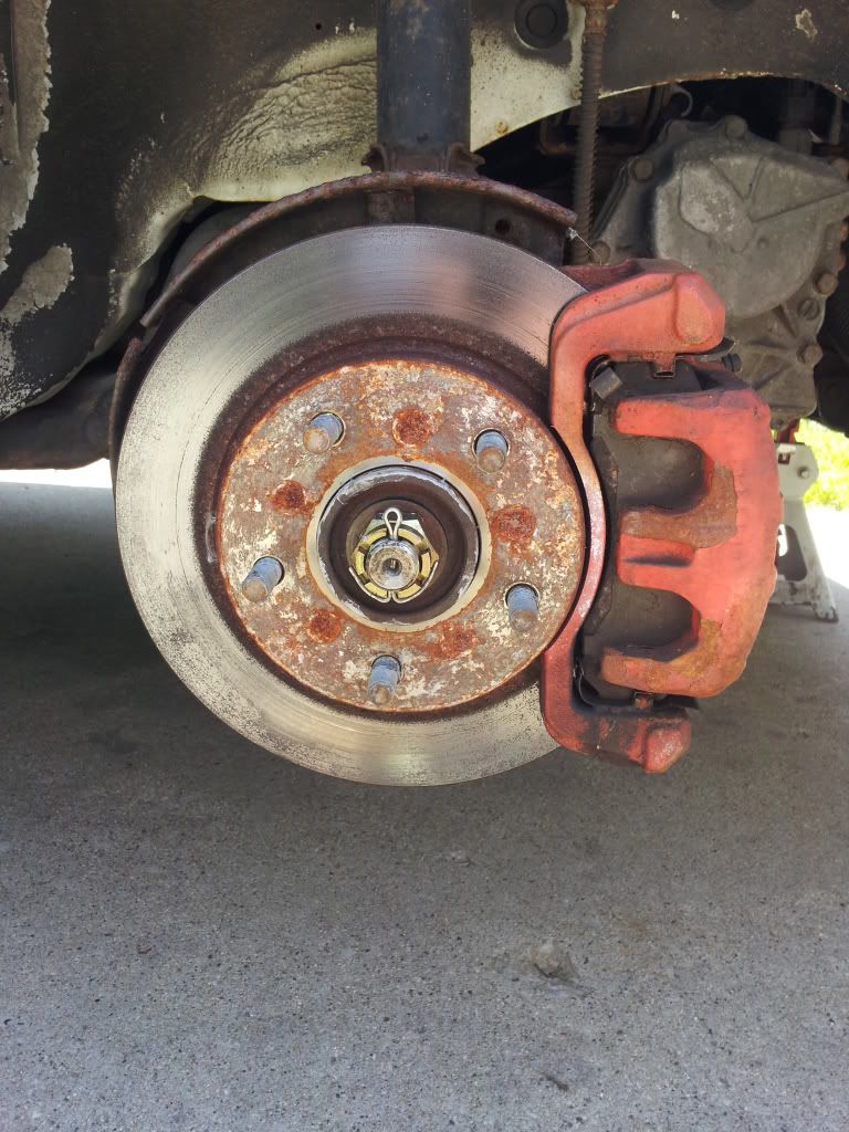

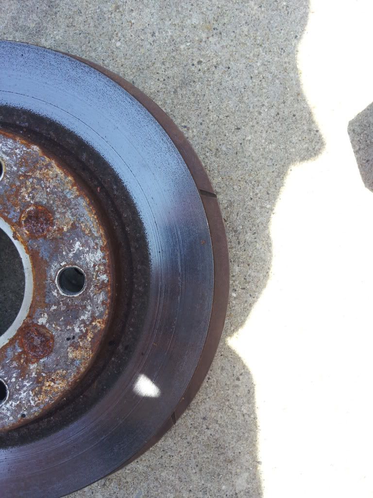

So a few days ago I took the wheels off my 2g and put 'em on the laser, as soon as I took off the front wheels I noticed the rotors didn't look like awd ones so I took em off, and I was right. Oh well, good thing I got new slotted rotors and new pads on the 2g so I swapped those out also.
Hard to tell in the picture, but in person you can definitely notice they weren't the right ones.
Wrong rotors over the slotter awd ones.

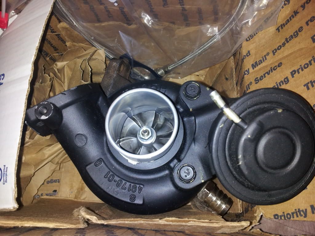

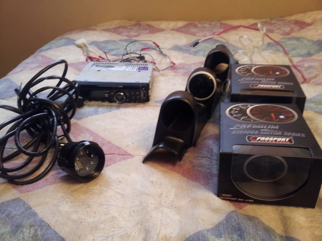

aem wideband, prosport boost and oil pressure gauges, 3 pod a pillar, single din radio(need to find a radio install kit if anyone has one)

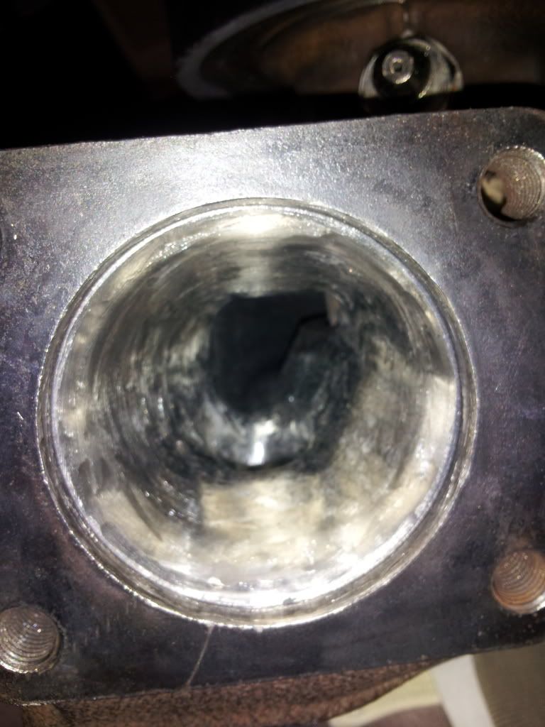

bastard 14b(18g wheel, 7cm hotside)
ported hotside
fp manifold and misc. bolts

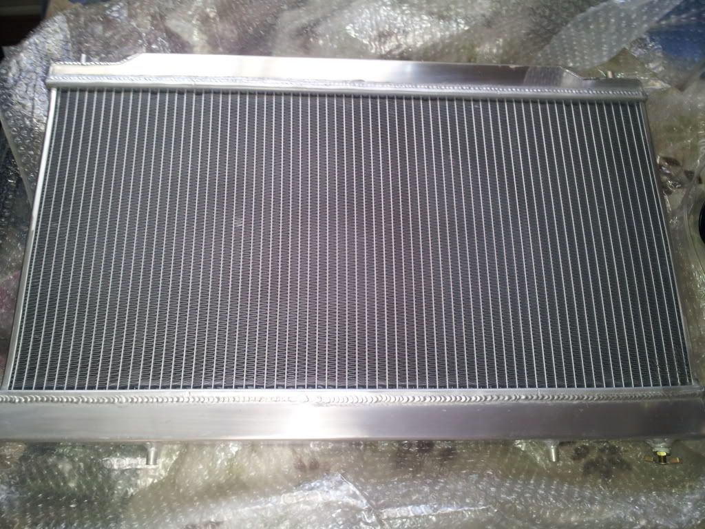

aluminum ebay(cxracing) radiator, and I have a slim fan for it
Gonna install the gauges tonight and start putting the rest of the things on soon.

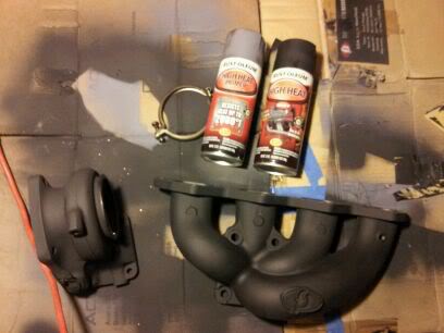

Got some hi temp primer and paint, did this on my old car's mani and exhaust housing, lasted for quite some time before it started to peel off slowly, I'm not a big fan of the rust look.

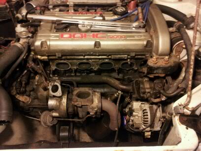

Just took a pic of how dirty and greasy it was. Tomorrow I'm going to de grease it all and put the new parts on.
On a side note, I found out that my turbo has no coolant ports, after doing a quick google search it seems that my turbo's actually an 18g with a 14b compressor wheel. I'll have to look into it more but for now we'll see how well it runs. Also I got an interview at a really awesome performance shop on thursday, hopefully I get the job :D

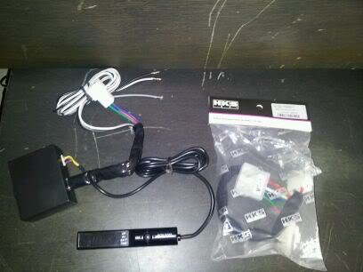

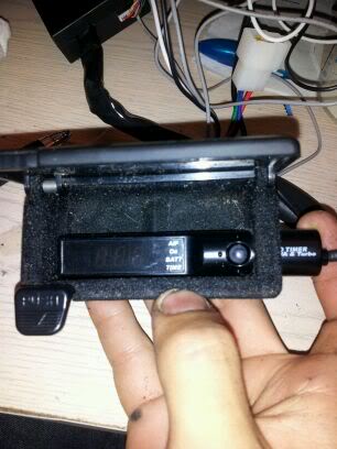

Fixed that, ordered an ebay turbo timer and p&p harness, and started figuring out a clean place to mount it.
Starting cutting out the area for it, going to clean up some of my wiring and install it tomorrow.
