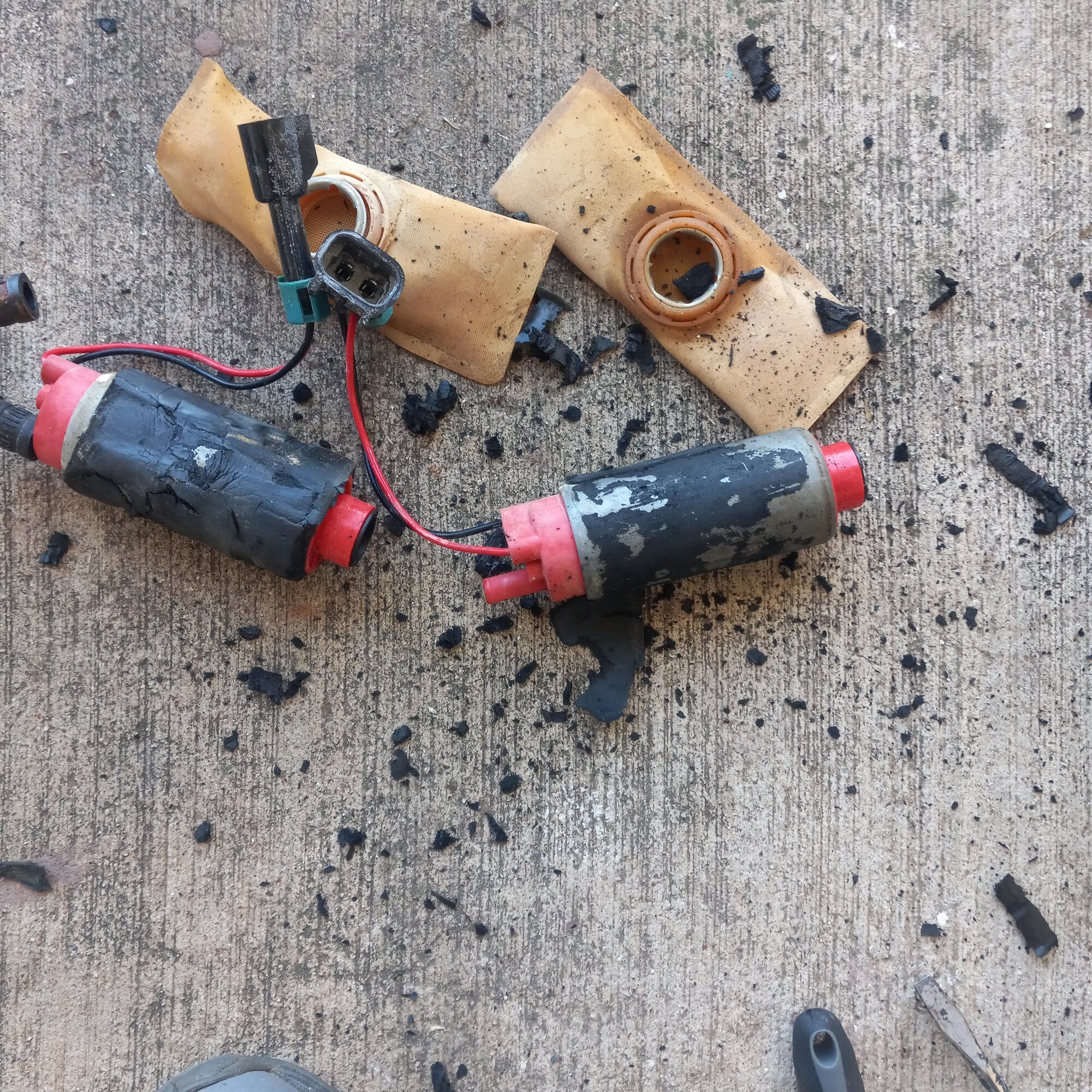

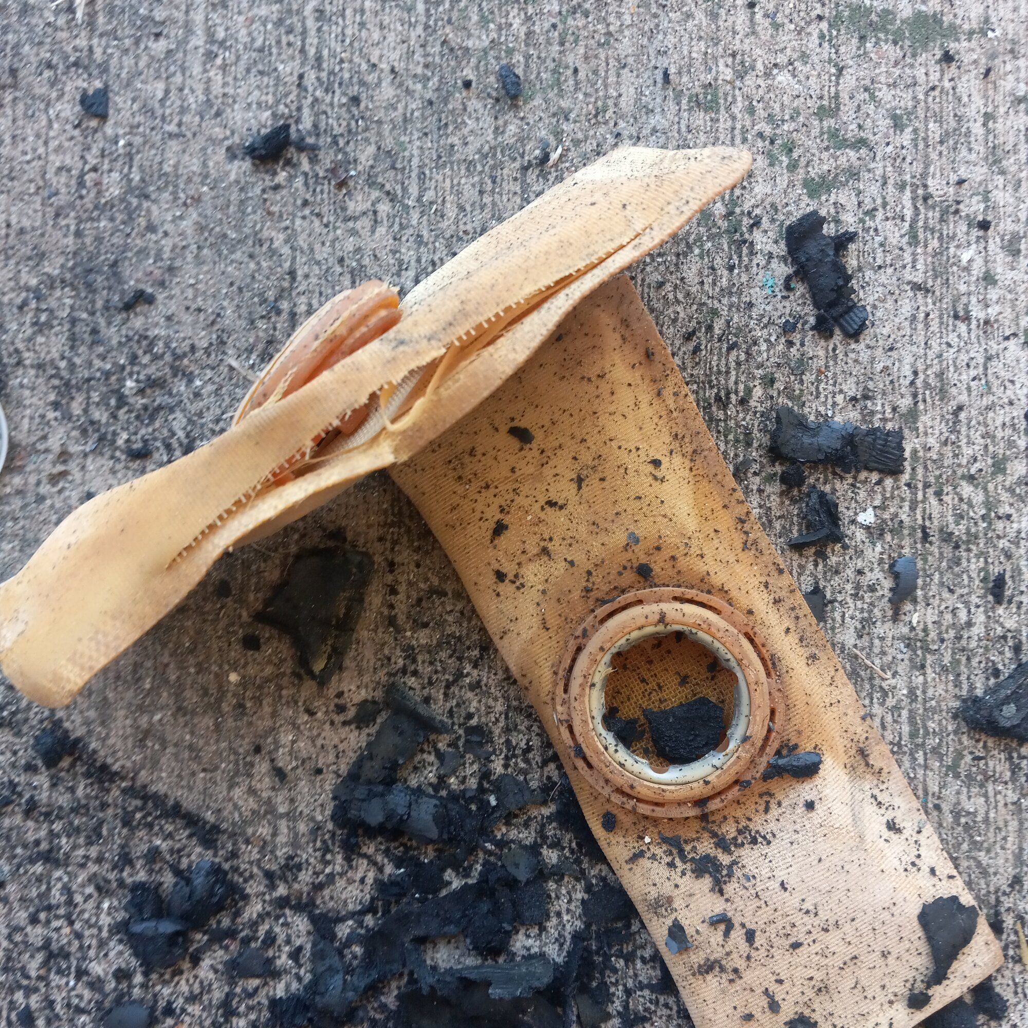

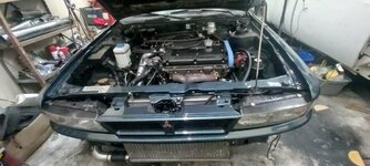

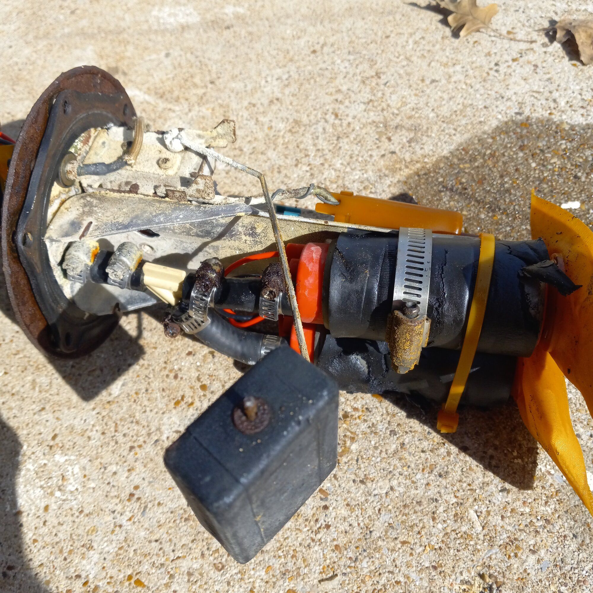

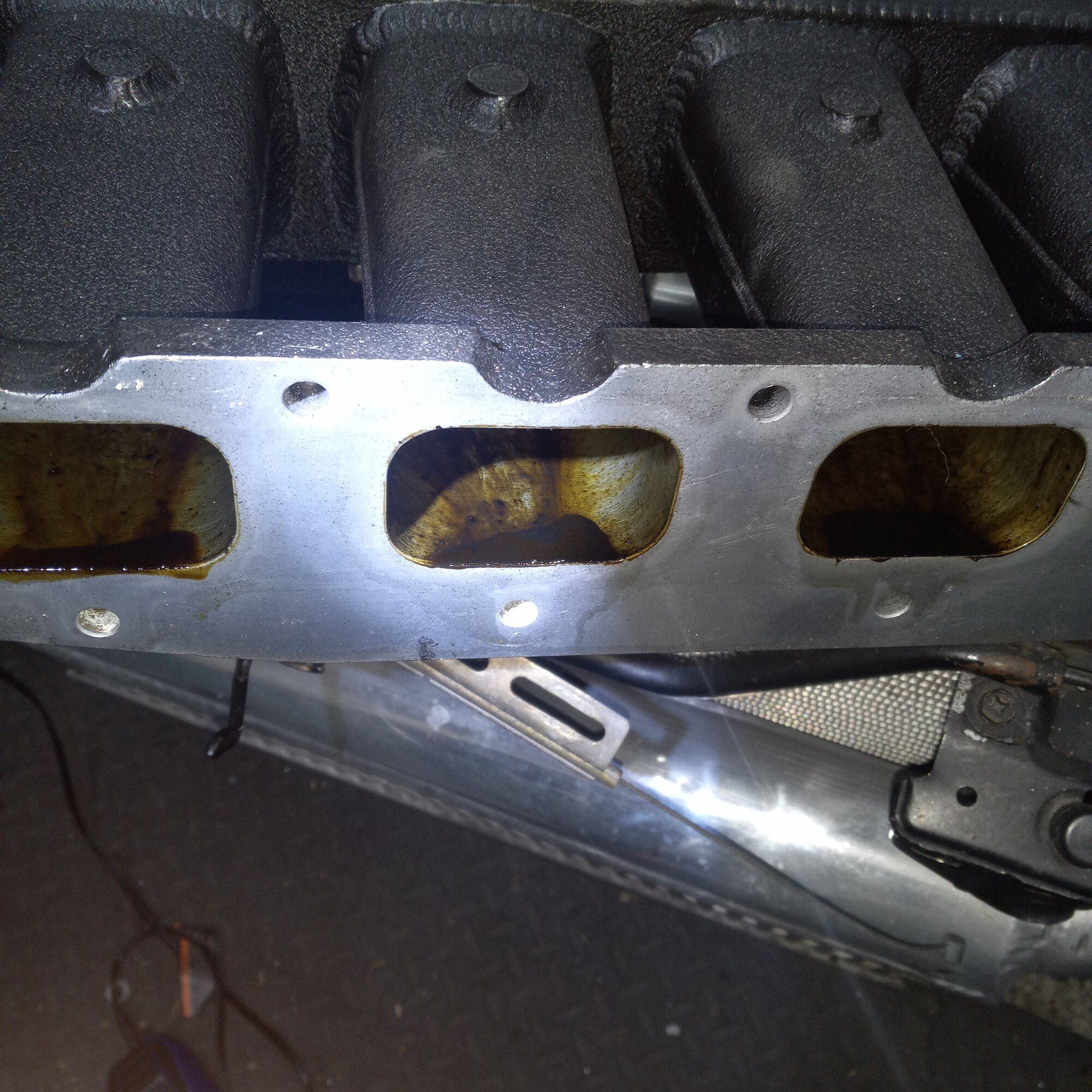

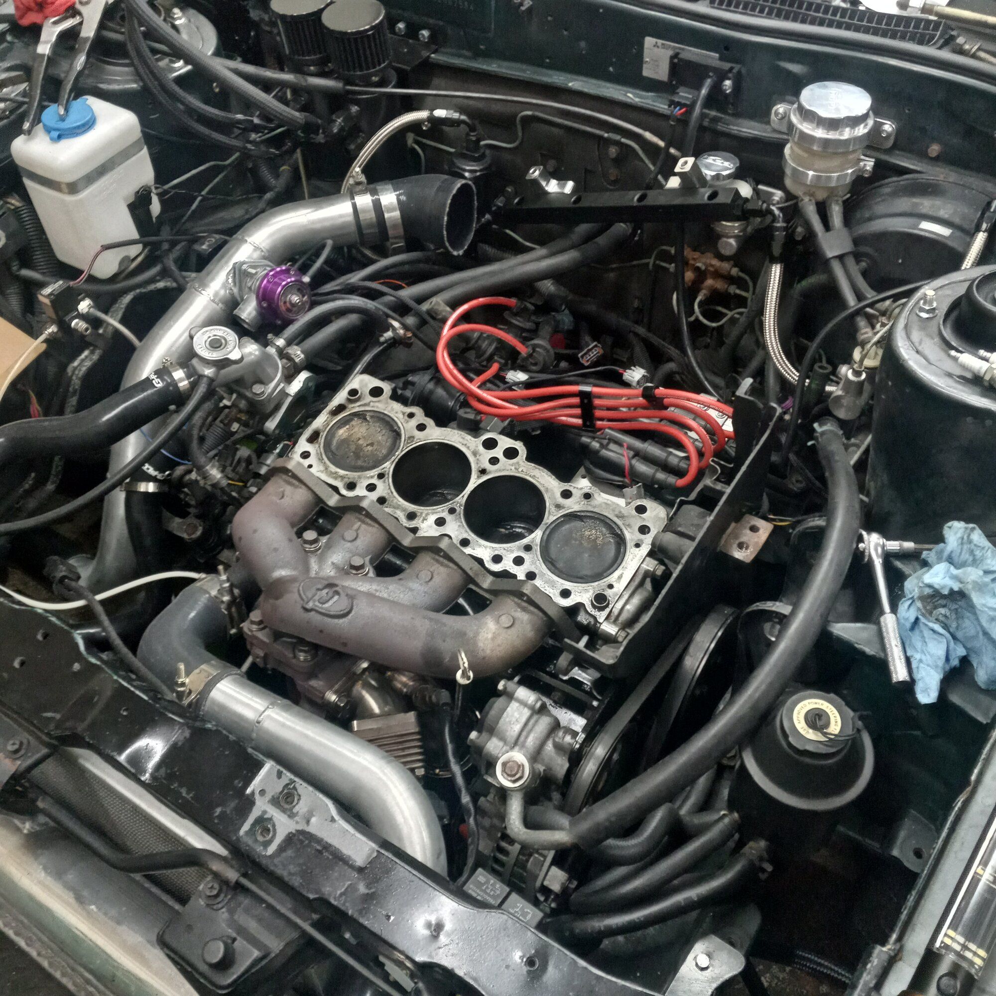

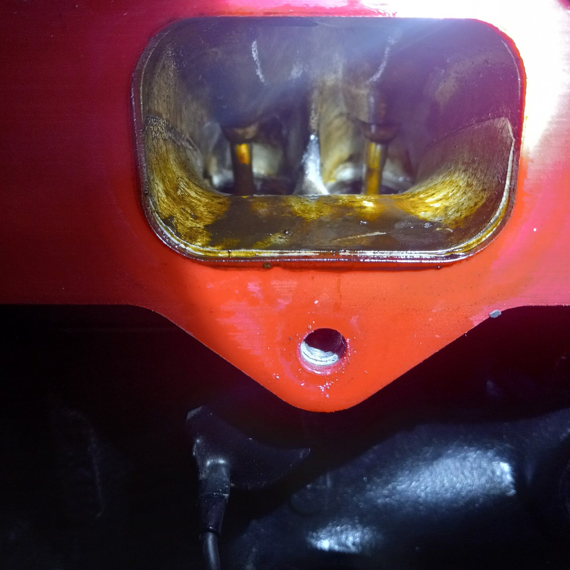

Finished the intercooler pipes and exhaust. As soon as I get the settings correct in the ecu I went to start the car the next day and had a loud pop on start up and it threw a rockers off. So pulled the lifter and checked it but found no problem so re installed and it ran fine. Next day had the same thing and a different rocker cam off but noticed the valve was still down. I expected the worst being a bent valve so i ran a scope in the injector hole to find the valve wasn't bent but everything looked coated in oil. Pulled the intake manifold and turns out it wasn't oil, the fuel had gone bad and turned to lacquer when the engine cooled off. When the cam was off the valve the valve was stuck in place so the piston caused it to pop back into place knocking the rocker off. Pulled the head and left it at a trans shop I do programing for and they were nice enough to throw it in the hot tank. Some how i was lucky enough no valves were bent and the head could go back on, bought some 112 octane from the gas station but the fuel pump lines and strainers in the tank along with all clamps had to be replaced. Tank wasnt bad but had to clean my hanger and fix my level sending unit that warped.

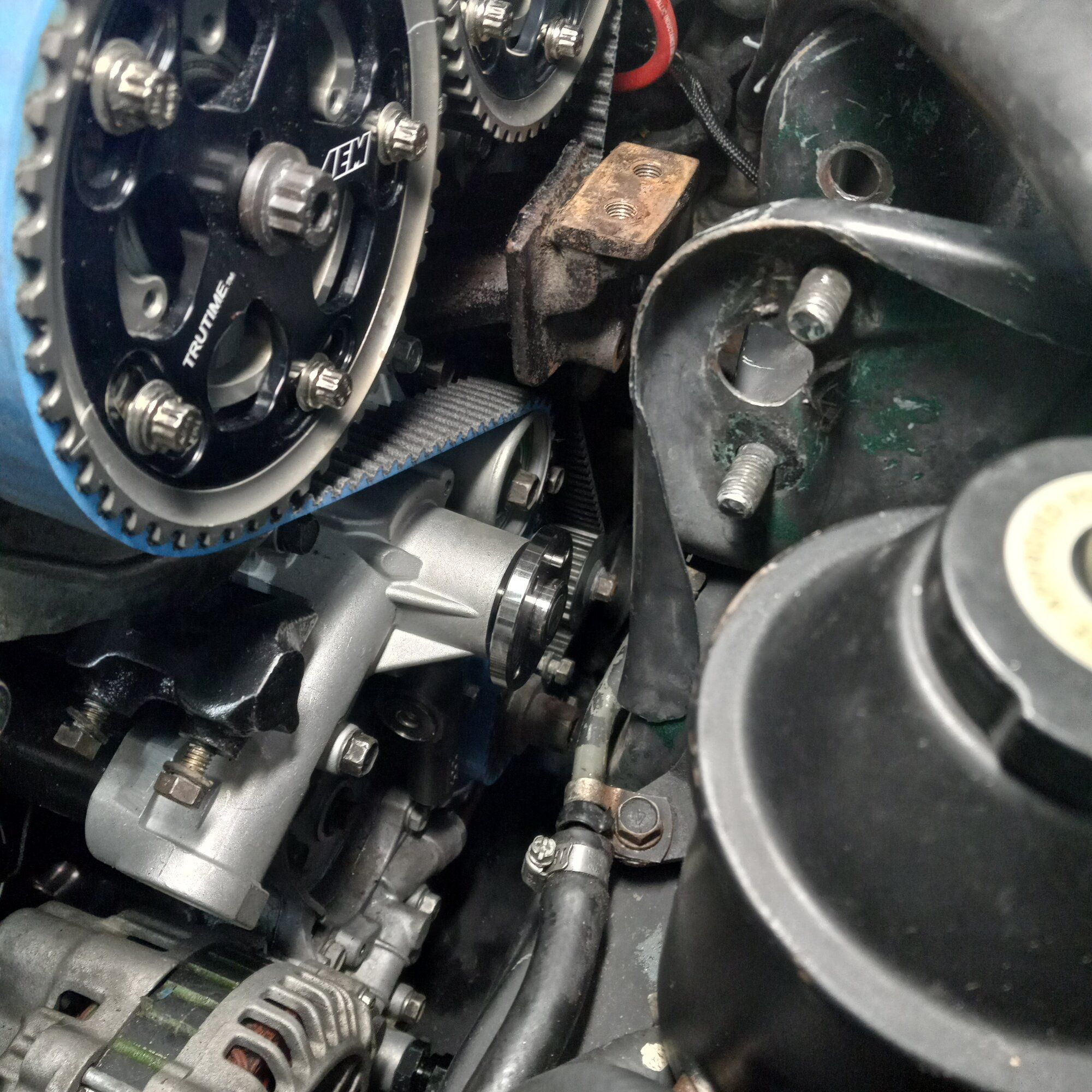

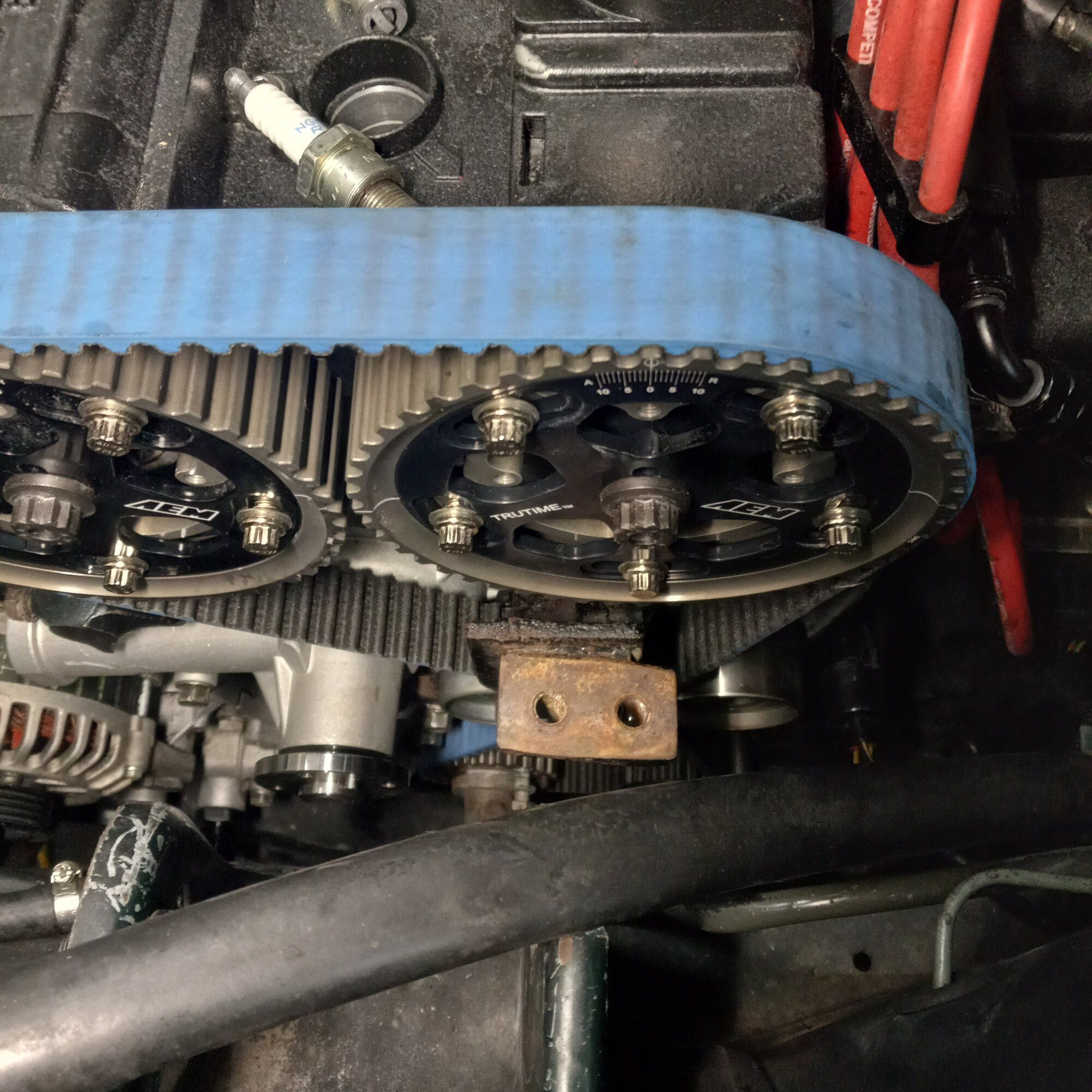

Figured Since its apart I should go ahead and install the new cam gears, replace the water pump, timing belt, tensioner and both pullies so I don't need to tear it back down in a few months just to do it again. Started right up and ran better than it ever has, good fuel cleaned the injectors right out with a little sea foam injector cleaner in the tank.
