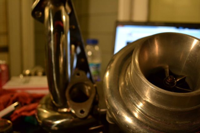

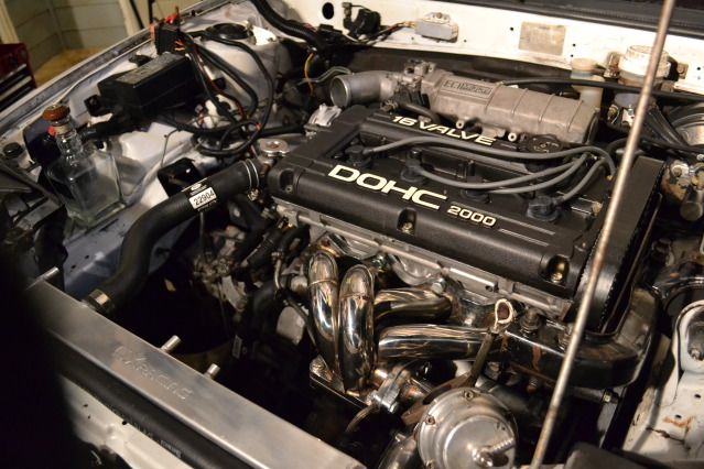

Well, with only 20 and some odd days left until IFO, i'm a doing alright but deff fighting for time. Finally got 85% of everything completed such as the wiring, mounting, fuel pump, etc. Now taking my car to get Fabbed up in the morning and then off to the dyno to see what it'll lay down.

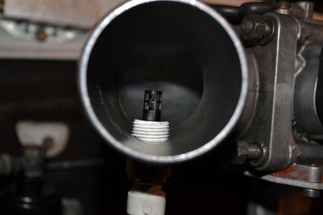

here ya goooo.

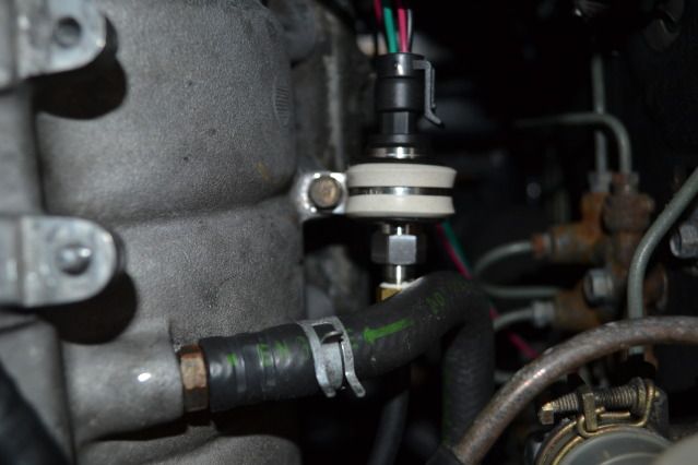

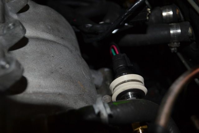

(AEM Map Sensor with a Boeing 747 Clamp holding it in place )
(GM IAT Sensor )
(Quick Tease )

Looking good man, i like the grip tape idea i think im gunna do that.

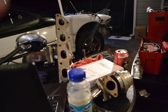

In the last picture, all the way to the left, is that really your overflow bottle? xD
bahaha, why yes it is.
i just now saw this but i'm making a bracket for it right now. basically got a AN fitting running to it through the cork on the top. just a little thing i wanted to try out since i was bored.

Sorry for the late reply, but yeah, that would be my overflow ha. Apple juice for the win !
