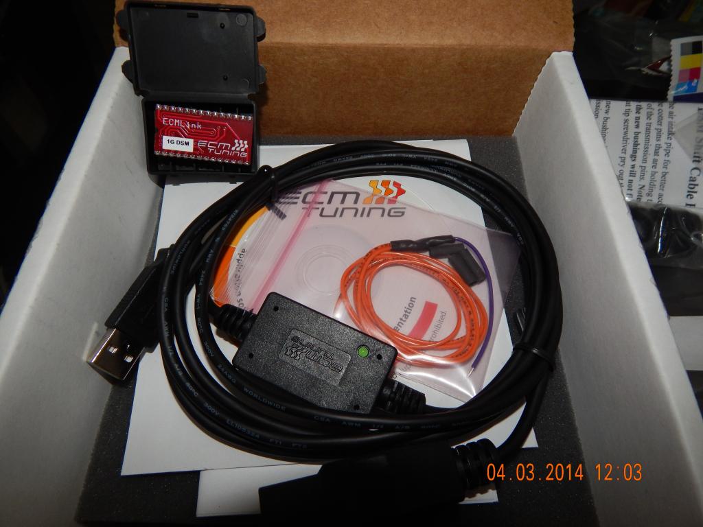

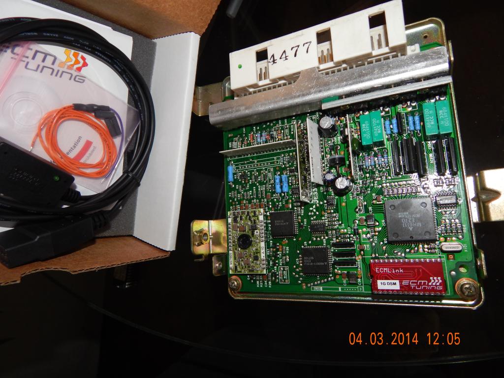

I went strait home and ordered ecmlink v3 full from SIM and I must say they gave me a really really good deal. Way cheaper then when I purchased link for my 95.

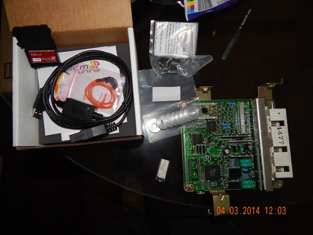

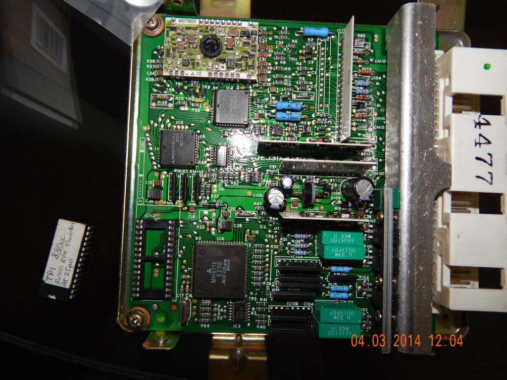

Link arrived, yaaaaaaaaaaaaay. I grabbed the 90 eprom ecu that came with the car and I popped the old ship out and slapped the new one in. Fit perfect. I went downstairs and went to work on getting it installed and uploaded. I plugged it in and put the cable in the correct plug. I couldn't connect to the darn car for some reason. I put the old one back in (ecu) and I couldn't even start the car now for some odd reason. I didn't do anything different so I don't know why this is happening. After much frustration I called it a night before I broke something.

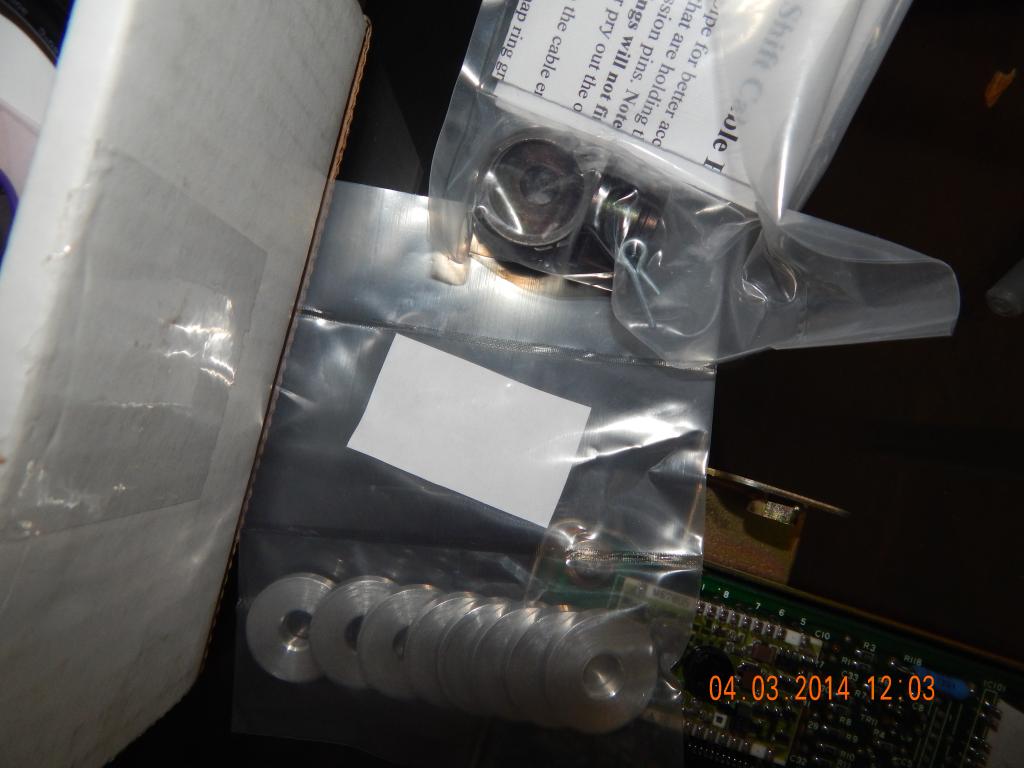

Got my shifter bushings and went down to install them. I did the shifter base bushings first and it was a little more difficult than the 95 but I got it done. Now for the cable bushings under the hood were more difficult then that. I also noticed the little clip that holds the cable to the trans brackets was gone on one of the cables. Thus the reason I couldn't shift into any other gears. I made a little bandage until I can get another one from somewhere. I also got the darn bushings is, and now the car shifts into all gears and is very solid now.

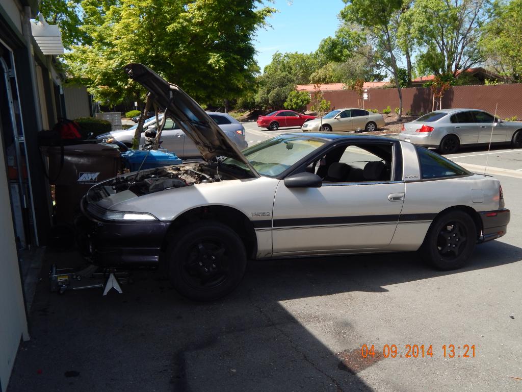

April 9TH 2014

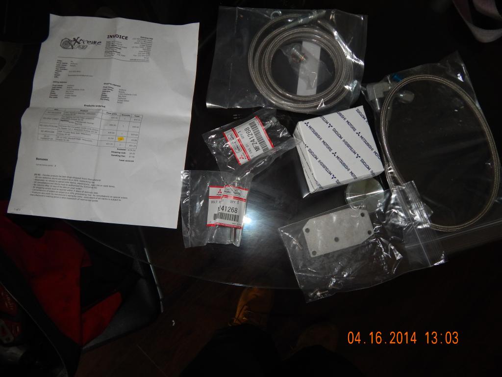

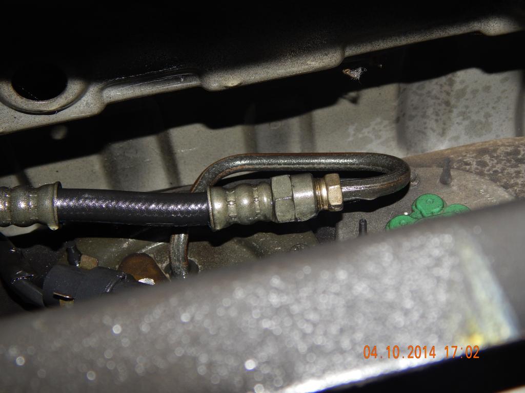

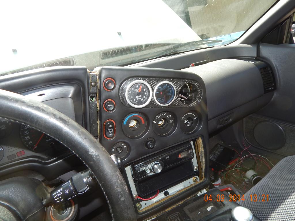

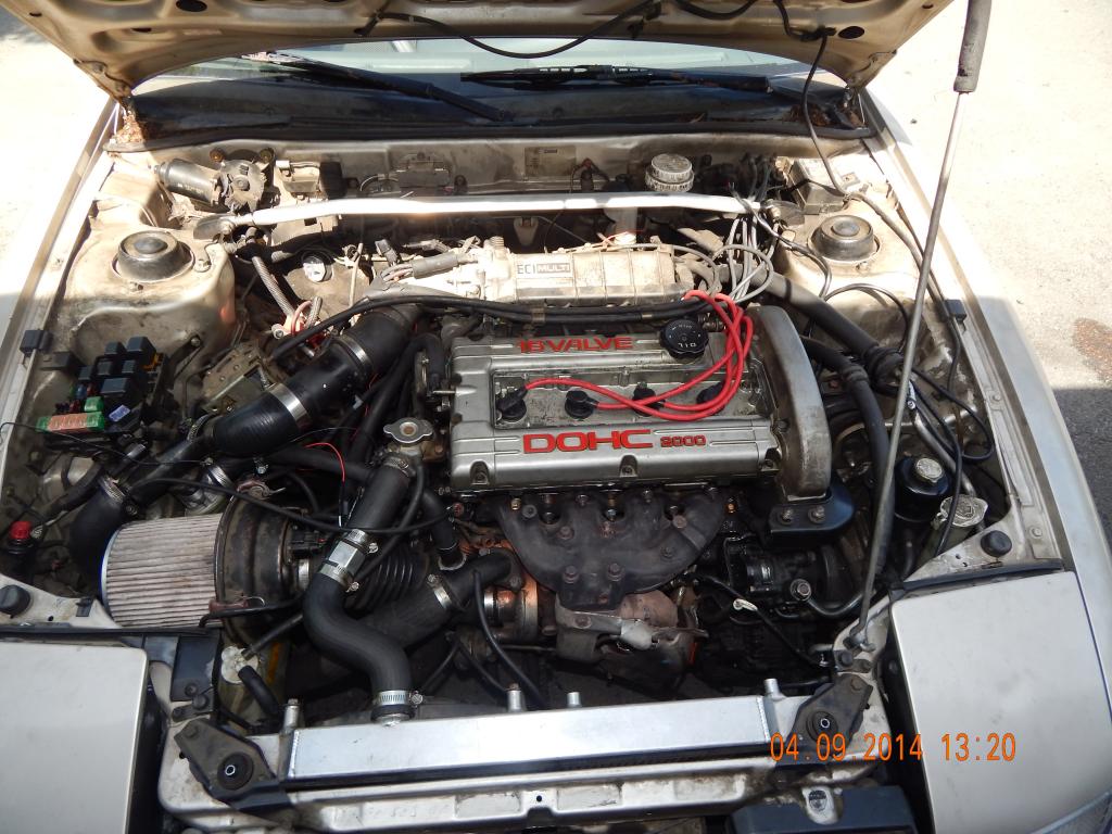

Put a order in at extremepsi order of SS full clutch line, SS oil feed for GT42, Fiav block off, OEM Tob, and @ OEM TB bolts.
April 10TH 2014

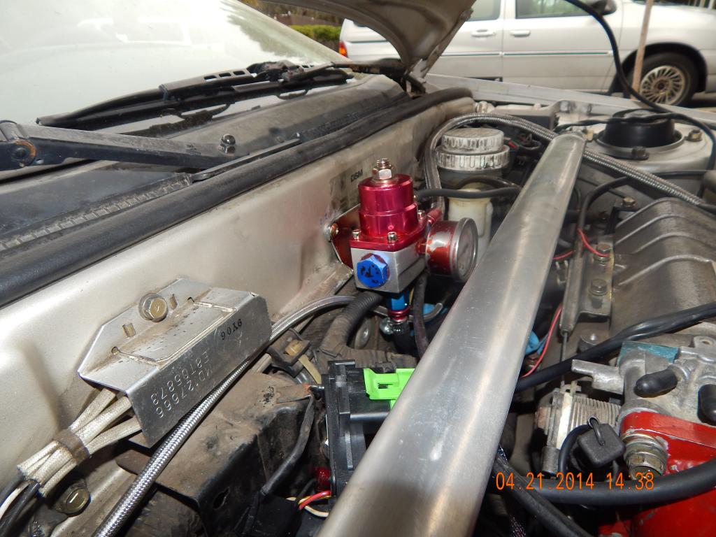

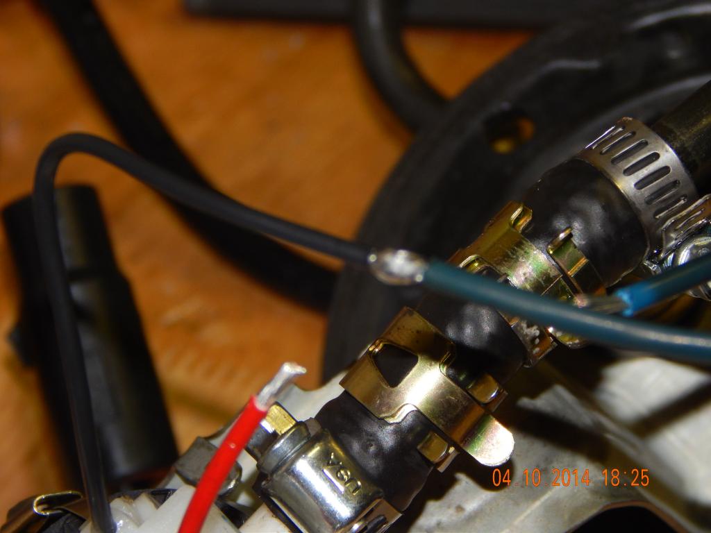

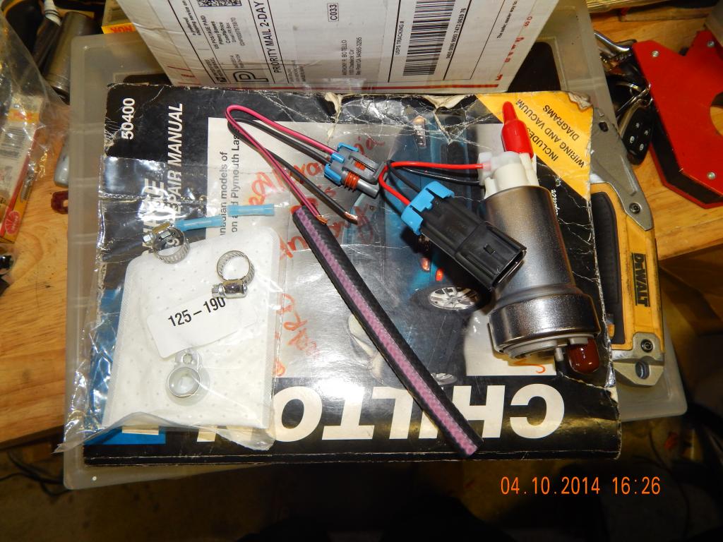

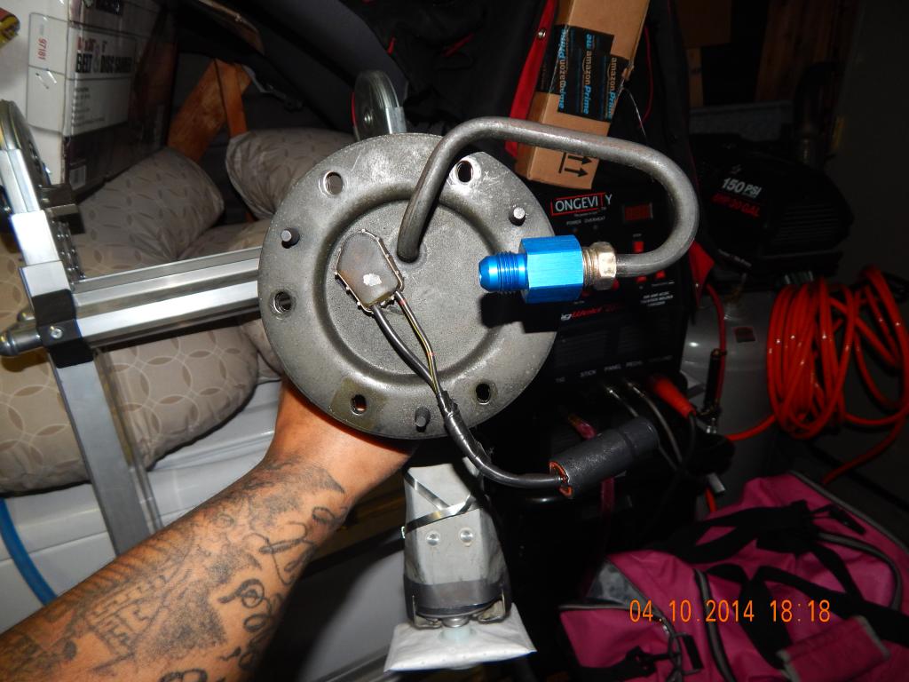

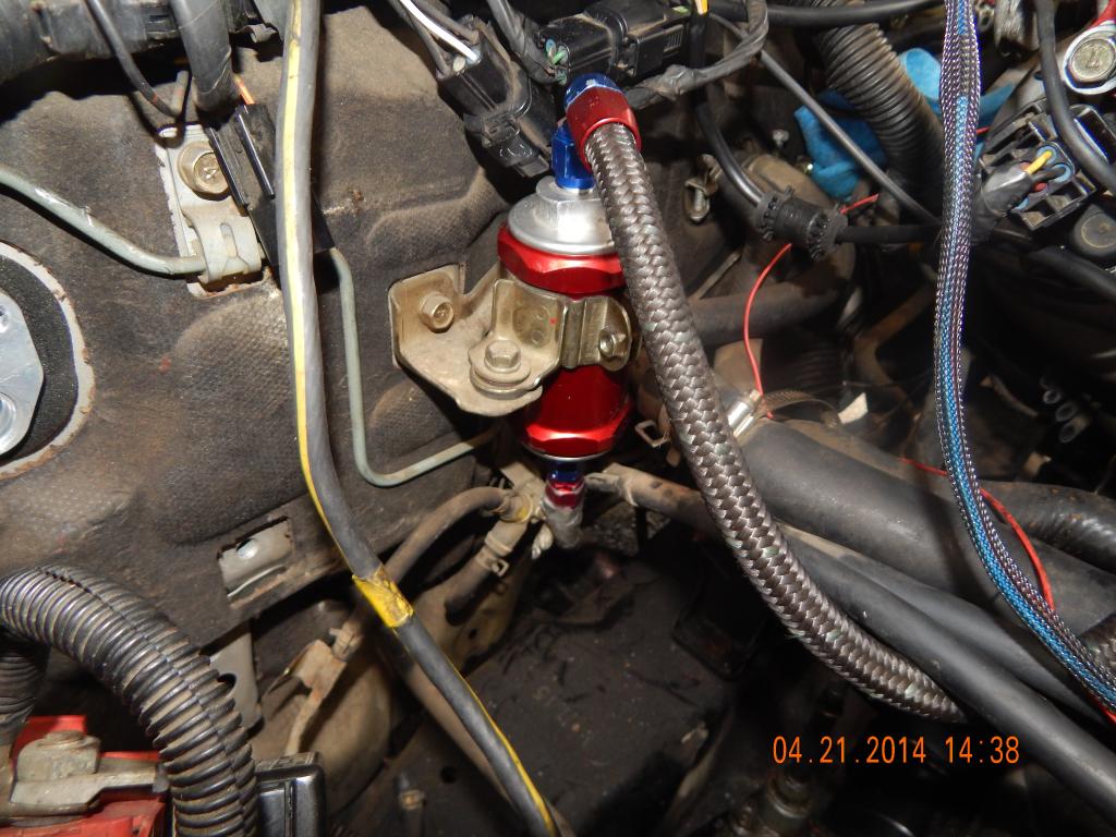

Installed wally 450, 6AN Feed, AFPR, and Fuel Lab Fuel Filter 6AN 40 micron ss filter for E85. The pump went alright in the beginning. It come out pretty easily, but when I went to install the pump back in the tank I forgot to put on the little thing that goes on the bottom that connects to the bolt on the bottom of the tank. I had to fab it up quite a bit to get it to fit, but it went good and it doesn't leak, does its job. 6AN feed was pretty strait forward as well as the fuel filter. The afpr was ok but I couldn't get it to stop leaking. I ended up calling it a night after it just kept leaking. I also put on my 2G fuel rail with STM 6AN fittings.
April 11th 2014
Got my cushion clamps for 6an feed line to correctly mount it under the car. I also finally fixed my driver's side head light. I ordered it a few weeks ago from miller and got the wrong one, too bad I broke it when trying to install it so I couldn't return it so I ordered another one from ebay. Finally got it and put it on. All is good now.

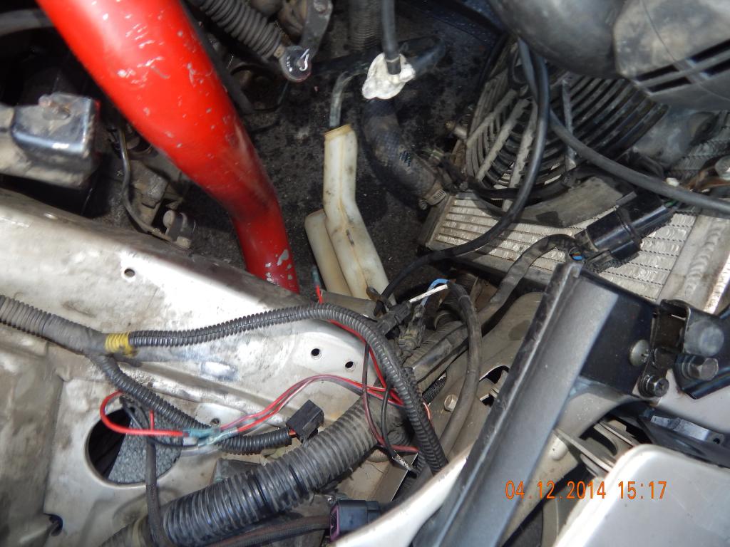

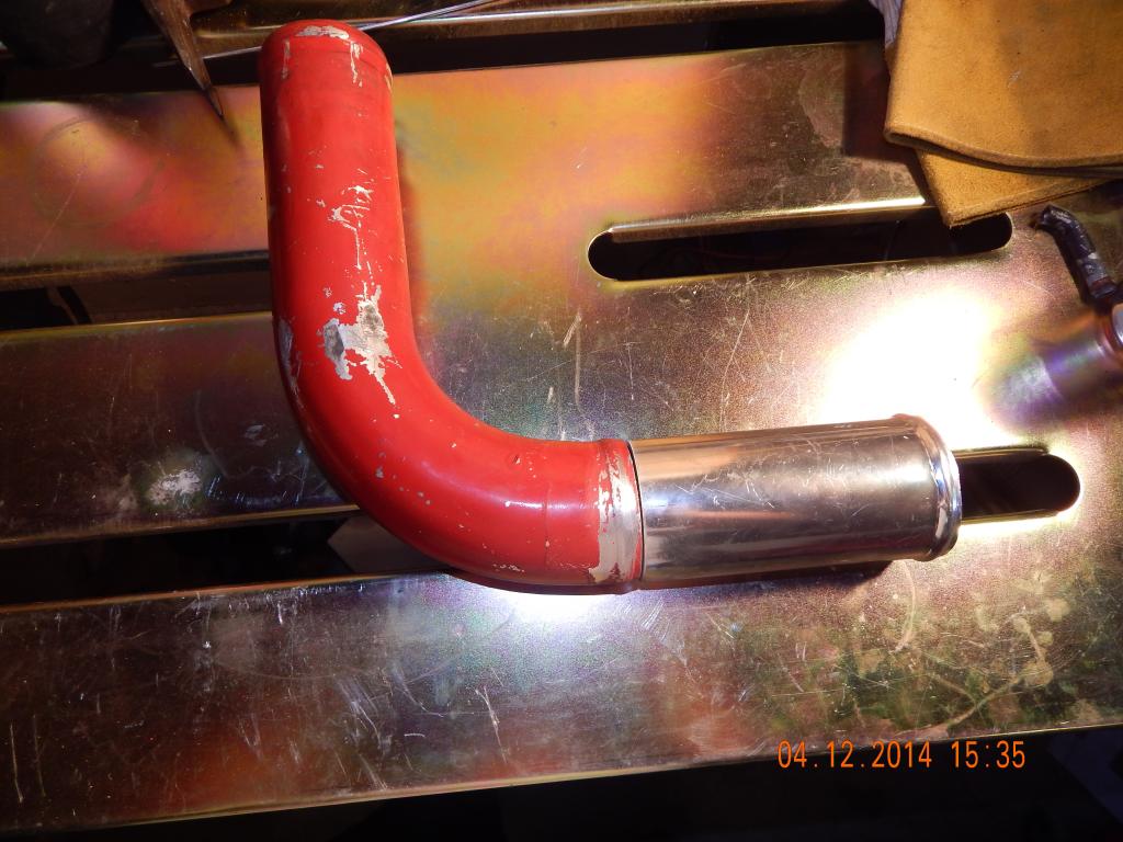

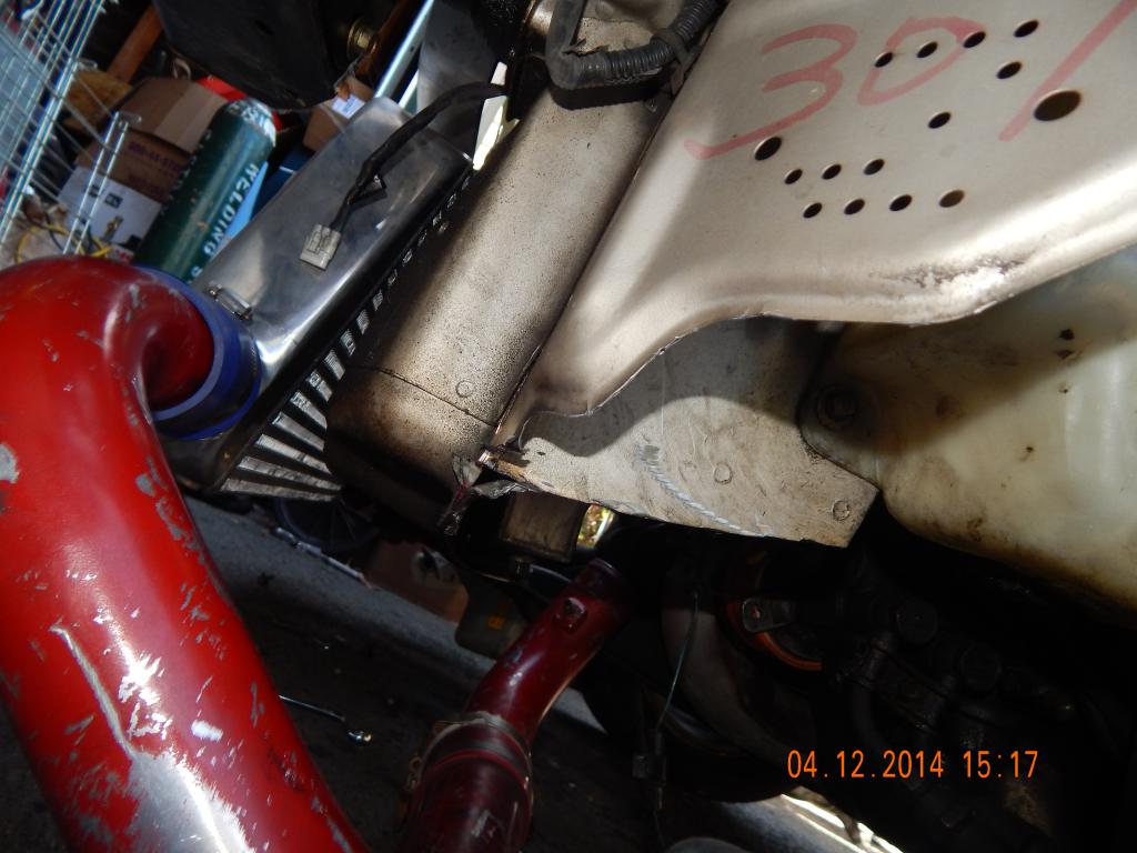

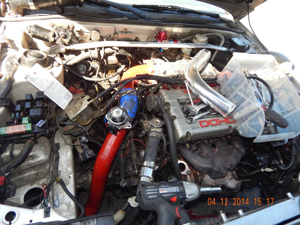

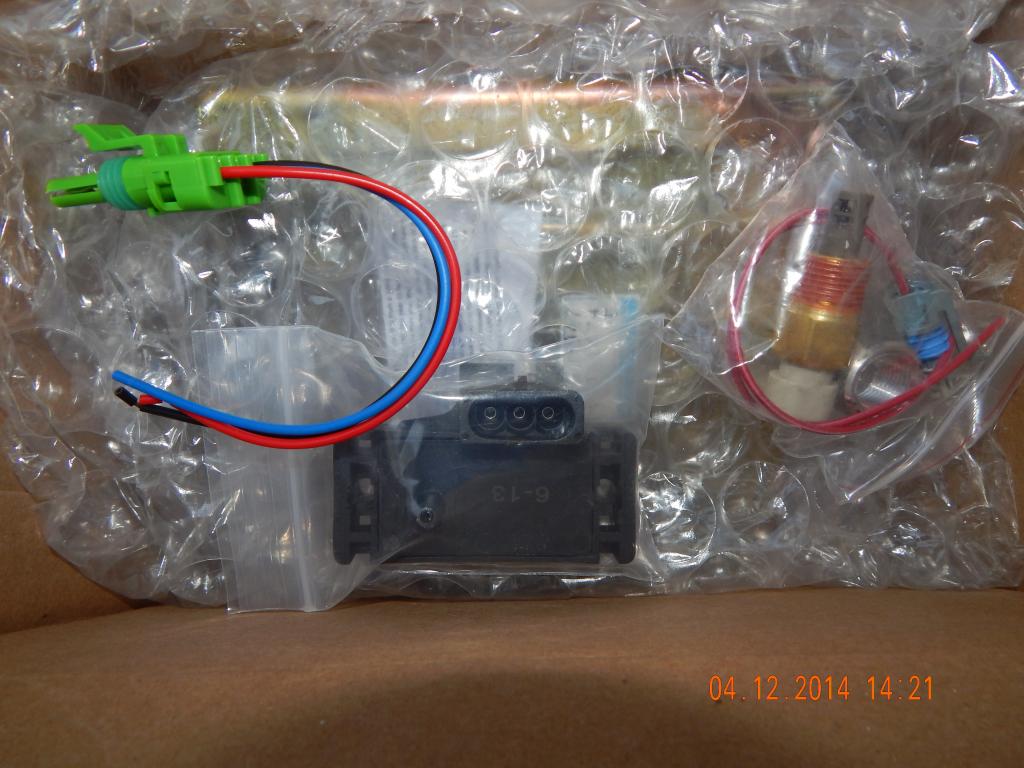

I went and picked up my ecmlink package from the post office. It was my rebuilt 2g ecu for the 95 and a SD bundle for the laser. When I got back from the post office I had my 6 puk rigid clutch kit waiting for me.

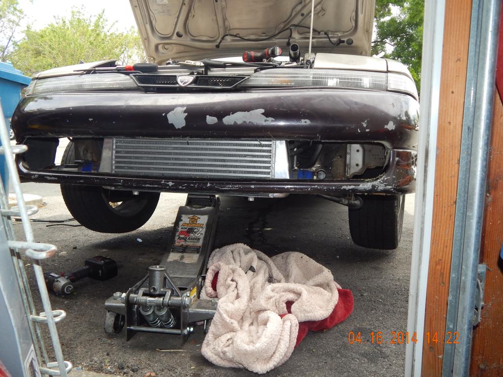

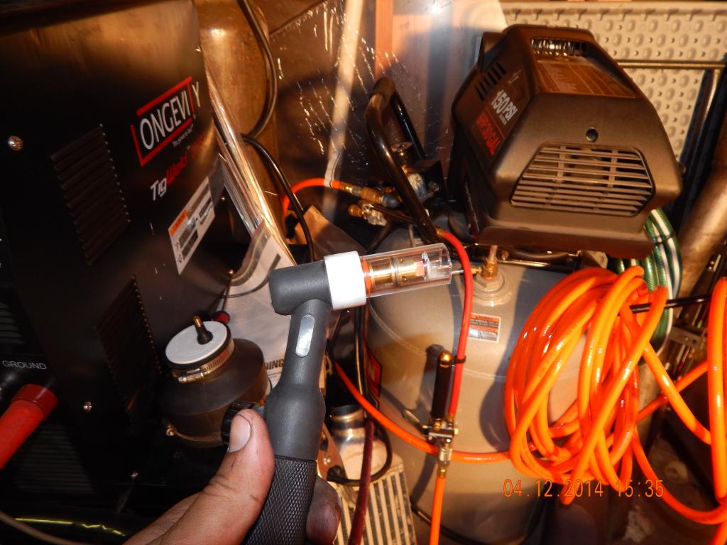

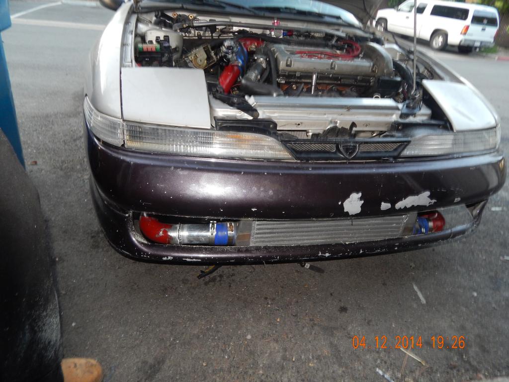

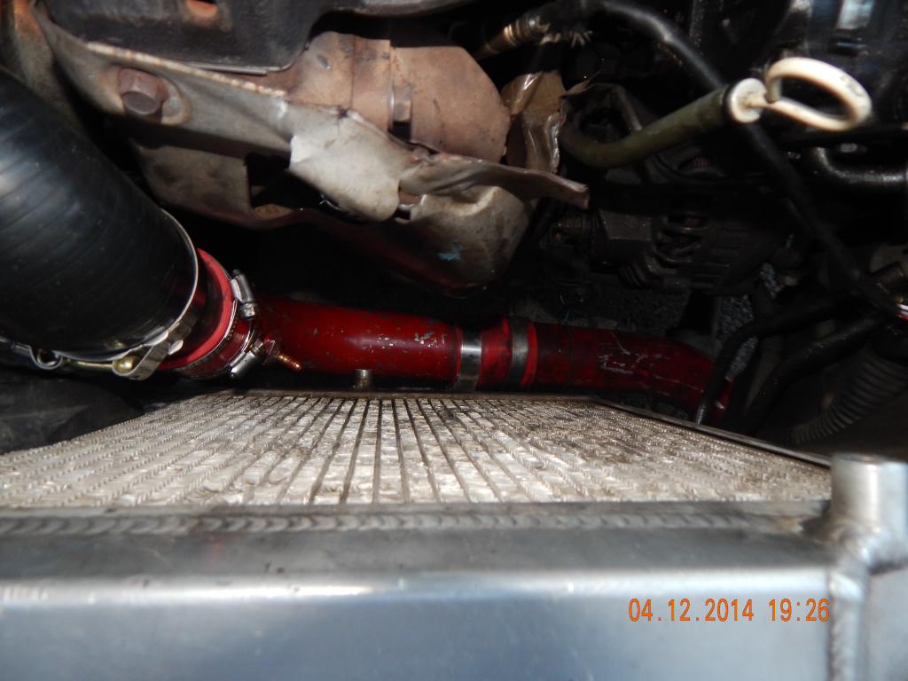

I also decided to try and install my PR 2G kit on the laser since im not using it on the 95 and I can't get anyone to buy it without trying to low ball me. The IC itself is new, piping used. I didn't have to do too much to get it to fit. I had to cut a piece of the front frame on both sides just a little bit. I also had to extend the lower pipe on the passenger side to connect the upper pipe to the IC. The hot side was pretty strait forward, just had to fab up my own j pipe since I still had the 14B on the car for now. Overall it came it pretty damn good and you couldn't tell it wasn't for the car that was for sure.
Spare piping just in case

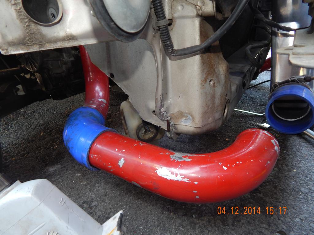

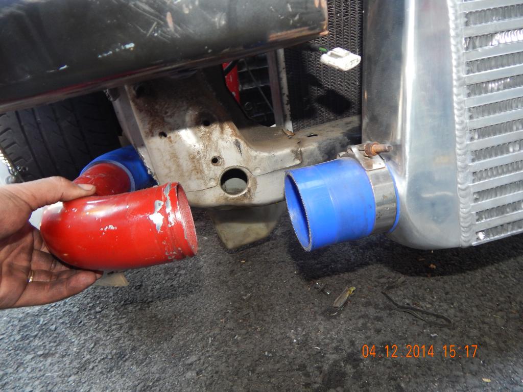

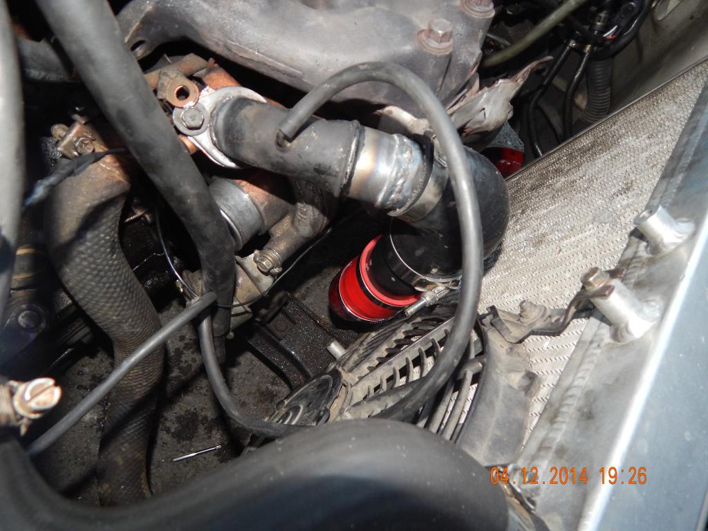

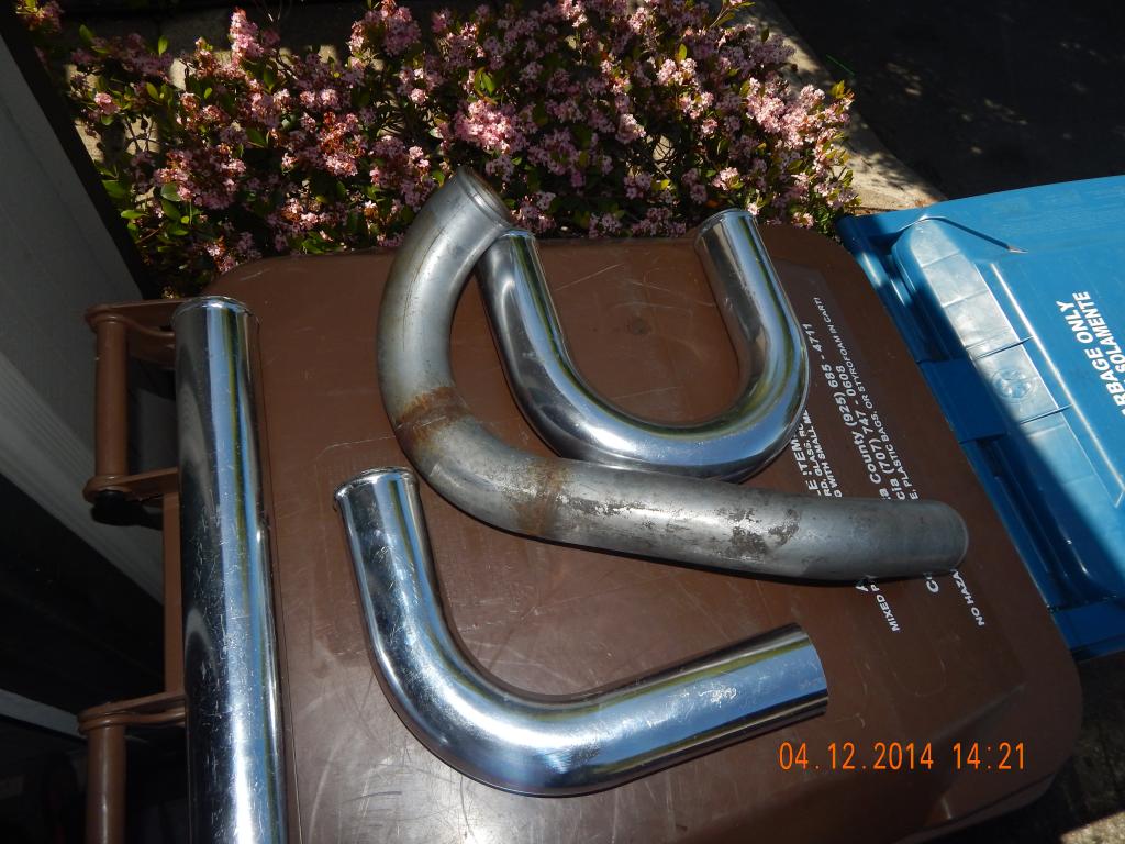

After calling it quits with the fmic I went to a local auto store and got an earls fitting for the fpr return fitting to see if I can get it to stop leaking. That worked but it was not leaking from the fuel rail.

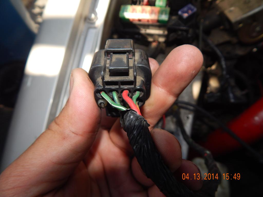

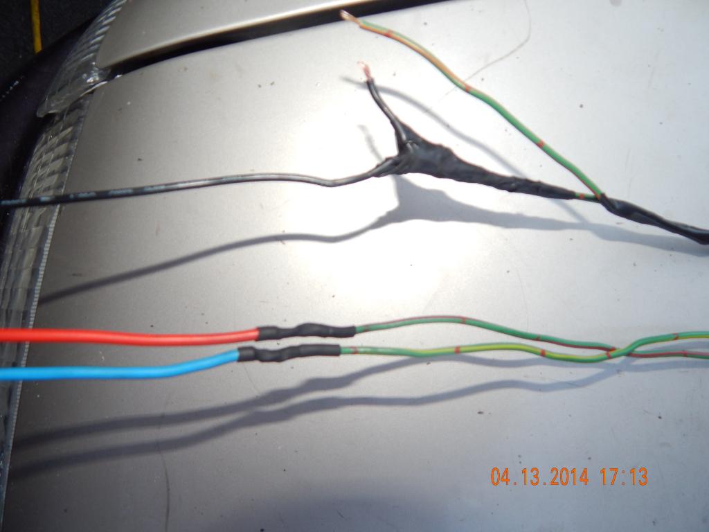

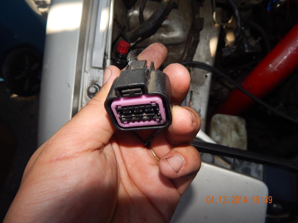

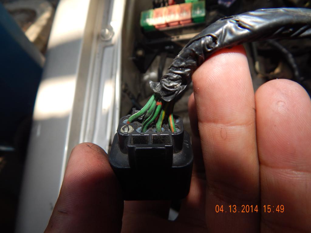

Wired in the SD kit and installed the sensors. Went good, followed the links on here for wiring. I wired both sensors into the stock maf connector.
April 14Th 2014

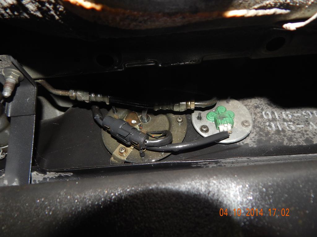

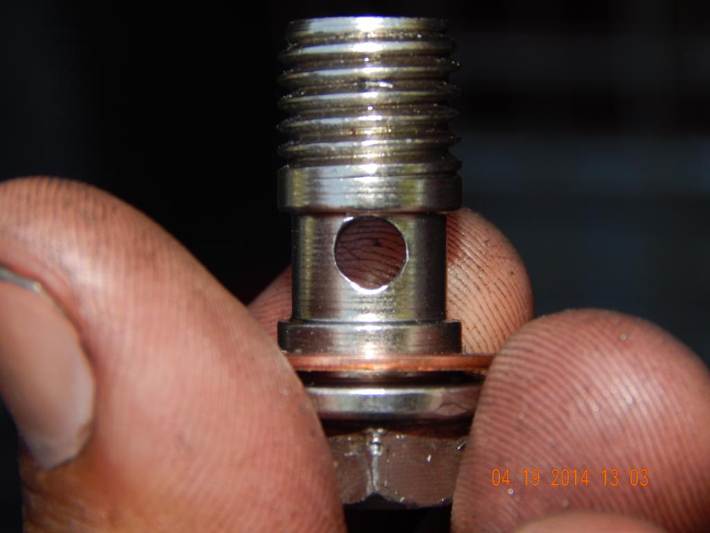

Figured out the leak. It was on the return side of the fuel rail. The 6an fitting was cut so it wasn't sealing. Good thing I had an extra one and it got rid of the leak. Thank goodness, I was getting tired of trying to start the car and gas going everywhere.

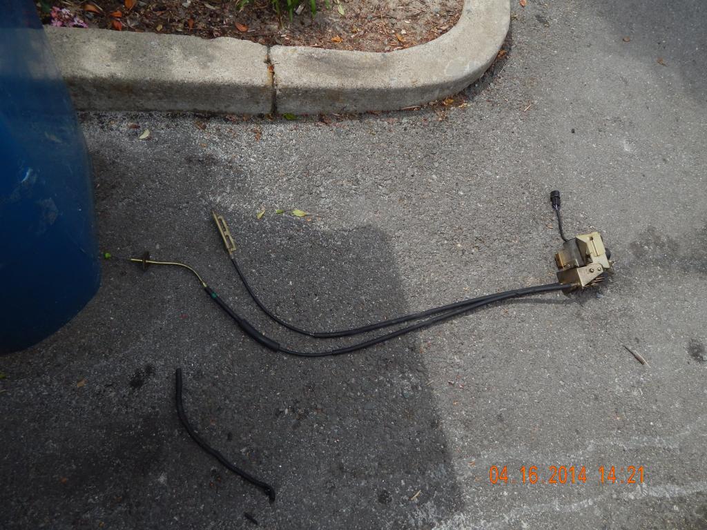

Received my non cruise cable
April 16Th 2014

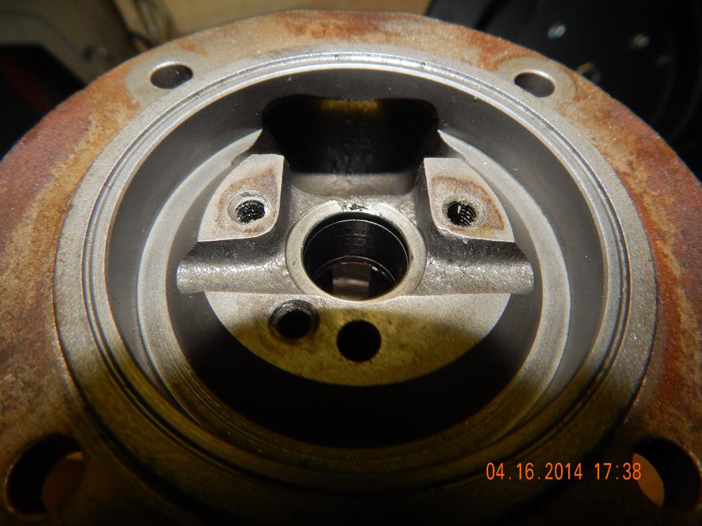

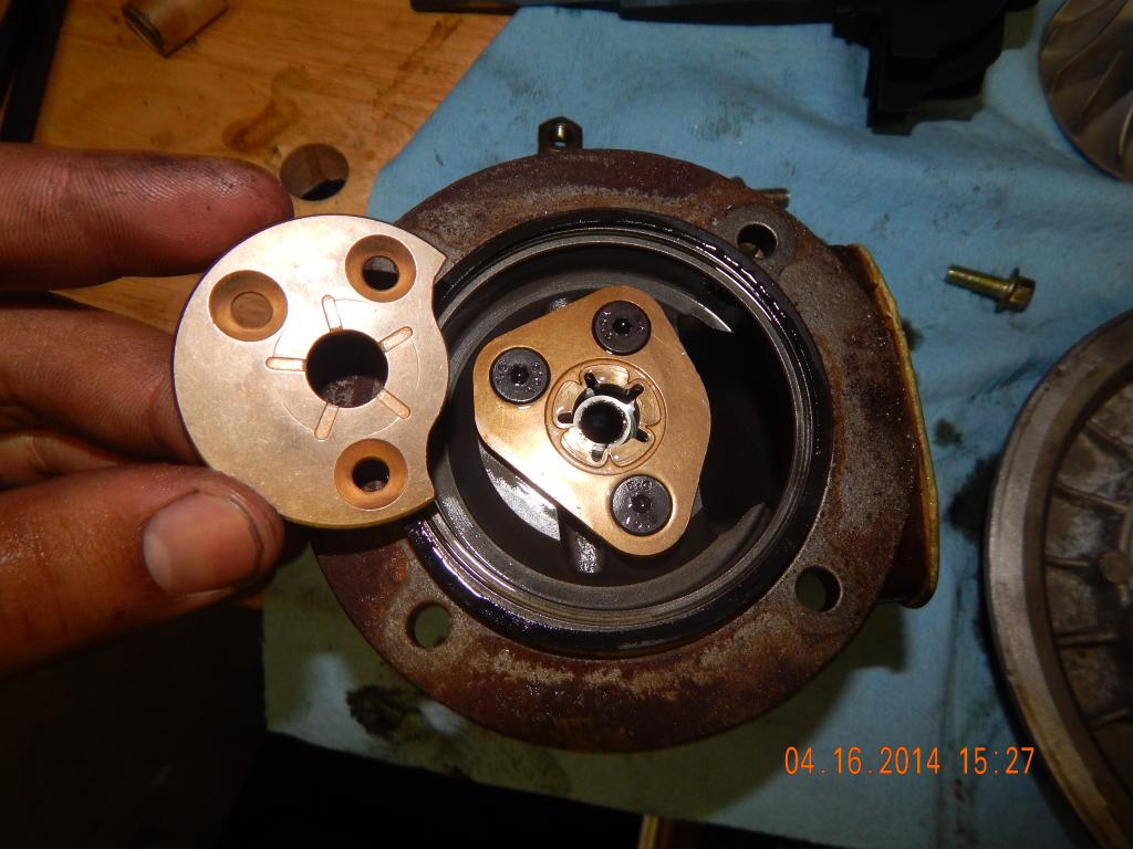

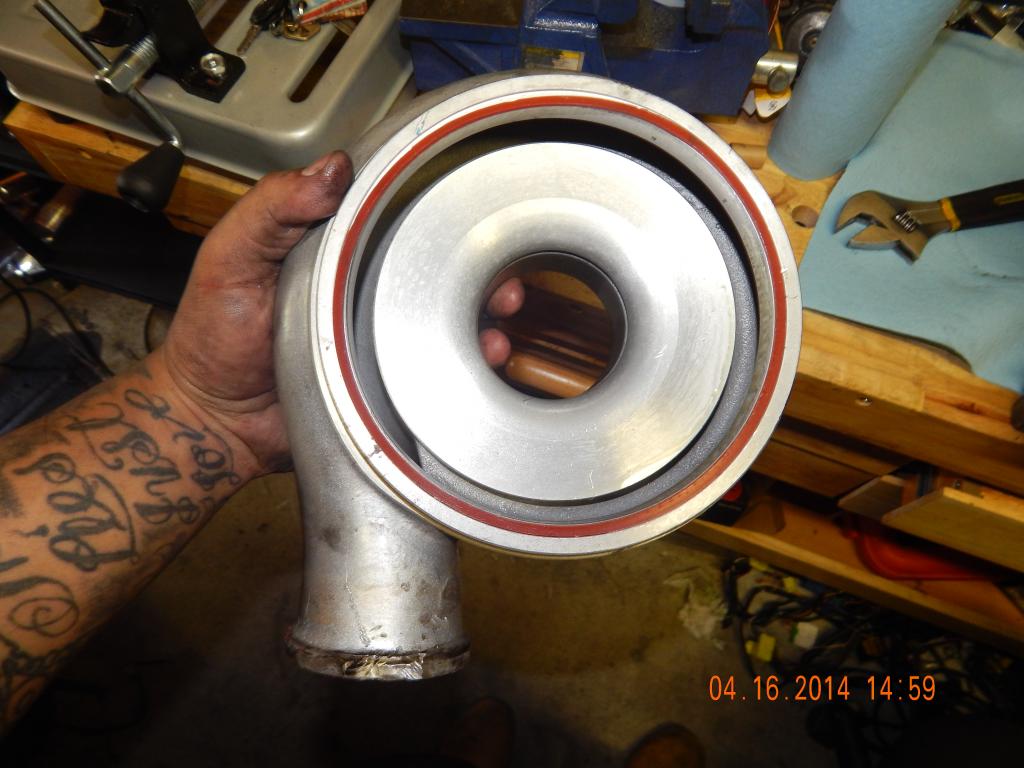

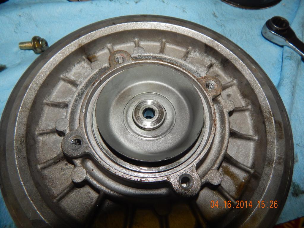

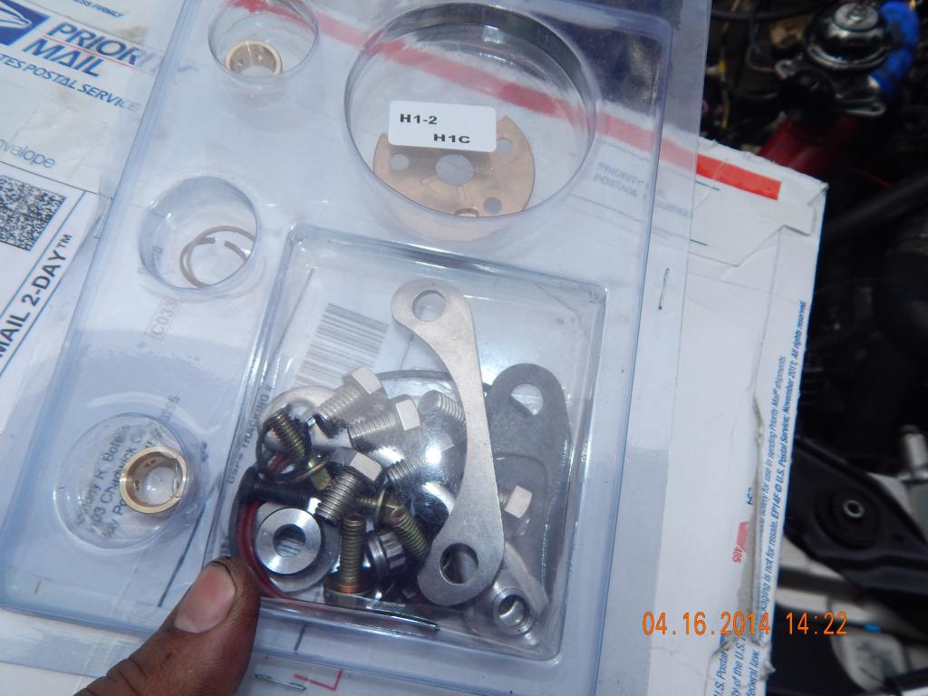

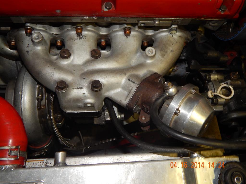

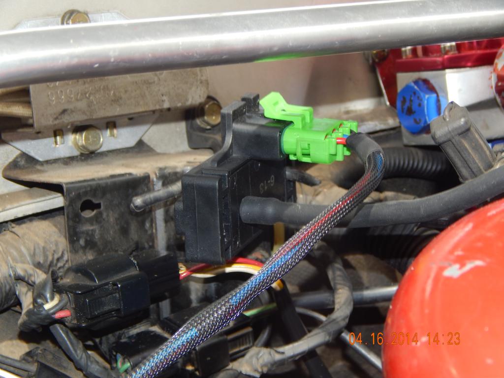

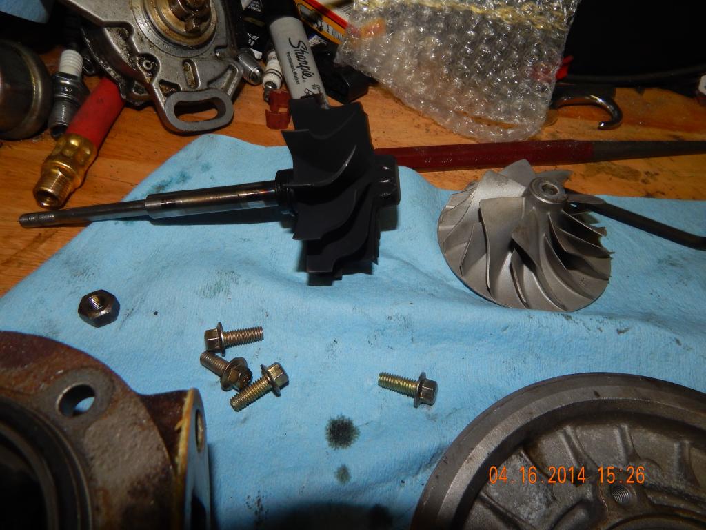

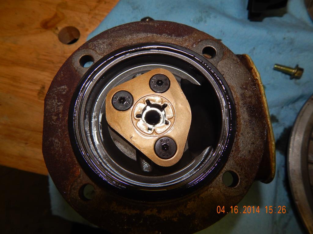

Rebuilt my H1E because it is going on the laser along with the hafe manifold, and tial wastegate. I got a oil feed set up from the oil filter housing for the laser and am using the oil return I already had from the 95. The rebuild took way longer than I thought it was going to even though I followed a rebuild link that I found. I should've took more pictures before taking it apart, but I got it together and upgraded the thrust collar while I was at it.
I also received my extreme psi order today and installed my non cruise cable.

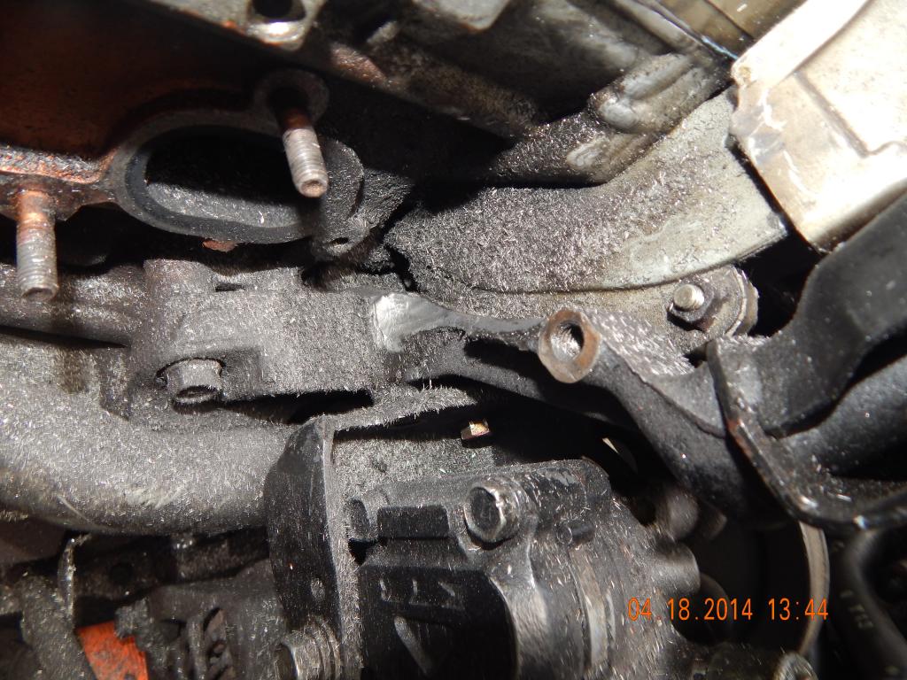

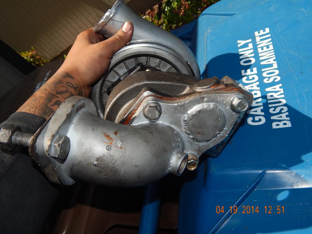

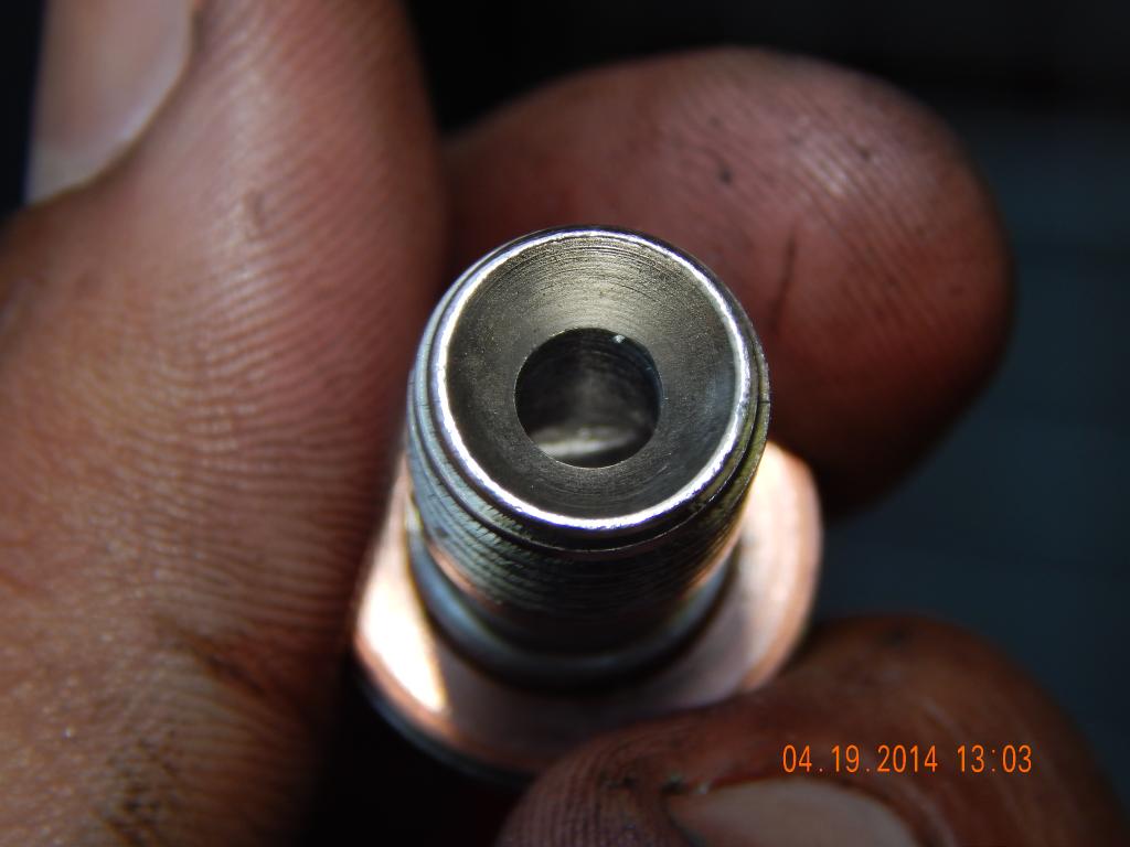

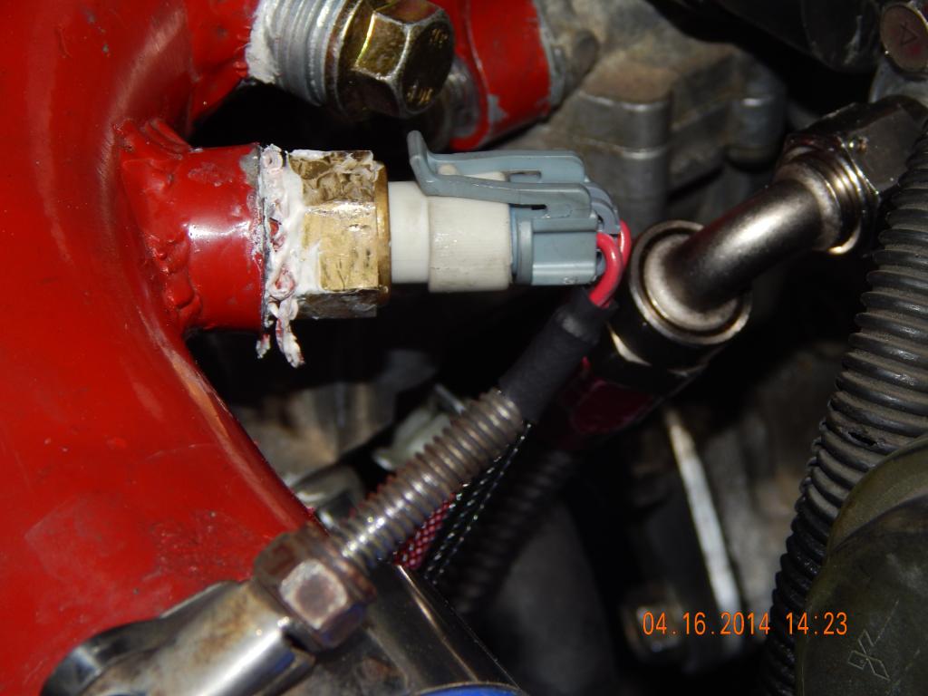

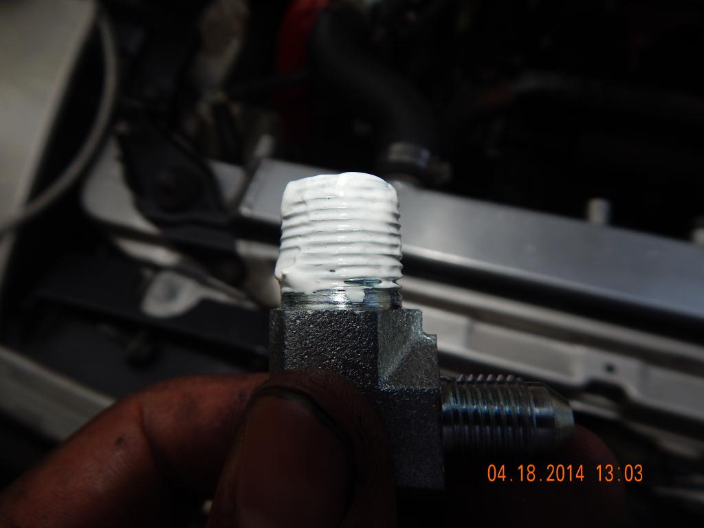

. Modified oil drain for the holset and got it just right. Also had to modify the oil feed restrictor I had on the turbo when it was supposed to be on the 95 because I didn't have balance shafts on the 95, and I do on the laser so I had to bore it out.

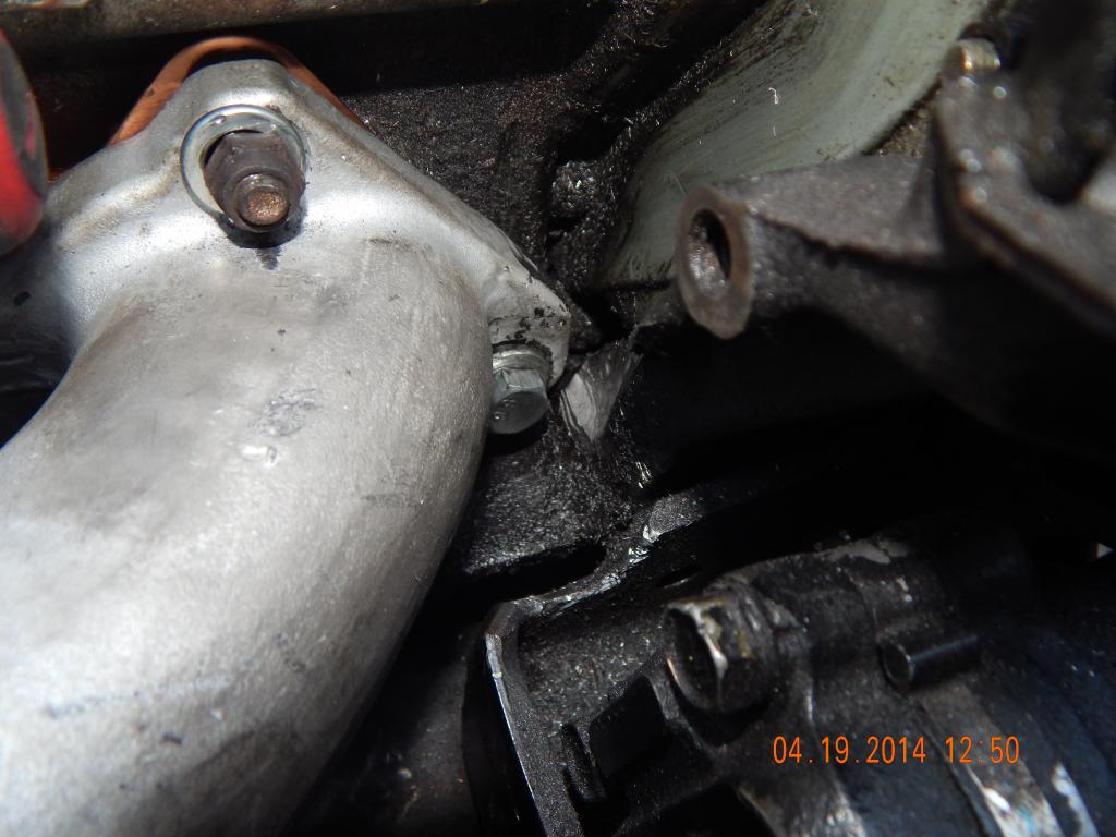

. I had to grind the power steering bracket for the Hafe manifold to fit. It also cleaned up the bay in that area a lot in my opinion. Those little burs I purchased along with the Makita die grinder for when I ported and polished my heads have come in handy for little things like this.
April 19th, 2014
. Holset is in its new home. I must say it looks mighty good in its new home and can't wait to see what I can achieve with this turbo. Overall with all the extra work I had to do to get this turbo in was very well worth it. I used the large bolt I removed from the OFH when I installed the oil feed, used it to block off the water fitting on the water pipe. Make sure to put some thread sealant on there if you do it this way, it does keep the coolant in.

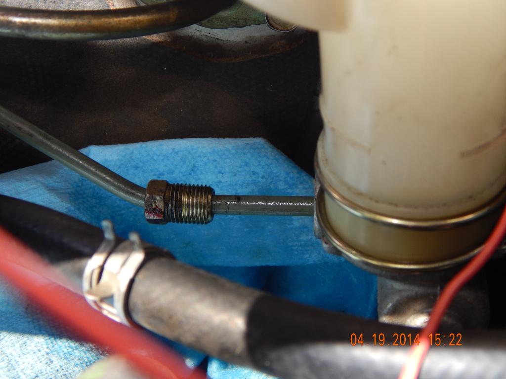

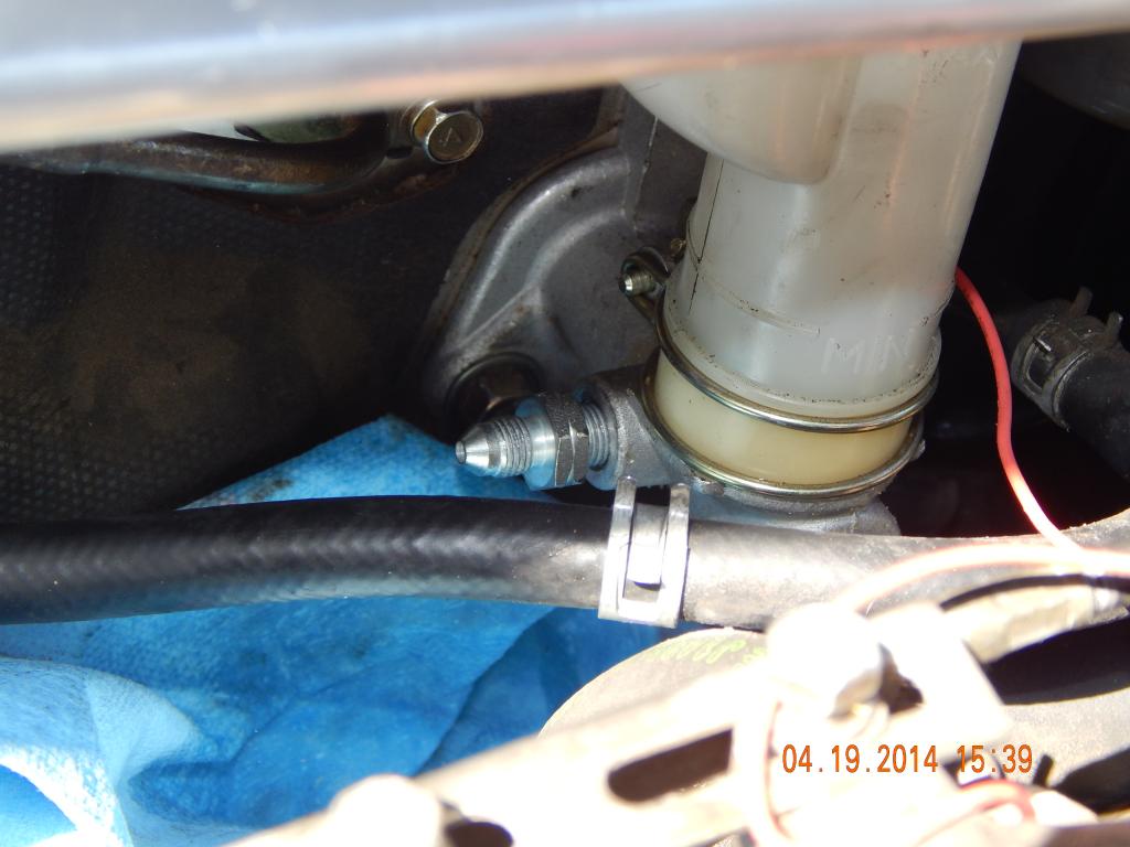

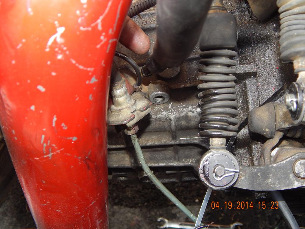

. SS clutch line installed as well. Pretty strait forward, just take the old one out. I ended up cutting it in a few different places because I couldn't pull it out in one piece, I wasn't re using any of it so you can cut it up as you wish to make removal a piece of cake. Make sure to drain the clutch fluid from the slave before doing this or you will make a mess. Install of the ss line is really easy, one fitting goes in the master and the other in the slave cylinder. Mine was flared so I didn't put any sealant on there and is just fine that way, or it is for me. Doesn't leak. Anyhow, when putting the new fluid in the master reservoir you must bleed it to get all the air out. Im sure you all know this, but I have come to find out reminders are nice. Overall I like it and it cleans up the bay and does a great job.

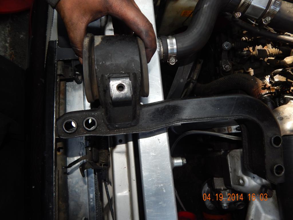

. I then modified/cut my driver's side motor mount and installed a polyurethane mount. Pretty strait forward, take out the old one, cut the long piece that bolts to the power steering bracket and re install it with the polyurethane insert.

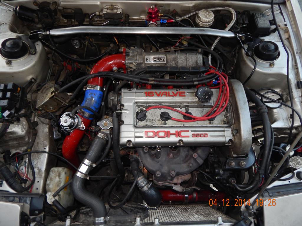

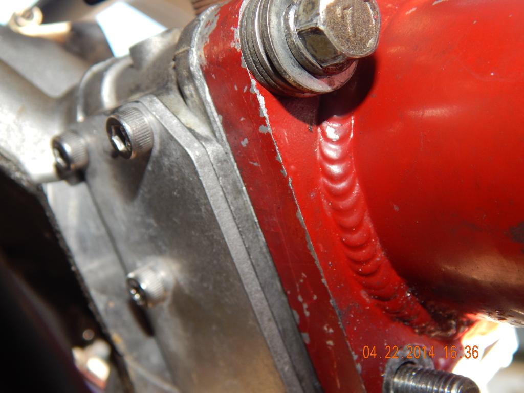

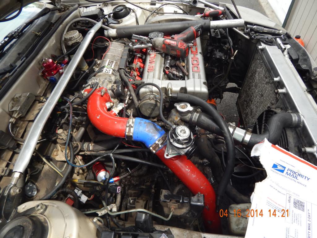

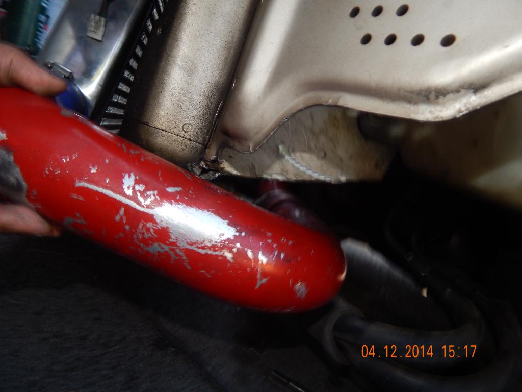

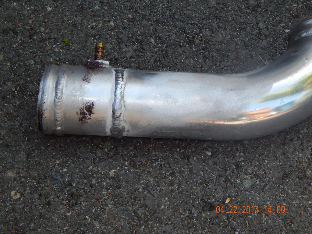

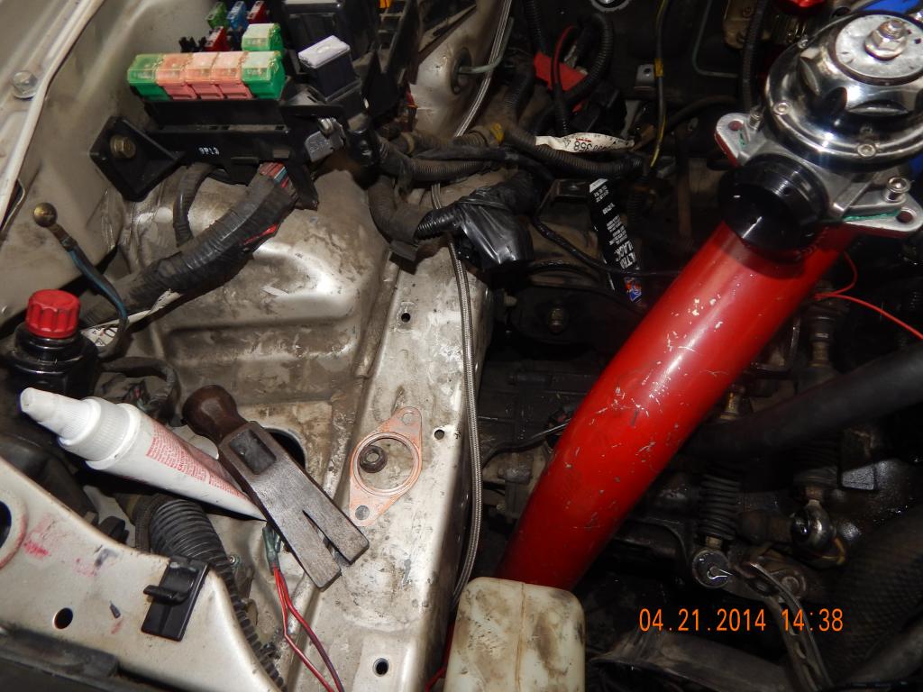

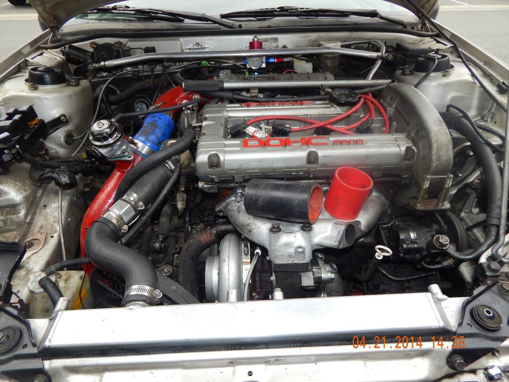

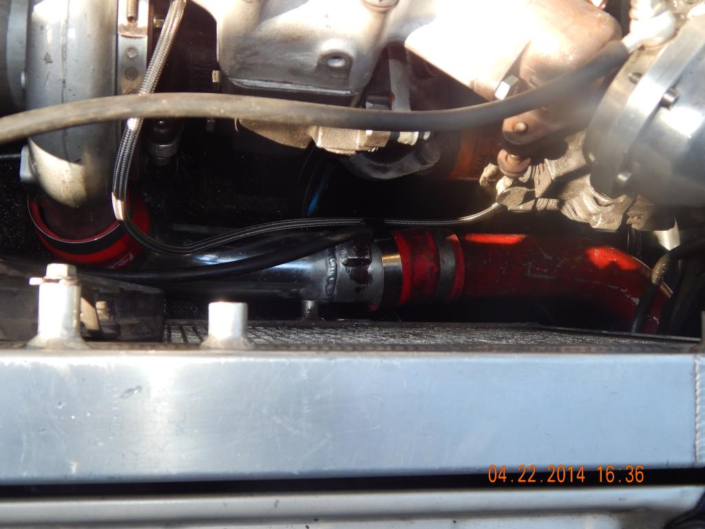

. Finally finished the turbo intercooler piping for the hotside. I was having trouble getting the turbo to even come close enough to the piping to properly fit a coupler. I ended up cutting it shorter from N to S and making it a little longer from E to W. I also had to weld on a bung for a fitting for the MBC. Overall it looks really nice and is going to look even better after paint.

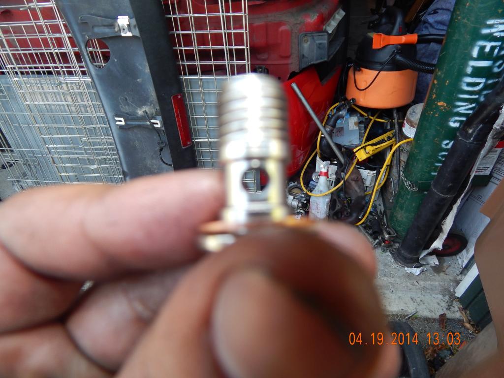

. FIAV block off finally installed and is really strait forward. Be careful with the screws to not strip them because that will make it harder to get them off if you don't have an impact driver. I would like to note I didn't notice any different idle characteristics and think it is a very nice modification to clean things up and get rid of some coolant lines.

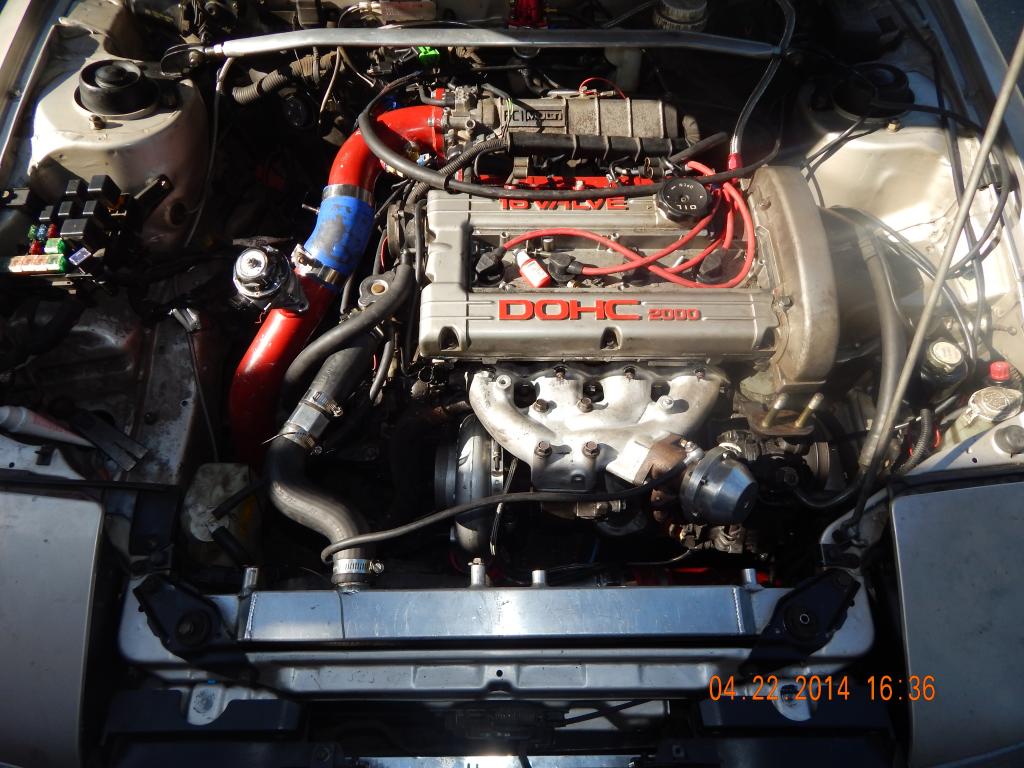

April 23rd, 2014

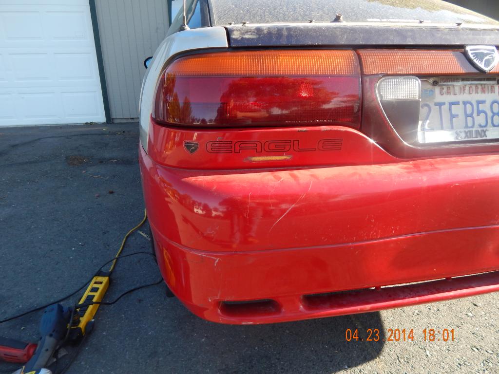

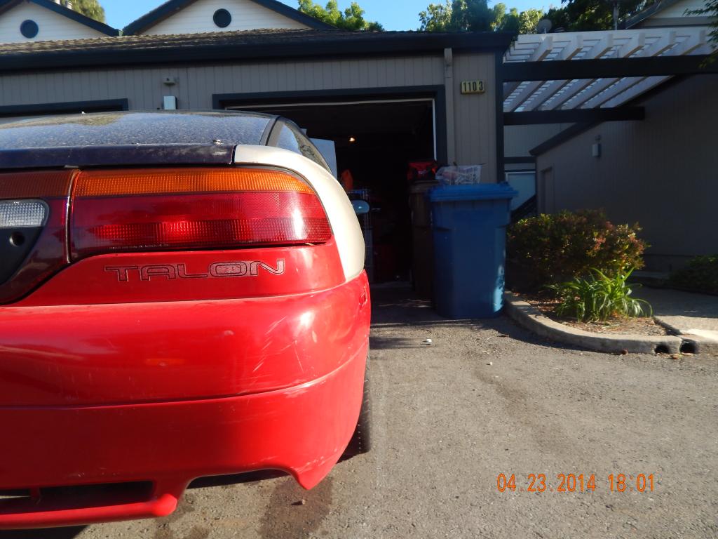

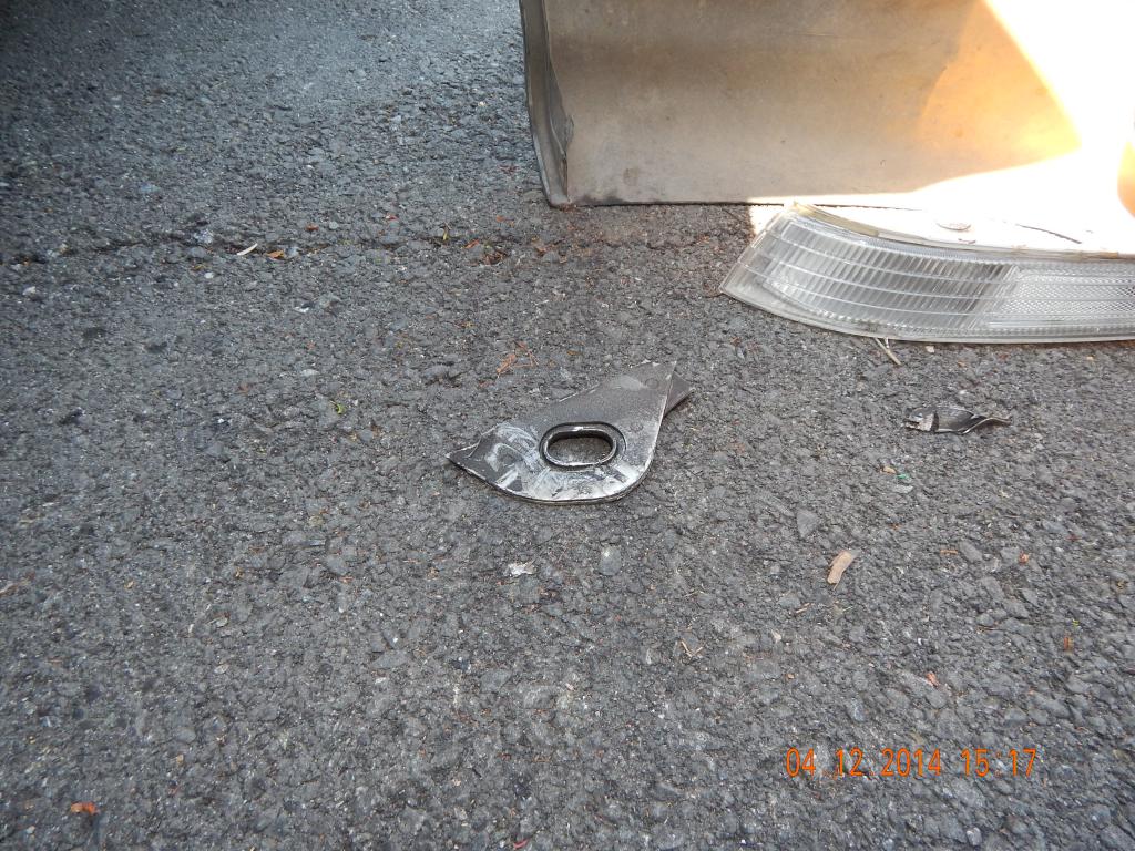

. 1GB Talon rear end conversion done. There is a couple write ups on it and is really easy to do. Removal of the stock tails and bumper is pretty strait forward. Just remove the rear panels and remove all the 10mm nuts to remove the tail lights. Same with the bumper, remove all the 10mm studs and bolts to remove it. Also don't forget the bumper support too, which are 14mm and there is 2 on each side. Also don't forget the two 10mm bolts hidden that would need to be removed from under the car behind the bumper near rear of tire. After that it should all be off now.
The tail lights will bolt right up mechanically, but would need to do some wiring to get the lights to work. Someone hacked my lights prior to my ownership so I had no pigtails or connectors, so I had to wire it straight to the tail lights. For the bumper all you really need to do to get it to fit properly is cut the center section of the old bumper mounting plate and drill and tap new holes for additional support because if you don't you'll only have about 1-2 on each side of the remaining piece of the mounting plate. Overall was really easy and I love the new look, now I need to prep the car for paint....

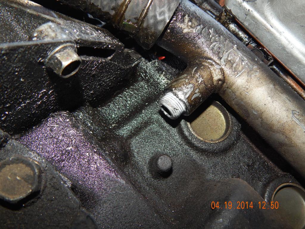

. Fixed the coolant lines that popped off and reassured it wouldn't happen again with some clamps. I also noticed my throttle cable was half off so I fixed it. I went to the auto parts store Monument Auto for coolant and gasket sealer. I asked if they had DSM injector's seals and they sure did so I got 4.

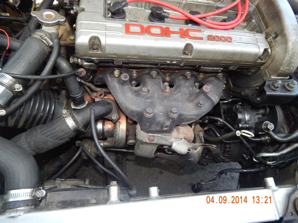

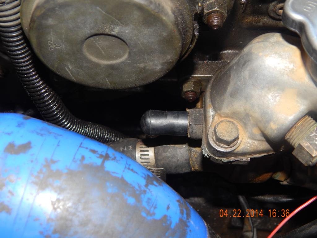

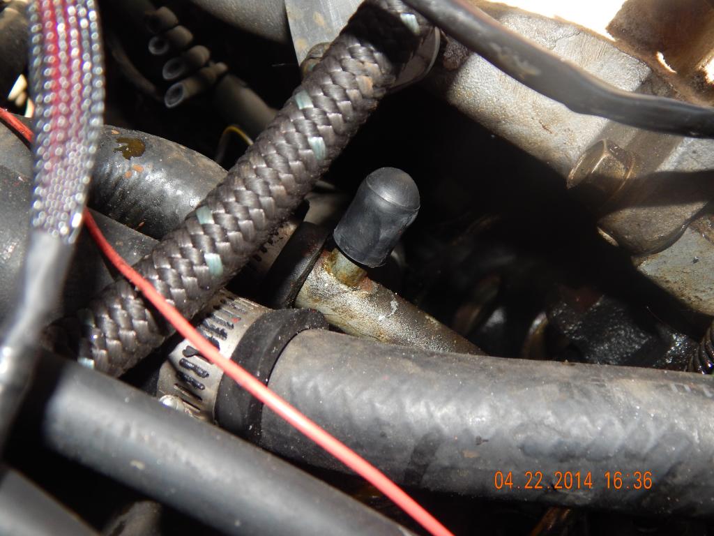

Nice going bro!! Just FYI those 2 rubber vacuum caps you put over the old coolant passages for the fiav need to be done better bro. Those will never stay on or hold the coolant back once pressure is built and your at operating temp. Just hate to see you loose all the coolant and something bad happen bro! It would be better to run a hose from one to the other and clamps on both ends, that's how all mine are. No leaks and no chance for blowing off. Can't wait to see a 3rd gear pull on vid and log!! :)
What's up long time no see LOL,
As for the caps, they are specifically made for coolant bypassing/blocking. They actually did really well holding pressure and only one popped off and lost only half my coolant LOL. I do now have twist clamps on them and they haven't blew off . . . . Yet LOL.
I started tuning and every time I get in boost I blow a coupler, only happened twice but I stopped trying, I'm ordereding better t bolt clamps. And a 30 degree coupler for the turbo to hot side piping. I am instead working on my idle tune. The thing sounds like a crazy crammed car LOL. It won't let me upload a video, so I'm going to upload it to youtube and post back in a sec.

^^ hmm he already had one blow off, so I vote no way they suck!! Lol I wouldn't trust those caps on my turbo car bro! They maybe made for coolant but probably not intended on a boosted car, more heat more stress. Plus you already had it pop off, and there's your sign!! I just see a blown headgasket possibly happening when one pops off while your 6-7k on a 3rd gear pull! Just loop one of the old hoses and clamp it and be done bro, trust me! Start welding all your ic pipes and try to minimize using couplers. Like only have one on each end then you only need a few tbolt clamps! Less chance of boost leaks and blowing couplers off!
To be honest I did the exact same thing no problems so far in regards of caps for your coolant lines. Keep up the good work bro .
Yea, I don't see them being a problem either. Especially with all the clamps I put on them, I'm sure they are not going anywhere anytime soon. Thanks for your support it is highly appreciated. How come no reply about my video LOL??
Ok ok, I will clamp them even tighter tomorrow LOL. Seriously though, I do have them all clamped down now and really am confident that that are not going anywhere. If I start to see any leak or start to doubt them I will just weld them or braze them for reassurance. You think my car idles like that because something is wrong or just the cams now pushing through the bigger turbo?? I kinda like it but it is way way to loud for a daily. I'm thinking of using my 3" aluminum piping and getting some vband parts and making from the downpipe back all aluminum. What are your thoughts on that?

I'm sorry just my opinion about the coolant plugs. For me I don't leave anything to chance if I have power over it of course. It's just like deleting all the emissions stuff. You take it out so there is less chance of boost leaks or other problems. So in my eyes if those things could possibly cause a problem, they gots to go bro!! Lol You need to work on the tune for sure. It sounds pretty good for where your at bro! Sounded like you still have a boost leak somewhere maybe by the fmic drivers side ic piping. Do you have adjustable cam gears? You may want to get some to help further dial in the cams. Are you runing speed density? Think you said you are. Ya I would make a nice exhaust maybe ad a cutout so when your at the track you can run open downpipe or make it so you can easily take off the back half and run open down! Boy get a air filter on that turbo!! LOL get me a Idle and cruise log and I can help you dial it in, no prob bro!! ;)

Well I have been driving my car for about 2 years with this setup now without any issues with these in my coolant lines since I don't need them anymore. I have them secure with heavy duty zip ties. Yes bro I have seen the video I love to see hard work dedication when it comes to these car. I use to run open down pipe for awhile but now I purchased a 3inch cutout in one of the best decision that I have ever made for a daily.
Yea I think I'll be ok with the plugs. The clamps should be more than enough. And thanks for watching it and for e nice words. I have been busting my ass to get this car from stock to this in about a month. And working on my 95 gst drag car as well, it is the love and appreciation I have for these cars that drives me to get up every single day sun or rain and wrench on both of the cars. I will never give up on them with the laser I plan to have fun with the car and push it to the point where I still consider it a daily. I think the hx40 will be its heart for a while though. That's why I have the gsT for strictly drag racing. Being FWD doesn't scare me and to be honest it doesn't even cause me to worry one bit, I know how to drive and I know what to do to make it hook you know what I mean. Anyways, thanks again and keep checking back, I'm far from done. Body and paint next.

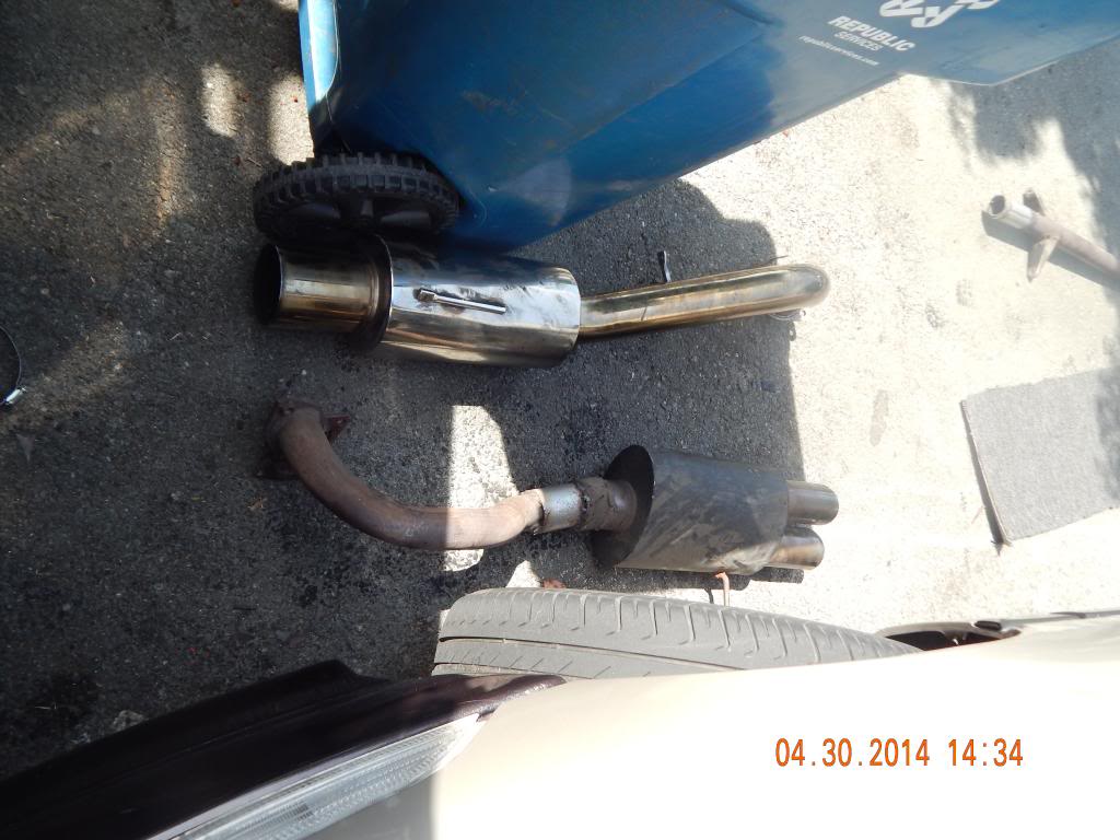

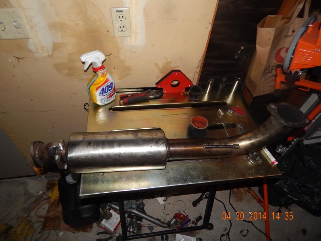

Started on my exhaust for my laser. First I laid the old piece down and made my measurements to try and replicate it. I made all my cuts and welded up a couple pieces and I didnt finish it because of the weird bend at the end near the subframe. I just ended it right before the rear tire. It quieted it a lot, but i am going to finish it one day.

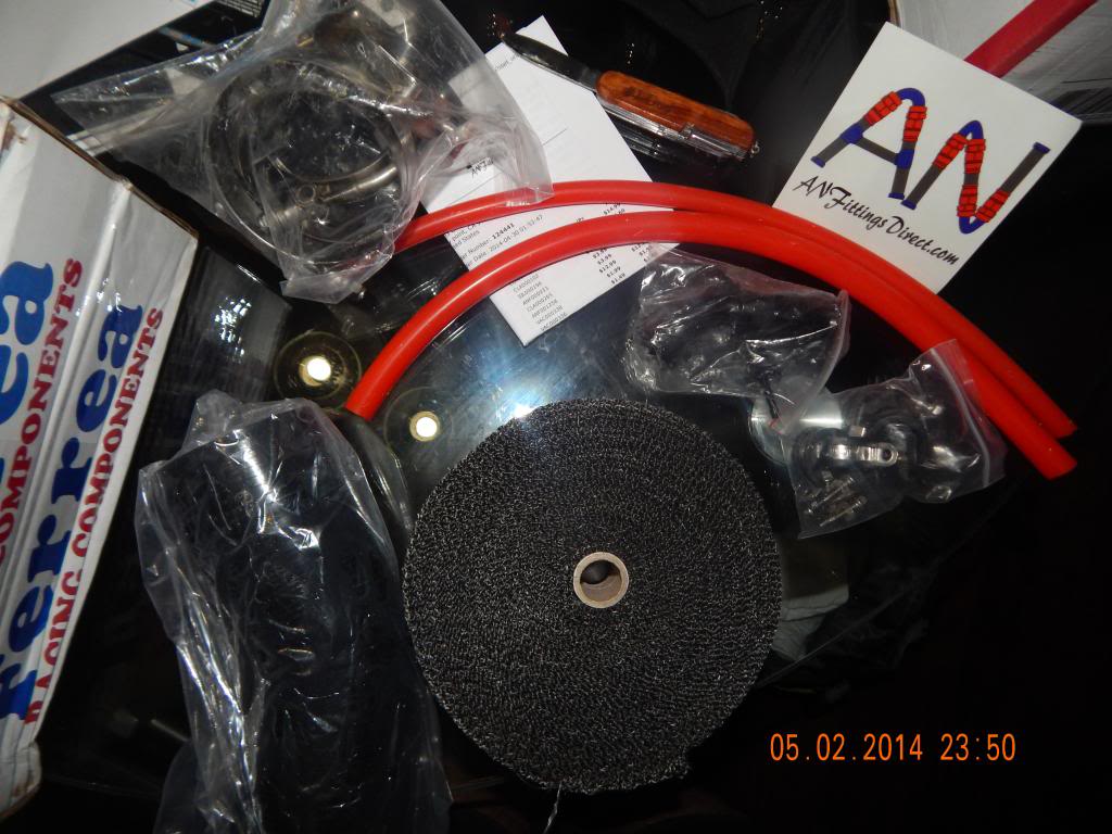

I got my ANFITTINGSDIRECT order that I've been waiting on.
Some exhaust wrap for my hot parts, vaccum lines, TBolt clamps, few AN fittings, 2.5" bend for turbo to intercooler pipe coupler, and a ouple other things.

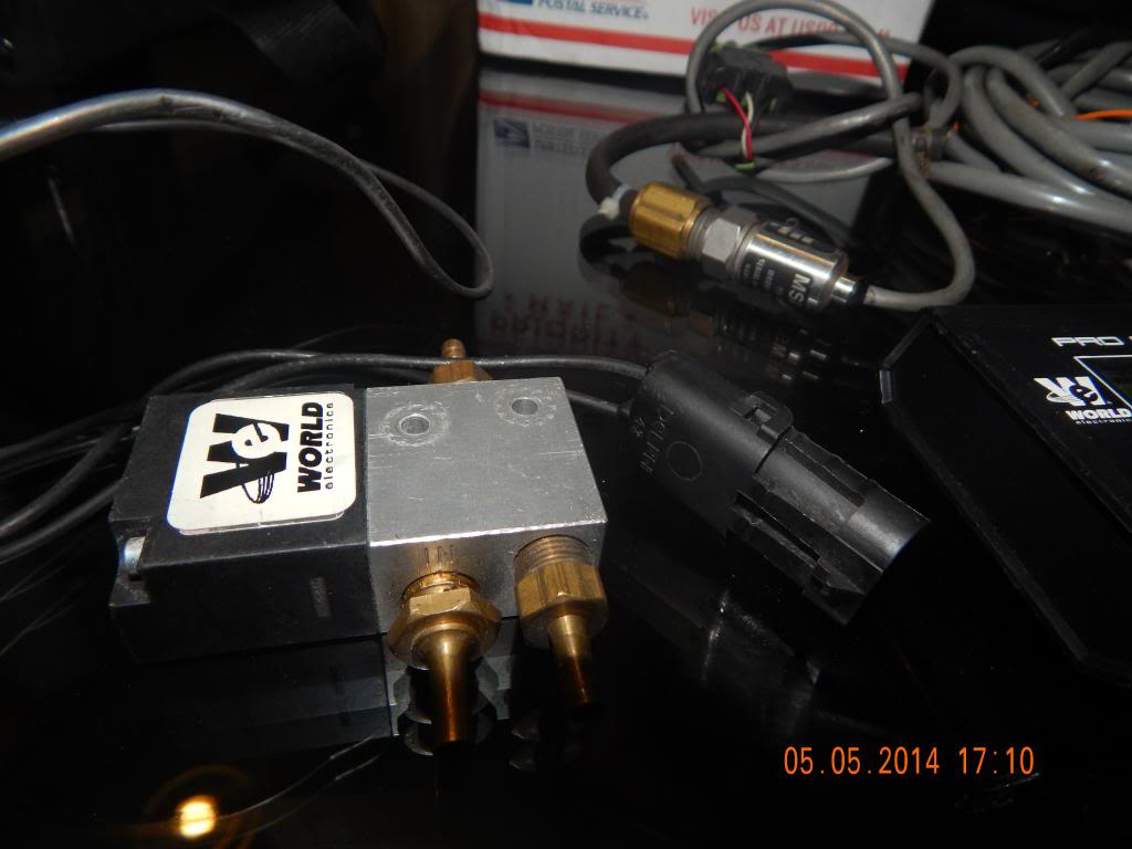

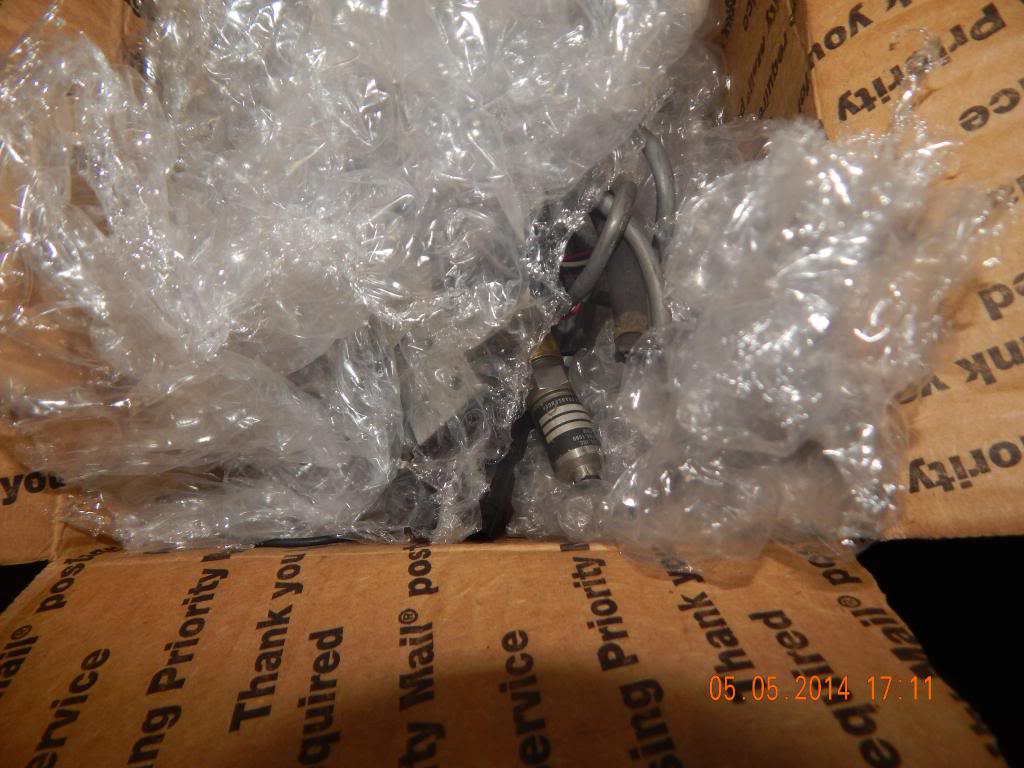

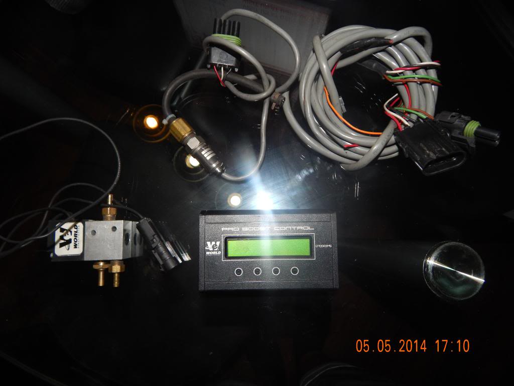

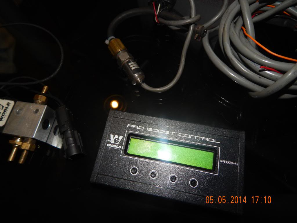

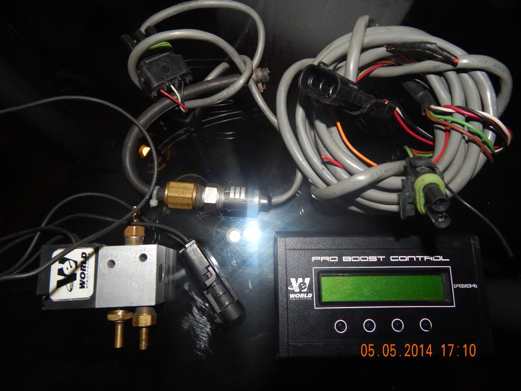

I also received my electronic boost controller.
I think it is a really nice unit and will work very well with my car being FWD. It has many boost settings and other settings and can control boost up to 50psi and it learns my driving habits, or so it says on the article about it. It is kind of like my Gizzmo MS-IBC I have for the GST. Well see how good it is, I will definitely be posting back how it performs.

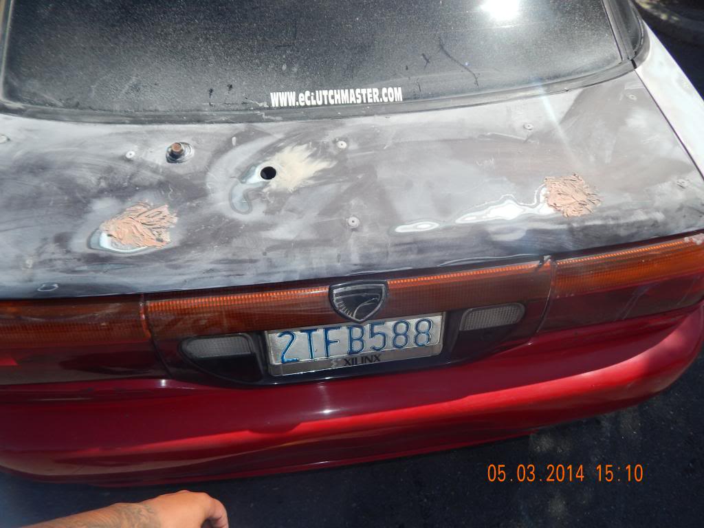

May 3rd, 2014

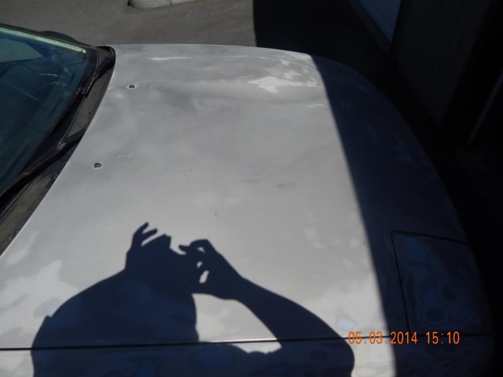

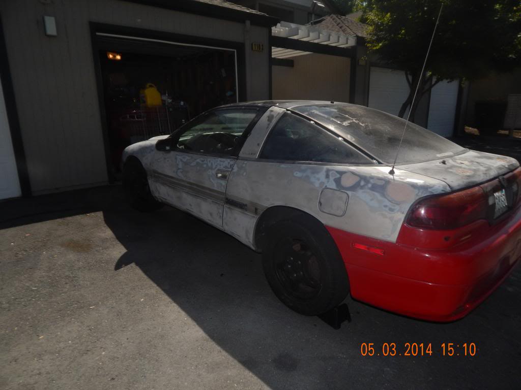

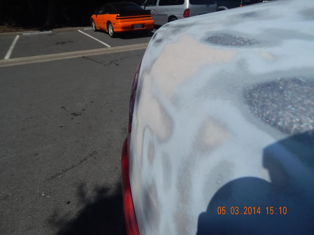

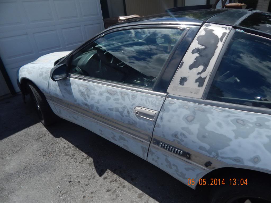

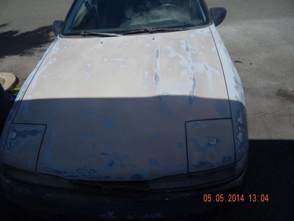

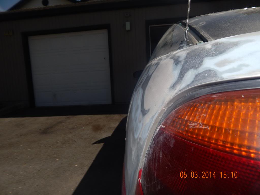

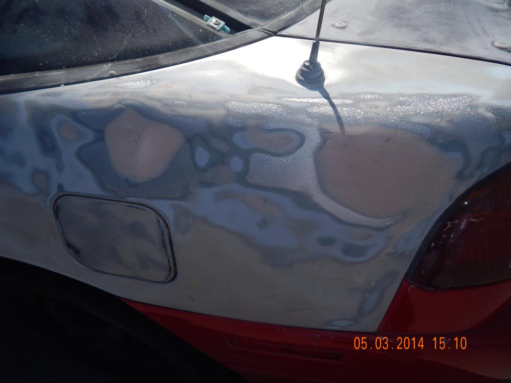

convinced my wife for a paint job on the laser so I went to Harbor Freight and got some things to get to work for prep. Ended up with a air DA Sander, 60-80-120-320 grit discs, 120-320-400-600-800 sanding blocks and a bunch of other little things that is needed. Also grabbed some bondo for some dents I cant get out. I went home and got to work. I didn't want to spend 3-5k on a paint job so I decided to do all the prep work and body work myself and take it to Macco. I know everyone thinks its a crappy place, but I honesty aint expecting to have a show quality paint job and that's why im doing the prep work so I do get a little better then if they would do it there selves. I don't know what colors yet, but I do know top is going black.
And on May 5th, 2014 I finished the prep work and took it in for paint. I was taking forever to chose a color. I knew I wanted a red, but the one I wanted was a tri stage candy and I couldn't get that. So I went to the car and see what my wife thought. She pointed at a color and I just went with it. I did pick the top color though. It came out to $953, and that was a super discount because he only charged me 50 for the roof, and gave me the 899 package for 799. I already did all the prep work and took off the spoiler and side skirts to try and get it done faster. They said Thursday......

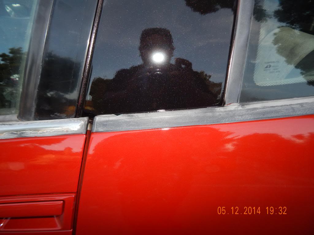

May 12th, 2014
I have been waiting very pateiently o get my car back from macco. I was told it would be done Thursday and they said Friday. I call Friday and now its Saturday. I call Saturday and now its Monday. I was really frustrated and pissed because I told them I needed it for the weekend for an event I was suppose to attend. I missed the event and its not that big of a deal, but I didn't appreciate that they took on a job that they obviously couldn't finish on time when I specifically said my intentions the day I brought it in. I mean the didn't even have to prep or anything. whatever, anyhow, I call today and they said come at 6pm.
I get there at 6PM and they tell me I should wait until tomorrow because they still haven't washed it and it still has tape all over it. I asked them why they would have me drive all the way over there to tell me this, and I told them to just give me my car, I can care less if they dint wash it, or spray it off with water. I think it came out fairly well, but a few parts I didn't like at all. Like the spots that were bondo'd, you could see it, I maybe prepped it wrong but I showed it to them when I took it in and said if it needs touch ups to be smoother to do it. And the day I took it in the guy told me bout a10% off coupon and to print it and bring it when I picked it up, I brought it and he said I cant use it because it says I have to have it at time of quote. I like the car, but I wold never take it Antioch Macco ever again. I think the paint job is good quality for the price and I got a 4YR warranty. I am still trying to et used to the color, but I like it, just wish it was a brighter, shiny red. Oh well I cant be mad, it looks way better than it did. Let me know what you think, I still have to put the spoiler and side skirts on.
Melbourne Pearl Red && Midnight Pearl Black
