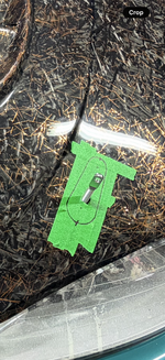

By November 2025, my carbon fiber hood and hatch had arrived—and were sitting patiently, still waiting for installation (and yes, they still are, haha).
Unfortunately, when the hood arrived, I discovered some damage from shipping. Both front corners had cracked: one corner had completely broken off, while the other was still attached but split through. Not exactly the kind of “carbon” I was hoping to see!
Thankfully, the manufacturer stepped up and offered to repair the hood free of charge, even helping to arrange return transport to take care of the damage.
That didn’t stop me from mocking it up on the car just to see how it’ll look once installed for real—and let’s just say, it’s going to transform the whole appearance of the Talon. Really can’t wait to get it fitted properly once it comes back repaired.

Then came the stressful part—cutting into a brand-new hood to install a set of locking AeroCatch hood pins.
You know the saying, "measure twice, cut once." Well... I probably measured two dozen times.
I used painter's tape to establish a centerline down the hood and repeatedly checked the AeroCatch templates to ensure both sides were perfectly symmetrical before drilling a single hole.
I then drilled and tapped the radiator support above each headlight, using the factory spot weld locations as reference points so the hood pins would also be perfectly symmetrical.
After drilling the pilot holes, I installed the hood pins and carefully closed the hood to verify their alignment one final time before committing to the larger cutouts with a hole saw and Dremel.
Thankfully, everything lined up exactly as planned.
Once the openings were finished, the AeroCatch latches dropped right into place. I shortened the hood pin studs to achieve a snug fit with no unnecessary play, while retaining the factory hood bump stops for additional support.
The finished product came out better than I had hoped.
