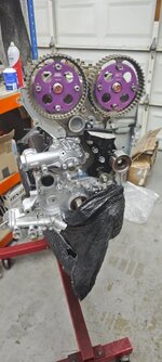

So, once the cylinder head was mounted to the block it was time to get oil and timing components installed. To speed up the process and have a possibility to fire up the car this winter I have contacted Bobby or FIBA Motorsport to help with assembly. We sat up the time and I dropped off the block and boxes of parts for him to do the magic. The whole process spanned over a few month tackling several issues and I cant thank him enough for his expertise and knowledge in dsm platform. So, first, we had issues with my brand new mitsubishi hydraulic lifters, twelve out of sixteen were seized shut and did not move. It was kind of upsetting considering their cost, so we got them sat in oil and degreaser for a few weeks and luckily they were back to working order. Next, was the HKS intake cam that apparently did not come with threads for the CAS bolt, thanks to Bobby and local machine shop that was well resolved.

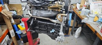

My exhaust manifold had a larger runners and thicker wall so the lifting bracket didn't fit and we had to shave some metal off of it.

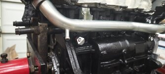

I aslo did not realize that evo3 oil filter housing did not have provision for the oil pressure light, so that had to be drilled and tapped. While we were at it, I decided to enlarge oil pressure relief opening since balance shafts were deleted.

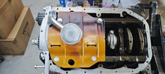

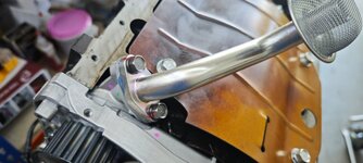

New oil pick up was fitted in.
0bf55f34-8c79-4071-a45e-8a14cf860449.jpg 89a84f23-58bd-4f2f-8999-a552a8fee920.jpg

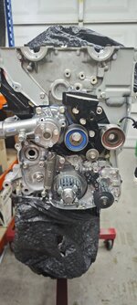

Installed evo3 water pipe and turbo water block off plug, both are made by mitsubishi: plug is md014929 and block joint is md314121

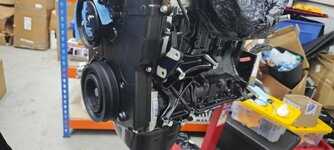

New timing cover and hardware, which are obsolete now. Oil pan was bolted with honda oil resistant silicone so we will see how it pans out.

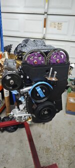

As of now I'm waiting on additional hardware to start mounting the rest of the accessories.
4f47f378-0870-4276-a209-23efe8caff00.jpg5d73cf0c-ce07-4564-80b2-1e37d31dce89.jpg864f21be-1d87-428e-8f65-f45ec4ad9fea.jpg
