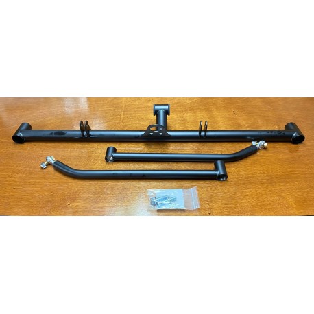

Not sure if the link will post here but I found another tube crossmember kit
