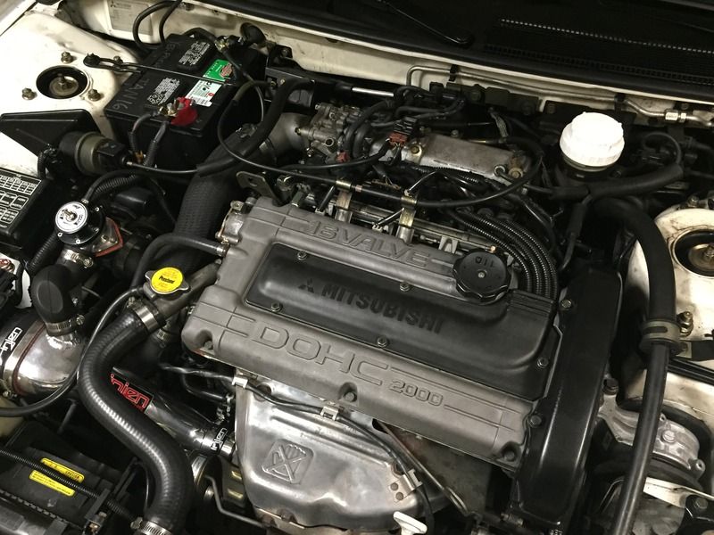

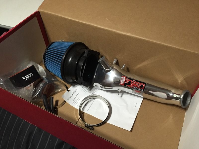

I picked the car up a couple weeks ago from the shop after they replaced the timing belt, water pump, tensioner, balance belt, and everything else in the timing cover. It also needed a new drivers side top motor mount which actually fixed the vibration I was getting while idling so I was happy with that! I still have to replace the rear diff, transfer case and transmission fluids but haven't gotten around to doing it yet. I ordered some goodies from ExtremePSI :cool:. I went with the Injen intake due to being in California and it's CARB approved. Still waiting on another package to come in the mail :D. I also bought a 2G weighted shift knob (BRAND NEW) from a member on here. It looks and feels awesome!
UPDATE 7/6/2016

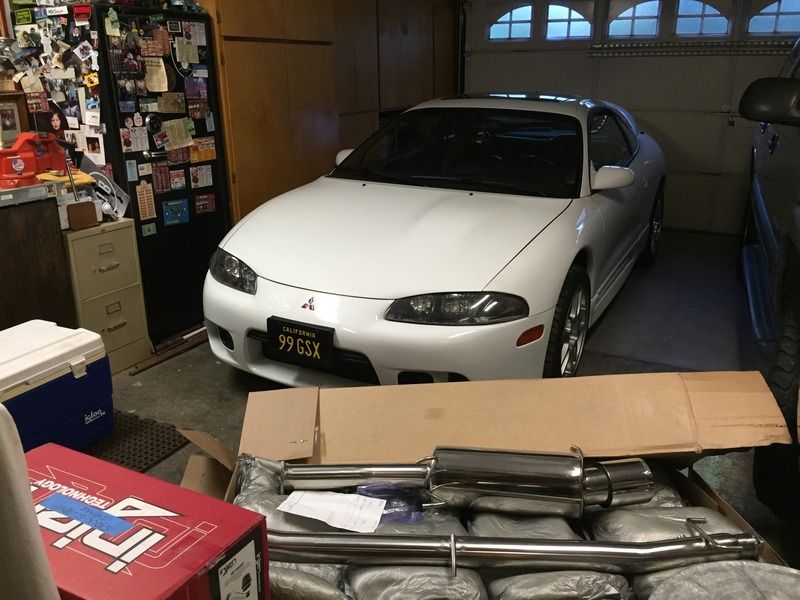

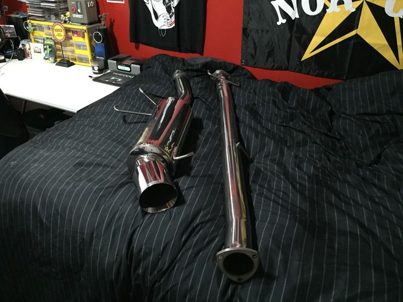

I just wanted to update this post and say I received my other package from ExtremePSI. Thermal R&D Exhaust is going on soon!! :D

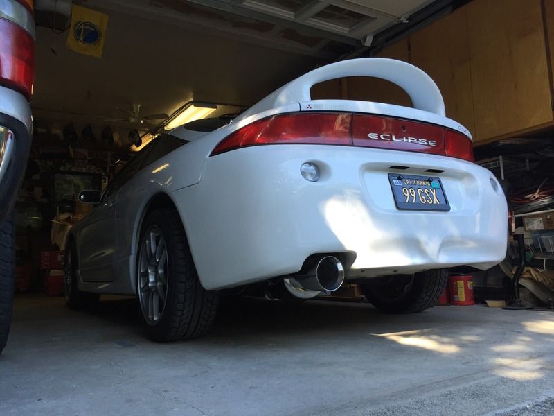

UPDATE 7/7/2016

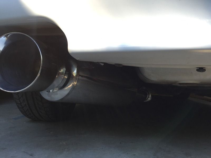

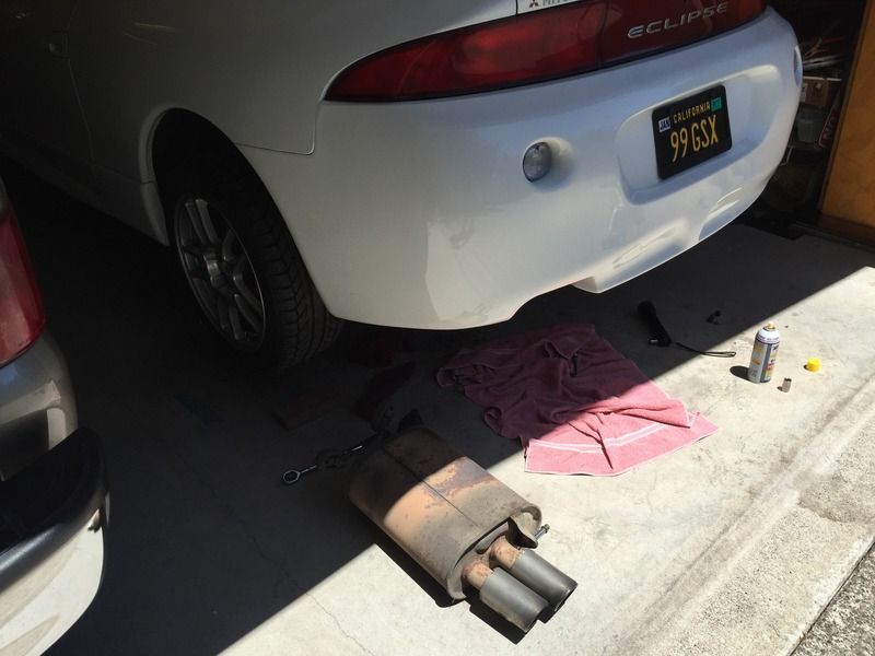

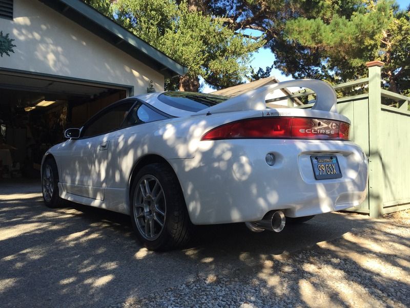

THE CATBACK EXHAUST IS ON! :hellyeah:Sounds very nice! (Thermal R&D)
UPDATE 7/11/2016

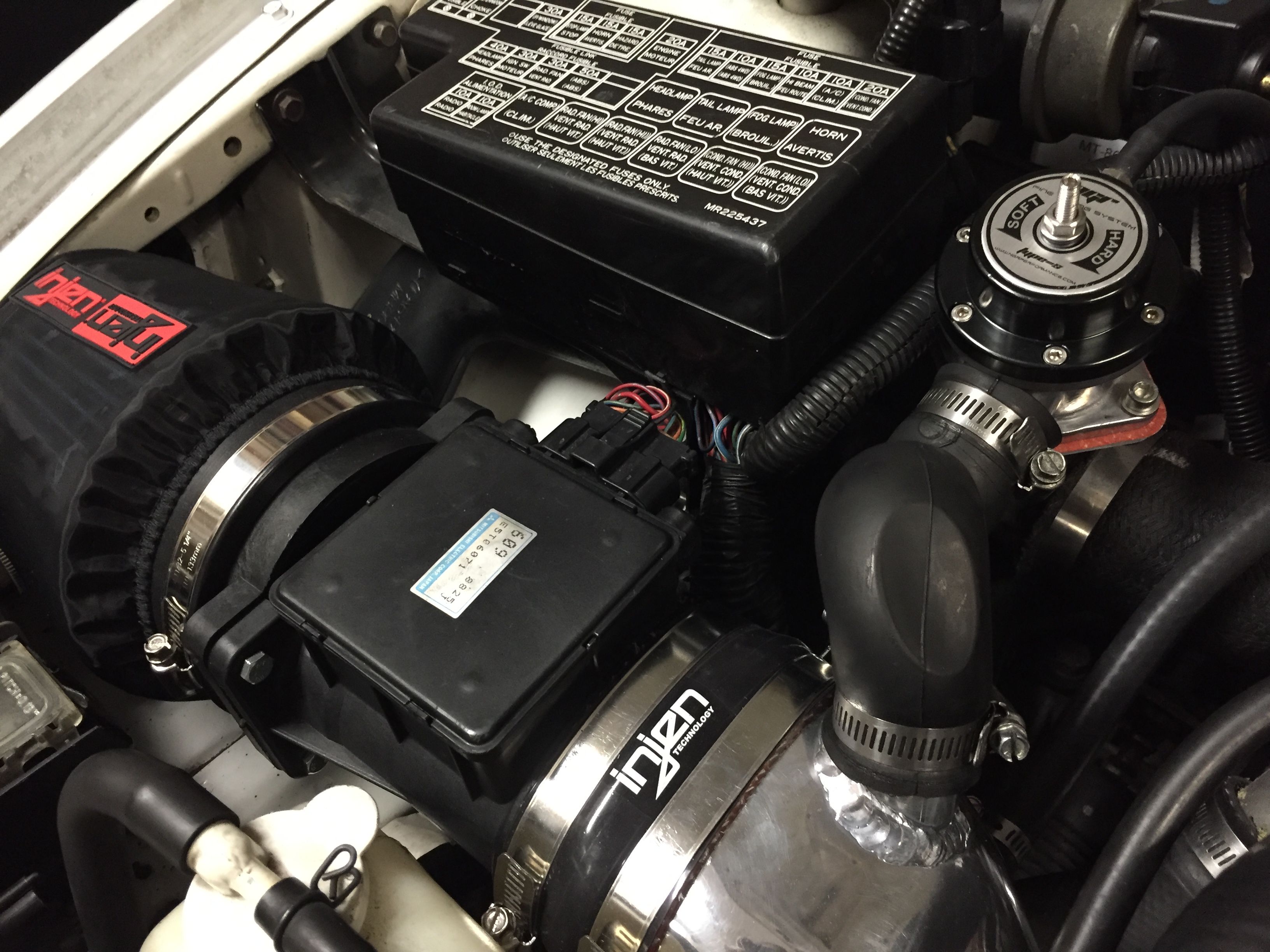

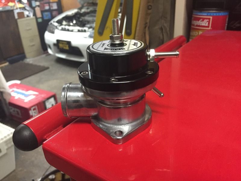

I installed a NGR Type-S BOV to replace the leaky OEM one. It sounds pretty awesome and looks great too. It's amazing how much more you can hear the turbo spool with the intake and exhaust set-up now. :D

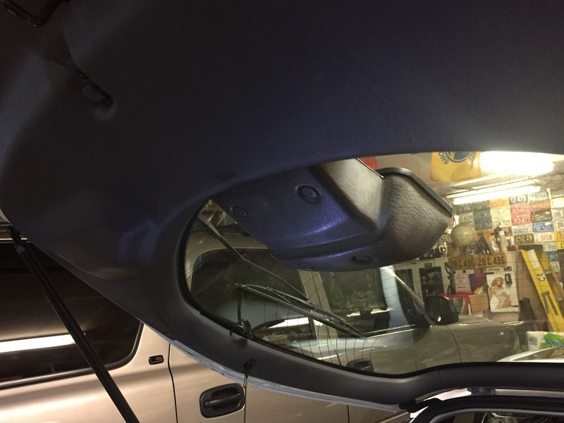

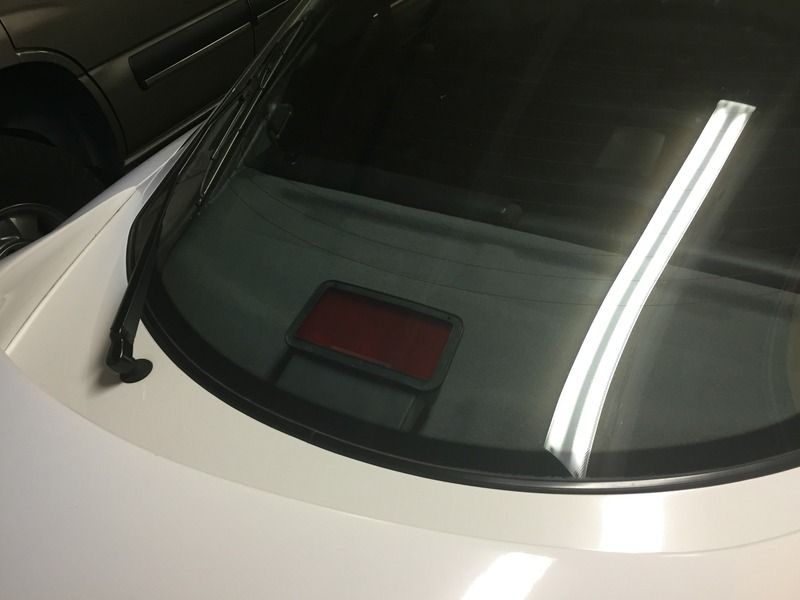

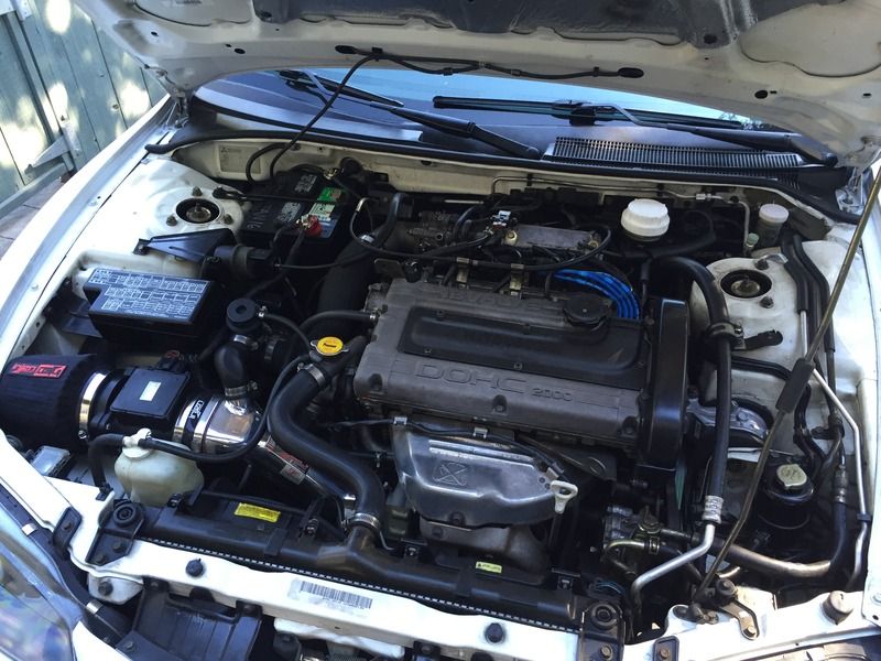

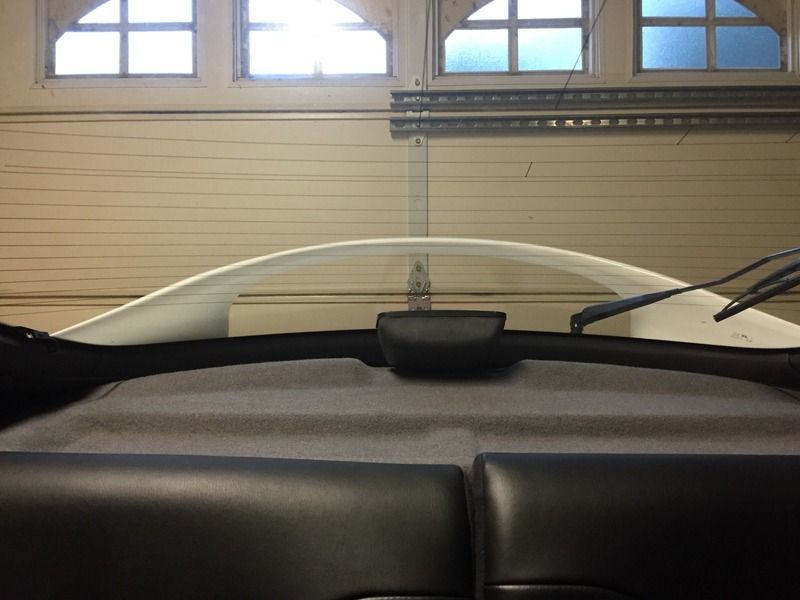

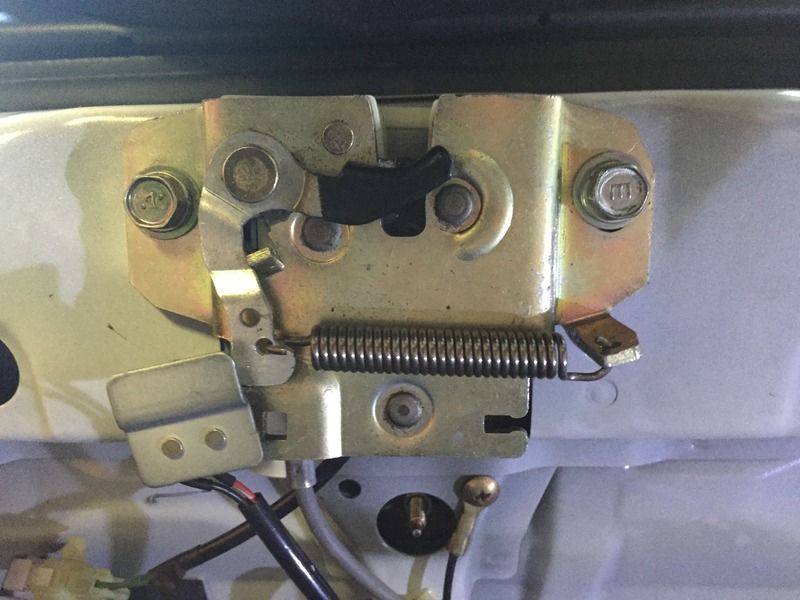

Just did a couple small things to the car. First off, I got an OEM 3rd brake light assembly and the trim cover for it. The previous owner must have deleted it cause the wiring was nicely tucked away and I do remember reading on here that people weren't too fond of it and it obstructs the rear view vision. I don't mind it and I wanted to have that OEM look. I also had the infamous "have to pull the hatch release handle once, go lift it up, *doesn't lift* then pull the handle a second time then it works". So I found the write-up online to drill a new hole, and bend the spring tab a little bit. It now works perfect (see picture below). And last but not least, I wasn't a fan of the blue spark plug wires that attracted too much attention in the engine bay, so I decided to put black wire loom over them. Came out pretty good :cool:. I am planning on a black/polished engine bay theme. ALSO!!! Posted a new Youtube video of the car. Just a walk-around style video. :dsm: Thanks for the kind words everybody!!

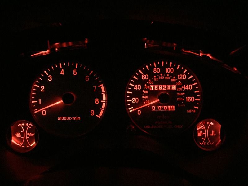

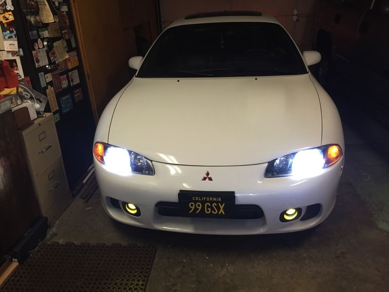

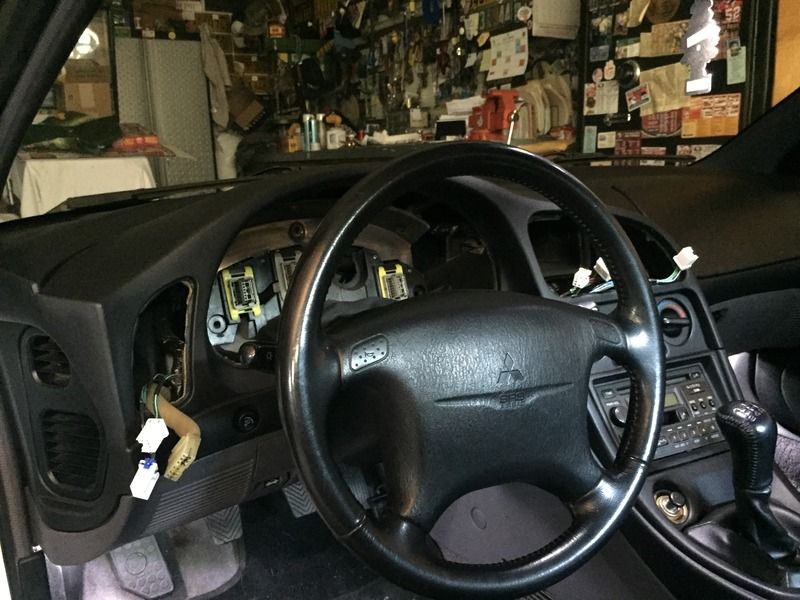

I have always been a fan of LED gauge lights and after reading the write-up on here I decided to order bulbs (red) from Superbrightleds. So I installed all the bulbs in the cluster and immediately noticed "hot spots", and with my OCD I couldn't handle it so I put all the OEM bulbs back in. With my luck, some of the stock bulbs decided to not work anymore!! I also had the foglight switch, side mirrors, cruise, defroster, hazards, and rear wiper switch already replaced with the red LED's so I had to put the stock bulbs back in because I didn't want everything not matching. Well some of those bulbs decided to not work, and they are pretty hard to find so to the junkyard I went! I got a whole bunch of bulbs and even came across a very clean set of smoked side-marker lights. Best part was they didn't charge me for the side-markers which was great because I wasn't really sure it I wanted them to begin with. Most recently, I installed LED headlights and foglights! Very bright and not blinding which is what I was worried about since they aren't in projector housings.

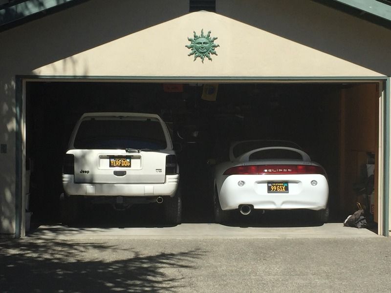

UPDATE 2/26/2017

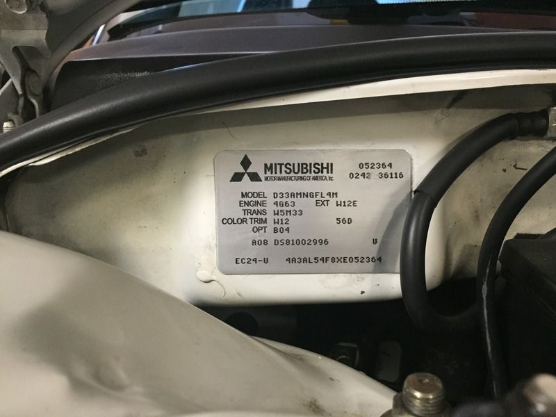

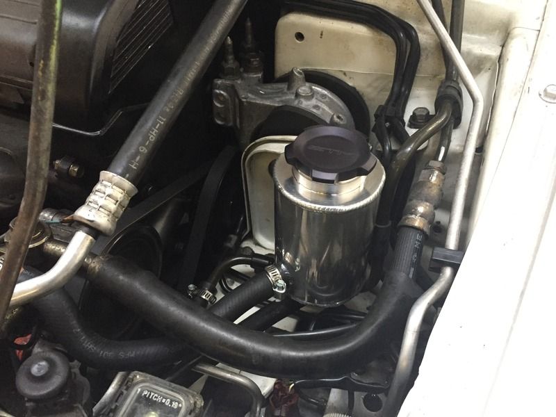

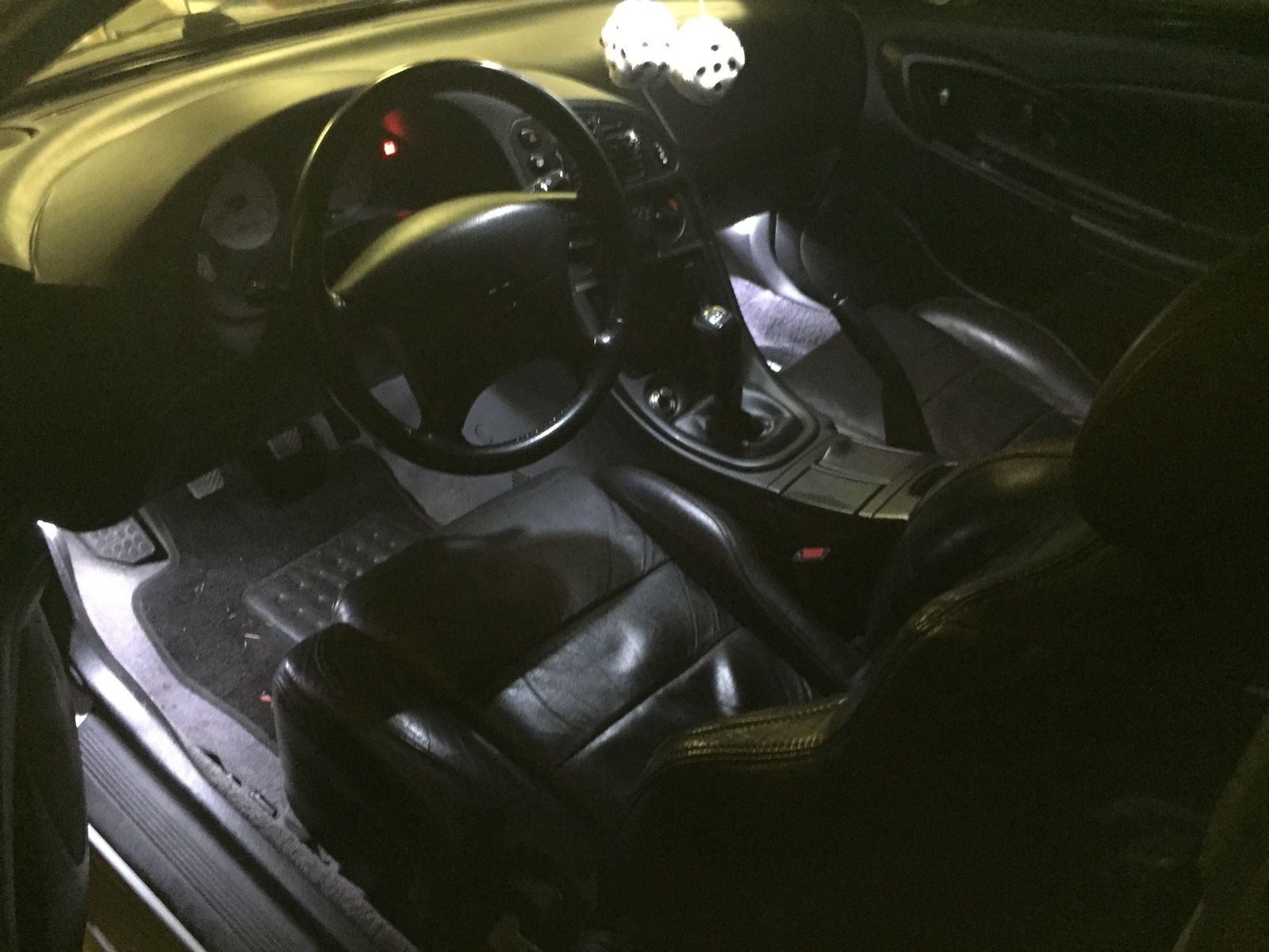

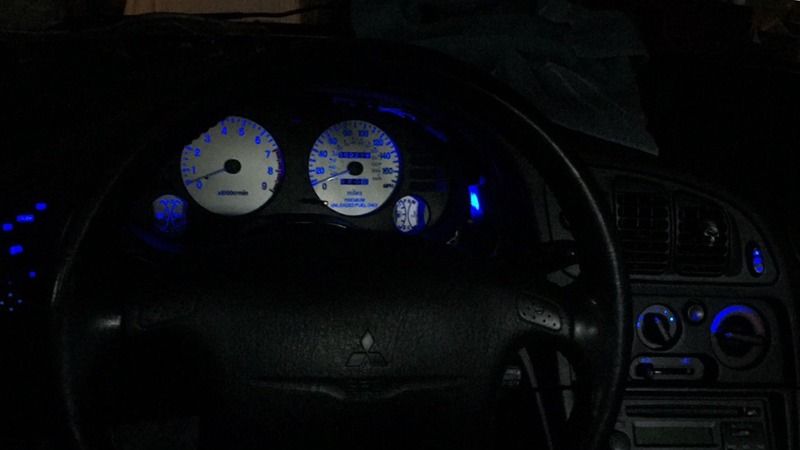

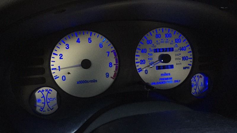

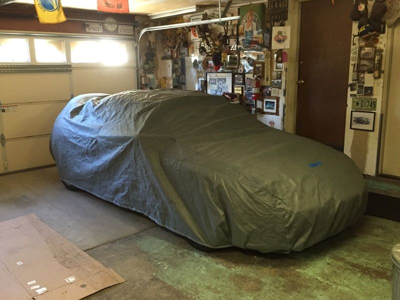

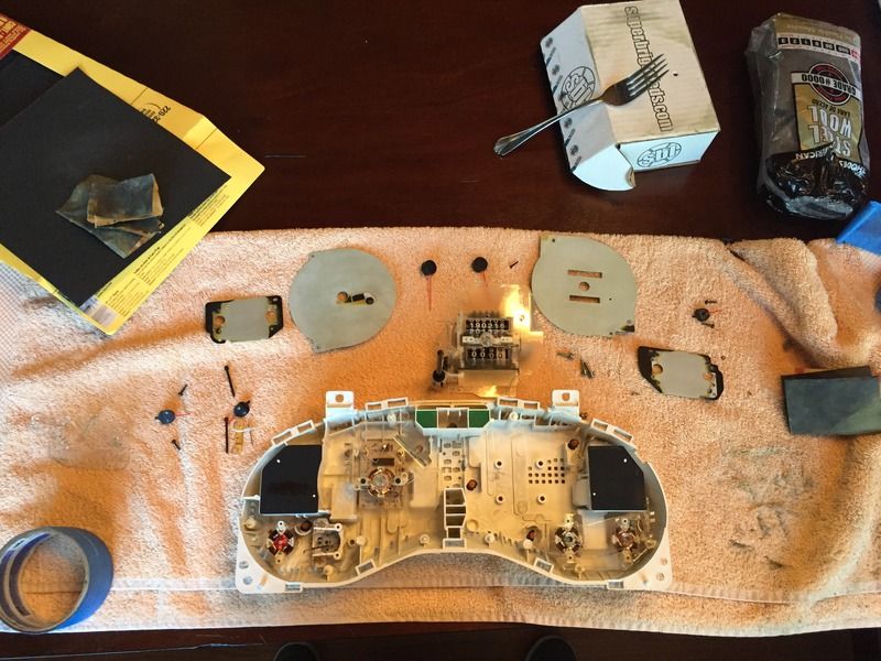

It's been awhile since I updated this, so I will mention everything I've done to the car since the last update. First off, the Eclipse gets to be in the garage so I wanted to get a light cover for it to keep the dust off. Found a cheap $25 cover at Costco and it fits like a glove! I then had a paint-less dent repair guy come to the house and pop out about 12 dents all around the car for pretty cheap and he did an awesome job. It makes the car look even better. I ordered and installed a new engine bay tag from forum member: "jdxnc" to replace the faded sticker one. I previously had WHITE LED's for the interior lighting but decided to get BLUE ones form V-LEDs and they are very bright. I also did the gauge cluster and all switches with blue LED's (they look a little purple in the pictures for some reason). I had to do the "gauge sanding" to get the blue light to shine through but it ended coming out pretty awesome. Very happy with the results. Since I bought the car, it had a small power steering fluid leak right at a hose connection on the reservoir, so I decided to get the STM polished one. The next two "mods" I did were recommended by a forum member on here. The "foglight" mod and "hood strut" mod. I've always liked the option of having foglights on with just the parking/running lights so an inline fuse jumper wire can easily fix that. I then read up on here about having hood struts and followed through with that! Looks OEM! That's about it for the last 6 months or so, but I have a couple other things in mind coming hopefully soon! I just spent a lot of time/money on my Jeep (lift kit, tires, wheels ect..) So I have to take a break for a little bit haha!! Lots of pictures of the updates mentioned and also some random ones:

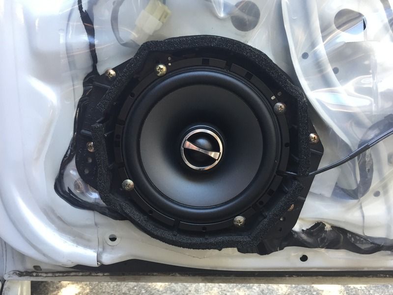

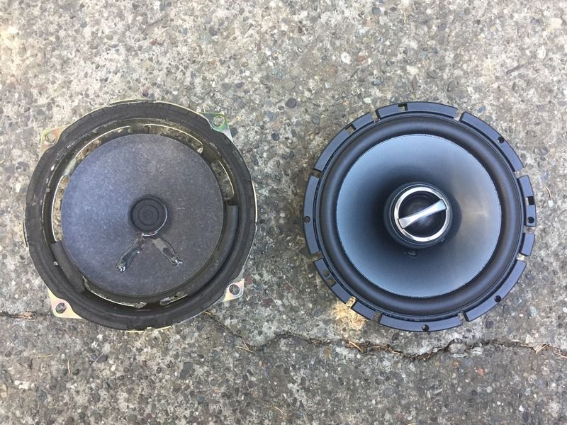

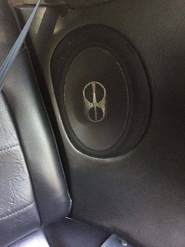

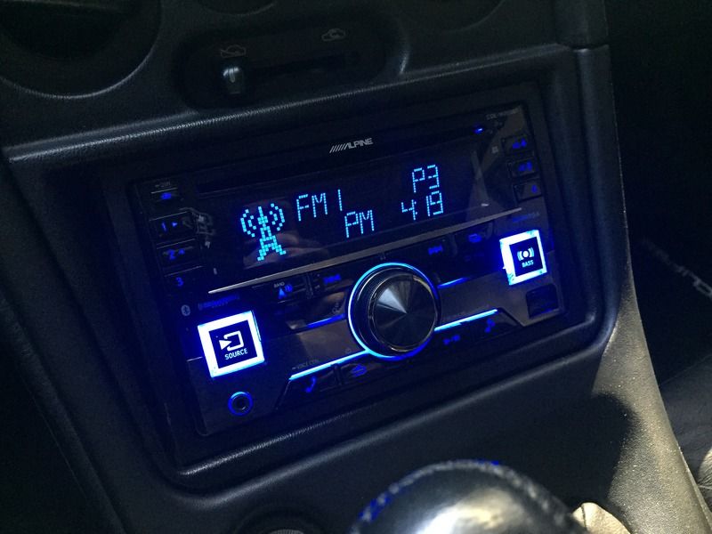

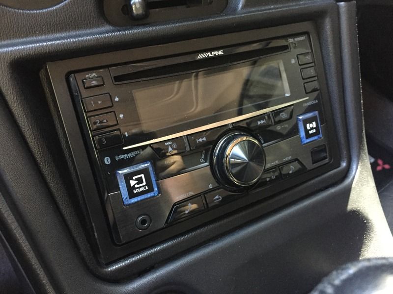

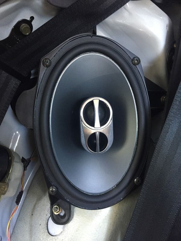

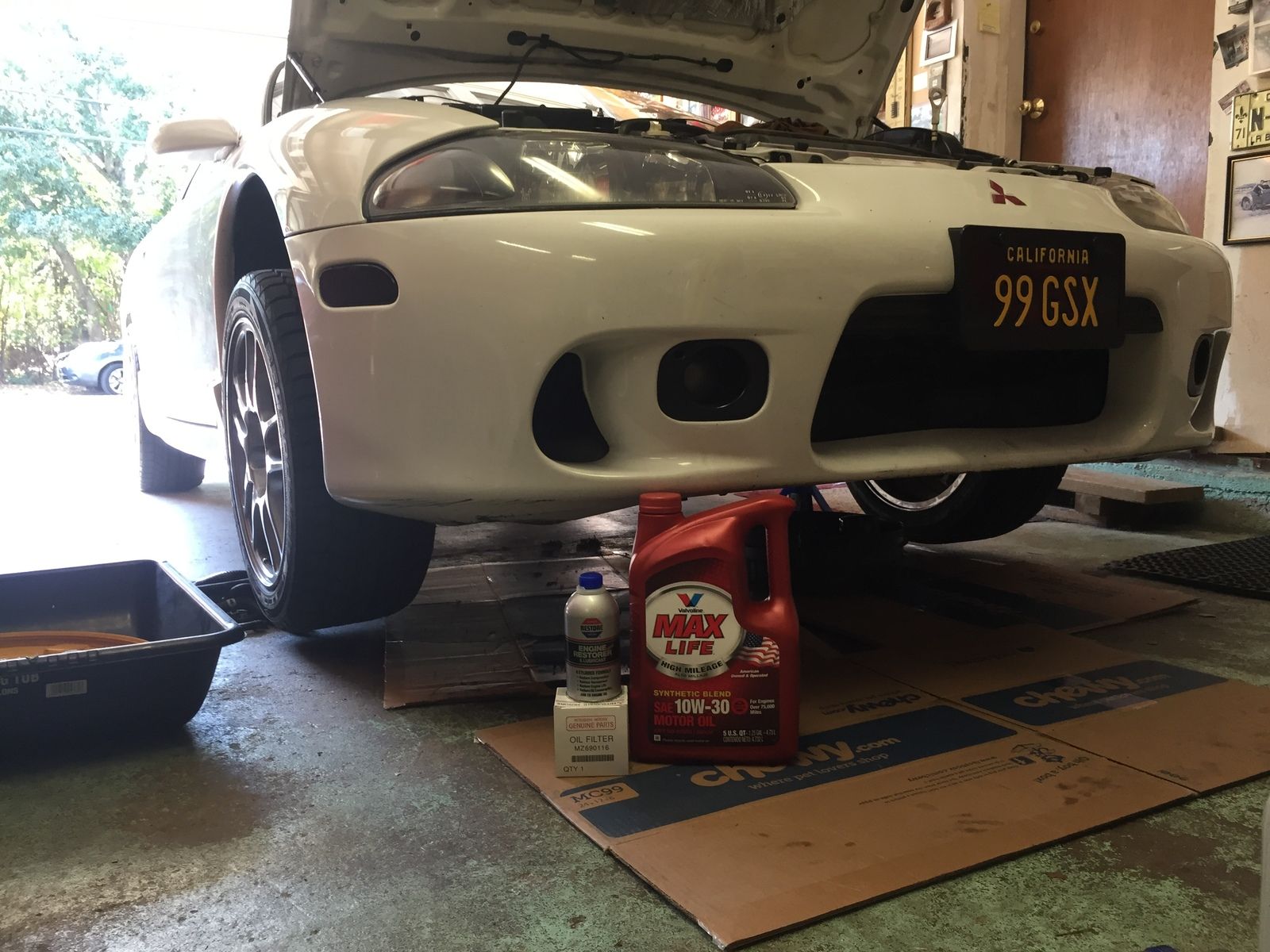

I have done a few things in the past several months that I need to update here. First off, I did an oil change on the car. Next I wanted to upgrade the stock stereo with a new Alpine double-din unit. I ended up going with the Alpine CDE-W265BT and I'm very happy with it. I then decided to order new speakers for the front doors and also the 6x9's in the back seat area. I went with Alpine SPS-610 & SPS-619 and they sound fantastic! Then again, the stock speakers were completely trashed. Next the windows were tinted. DARK. We'll see how long it lasts :shhh:, it looks cool and my Jeep is the same way but the Eclipse just seems darker. It's 5% all around/sunroof and 35% on the windshield with a 5% strip. I also put back my white interior LED's to replace the blue. They look so much cleaner and make the interior pop at night.

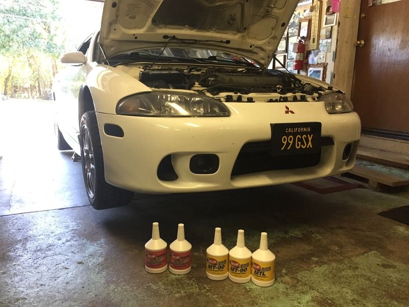

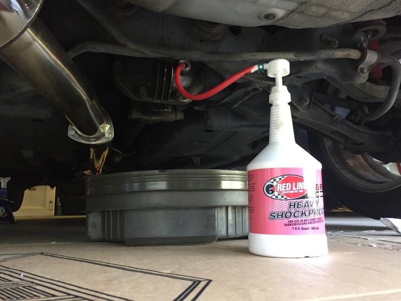

FINALLY, got around to changing the transmission, transfer case, and rear differential fluids. I have had the Redline fluid sitting in my garage for about a year...:p
Anyway, the transmission got 1 quart of Redline MTL and the rest Redline MT-90. The transfer case and rear differential got Redline Heavy ShockProof

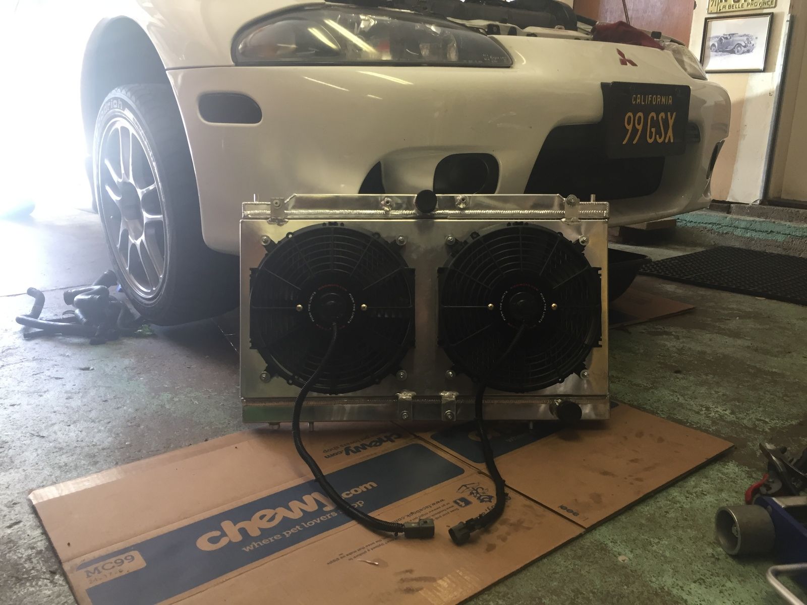

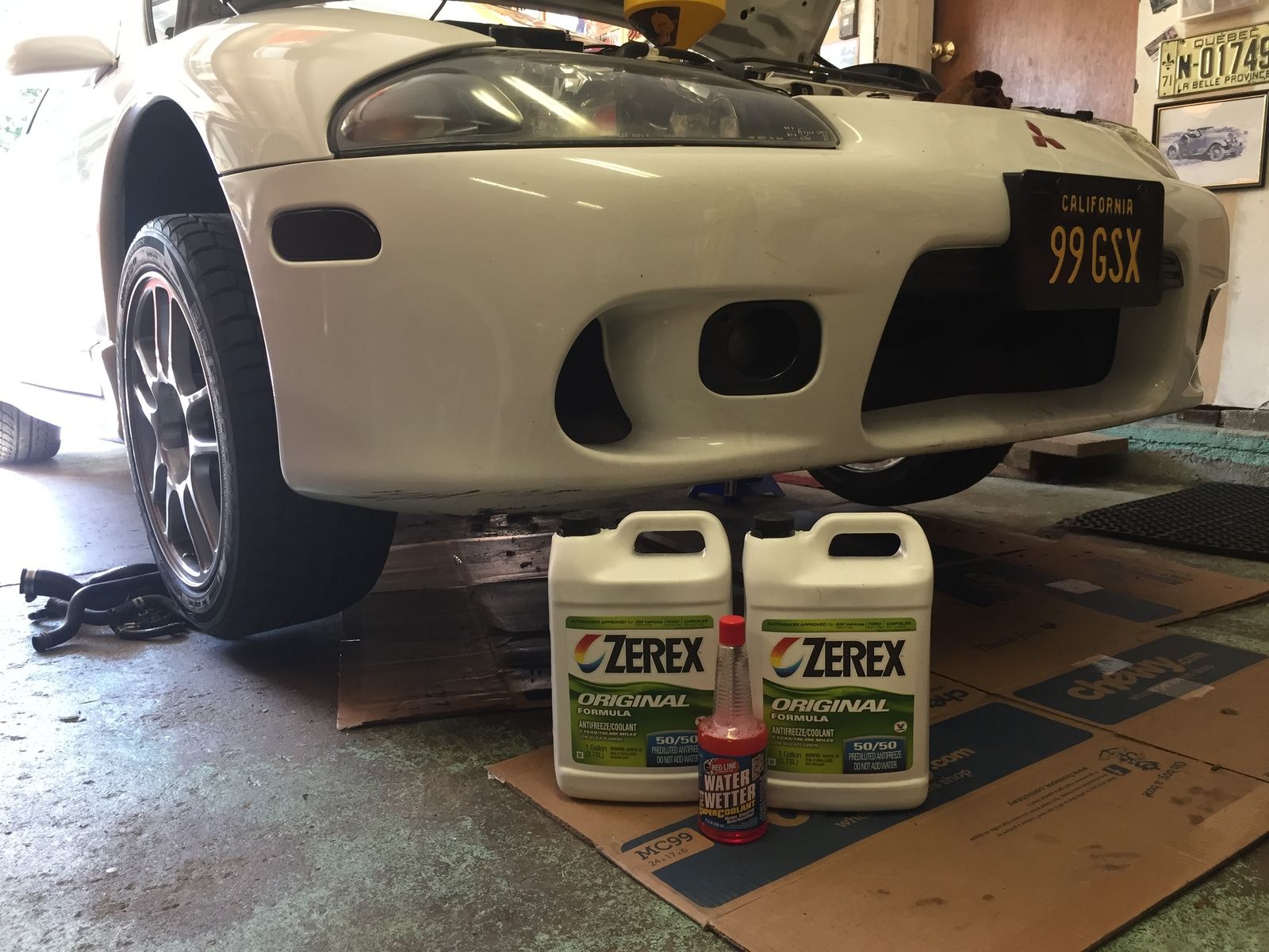

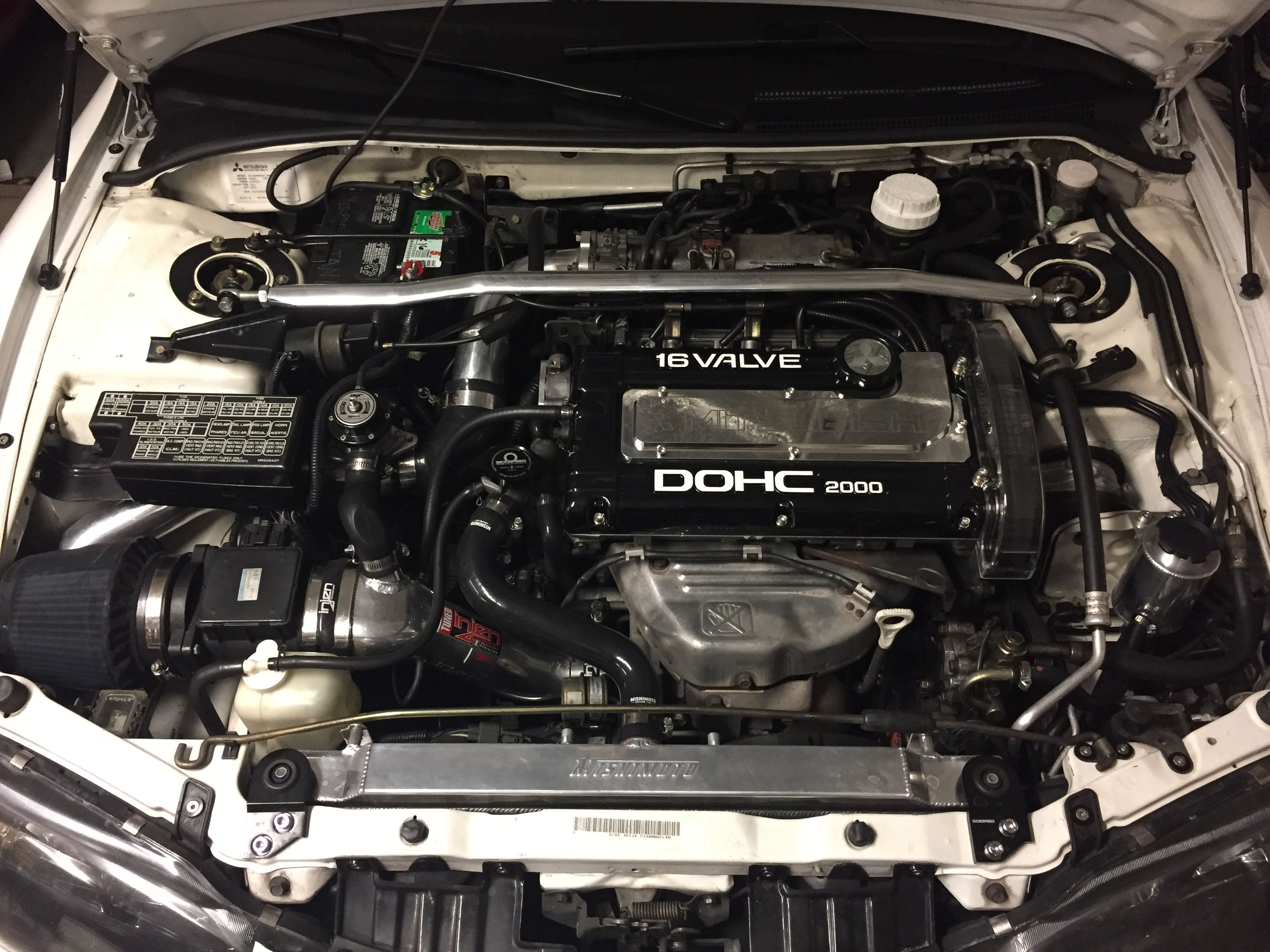

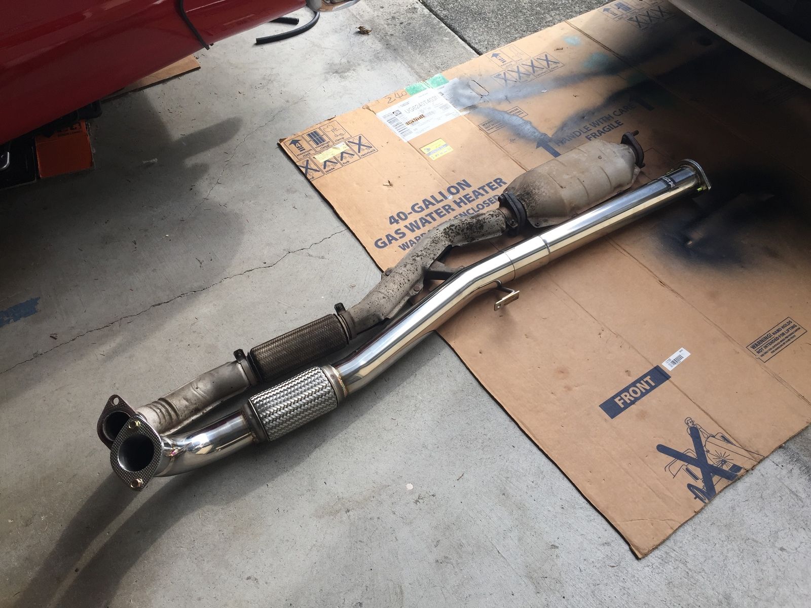

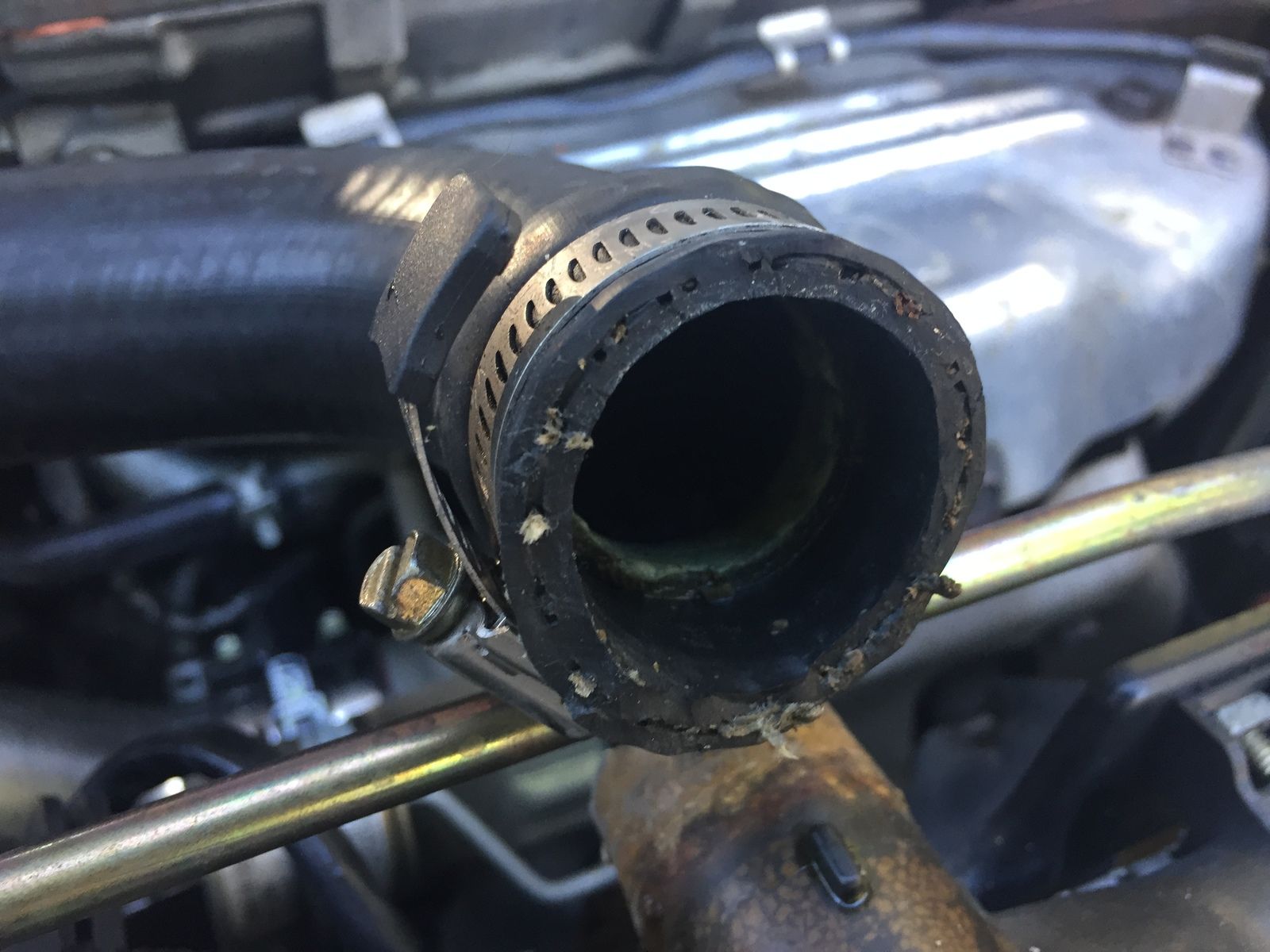

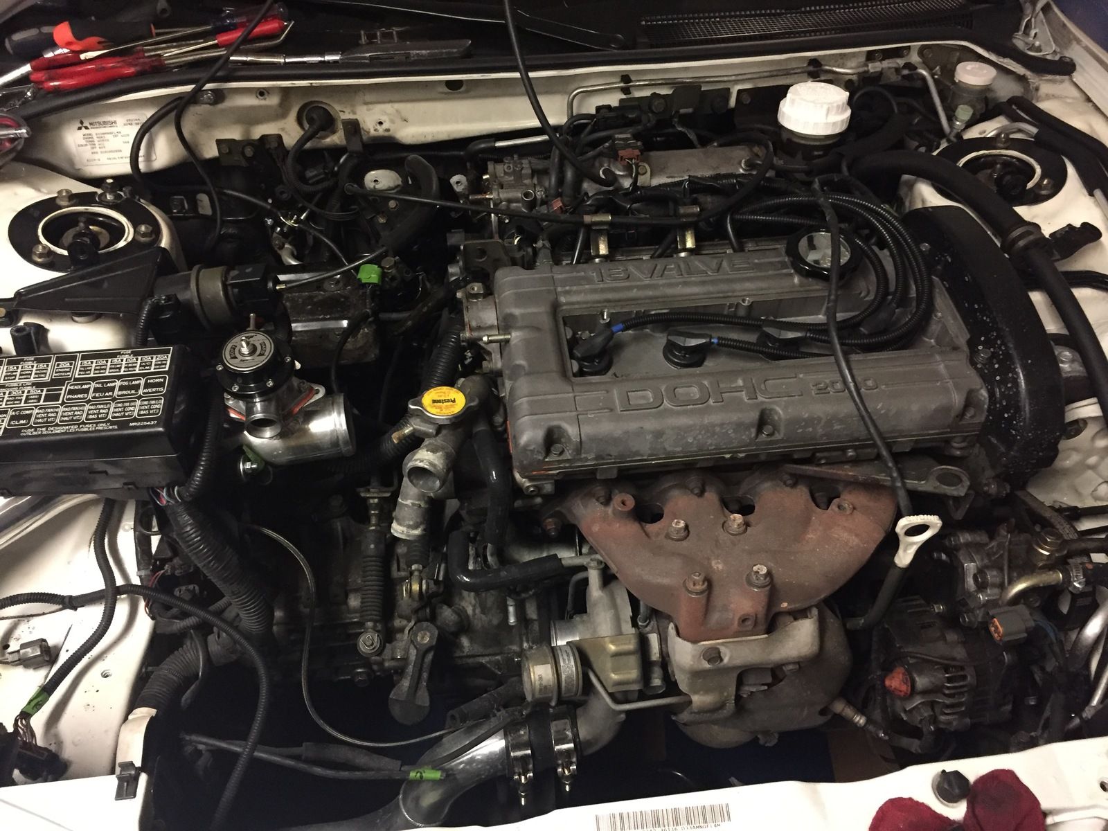

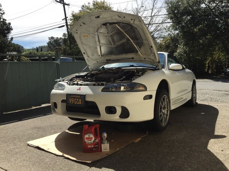

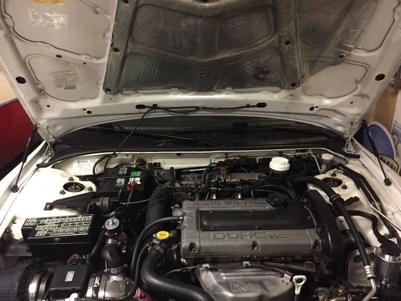

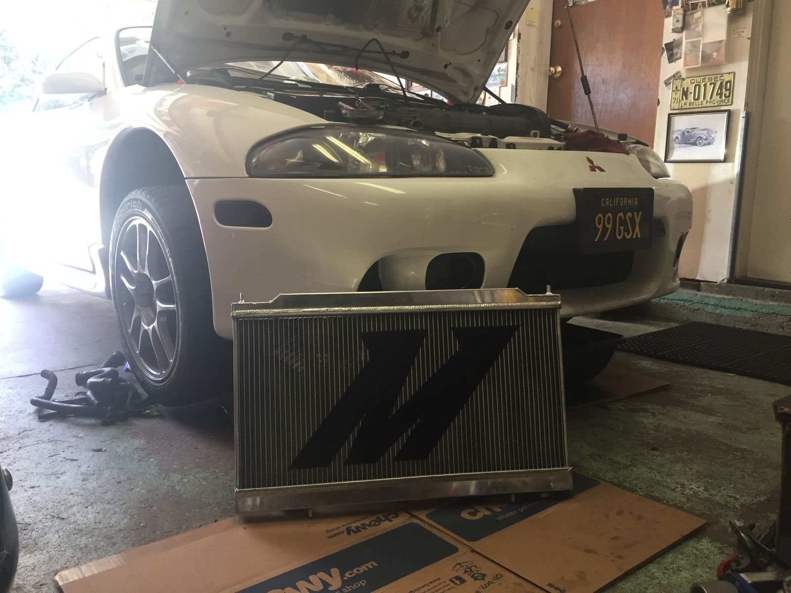

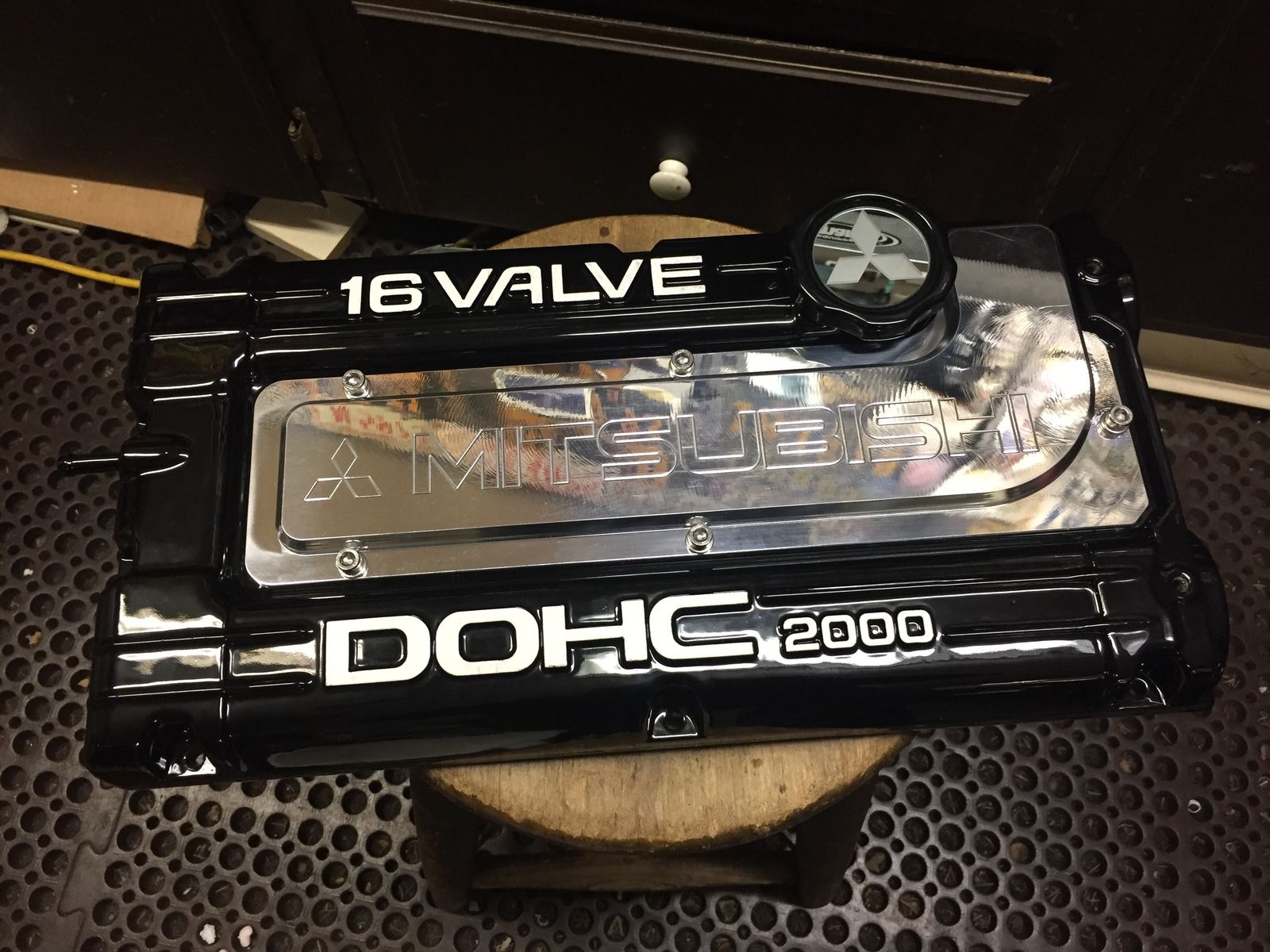

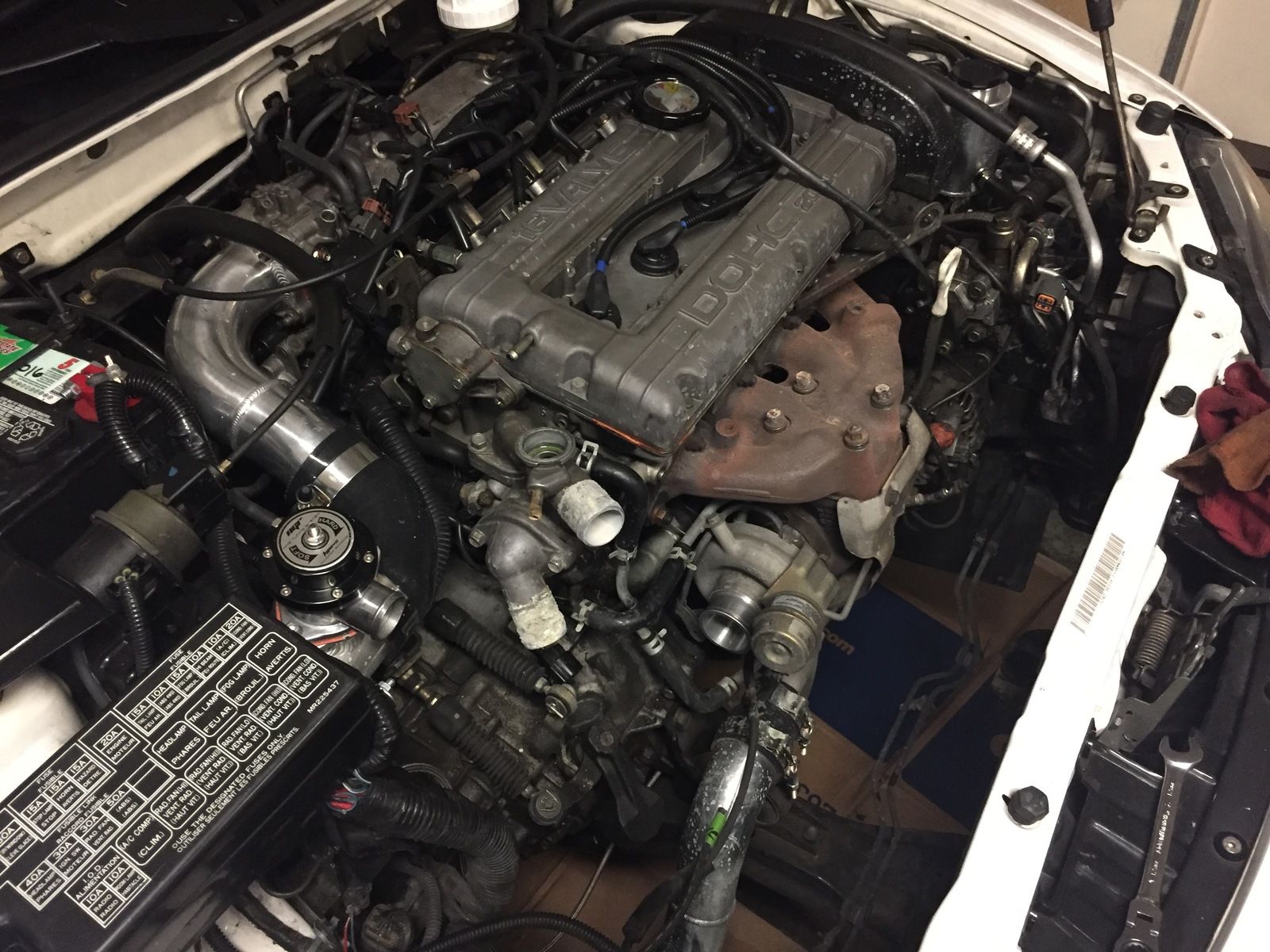

Here is a long overdue update! This will be covering everything since I last updated this thread. First off, I got the center taillight paint-matched and also bought some Euro/EDM folding side mirrors which had to be painted. I then had a pretty bad scare with the car. I was driving on the freeway when I started to smell and see smoke from under the hood. The car began to overheat and I pulled over right away. The upper hose broke off the radiator inlet and was shooting coolant all over the exhaust. I lost most of my coolant and had the car towed home. I did a few tests (compression, ect.) as I was nervous that the head gasket may have blown. All seems good. So I did an oil change, and replaced the radiator with the Mishimoto aluminum one with slim fans and shroud. I also got Mishimoto silicone hoses and an eBay silicone hose kit to replace all the coolant lines. I then got an extra valve cover powder-coated, Zaklee clear cam gear cover, front strut bar, polished spark plug cover, oil cap and hard intercooler piping to clean things up a bit under the hood. I then wanted to free up the exhaust a bit more so I got a Megan Racing V2 downpipe and welded a 3" high-flow cat on it to stay somewhat "clean" haha! And most recently I got my EVO 9 wheels powder-coated black, new Goodyear Eagle F1 Asymmetric All-Season tires (235/45/17), Power Stop Z26 drilled/slotted rotors all around and painted my calipers red. It'll have to do until I do the Brembo upgrade...
