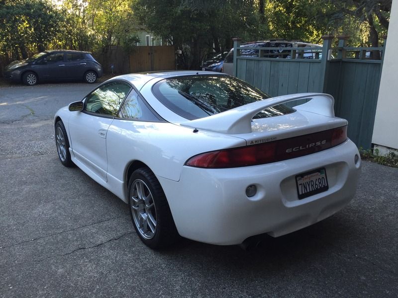

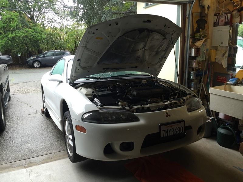

Hey DSMtuners!

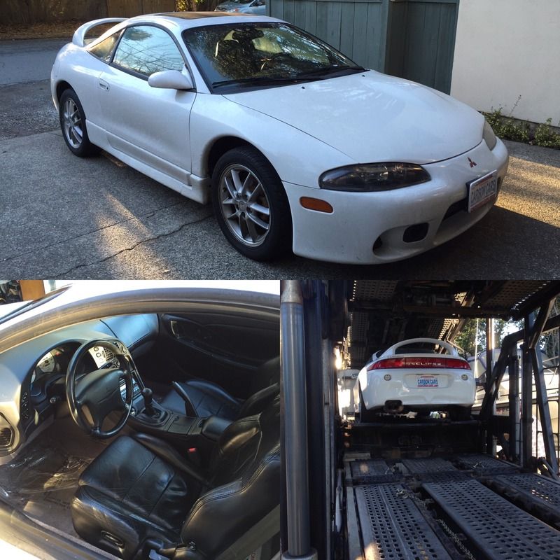

My name is Eric and I am somewhat new here. I've been lurking the forum for quite some time but never owned a DSM until this past December (2015). I was in the search for a white 99 GSX for about 4 years and finally bought one. I live in California and purchased the car from Washington. What sold me on this car is that it is 100% stock!! Seriously rare for a 2G, as you guys know. Mileage is a bit on the high side at 168,000 but seems to be very well taken care of. Not too worried though as I do have mild plans for it in the future. As of right now, I'm enjoying driving it as it is. I do want to do a EVO III 16G in the future and supporting mods but being in California may limit it a bit but then again there is always a way around SMOG ect. :D

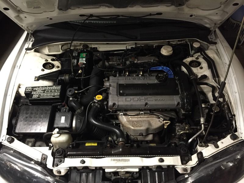

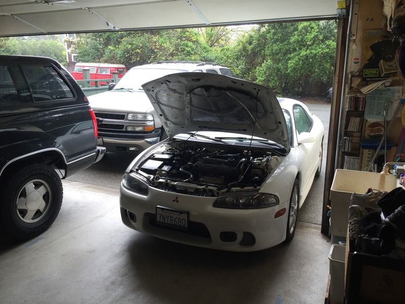

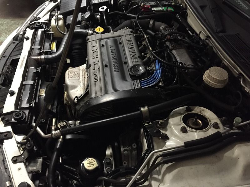

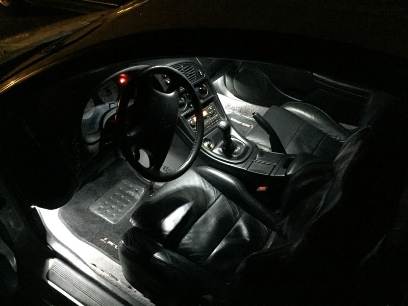

First things first was maintenance. Oil change, spark plugs, wires, PCV valve, valve cover gasket, fuel filter, and new battery. I want to definitely address the other fluids and timing belt soon. I've always been a fan of LED's so I changed the interior lighting to white and the license plates also got white LED's. I will try and update this as much as possible but it may be somewhat of a slow build, so bare with me!

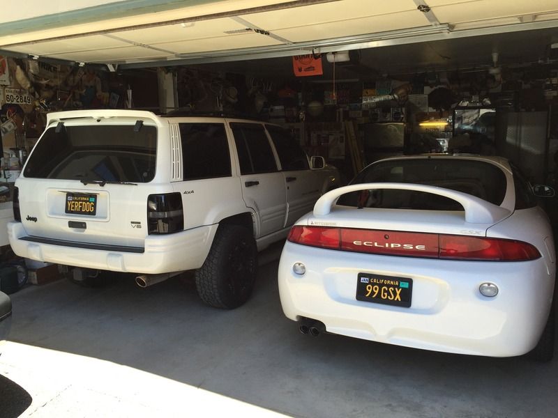

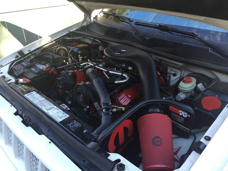

Also thought I'd show you my other ride. A 1998 Jeep Grand Cherokee 5.9 Limited!
http://thespeedfreaks.net/showthread.php?6669-YERFDOG-s-White-5-9-D

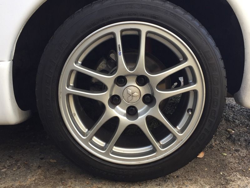

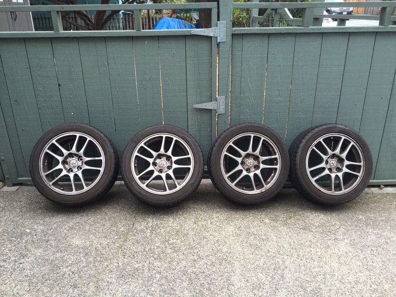

The front tires on the car are bald on the inside edge so it is needing an alignment ASAP. The front right rim is bent and I have read that this is fairly common so I was looking elsewhere for rims/tires as I did not want to purchase new tires for the stock wheels. I bought myself a set of EVO 9 Enkeis with nice meaty BFGoodrich tires for an awesome deal!! I have yet to put them on the car but will update once I do. It will be getting an alignment when they go on though :). I am also not exactly sure, but I'm thinking of getting them powder coated black...
UPDATE 3/20/2016

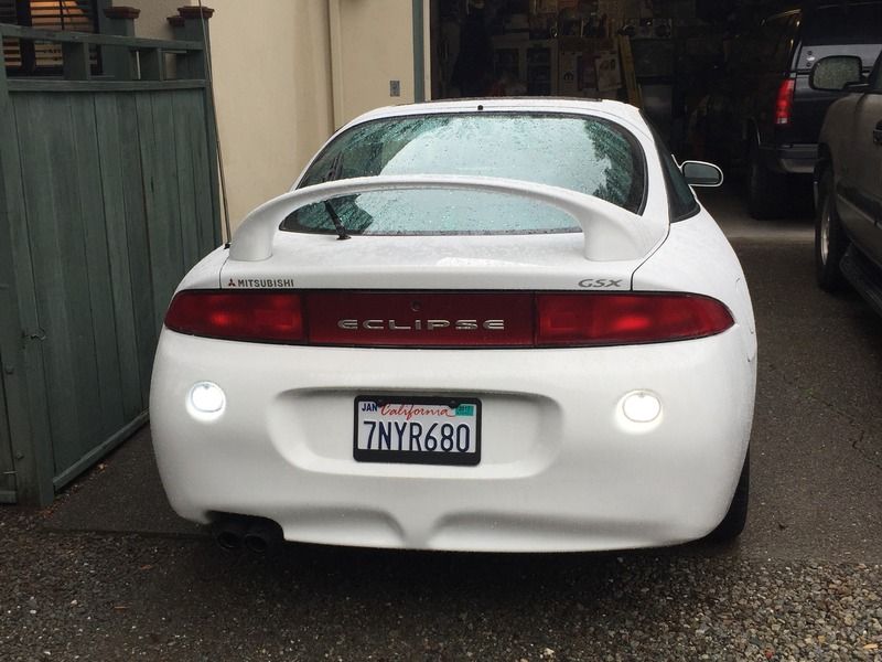

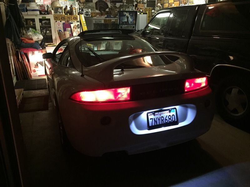

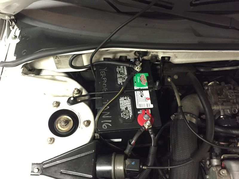

Did a couple small things to the Eclipse in the last couple weeks but not much. The battery terminals had some poor connections and were even causing my lights to flicker while idling. I got some new wing-nut style ones and crimped some heavy duty ring terminals on the wiring and put heat shrink tubing to make it look nice. Even added some felt battery post insulators for a nice touch :cool:. My downpipe was missing one of the nuts so I replaced both to fix a small exhaust leak. The EVO 9 Enkeis will be going on soon as I did just receive new lugs and locks for them. Now time for pictures...:thumb:

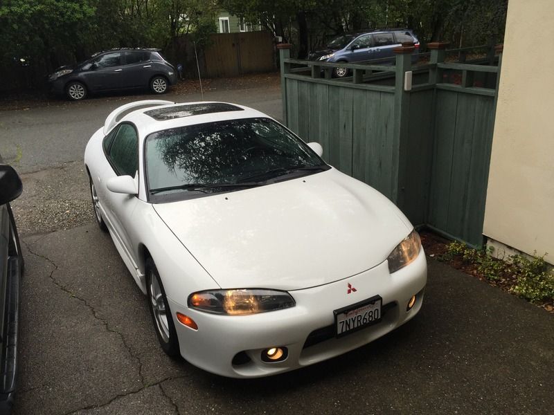

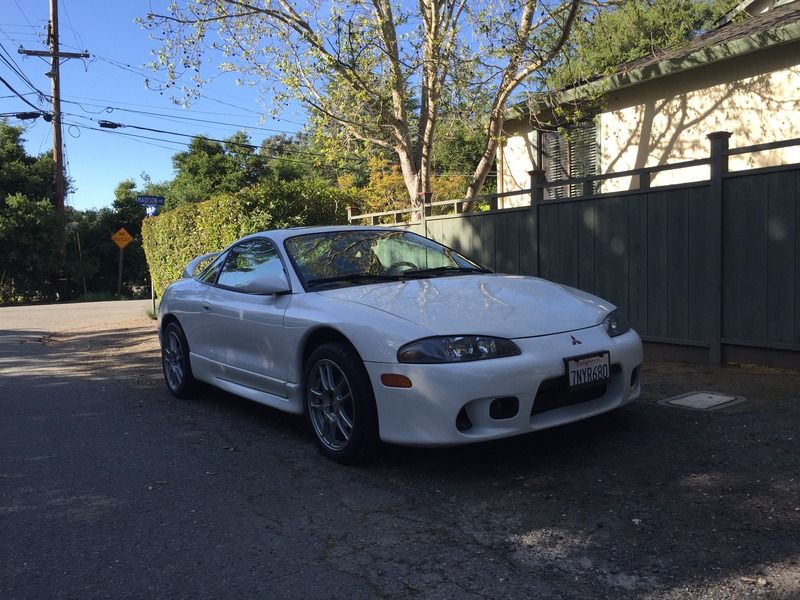

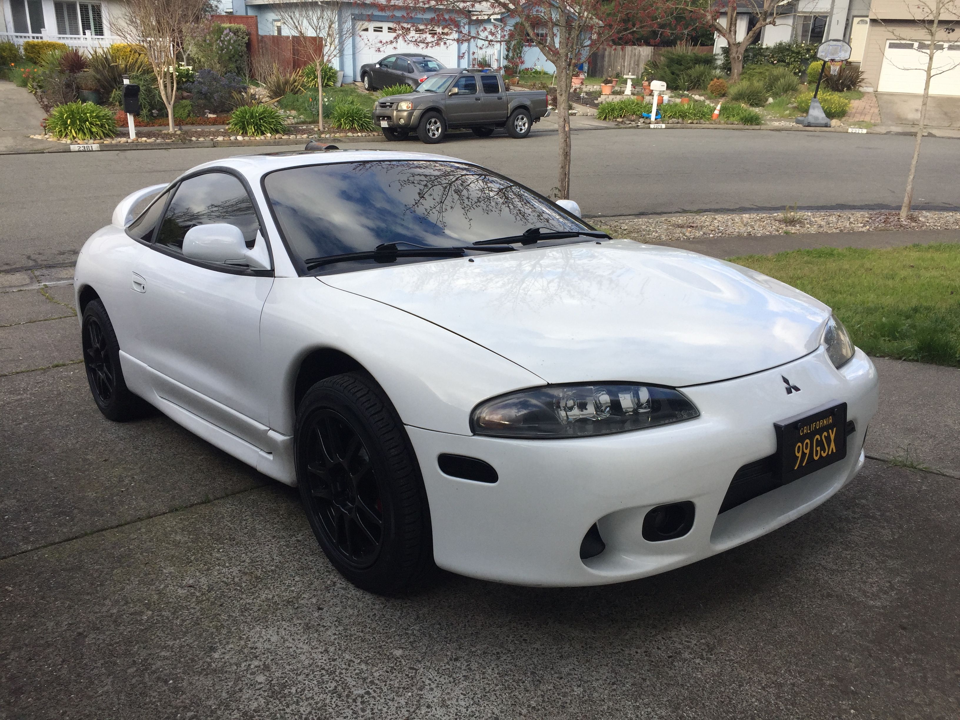

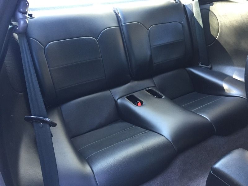

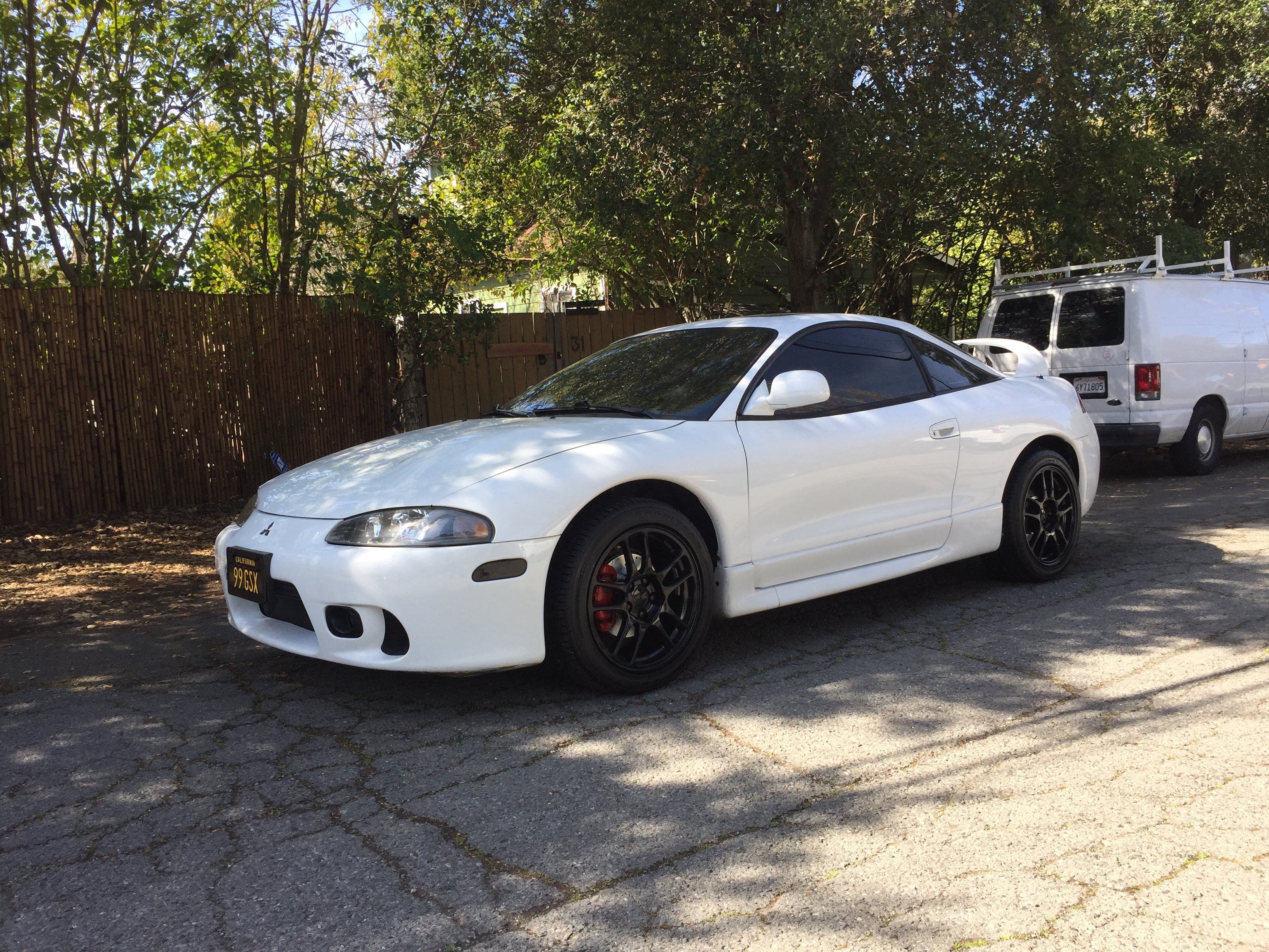

I got the EVO 9 Enkeis I picked up awhile ago mounted, balanced and aligned at the old shop I used to work at. I really like how they look, BUT now the car is in desperate need of a drop haha!! I planned to drop the car anyway, but might be sooner than I thought. Tire size is 235/45/17 and they are BFGoodrich! Anyway, I snapped a lot of pictures. Also have some random shots of the interior :D
UPDATE 4/18/2016

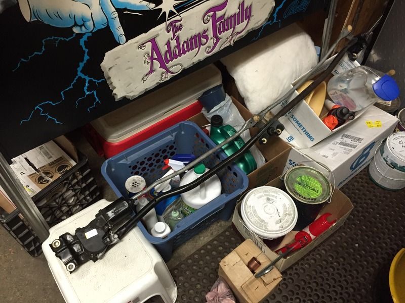

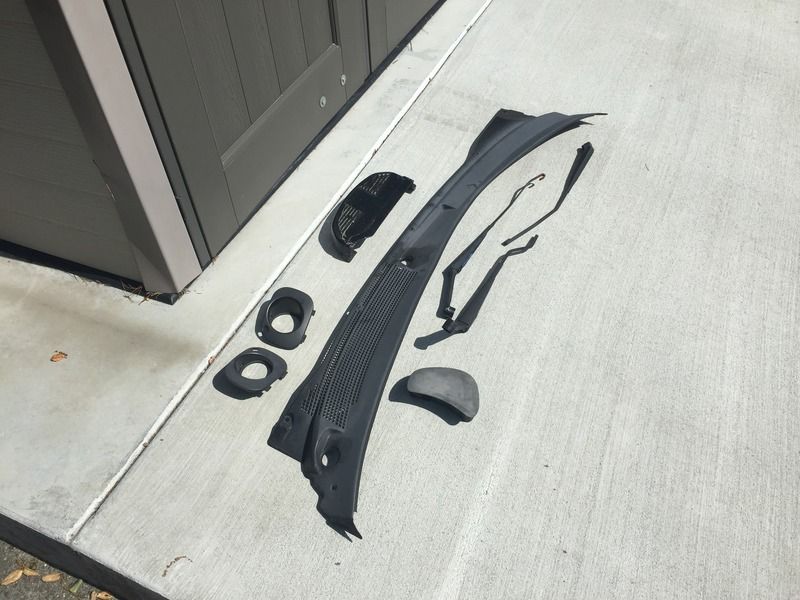

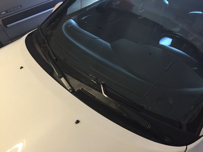

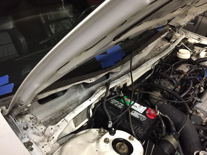

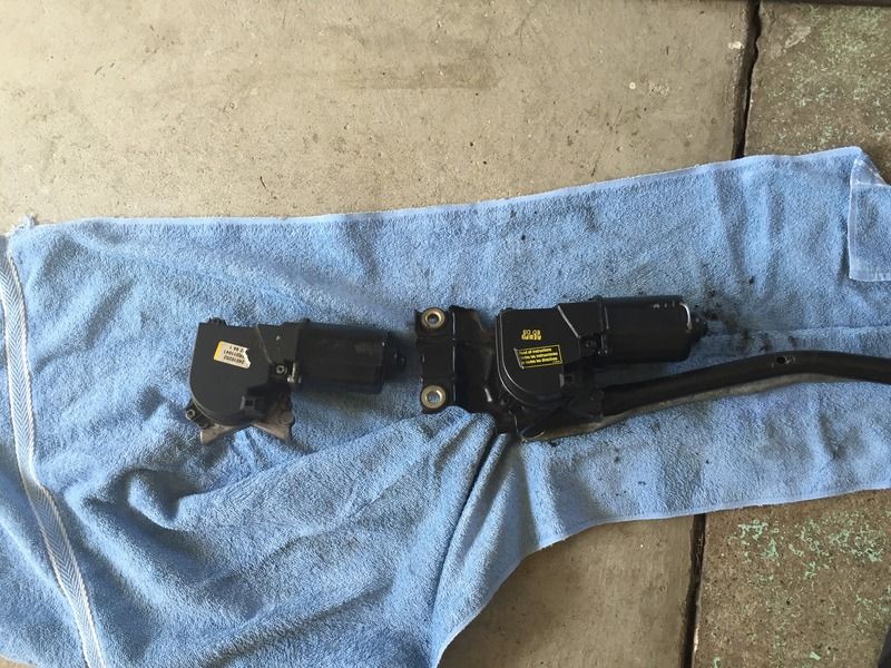

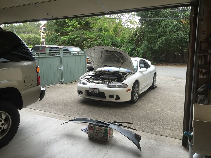

I had to replace my wiper motor because they would not "park" after turning them off. That is now fixed :thumb:. While having the cowl off, I decided to re-paint it black and I also did the wiper arms, cam gear cover, fog light bezels, and drivers side lower front bumper bezel. Some of the cowl clips broke so I got all new cowl clips and decided to get some other new OEM parts. Oil dipstick, oil cap, brake fluid cap, clutch reservoir cap, interior fuse box cover (mine was missing), and an OEM oil filter to hopefully help the lifter tick (it did not :cry:). I've always liked blind spot mirrors so I threw some on. Also, I am LOOKING for a nice condition under-hood insulation if anybody has one?!? AND the 3rd brake light assembly for the rear window since the previous owner deleted it. Other than that nothing else has been done, I'm just enjoying it as it is right now.
UPDATE 4/23/2016

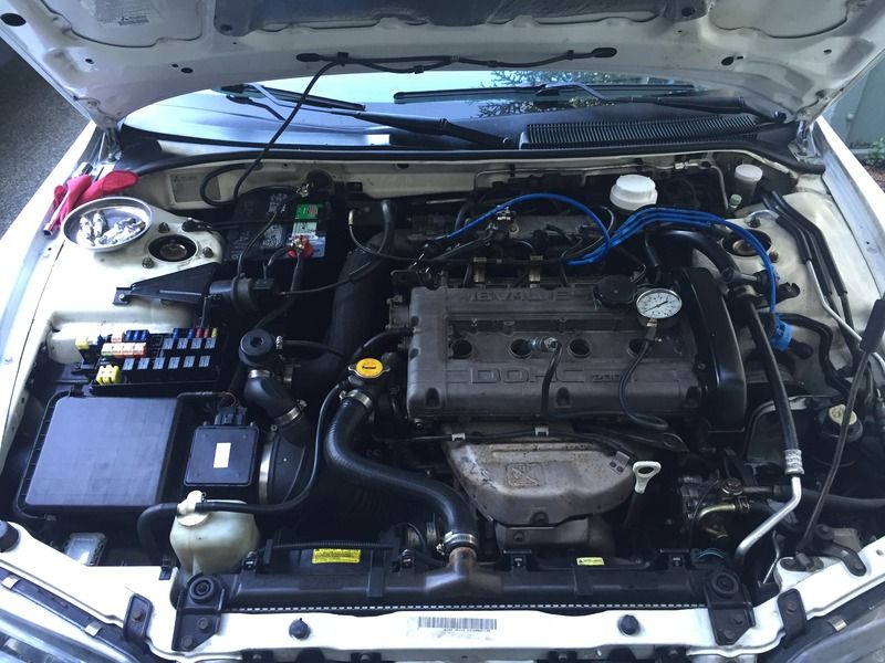

I finally got around to doing a compression test. The motor is original and is about to hit 168,000 miles! I am happy with the results. The test was done after driving for about a half hour on the freeway.
Test Results (Dry)
Cylinder 1: 170
Cylinder 2: 165
Cylinder 3: 160
Cylinder 4: 165

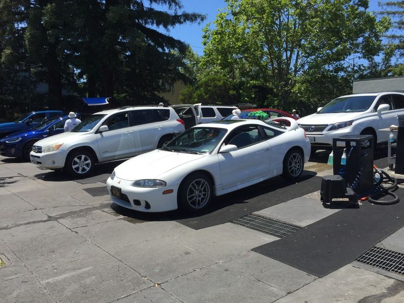

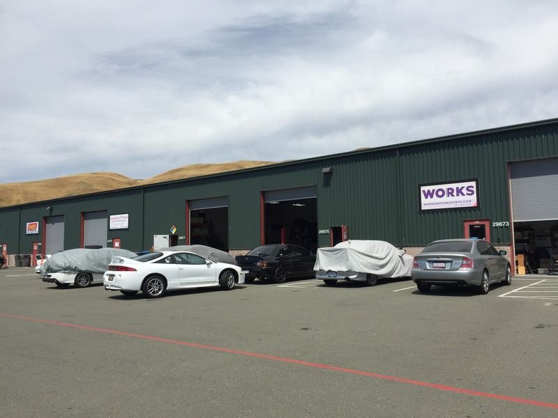

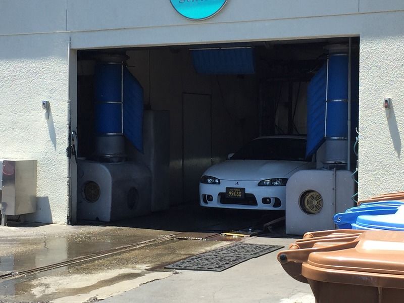

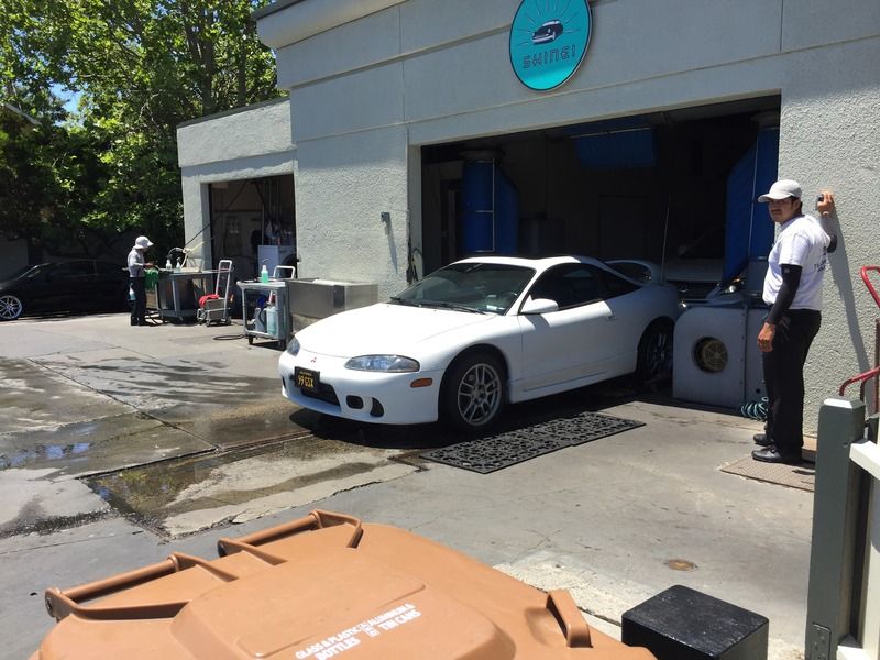

So tomorrow (6/10/16) I will be dropping the car off at WORKS Motorsports (Sonoma Raceway) to get the timing belt job done. As much as I'd like to do it myself, I don't have the time for it. I will be changing the rear differential, transfer case and transmission fluids with Redline once it comes back from the shop. I had a free brushless car-wash coupon so I took advantage of that and snapped some pics. I like having my cars nice and clean when it heads to a shop. I feel they take better care of it ROFL.
Dropped the car off this morning. I think it'll be in good hands...;)
