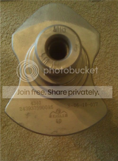

100mm eagle crank

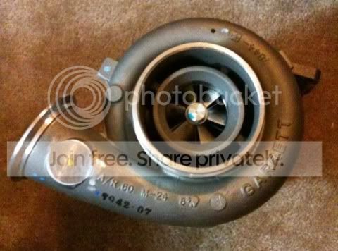

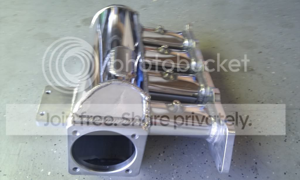

Also, I picked up a few new parts... JMFab Drag SMIM, ID-2200 injectors, a garrett GT4294, NX direct port setup, and a nice new AEM EMS to make sure everything runs smoothly.

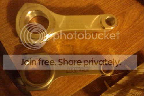

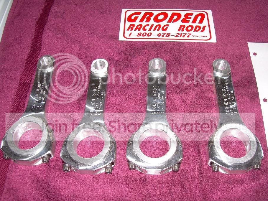

Groden rod beside a Manley H-beam
JMFab Drag manifold
Eagle Crank
New turbo

Actually don't like the Grodens. I got a set from Euroexport and their really legit. We had some issues with the grodens. If you look at where the bolt comes through on the grodens, it goes past the threads and we had issues with it messing up there. The Euroexport have about 4 threads more so you can torque them down better and they won't back out or any of that BS. Just my 2 cents.

hell yeah finnaly some one uses those grodens! i would use those on my daily driver if i had the money. dont belive all those people who hate on aluminum rods.

No you wouldn't use them on a dd. You shouldn't use aluminum rods for really anything other them a track car.
some peoples kids i tell ya!!! ya buy parts u know are good and some guy has to piss on your new parts party. then some other guy jumps in and says hey i'd........ just to try to fit in but only making an a** of himself. LOFL!!!! nice build expectations by the way!!!! hope she is bullet proof and pulls like an ox when your done!!! good luck and God bless that stroker!!!! if i ever rebuild again im goin stroker too buy n my 420a!!!!
Nice build! A note about the aluminum rods: I believe twicks69 on this forum ran the aluminum in his 700awhp dd for quite some time. There are more and more dds popping up with these rods all the time. I am using them in my 2.4l long rod build but they are from magnus.
