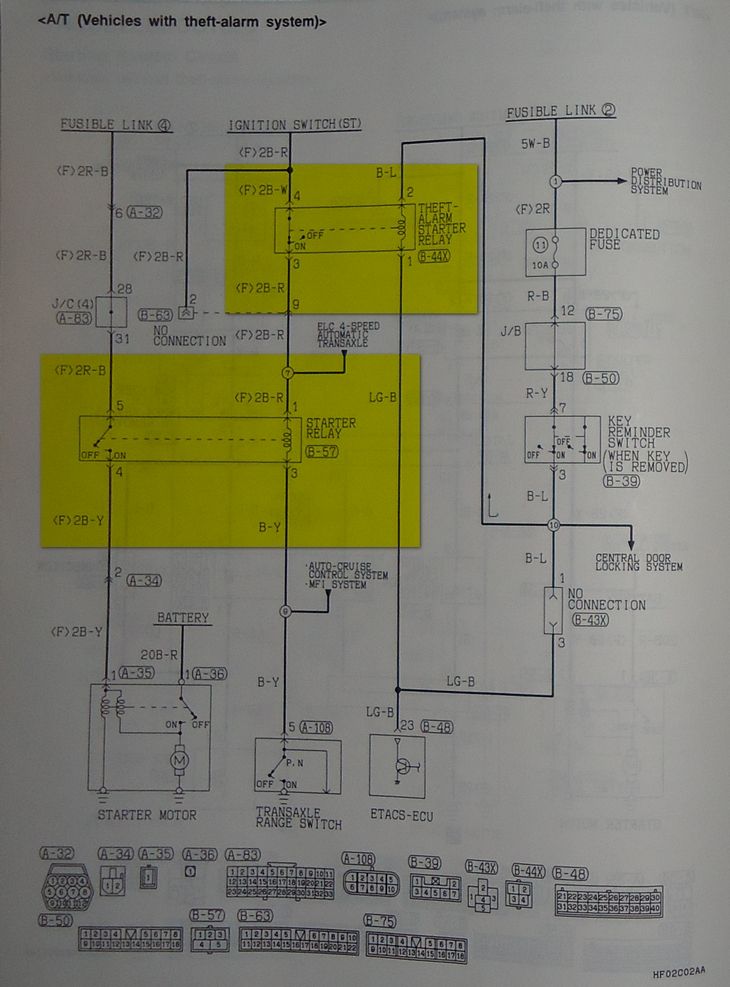

going off this diagram, power comes from the ignition switch to the theft alarm relay. the ETACS activates the relay by grounding the trigger side of the relay.
that allows power to flow to the trigger side of the starter relay. the transaxle range switch provides the path to ground for the trigger side of the starter relay when in park or neutral.
so if you ground the thin black/yellow wire and it still doesn't start with the key, the problem is probably the theft alarm relay isn't activating which could mean you need to replace the ETACS

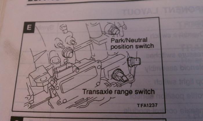

well the 95 is has its own setup compared to later models and after doing a little research i found that the 95 have a separate neutral safety switch. It should have a 3 wire. plug. The wire colors are red/blue dashes, black/blue stripe, and black/yellow stripe. The (black/yellow) wire is the one connected to your relay. The neutral safety switch also operates the reverse lights.
imag0205-jpg.127018
I don't f*** with automatics and don't have a 95 service manual so i can't tell you anything about how the neutral safety switch or the range switch operate or how to check them. all i can tell you is your neutral safety switch isn't operating correctly or you have an open circuit (broken wire) between the NS switch and the starter relay.
according to DarkOne who runs 2gnt.com and knows everything possible about 420a equipped talons/eclipses:
so there is a good chance that the range switch and possibly the input and output speed sensors are fuct.
the neutral safety switch (part# 4671017) has been discontinued by chrysler so the only place your gonna be able to get a factory replacement is probably ebay. https://www.ebay.com/p/83559224
--or you can get one at napa (part# ECH NS6489). If you get one from napa i would take in the old one and make sure it matches up with the new one.
https://www.napaonline.com/en/p/ECHNS6489
the range switch (part# 4671019) should still be available from chrysler and dodge dealerships or ebay. https://www.ebay.com/itm/Genuine-Mopar-Switch-Prnodl-4671019/303326130486
--napa (part# ECH NS6836). its cheaper to get them from the ebay link i just posted but if you go thru napa or any local parts store your gonna wanna match up the old one an new one.
