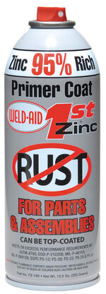

The factory one was spot welded in place. I don't have a spot welder so I MIG welded mine. I used an air powered hammer/chisel to break apart the spot welds. You can also use a spot weld cutter/drill. Once the old core was off I used a grinder to smooth out the old spot welds. Then with all the rust gone and the bare metal exposed I used a ZINC coating on any exposed metal. This will help the metal resist further oxidization. Then you can apply an epoxy primer and paint the spots that are NOT going to be welded. Leaving the spots that need to be welded, bare metal.
Set the New core in place and begin to weld. Once it is fully welded in place, grind the welds smooth and Zinc coat them as well. Prime and paint, then reassemble the car.
These don't need a TON of welding. They were only spot welded on originally. So don't go nuts on the weld haha. I see some people putting 3/4 inch thick welds on sheet metal and I'm like WTF?

A word of caution on the zinc primers when used as a weld thru primer. The fumes/smoke from welding are very toxic and the zinc can affect weld quality. I used it on the backside of my sons front strut tower before welding because it would be inaccessable after it was welded. I posted my weld quality concerns on the welding forum and was then alerted to the toxic nature of the fumes/smoke.
