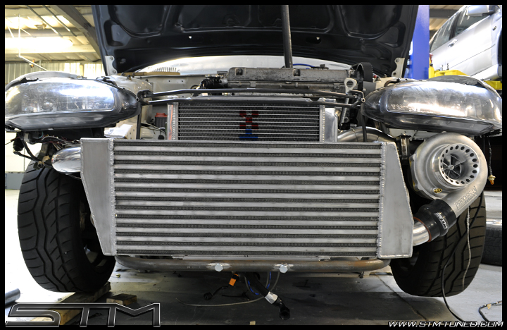

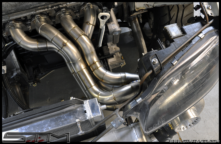

Quick RFI on the radiator setup: What size radiator is that - is it the same as the 1/2 sized radiators that we see on the market? What do you expect as far as its cooling capabilities and the fact that this is a street car that might make a trip in the hot summer?
I'll answer the best I can here, guys. I generally just take pictures. :)
Until we have an entire machine shop in our back room at our disposal, we aren't doing motors. Perfection is the name of the game. There are many things we can still grow into. Just takes time.

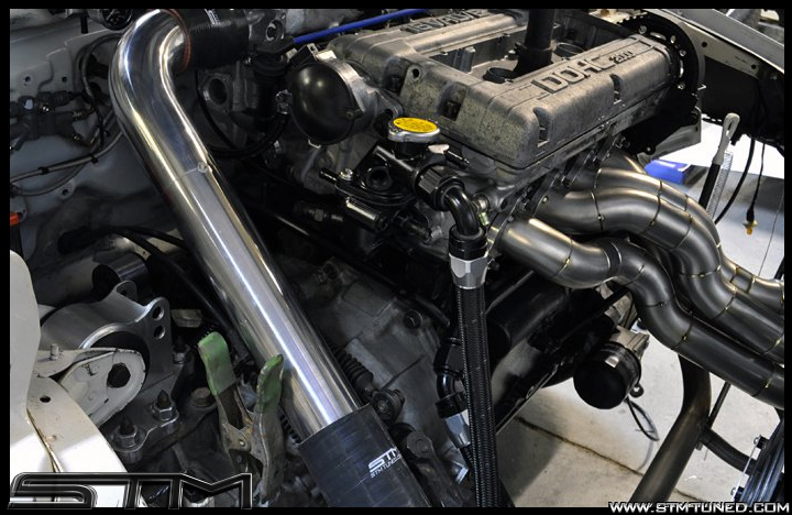

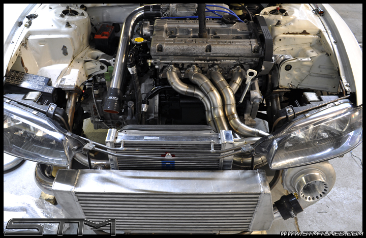

The Koyo is the half sized radiator, but we modify it to suit our needs. As far as the capabilities, we haven't had any issues with our cars or customer cars getting hot. Sure, it's smaller, but that also means less fluid to cool.

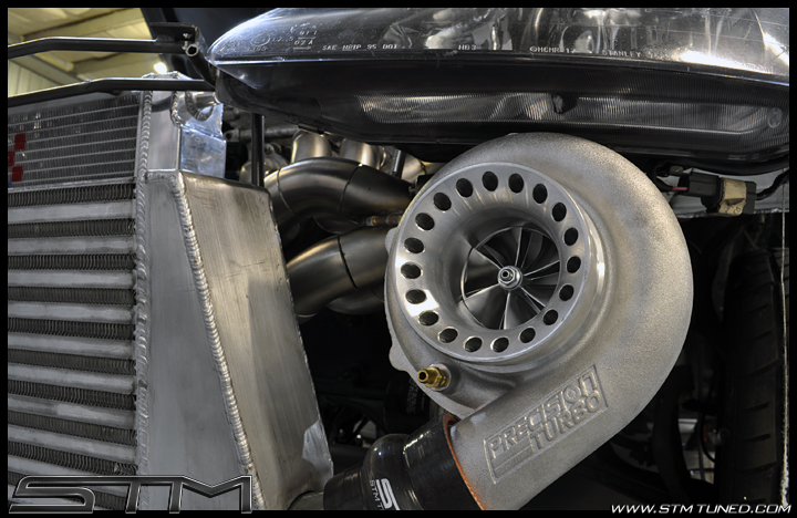

The turbo is a PTE6262 and we went with the 4 bolt... because it was available. We don't have time to wait around.
Tomorrow we should see some welds in place, but it's coming along nicely!

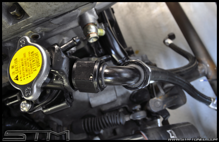

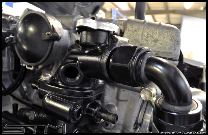

Great work STM the car looks great so far:thumb:. One suggestion, I would have used -16 on the radiator lines and fittings, -16 male fittings matches perfect with the water neck and water pipe.

Are you guys planning on running the car on the streets without a filter for the turbo intake? It looks better without one, but get behind that one truck that drops a rock that bounces right into the turbo and :ohdamn:
