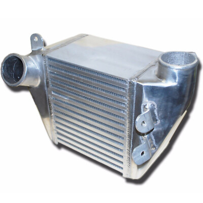

I just bought a Dejon big SMIC, was going to put it on yesterday, but couldn't find any way the brackets would line up to bolt it on. I can't even get the bracket to meet the frame while allowing the inlet/outlet to be in good position.
Am I missing something? Does anyone have a pic of either their Dejon or even a stock IC mounted up on a 2G? I'd like to get this figured out so I can use my new parts.
Well, damn. I guess I'll just see if I can make up a bracket to mount it. That's annoying. Unless someone can direct me to a larger side mount that actually bolts up...

Well, I'm guessing it is for a 1G as I couldn't get it to fit right for anything. Maybe if i cut sheet metal above it for the outlet, but I don't want to do that. The biggest problem was when I connected the outlet, the intercooler sits out too far and the bumper won't fit back on. Very disappointing.
Well, I made it work. I had to cut a fair bit of sheet metal from above the IC then make a few brackets to help mount it as with one bolt lined up, none of the others did. Seems to work well enough. Still want to make a scoop for it, which should help improve its efficiency. Throttle response and low end are improved given there is less piping volume to pressurize. Lastly, and possibly most importantly, I was able to clear up the central bumper duct so the airflow goes straight to the AC condensor and radiator (and my auto trans cooler), which helps my car run cooler in this 90-100 degree weather, where previously my temp gauge was creeping up with the front mount.

I know I'm a bit late but, this is the 1g Dejon Big SMIC
I believe the one you have is an Alamo 1g aftermarket SMIC or possibly the really old Dejon 1g smic that was made out of two 1g OEM cores like this one (old 1g cores together).
