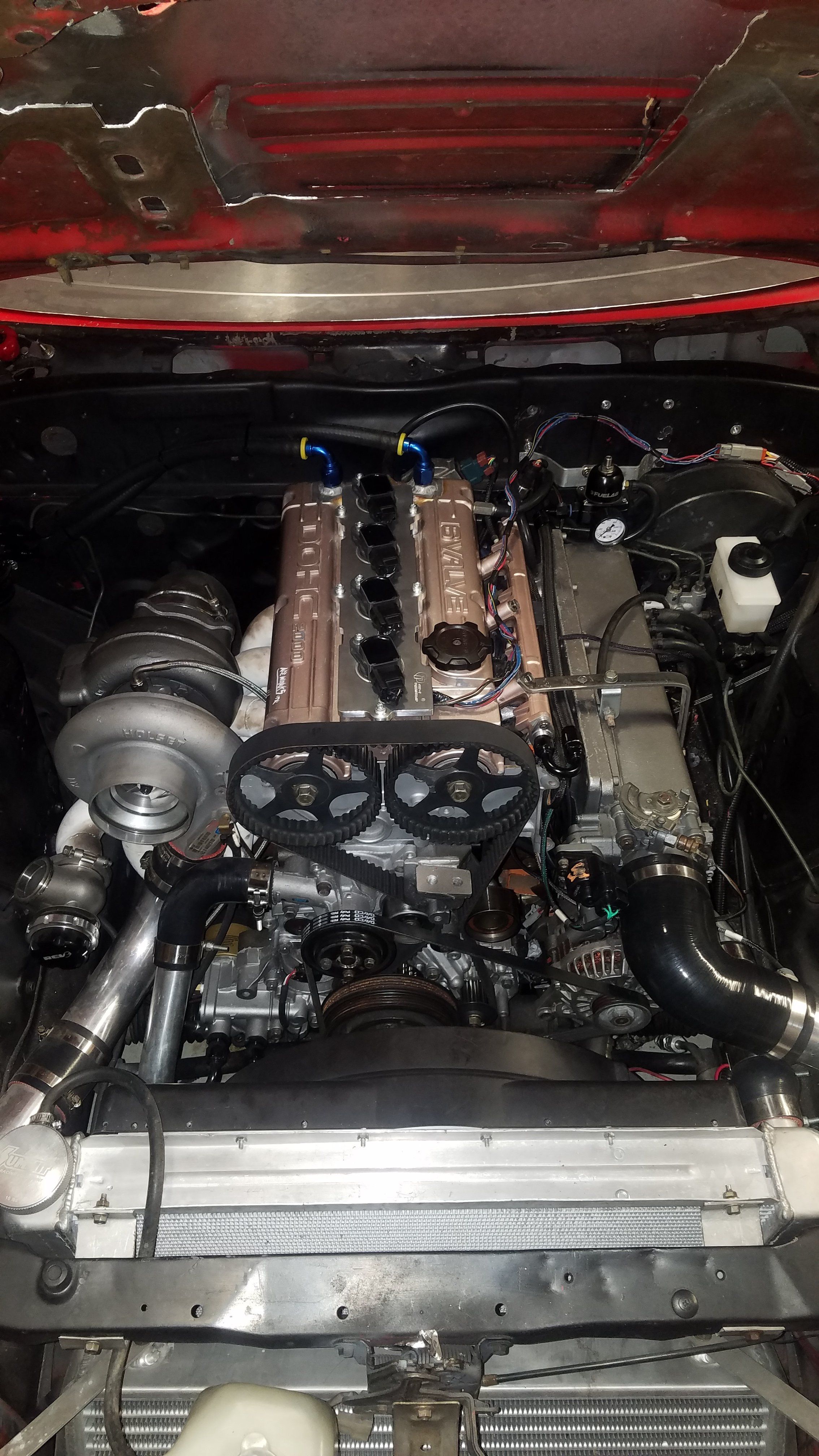

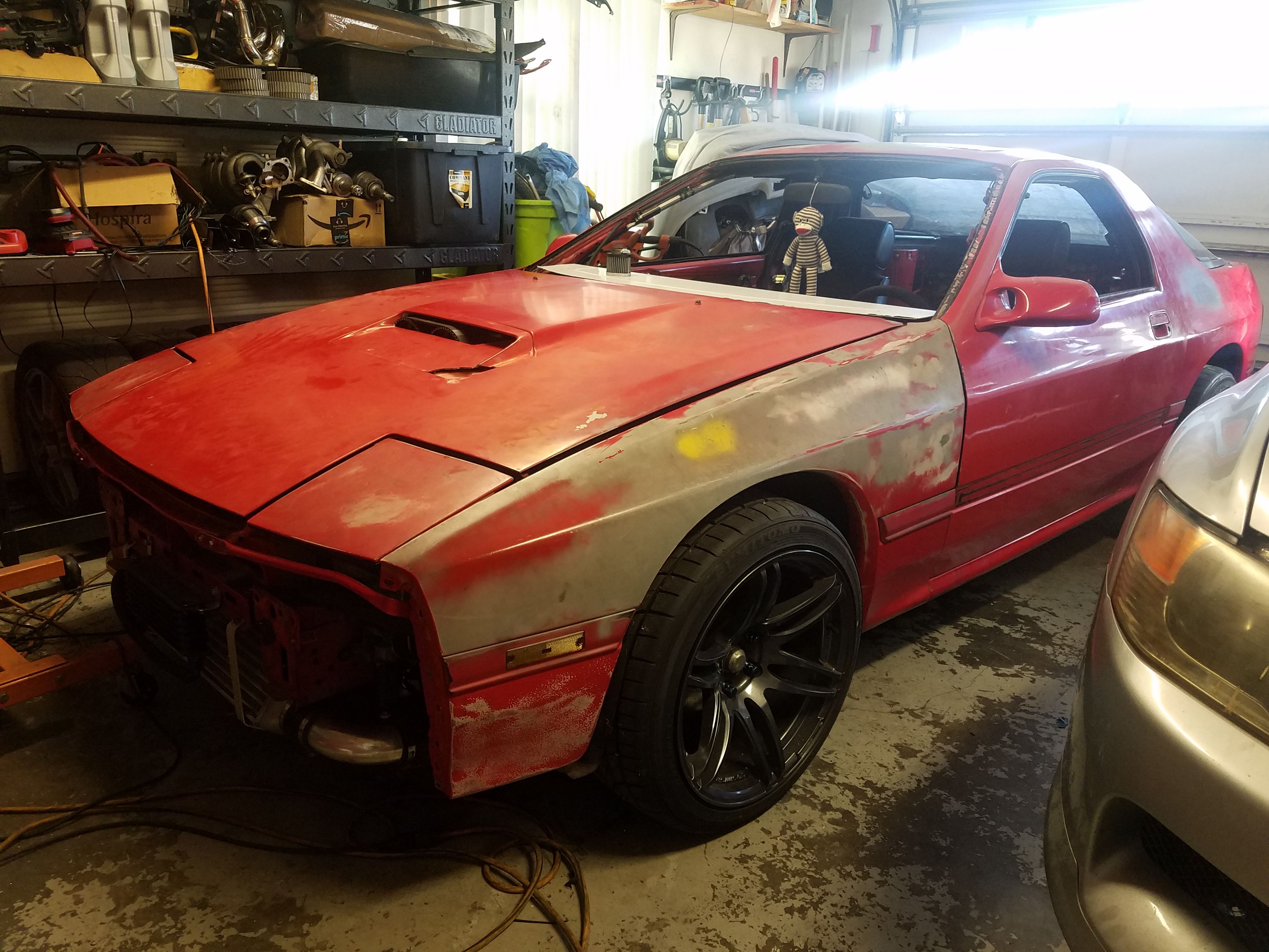

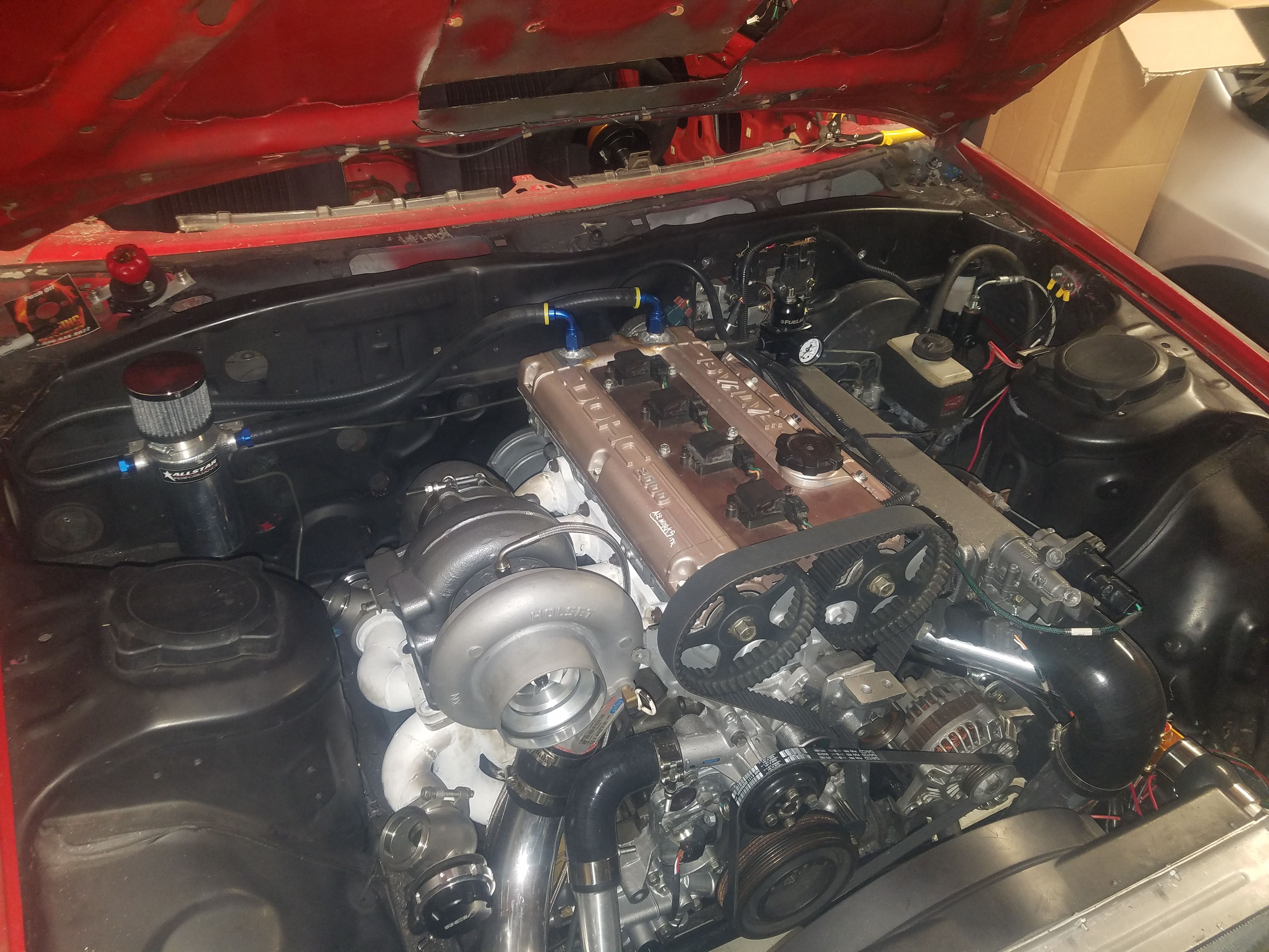

Been working on the rx7 but havent been posting. Fb/Insta got more of my attention but think I may move away from that.
Anyways here are a few pics of what ive been up too.

Two years later :)....

Updated pic attached.
Issue was with the type of sensor I was using for the tps.
I had to use the one for a 3g eclipse 8gGalamt, etc....
