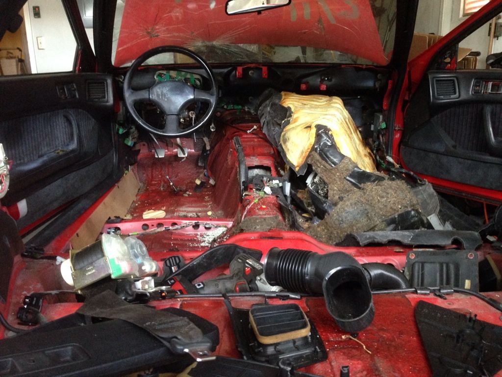

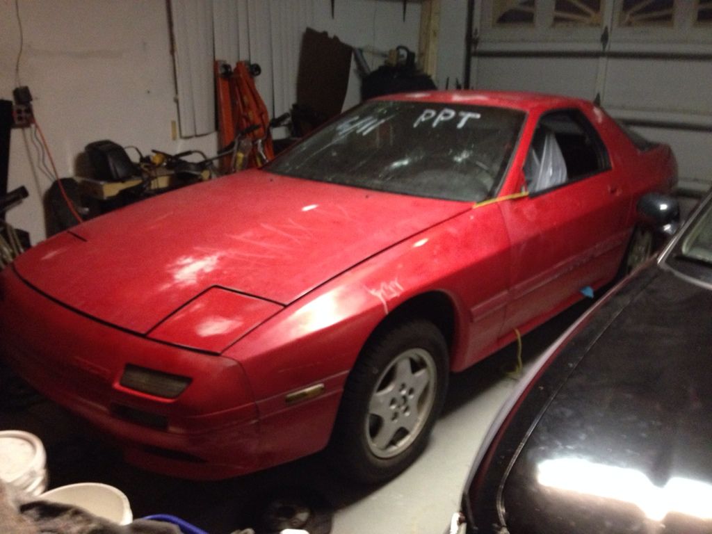

I've been really interested in the local drift scene and after spectating a few events I wanted to join in but couldn't justify the price/drift tax thats attached to the 240's in my area. A friend of mine was also interested in drifting and picked up a Base FC which sparked my interest in the platform. After some research on swaps and casually checking craigslist, I found one up for sale for $400.00 bux and couldn't resist the urge.
A 91 Rx7 fc, not sure of the model but came with an auto transmission and automatic seat belts.
Here is how I got it…

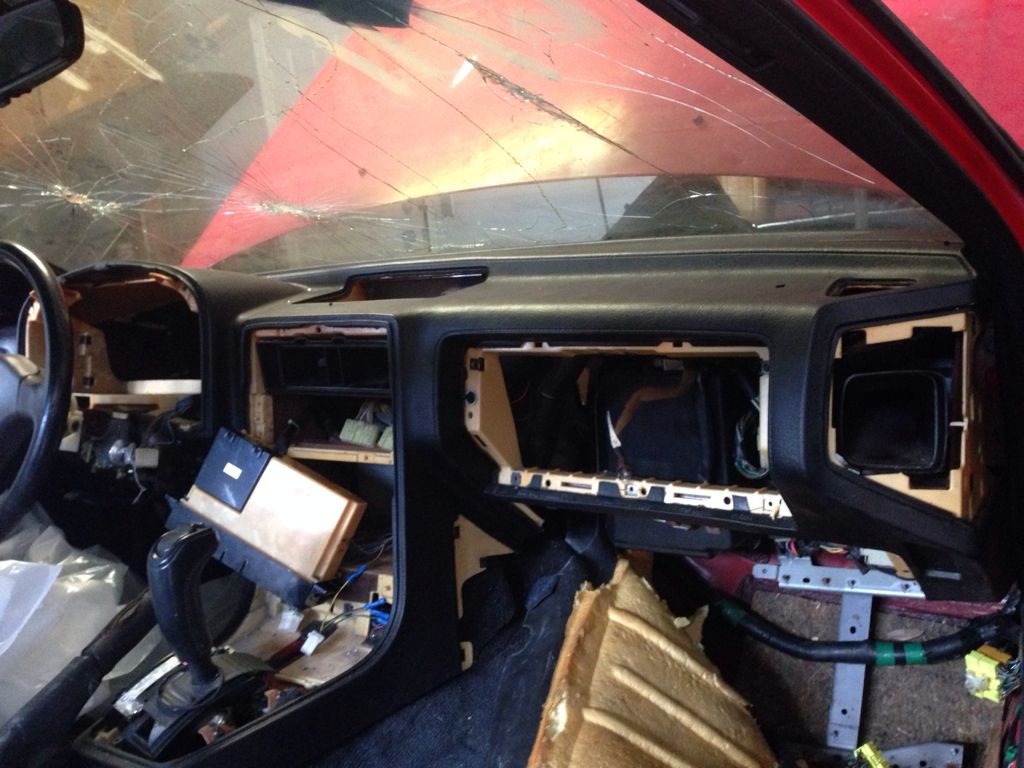

The interior wasn't too bad but it was missing the speedometer and nearly everything else in the dash/window switches/etc.
So I figured its best suited as a track only car.
Halfway through removing some things not needed.

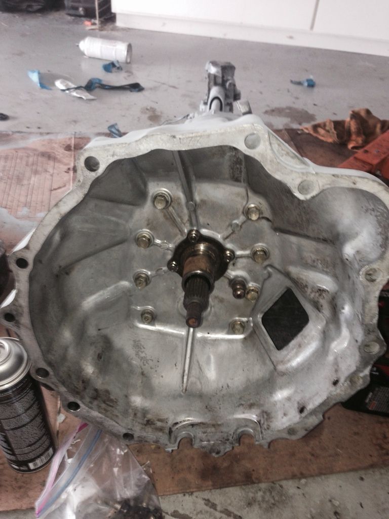

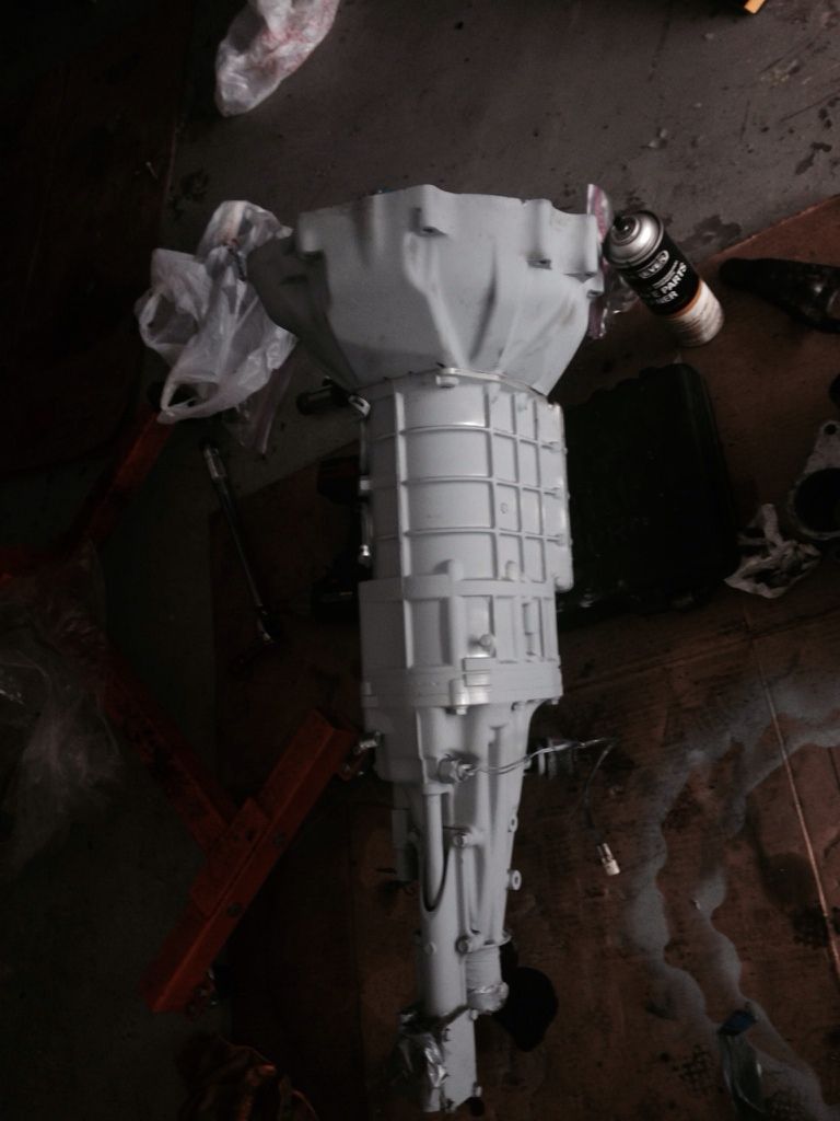

I grabbed a wide block 6bolt 4g64 from the local JY on black friday for half price and was able to source the Rx7 Turbo2 Model R Transmission and an 88' B2600 Bell housing that bolts up to the wide block for cheap. I know everyone drops LS motors in these but I'am unfamiliar with the platform and I had an extra 2g head lying around with several other 4g63 spare parts.
Model R trans with b2600 bellhousing attached

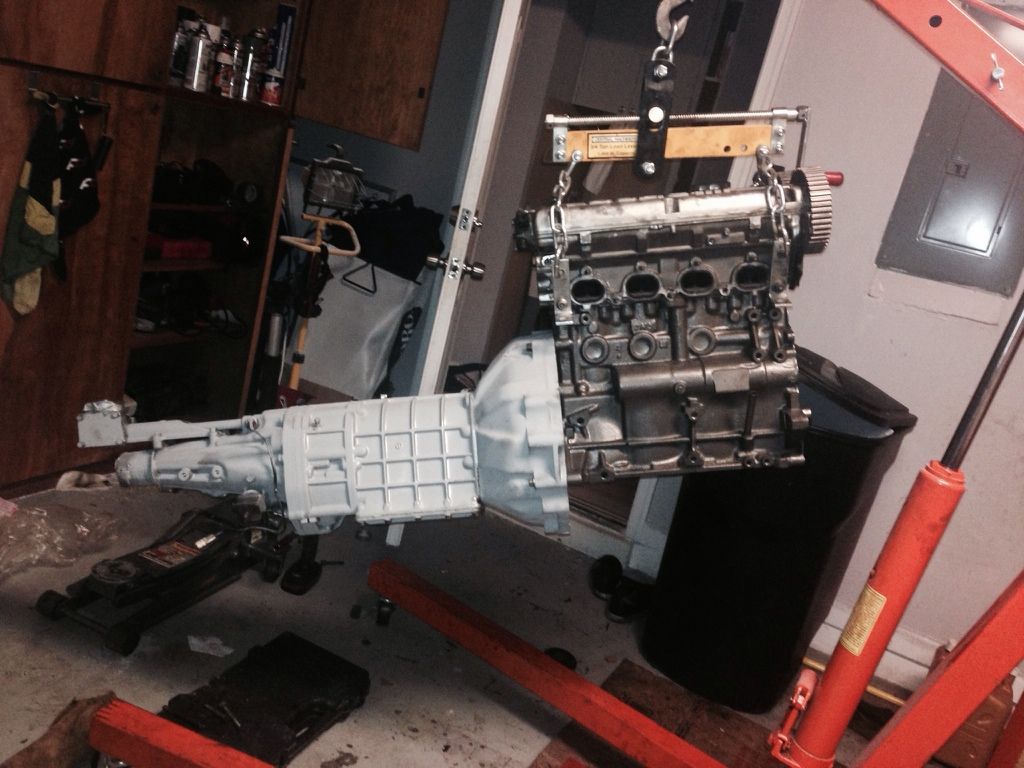

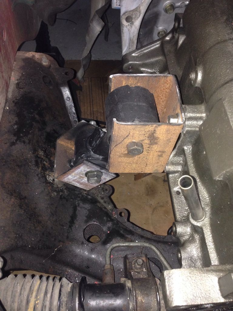

My first huge task was mounting the engine. I've never fabricated custom mounts although I've done an awd swap to a 7g Galant successfully.
So here is the engine being lowered in

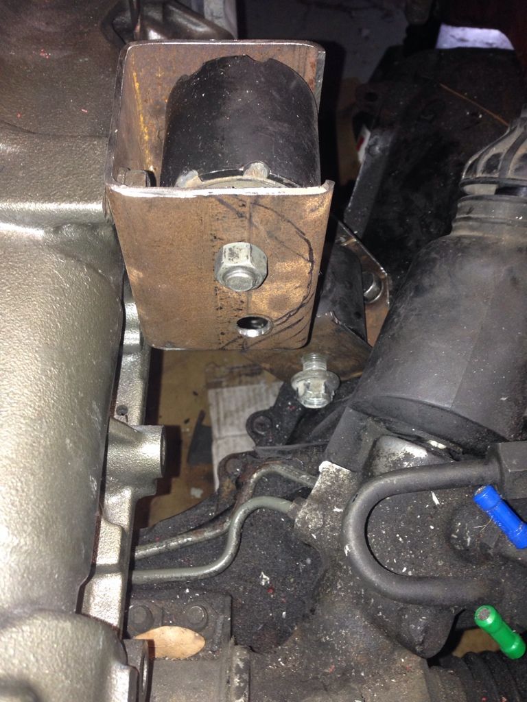

After some time I cam up with this.

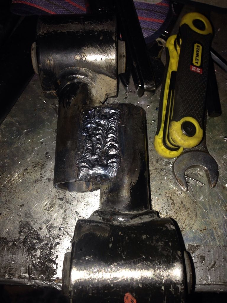

For the engine mounts, I got a 3 inch square steel 8th inch thick tube and picked up some trailing arms from a an older isuzu Passport in the JY. Cut em up and welded them the best I could with my HF 90amp arc welder LOL.

Let me know your thoughts or better way of doing some things if anything looks wrong in the pics. Thanks

I'm just a little curious about the mounts. I think if you inserted a "slug" into the end of the trailing arms, say a 4" piece, then welded them straight together it would look 10x nicer. You should also drill at least two holes on each end and rosette weld the slug in place. Just a suggestion if you'd want to make it look cleaner :)
Looks like it will be a sweet ride though!
Thanks for the pointers Breezio, Iam coming from a Information technology field and have gotten my ideas from the web and other cars I've seen, What do you mean by a "slug" If you could point me towards an example, I will more then likely make the change.

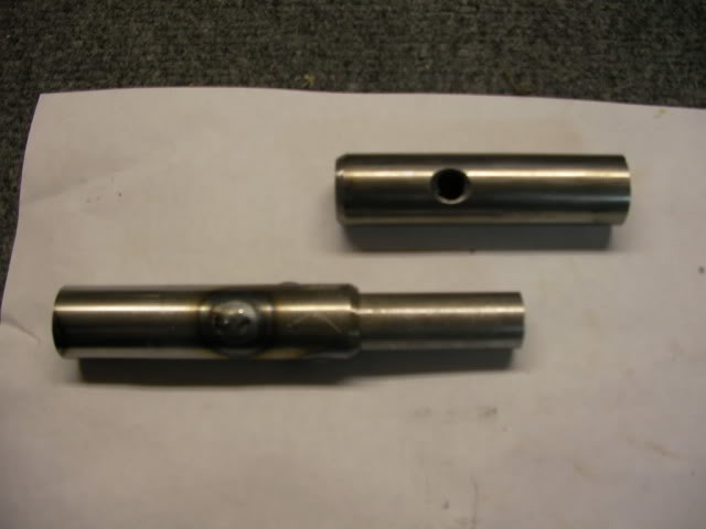

This photo in conjunction with a description should give you the idea.
You basically take your trailing arm and measure the inside diameter of the tubing. Then you match that up with the outside diameter of a smaller piece of metal (in your case 3-4" would sleeve the entire thing). You drill a couple of holes to "rosette" weld the slug in place on both pieces of your trailing arm. Then make sure you grind yourself a nice "valley" to fill with weld, which means just making 45º grind around the outside of your pieces where you plan to weld. Butt he two pieces togther and burn the two pipes together, then rosette weld the other piece to the slug.
After a little bump and grinding it should look like it was never cut in half and have some serious strength :thumb:
Hmm nice thanks for the description, but the mounts need to be offset / slanted, It would have taken a bit longer to get the angle correct but would definitely look better :)
Iam going to spray it black and after the intake/turbo goes on, it will be barley noticeable.

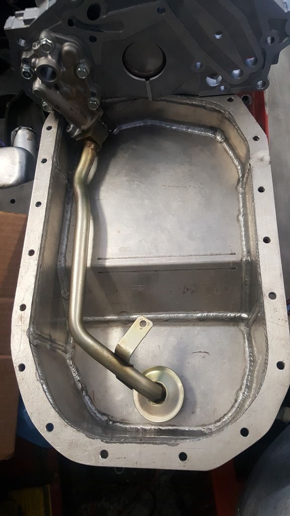

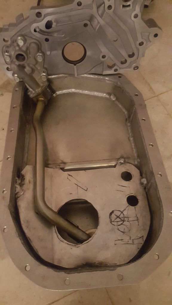

Iam pretty much stuck when it comes to the oil pan..
I spent a lot of time trying to arc weld a solution out of the oem pan only to find out it leaks like crazy afterwards with all the pin holes. :(
I've reached out to a few vendors about building one with no luck yet, the next best thing I figured was to try again with a tig setup..
So Iam nearly completed gathering all those items for a simple scratch start setup and will post progress afterwards....
Iam also playing around with the idea of casting an aluminum one from a home foundry setup but thats on the backburner for now.
If anyone has any other solution's let me know..
I would try getting someone to Tig it for you. To save some cash, You could cut all the pieces out, tack them with a Mig and send them to a welder to finish weld. Make sure your gaps are tight.

So I scored this pan from a fella here on the fourms that was willing to let it go..
Then I added a rear pickup tube from a mazda miata 1.8 and a splash plate, the tube was the same diameter as the 4g64 but the pickup was a slightly different design, I also had to modify the flange to fit and bend it a little.

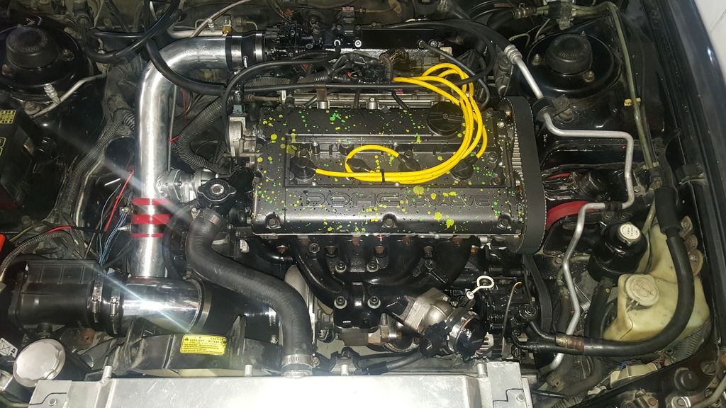

Quick Break Build Breakdown
7g Galant Fwd
4g64 block 4g63 head
Holset hx30 .55 ar housing
hafe exhaust manifold
manly h beam rods and pistons.
evo 560cc injectors
3g eclipse ecu with Tephra Flash, SlowPoke tune
SD, Maft was removed and replaced with filter.
Godspeed wastegate and bov...
Made 350hp and 340tq but could of made more...
ebay 3" intercooler, 1g ebay radiator.
Outside pic of car.

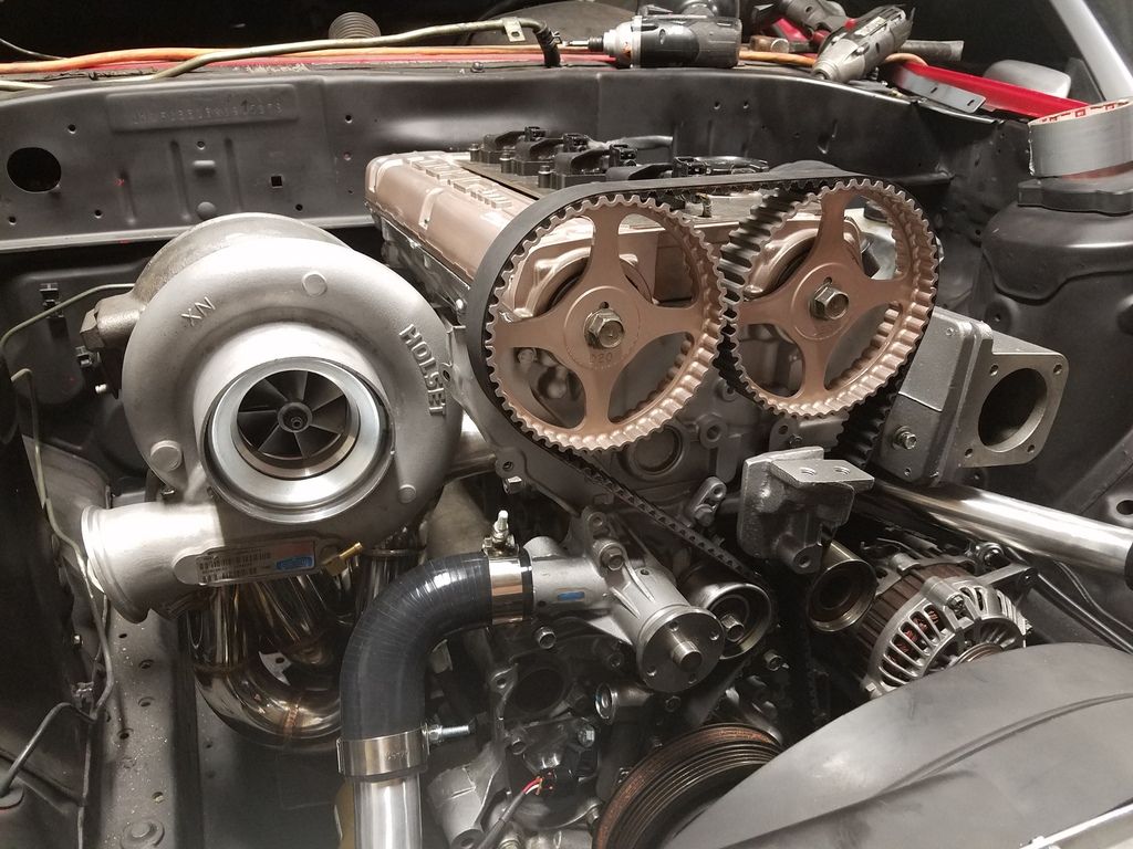

Yep I had the same one but swapped it with a gsx drivetrain, was very fun but drove a bit tooo rough.... hoping the rx7 will have a little more solid feel. I passed up the 8g and got a Evo IX instead....
Figured out a trick setup for the power steering since the exhaust manifold placed the turbo to far north making it unable to use original ps pump. I'am using a pump from a volvo s40 plumbed directly into the rx7 rack.. I may add a filter later.. but decided on the volvo pump instead of the mr2 cause price was nearly half and they are more abundant.

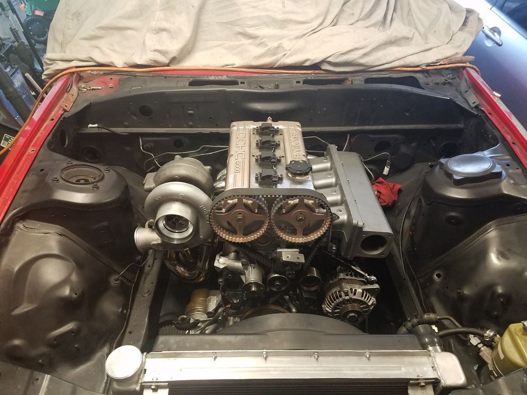

Things are moving along....
I actually re-made the passenger motor mount because I found a very well made 12an oil drain ss line from ebay user of nascar team that interfered with the original mount i made.
Latest list of things working on below
grimspeed 3 port.
extremepsi oil feed line for holset
Fuel line and fittings 6an.
Cleaned the fuel tank.. It was full of old gas :(
raspberry pi and screen for speedometer rpm/mph/boost etc readout
digital vehicle speed sensor for transmission
building battery box behind passenger seat.. "going to post some pics on this when I get farther along"
On a side note these things are finished...
Intercooler and piping fabbed and bolted in.
Brake calipers painted and ss brake lines installed.
Mounted electronics plate and ecu.
DIY COP completed and plugged up.
Throttle Body installed and found a TB cable from a Montero that fit.
