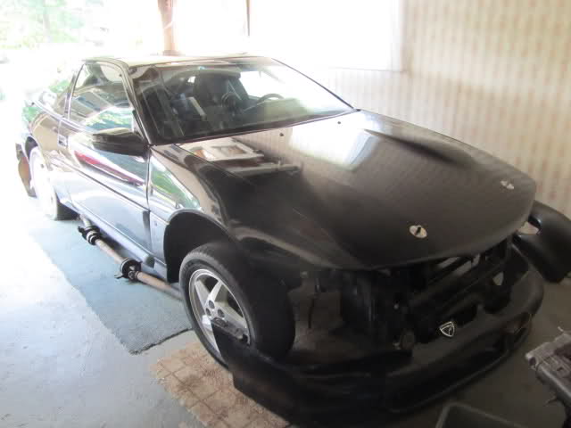

What's up guys? Since my Eclipse project is coming to a close, I have a new project that I have somewhat recently acquired. I picked up a 1992 Talon TSi AWD shell in New Jersey a few months ago. Yes, it is Casey Barrett's old black talon that Sean(Slippi84) bought. You may recognize this car from his Project 9's No Compromise build blog. It needed many things, including an engine, transmission, drive shaft, turbo, intercooler, radiator, etc... I have already gotten a lot of these things, but there are so many more things I need. My initial plans for this car is a budget build. I originally wanted to hit 10's for under 10k, but now I just want to go as fast as I can using the best parts I can for a reasonable amount of money. If I can only hit 11's or 12's, so be it. If I miraculously hit 9's, that's fine too. As long as I am having fun, the project will be a success. Here are some pics:

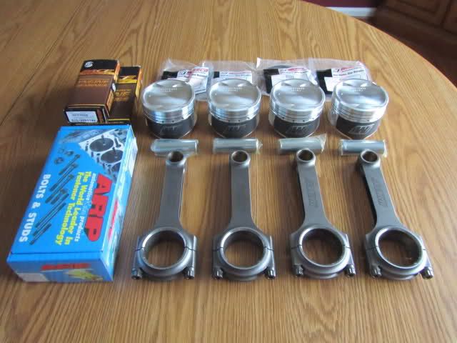

Here is what I have acquired so far:
Engine:
6-bolt motor
Wiseco 9:1 Pistons
Manley H-beams
ARP main studs
ACL Race rod and main bearings
Stock head

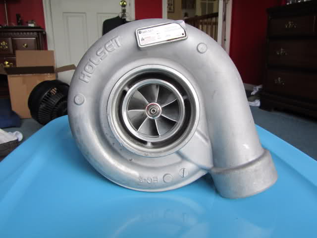

Turbo:
Holset HX-52

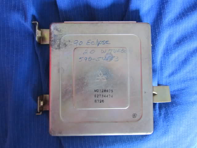

EPROM ECU from a 90

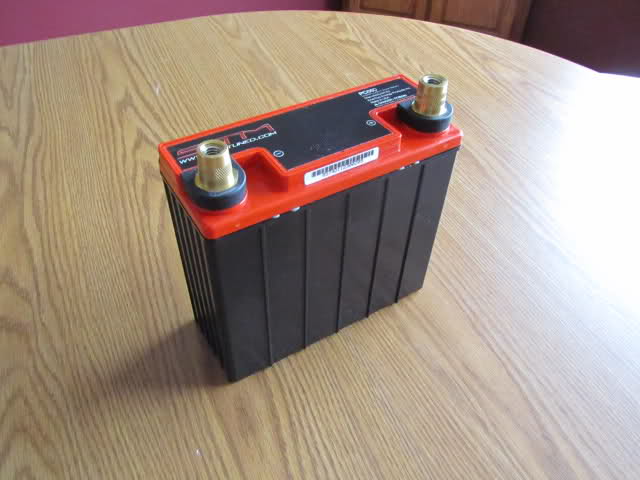

STM light weight battery

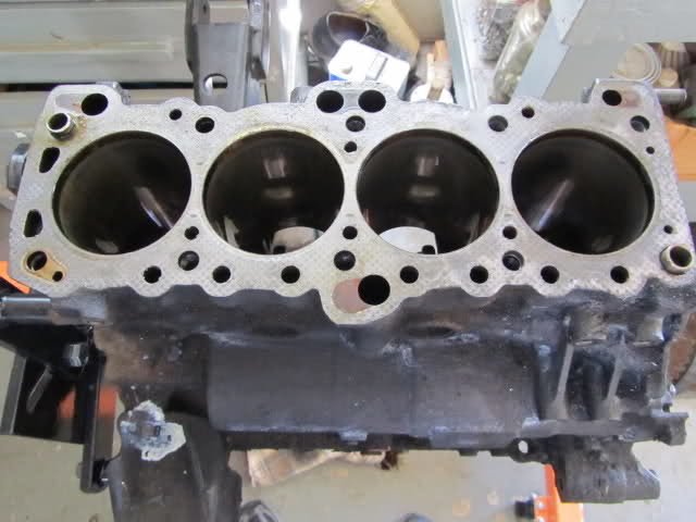

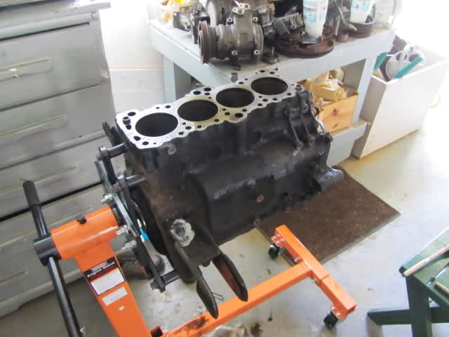

As you can tell from the massive fuel system parts, I plan on running E98. All I need are injectors and a fuel cell to complete the fuel system. Most likely I will get 1850's and a small fuel cell to mount up front. I am shooting for 600-650 whp on a relatively low boost setting of 28-30 psi. The transmission will be built by JNZ tuning. The transmission is there now, I just have to give them the ok (and save up some more money). The engine is apart, all I have to do is drop it off at the machine shop with all of the parts I just got. I am considering getting an AEM EMS instead of using the EPROM ECU I got for free. I also am planning on making my own front-facing exhaust manifold and getting an air-to-water intercooler. The first thing I need to do is strip out the entire interior. If I want to go as fast as I can on a budget, I need to take advantage of every free mod I can. Progress will be slow until March because of school and limited funds, but I will have a Co-Op job in the spring and summer close to where the car is. My probably unrealistic goal is to have it done by the 2012 Shootout, but it will most likely be the 2013 Shootout. I don't want to rush anything.

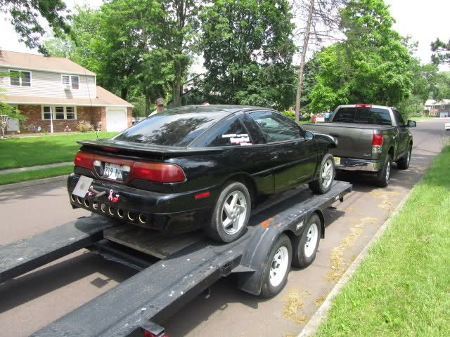

Sean had it shipped all the way from Utah to New Jersey. Glad he saved me the trouble and money :thumb:. I just wish it still looked as clean as it was when Casey had it. I'm pretty sure I'll be the first person to take this Talon into the 10's if I do since I think the best time he ran in it was an 11.0.

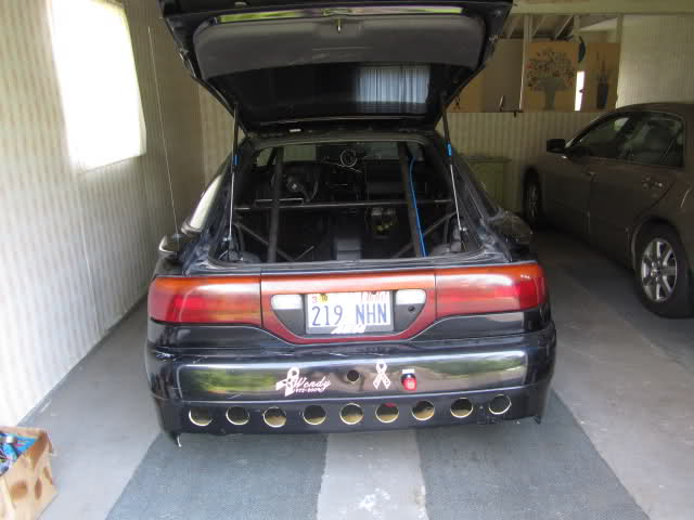

I"ll redo the cage, judging by the (slippi guy) there will be no surprise that this are just a bunch of bars welded without any math proven design.

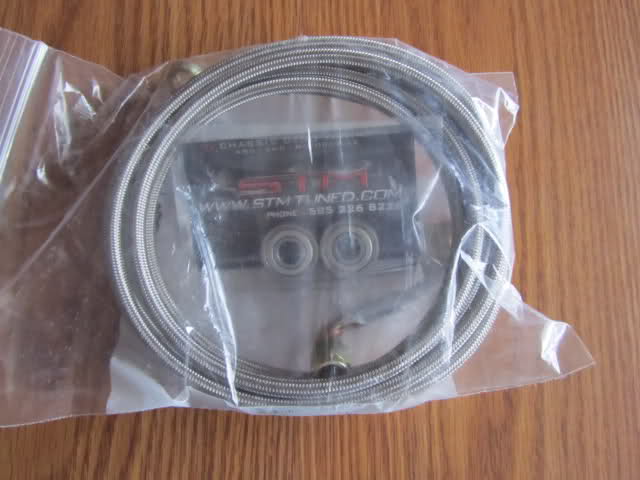

Car looks great, will be nice to see it run after all this time. ONe thing i would warn you to be patient with is bleeding the clutch if that's a -4 line. I went down to a -3 because the -4 was insanely hard to get bled properly, Even a friend that owns a local import shop said they only use -3 now because of thebleeding issues with the 4, said the only way they could get them to bleed was with a vacum bleeder when using the larger stuff. SOif it doesn't want to bleed, don't jump to looking for leaks too fast because it's probably just air that won't come out of the slave but you can get a lot of that out by pushing the slave in with the bleeder open and then closing the bleeder and releasing the slave rod.

The owner of the car before him, Casey Barrett had the cage done. It was certified to 8.50's. He made 750 whp on the car and 140 mph passes before he parted it out. Sean didn't really do much to the car except put dents in it and cut up the bumpers. I'm starting my paid internship next week so updates should start coming very soon.

I have the same clutch line in my 99 GSX. Took a long time to bleed it, but it works great. Combined with all new shifter bushings, it shifts better than it ever has before.

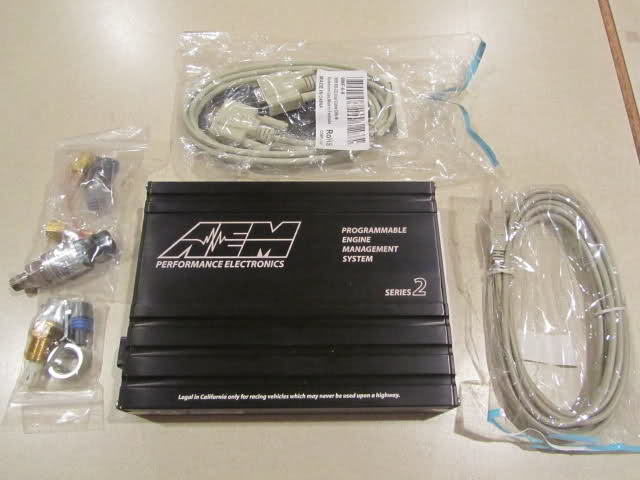

Being cheap wasn't really getting me anywhere and I don't want to make the same mistakes that Sean aka Slippi81 made. I am going with quality parts from now on. I plan on having turbo4.com build the motor (guys with the 4G63 Dragster). The trans will be going to Shep for a stage 4, not JNZ as I originally planned (more expensive anyway). I just bought a 1G Series 2 AEM EMS, along with their AIT and 3.5 bar MAP sensor. I will probably ditch the HX-52 and get the new BW S400SX 67mm FMW. I also plan on reducing weight as much as possible. I almost have the entire interior out and I plan on removing a bunch of the interior excess sheet metal, as well as a comprehensive wire tuck. I will probably do a tubular front end because the front is already kind of butchered up.

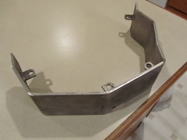

3speed scatter shield:

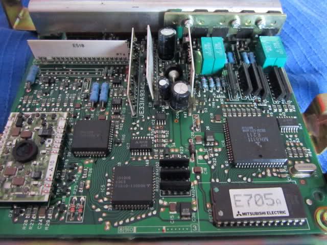

AEM Series 2 EMS w/ 3.5 bar MAP and AIT:
