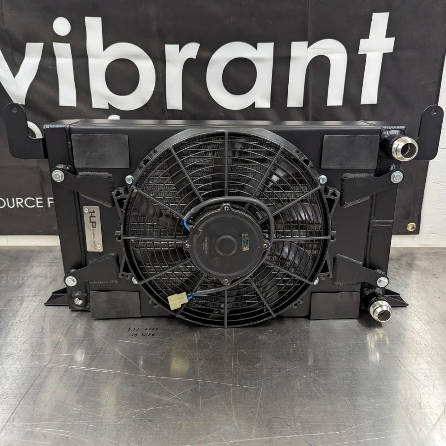

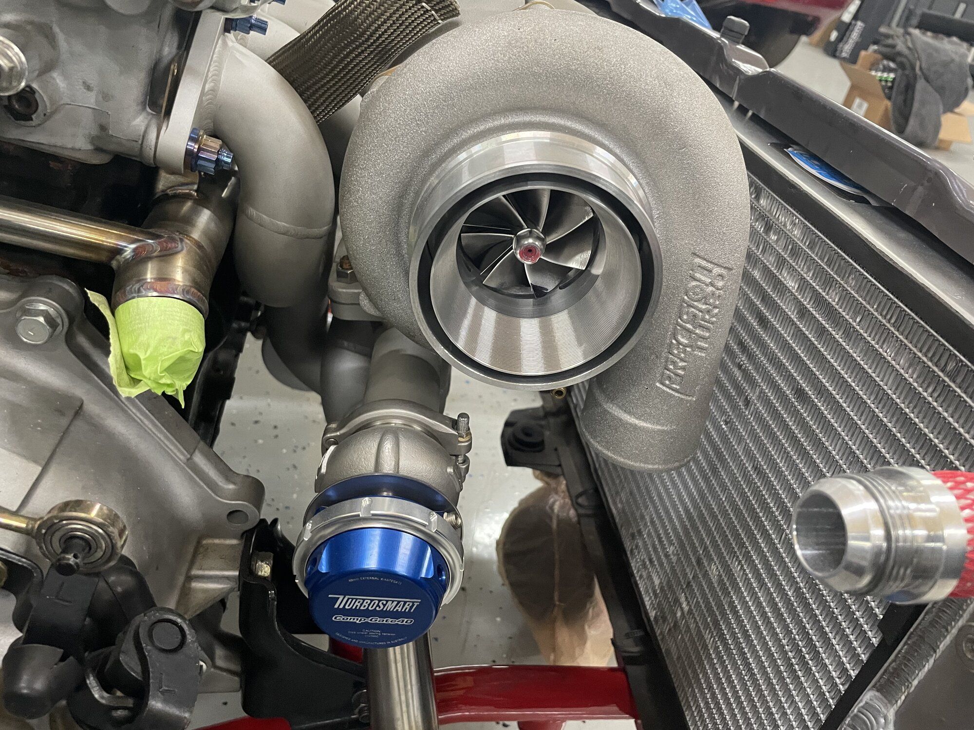

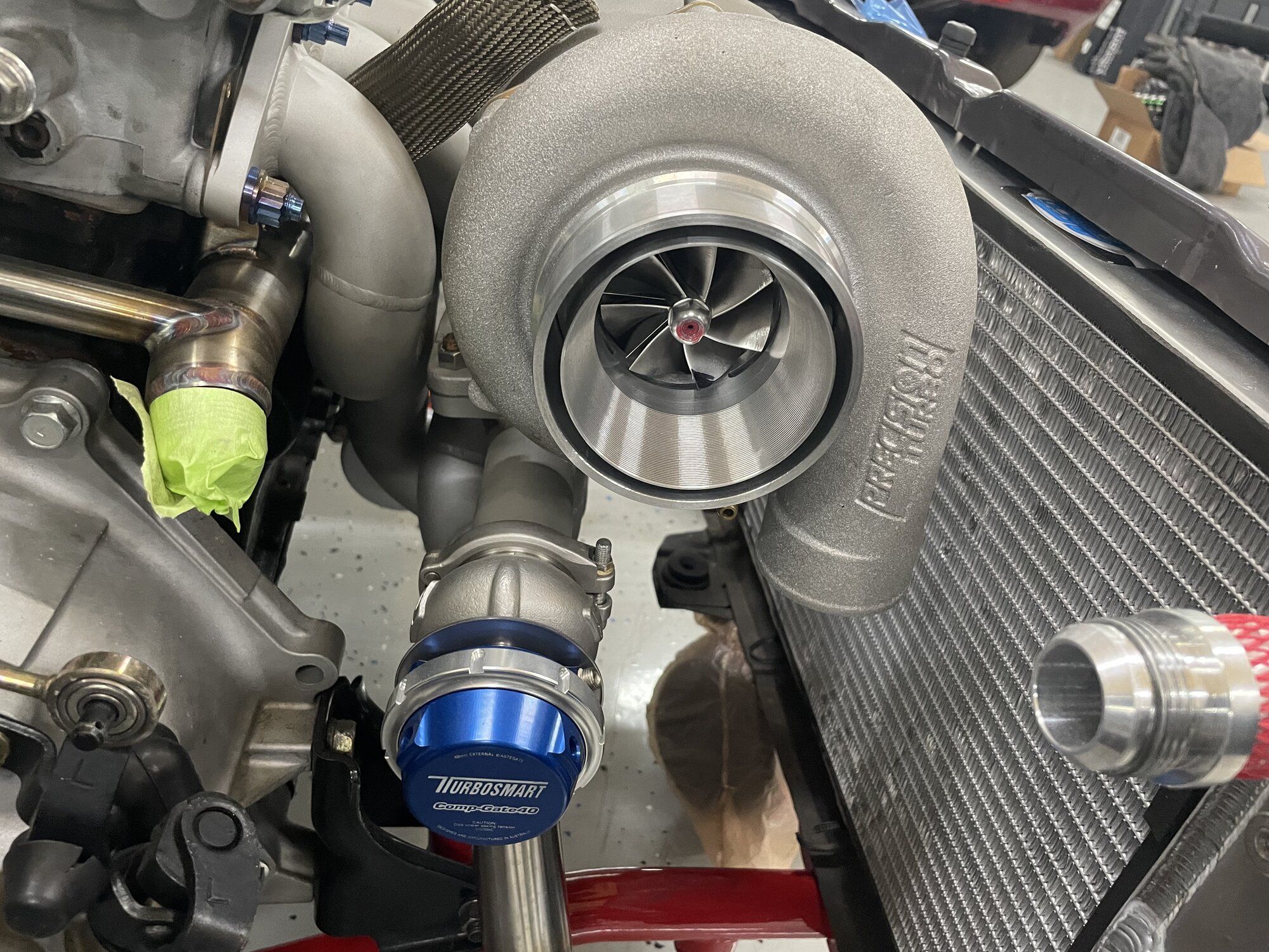

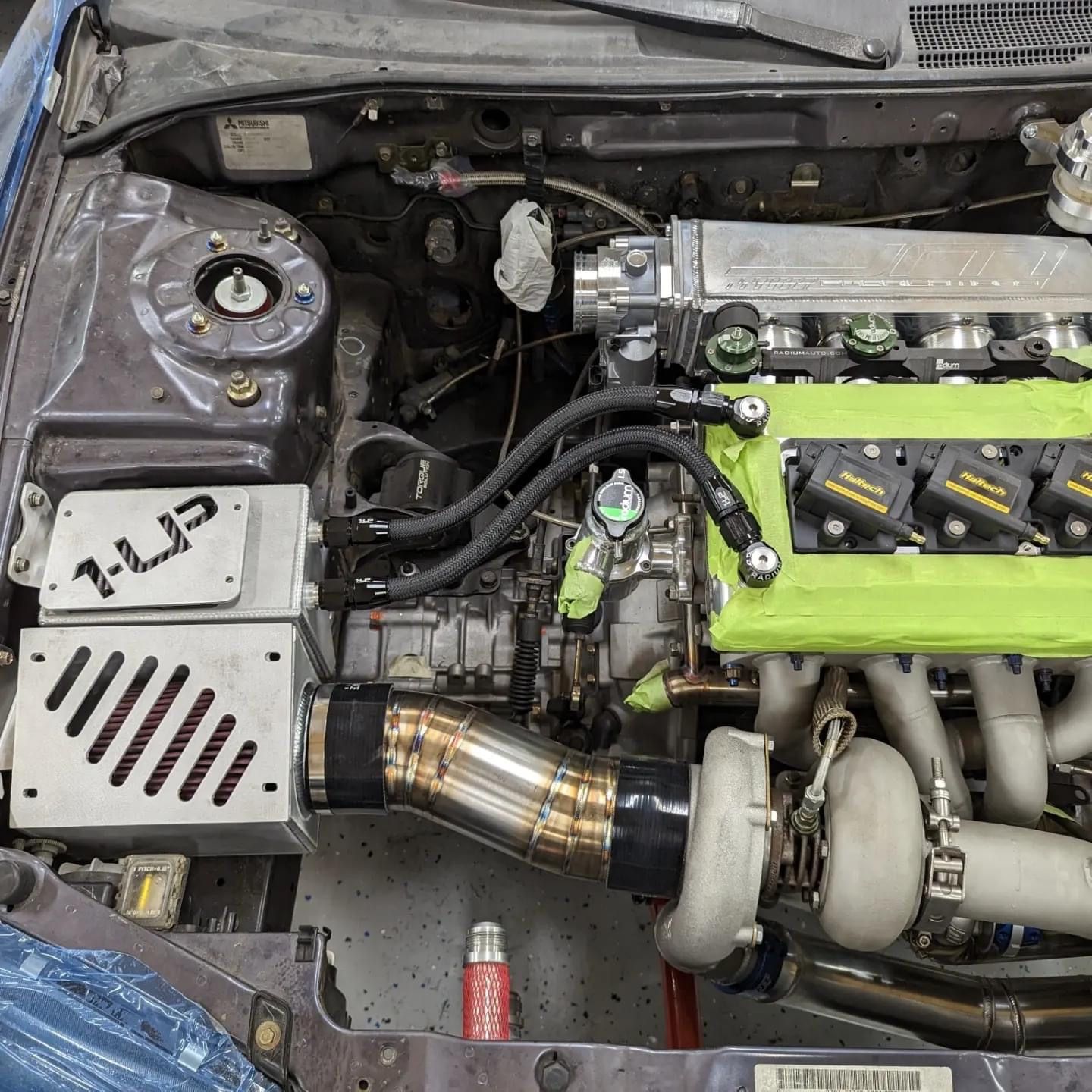

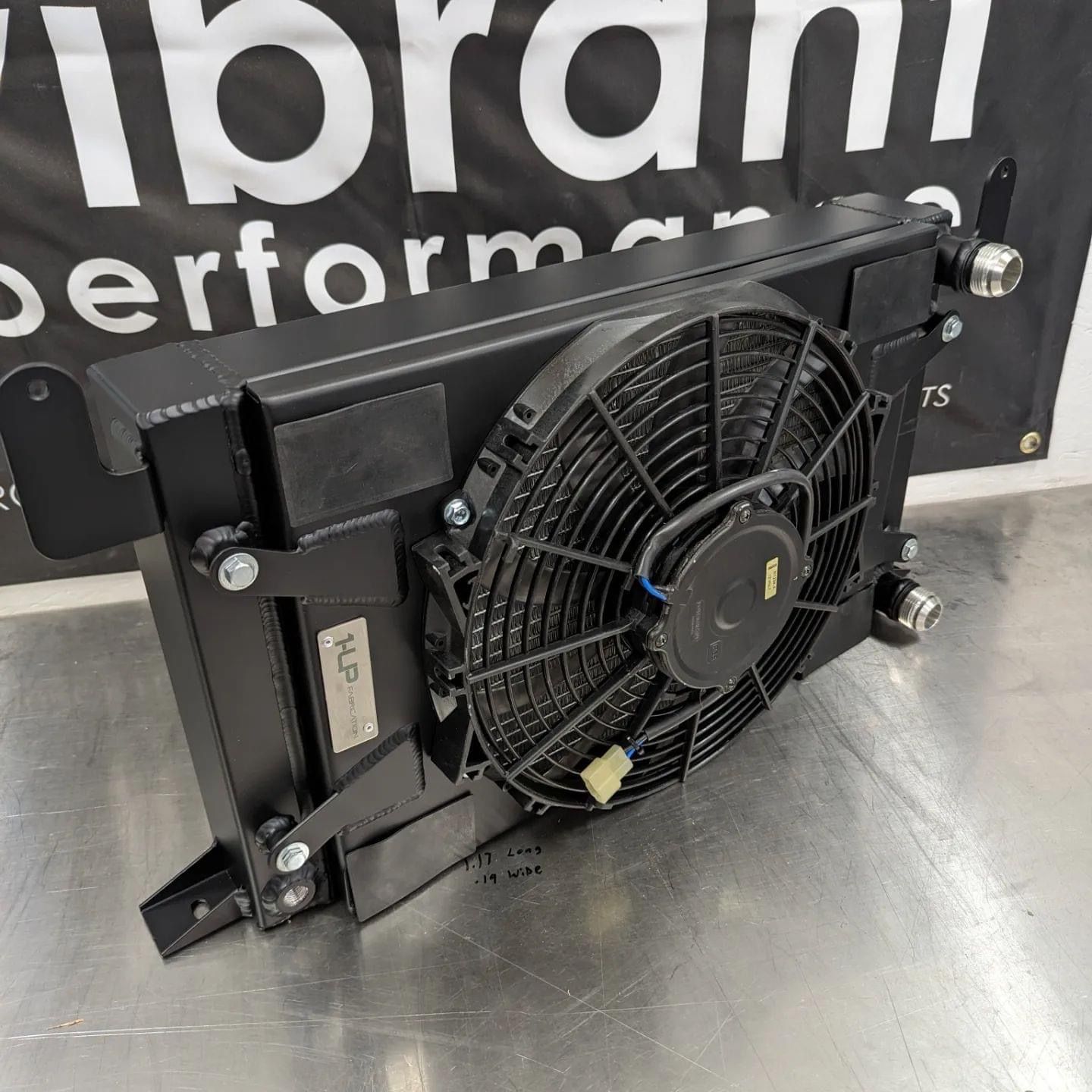

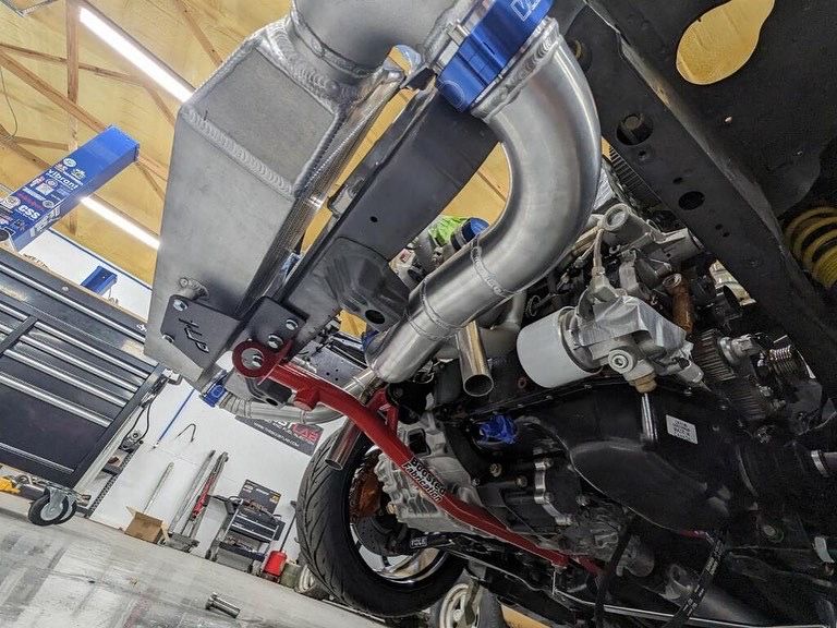

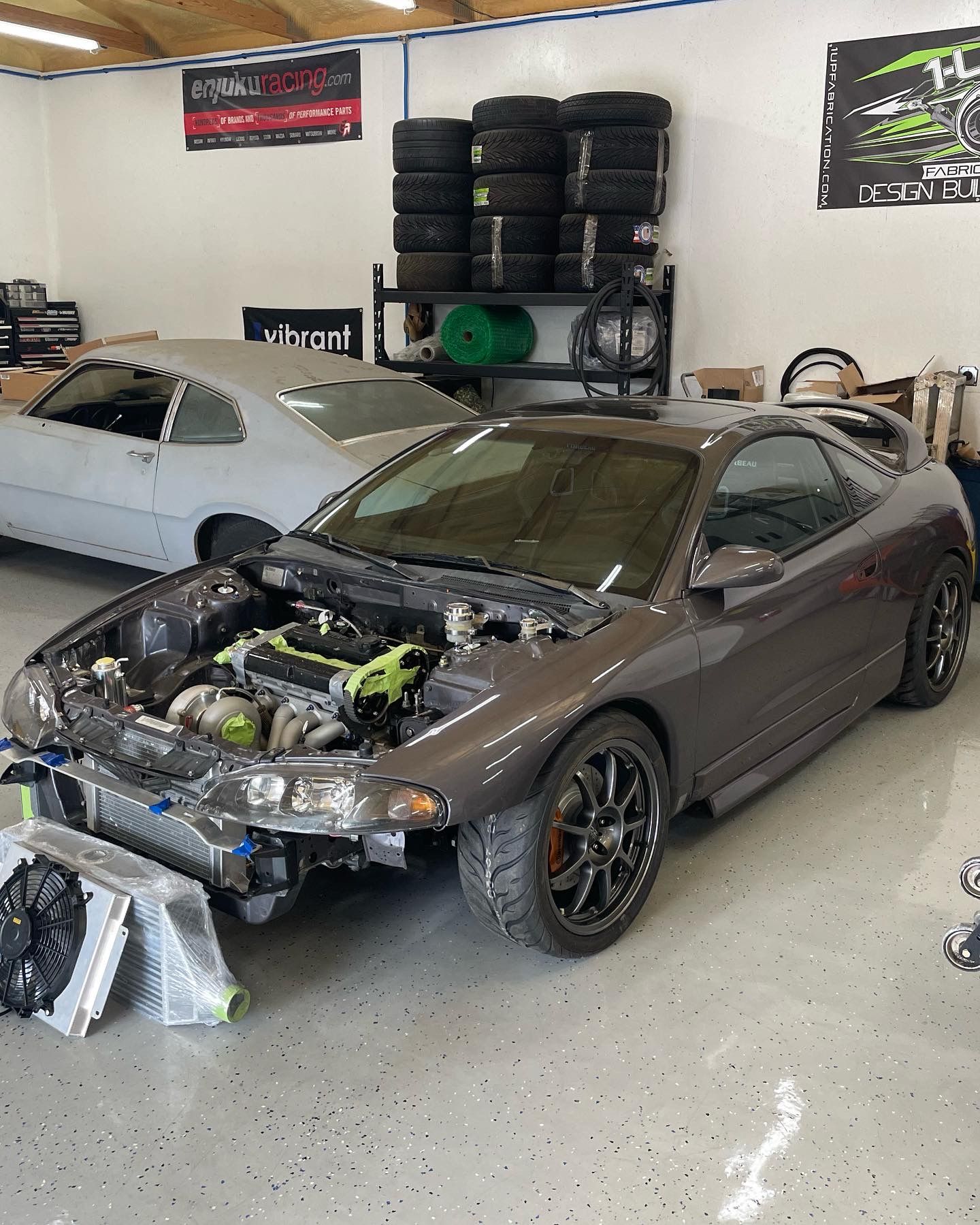

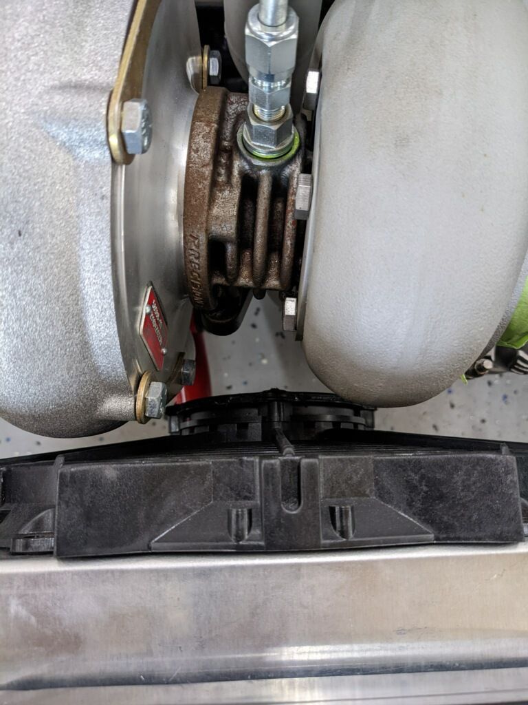

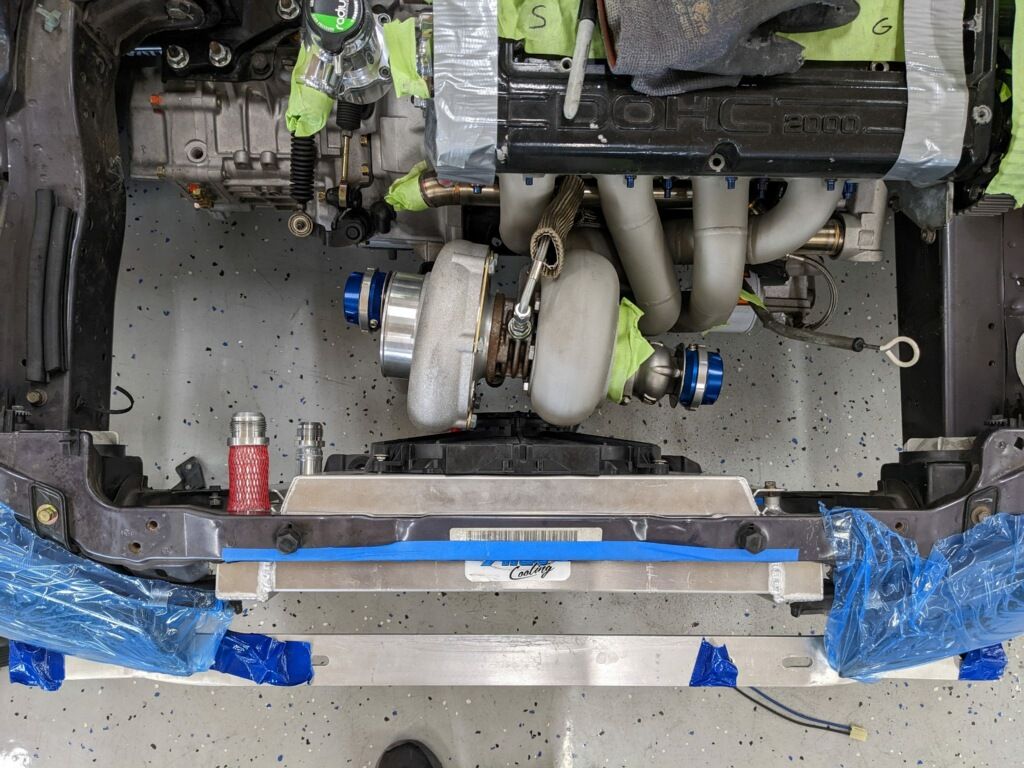

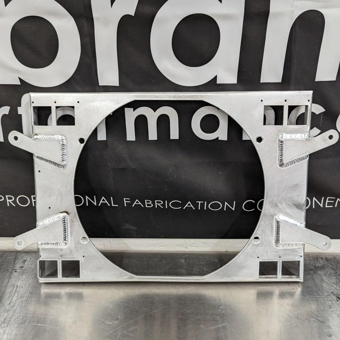

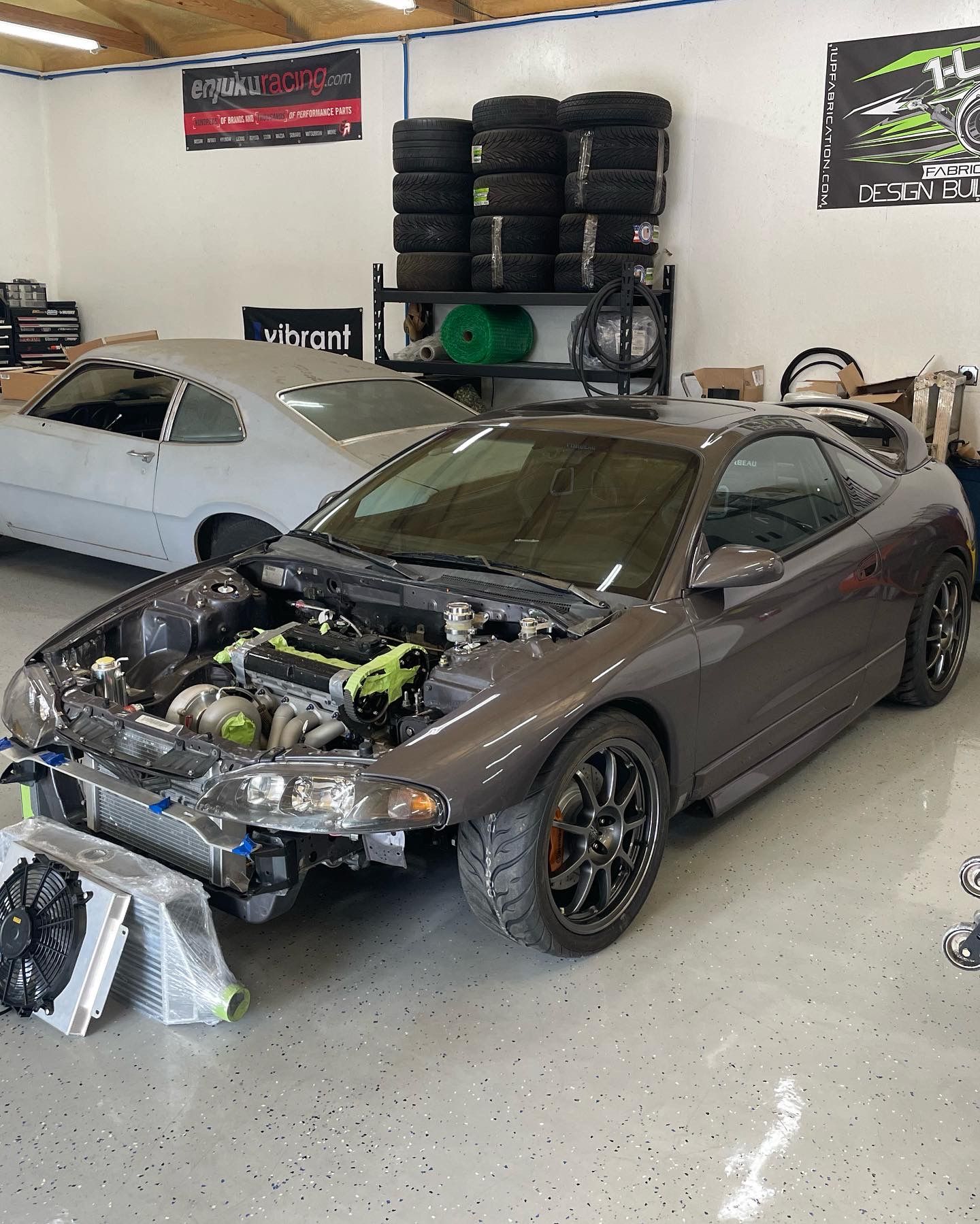

Andy at 1-up fabrication started working on fitting the radiator and shroud and discovered there is not enough clearance from the turbo. After researching slimmer fan options, we found it won’t give enough additional clearance, so Andy is planning to fabricate a thinner profile fan shroud.

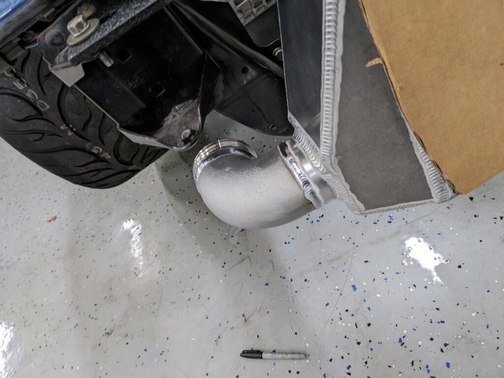

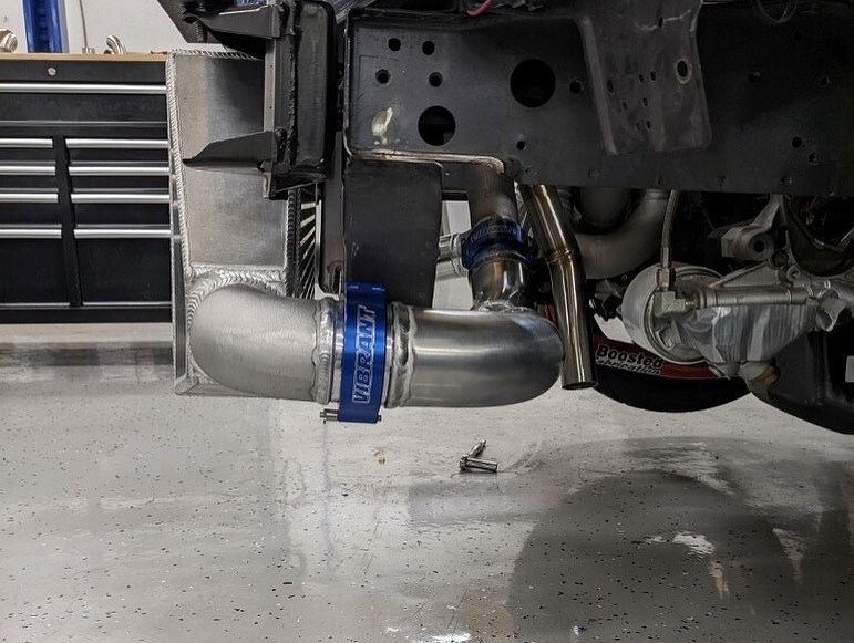

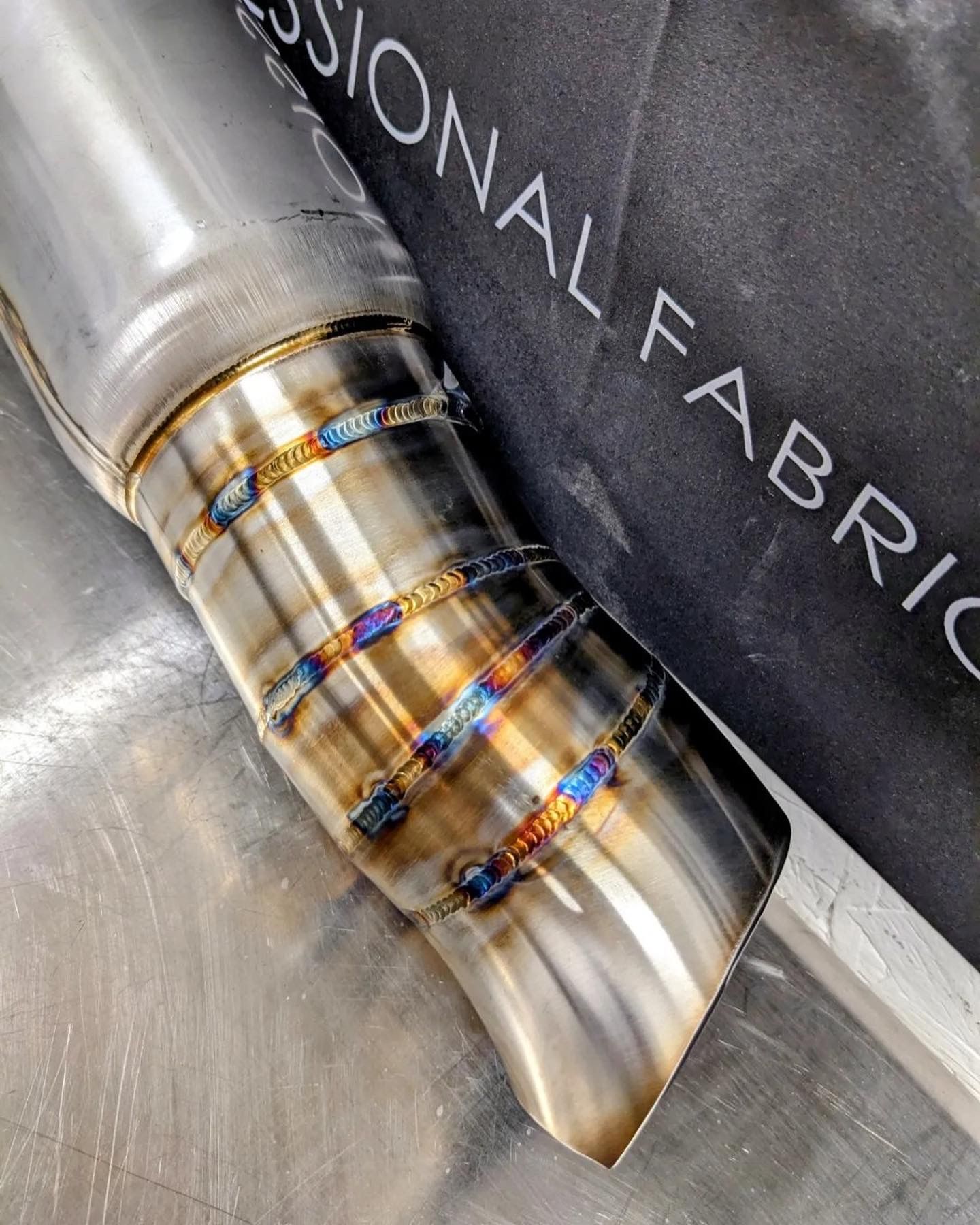

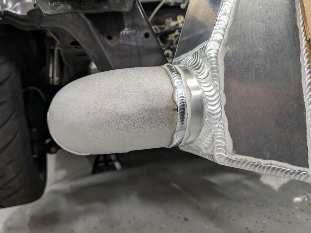

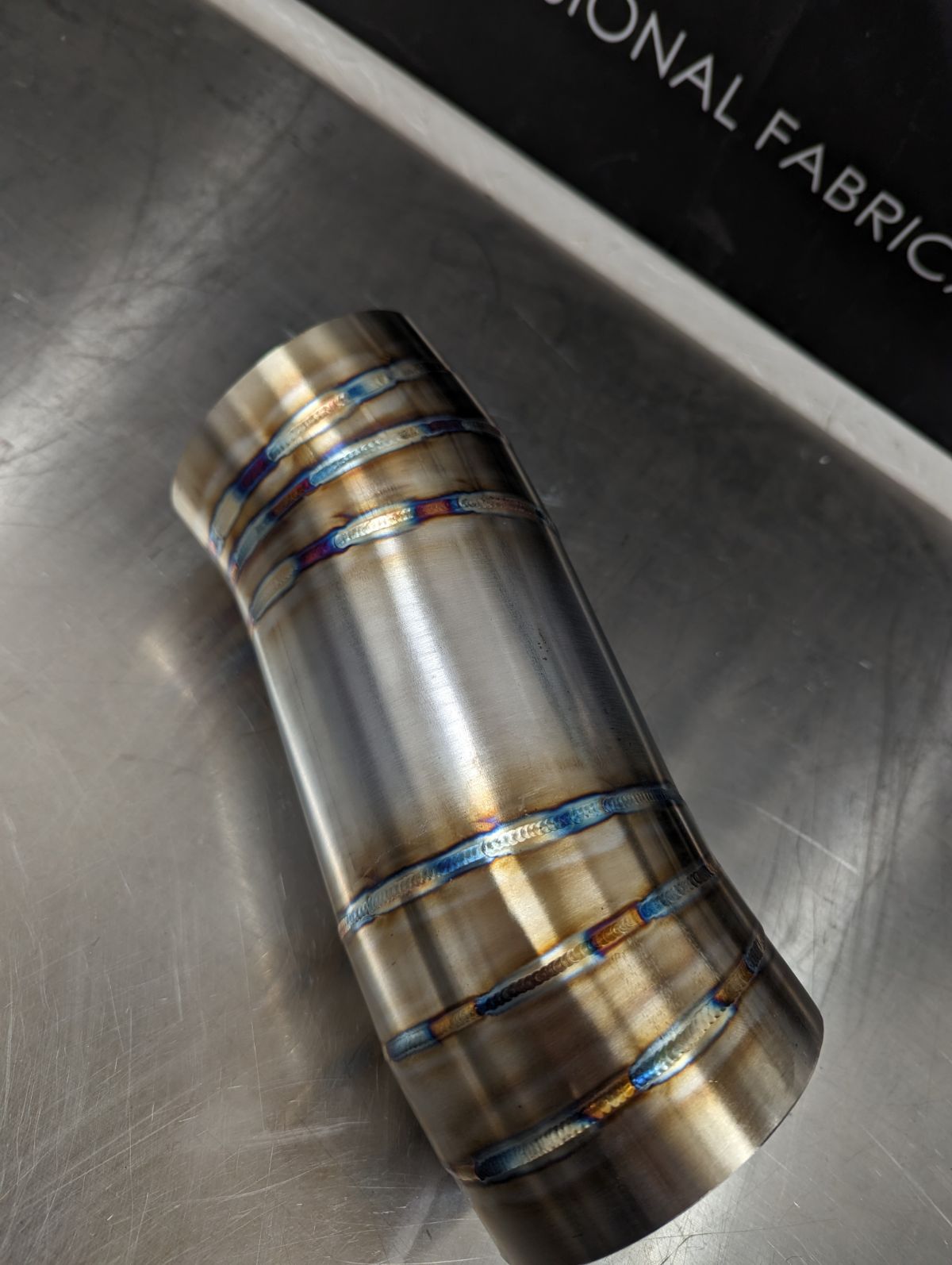

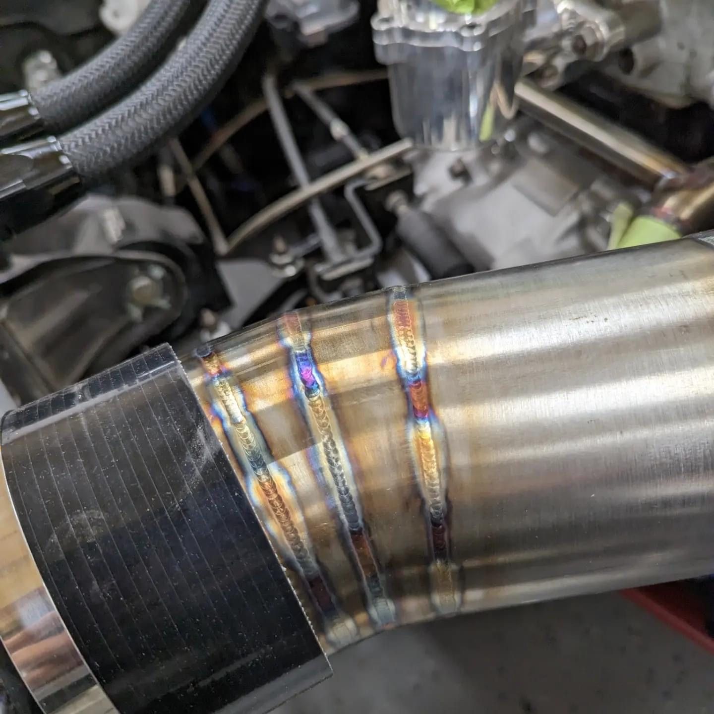

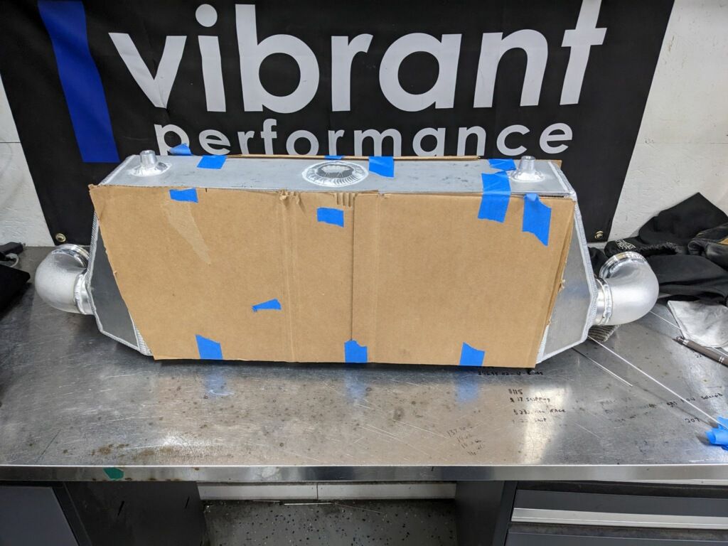

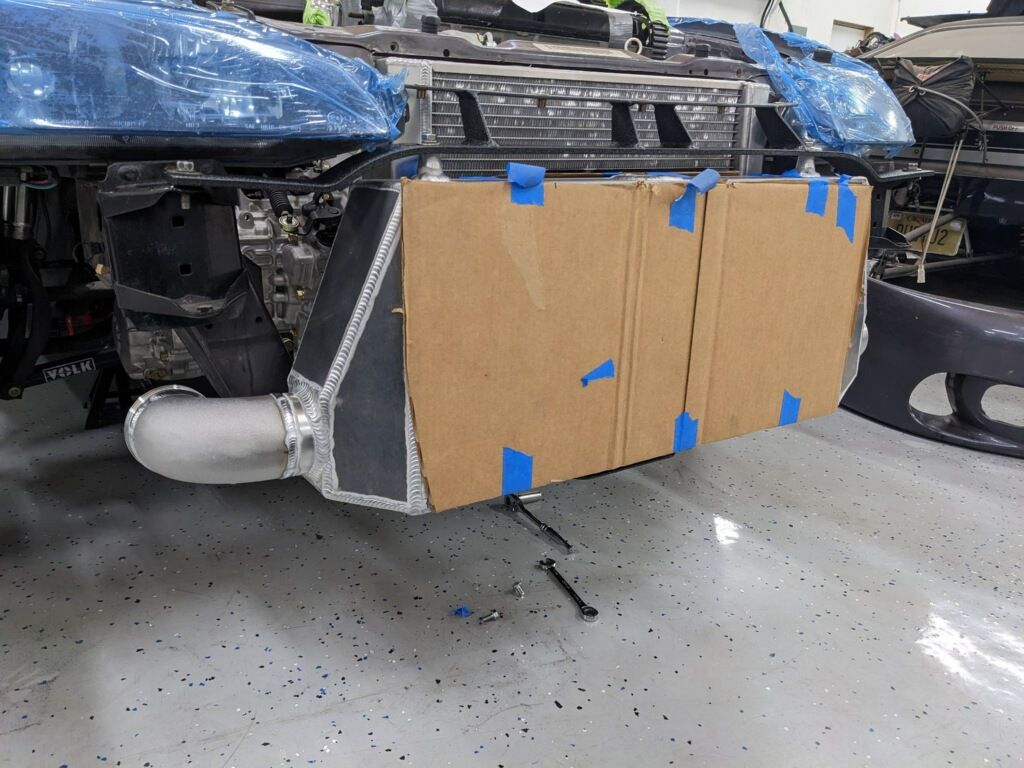

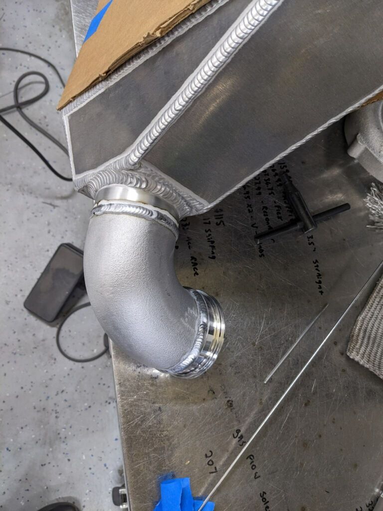

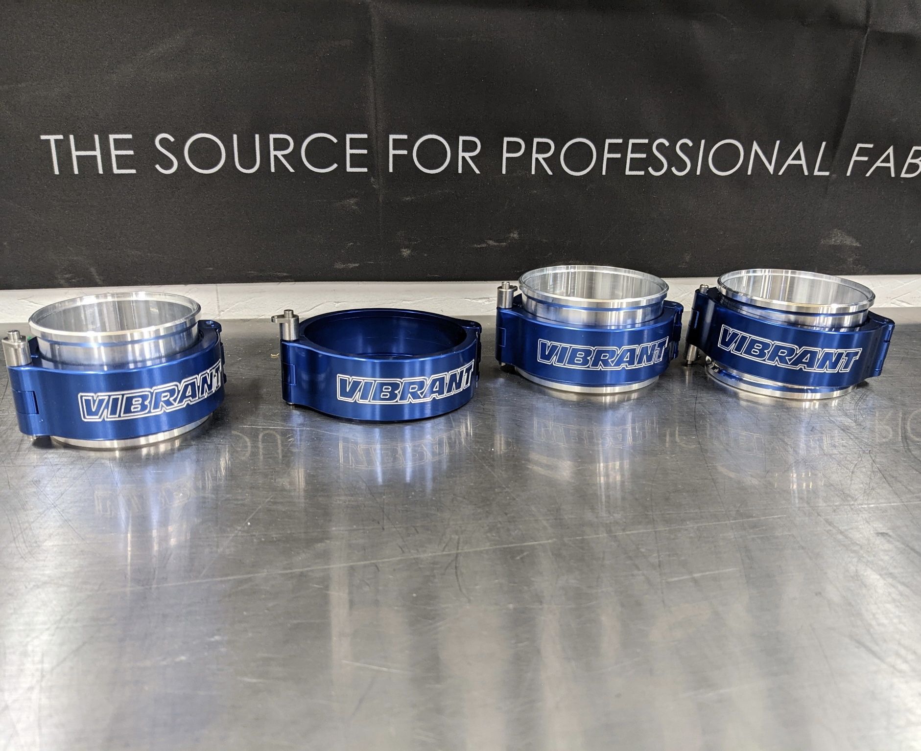

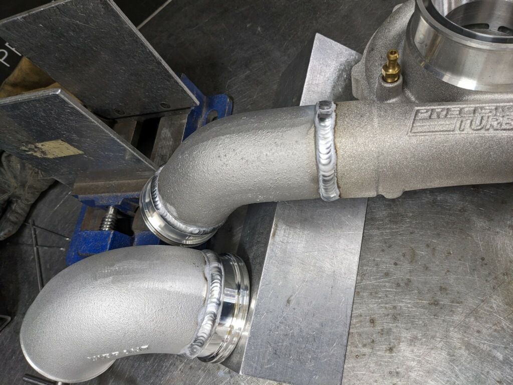

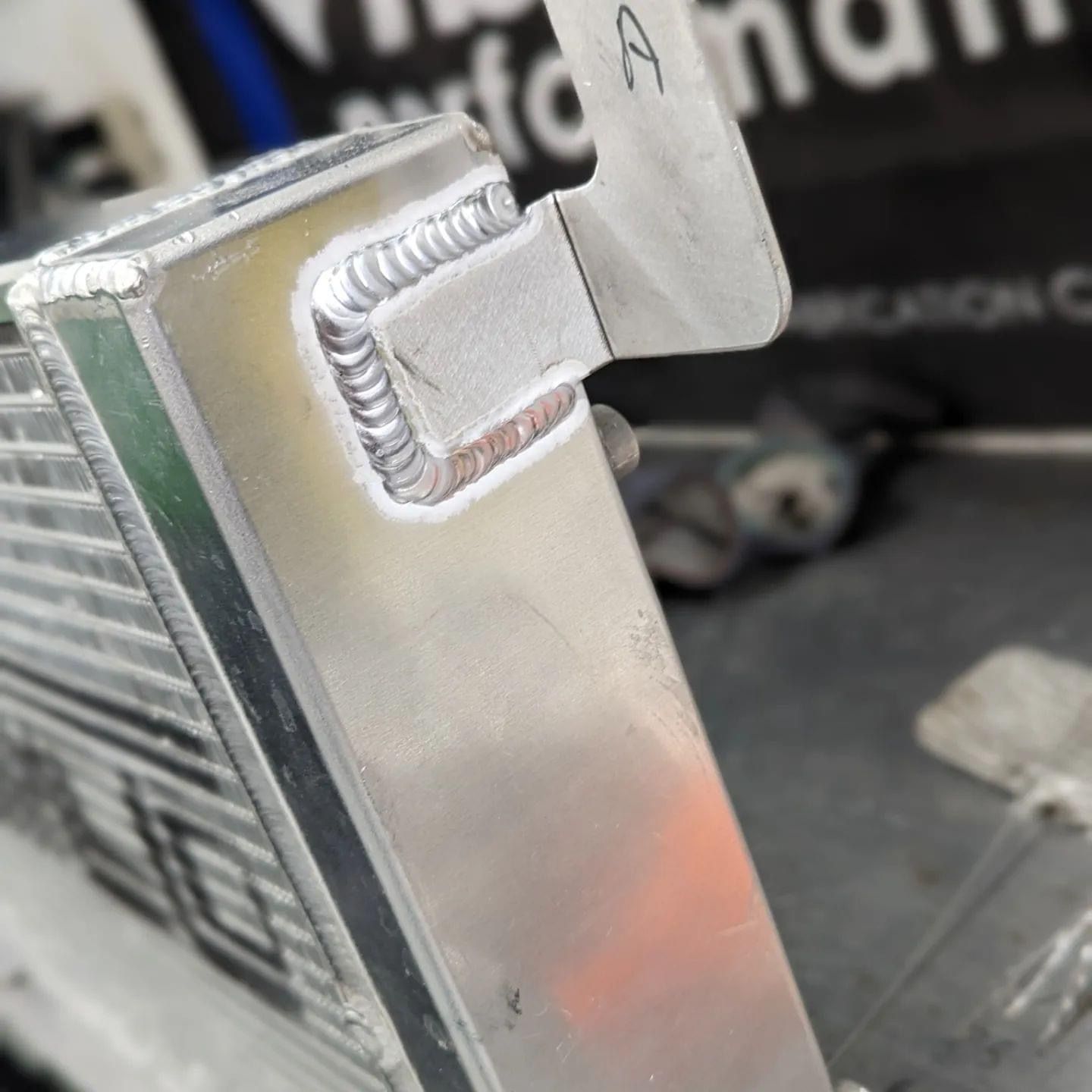

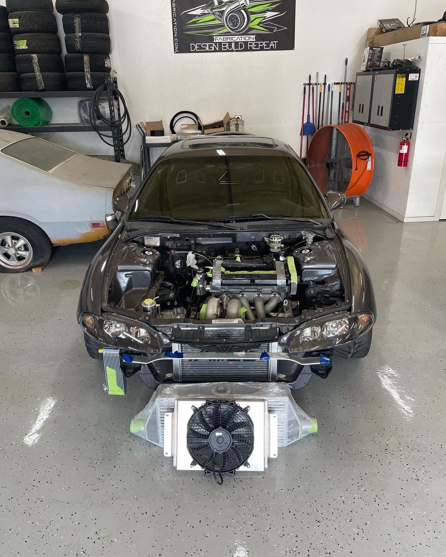

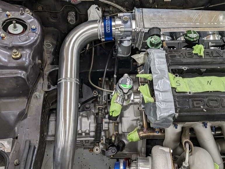

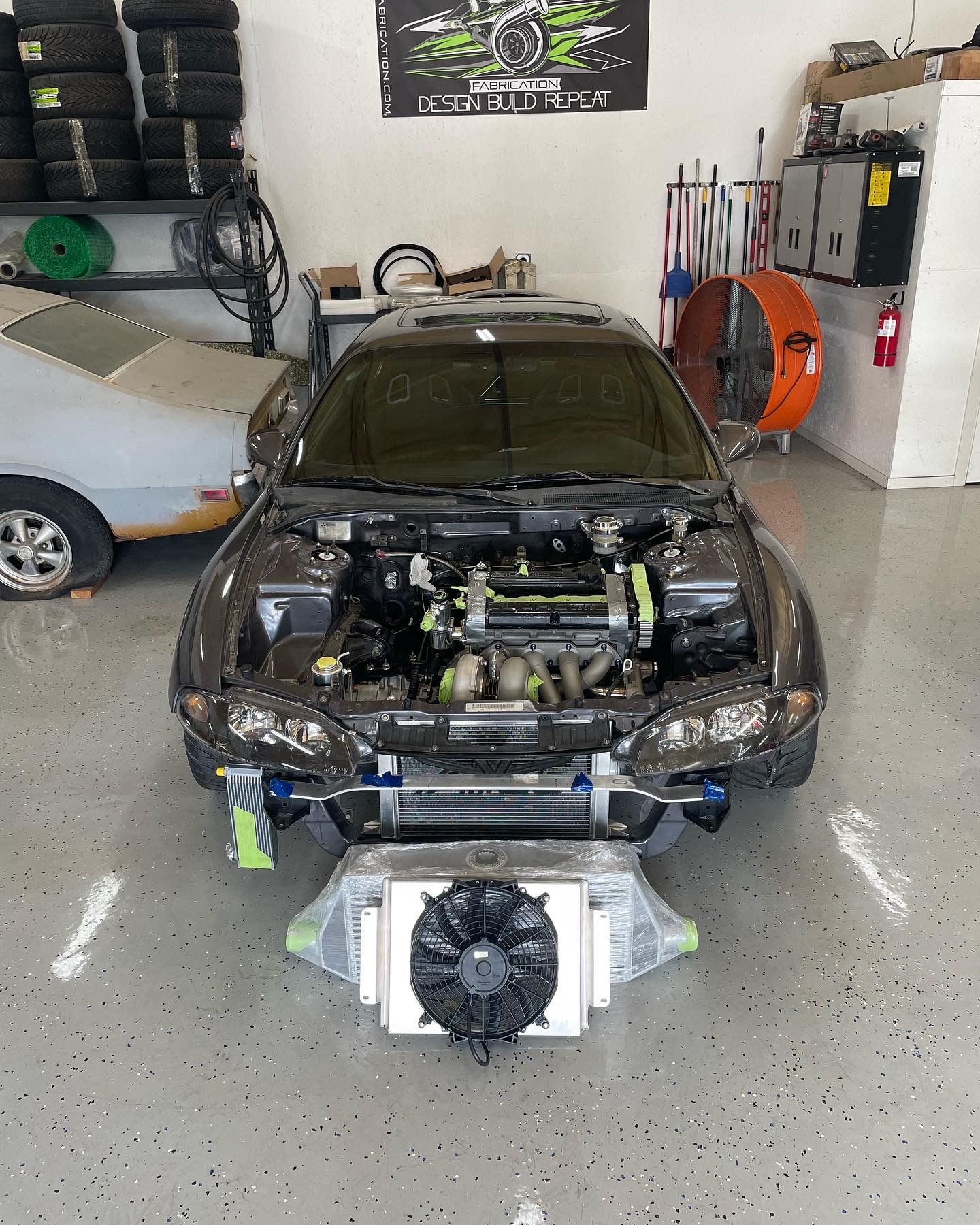

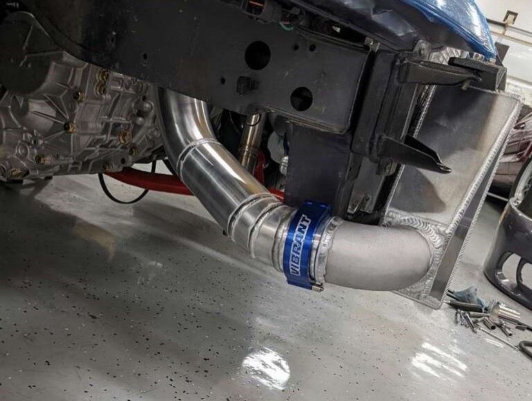

More progress on the fab work. Andy at 1-up fabrication is killing it. Though he initially welded the vibrant HD flange straight off the intercooler, clearance was going to be an issue, so he opted to weld cast 90s directly to the intercooler, then the HD flanges. More pics to come!

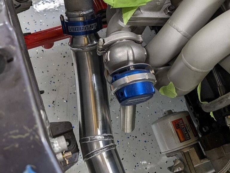

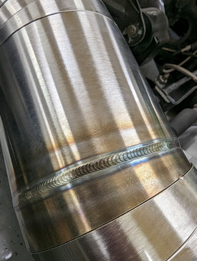

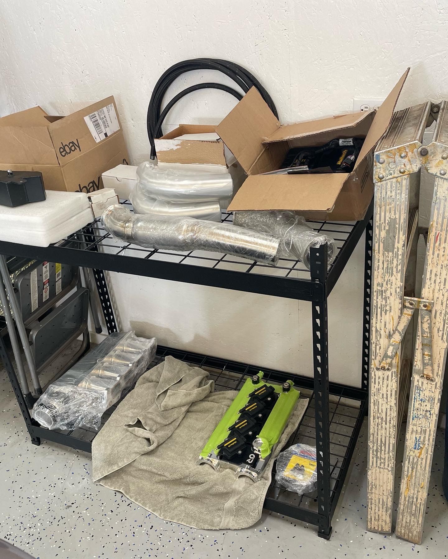

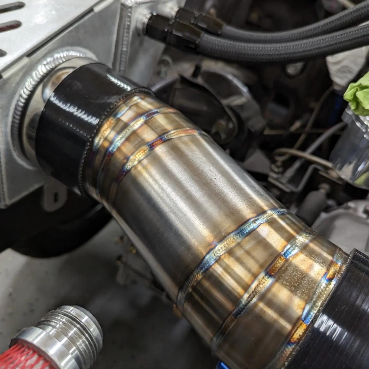

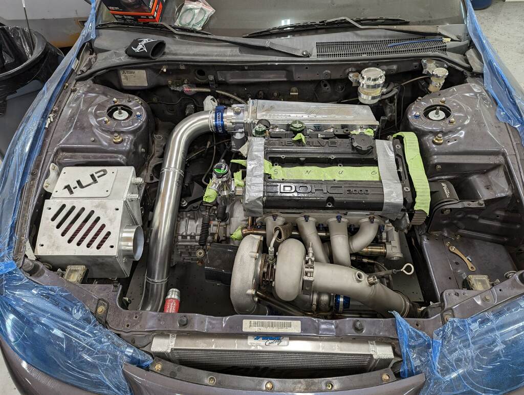

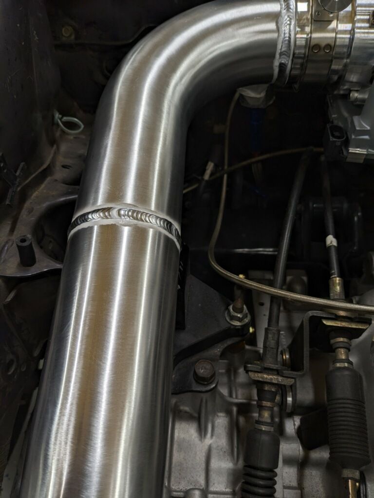

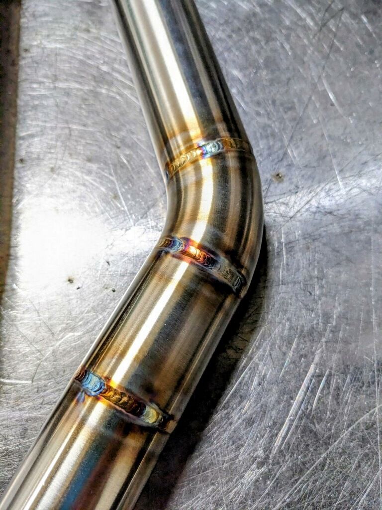

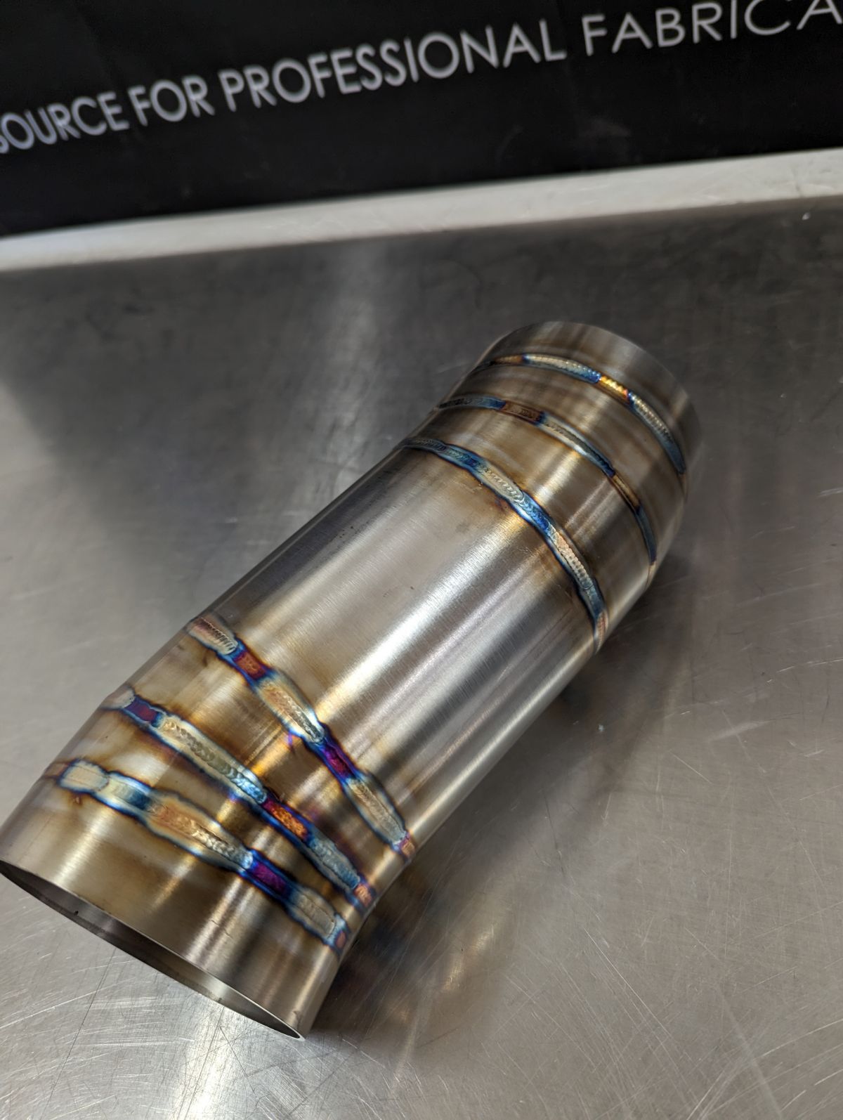

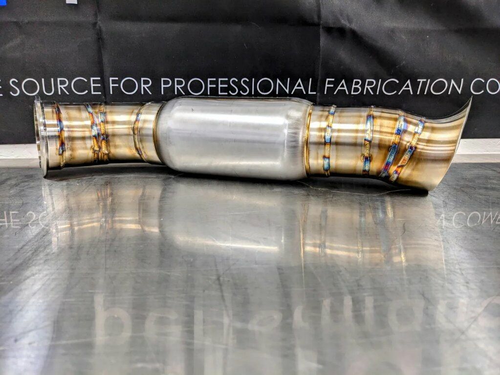

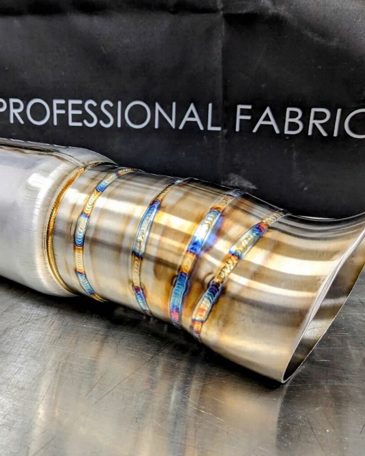

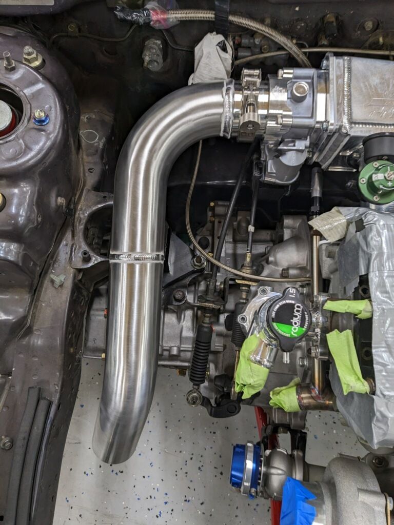

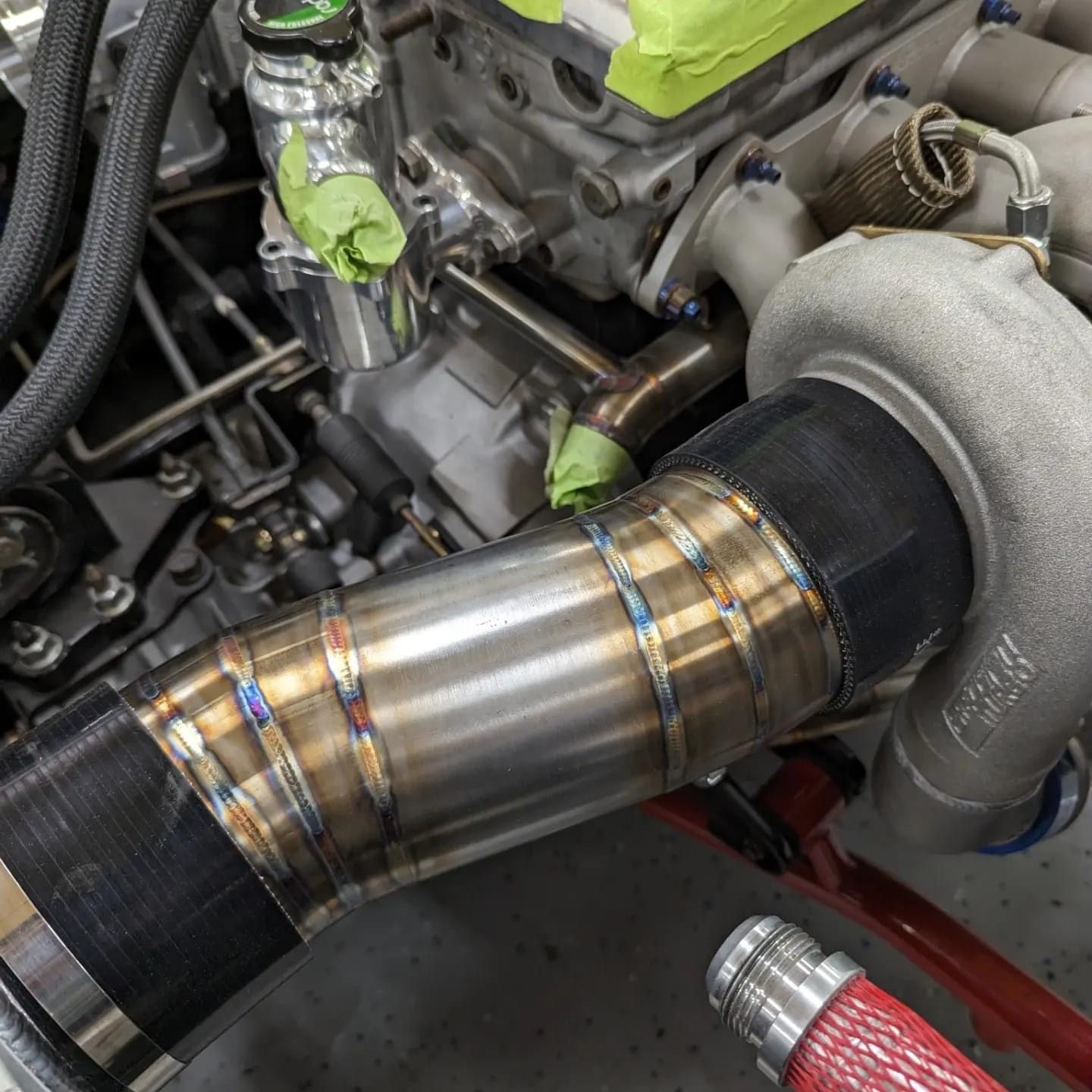

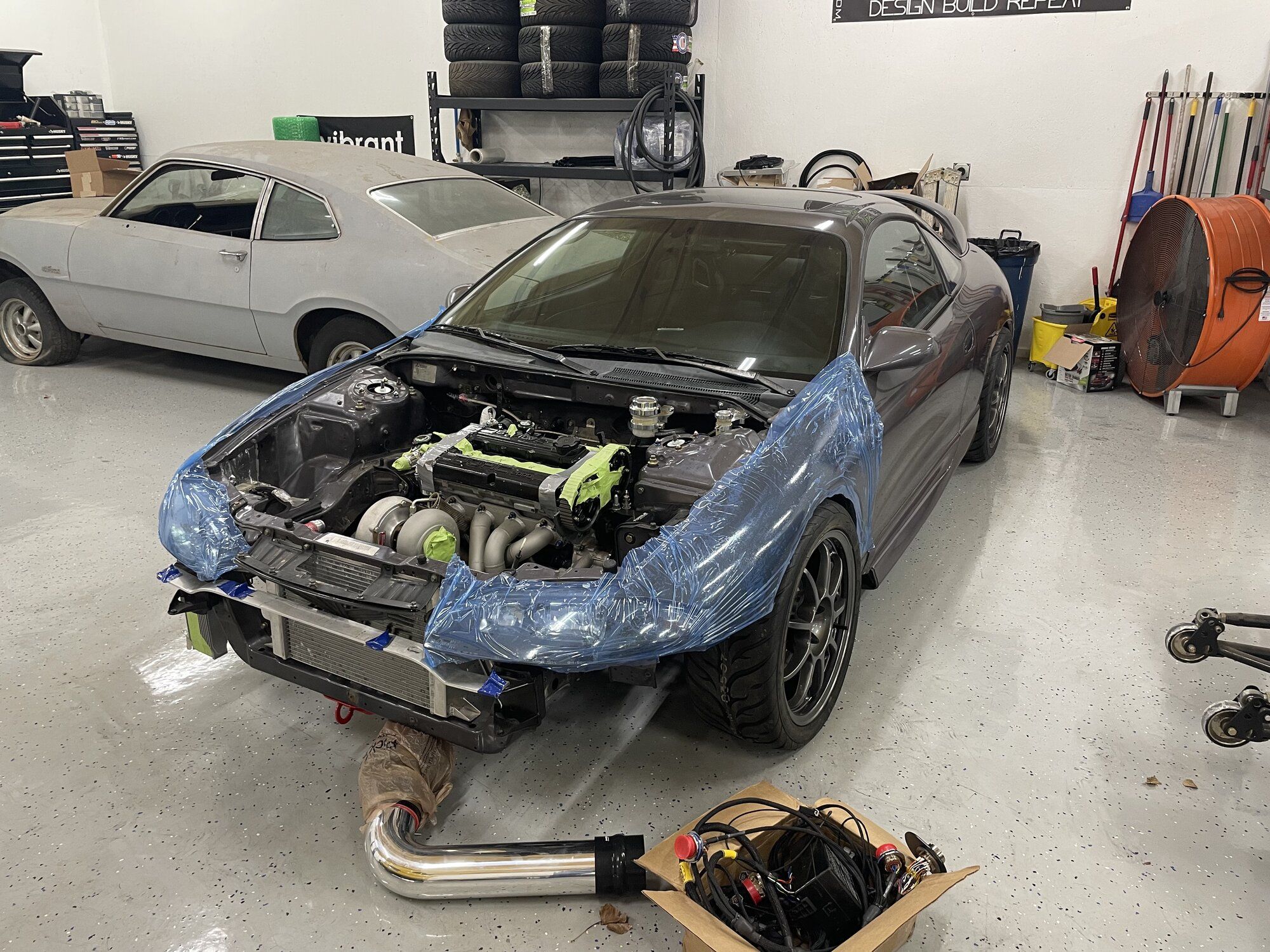

Andy at 1-up Fab completed the hot side and cold side intercooler piping. Ready for powder coating. Trying to decide what color. Any suggestions? I initially wanted gloss black but hate that it will show scratches so easily. Considering satin black or a dark metallic gray? Or maybe I should just clear them?

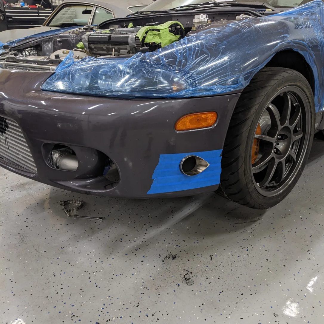

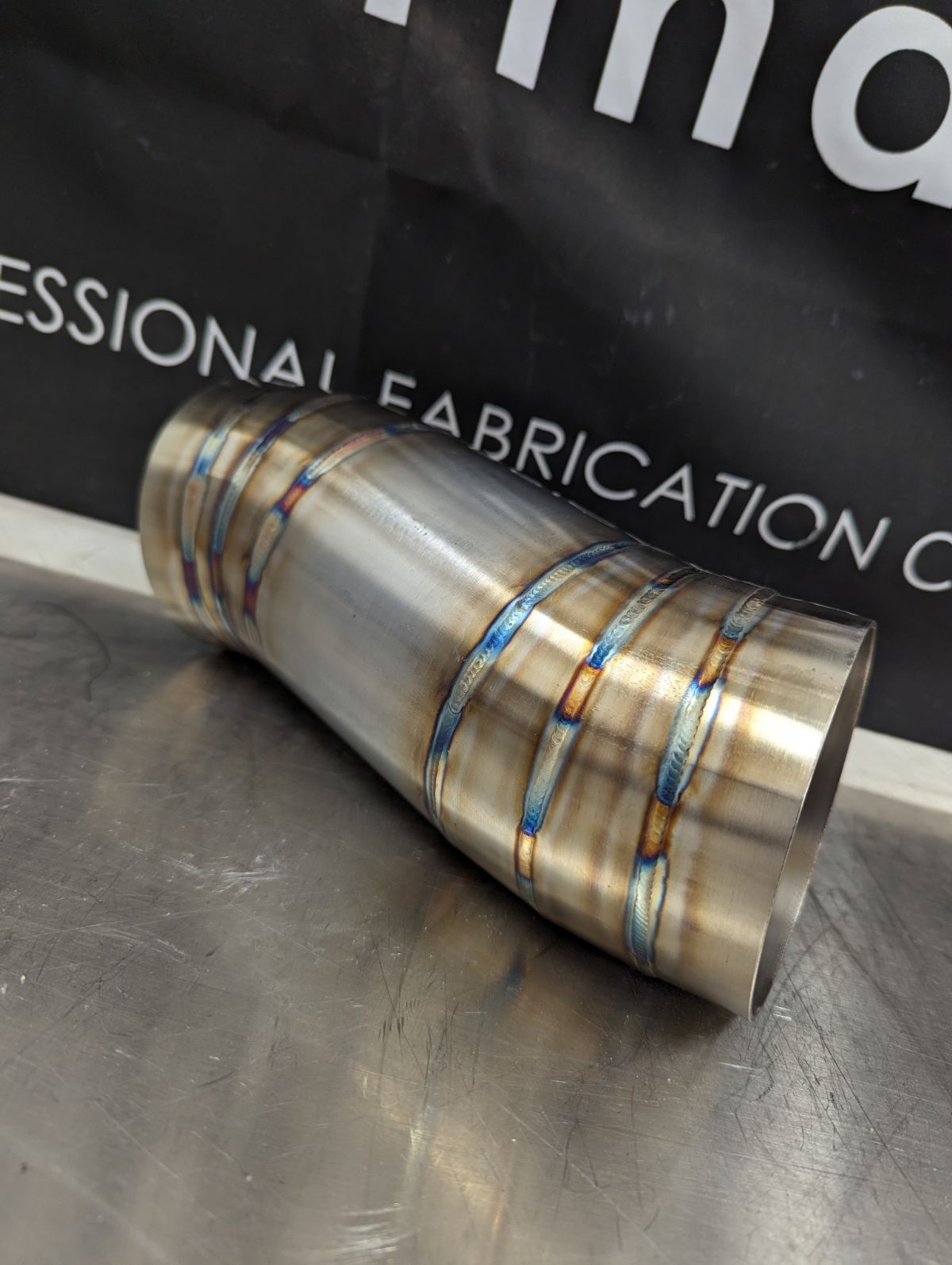

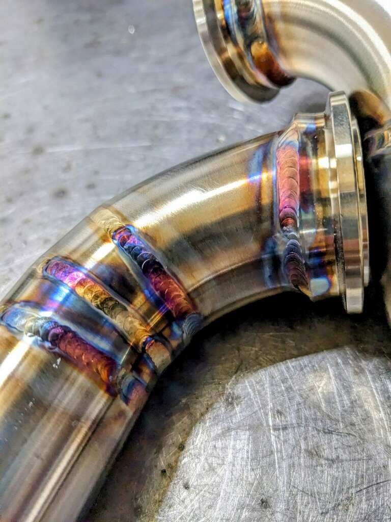

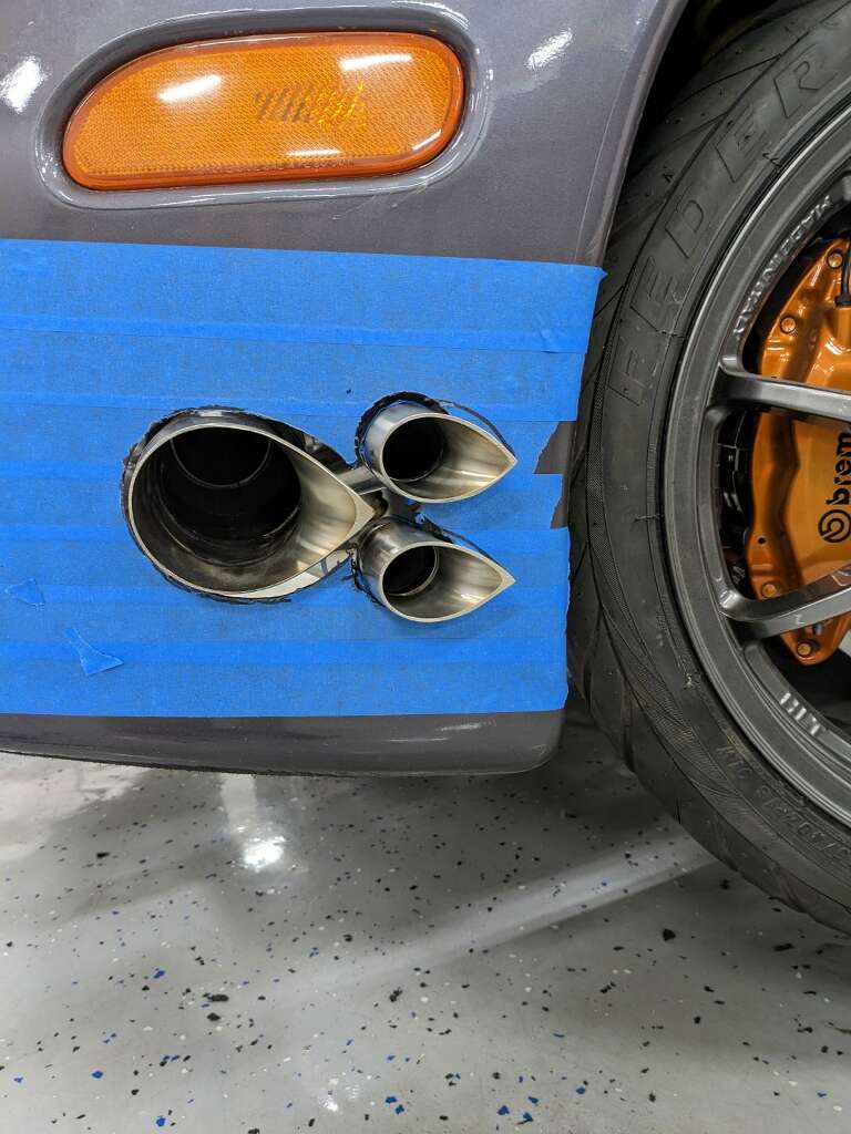

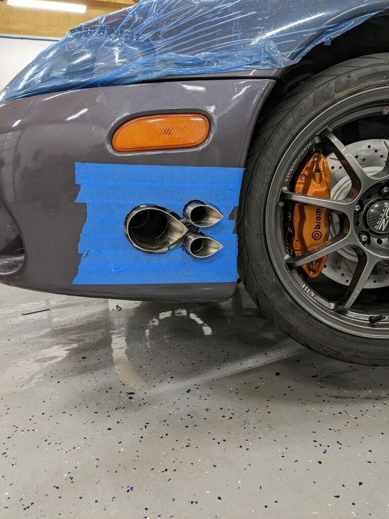

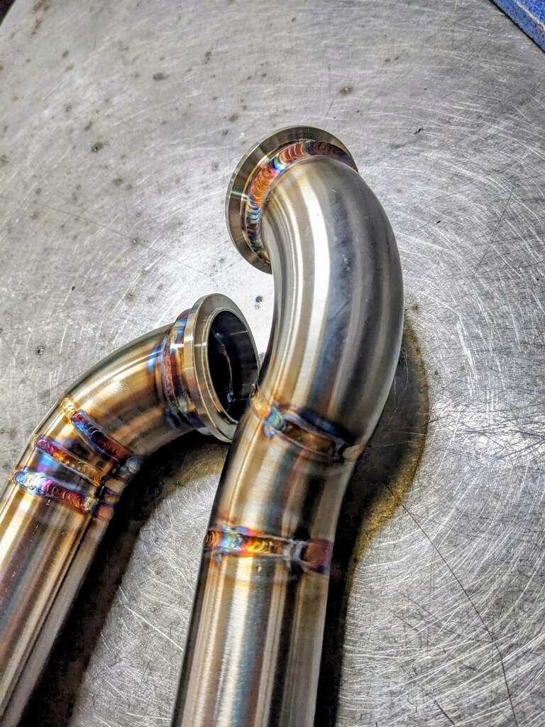

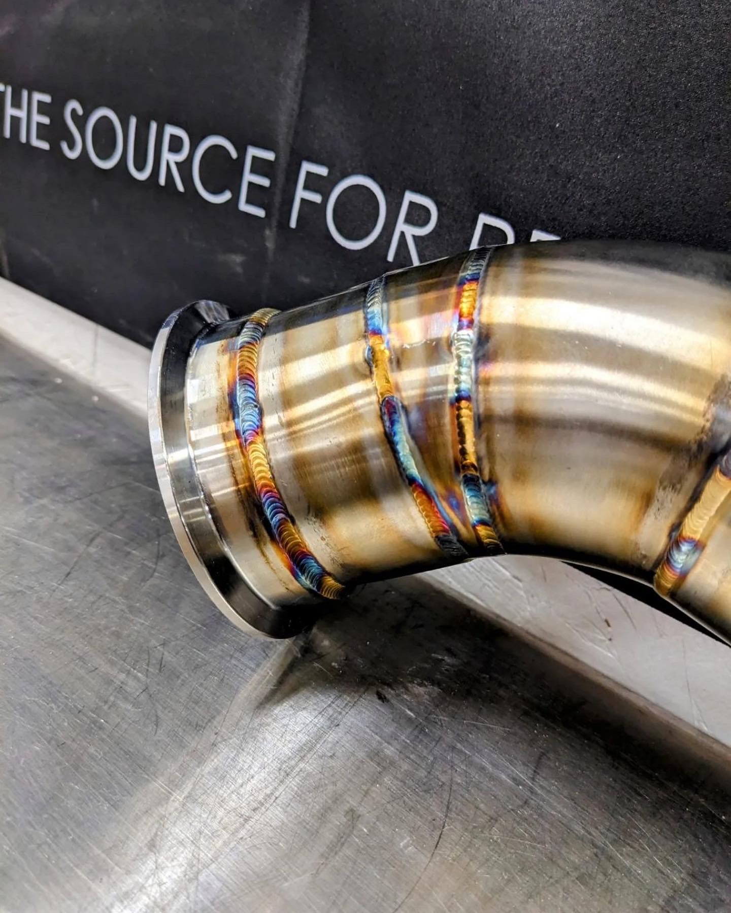

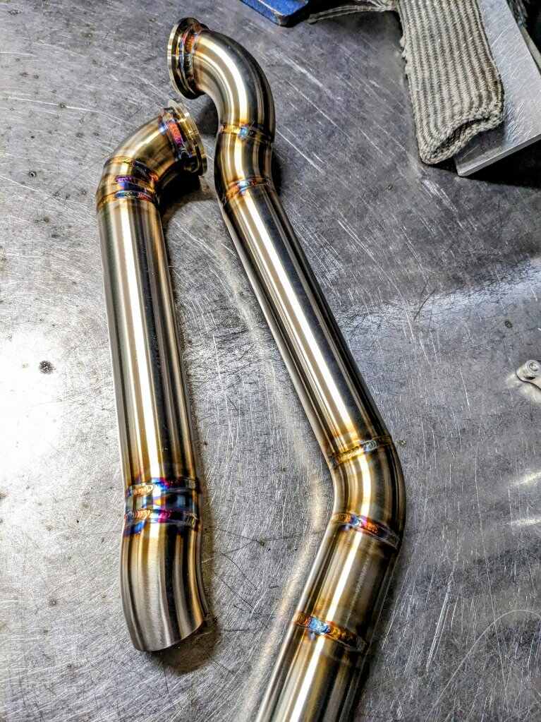

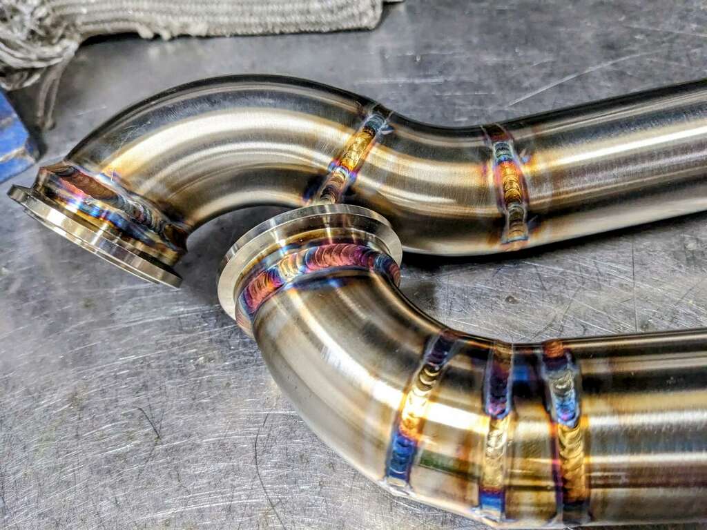

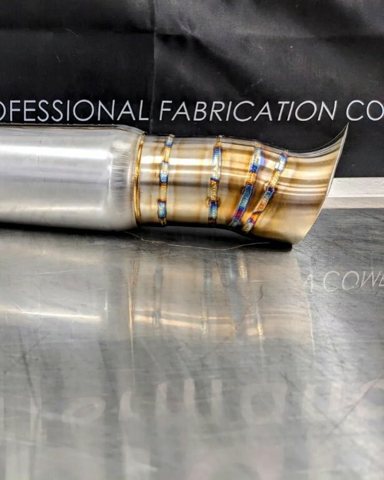

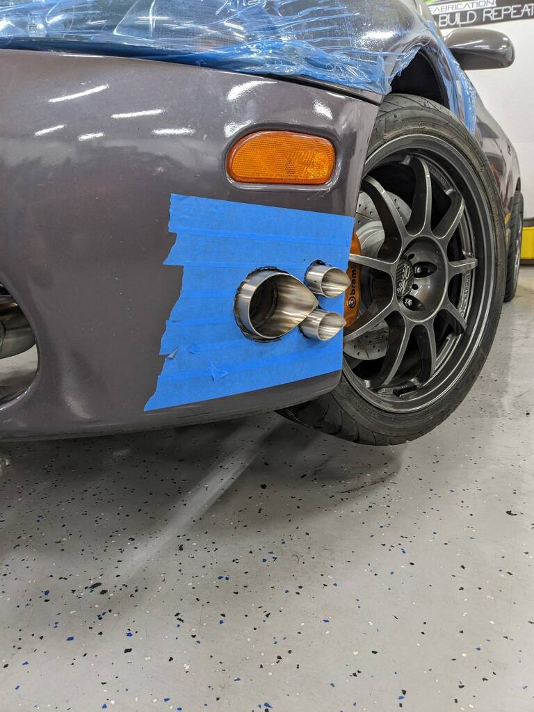

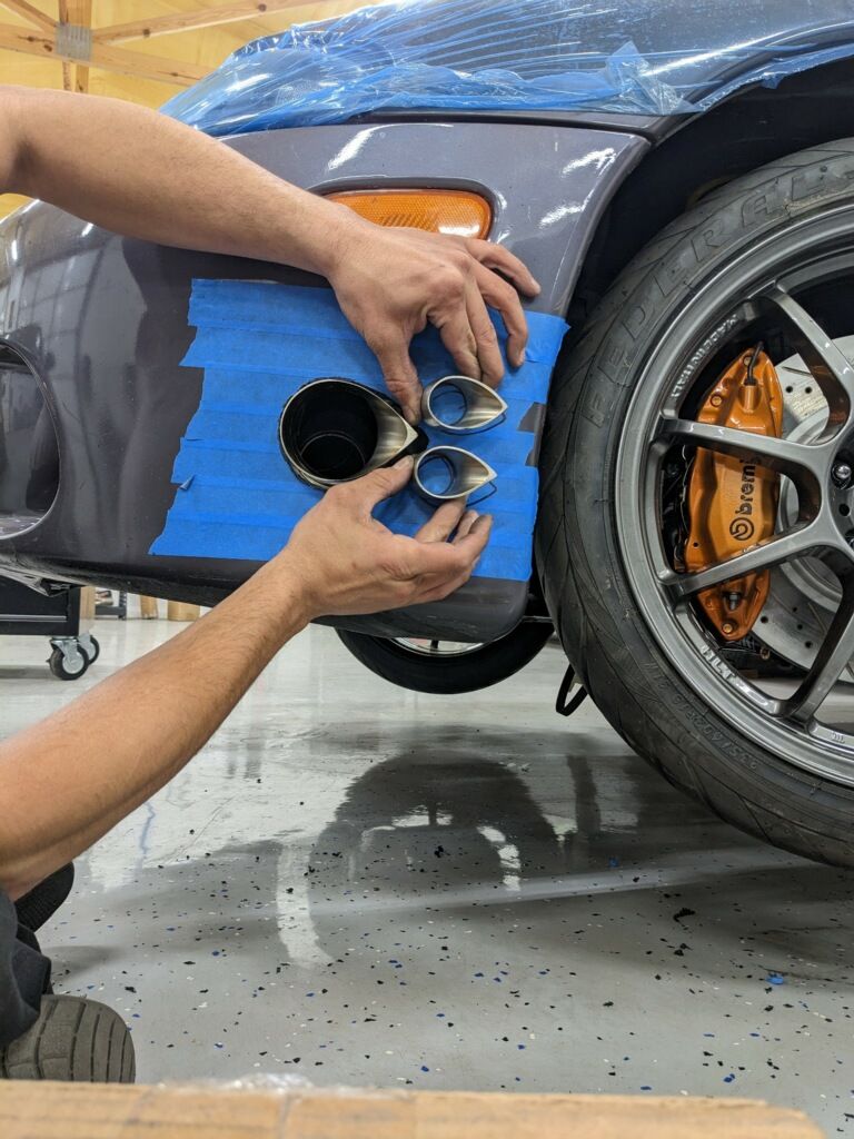

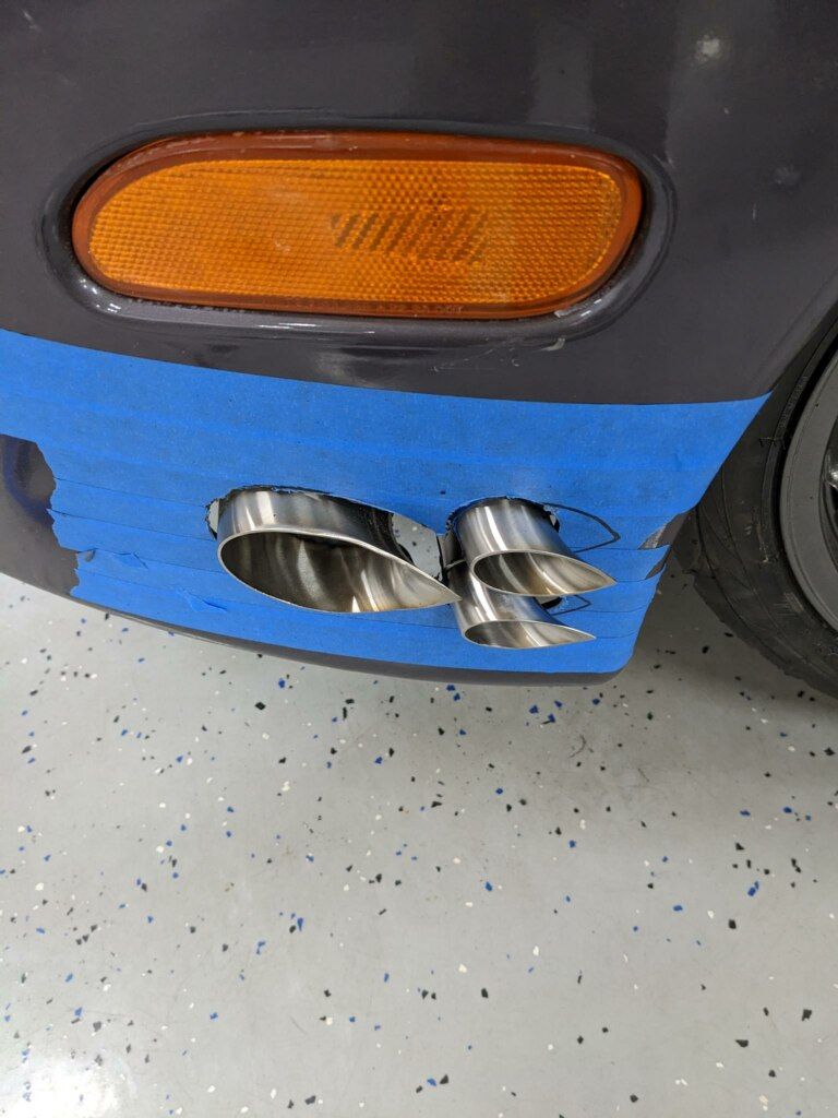

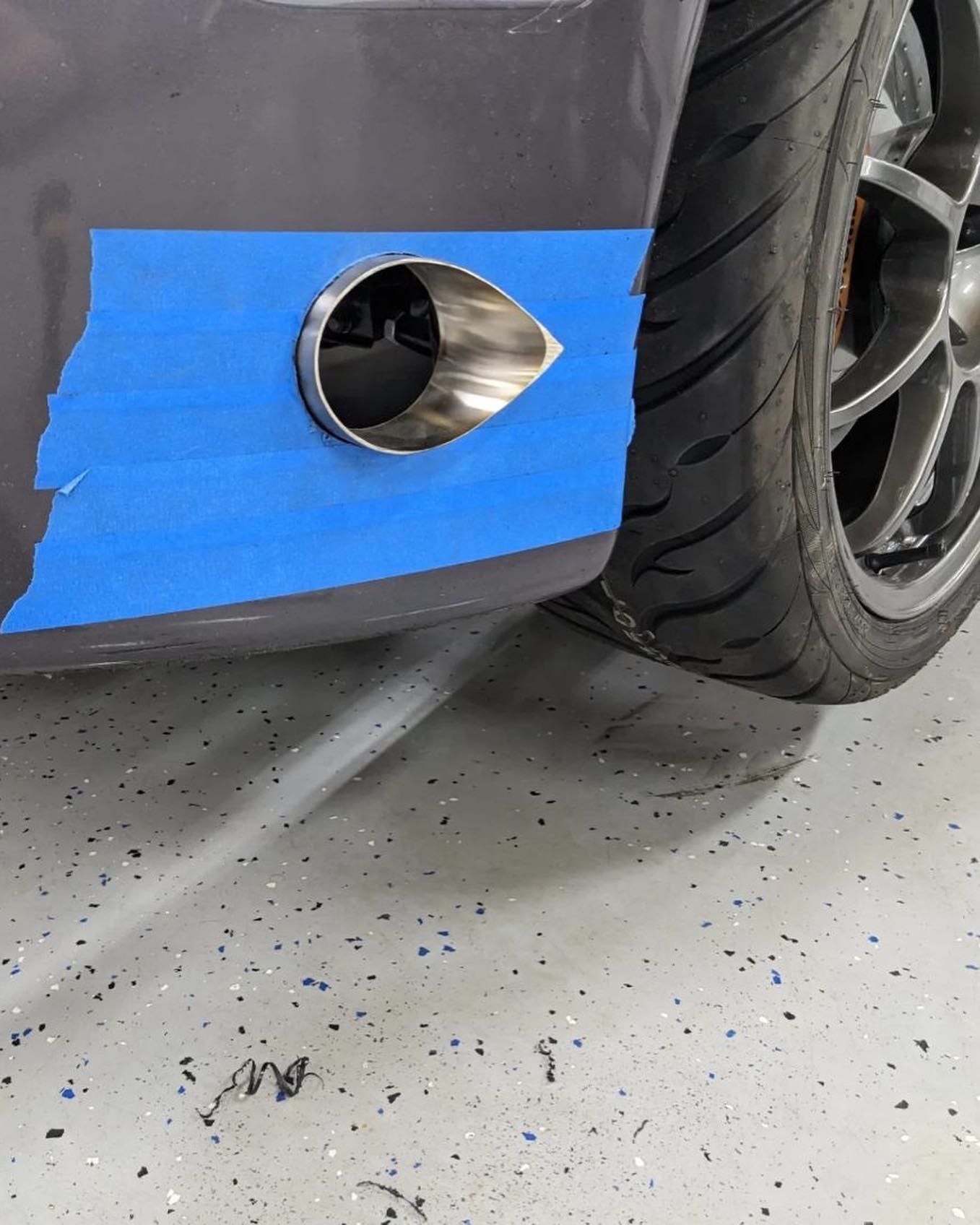

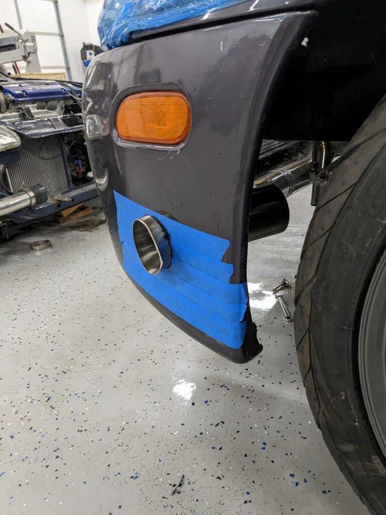

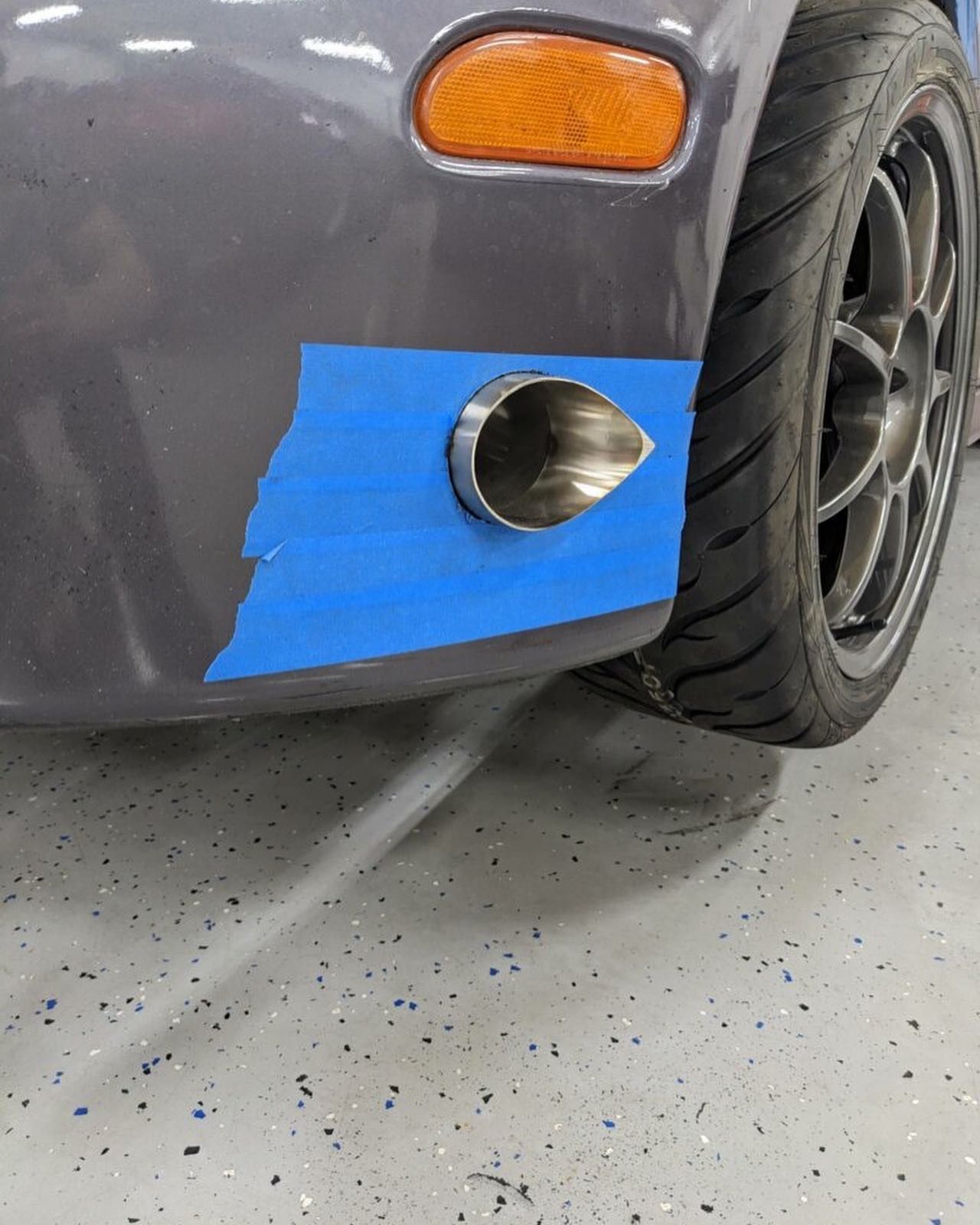

Next up is the stainless bumper exit exhaust and waste gate dumps.

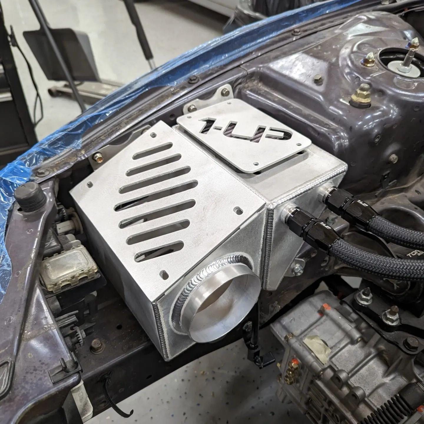

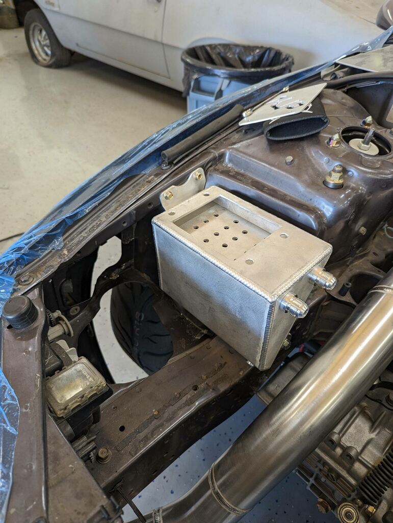

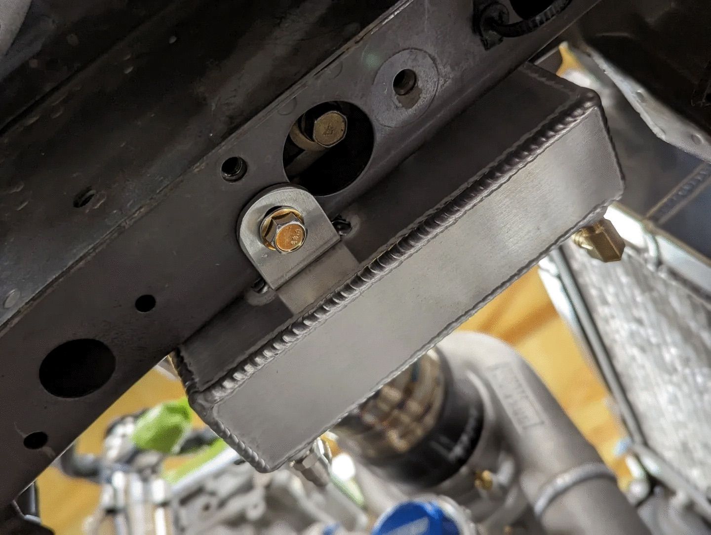

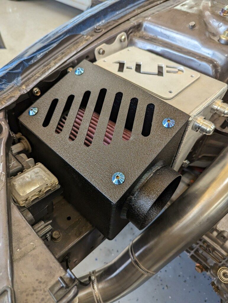

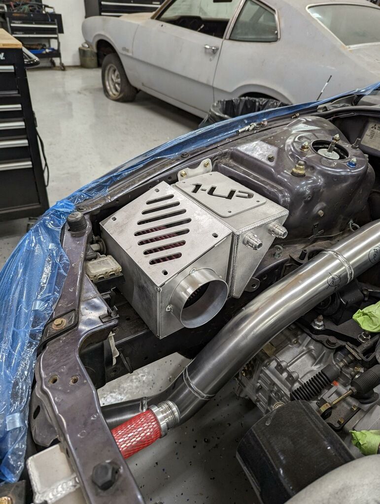

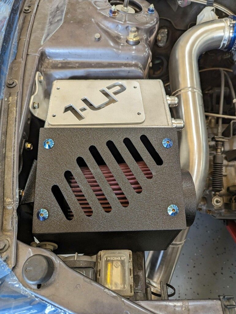

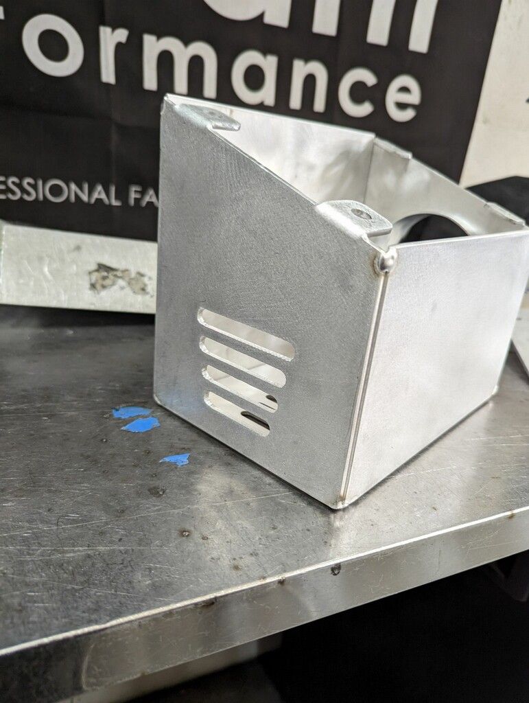

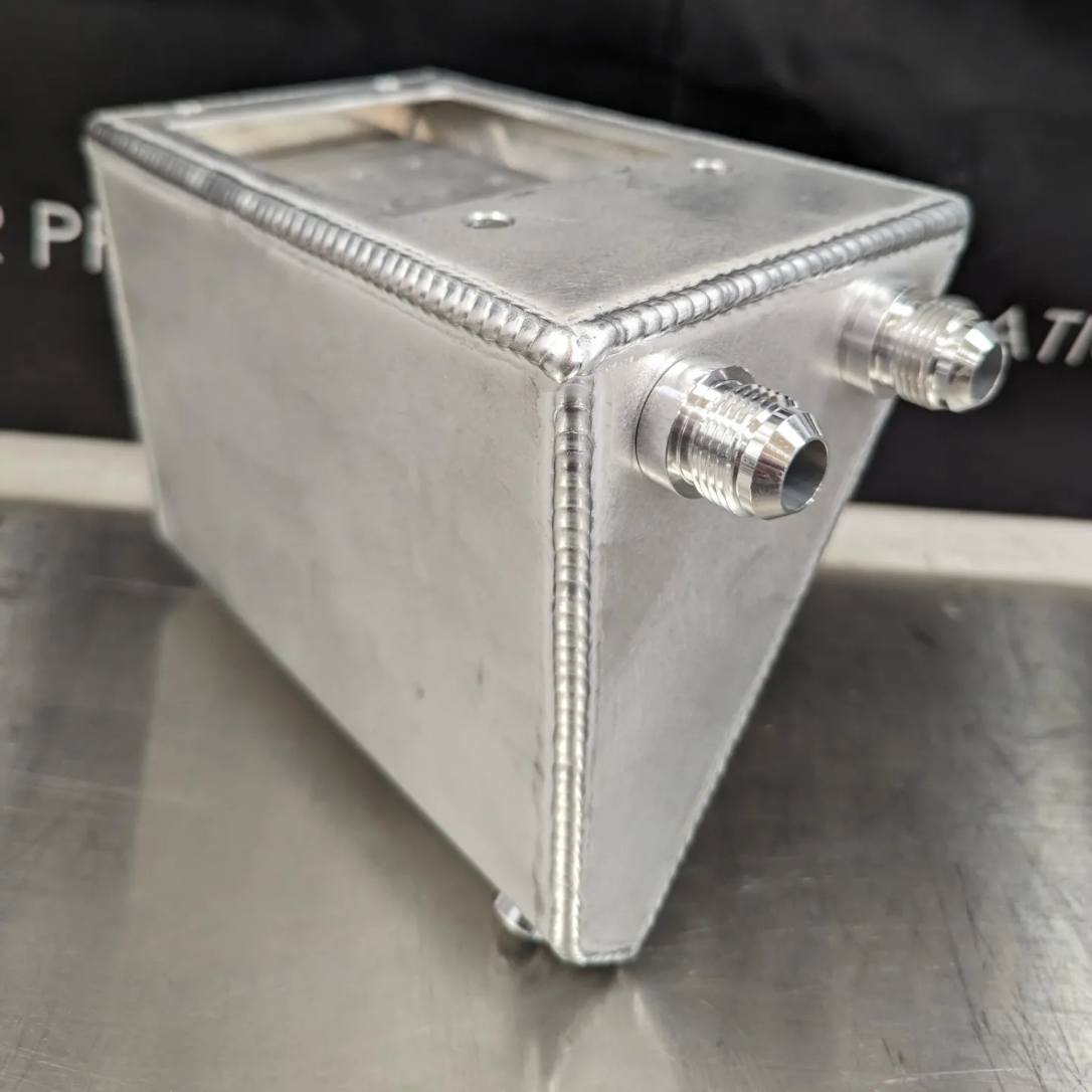

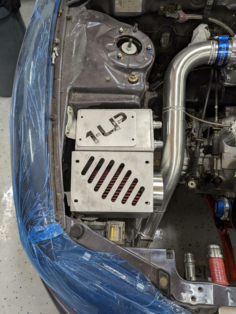

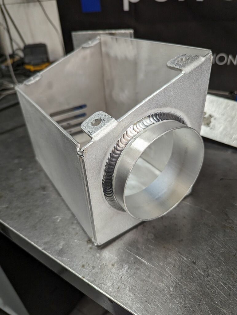

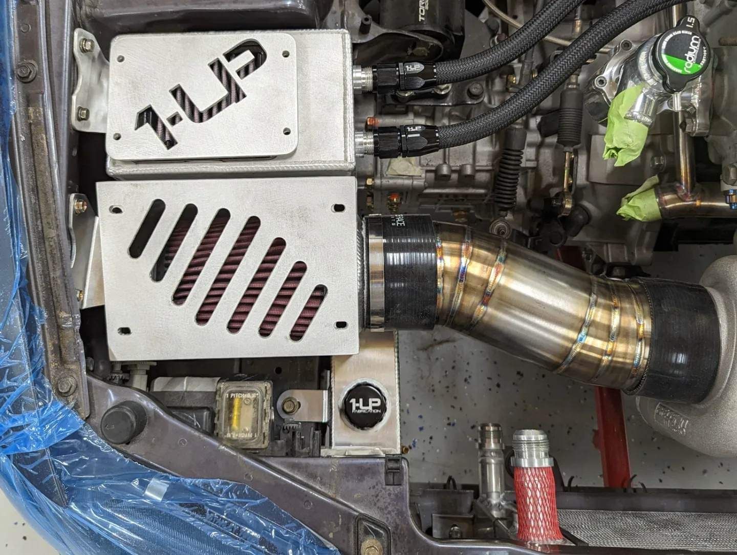

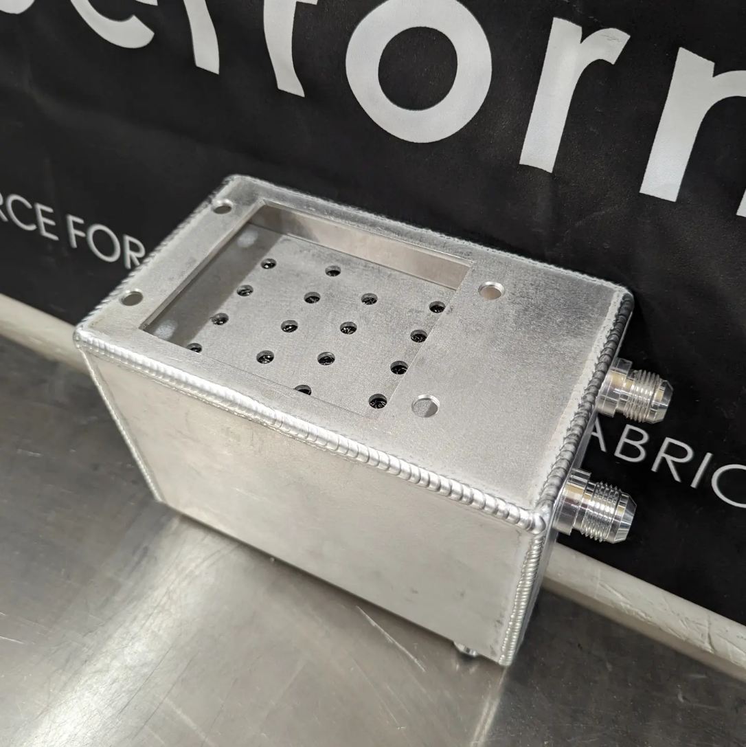

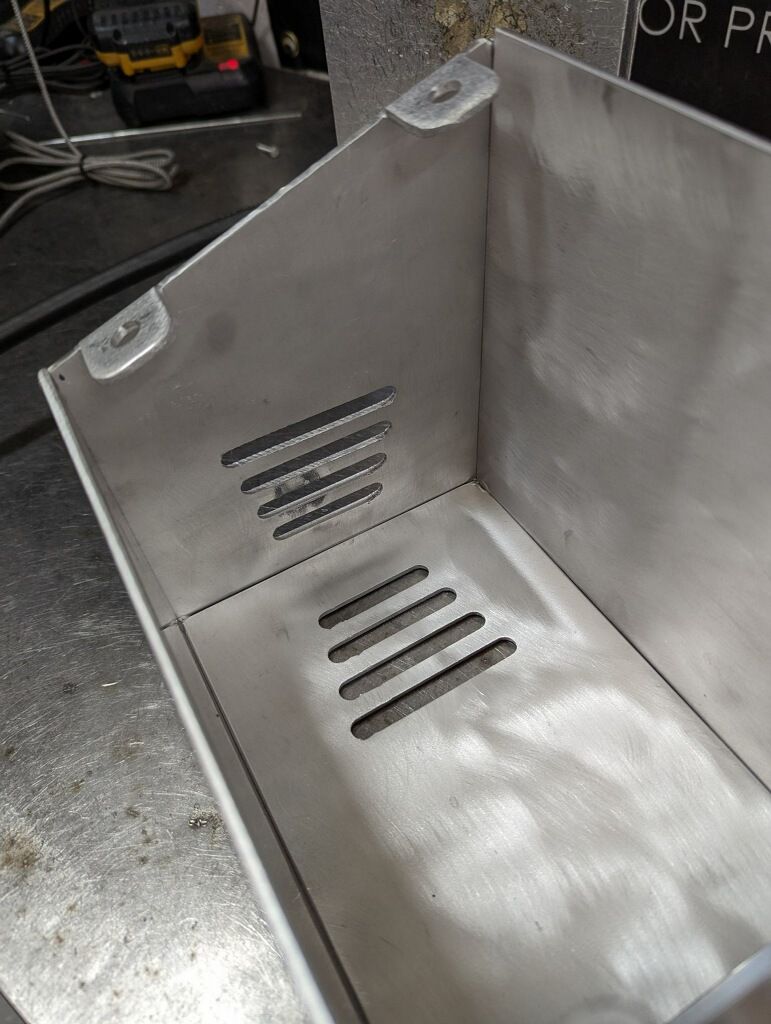

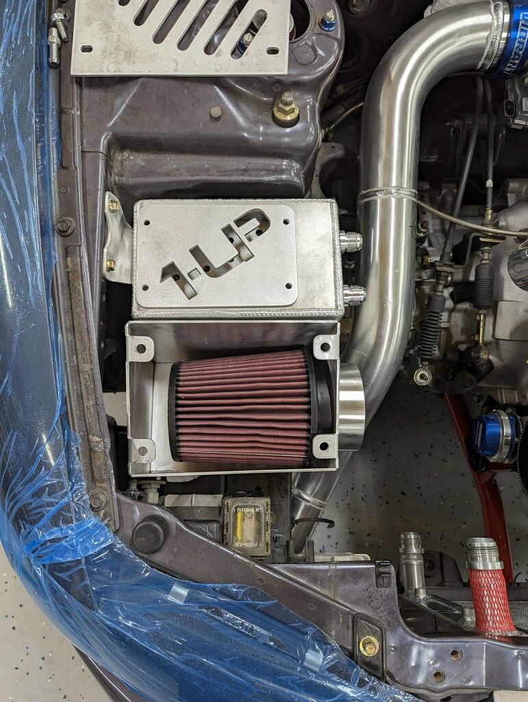

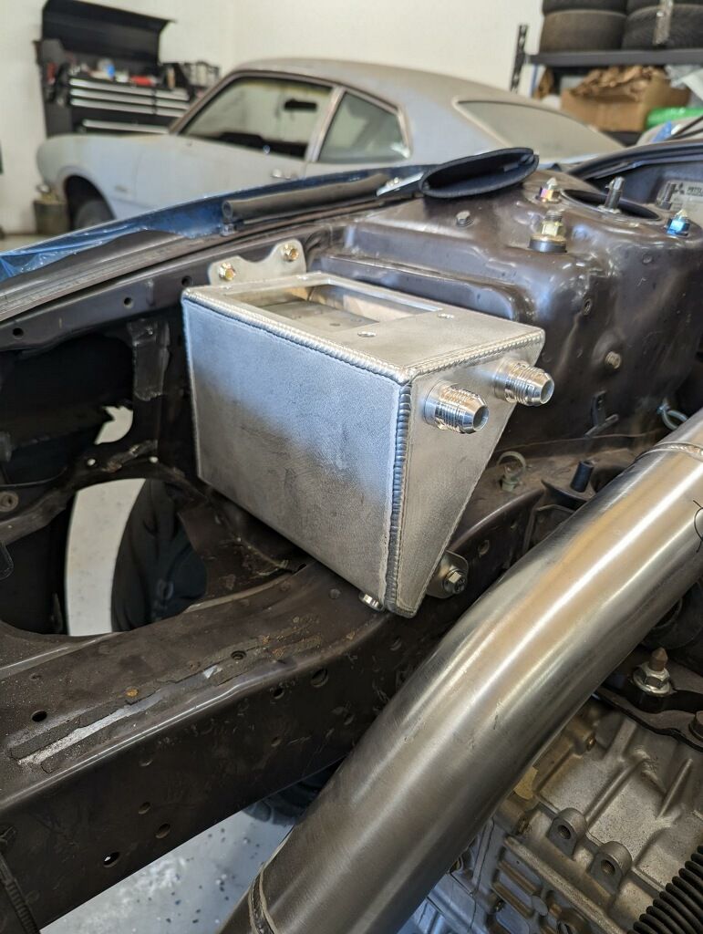

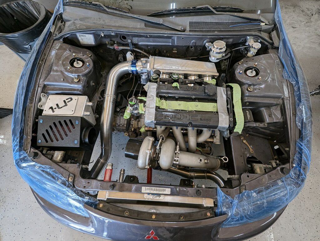

I guess I skipped the airbox Andy @1up-fabrication created for the 2g DSM using Scram_GSX as the prototype. (Along with the oil catch can and coolant overflow to come)
These will be available for our platform soon!

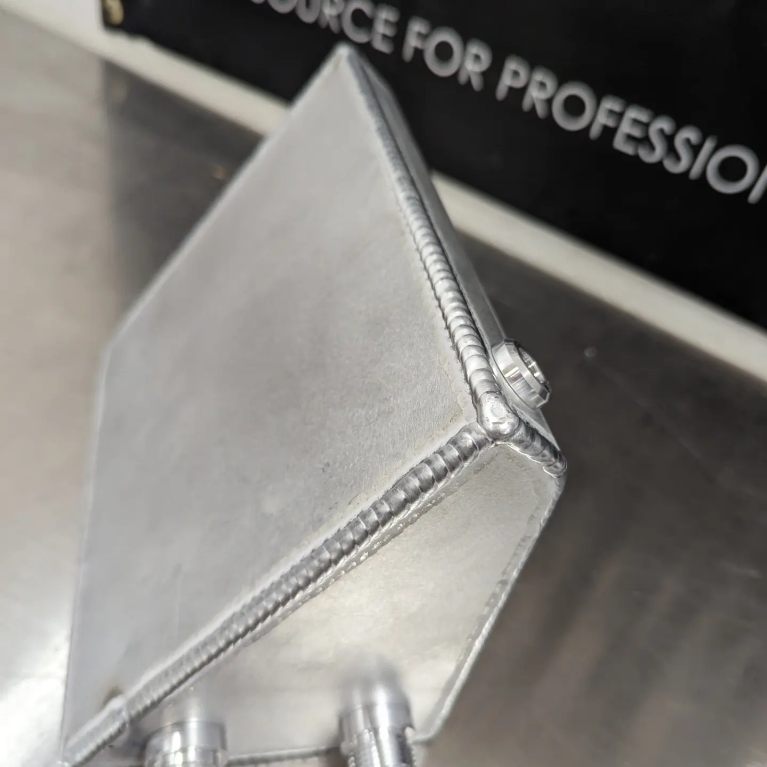

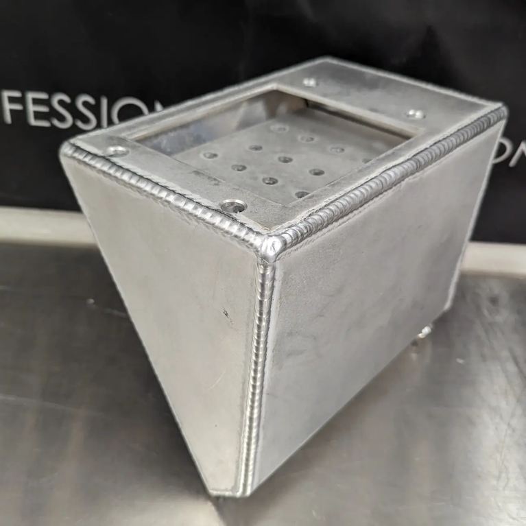

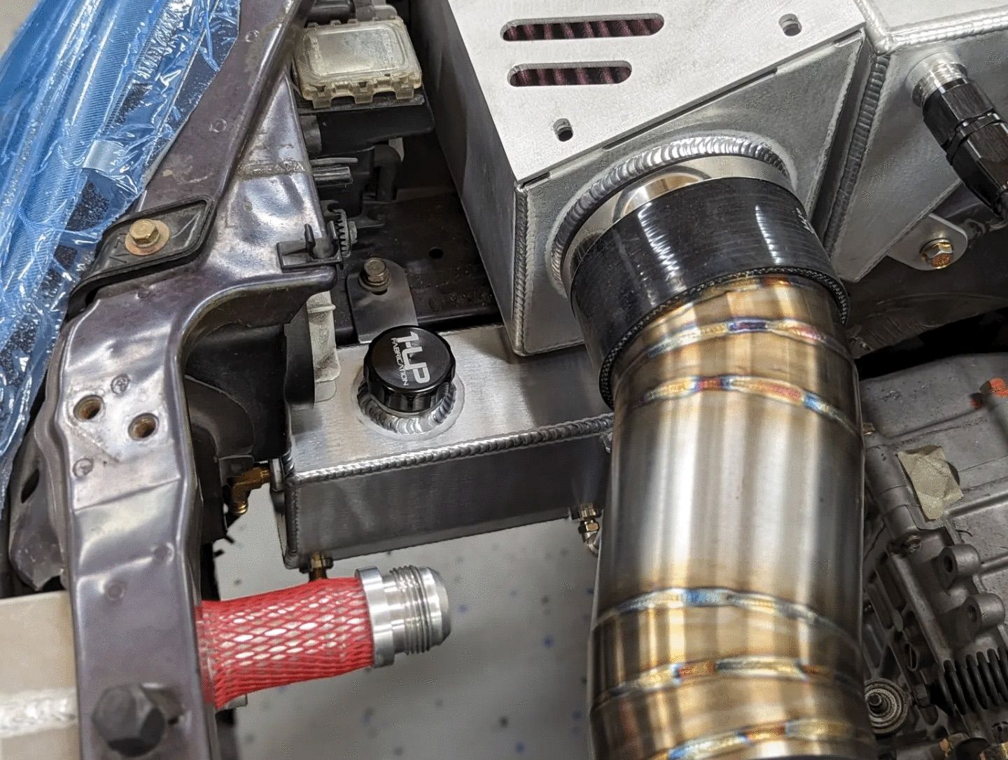

Alright everyone. Andy @1up-Fabrication knocked it out of the park with all this fab work. His 2G DSM Coolant Overflow Catch Can is finalized and will be available soon! So glad Scram could be his prototype model yet again. Every step gets us closer to the finish line!

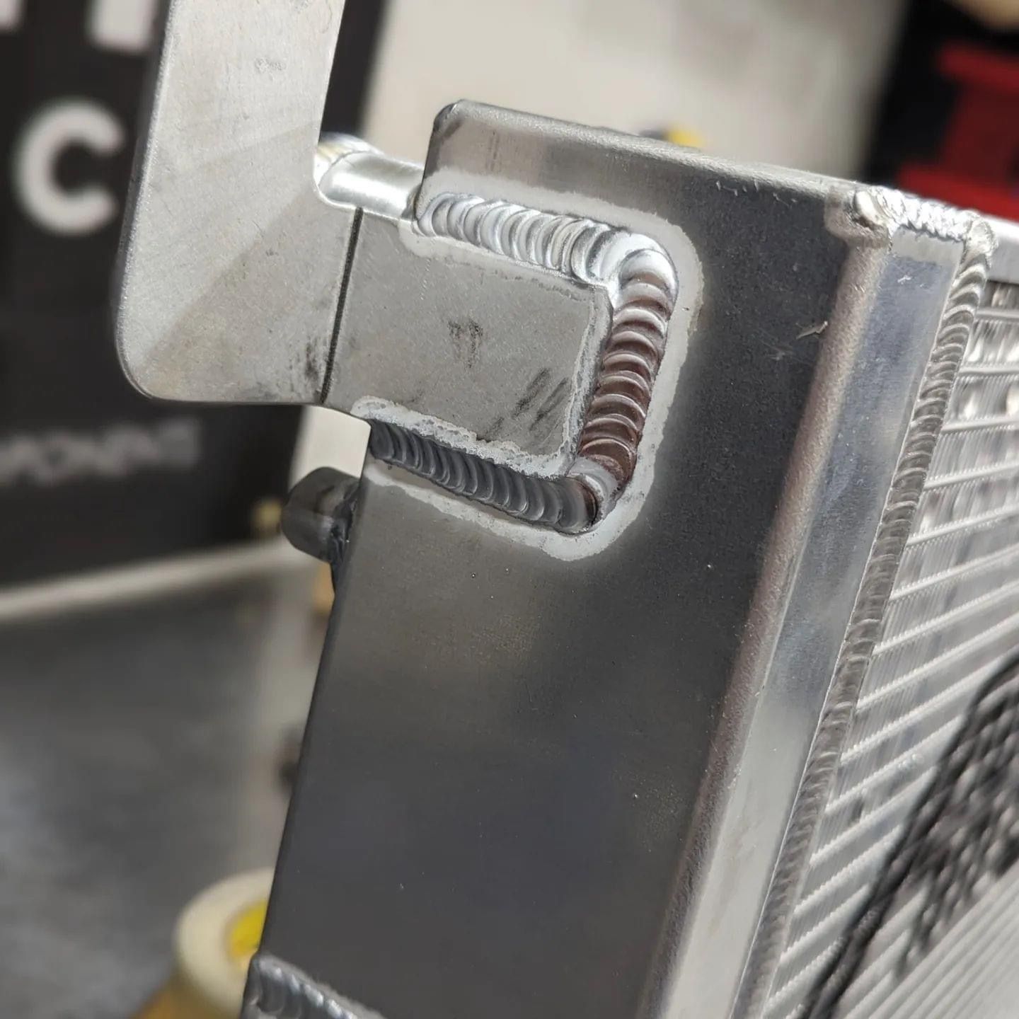

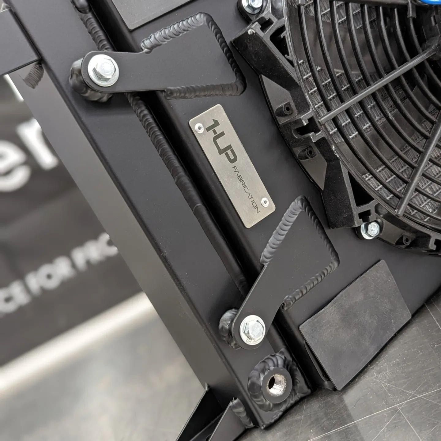

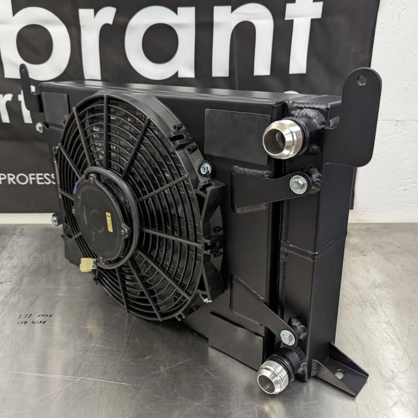

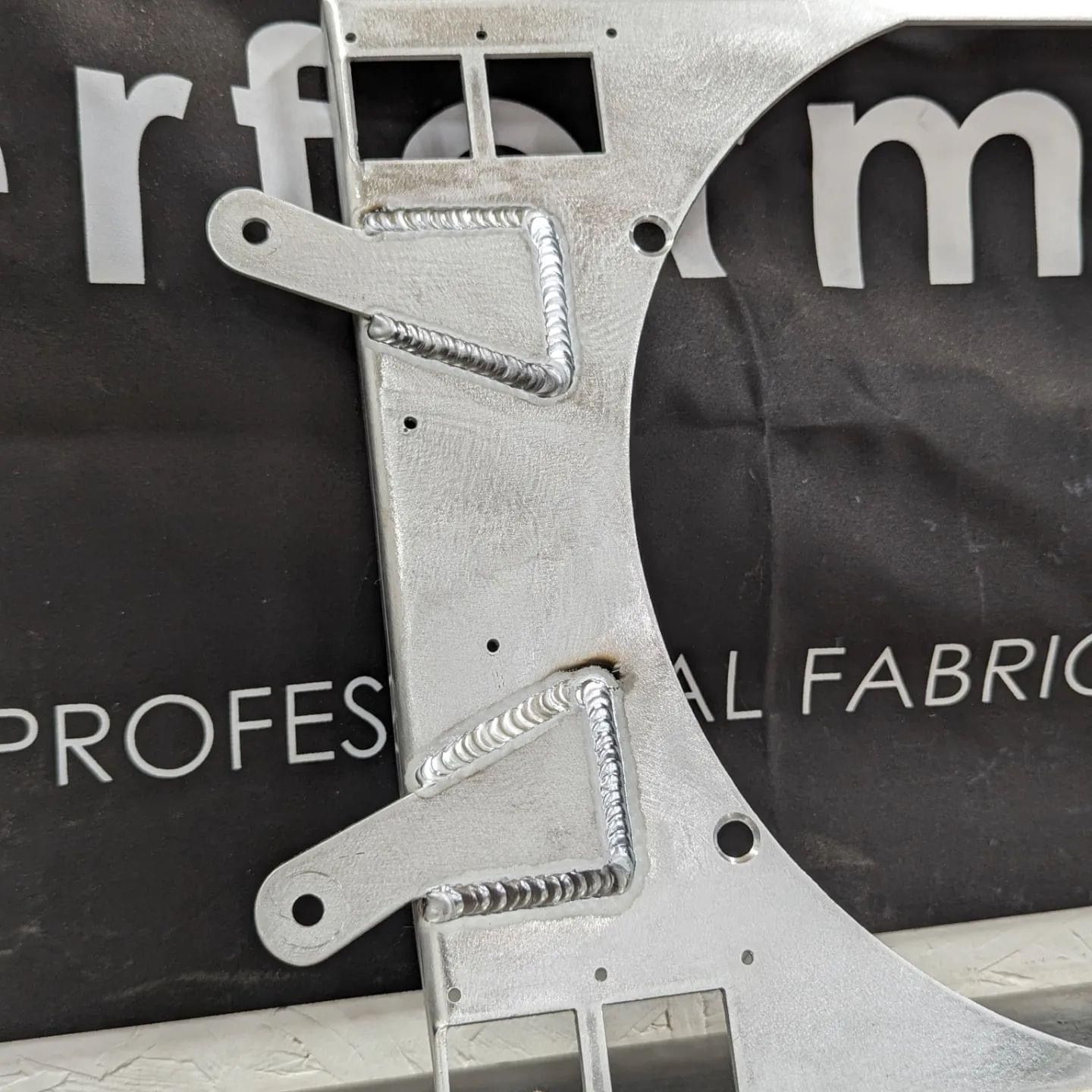

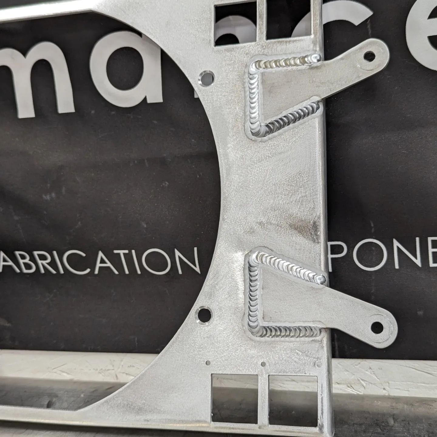

When I bought Scram_GSX from Kyle he had already acquired a nice AFCO radiator with -16 fittings and an aluminum shroud & electric fan, but there was not enough clearance between the turbo and the fan motor for my liking. Andy @1up-fab worked his magic again and whipped up this custom slim shroud to provide another inch of clearance.
