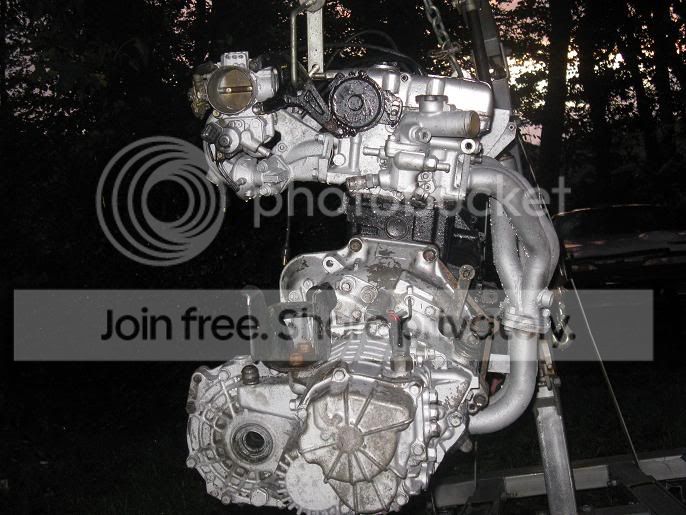

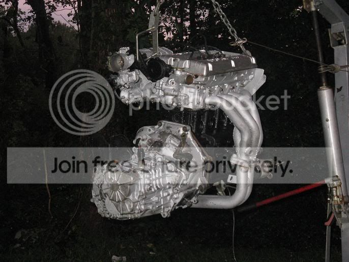

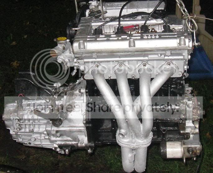

I bought a used pacesetter n/t 4g63 header for $100 :). Deal. Yes. But the good ol obx header on ebay is an identical 4-2-1 design for $150. IDENTICAL in shape, welding, everything but the pacesetter nameplate. Here's the header and head on the 2.4 block:
So total invested is a reasonable $80 + $35 + $16 + $150 = $280 . . . PLUS the 7bolt fly wheel for $60 more.

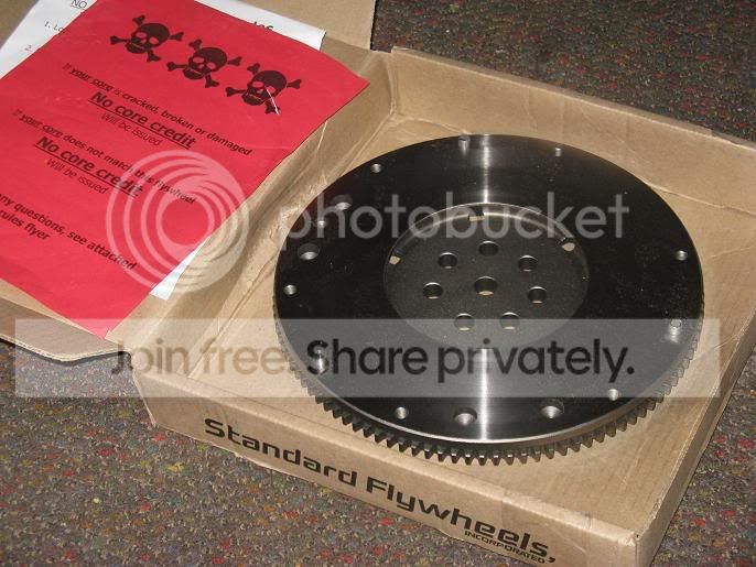

I had to trade up flywheels. I bought a refurbished flywheel from autozone for $60 The 6 bolt flywheel as a core exchange was accepted:

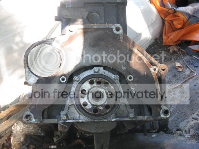

Here is the N/T 1g block plate attached to the 4g64.
As you can see there is space for the 3 o'clock bolt to hole to be used (the 1g tranny doesn't use this hole). This is good. This will be used for the custom 4g64 front roll stop. . . Which is actually not really scary. . . if you can take a moment to picture the combination of parts. This will be another blog.
