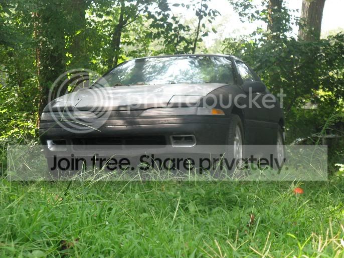

Here's the car I got for litterally free. The guy even paid the tow truck driver to put it at my house. 1991 N/t 4g63 Plymouth Laser. With no radio. It has a clean interior and no rust with kyb struts all around. . .
