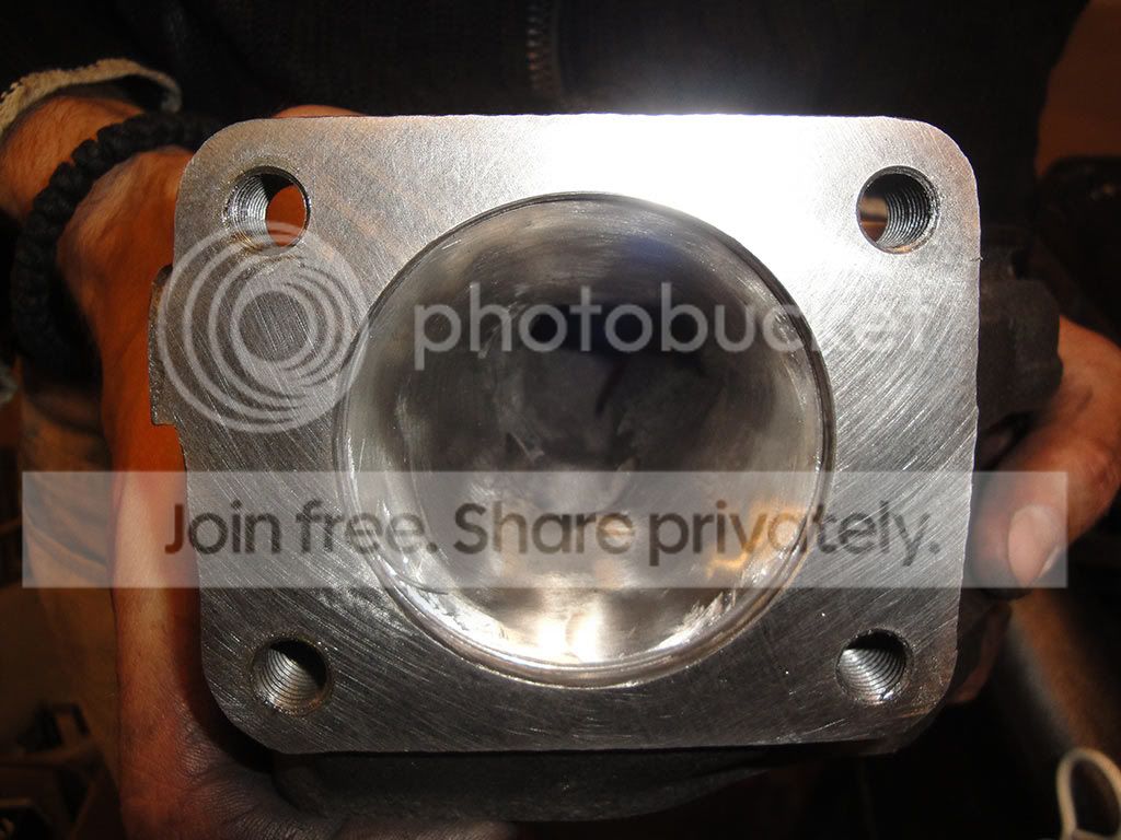

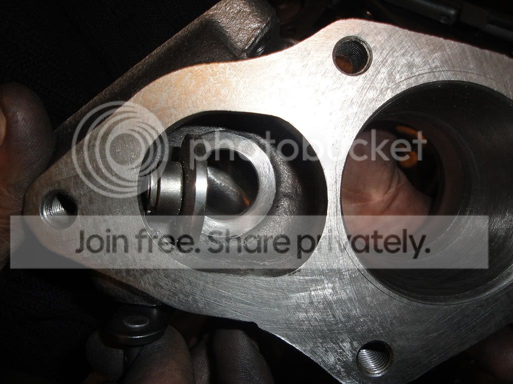

This was done yesterday:

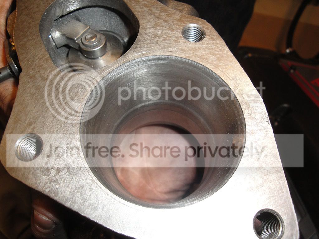

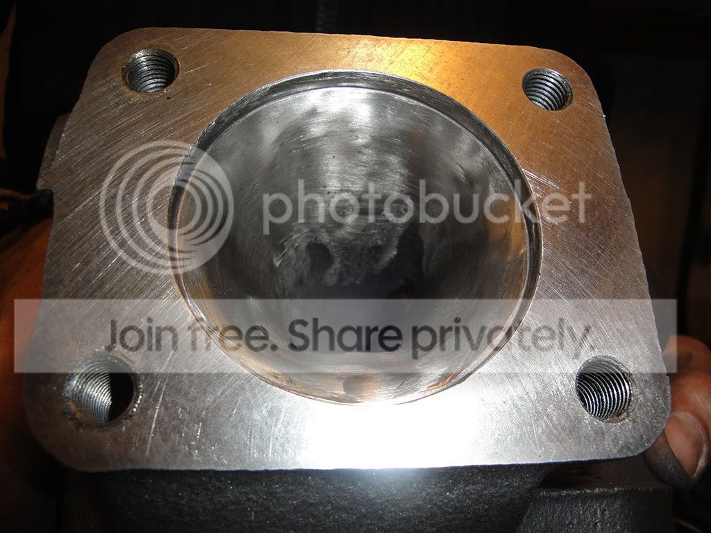

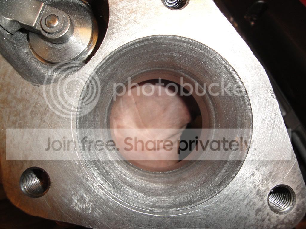

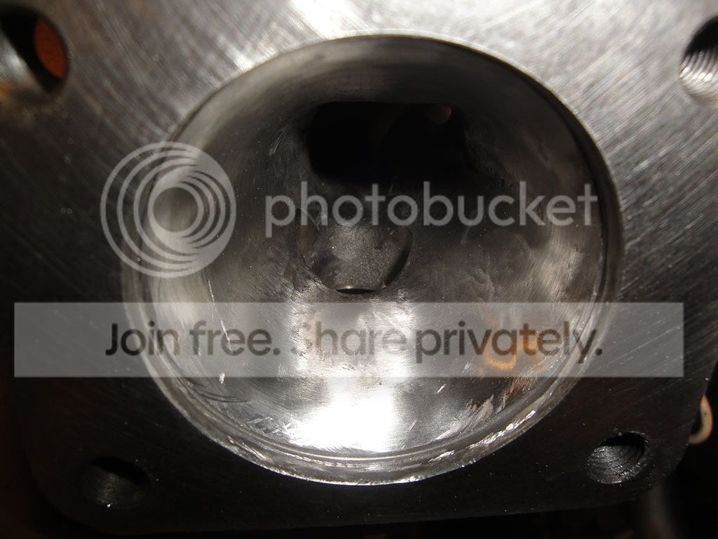

Ported turbo. How does it look, guys? Does it need more porting?
not fully 90 degrees opening, but it is a lot better than stock.

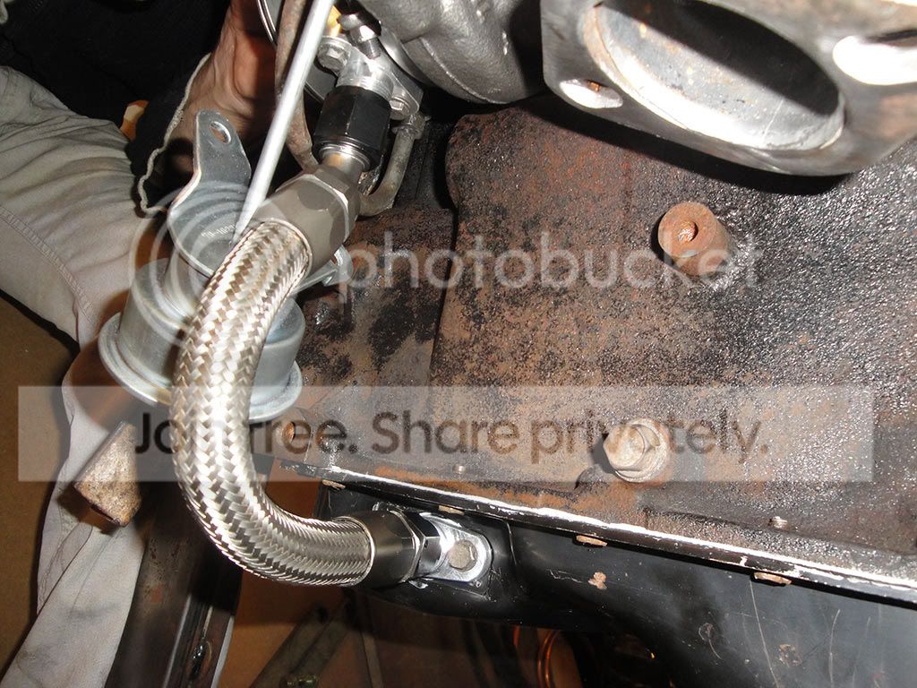

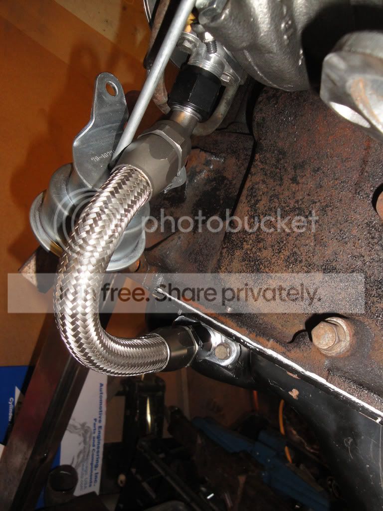

STM Oil drain kit. Does this look like a proper install? Tried to put the straight fitting on the turbo, but they do not match with the 45 degree on the oil pan. The hose had to be S shaped which didn't seem right, so I put it that way. What do you think. Will it drain fine?

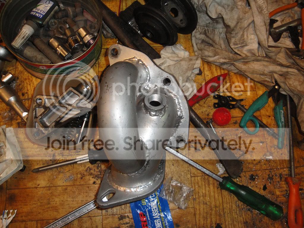

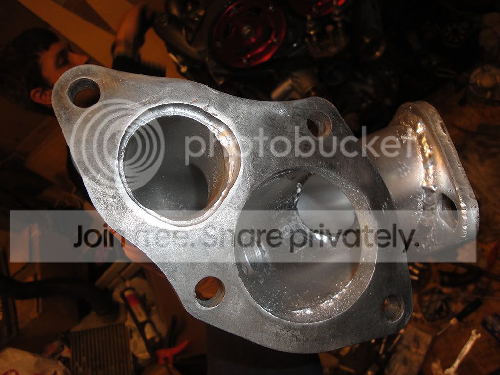

o2 housing - got it from a guy here on DSM tuners. It was supposed to be punishment racing, but I guess he lied in his ad.

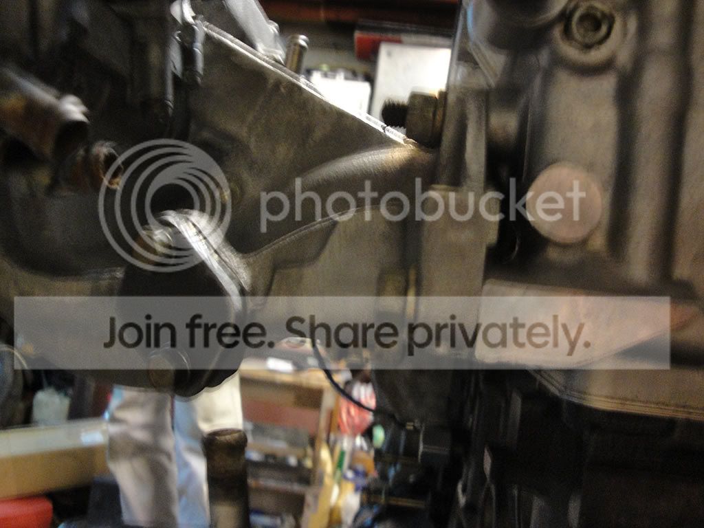

So what happens now is there is so little space between the o2 and the steering pump bracket that the oil dipstick had to be bent a dosen times to fit in between.

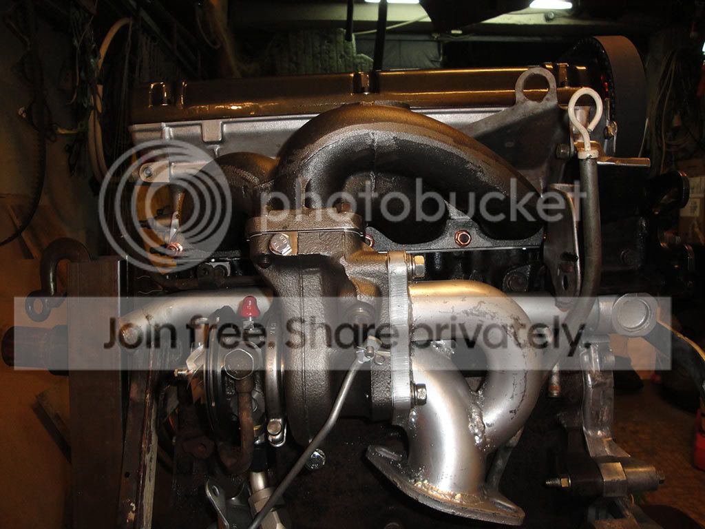

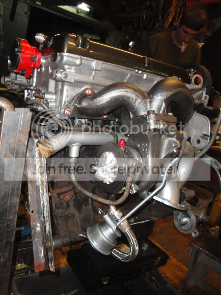

The turbo on the manifold. I just love the FP Race :) We are fabricating the compressor housing of the turbo so it points downward-ish.

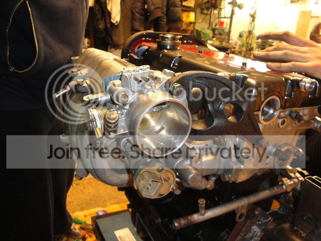

The NT polished throttle body. The bracket used to lift the engine is different from the turbo TB so it had to be changed as well. Luckily we had one from the NT engine...

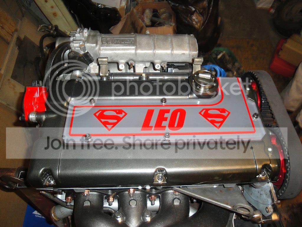

And lastly - I got a surprise! A custom spark plug cover with my name on it. My nickname over here is Superman and they decided to put his logo. I personally don't like the red line and the superman logo, but will stick for a while with it. The cover itself is gorgeous, doesn't look so on the pictures though. Plus a blacktop CAS :)
happy superman :)
i like the superman/leo sparkplug cover. very cool. porting looks Great too, just port the sides out a little bigger, and port match the WG flapper. I think porting the WG flapper is pretty important, we didnt do port match the flapper on a friends car, and his was spiking to 20 with a MBC. But i guess that wouldnt matter if your running over 20 psi, but i think its good to do anyway. That o2 doesnt look like my ebay o2, where the WG hole was round and tiny. It may be a punishment racing o2.
