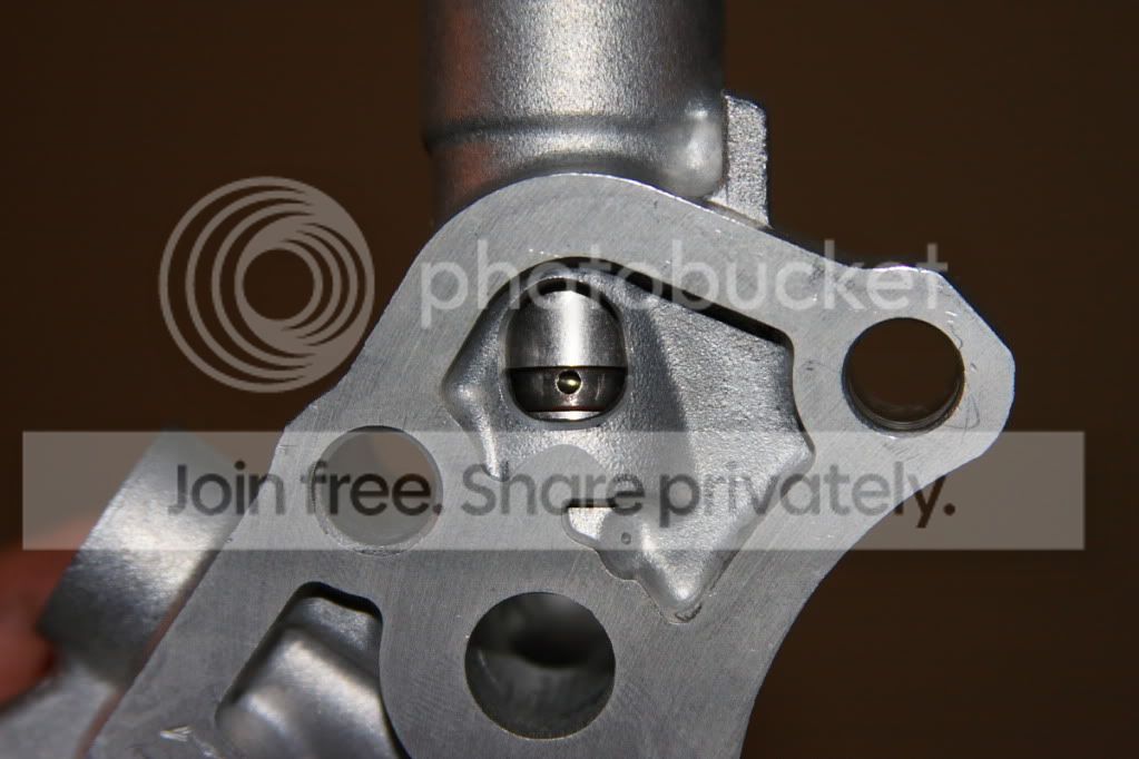

I spent a while today trying to find all the front case bolts. Made a little progress and ported the OFH.

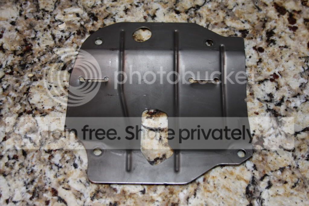

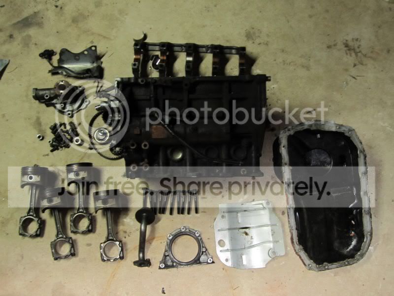

I tried to find a 2g windage tray but couldn't locate one. However, I got an Evo tray and the bolts and almost everything else is the same but there is a large opening on the Evo tray where the 2g tray doesn't have one:
Evo:
2g:
