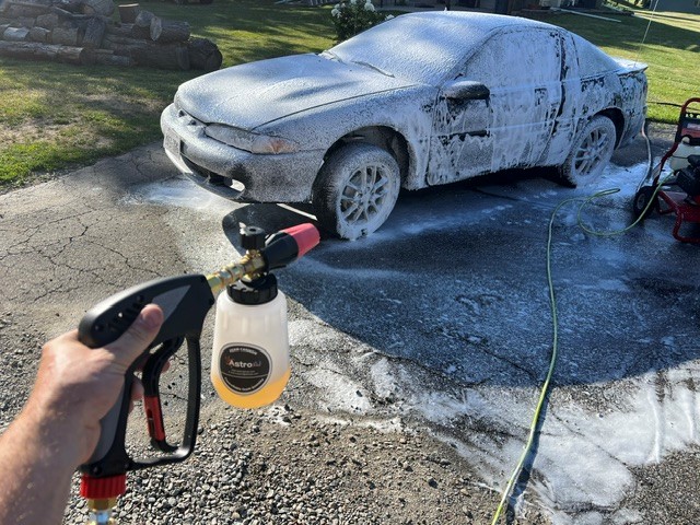

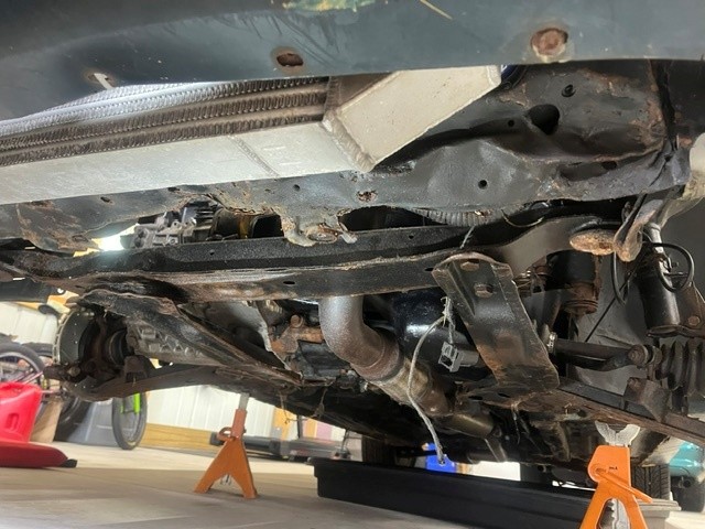

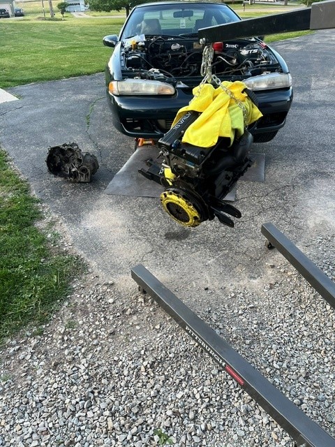

Last night I was laying under the car with the power washer till after dark.
Everything underhood and underneath is a lot cleaner and I was able to push the car back in the garage.
The driveway was absolutely full of crunchy crusty stuff this morning as I walked out to go to work.

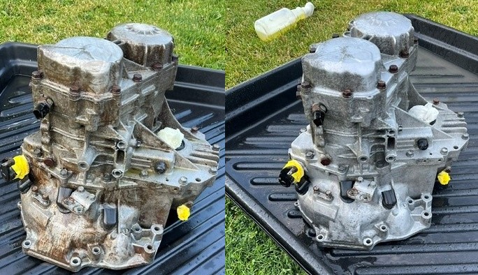

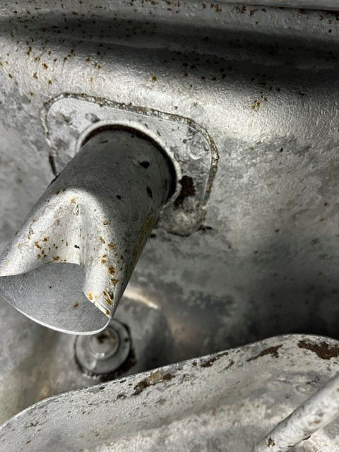

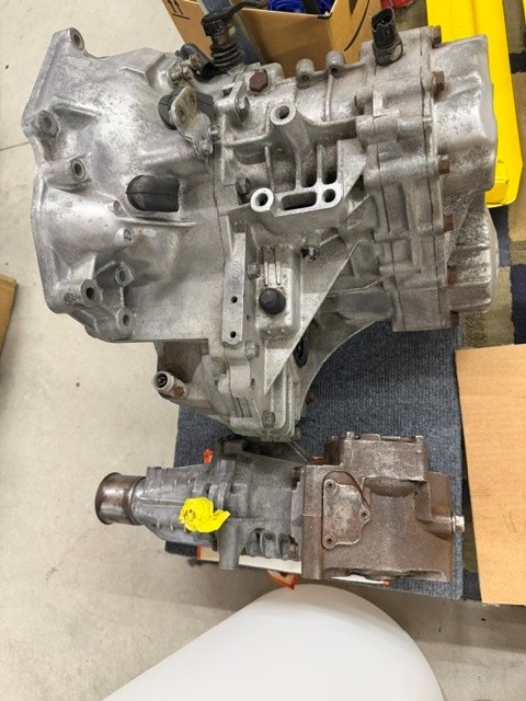

Added a picture of cleaning the transmission with S100 degreaser mixed 50/50 with water.
Sprayed it on, let it sit 5 mins, hosed it off.
At some point I'll use this as the ultrasonic solution and show how amazing it works.

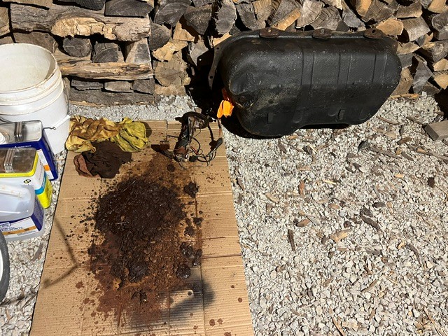

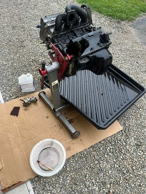

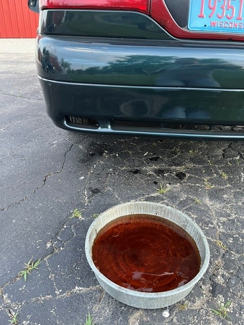

The pan of bad gasoline has been sitting outside evaporating off and there is 1/4" deep slurry at the bottom of the pan now.
So if you need to get rid of some, it seems to go away pretty quickly this way.

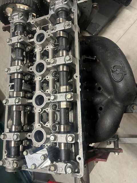

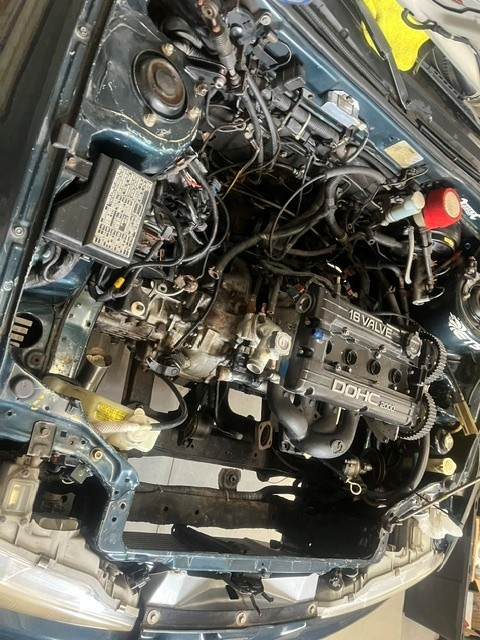

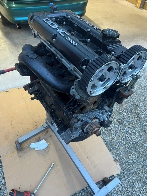

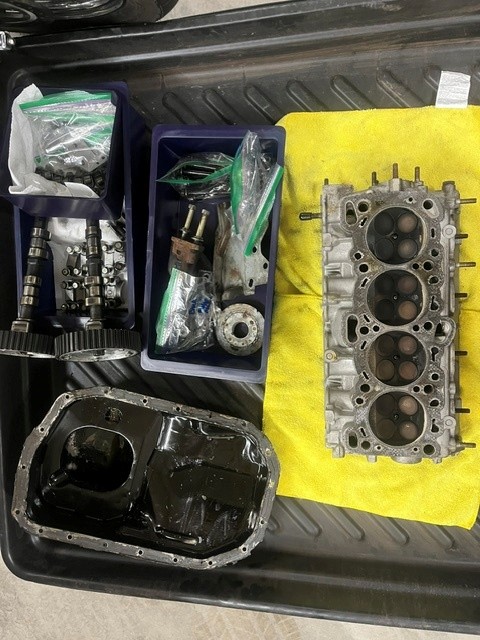

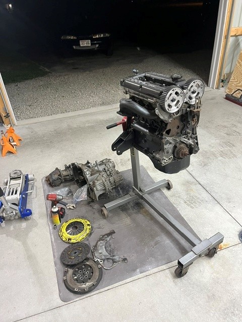

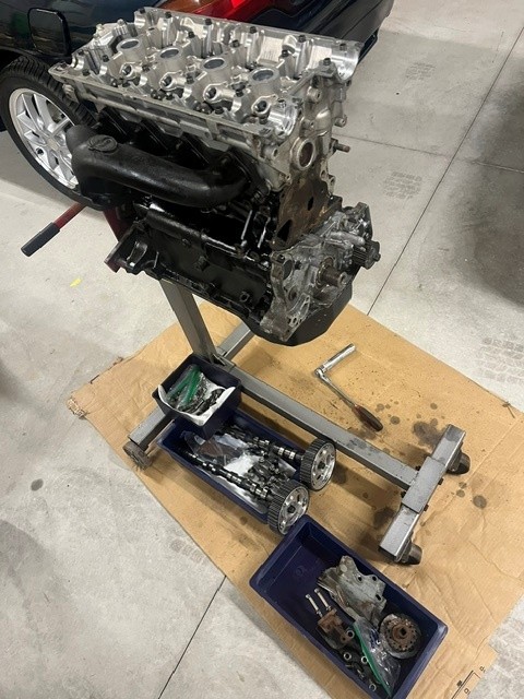

Last night I spent an hour on disassembly; valve cover off, valvetrain removed, exhaust manifold studs soaking in PB blaster, bagging and tagging hardware for cleanup.
Overall happy with the ''re-usableness" of what I see so far; all rockers roll nicely, cam bearing journals look alright.
I am planning to send the head out for a once-over and new valve seals.
The lurking shortblock concern is knowing I ran this ~30Kmi on Rotella oil with an un-cooled NT filter housing.

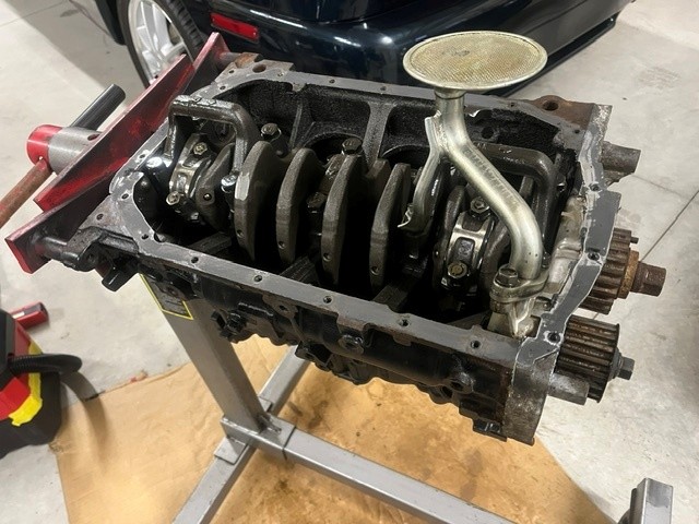

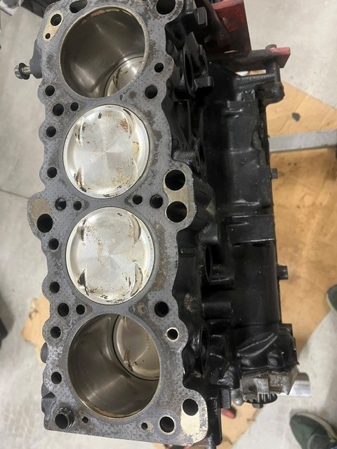

Have things down to the shortblock and the bores look good. We're looking at .5mm over Wisecos and 1G big rods.
Struggled getting the pan off more than normal because I used Right Stuff. But also it wasn't showing signs of leaking.
The alternator bracket/WP bolt is broke off flush in the block so I will have to work that out.
Parts cleanup, parts ordering, and more disassembly to come.

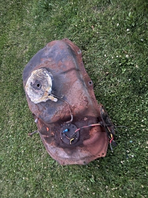

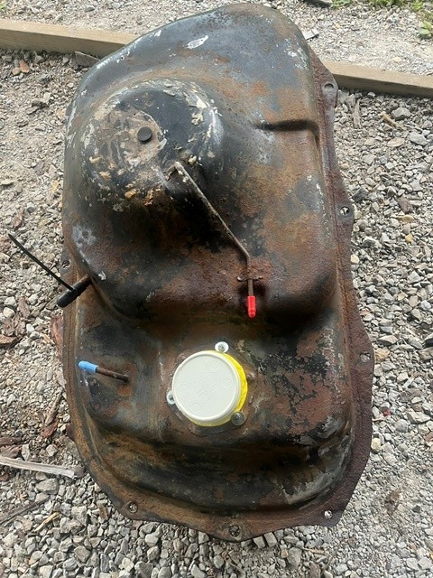

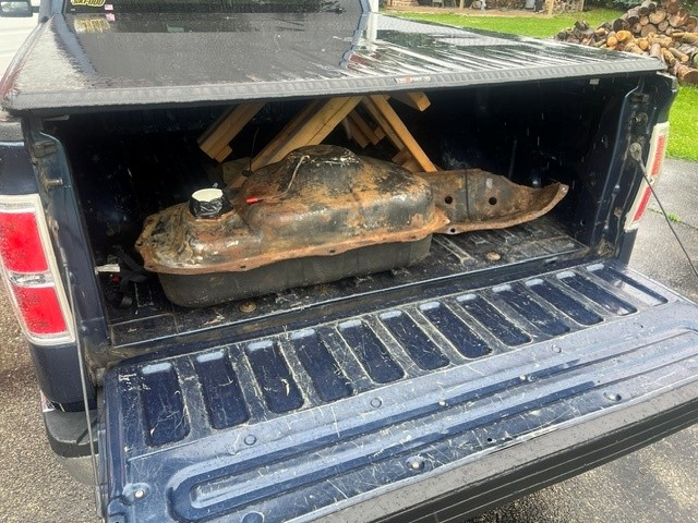

Over the weekend, I got into the gas tank. This is a multi-step, multi-day deal.
There are several items to address here and we're going to talk about all of it.
So lets begin by saying this was parked with a half tank of fuel for 10 years as a datapoint of 'how bad'.

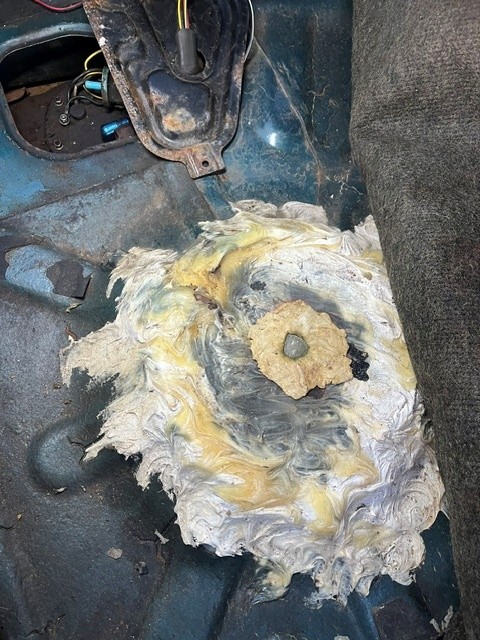

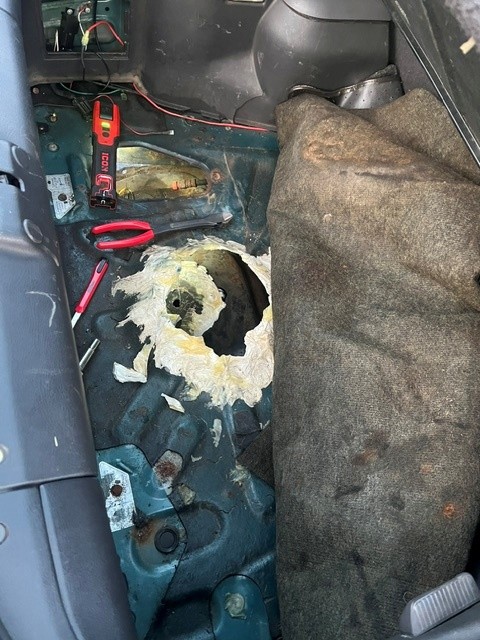

Some hack long ago cut the trunk floor (sub box?) and proceeded to lay down 2 tubes of silicone caulk to cover it up.

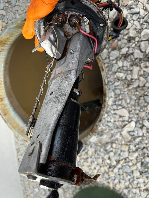

Step one was to cut all of the caulk when the tank wouldn't drop out with all fasteners/hoses/filler neck removed and all of my weight hanging from it underneath. (STRONG stuff!!)

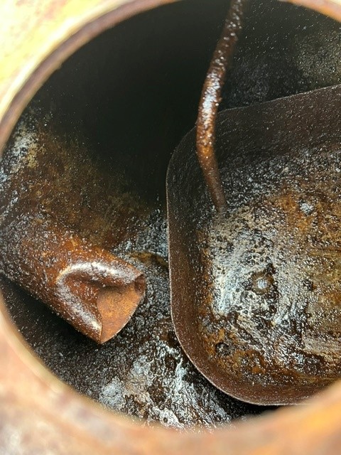

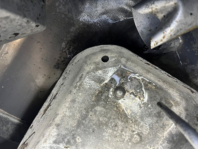

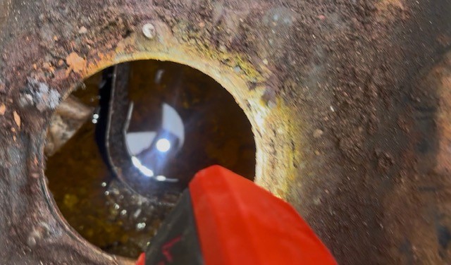

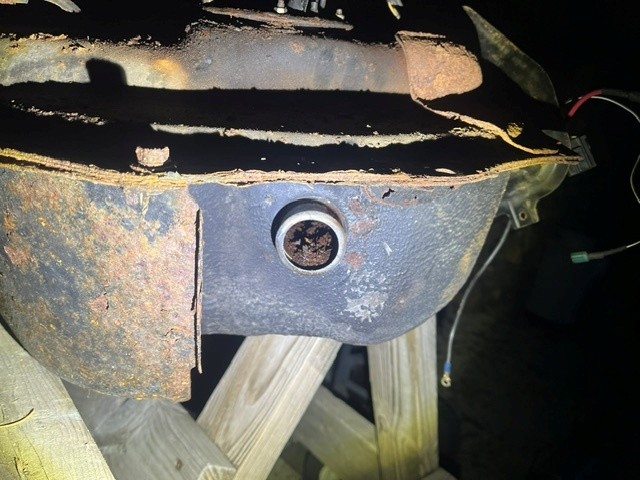

This also leads to discovering the "exploration hole"; about a 3/4" step drill hole right in the top of the tank! This was covered by a US quarter JB welded over the top of it. :dsm: :talon::thumb:
The sending unit studs, nothing broke.
The gas tank shroud, 1 bolt broke I'll have to deal with later.
The original return line, sheared right off.
The fuel filler assembly, I gotta look at that some more.

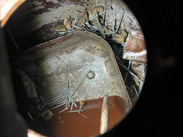

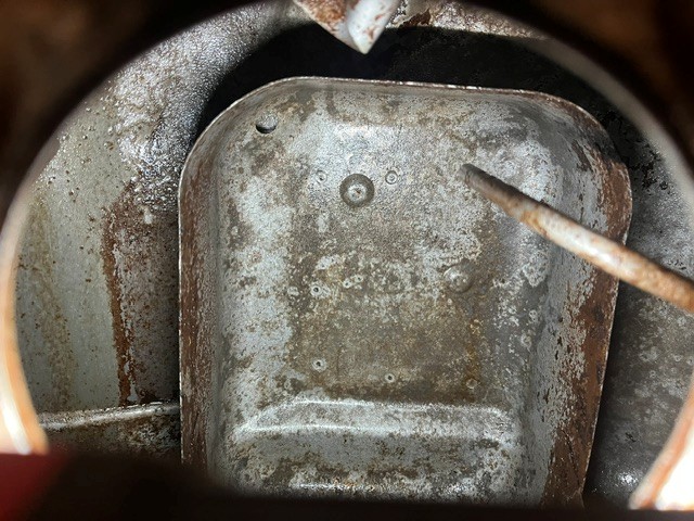

I dumped in a half gallon of Lacquer thinner in the tank and started scraping with a long stick. It was on sale for $15/gal. YUCK....not really doing much to this mess. Rotated it around a bunch, flipped it over and drained it off after a couple hours of that. Nasty stuff drained out.

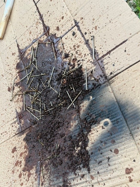

NEXT.....I grabbed a box of roofing nails, dropped about 2.5lbs worth in there and dumped the other half gallon of lacquer thinner in. Proceeded to shake that all around for a while on and off for a couple hours. Dumped out the liquid, noticed more solids breaking away.
Next I decided to try Tolulene since the internet said that works good on old gas. The stuff is $27 a gallon. I sorted out my used roofing nails and re-installed them, dumped in a half gallon and shook the daylights out of this for a couple hours rotating it around during rest sessions.
Dumped the liquid off into an appropriate vessel. Noticed lots more solids and began lightly banging the sides of the tank on the lawn to dislodge crusty stuff. I dumped the solids and nails out on a piece of cardboard.
This is where we are after Tolulene + Nails.

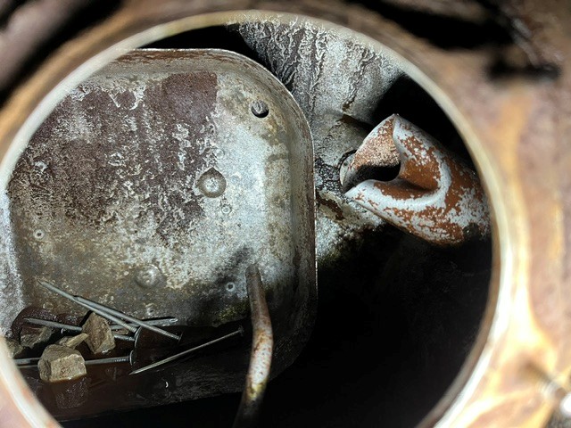

With the tolulene fumes quickly evaporating off, I threw the tank in the truck and headed down to the gas station, put $5 worth of E85 in there!
I also added 5lbs of roofing nails and several handfuls of gravel from my driveway. Shook it all around, rotated it, shook it some more.

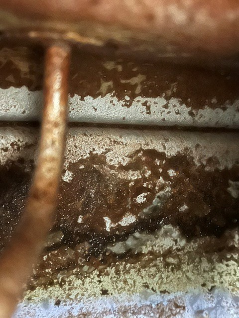

Its still sitting there soaking as I type this, but I retired for the evening feeling great that I got to see things looking like this:

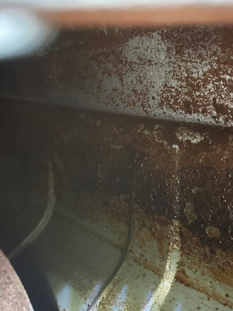

Without trying to make this a multi-page thread about gas tank cleaning pictures; these pics were after Round 1 of nails, gravel, E85 and lots of shaking.
The bottom of the tank is pretty clean, the varnish residue is still along the sides and top of the tank.
I think with the level of abrasion inside the tank while shaking all of this around, you probably could wash this out really well and declare this halfway run-able as it stands.

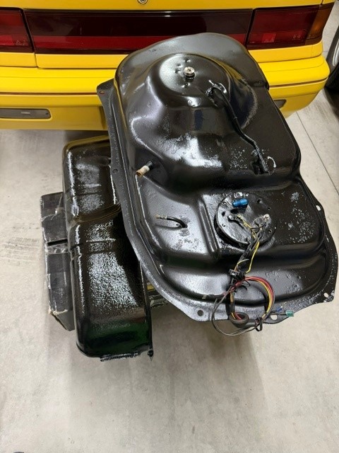

I’ve been at this gas tank project for a full week now!
Since last visit:

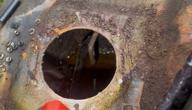

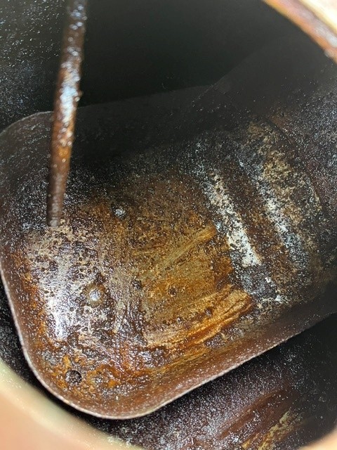

Lots of shaking with screws/bolts/rocks and small amounts of mineral spirits. Probably 3-4 rounds since last post. This agitated a lot of small/loose particulate but really was doing some tight-spot cleaning inside. I made a comment earlier about how you could probably call it 'good enough'. Honestly, after further review; this process was breaking loose that really fine junk that would've continually plugged up the fuel pump sock.
Then I took the tank to a local media blast place to get all the rust out of the tank top/around the flange and primed with PPG primer.
Once it was back from blasting, I washed it out really good with water and dish soap to get any grit and dislodged rust/varnish crud. And it really needed several rounds of this. Covered all the openings; the filler tube hole I used a rubber glove and zip ties.

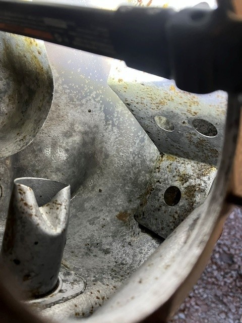

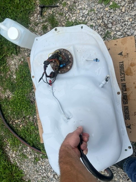

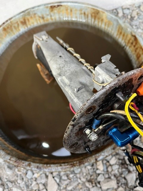

Dumped in the Rust 911 around 10am, closed up the sending unit hole. Proceeded to fill the tank the rest of the way, full to the brim with tap water. (No pinholes!!!)
Let it sit all day and allow the chemicals to do the work!!
Around 8pm a friend came over to help me dump off the solution into containers.

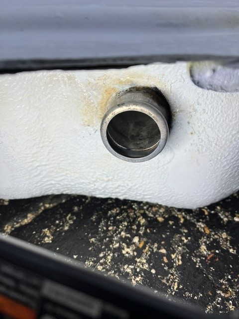

The Rust 911 product says to mix up to 16 gallons. I learned while emptying these 1G AWD tanks verifiably hold about 19-20 gallons when you can fill them all the way up!

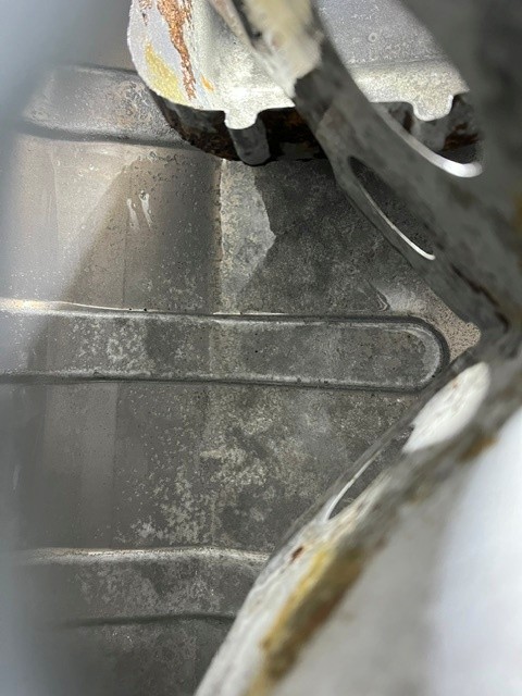

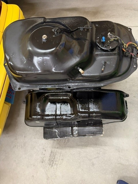

I have a 3/4" hole drilled in the top of my tank, so these are no-BS pictures of how well this works after 10 hours and a (probably) dilute solution. After this I rinsed it out completely and sprayed down the inside with WD40.
I am very happy with how this tank cleaned up. :thumb: And VERY glad I don't have to inhale bad gas odors!!
Rust 911 items to note for anyone that might need to do this:
1. I could've left the Rust 911 solution in the tank overnight (days) instead of 10 hours.
2. Glad I didn't spend too much time on the sending unit; the solution did all the cleanup work!
3. Any residue you see in the tank, basically wipes off now. And yes, I've cleaned up some stuff by hand.
4. That leftover barely-dirty solution works really good at cleaning up my other rusty parts!

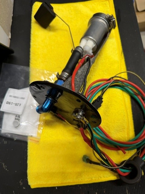

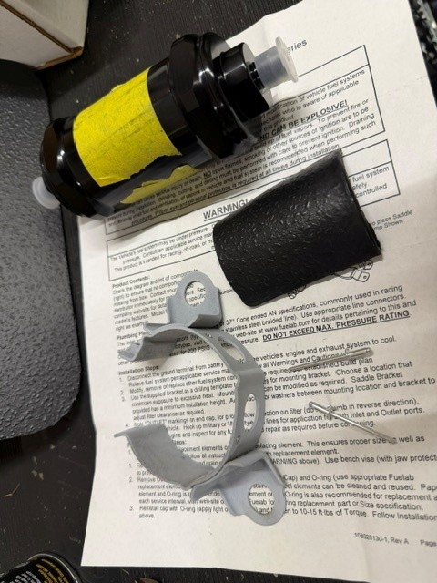

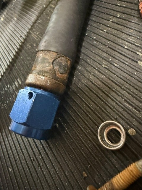

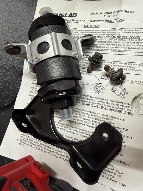

While at SICK Week I got a 25% discount code from Redhorse for AN supplies; so that is my project for today.
A week since my last post, but plenty of small stuff in the background while I watch tracking numbers on parts.

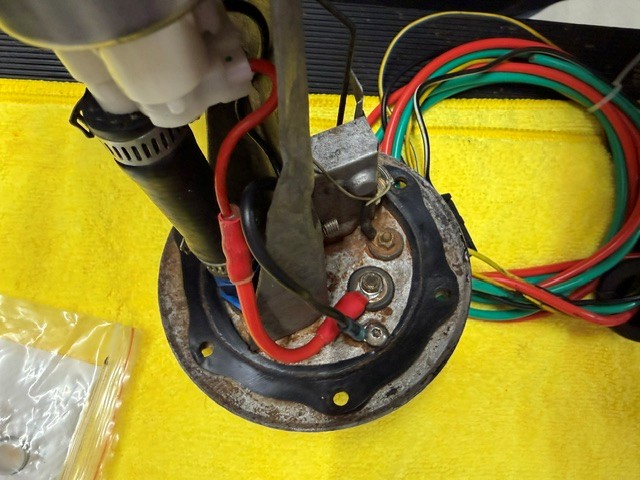

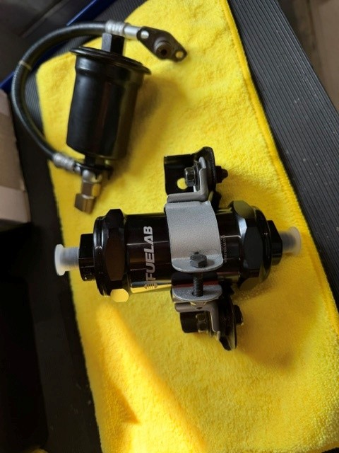

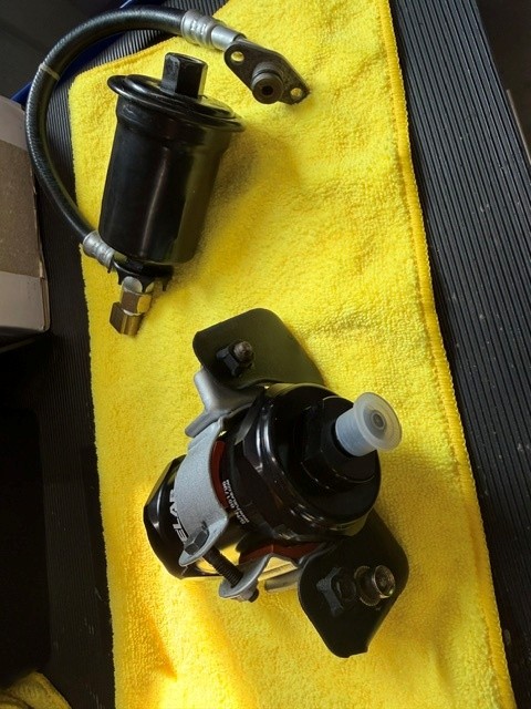

I now have all the supplies for -6 AN feed and return lines from Redhorse, and waiting on 450 pump to arrive.
The gas tank still needs that hole in the top addressed before painting.

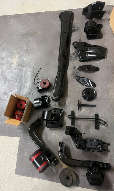

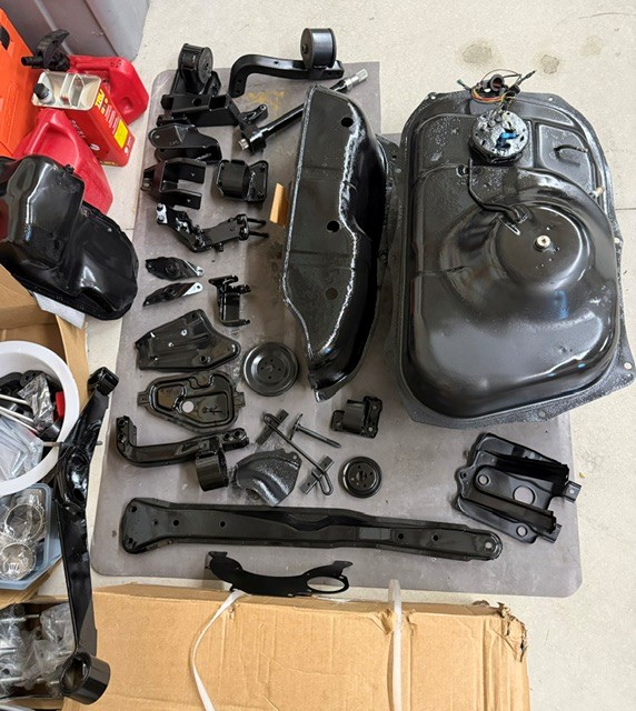

I've blasted and spraypainted parts as seen in prior post, but want to recoat everything with POR15 Top Coat as long as we're setup to spray out of HVLP gun. So I've been scuffing/blasting/priming and getting more parts ready for the big paint day.
I now have the engine fully torn down and had to re-order +.010" Rod & Main bearings, also waiting on gasket kits.
I have much cleaning of parts to do in the meantime, and still need to discover what my oil pump looks like inside.

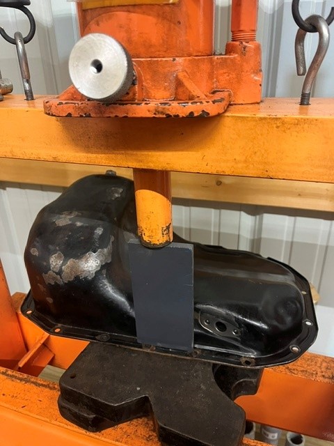

I added the picture below to represent the time you can spend walking around looking for just the right 'thing' to press your oil pan flange flat again. Or the countless sidebar projects like this. :cool:

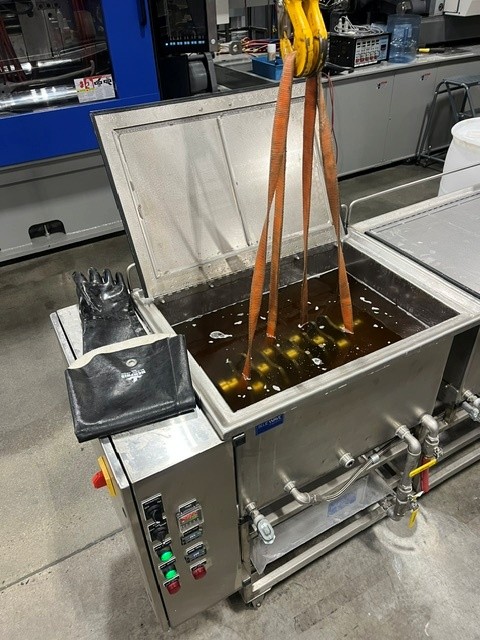

Brought the crankshaft to work so I could use our big ultrasonic cleaner and hang it from the overhead crane with a strap.
Cleaning solution being used is water + sodium hydroxide at 180F.
I am thoroughly impressed by the cloud of black stuff that continued to plume out of the oil galley holes as soon as I turned on the sonics for the 5 mins I watched. I'll do more manual/solvent cleaning work after this.

Between the hacked up floor, the rust, the drilled hole; that was reason enough to strongly consider it, or the fabbed aluminum 10gal offering.
I probably have $300+ in chemicals, blasting service, paint materials, rust 911 going through saving this. How many hours? My wife agrees I probably spent 40-50 hours screwing around with this over the week.
Fortunately I really enjoy mad scientist projects and polishing turds!
I remain hopeful the fuel level gauge still works!! 😎

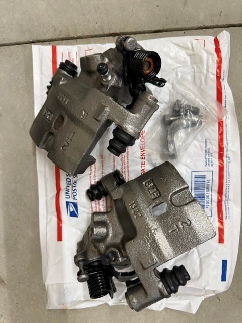

Project related, yesterday I shipped my rear brake calipers to Indiana to get those operational again.
Thanks guys for checking in! Till the next one….
