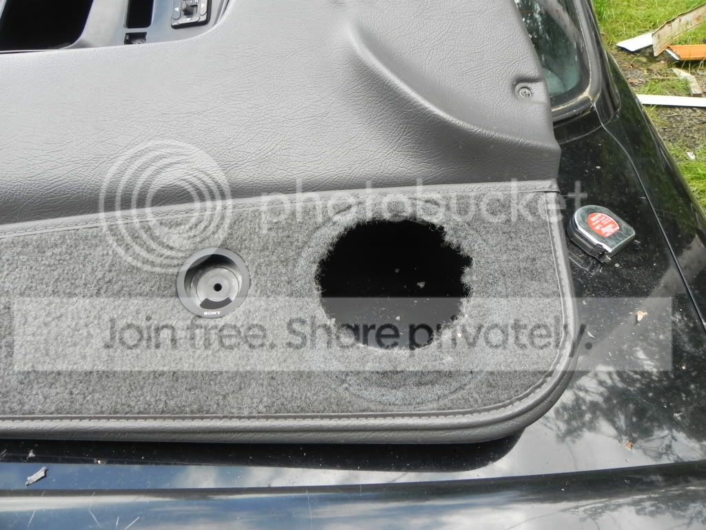

After installing the interior and before finishing the Engine bay i starting working on a custom sound system.

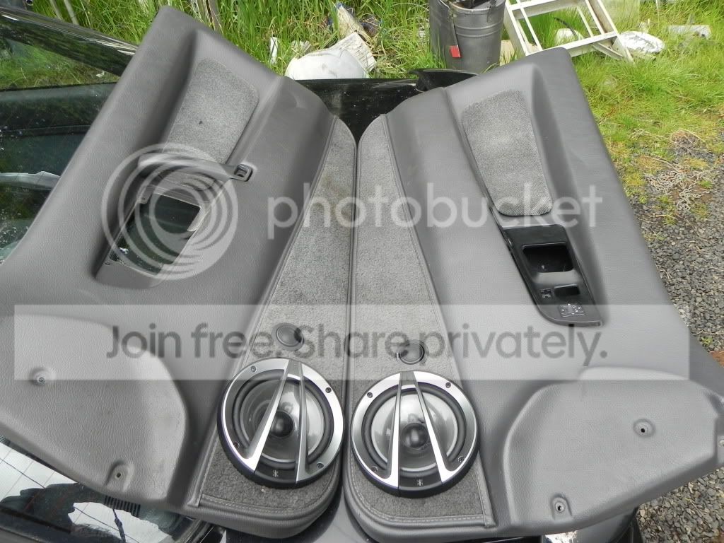

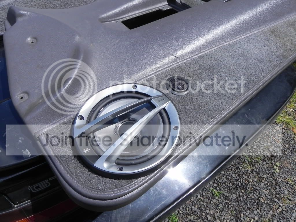

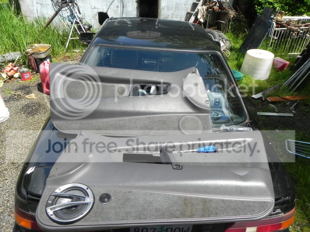

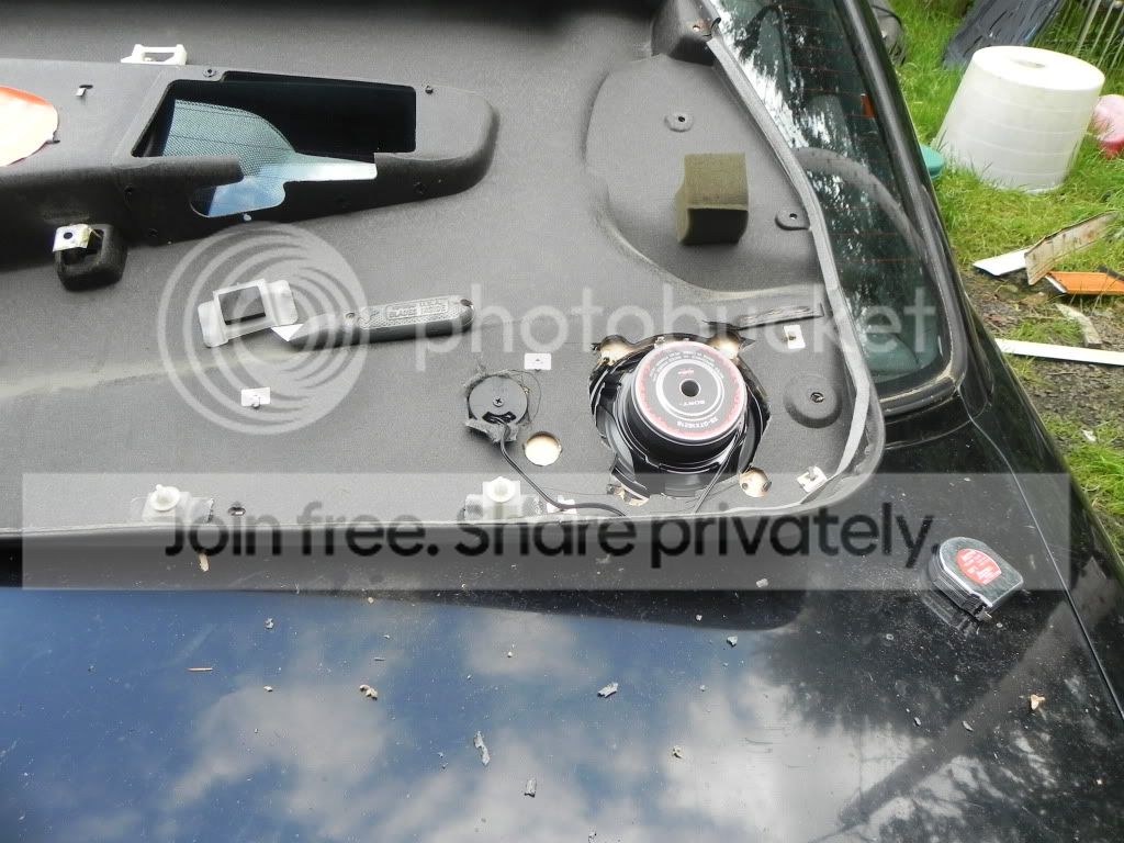

In the doors I installed 6" Components:

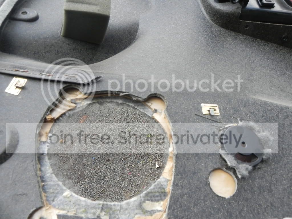

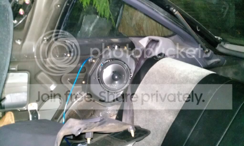

In the Rear I am still working out what I want to do, more components or install some 6" 4-ways:

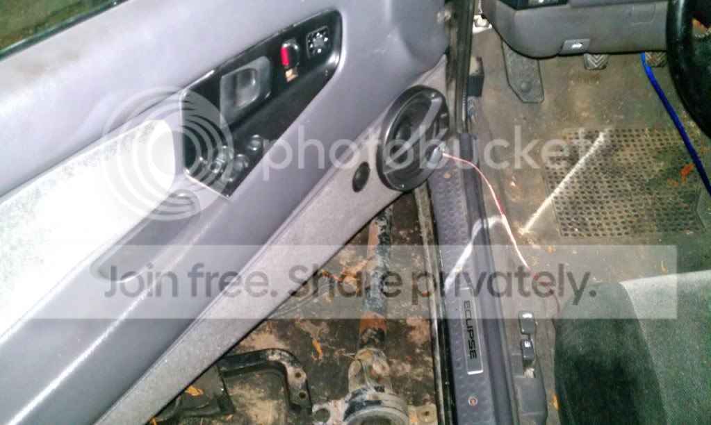

Also noticed an issue with the Door electrical only partially working, only the door ajar lights in the corners and the dash light worked. No power to the seat belts or the windows. Still working on that :p

I would consider making an mdf spacer and mount the speakers directly to the door frame to help eliminate vibration. I would go a step further and install a baffle on the inside of the door frame to help improve sound quality. It could sound fine mounted to the door panel but it is not ideal
