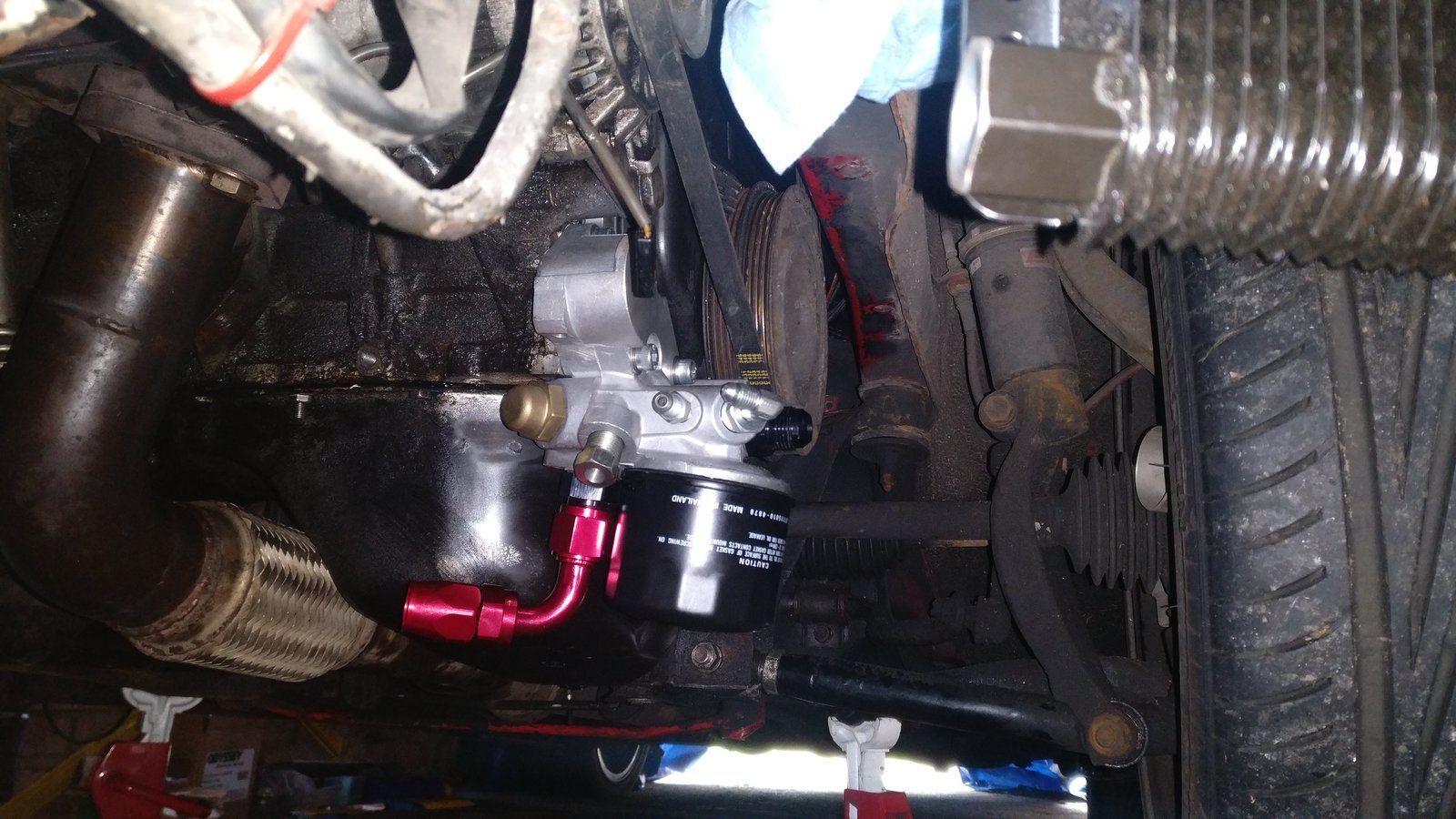

I have an evo 9 ofh with cooler lines, temp sensor is in the housing and pressure is AN line remoted to avoid vibration, i dont think i got pics of it on this phone, its nice as it gives you more room and it makes the filter face down

Sorry for the bad pics, car is low and it's cold outside.

This is an Evo 8 OFH. Also before it was 100% finished. I had to order a 1/8 BSPT tap and get creative to finish it. The Evo 9 OFH is simpler as far as supporting both OEM sensors.
