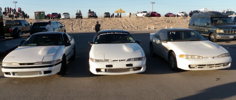

In February I made it out to the local drag strip. I hit a new best MPH (102 MPH) but my et suffered (14.7) due to crappy 60' times (best of 2.4). My boost gauge claimed 14 psi but I have since found (based on my MAP sensor reading) that it reads about 3 psi high so it was really more like 11 psi. However it was a lot of fun and I was joined by two other white 1gs and got to beat up on a Mustang GT!
