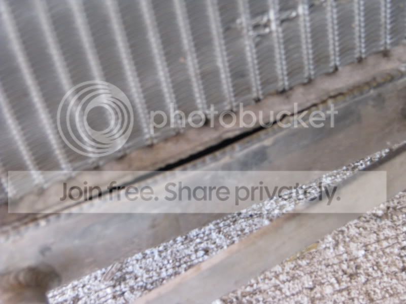

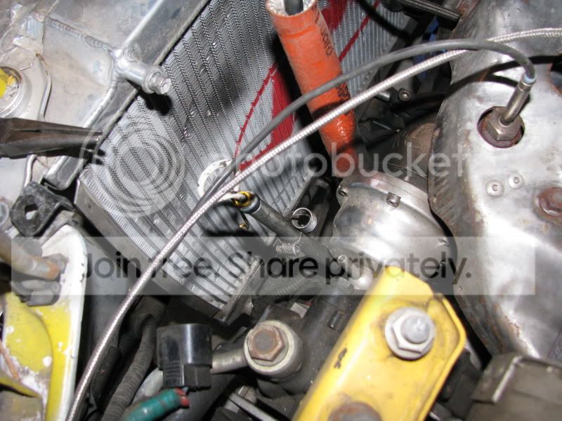

So I go inside the garage and find some anti freeze and start to fill the radiator when I can hear it dripping, at that point I immediately stop filling and look under the car to see the AF dripping out the bottom but I cant see from where. So I go inside fill a bottle with water and fill it again just to make sure it wasn't spilled AF. Sure enough the radiator drains and leaks all over the drive way. So, I decide to push the car into the garage and start exploring the problem later. Here is what I found

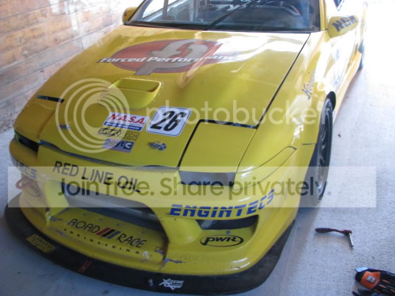

Dont mind how dirty she is, It was a long trip on the trailer. Busted Spoiler Supports on the front are from my last track time.

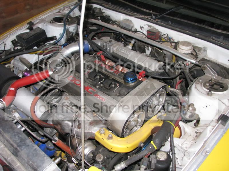

Engine bay needs to be cleaned Like I said it was a long trip
V Mount

Needless to say, I am pissed the **** off no one told me that the shop had lost power. It must have had no power for at least a week for it to have been able to get so cold everything froze up. I know of four other cars some of them classics that where being stored there and I wonder if they had problems as well. I still have a leak at the rear of the engine Im trying to find. Like I stated before, I'm not in a very good mood right now. I am only 50 miles from a track I was going to take my car to next weekend and get some track footage. Not sure thats going to happen now. But I did learn something.

What front bumper is that on there by the way?
It happens, It was owned by an elderly guy and all he does is rent out the space to store vehicles. As far as the bumper, that's the Drifter Front Bumper

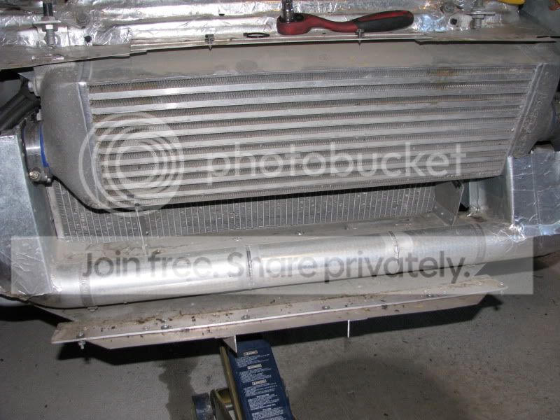

Sorry to hear that. On another note, that doesn't look like the radiator/fmic that was on it when it was the flying banana. Did you change it out or did he not sell it to you?

I think, Greg changed things the last season he owned the car. Ill have to dig around for the build post before he sold the car.

Couldn't find another leak other then a rubber hose that was split, I replaced that. I get the radiator back from the shop today. They re welded the seem and pressure checked the radiator. I was told the seam was the only leak/crack. Radiator is going back in next week. I will then, fill the system and begin hunting for other leaks. Wish me luck guys.
