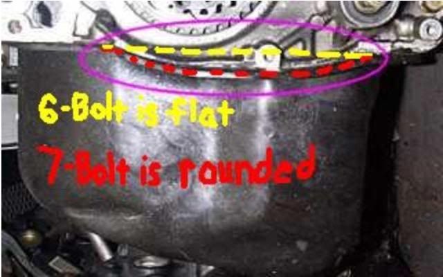

Can anyone help me out I'm trying to identify the engine if it's a 6 bolt or 7 bolt I need to order a new clutches
Bottom of crank will b flat if it’s a 6 bolt. It’s it’s cob some curve to it it’s a 7 bolt.
