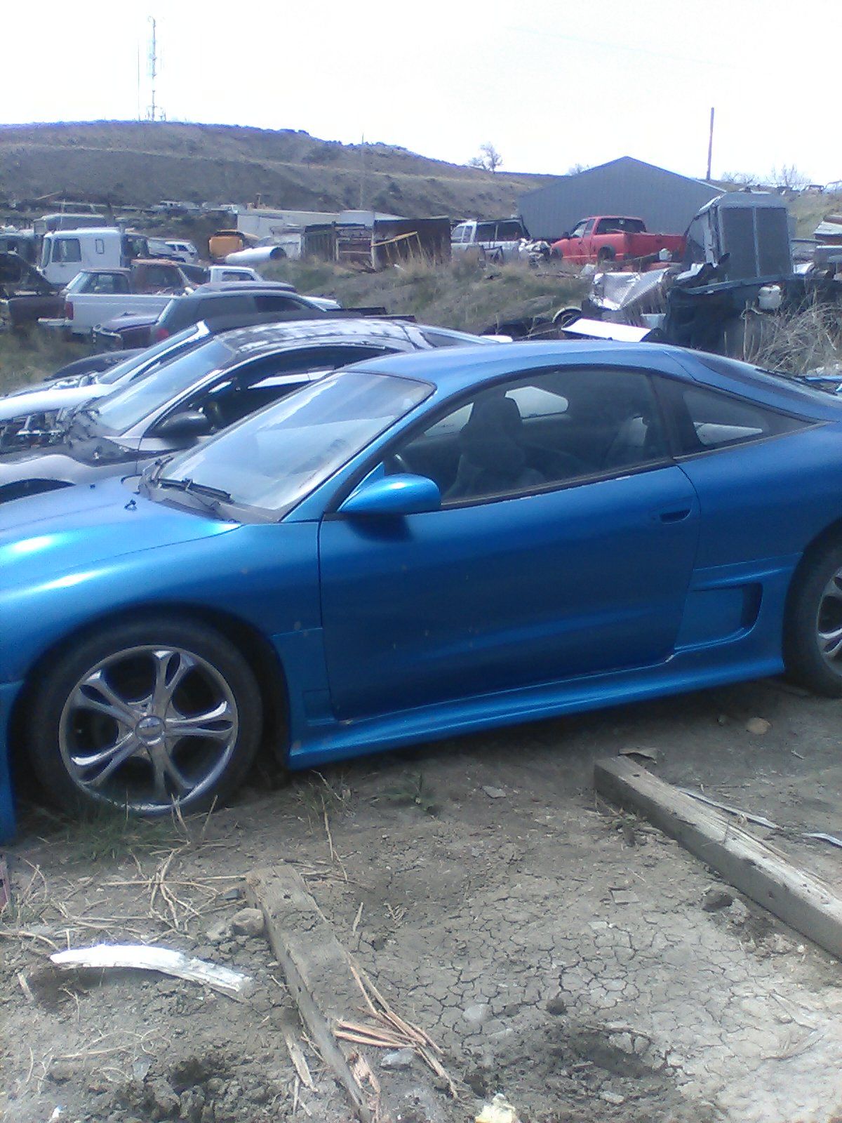

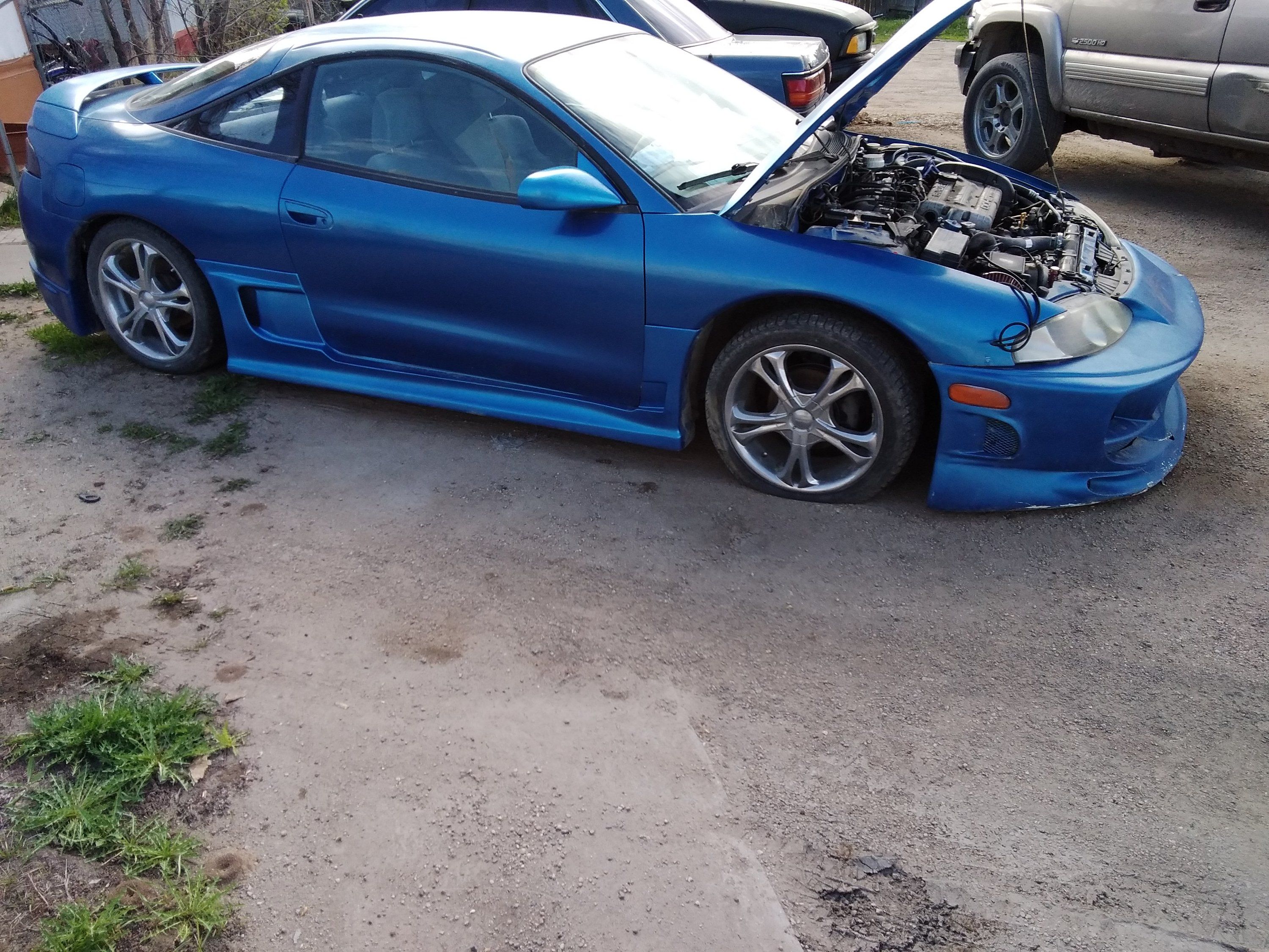

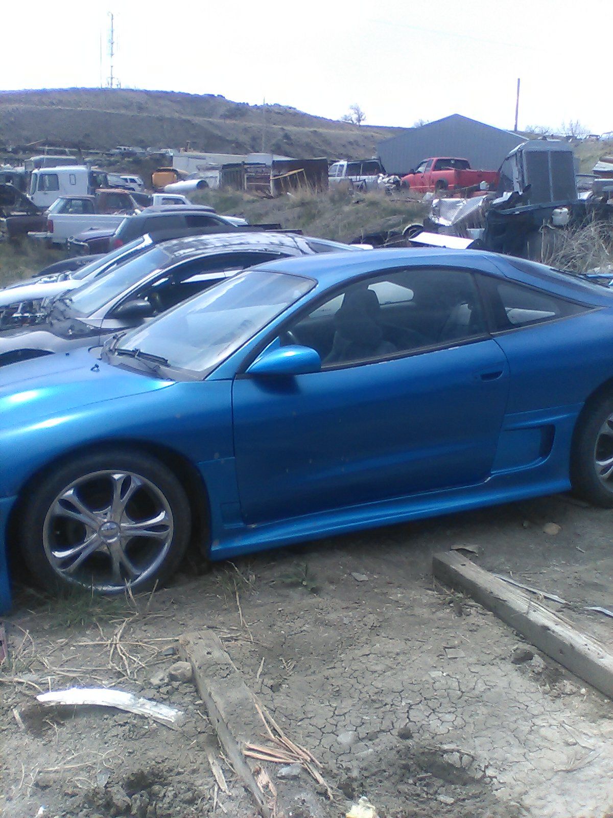

My new to me gs-t
Looks good man I like the body kit on there. It’s a nice peace of art.

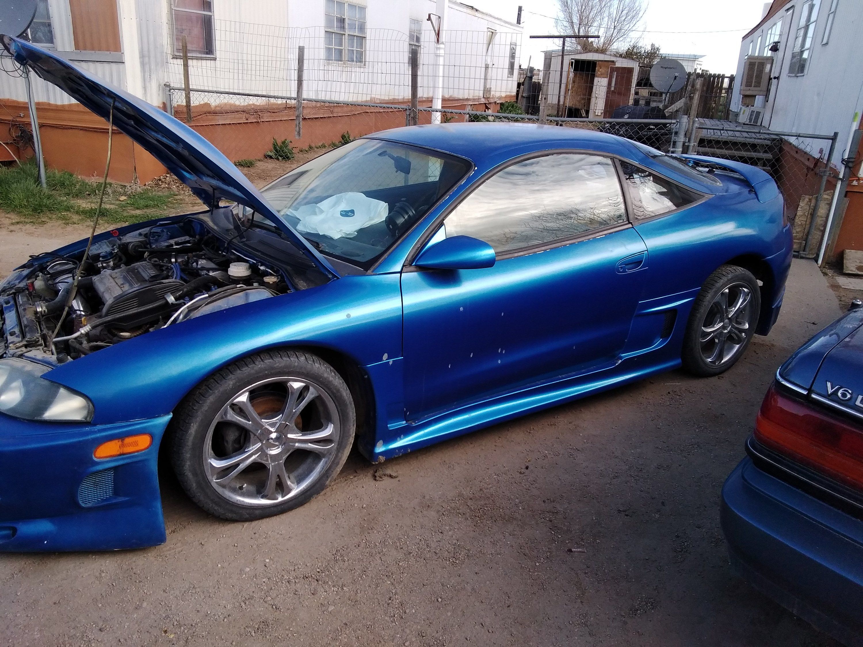

Ya it is a nice body kit fixed all the vacuum lines found some chewed up wires one for the temp sensor and the cam sensor wires got the cam sensor fixed and need to get a new plug for the temp sensor and just got it running

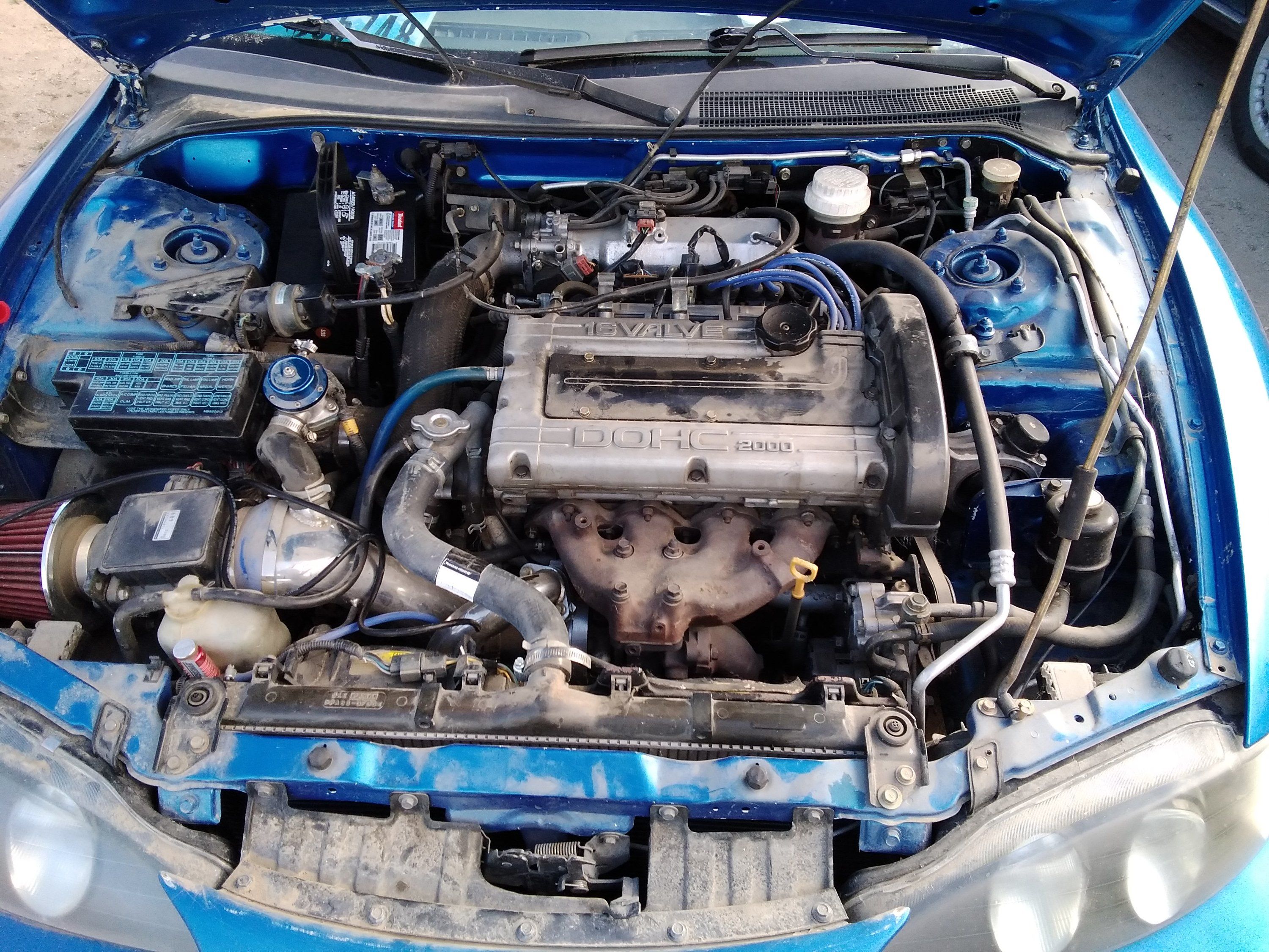

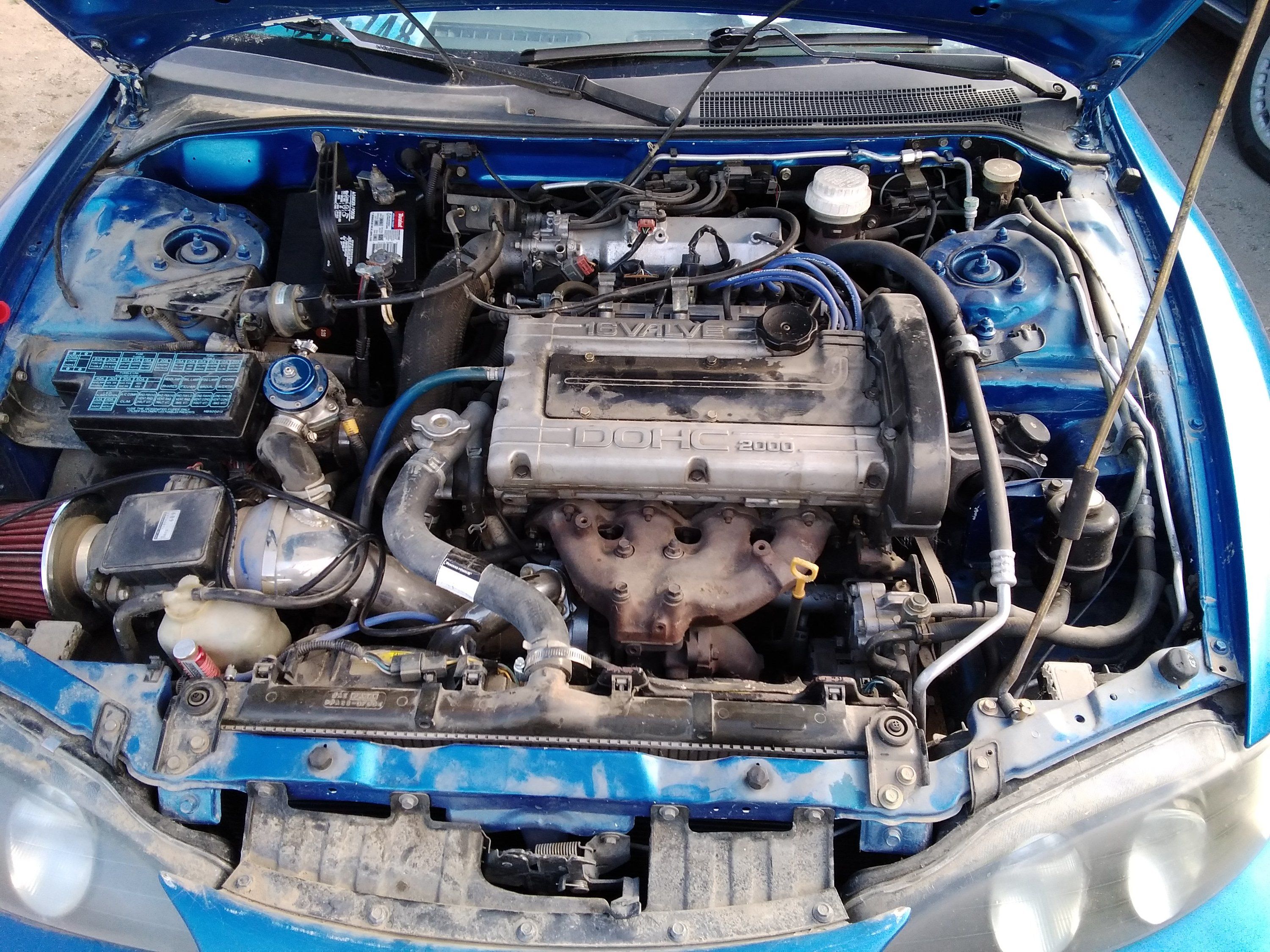

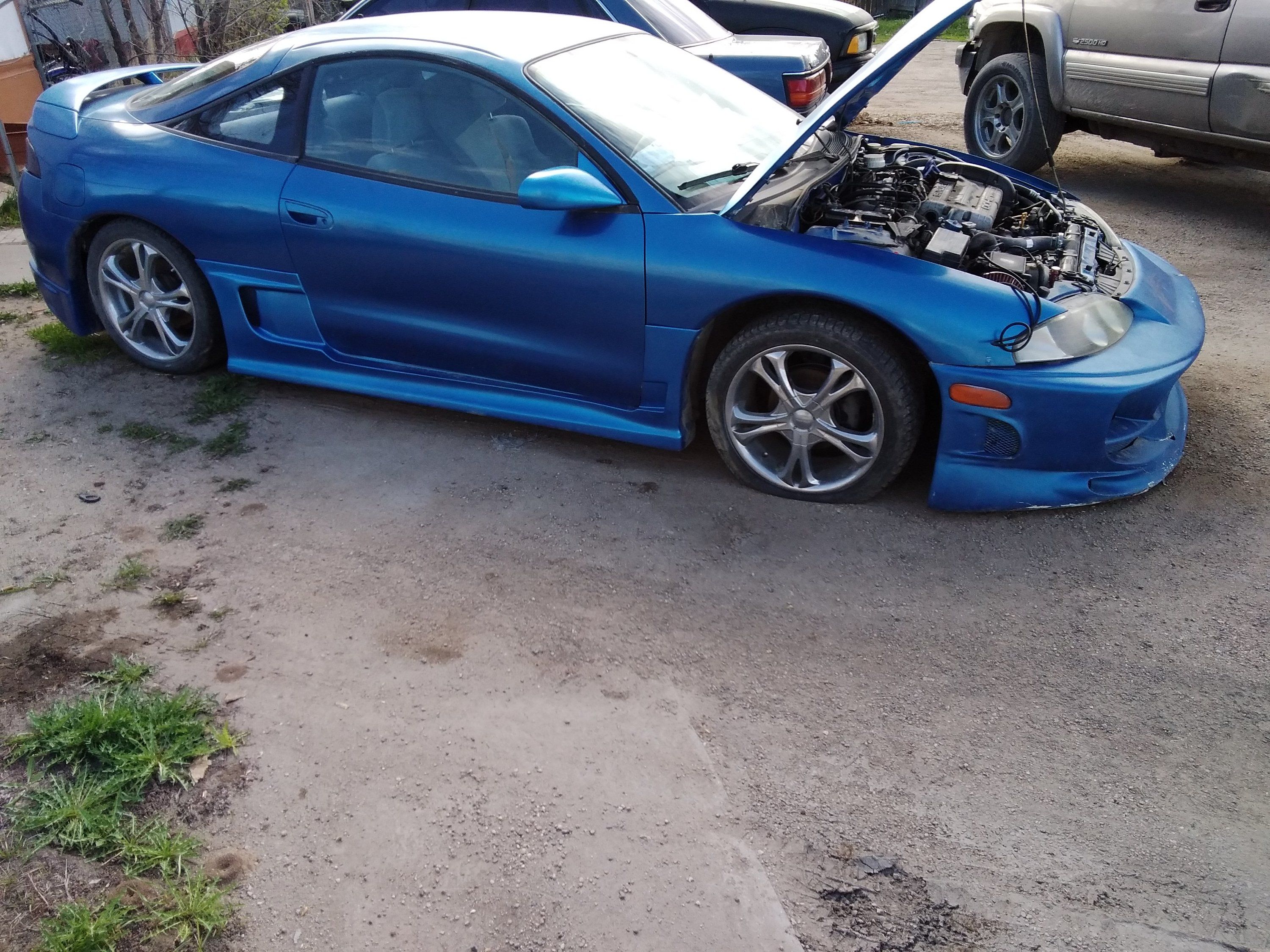

That’s cool man I see in the pic of the motor that the blow off valve is missing the vacuum line from that it goes to that open nipple on the intake to the left of that sensor on the intake. Just letting u know if u haven’t already fixed it
Got the temp sensor plug fixed ended finding the plug at napa just took it for a drive now just need to do routine maintenance oil change and tune up
Nice man run good? Wasent too bad was it I like it tho
