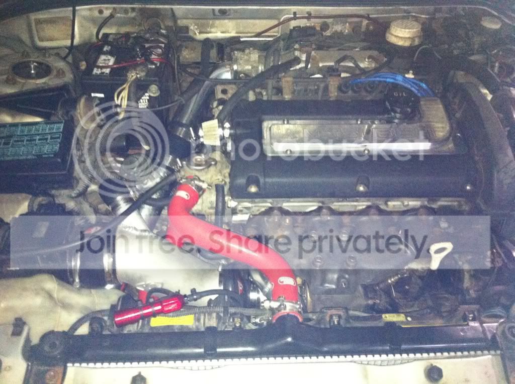

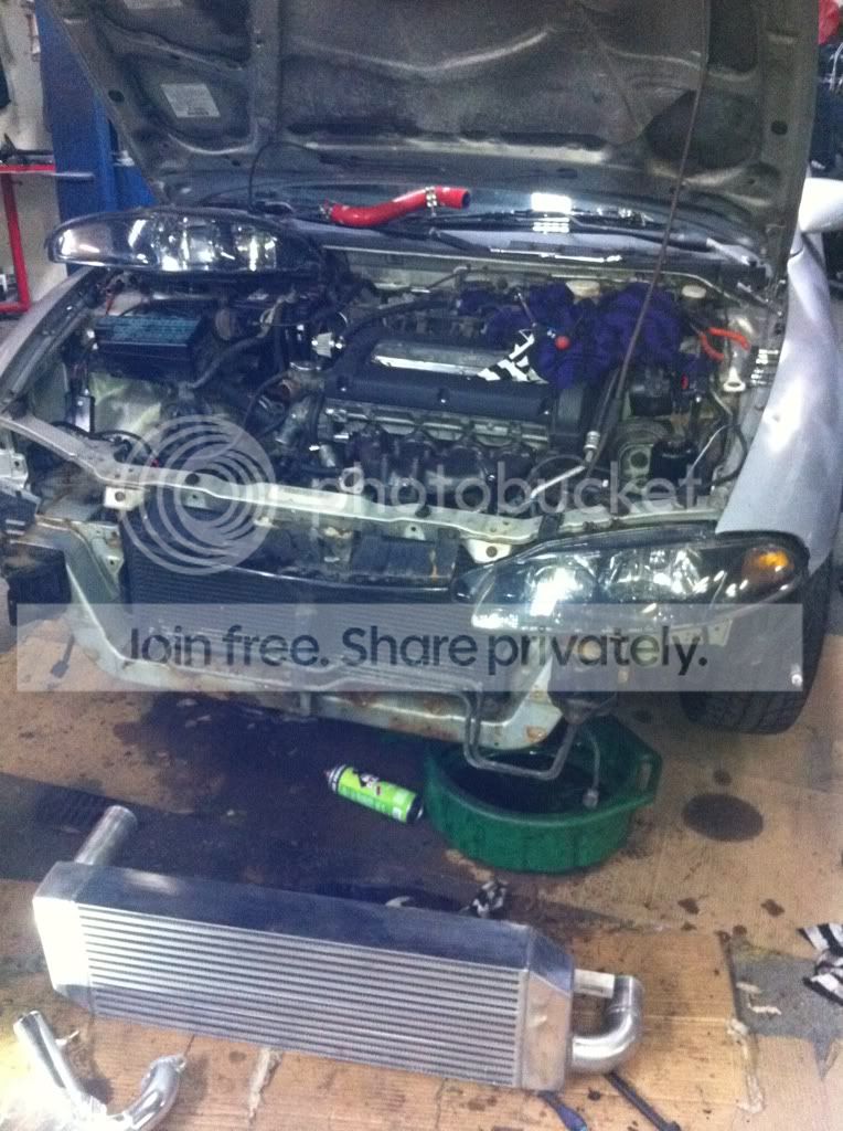

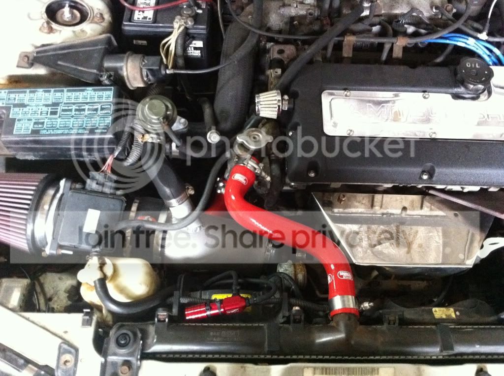

My new spyder clean up

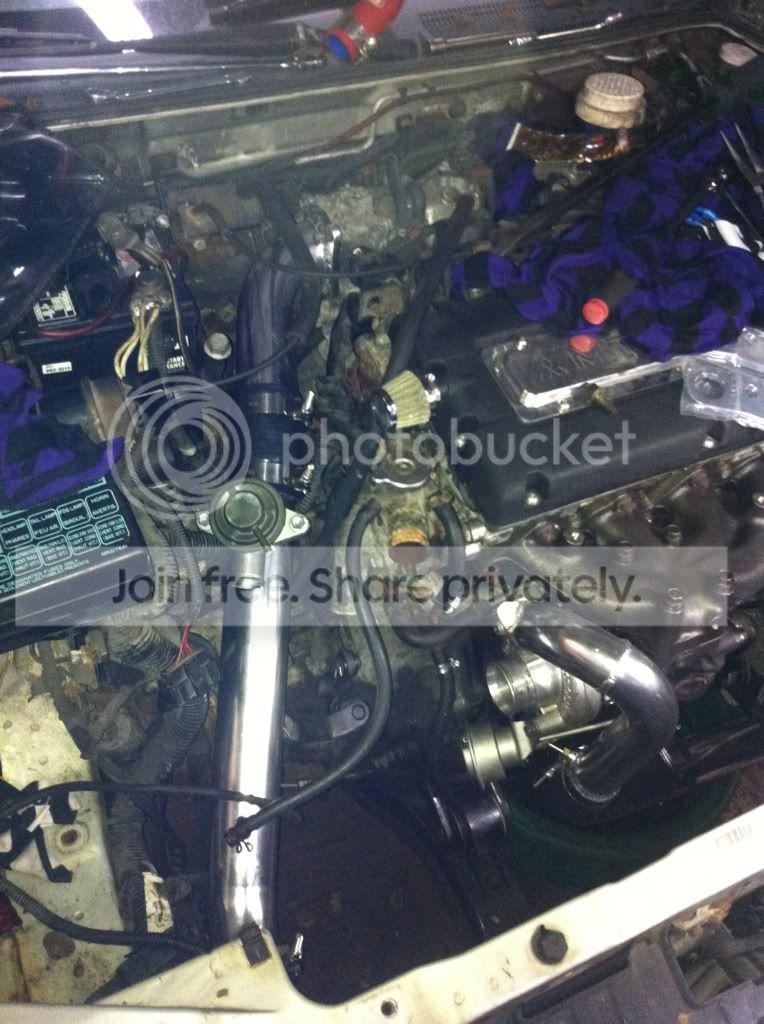

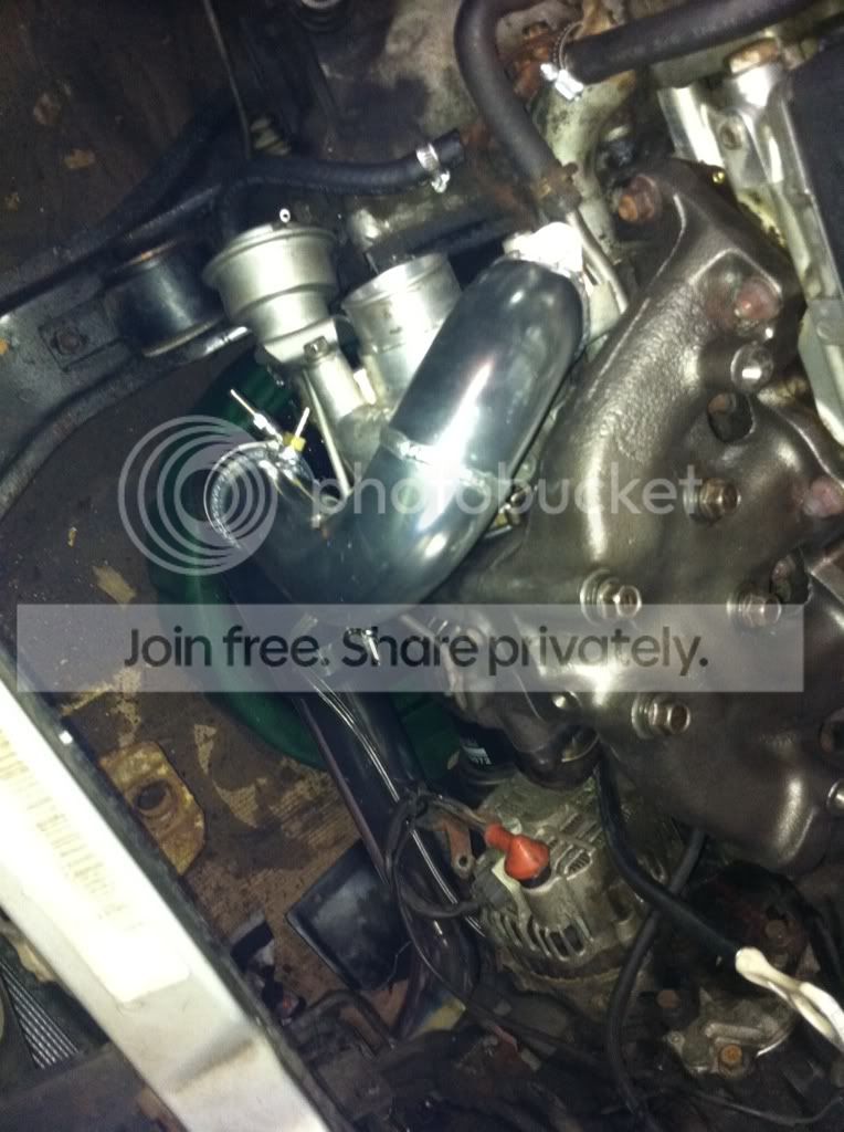

The hoses installed, polished heatshield, and 1g BOV. That 1g bov fixed the big boost leak for the 2g bov.

op, how long did it take you to shave down your valve cover? Looks great, engine bay is a night and day difference from when you first got it.
I didnt do the VC, I got it from JNZTuning shaved and coated. Thanks, I just got a little more to go, and it should look much better.

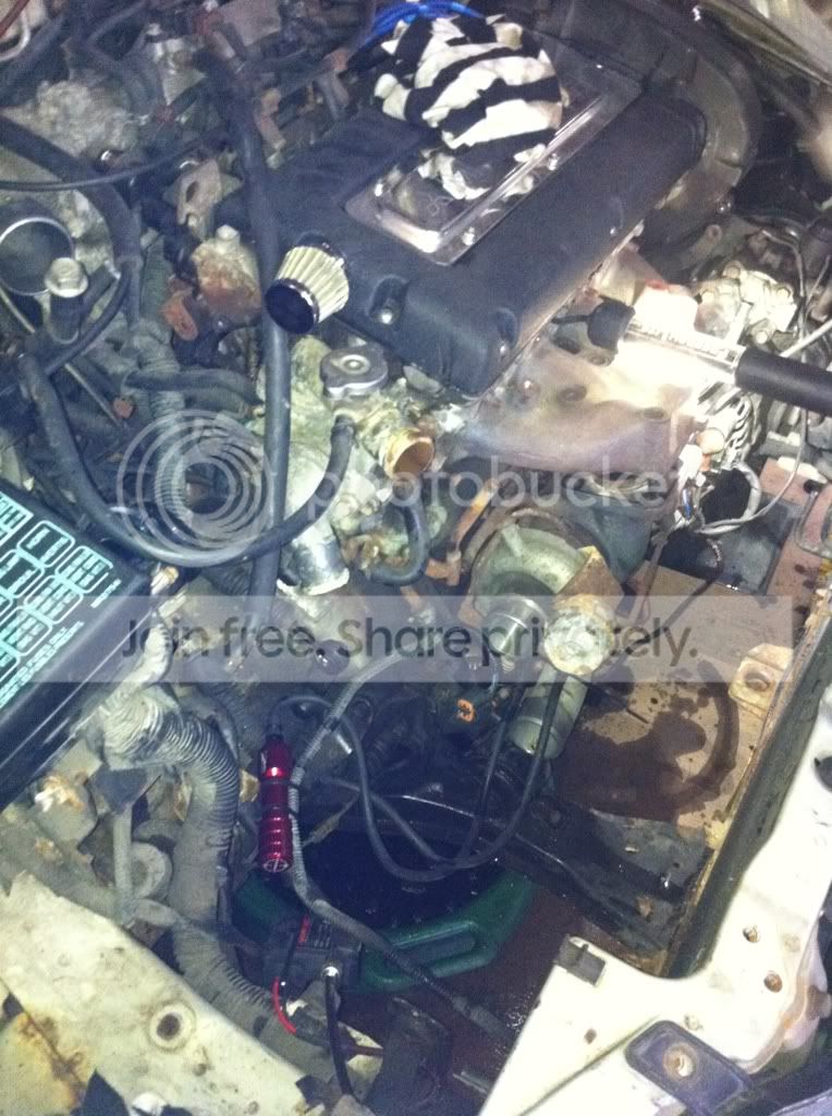

looks very nice. was interested in your valve cover filter install. does it make a mess of your engine bay? i was looking into do the same thing with a weapon r filter but was concerned about the open filter causing an oil leak in my engine bay.
Nice look, 2 weeks ago I just fired up my complete engine rebuild, fired up the first time... haha lucky me. Now I am getting a new top installed. How easy was it to install the 1g blow off valve? How is the electrical on your car?
No mess at all. It was only a temp thing, 1 sign of it making a mess, it is gone with.
It was very easy to install. Removed the house on the 2g bov, take off both the zebra clamps, clean the edges of the pipe, and remove the small rubber piece under the 2g bov. Take the 1g bov with gasket, two bolts to the adaptor, and connect the small rubber piece to the adaptor. Tighten both the zebra clamps on the bottle, n rec, than put the hose back on. Well my electrical seems good to me, the top doesnt come down on its own, didnt look into it yet.

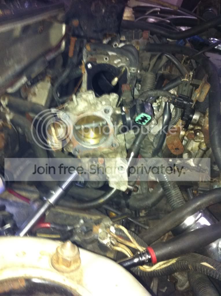

Working on the car today. ####ing radiator broke from being old smfh. Good thing my other dsm isn't running and I could take parts from it.
