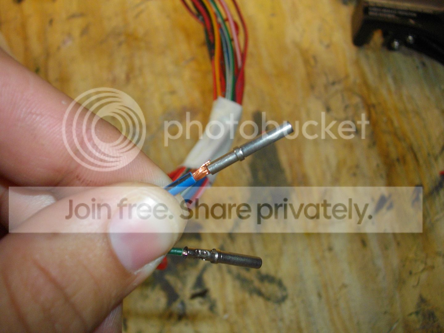

I started on the fuse box harness today. I was going about my business stripping and crimping barrel connectors on when I hit a snag.
I need one size bigger on the barrel connectors for the remaining wire so I'm stopping here plus I need to order wire.

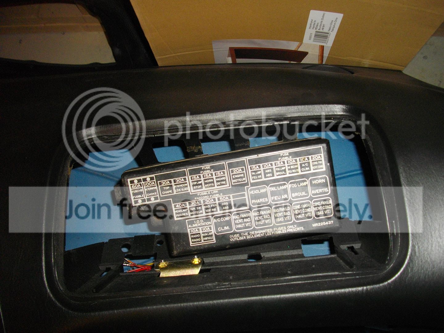

Here's what the Fuse box looks like in it's new home; I need to make the mount up still so it will sit straight.

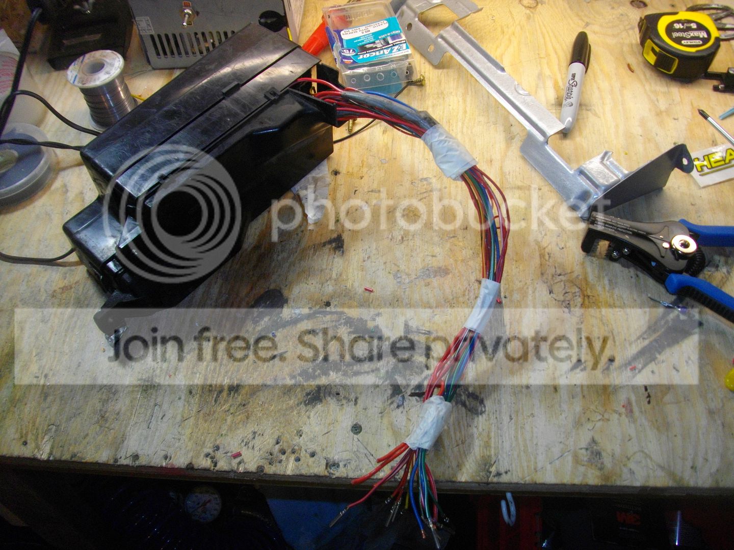

Here it is on the bench.
Looks good i put mine in under the dash when i was experimenting next time its going probably in the cup holder area, looks good.
I still want to keep stuff like my glove box and center console useable, that's why I chose the air bag spot.
snowborder714;bt16216 said:
It looks like you only have 2-3 strands sticking out. There really was no way or room to stuff them in? It looks like it should fit, but maybe the picture is deceiving.
Looking good so far!
It's the picture, I can't slide it down any further without pushing out even more strands and that's something I want to avoid. I'll just order up some new barrel connectors in the am.
