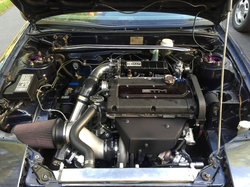

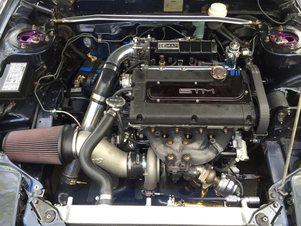

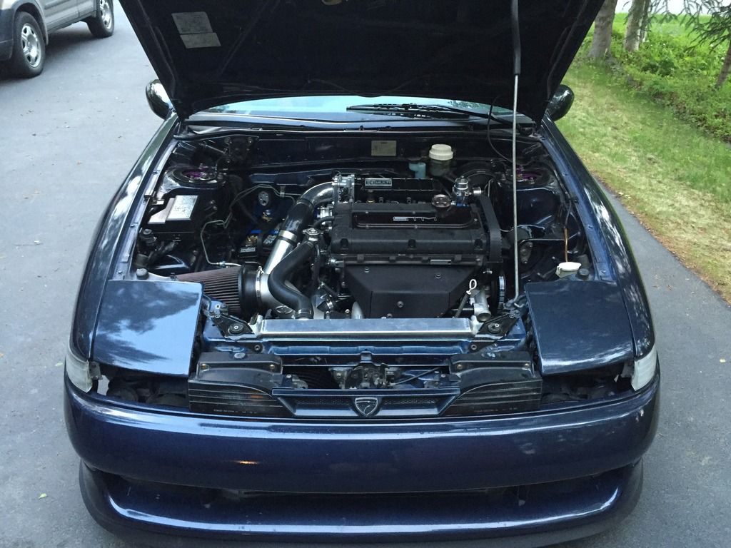

Long time no update... It has certainly kept me busy with working through problems. Everything from lean conditions, to running hot, to boost creep. Anyway here's some progress. Its getting there.

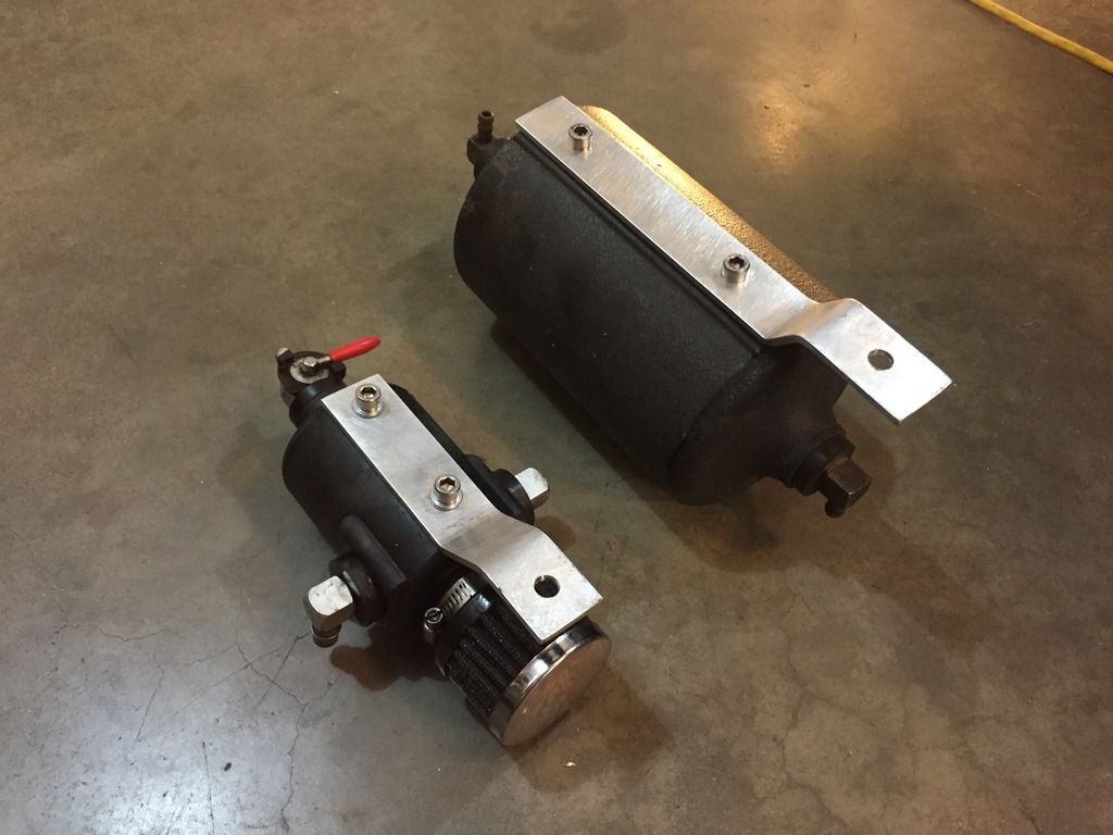

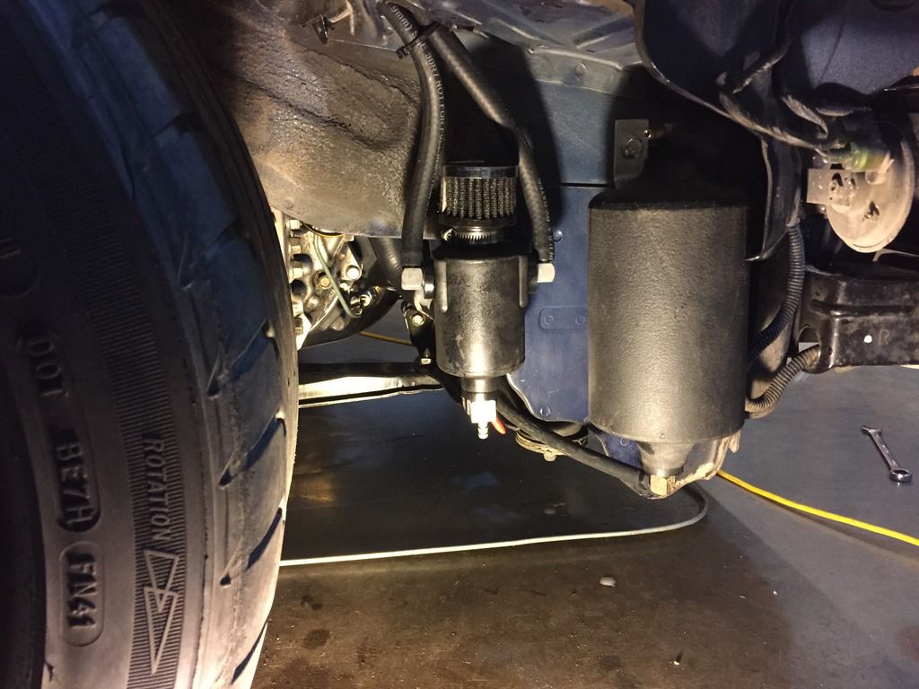

Made some new brackets to mount my catch can next to the coolant overflow.

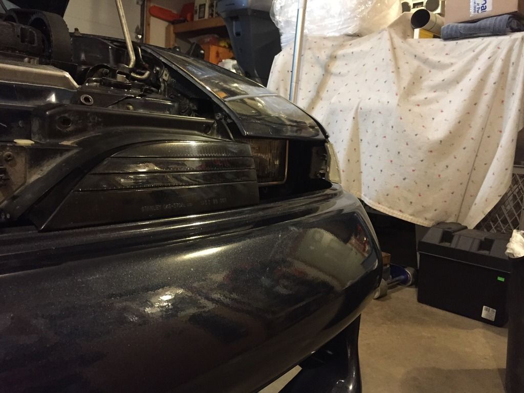

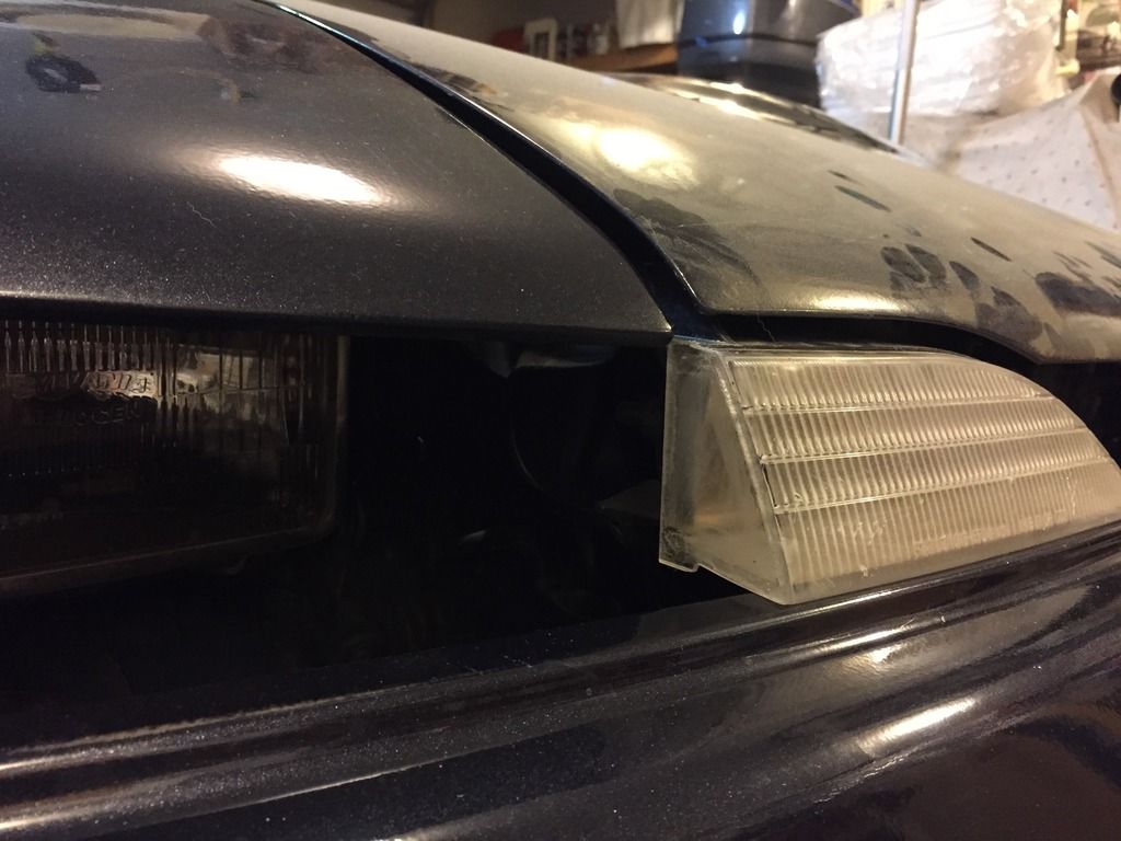

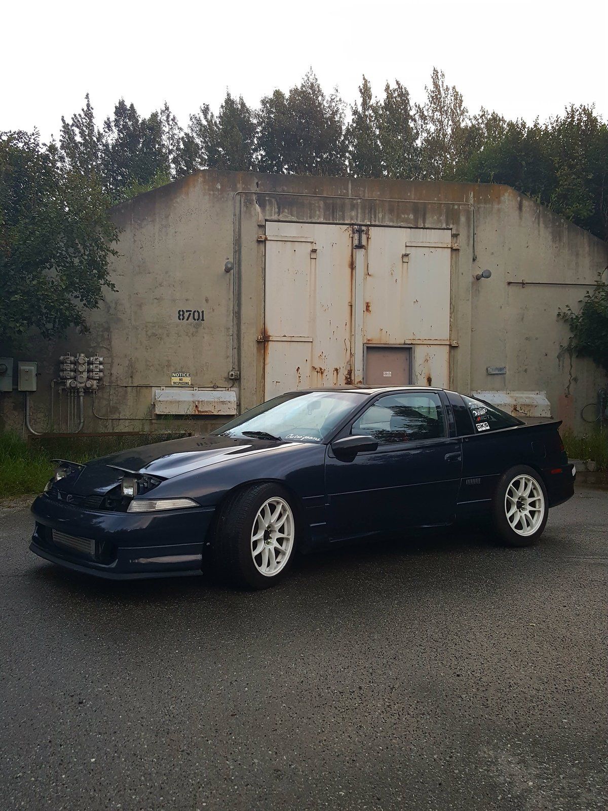

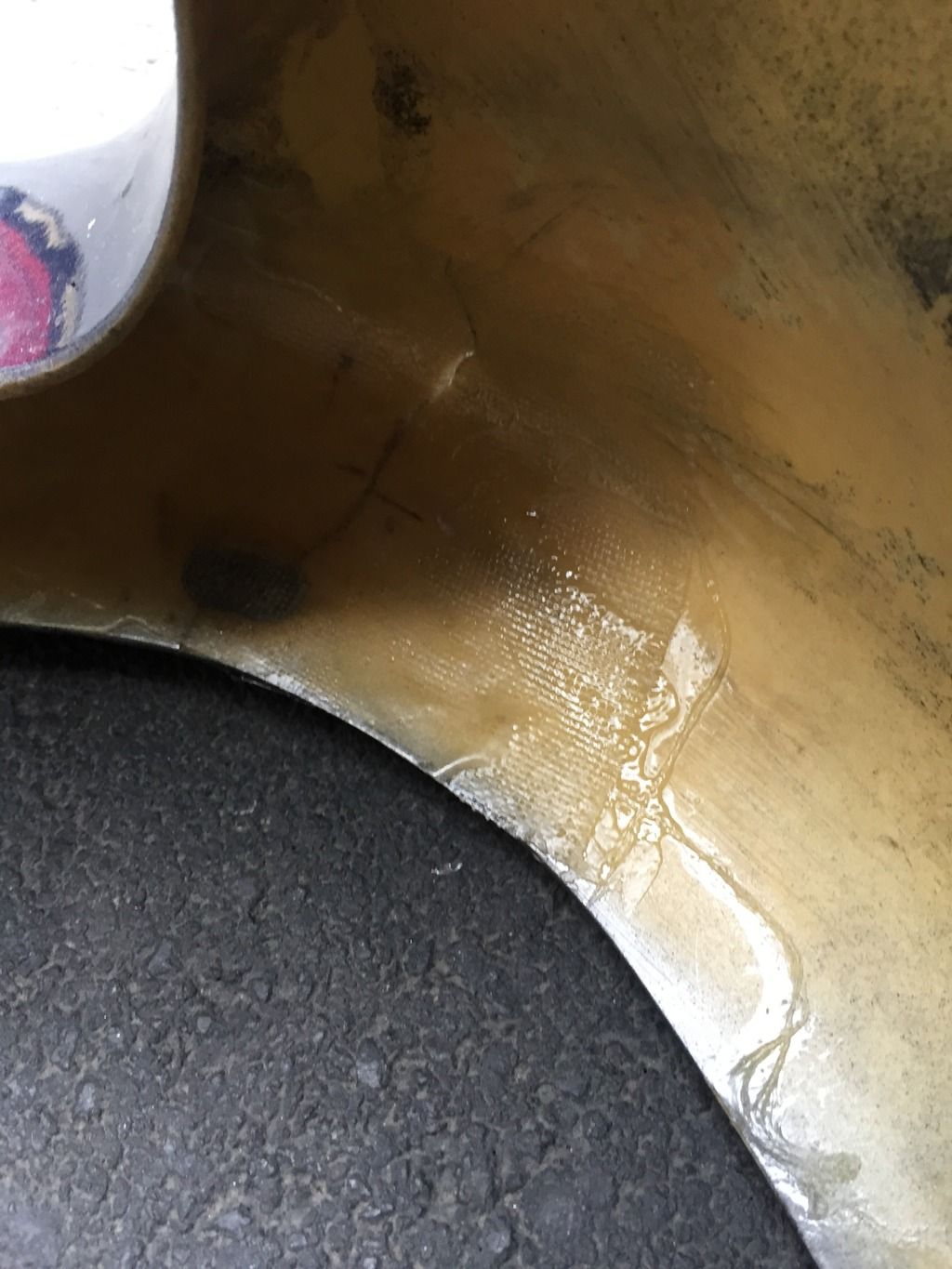

Took the bumper off to repair and reinforce it.

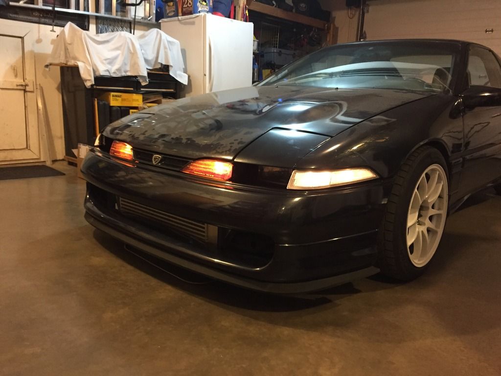

After a quick polish.

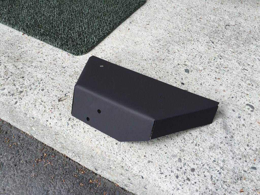

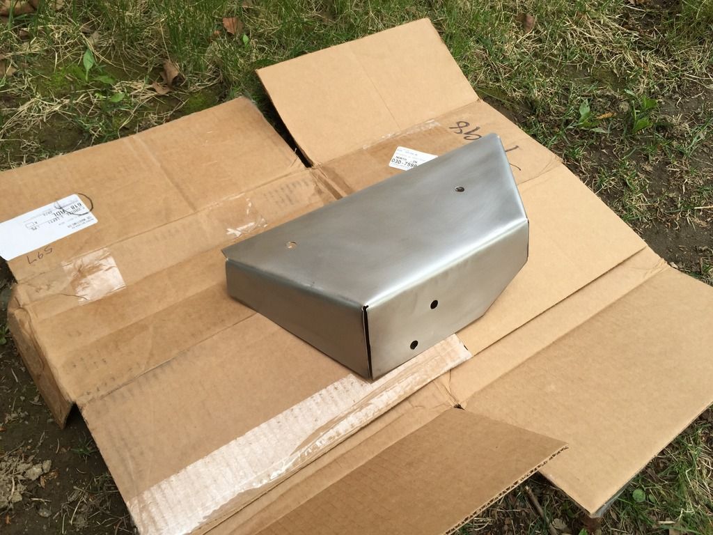

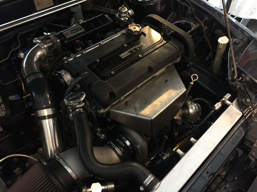

And my evo III manifold got really ugly really fast, so i decided to make a heat shield for it.
Despite all the problems, im really enjoying the car! It is hilariously fun to drive, especially in the twisties. The tune is getting there but progress is slow as we work through the issues. Much more to come soon.

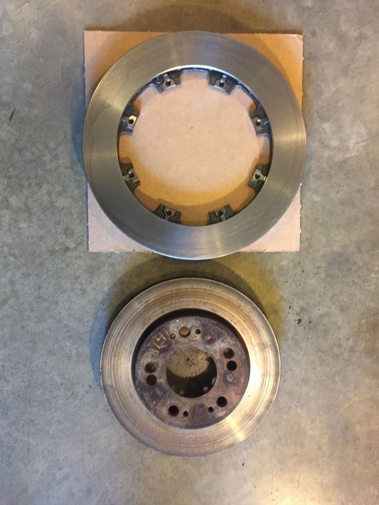

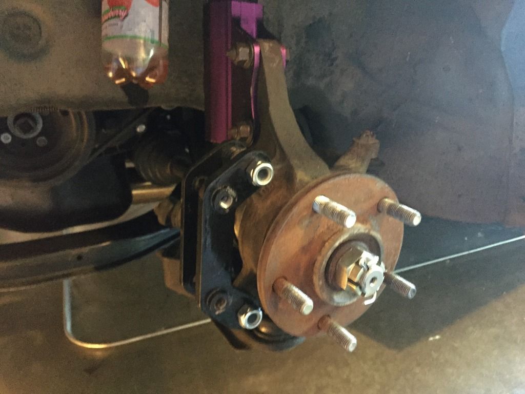

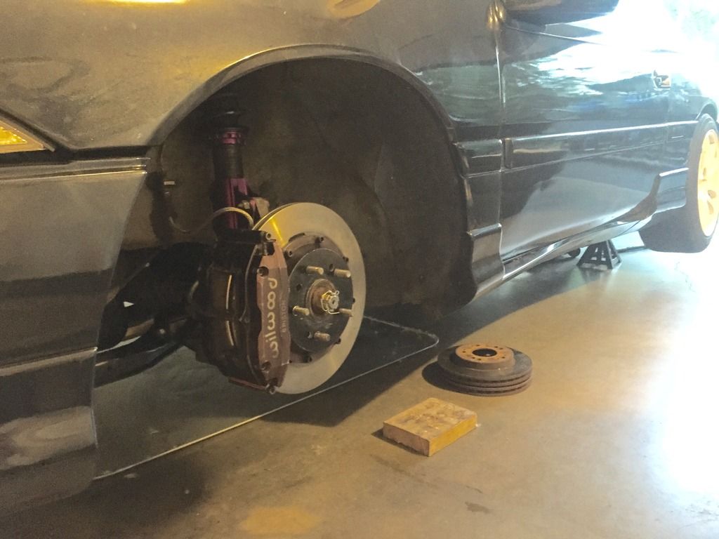

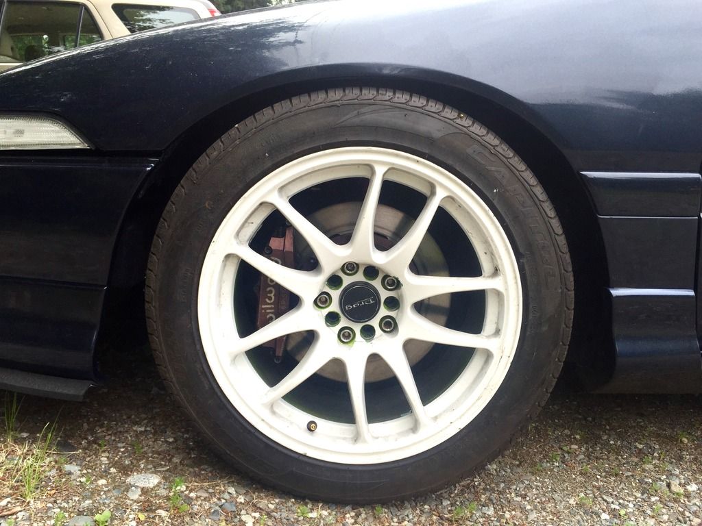

So i heard an unnerving scraping from my front brakes after about 500 miles on the new motor. In all fairness, a lot of those miles were "spirited' to say the least. I figured that was as good an excuse as any to upgrade to big brakes. These wilwood 6 pistons have probably been around for 10+ years, but they still get the job done.
Side note- ^these tires are trash.. Took me half a mile of driving to want to miss my worn out g force sports. It doesn't help that the tread pattern looks awful.

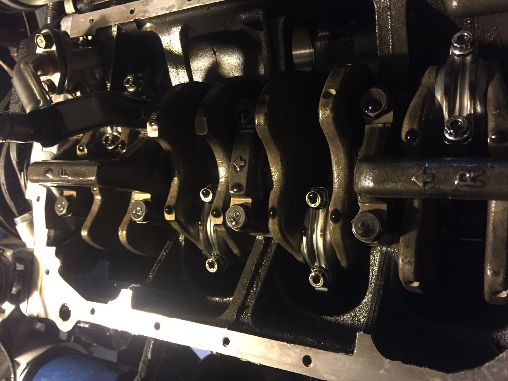

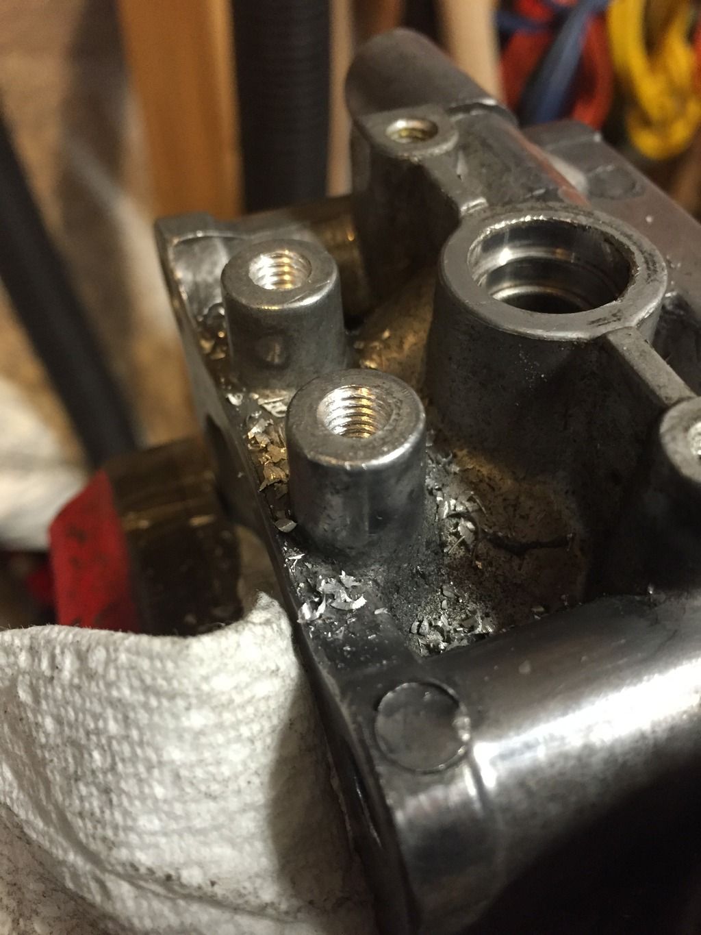

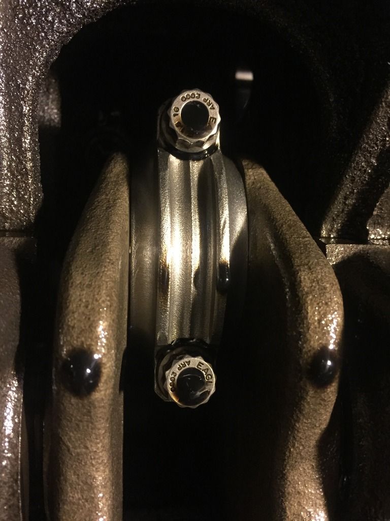

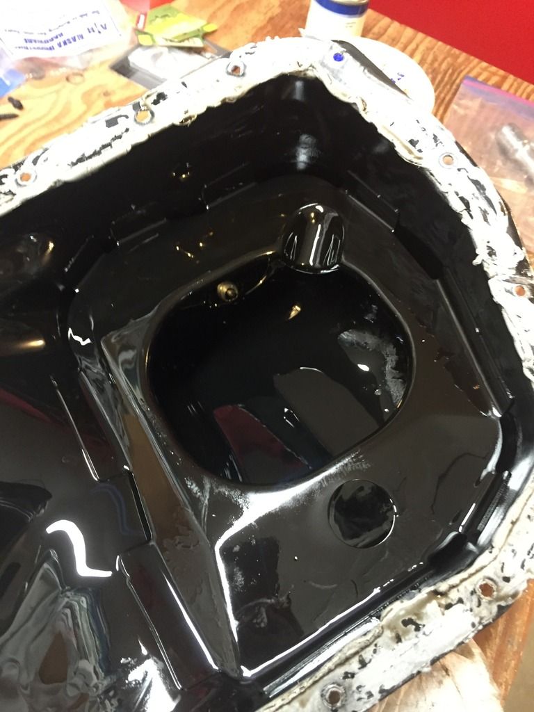

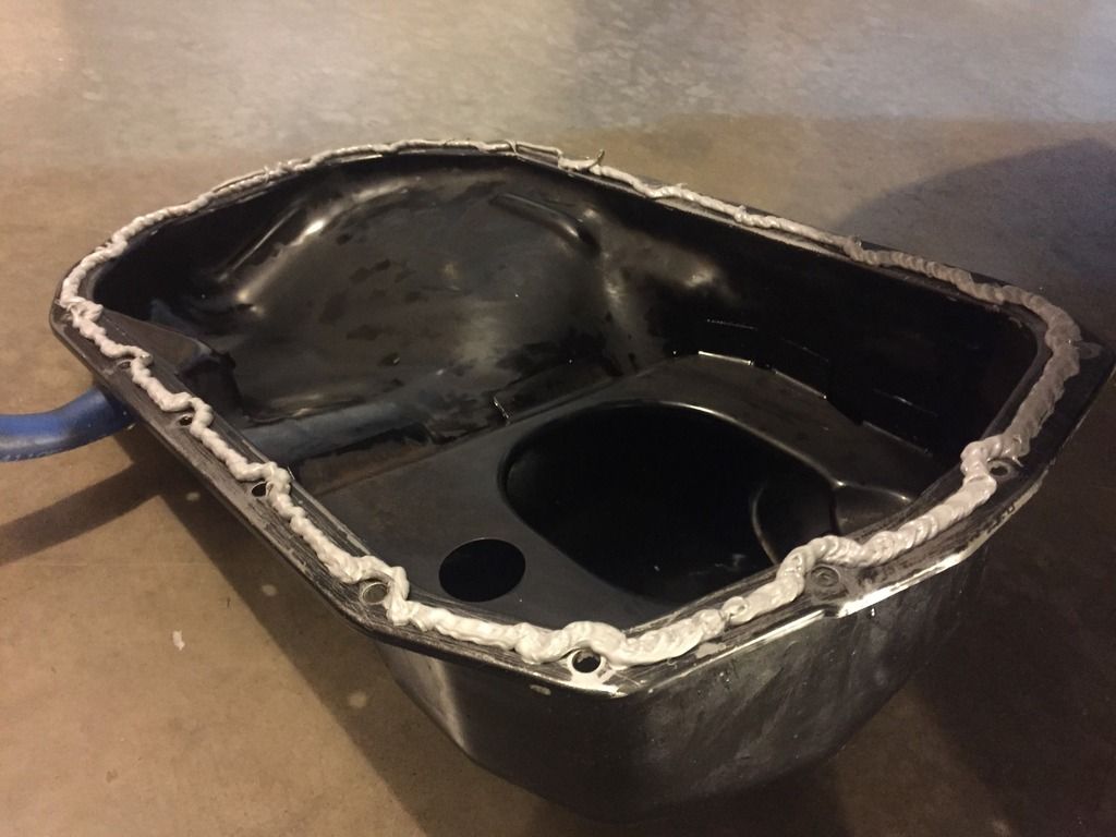

I also took the oil pan off to fix a leaky seal. The good news is i didn't find a single metal shaving! The rod caps didn't have any heat marks and i didn't find any foreign material whatsoever. The not so great news is IM STILL LEAKING OIL. It doesn't seem to be coming from the pan but still drives me crazy. Nothing is more infuriating to me than unsolvable oil leaks.

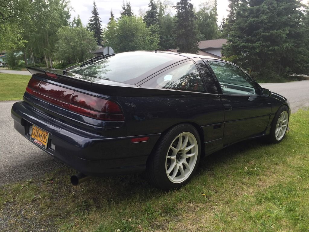

And lastly i finally got around to cutting and buffing my 2 year old paint job. Super happy with the results.

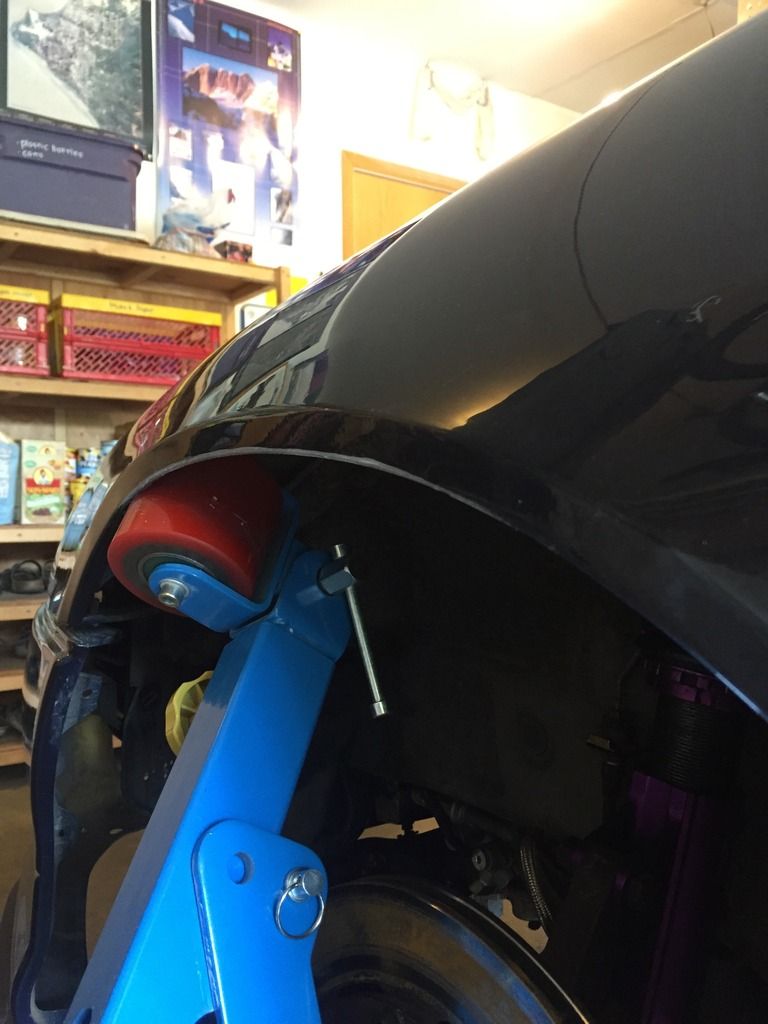

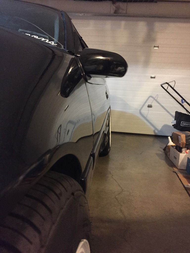

I had to roll the front fenders in order to make room for these 245's. Im still not sold on these wider tires though, they are a very tight fit for a gain of only 10mm in width.

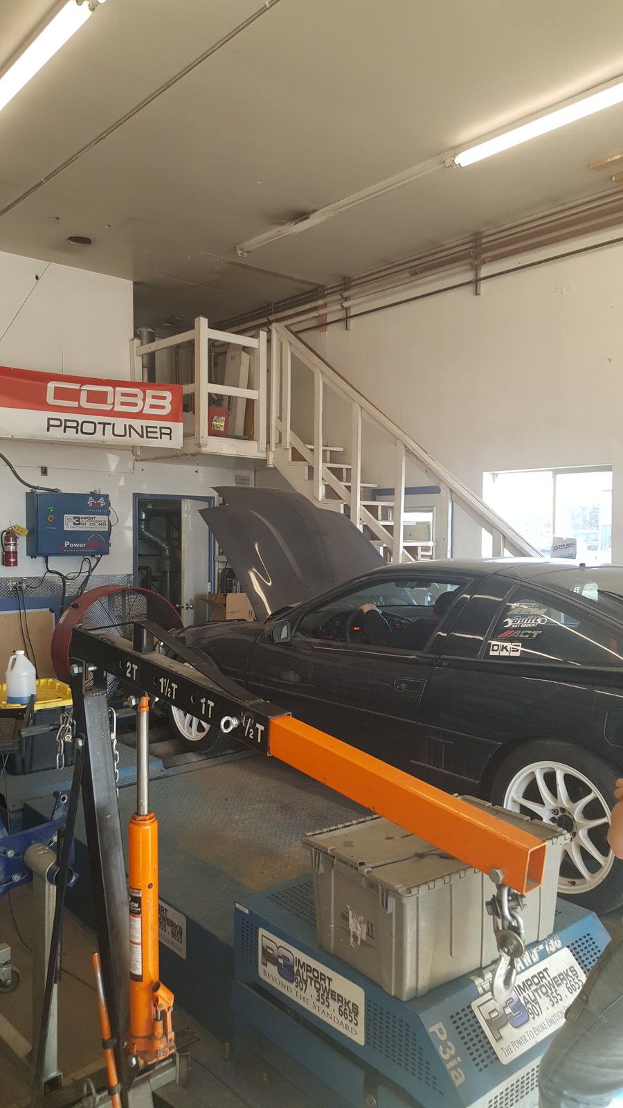

Hello again everyone. Breakup finally hit up here in Alaska. We got the aqua mist kit installed and the car up on the dyno. But of course we hit a few snags. The oil pressure is a little high and we couldn't get any boost control so it was waste gate pressure only until it hit some boost creep. Turns out one of the wires for the solenoid didn't get crimped(all my fault). I'm Hoping that porting the ofh will solve my oil pressure issue. As for the boost creep I'm not sure where to start yet on that. But the car runs well. It made 310 so far. I'll update again when everything is nailed down and we get the full tune done.

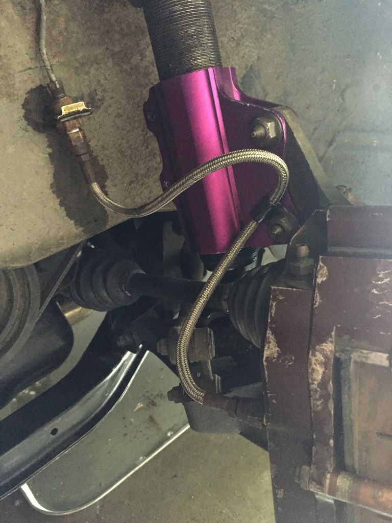

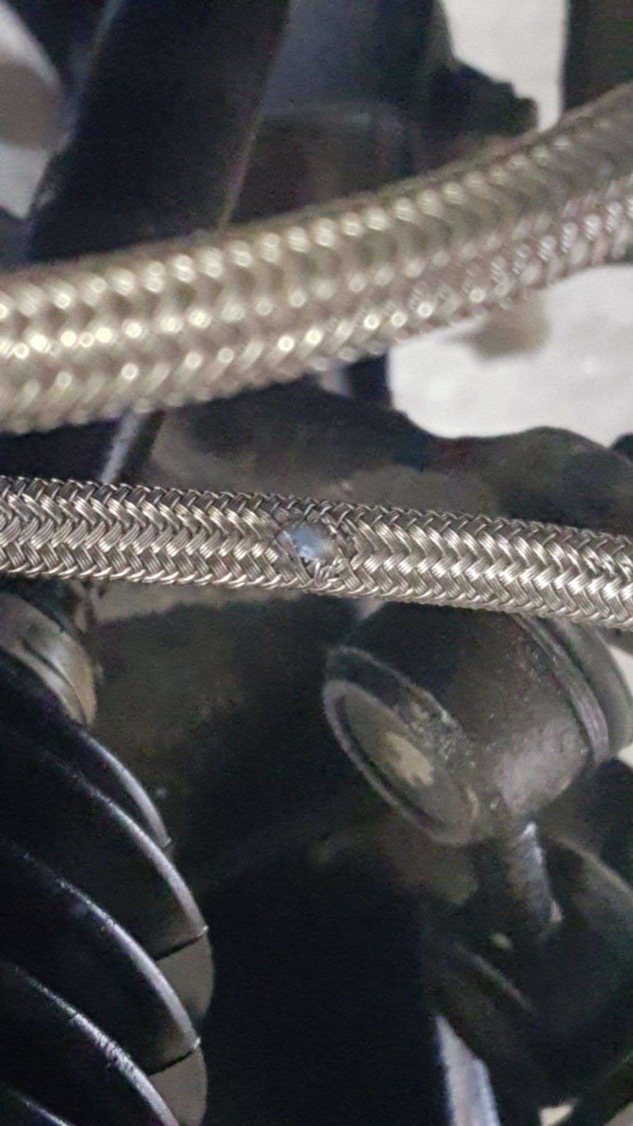

Well a few hours later I get a call telling me the car has no brakes and they can find out why for me if I'd like. I told them to leave it on the lift and I'll be right there. There was a lot of brake fluid all over when I got there. Now I drove the car a good 50 miles the day before and the bakes worked just fine when I dropped the car off. Just saying. So I had the car towed home and in 10 mins found a hole in the brake hose idk how the certified techs missed that one.

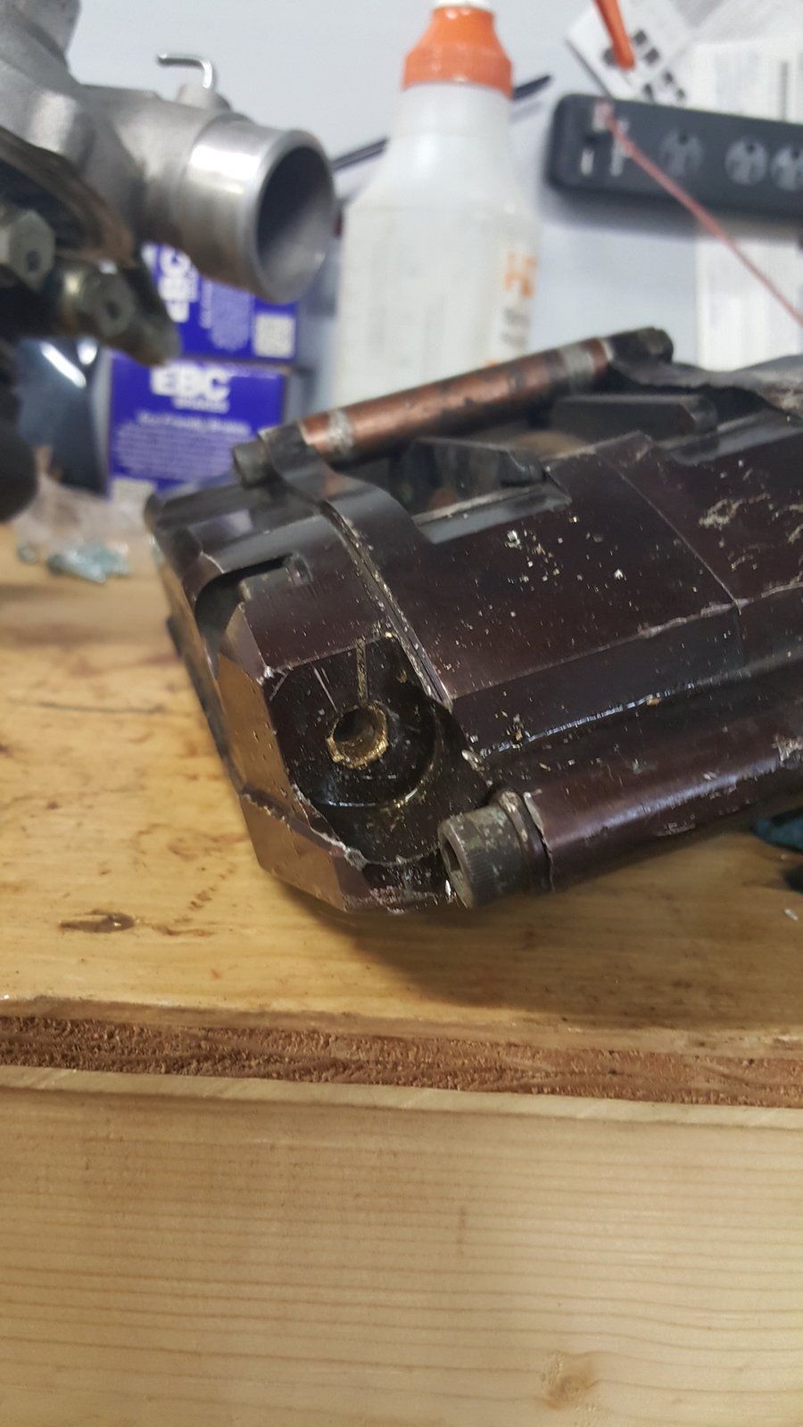

And finally with the car having no brakes I felt this was a great time to replace some broken bleeders on the wilwood 120-5957/6 superlite 6s. More on that later. Well I got 3 of the 4 valves changed then I managed to destroy the driver side caliper when the 4th was stuck. I should have left it alone but I didn't anyway the machine shop doesn't want to touch it and I think I'm good with that.
So on to my story. This morning I called wilwood to see if maybe this caliper was still around. The answer was quickly a no LOL. But wilwoods customer service was great they spent a good half hour with me finding a caliper that would use the same pads and rotors although they were radial mount and I would need a bracket kit. Then they gave me a few numbers to call.
The magic number was tce performance. I called them and told the guy my story and right away he says oh yeah that's my kit I made those way back for that car. He then very quickly rattled off a part number that would bolt right up to the kit I have and use the pads and rotors so for 150 a caliper I have new wilwood 4 pistons on the way. I highly recommend tce performance for brake needs.

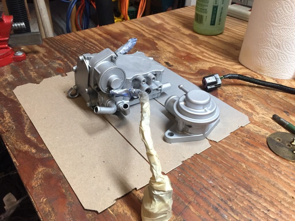

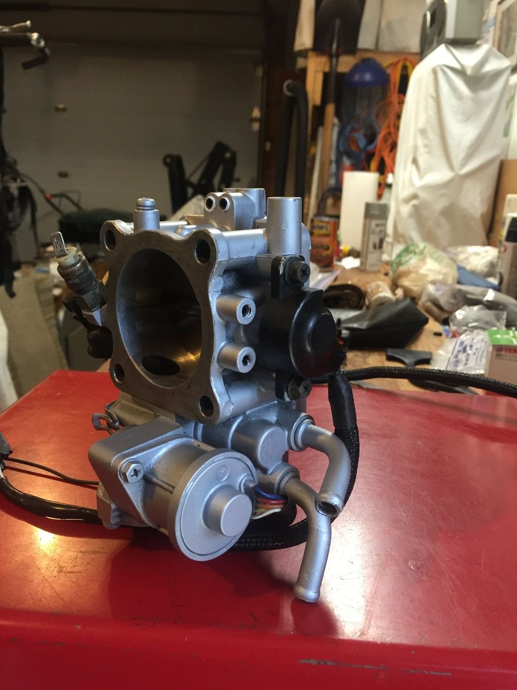

So now that I have no brakes I think it's a great time to port my ofh. So that's my story.
