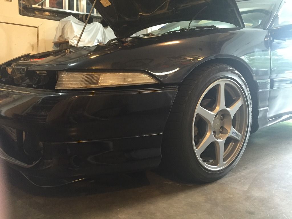

Why did you get rid of the FD wheels for the Evo8's? I thought everyone wanted the light FD's?
Yep, that's the block out of my old car (the one that I was told was "built" LOL) and the stock head off of my current car. I may just have future plans for it...
I really liked the fd wheels, but I couldn't justify getting extended studs and spacers for a 16" wheel as I may be going with bigger brakes in the future. Also I really like the fitment of the evo8's with the slightly lower offset.

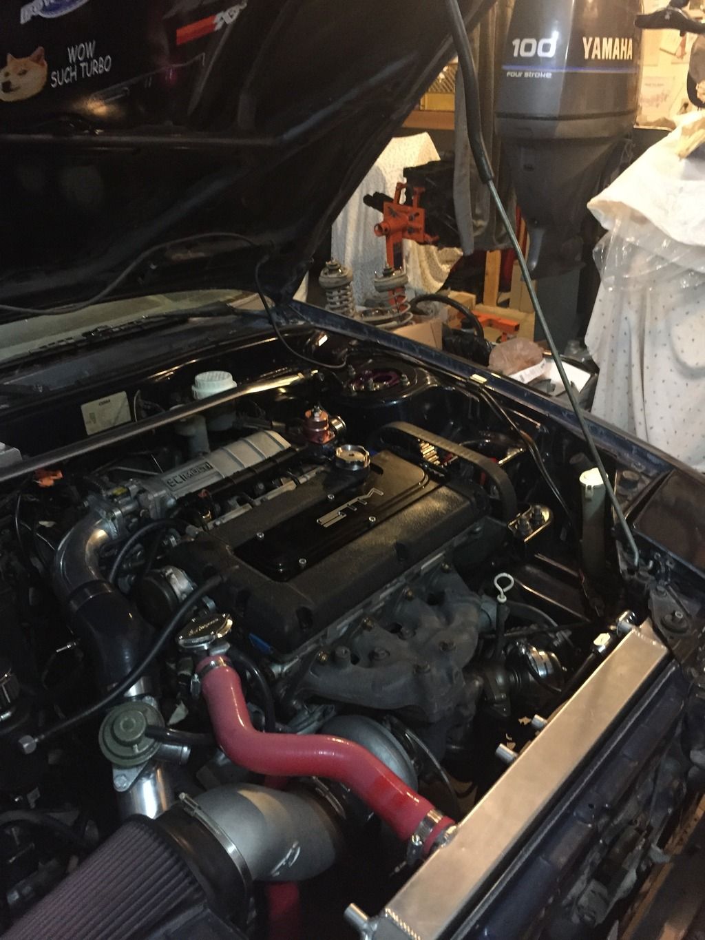

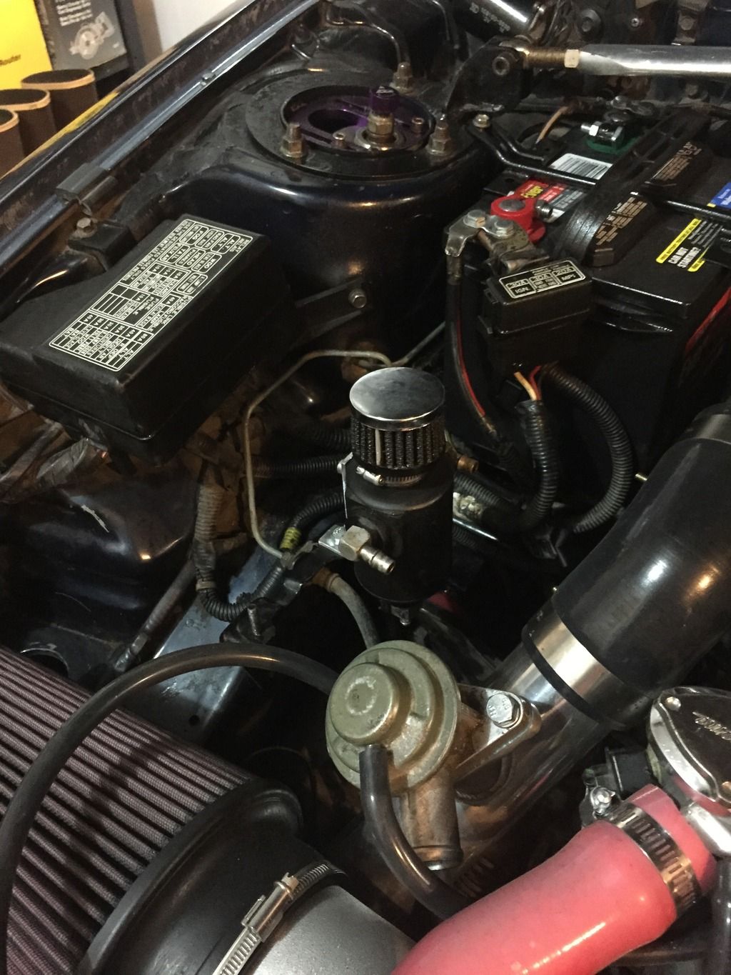

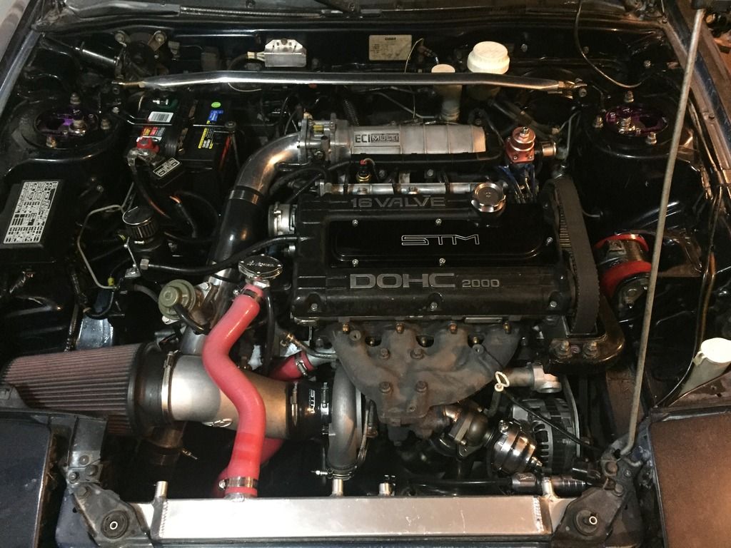

So why didn't you run the map sensor off the intake manifold?
Thanks everybody for the kind words! Really helps motivate me to finish it.
Good work ! Makes me not miss doing body work at all!
I didn't run the map sensor straight off the intake mani because by the time I figured out that I was going to run speed density the manifold was already on the car. And tapping into it then would've gotten metal shavings in everything. The brake booster line seems to be working well for now and its pretty inconspicuous.

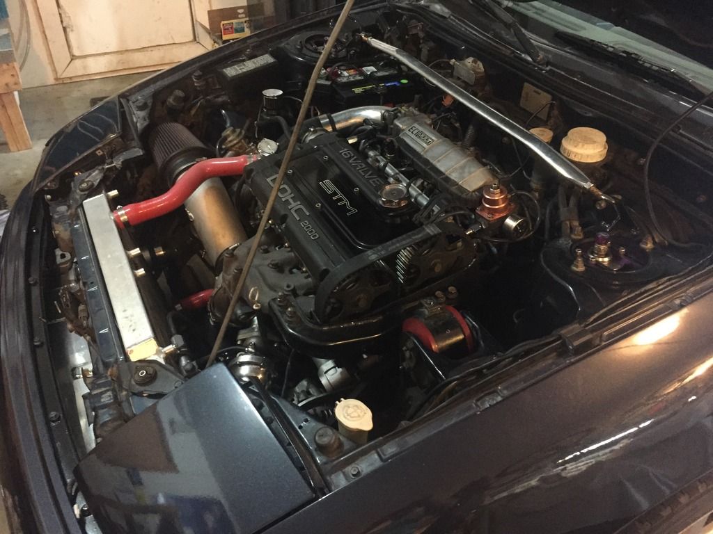

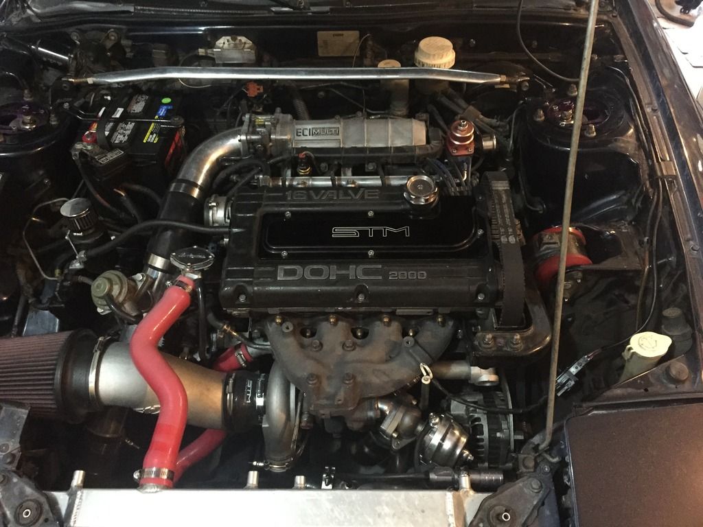

Not much to report, but heres a little bit of an update. Ive put almost 500 miles on the car so far, and all is good! There are still all sorts of minor leaks and issues that im working through but the car is running great. It pulls pretty decent too considering the super conservative 14psi and 8 degrees of peak timing. Ive been taking it to quite a few meets and local events and the car seems pretty well received :hellyeah:. Oh how I missed driving a dsm!
Looks good. Are you going to be putting in the rest of the front lenses?
Yea I am. I actually took them out because the car was getting a little hot in traffic on a really warm day. Wanted to see if a little extra airflow helped.
Coolant overflow mounted where the stock smic was.

Looped my power steering lines. I love how much room it frees up in the engine bay.

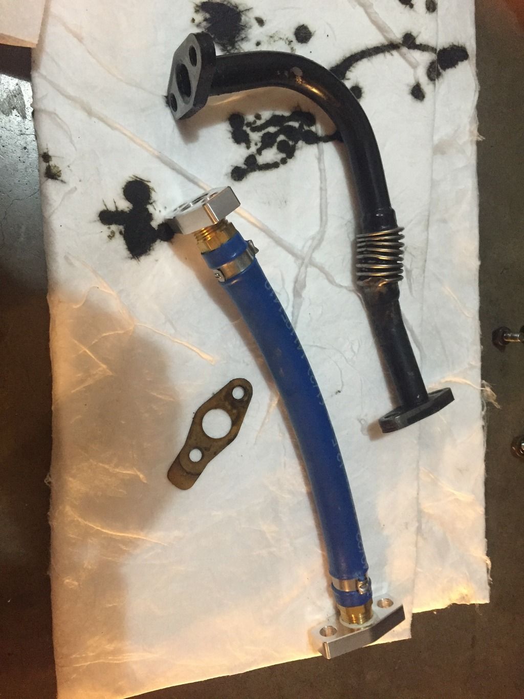

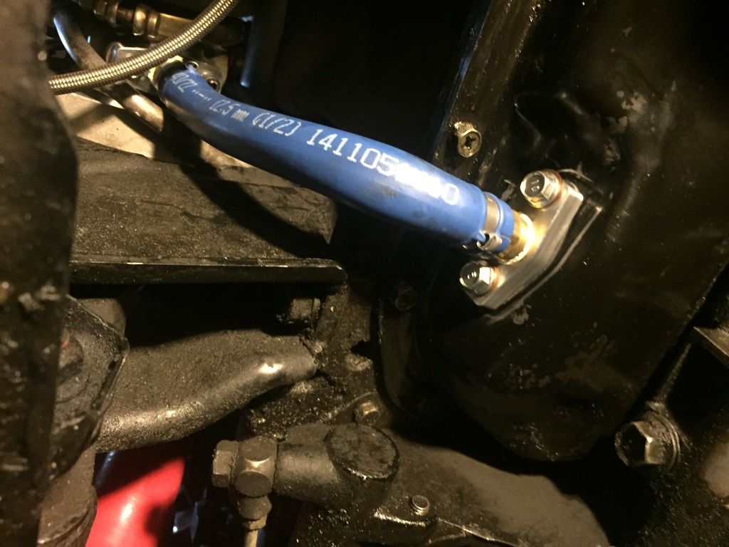

5th time is the charm (hopefully) trying to get my oil drain to seal without leaking oil. This time im switching to an fp blue drain tube, and all new oem bolts and gaskets. I even used a bit of rtv... Normally I avoid the stuff like the plague.

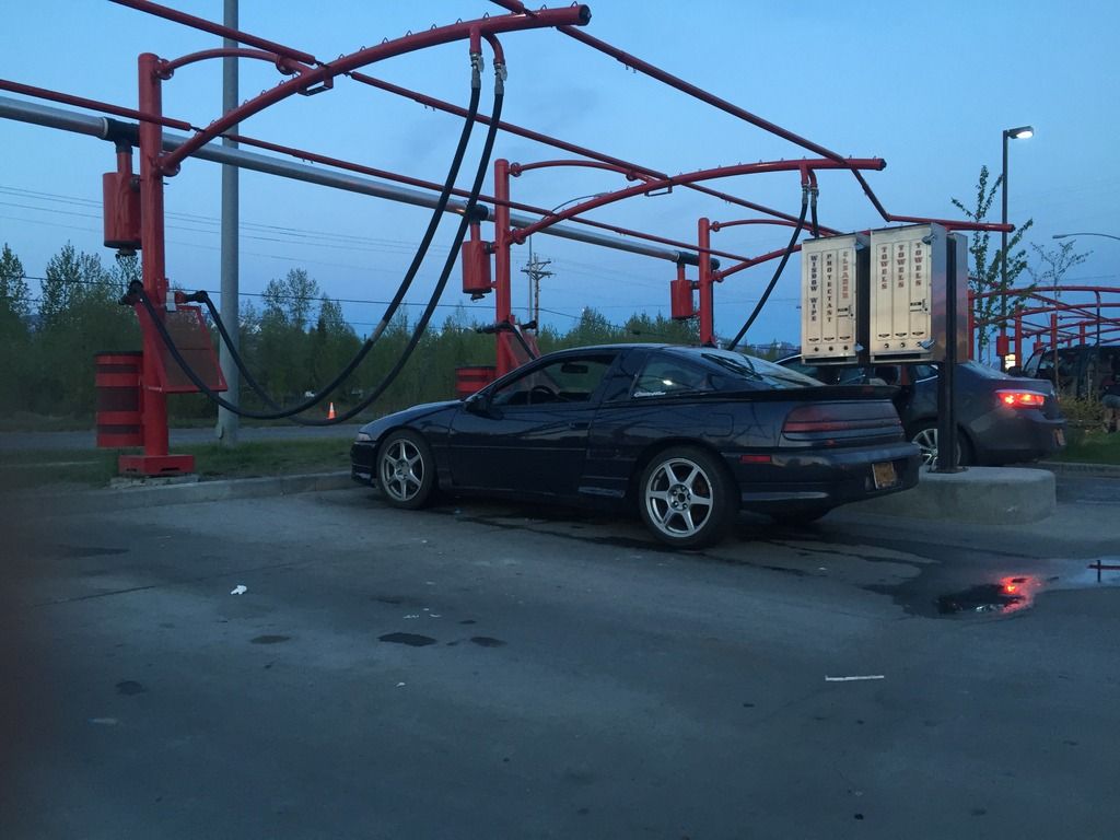

Stupid Alaska roads, the underside of my car gets so filthy.
Took it to a buddys to give the engine bay a good clean with a power washer.

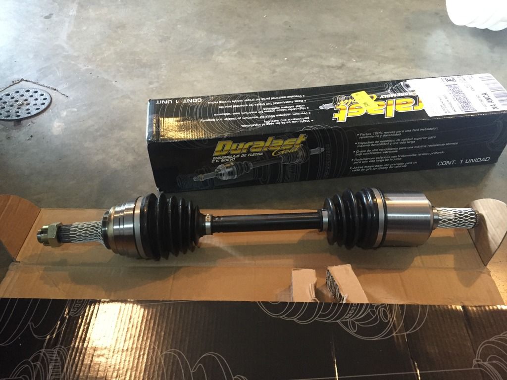

The car is now currently down because I had to send my downpipe to a machine shop to have the flange machined flat (it was leaking and throwing my afr's off). I was also having some issues getting the car into first gear, and it appears my master cylinder was the culprit. So new master and slave are soon to come too.
Oh yeah, new axles are going in too!

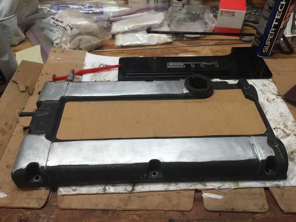

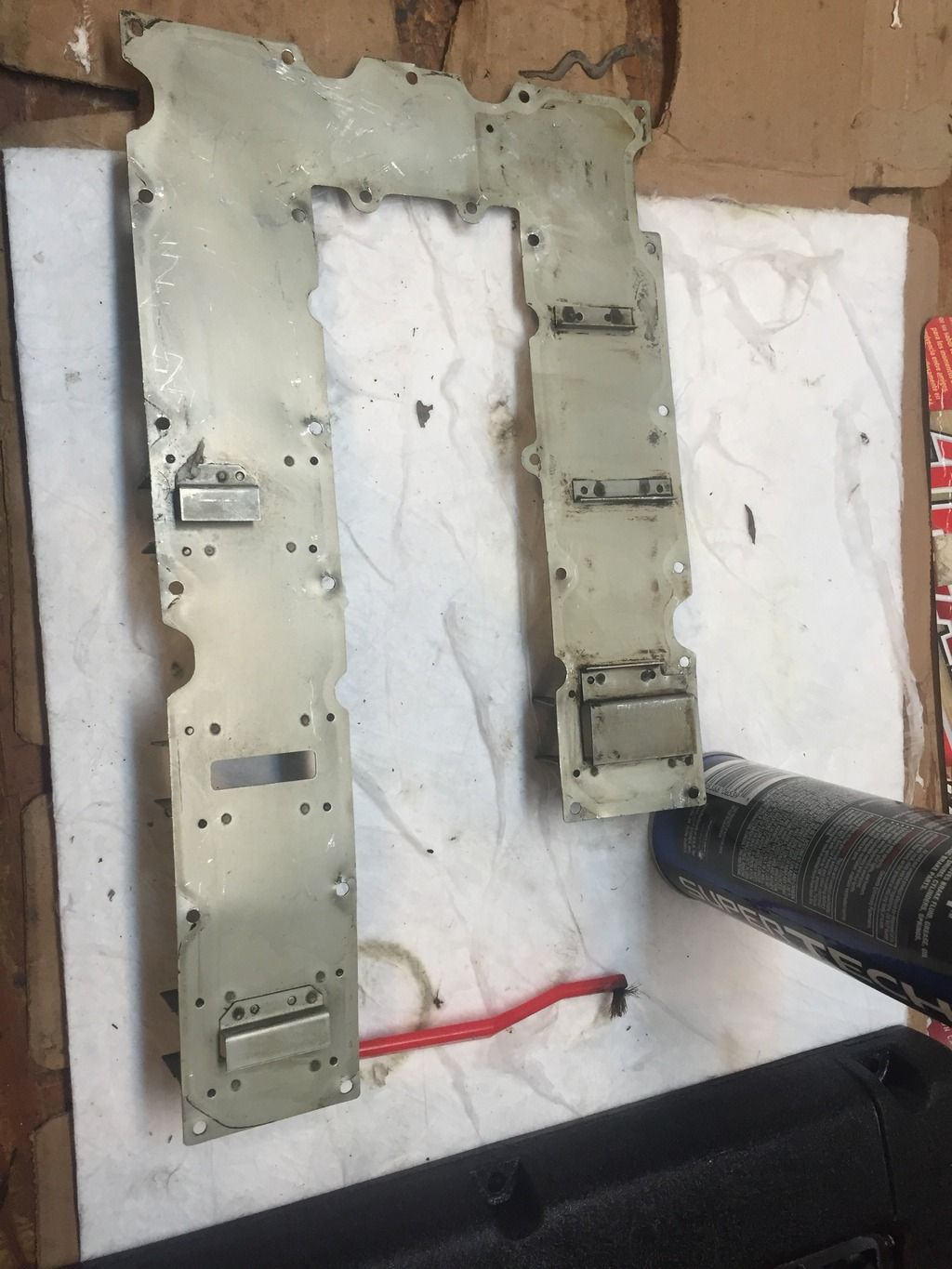

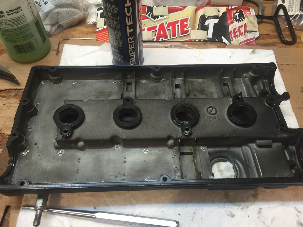

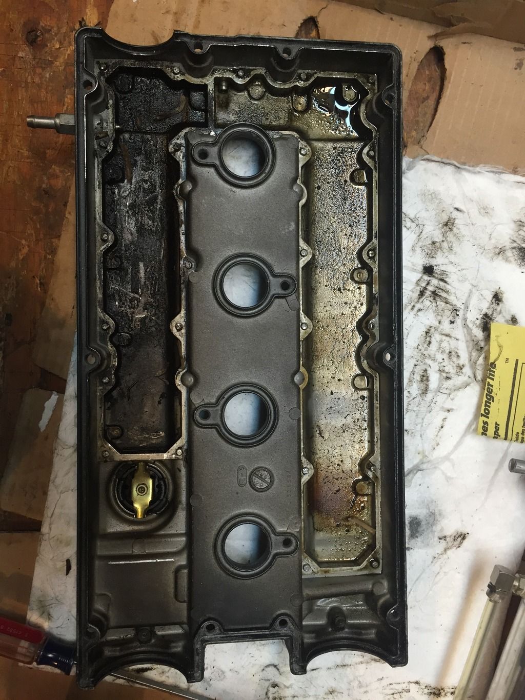

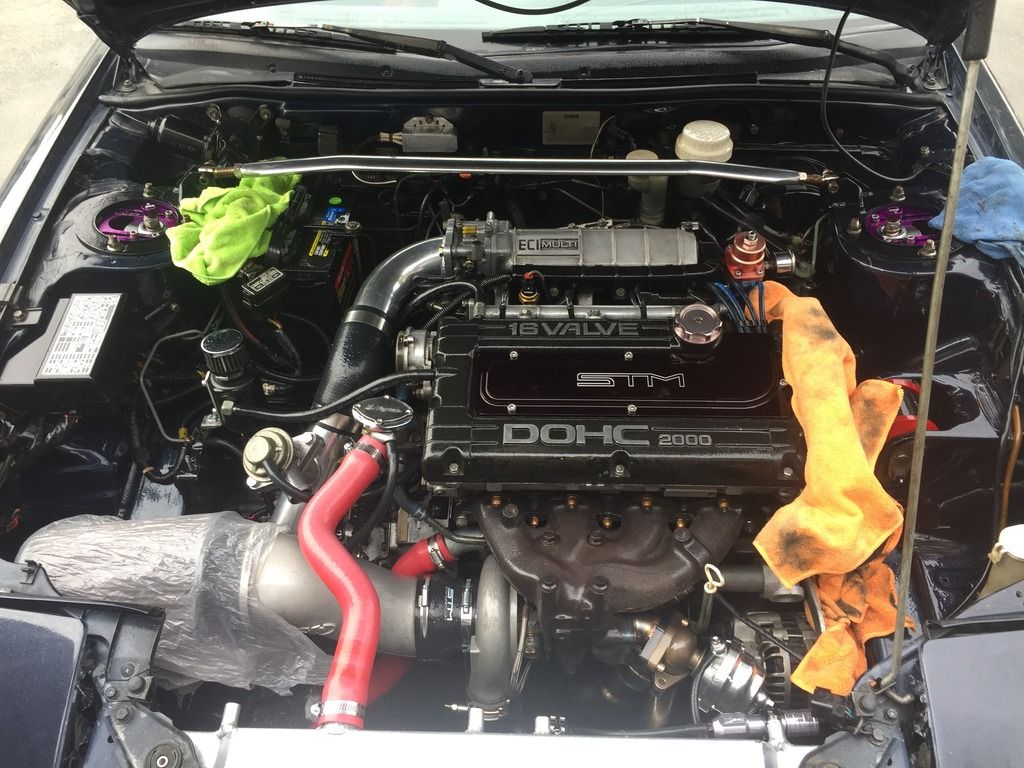

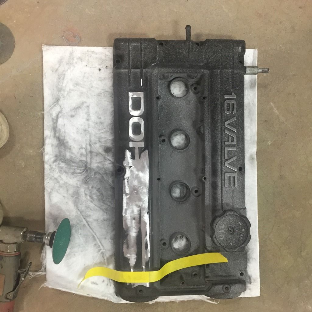

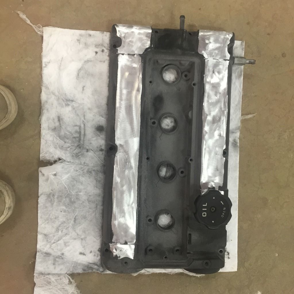

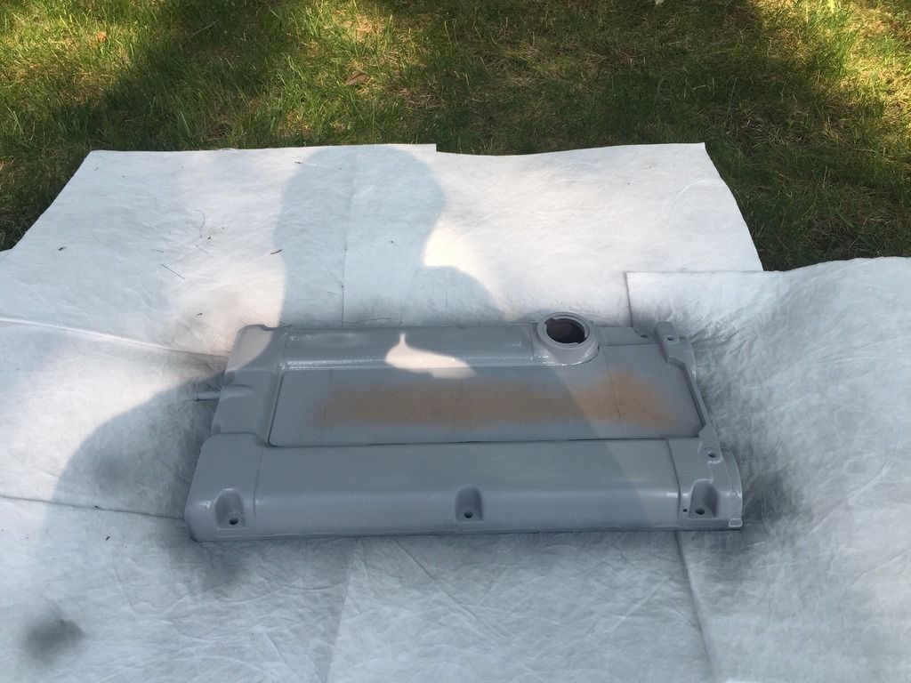

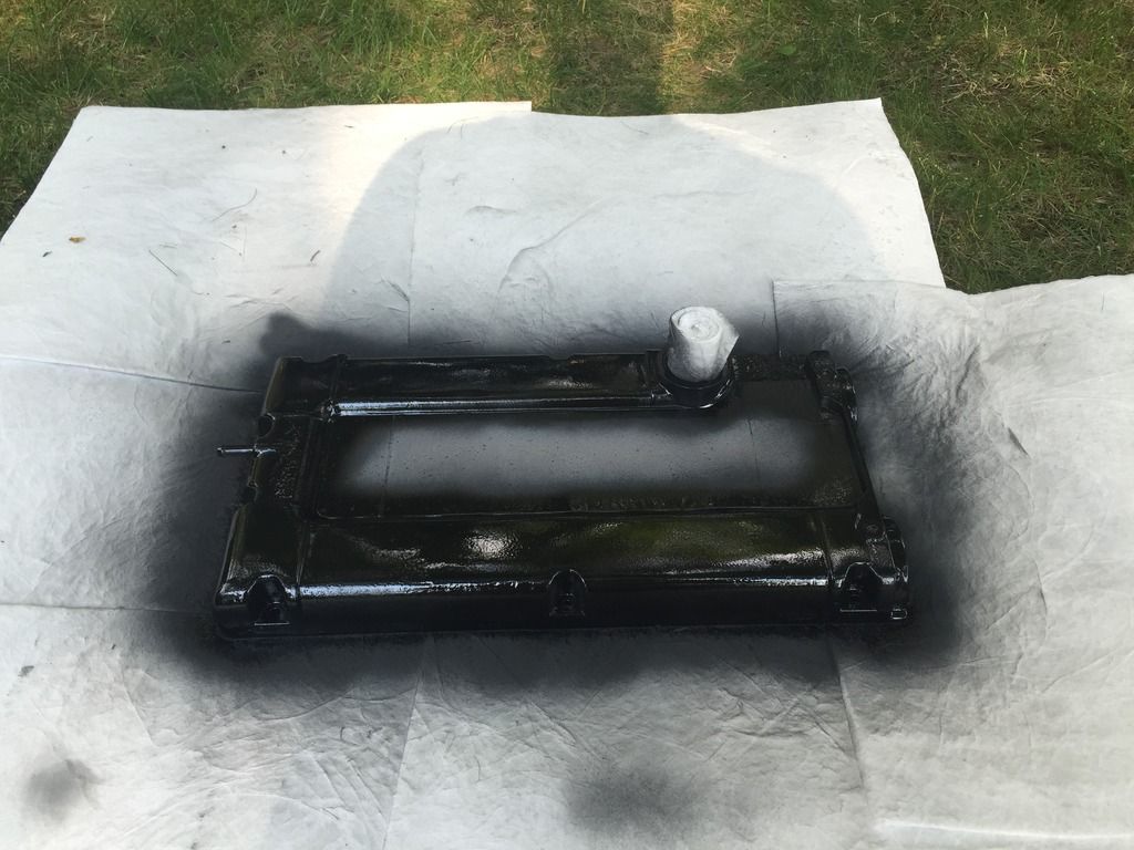

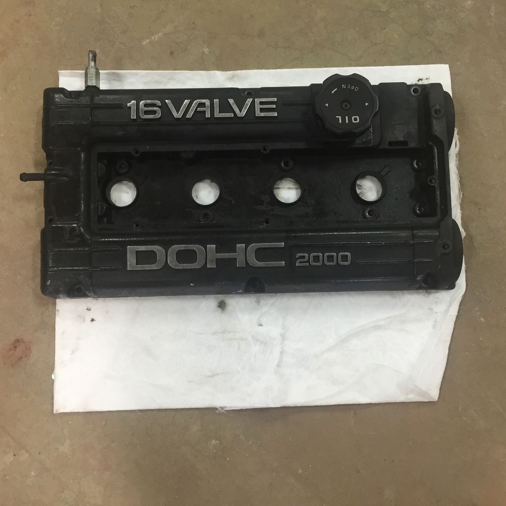

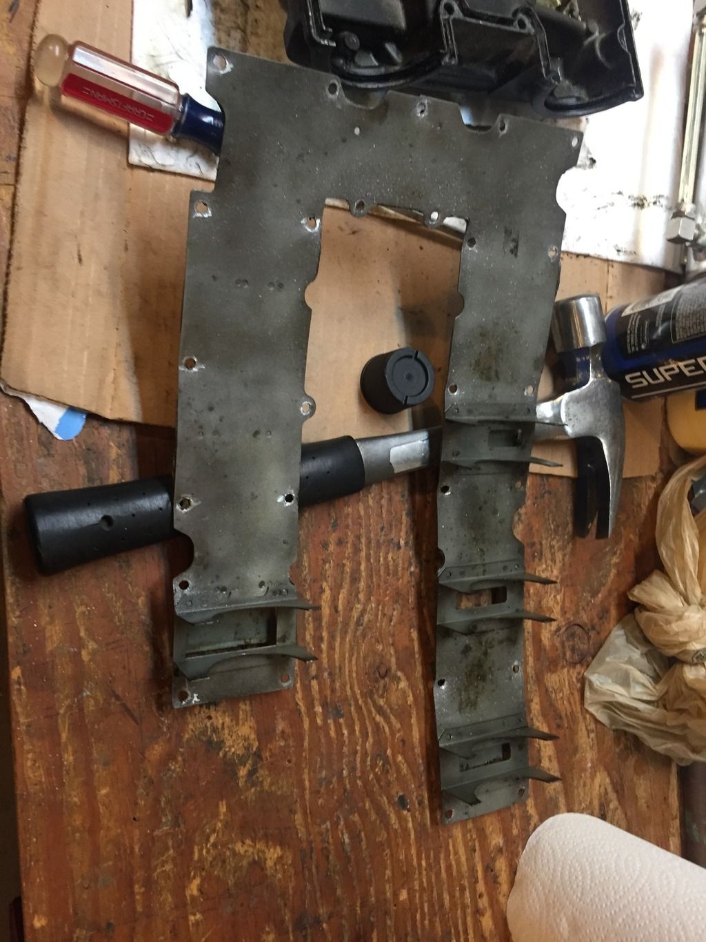

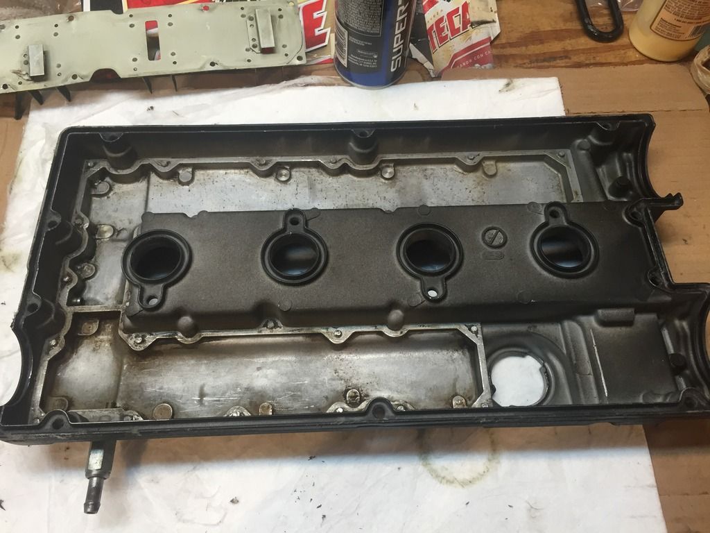

Hell yeah we will have to do some midnight snow drifting which is my favorite. Are those new valve cover baffles or did you just clean and Re weld the old one?
They are the original baffles. Just cleaned up and put back they way the factory installs them (sealant around the perimeter and peen the stubs back so they are mushroomed and hold the valve cover in place). The removal is kind of tedious but I just followed a tutorial on this site.
