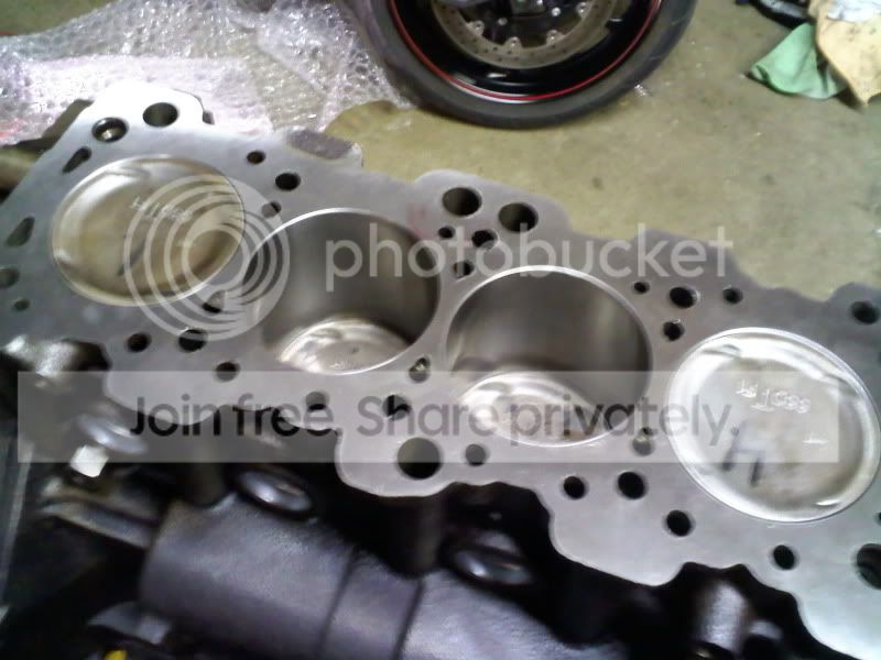

More progress, shortblock assembled

I got my fuel pump rewire kit installed yesterday and finished assembling my short block. Now I just need to get a long block gasket kit, oil pump/front case, headstuds, headgasket, and all new t-belt components and that should take care of my long block. Then I will still have things to get like the turbo, exhaust, clutch, etc. Although I think I may just put a lot of the old stock parts back on just for the fact that I need to get this thing back together quick and cheap. But at least I'll have a good motor to start modding.
The short block is all stock with arp main studs and new piston rings.

Pistons are labeled backwards, #1 is always at the timing belt side!
I guess that's how you count =)
That may be true but thats how I labeled them when I took them out.

I may have missed it but is your longblock just a 6-bolt rebuild using all stock components with a few exceptions for studs etc?
yes but it's a 7 bolt
stock rebuilds on both blocks? why not put some forged pistons on evo pistons in and some rods at least?
and he only wants 350hp, no need for built engine till after 500hp.
yea sure my stock block i was pushing almost 300 we took it apart and pistons 3 and 4 the rings are like gone and the bearings. needs a whole rebuild might as well put a forged bottom end in sell the stock parts
