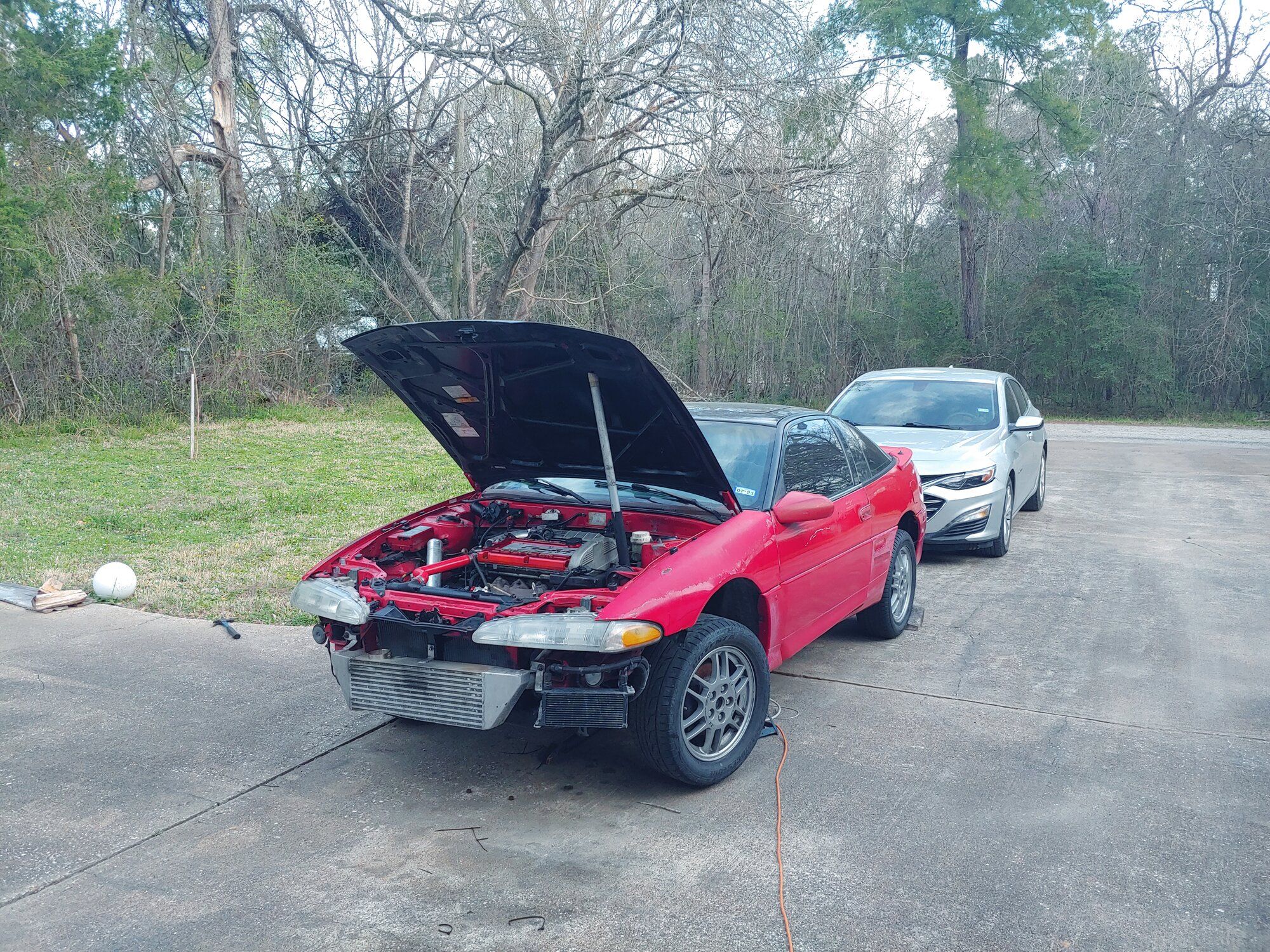

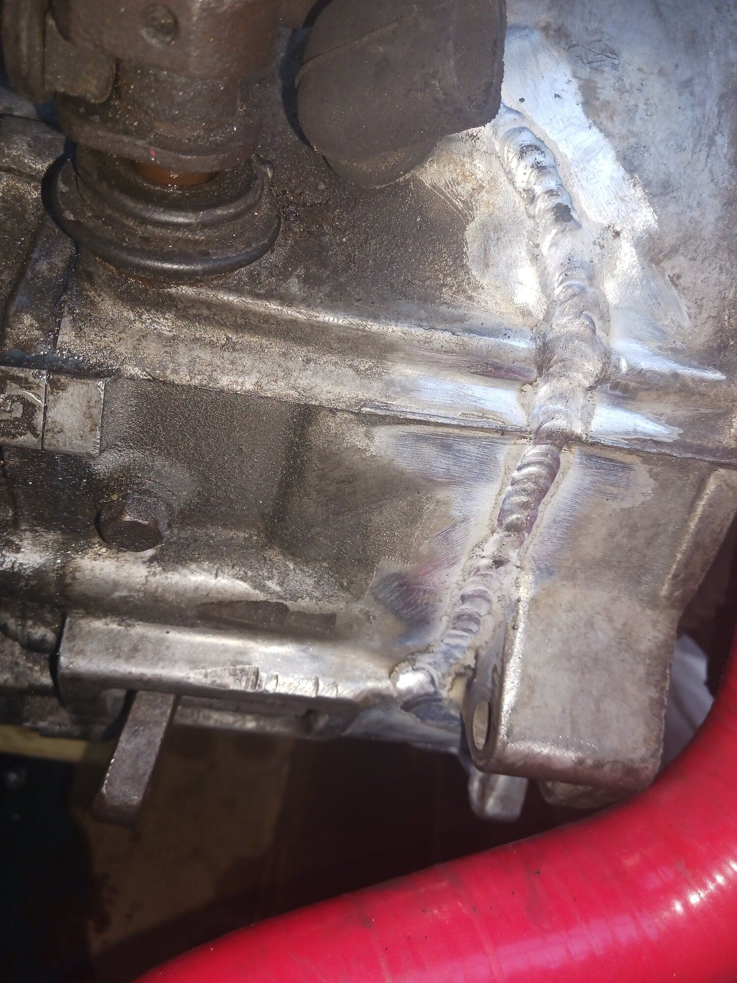

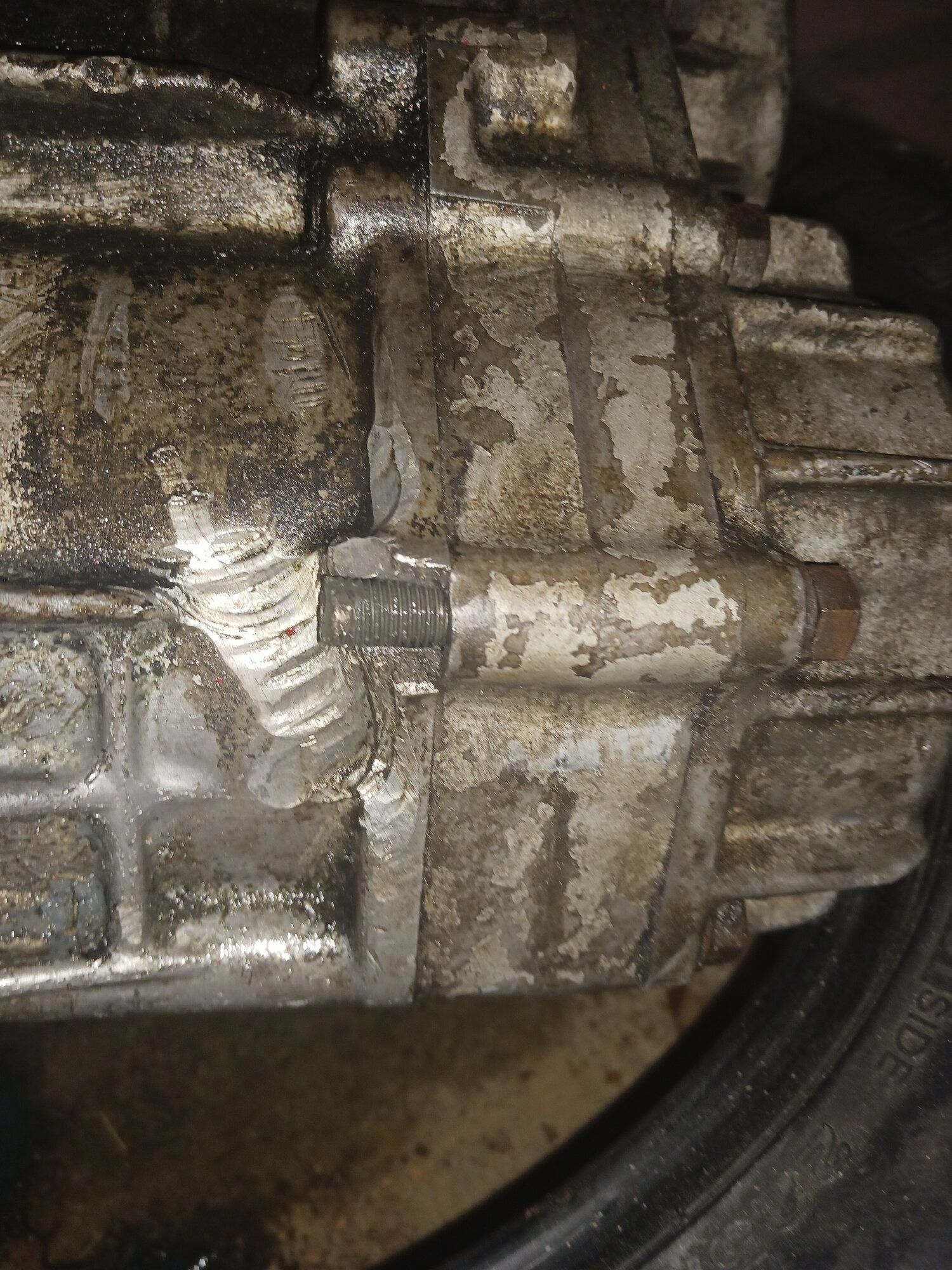

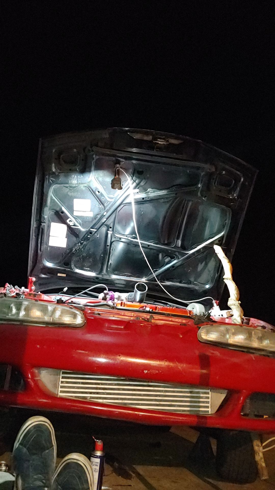

broke the slave cylnder mounting ear amd cracked the bellhousing in the proccess so its goin on jack stands for a bit so it can get some love, i took the bumber off and found 2 out of 3 fmic mounts completely broke so ill be replacing that with a mishimoto at some point for now i just slapped some jb weld on it and its holding fine, still have yet to find the issue on the starter but thats for another day im gonna have the bellhousing welded because from what ive read on the forums you have to dissasemble the trans to take the BH off and i think im good on that for now until i get a dsm bible
MAke sure you put all the bolts in the trans ask me how i know i didnt put the back on in near the firewall.
Definetly im keeping track of evrrything amd takimg picutre of the thing i take apart incase i forget something since its going to be sitting until i find someone that can weld cast aluminum near me and i can afford it😂
So i was trying to get my car together for my birthday(today) and its all come down to a damn seal on the passenger front cv axle where it goes into the trans..🤦‍♂️ long story short i got the trans welded up just to find another broken ear on the trans side this time, but its hasnt leaked since ive owned it so it getting thrown back into the car tonight and tmr ill have the seal to slap in, i cant find anywhere that gives you the right part number for it, only one ive been told that actually fits is 710396 precision or masterpro from oriellys or AZ but they measure different thicknesses can anyone confirm which one i need to run? Also does anyone have the dimentions for the hidden bolt on the back side of the BH? mine was missing so id like to put a bolt there😂🤦‍♂️

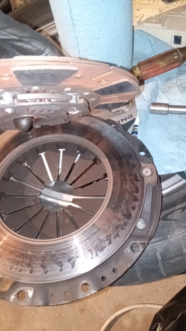

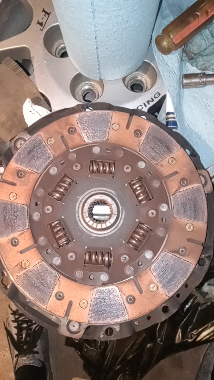

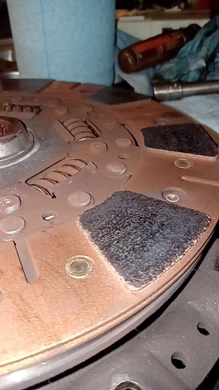

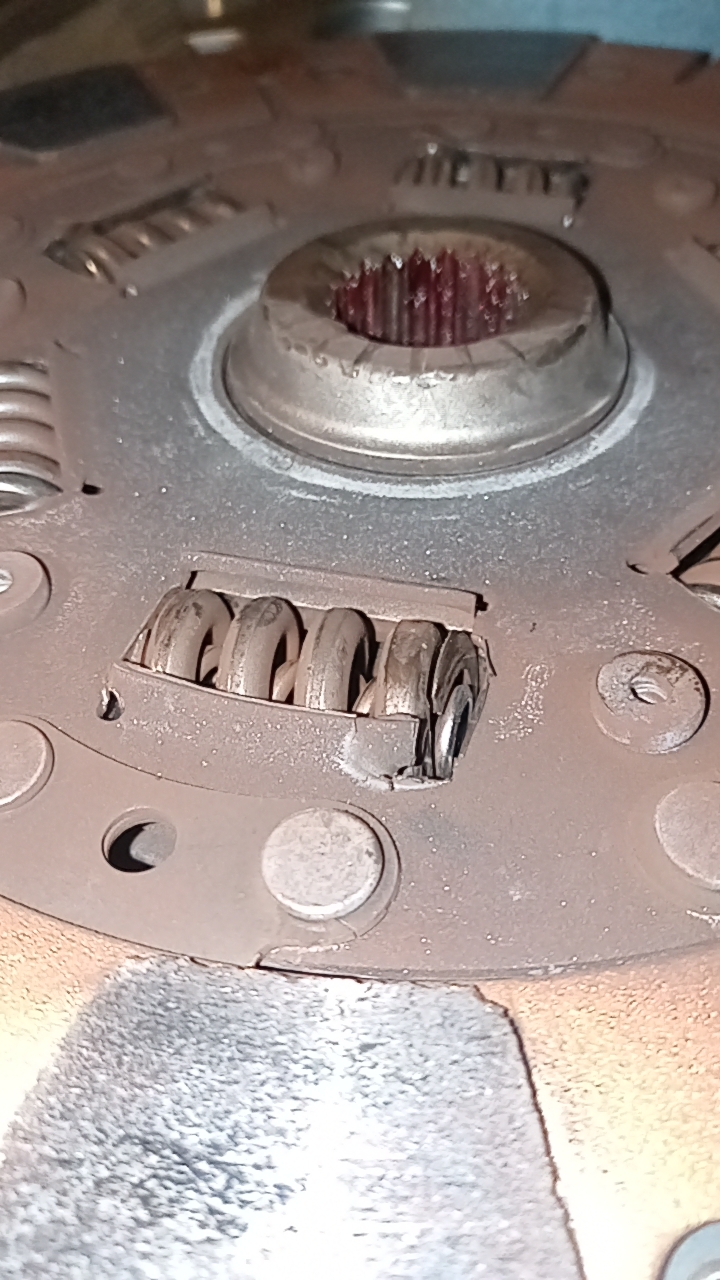

When the transmission was still in it shifted completely normal except second would grind a bit when putting it into gear, once it was in second it was fine unless I let off while going slow or around a corner and then it would pop out into neutral so I decided to pull it after the TOB started making noise, and the TOB was toast along with the stage 3 comp clutch stop and go traffic probably was the best for it but I definety had some clutch drag. probably gonna switch to a more street friendly clutch and oem TOB. And hopefully not pulling it again for syncros...also might try a different fluid
